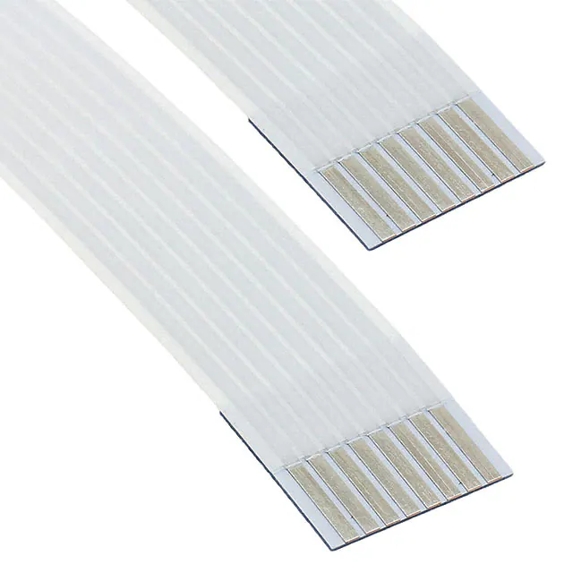

Premo-Flex™ FFC jumpers, available in a variety of pitches, cable lengths and thicknesses, plus high-temperature ratings up to +105°C, deliver durable, ultra flexible, low-cost solutions for PCB connections in virtually any industry The complete line of 0.50, 1.00 and 1.25mm pitch flat flex cable (FFC) jumpers offers standard lengths, pitches and circuit sizes to accommodate a wide range of flexible interconnect requirements between two PC boards. Standard, off-the-shelf FFC cable jumpers reduce lead-times and tooling costs to the customer. In addition, Molex can also accommodate custom requirements for FFC cable jumpers in lengths of over 305mm, with prototype lead-times of around 1 week. The flat flex jumpers are terminated to Zero Insertion Force (ZIF), non-ZIF or Low Insertion Force (LIF) FFC connectors, available from Molex. Premo-Flex standard flat flex jumpers are now available in extra flexible 0.12mm cable, ideal for complex board-toboard interconnections in confined spaces. Molex offers an extensive range of FFC connectors and is able to design customized FFC connectors to customer requirements. Type A (same-side) and Type D (opposite-side) contact layouts allow for mirrored contacts in top- and bottom-mount ZIF applications. For additional information visit: www.molex.com/product/premoflex_ffc-fpc.html FEATURES AND BENEFITS • Available in numerous circuit sizes (4 to 60) and custom lengths • Provides limitless design-in options • Contact area can be configured on the same or opposite sides of the flexible cable jumper • Cable mirrors signal layout between PCBs • Rated up to +105°C • Meets industry-standard requirements • Simple assembly process • Ideal for electrical connections between PCBs, display boards, etc. • Various cable termination thicknesses • Meets industry-standard ZIF connector requirements • Ease-of-assembly in hard-to-reach applications • Polyester insulation • Meets Registration Evaluation, Authorization and Restriction of Chemicals (REACH) requirements • Extra flexible 0.12mm cable option • Extends life of cable: 900,000 cycles vs. standard jumper flex life of 6,000 cycles Premo-Flex™ Flat Flex Cable Jumpers Cable Thickness 0.12mm 15166 Tin, 0.50mm Pitch, 105°C 15167 Tin, 1.00mm Pitch, 105°C 15168 Tin, 1.25mm Pitch, 105°C Cable Thickness 0.22mm 98266 Tin, 0.50mm Pitch, 105°C 98267 Tin, 1.00mm Pitch, 105°C 98268 Tin, 1.25mm Pitch, 105°C Cable Thickness 0.27mm 15266 Tin, 0.50mm Pitch, 105°C 15267 Tin, 1.00mm Pitch, 105°C 15268 Tin, 1.25mm Pitch, 105°C 15020 Gold, 0.50mm Pitch, 105°C 15039 Gold, 1.00mm Pitch, 105°C 15049 Gold, 1.25mm Pitch, 105°C Premo-Flex™ Flat Flex Jumpers MARKETS AND APPLICATIONS • Automotive - Radio, CD, DVD, GPS device - LCD display - Keyboard - Moveable units • • • • Industrial Medical Equipment Military Home Appliance - Control Panels • Consumer - Set top box - Camcorder - Plasma display • Computer - Notebook - Printer - Scanner - Keyboard - LCD flat panel Automotive Electronics Surgery Lamp SPECIFICATIONS Electrical Voltage (max.): 60V Current (max.): 0.50mm Pitch — 0.5A 1.00mm Pitch — 1.2A 1.25mm Pitch — 1.4A Conductor Resistance: 730 ohms per km. max. Insulation Resistance: 10 Megohms per km. min. Dielectric Test: 200V AC for 1 minute, no disrupted discharge Reference Information Packaging: Box UL Style No: 20706 (copper wire) Flame Resistance: UL 758 VW-1 RoHS: Yes Halogen Free: Yes Physical Temperature Rating: -40 to +105°C Heat Resistance: 168 hours at +136°C Moisture Resistance: 96 hours at +60°C, 95% Relative Humidity (RH) Folding: Specimen to be folded manually at +180° over a 4.00mm (.157") radius, min. 20 cycles Premo-Flex™ Flat Flex Cable Jumpers Cable Thickness 0.12mm 15166 Tin, 0.50mm Pitch, 105°C 15167 Tin, 1.00mm Pitch, 105°C 15168 Tin, 1.25mm Pitch, 105°C Cable Thickness 0.22mm 98266 Tin, 0.50mm Pitch, 105°C 98267 Tin, 1.00mm Pitch, 105°C 98268 Tin, 1.25mm Pitch, 105°C Cable Thickness 0.27mm 15266 Tin, 0.50mm Pitch, 105°C 15267 Tin, 1.00mm Pitch, 105°C 15268 Tin, 1.25mm Pitch, 105°C 15020 Gold, 0.50mm Pitch, 105°C 15039 Gold, 1.00mm Pitch, 105°C 15049 Gold, 1.25mm Pitch, 105°C Control Panels ORDERING INFORMATION Series No. Plating Material Cable Thickness mm Flex Life Cycles Pitch mm Temp Rating Max. °C Circuits Contact Layout Type Cable Lengths Minimum Order Quantity 0.50 15166-XXXX 15167-XXXX 0.12 2.5M 1.00 15168-XXXX 1.25 98266-XXXX 0.50 6 to 60 105 98267-XXXX Tin 0.22 100K 6 to 50 1.00 Standard lengths 30 up to 305mm 4 to 50 98268-XXXX 1.25 15266-XXXX 0.50 15267-XXXX 1.00 15268-XXXX 1.25 1000 A or D Custom lengths available over 305mm 4 to 50 .27 15020-XXXX 15039-XXXX 10K 105 0.50 Gold 6 to 50 1.00 4 to 50 15049-XXXX 1.25 www.molex.com/product/premoflex_ffc-fpc.html Order No. 987650-6631 Rev. 1 Printed in EUR/GF/2015.05 ©2015, Molex

物料型号: - 0.12mm 线缆厚度:15166(锡,0.50mm 间距,105°C)、15167(锡,1.00mm 间距,105°C)、15168(锡,1.25mm 间距,105°C) - 0.22mm 线缆厚度:98266(锡,0.50mm 间距,105°C)、98267(锡,1.00mm 间距,105°C)、98268(锡,1.25mm 间距,105°C) - 0.27mm 线缆厚度:15266(锡,0.50mm 间距,105°C)、15267(锡,1.00mm 间距,105°C)、15268(锡,1.25mm 间距,105°C)、15020(金,0.50mm 间距,105°C)、15039(金,1.00mm 间距,105°C)、15049(金,1.25mm 间距,105°C)
器件简介: Premo-Flex™ FFC跳线提供多种间距、电缆长度和厚度,以及高达+105°C的高温等级,为几乎所有行业的PCB连接提供耐用、超灵活、低成本的解决方案。
引脚分配: - 接触区域可以在柔性电缆跳线的同侧或对侧配置,以在顶部和底部安装的ZIF应用中实现镜像接触。
参数特性: - 额定温度高达+105°C,满足行业标准要求。 - 简单的组装过程,适用于PCB、显示屏等之间的电气连接。 - 多种电缆终端厚度,满足行业标准的ZIF连接器要求,便于在难以触及的应用中组装。 - 聚酯绝缘,符合REACH要求。 - 额外灵活的0.12mm电缆选项,延长电缆寿命至90万次循环,而标准跳线寿命为6000次循环。
功能详解: Premo-Flex™ FFC跳线适用于多种电路尺寸(4至60)和自定义长度,提供无限的设计选项。接触区域可以在柔性电缆跳线的同侧或对侧配置,以在PCBs之间镜像信号布局。
应用信息: - 汽车电子:收音机、CD、DVD、GPS设备、LCD显示屏、键盘、可移动单元。 - 工业、医疗设备、军事、家电(控制面板)、消费电子(机顶盒、摄像机、等离子显示屏)、计算机(笔记本电脑、打印机、扫描仪、键盘、LCD平板)。
封装信息: - 包装:盒装 - 电压(最大):60V - UL风格编号:20706(铜线) - 电流(最大):根据线缆厚度和间距不同,从0.5A到1.4A不等 - 阻燃性:UL 758 VW-1 - 温度等级:-40至+105°C - 绝缘电阻:每公里最小10兆欧 - 耐热性:在+136°C下168小时 - 耐湿性:在+60°C、95%相对湿度下96小时
