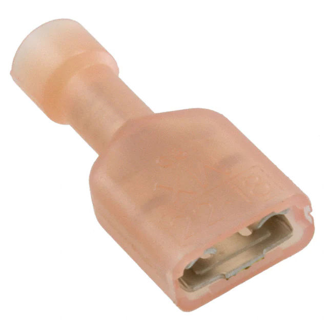

    MOLEX10(莫仕)
    胶壳端子 母头,完全绝缘红色,18-22AWG
0192760002 数据手册
F 10 LOOSE PIECE MATERIAL NUMBER 9 LOOSE PIECE ENGRNG NUMBER 192760002 192760005 192760008 AA-2201-LIF BB-2206-LIF C-2293-LIF 8 CONTINUOUS CONTINUOUS STRIP STRIP ENGRNG MATERIAL NUMBER NUMBER 192760001 192760004 192760007 AA-2201C-LIF BB-2206C-LIF C-2293C-LIF 7 MYLAR TAPE MATERIAL NUMBER 192760003 192760006 192760009 5 6 MYLAR TAPE ENGRNG NUMBER AA-2201T-LIF BB-2206T-LIF C-2293T-LIF 4 WIRE RANGE AWG FITS MALE TAB SIZE HOUSING COLOR 22-18 .250x.032 (6.35x0.81) .250x.032 (6.35x0.81) RED BLUE 16-14 12-10 .250x.032 (6.35x0.81) 3 "B" MIN. "A" MAX. STOCK THICK .016/0.41 2 "C" MAX. 1 "D" MWID "E" "H" MAX. NOMINAL F .86 /21.8 .058 /1.47 .38 /9.7 .135 /3.43 .18 /4.6 .56 /14.2 .86 /21.8 .083 /2.10 .38 /9.7 .160/4.06 .18 /4.6 .56 /14.2 1.03 /26.1 .117/2.97 .38 /9.7 .235 /5.97 .22 /5.6 .51 /12.9 .016/0.41 YELLOW .018/0.46 E E NEMA DETENT LOCATION PER UL 310 CONTINUOUS PLASTIC STRIP A1 "C" "H"±.03(0.8) D D "B" TERMINAL CUT-OFF A1 LOCATION, MAY PROTRUDE FROM HOUSING PARTS ON TAPE WIRE STOP C "E" "D" MWID C "A" B NOTES: 1. MATERIALS: TERMINAL: MATTE-TIN PLATED BRASS INSULATION: NYLON 6/6 94V-2, SEE CHART FOR COLORS 2. PRODUCT SPECIFICATION: PS-19902-012 3. MWID = MAXIMUM WIRE INSULATION DIAMETER 4. PARTS ARE RoHS COMPLIANT B SYMBOLS = 0 = 0 THIS DRAWING CONTAINS INFORMATION THAT IS PROPRIETARY TO MOLEX ELECTRONIC TECHNOLOGIES, LLC AND SHOULD NOT BE USED WITHOUT WRITTEN PERMISSION DIMENSION UNITS SCALE IN/MM NTS GENERAL TOLERANCES (UNLESS SPECIFIED) = 0 = 0 MM 4 PLACES ± A ± 0.005 2 PLACES ± 0.13 ± 0.01 ± 0.25 ± 0.02 = 0 1 PLACE = 0 0 PLACES ± ANGULAR TOL = 0 DOCUMENT STATUS FORMAT: Eng-lega-master-tb-prod-B REVISION: D DATE: 2018/01/18 P1 RELEASE DATE 9 2018/11/02 16:36:43 C 8 7 6 5 = 0 INCH ± 3 PLACES ± = 0 CURRENT REV DESC: ADD CUT-OFF NOTE ± ± 0.5 ° DRAFT WHERE APPLICABLE MUST REMAIN WITHIN DIMENSIONS 4 EC NO: 607062 QUIXON LOW INSERT FORCE DRWN: DMYRICK CHK'D: JMACNEIL APPR: JMACNEIL INITIAL REVISION: DRWN: ETHRODAHL APPR: JMACNEIL THIRD ANGLE PROJECTION 3 2018/11/01 FULLY INSUL QUICK DISCNT INSULKRIMP 22-10 AWG 2018/11/02 2018/11/02 PRODUCT CUSTOMER DRAWING DOC TYPE DOC PART REVISION DOCUMENT NUMBER 2010/03/18 2011/01/06 DRAWING SERIES B-SIZE 19276 SD-19276-001 MATERIAL NUMBER SEE CHART 2 PSD 001 CUSTOMER GENERAL MARKET A1 SHEET NUMBER 1 OF 1 1 A
