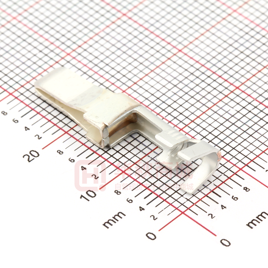

    MOLEX10(莫仕)
    胶壳端子 压接公端子,14-16AWG
0428171044 数据手册
12 11 10 9 8 7 4 3 2 1 NOTES: 1. MATERIAL: COPPER ALLOY 151, 0.50mm THICK. 2. PLATING: SELECT GOLD: 0.00076 MIN. SELECT. GOLD IN CONTACT AREA, 0.00254 MIN. SELECT *TIN IN CRIMP AREA,OVER 0.00127 NICKEL. SELECT SILVER: 0.00254 MIN. SELECT. SILVER IN CONTACT AREA, 0.00254 MIN. SELECT *TIN IN CRIMP AREA,OVER 0.00127 NICKEL. OVERALL TIN: 0.00254 MIN. BRIGHT *TIN OVER 0.00127 MIN. NICKEL 3. PRODUCT SPECIFICATION: PS-42815-001. 4. PACKAGING INFORMATION: PK-42815-001. 5. PART IS DESIGN IN METRIC. 6. TERMINALS FOR USE WITH STRANDED WIRE ONLY, STRANDED TINNED WIRE IS RECOMMENDED. 7 AFTER CRIMPING, THIS DIMENSION = 3.55mm MIN. 8 AFTER CRIMPING, THIS DIMENSION = 2.25mm MAX. 9. CRIMP SPECIFICATION: 638301000. WHEN USING TIN-PLATED TERMINALS FOR APPLICATIONS 10 INVOLVING VIBRATION AND/OR THERMAL CYCLING, MOLEX STRONGLY RECOMMENDS THE USE OF NYE LUBRICANT, NYOGEL 760G, ON THE MATING AREA OF THE TERMINAL. LUBRICANT SHOULD BE APPLIED AFTER THE TERMINALS ARE INSERTED INTO THE HOUSING. 11. PARTS CONFORM TO CLASS 'B' REQUIREMENT OF COSMETIC SPEC PS-45499-002 12. REFER AS-42815-001 FOR TIN PLATED TERMINALS RECOMMENDED LUBRICATION PROCEDURE. H 2.14 1.97 5 6 MATING AREA 3.05 G 2.00 ±0.10 8 0.50 MAX. CUT-OFF IN CRIMP TOOLING F A H G F 0.90 A E 3.80 ±0.15 7 B E 4.80 6.20 B A D D ISOMETRIC VIEW MATERIAL NO. CONFIGURATION DIM. "A" PLATING 428170041 STANDARD 27.60 TIN 10 428170141 MAKE-FIRST/BREAK-LAST 29.60 TIN 10 428170042 428170142 428171044 428171144 STANDARD MAKE-FIRST/BREAK-LAST STANDARD MAKE-FIRST/BREAK-LAST 27.60 29.60 27.60 29.60 C 5.94 B 3.80 5.69 STATUS C PLANNED FOR OBSOLESCENCE SELECT GOLD SELECT GOLD SELECT SILVER SELECT SILVER ACTIVE ACTIVE ACTIVE ACTIVE B 3.92 THIS DRAWING CONTAINS INFORMATION THAT IS PROPRIETARY TO MOLEX ELECTRONIC TECHNOLOGIES, LLC AND SHOULD NOT BE USED WITHOUT WRITTEN PERMISSION R 1.14 R 1.57 SECTION A-A SCALE MM 4:1 MM CONDUCTOR CRIMP A ± 3 PLACES ± ± 2 PLACES ± 0.25 ± ± 0.4 ± 0 PLACES ± ANGULAR TOL DOCUMENT STATUS 12 P1 RELEASE DATE 11 2018/05/04 10 INCH 4 PLACES ± 1 PLACE FORMAT: Eng-lega-master-tb-prod-C REVISION: D DATE: 2017/10/06 CURRENT REV DESC: MIGRATED TO ECTR GENERAL TOLERANCES (UNLESS SPECIFIED) SECTION B-B INSULATON CRIMP DIMENSION UNITS ± ± 0.5 ° DRAFT WHERE APPLICABLE MUST REMAIN WITHIN DIMENSIONS 12:38:13 9 8 7 6 5 EC NO: 171562 DRWN: RLALSANGI CHK'D: ISHWARG APPR: ISHWARG INITIAL REVISION: DRWN: MFIRLEJ APPR: JCOMERCI THIRD ANGLE PROJECTION 4 2017/07/19 2018/05/04 2018/05/04 MINI-FIT SR. MALE CRIMP TERMINAL, 14-16 AWG PRODUCT CUSTOMER DRAWING DOC TYPE DOC PART REVISION DOCUMENT NUMBER 2002/05/15 2002/05/15 DRAWING SERIES C-SIZE 42817 3 SD-42817-020 MATERIAL NUMBER PSD 001 CUSTOMER SEE CHART 2 C SHEET NUMBER GENERAL MARKET 1 OF 1 1 A
