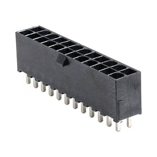

    MOLEX10(莫仕)
    CONN HEADER VERT 24POS 4.2MM
0462071124 数据手册
12 11 10 9 7 8 5 6 4 3 2 1 CKT 02 04 06 08 10 12 14 16 18 20 22 24 H 2 CKT SHOWN DIM A G .016±.010 0.40±0.25 0.21/5.4 0.38/9.6 0.54/13.8 0.71/18.0 0.87/22.2 1.04/26.4 1.21/30.6 1.37/34.8 1.54/39.0 1.70/43.2 1.87/47.4 2.03/51.6 NA H 0.165/4.20 0.331/8.40 0.496/12.60 0.661/16.80 0.827/21.00 0.992/25.20 1.160/29.40 1.323/33.60 1.488/37.80 G 1.654/42.00 1.819/46.20 DIM B .10 2.5 F DIM. B DIM. A SIZE .165 PITCH 4.20 (12 CKT - SHOWN) F .378±.010 9.60±0.25 .165 PITCH 4.20 ISOMETRIC VIEW .54 13.6 .016±.010 0.40±0.25 .43 REF 11.0 CKT 1 INDICATOR NOTES: .042SQUARE PIN TYP. 1.07 E E 1. MATERIALS: HOUSING - GLASS FILLED LCP UL94V-0, COLOR: SEE CHART TERMINAL - BRASS 2. TERMINAL PLATING: TIN= .000100/0.00254 MIN. MATTE TIN OVER .000050/0.00127 MIN. NICKEL GOLD=.000030/0.00076 MIN. SELECT GOLD OVER .000100/0.00254 MIN. SELECT MATTE TIN D D OVER .000050/0.00127 MIN. NICKEL OVERALL. DIM. C .012 0.30 3. PRODUCT SPECIFICATION: PS-5556-001 OR PS-45750-001 TYP. 4 PACKAGING SPECIFICATION:TRAY PACK PER: PK-46207-001 UNLESS NOTED. TAPE AND REEL PACK PER: PK-46207-002 DIM. B REF. (SEE CHART) 5. PART MATES WITH MINIFIT JR RECEPTACLE SERIES 5557 6. DISCOLORIZATION IN THE BANDOLIER CARRIER AREA OF THE PIN IS INHERENT TO THE PLATING PROCESS AND IS DUE TO THE MASKING EFFECT C C OF THE CARRIER. THIS DISCOLORIZTION IS A NON-FUNCTIONAL AREA OF THE PIN AND WILL NOT AFFECT THE PERFORMANCE OF THE HEADER ASSEMBLY. LAST CKT 7. CONNECTORS ARE NOT TO BE MATED OR UNMATED WHILE CIRCUITS ARE LIVE. CKT 2 ⌀.071±.002 1.80±0.05 TYP. 8. PARTS ARE NOT DESIGNED FOR CURRENT SHARING. .165±.004 TYP 4.20±0.10 9. THIS PART CONFORMS TO CLASS B REQUIREMENTS OF COSMETIC SPECIFICATION PS-45499-002. 10.TEXT ON PART IS FOR REFERENCE ONLY. TEXT AND TEXT LOCATION MAY VARY CKT 1 B B DEPENDING ON PART NUMBER AND/OR TOOL. LAYOUT FOR FORMAT: Eng-lega-master-tb-prod-C REVISION: C DATE: 2016/02/04 12 11 10 0 = 0 9 8 7 6 0 = 0 = 0 EC NO: DRWN: CHK'D: APPR: C MODEL: EM-46207-1012 RELEASE DATE = = RECOMMENDED PCB HOLE LAYOUT COMPONENT SIDE RELEASE STATUS 0 2 CIRCUIT 4-24 CIRCUITS A = = 0 C5 5 REV LAYOUT FOR 0 2017/09/22 2017/10/18 2017/10/23 CKT 2 = 122374 AZAHIROVIC JBELL FSMITH .165±.004 PITCH 4.20±0.10 NON-ACCUMULATIVE REL 8 & 10 CKT TAPE QUALITY THIS DRAWING CONTAINS INFORMATION THAT IS PROPRIETARY TO MOLEX ELECTRONIC TECHNOLOGIES, LLC AND SHOULD NOT BE USED WITHOUT WRITTEN PERMISSION DIMENSION UNITS SCALE SYMBOLS CKT 1 GENERAL TOLERANCES (UNLESS SPECIFIED) IN/MM INCH MM 4:1 DRWN BY DATE 4 PLACES ± ± LSCHMIDT 3 PLACES ± ± 0.005 CHK'D BY 2 PLACES ± 0.13 ± 0.01 JBELL 1 PLACES ± 0.25 ± APPR BY 0 PLACES ± ± DRAWING SIZE DRAFT WHERE APPLICABLE MUST REMAIN WITHIN DIMENSIONS 4 MINI-FIT RTC HI-TEMP VERTICAL HEADER IN LCP, W/O PCB PEGS DATE 2007/12/17 DATE FSMITHROEMER ANGULAR TOL ± 0.5 2007/12/14 PRODUCT CUSTOMER DRAWING 2007/12/18 THIRD ANGLE PROJECTION C MATERIAL NUMBER SERIES 46207 SEE CHART GENERAL MARKET DOC TYPE DOC PART SHEET NUMBER DOCUMENT NUMBER SD-46207-002 3 CUSTOMER 2 PSD 1 OF 3 000 1 A 12 11 GOLD PLATING CKT SIZE 02 04 06 08 10 12 14 16 18 20 22 24 D 462076002 462076004 462076006 462076008 462076010 462076012 462076014 462076016 462076018 462076020 462076022 462076024 TIN PLATING DIM. C * * * * * 0.144/3.66 0.144/3.66 0.144/3.66 0.144/3.66 0.144/3.66 0.144/3.66 0.144/3.66 0.144/3.66 0.144/3.66 0.144/3.66 0.144/3.66 0.144/3.66 PCB THK. 02 04 06 08 10 12 14 16 18 20 22 24 0.062 0.062 0.062 0.062 0.062 0.062 0.062 0.062 0.062 0.062 0.062 0.062 462074002 462074004 462074006 462074008 462074010 462074012 462074014 462074016 462074018 462074020 462074022 462074024 1 COLOR=BLACK TRAY PACK MATERIAL NUMBER TAPE & REEL MATERIAL NUMBER CKT SIZE 462071002 462071004 462071006 462071008 462071010 462071012 462071014 462071016 462071018 462071020 462071022 462071024 * * * * * * * * 462071102 462071104 462071106 462071108 462071110 462071112 462071114 462071116 462071118 462071120 462071122 462071124 02 04 06 08 10 12 14 16 18 20 22 24 02 04 06 08 10 12 14 16 18 20 22 24 462071202 462071204 462071206 462071208 462071210 462071212 462071214 462071216 462071218 462071220 462071222 462071224 462076602 462076604 462076606 462076608 462076610 462076612 462076614 462076616 462076618 462076620 462076622 462076624 * * * * * * * * * * * * .278/7.06 .278/7.06 .278/7.06 .278/7.06 .278/7.06 .278/7.06 .278/7.06 .278/7.06 .278/7.06 .278/7.06 .278/7.06 .278/7.06 0.250 0.250 0.250 0.250 0.250 0.250 0.250 0.250 0.250 0.250 0.250 0.250 * 11 = 0 = 0 = 0 = 0 C 22:37:30 10 9 8 7 6 0 = 0 = 0 EC NO: DRWN: CHK'D: APPR: 23.10.2017 0.176/4.46 0.176/4.46 0.176/4.46 0.176/4.46 0.176/4.46 0.176/4.46 0.176/4.46 0.176/4.46 0.176/4.46 0.176/4.46 0.176/4.46 0.176/4.46 0.093 0.093 0.093 0.093 0.093 0.093 0.093 0.093 0.093 0.093 0.093 0.093 0.207/5.26 0.207/5.26 0.207/5.26 0.207/5.26 0.207/5.26 0.207/5.26 0.207/5.26 0.207/5.26 0.207/5.26 0.207/5.26 0.207/5.26 0.207/5.26 0.125 E 0.125 0.125 0.125 0.125 0.125 0.125 0.125 0.125 D 0.125 0.125 0.125 * * * * * F DESIGNATES PART NOT RELEASED. C QUALITY THIS DRAWING CONTAINS INFORMATION THAT IS PROPRIETARY TO MOLEX ELECTRONIC TECHNOLOGIES, LLC AND SHOULD NOT BE USED WITHOUT WRITTEN PERMISSION DIMENSION UNITS SCALE SYMBOLS = RELEASE DATE 0.062 0.062 0.062 0.062 0.062 0.062 0.062 0.062 0.062 G 0.062 0.062 0.062 * * * * * * * * * * H 0.144/3.66 0.144/3.66 0.144/3.66 0.144/3.66 0.144/3.66 0.144/3.66 0.144/3.66 0.144/3.66 0.144/3.66 0.144/3.66 0.144/3.66 0.144/3.66 B A P1 DIM. C TRAY PACKAGED PER PK-5569-003 CONTACT FACTORY FOR AVAILABILITY. RELEASE STATUS PCB THK. CONTACT FACTORY FOR AVAILABILITY. 4 * DESIGNATES PART NOT RELEASED. 12 2 02 04 06 08 10 12 14 16 18 20 22 24 B FORMAT: Eng-lega-master-tb-prod-C REVISION: C DATE: 2016/02/04 3 02 04 06 08 10 12 14 16 18 20 22 24 02 04 06 08 10 12 14 16 18 20 22 24 C 4 = 0 C5 5 REV E * * * * * * * 5 6 2017/09/22 2017/10/18 2017/10/23 F * 7 122374 AZAHIROVIC JBELL FSMITH G 462078002 462078004 462078006 462078008 462078010 462078012 462078014 462078016 462078018 462078020 462078022 462078024 8 COLOR=BLACK TRAY PACK MATERIAL NUMBER TAPE & REEL MATERIAL NUMBER 9 REL 8 & 10 CKT TAPE H 10 GENERAL TOLERANCES (UNLESS SPECIFIED) IN/MM INCH MM 4:1 DRWN BY DATE 4 PLACES ± ± LSCHMIDT 3 PLACES ± ± 0.005 CHK'D BY 2 PLACES ± 0.13 ± 0.01 JBELL 1 PLACES ± 0.25 ± APPR BY 0 PLACES ± ± DRAWING SIZE DRAFT WHERE APPLICABLE MUST REMAIN WITHIN DIMENSIONS 4 MINI-FIT RTC HI-TEMP VERTICAL HEADER IN LCP, W/O PCB PEGS DATE 2007/12/17 DATE FSMITHROEMER ANGULAR TOL ± 0.5 2007/12/14 PRODUCT CUSTOMER DRAWING 2007/12/18 THIRD ANGLE PROJECTION C MATERIAL NUMBER SERIES 46207 SEE CHART GENERAL MARKET DOC TYPE DOC PART SHEET NUMBER DOCUMENT NUMBER SD-46207-002 3 CUSTOMER 2 PSD 2 OF 3 000 1 A 12 11 10 9 8 7 5 6 4 3 2 1 TIN PLATING COLOR=NATURAL TAPE & REEL TRAY PACK CKT MATERIAL MATERIAL SIZE NUMBER DIM. C NUMBER H G * * * * * * * * * * * * 02 04 06 08 10 12 14 16 18 20 22 24 * * * * * * * * * * * * * * * * * * * * * * * * * * * * * * * * * * * * * DESIGNATES PART NOT RELEASED. 02 04 06 08 10 12 14 16 18 20 22 24 462074302 462074304 462074306 462074308 462074310 462074312 462074314 462074316 462074318 462074320 462074322 462074324 462071302 462071304 462071306 462071308 462071310 462071312 462071314 462071316 462071318 462071320 462071322 462071324 02 04 06 08 10 12 14 16 18 20 22 24 F E D PCB THK. H 0.144/3.66 0.144/3.66 0.144/3.66 0.144/3.66 0.144/3.66 0.144/3.66 0.144/3.66 0.144/3.66 0.144/3.66 0.144/3.66 0.144/3.66 0.144/3.66 0.062 0.062 0.062 0.062 0.062 0.062 0.062 0.062 0.062 G 0.062 0.062 0.062 0.176/4.46 0.176/4.46 0.176/4.46 0.176/4.46 0.176/4.46 0.176/4.46 0.176/4.46 0.176/4.46 0.176/4.46 0.176/4.46 0.176/4.46 0.176/4.46 0.093 0.093 0.093 0.093 0.093 0.093 0.093 0.093 0.093 0.093 0.093 0.093 0.207/5.26 0.207/5.26 0.207/5.26 0.207/5.26 0.207/5.26 0.207/5.26 0.207/5.26 0.207/5.26 0.207/5.26 0.207/5.26 0.207/5.26 0.207/5.26 0.125 E 0.125 0.125 0.125 0.125 0.125 0.125 0.125 0.125 D 0.125 0.125 0.125 CONTACT FACTORY FOR AVAILABILITY. C F C B B = 0 = 0 = 0 FORMAT: Eng-lega-master-tb-prod-C REVISION: C DATE: 2016/02/04 12 P1 RELEASE DATE 11 23.10.2017 C 22:37:30 10 9 8 7 6 = 0 = 0 = 0 C5 5 REV RELEASE STATUS 0 EC NO: DRWN: CHK'D: APPR: = A 2017/09/22 2017/10/18 2017/10/23 0 122374 AZAHIROVIC JBELL FSMITH = REL 8 & 10 CKT TAPE QUALITY THIS DRAWING CONTAINS INFORMATION THAT IS PROPRIETARY TO MOLEX ELECTRONIC TECHNOLOGIES, LLC AND SHOULD NOT BE USED WITHOUT WRITTEN PERMISSION DIMENSION UNITS SCALE SYMBOLS GENERAL TOLERANCES (UNLESS SPECIFIED) IN/MM INCH MM 1:1 DRWN BY DATE 4 PLACES ± ± LSCHMIDT 3 PLACES ± ± 0.005 CHK'D BY 2 PLACES ± 0.13 ± 0.01 JBELL 1 PLACES ± 0.25 ± APPR BY 0 PLACES ± ± DRAWING SIZE DRAFT WHERE APPLICABLE MUST REMAIN WITHIN DIMENSIONS 4 MINI-FIT RTC HI-TEMP VERTICAL HEADER IN LCP, W/O PCB PEGS DATE 2007/12/17 DATE FSMITHROEMER ANGULAR TOL ± 0.5 2007/12/14 PRODUCT CUSTOMER DRAWING 2007/12/18 THIRD ANGLE PROJECTION C MATERIAL NUMBER SERIES 46207 SEE CHART GENERAL MARKET DOC TYPE DOC PART SHEET NUMBER DOCUMENT NUMBER SD-46207-002 3 CUSTOMER 2 PSD 3 OF 3 000 1 A
0462071124
物料型号:EM-46207-1012
器件简介:文档描述了一种Mini-Fit RTC Hi-Temp垂直头,使用在LCP材料中,没有PCB定位销。
引脚分配:文档提供了不同电路大小的引脚分配和尺寸,例如2电路、4电路到24电路的配置。
参数特性:包括材料规格(如玻璃填充LCP)、端子镀层(如锡、镍、金)、产品规格文档编号等。
功能详解:文档中没有提供详细的功能解释,但提到了连接器不应在电路活跃时进行插拔,且部件不设计用于电流共享。
应用信息:该部件与Minifit Jr插座系列5557兼容。
封装信息:提供了详细的封装尺寸和公差,以及PCB孔布局推荐。
