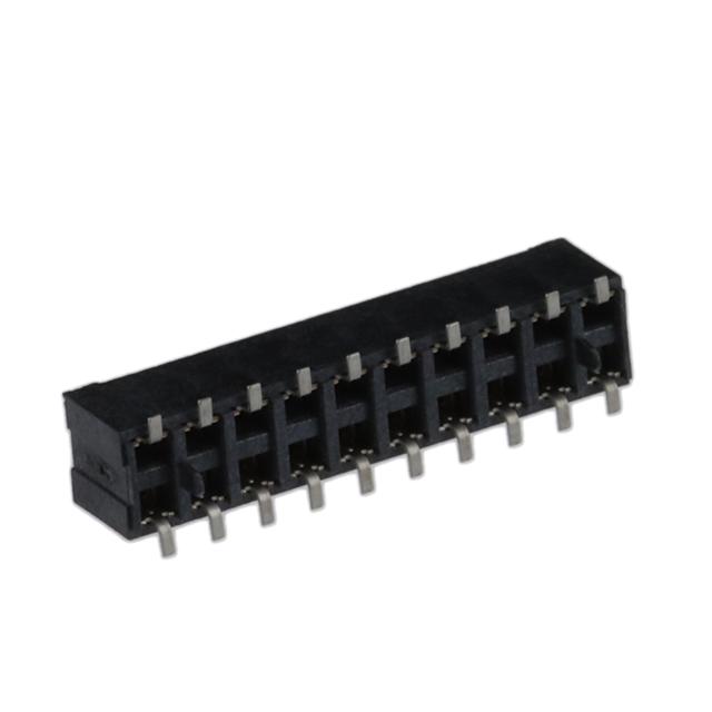

    MOLEX10(莫仕)
    SMD,P=2mm
    排母 间距:2mm 2x3P SMT
0791091002 数据手册
10 9 7 8 5 6 4 3 2 1 B A A F F ROW A CKT 1 1 2 . . . 4.19 NOTES: 25 1. HOUSING MATERIAL: LCP, GLASS FILLED, UL 94V-0 COLOUR BLACK. 2. TERMINAL MATERIAL: PHOSPHOR BRONZE 3. SEE APPROPRIATE SHEET FOR CIRCUIT SIZE, PART NUMBERS AND OVERALL DIMENSIONS. 4. FOR ILLUSTRATION, 6 CKT ASSY SHOWN. 5. REFER TO PRODUCT SPEC PS-79107. 6. TUBE PACKAGING PER PK-70873-0217 OR TAPE PACKAGING PER PK-70873-0259 7. SEE FROM SHT 4 FOR PEG OPTION ASSEMBLIES. 8. CKT LOCATIONS ARE NUMBERED FROM LEFT TO RIGHT WHEN VIEWING ASSY FROM TOP WITH THE GATE RECESS ON THE RIGHT AS SHOWN. 9. SEE SHT 3, 7 & 9 FOR VOIDED CIRCUIT PART NUMBERS. 10. MEASUREMENT IS TAKEN BETWEEN THE TANGENT OF THE TOE TO TIP OF THE TERMINAL. ROW A CKT 25 ROW A E 1.12 ±0.08 2.00 2.00 �2.82� 6.48 ±0.08 CAVITY ID (NON CIRCUIT ID) 2.00 CKT. LOCATION 8 1.83 ±0.08 ROW B ROW B CKT 25 ROW B CKT 1 1 RECOMMENDED PCB PAD LAYOUT 2 . . . . 25 1.50 CONTACT POINT D E D Z PLATING OPTION: (4). 30µin (0.75µm) MIN. GOLD PLATE IN SELECTED AREA AND 75µin (1.88µm) MIN. TIN IN SELECTED AREA OVER 50µin (1.25µm) MIN. NICKEL OVER-ALL. 4.44 D ± 0.25 (5). 15µin (0.38µm) MIN. GOLD PLATE IN SELECTED AREA AND 75µin (1.88µm) MIN. TIN IN SELECTED AREA OVER 50µin (1.25µm) MIN. NICKEL OVER-ALL. C 0.38 (6). 5µin (0.13µm) MIN. GOLD PLATE IN SELECTED AREA AND 75µin (1.88µm) MIN. TIN IN SELECTED AREA OVER 50µin (1.25µm) MIN. NICKEL OVER-ALL. ⌓ 0.15 Z 0.46 C 5.33 DETAIL A SECTION Z-Z B B 0 0.00 -0.05 10 THIS DRAWING CONTAINS INFORMATION THAT IS PROPRIETARY TO MOLEX ELECTRONIC TECHNOLOGIES, LLC AND SHOULD NOT BE USED WITHOUT WRITTEN PERMISSION DIMENSION UNITS SCALE mm NTS CURRENT REV DESC: CHAMFER REMOVED GENERAL TOLERANCES (UNLESS SPECIFIED) +0.075 0 0.000 10 A DETAIL A DOCUMENT STATUS FORMAT: master-tb-prod-A3 REVISION: J DATE: 2020/01/14 P1 RELEASE DATE 9 2021/03/16 BENDING ANGLE OF TAIL 7 6 ± 4 PLACES ± 3 PLACES ± 2 PLACES ± 1 PLACE ± 0 PLACES ± ° 0.25 0.38 DRAFT WHERE APPLICABLE MUST REMAIN WITHIN DIMENSIONS 11:11:17 8 ANGULAR TOL 5 4 EC NO: 658279 DRWN: ABABUPS CHK'D: MRAMAKRISHNA APPR: MRAMAKRISHNA INITIAL REVISION: DRWN: ATSEE APPR: LBLEE THIRD ANGLE PROJECTION 2MM DUAL ROW VERTICAL RECEPTACLE, SMT 2020/12/17 2021/03/16 2021/03/16 2014/07/24 2014/08/01 DRAWING SERIES A3-SIZE 79109 3 PRODUCT CUSTOMER DRAWING DOC TYPE DOC PART REVISION DOCUMENT NUMBER SDA-79109-XXXX MATERIAL NUMBER PSD 001 CUSTOMER GENERAL MARKET 2 N8 SHEET NUMBER 1 OF 10 1 A 10 9 7 8 5 6 4 3 2 1 WITHOUT PEG OPTION F PLATING OPTION 5 2.00 HOUSING RECESS 12.00 ⌀ 1.50 +0.10 TYP. 0.00 4.00 CKT. SIZE DIM. "A" DIM. "B" DIM. "D" (PILOT HOLE) 04 06 08 10 12 14 16 18 20 22 24 26 28 30 32 34 36 38 E PULL OUT DIRECTION D 40 42 44 46 48 50 REEL TAPE AND REEL ORIENTATION 2.00 4.00 6.00 8.00 10.00 12.00 14.00 16.00 18.00 20.00 22.00 24.00 26.00 28.00 30.00 32.00 34.00 36.00 38.00 40.00 42.00 44.00 46.00 48.00 4.19 6.19 8.19 10.19 12.19 14.19 16.19 18.19 20.19 22.19 24.19 26.19 28.19 30.19 32.19 34.19 36.19 38.19 40.19 42.19 44.19 46.19 48.19 50.19 4.65 4.65 4.65 4.65 4.65 4.65 4.65 4.65 4.65 4.65 4.65 4.65 4.65 4.65 4.65 4.65 4.65 4.65 4.65 4.65 4.65 4.65 4.65 4.65 PLATING OPTION 4 PLATING OPTION 6 F ITEM NO. ITEM NO. ITEM NO. ITEM NO. ITEM NO. ITEM NO. ITEM NO. TUBE PACKED (WITHOUT CAP) TAPE PACKED (WITH CAP) TUBE PACKED (WITHOUT CAP) TAPE PACKED (WITH CAP) TUBE PACKED (WITHOUT CAP) TAPE PACKED (WITH CAP) TAPE PACKED (WITHOUT CAP) 79109-1149 79109-2801 - - - - - - - - - - - - - - - - - - - - - - - - - - - - - - - - - - 79109-1001 79109-1002 79109-1003 79109-1004 79109-1005 79109-1006 79109-1007 79109-1008 79109-1009 79109-1010 79109-1011 79109-1012 79109-1013 79109-1014 79109-1015 79109-1016 79109-1017 79109-1018 79109-1019 79109-1020 79109-1021 79109-1022 79109-1023 79109-1024 79109-8401 79109-8402 79109-8403 79109-8404 79109-8405 79109-8406 79109-8407 79109-8408 79109-8409 79109-8410 79109-8411 79109-8412 79109-8413 79109-8414 79109-8415 79109-8416 79109-8417 79109-8418 79109-8419 79109-8420 79109-8421 79109-8422 79109-8423 79109-8424 79109-1051 79109-1052 79109-1053 79109-1054 79109-1055 79109-1056 79109-1057 79109-1058 79109-1059 79109-1060 79109-1061 79109-1062 79109-1063 79109-1064 79109-1065 79109-1066 79109-1067 79109-1068 79109-1069 79109-1070 79109-1071 79109-1072 79109-1073 79109-1074 79109-8451 79109-8452 79109-8453 79109-8454 79109-8455 79109-8456 79109-8457 79109-8458 79109-8459 79109-8460 79109-8461 79109-8462 79109-8463 79109-8464 79109-8465 79109-8466 79109-8467 79109-8468 79109-8469 79109-8470 79109-8471 79109-8472 79109-8473 79109-8474 79109-1101 79109-1102 79109-1103 79109-1104 79109-1105 79109-1106 79109-1107 79109-1108 79109-1109 79109-1110 79109-1111 79109-1112 79109-1113 79109-1114 79109-1115 79109-1116 79109-1117 79109-1118 79109-1119 79109-1120 79109-1121 79109-1122 79109-1123 79109-1124 - - - - - - - - - - - - N8 E D "X" INDICATES TOOLING NOT AVAILABLE. C NOTES: 1. LEADER AND TRAILER TAPE. SPECIAL PACKAGING (TAPE PACKED WITHOUT CAP) 160 MIN. TOP TAPE TRAILER 390 MIN. TOP TAPE CKT. SIZE 06 20 50 34 PULL OUT DIRECTION COMPONENT 160 MIN. TAIL PART (EMPTY) B DIM. "A" DIM. "B" DIM. "D" 230 MIN. LEADER PART (EMPTY) 4.00 18.00 48.00 32.00 6.19 20.19 50.19 34.19 4.65 4.65 4.65 4.65 ITEM NO. PLATING OPTION SEE SHEET 1 79109-9004 79109-9005 79109-9006 79109-9007 5 5 5 5 C B 2. PEELING OFF FORCE OF THE TOP TAPE: 20-80gf. (PEELING DIRECTION AS SHOWN IN FOLLOWING FIGURE) PEEL OFF DIRECTION 15° MAX. THIS DRAWING CONTAINS INFORMATION THAT IS PROPRIETARY TO MOLEX ELECTRONIC TECHNOLOGIES, LLC AND SHOULD NOT BE USED WITHOUT WRITTEN PERMISSION PULL OUT DIRECTION DIMENSION UNITS SCALE mm NTS CURRENT REV DESC: CHAMFER REMOVED GENERAL TOLERANCES (UNLESS SPECIFIED) 3. PACKAGING STANDARD IS AS PER EIA-481. 4. TAPE & REEL QUANTITY = 500 PCS/REEL A DOCUMENT STATUS FORMAT: master-tb-prod-A3 REVISION: J DATE: 2020/01/14 P1 RELEASE DATE 9 2021/03/16 ± 4 PLACES ± 3 PLACES ± 2 PLACES ± 1 PLACE ± 0 PLACES ± ° 0.25 0.38 DRAFT WHERE APPLICABLE MUST REMAIN WITHIN DIMENSIONS 11:11:17 8 ANGULAR TOL 7 6 5 4 EC NO: 658279 DRWN: ABABUPS CHK'D: MRAMAKRISHNA APPR: MRAMAKRISHNA INITIAL REVISION: DRWN: ATSEE APPR: LBLEE THIRD ANGLE PROJECTION 2MM DUAL ROW VERTICAL RECEPTACLE, SMT 2020/12/17 2021/03/16 2021/03/16 2014/07/24 2014/08/01 DRAWING SERIES A3-SIZE 79109 3 PRODUCT CUSTOMER DRAWING DOC TYPE DOC PART REVISION DOCUMENT NUMBER SDA-79109-XXXX MATERIAL NUMBER PSD 001 CUSTOMER GENERAL MARKET 2 N8 SHEET NUMBER 2 OF 10 1 A 10 9 7 8 5 6 4 3 2 1 ASSEMBLIES WITHOUT PEGS F F VOIDED CIRCUIT OPTION CKT. SIZE ASSEMBLY VOID LOCATION(S) �WITHOUT CAP IN TUBE� SEE SHEET 1 FOR CONVENTION PLATING OPTION DIM."A" DIM."B" DIM."D" PART NUMBER. ROW CKT. NO.(S) 22 79109-5011 A 2 4 20.00 22.19 4.65 6 79109-5012 A 2 5 4.00 6.19 4.65 E E CKT. SIZE D ASSEMBLY VOID LOCATION(S) (WITH CAP IN T&R) SEE SHEET 1 FOR CONVENTION PART NUMBER 50 79109-8924 ROW CKT. NO.(S) A 13, 23 B 23 PLATING OPTION DIM."A" DIM."B" DIM."D" D 5 48.00 50.19 4.65 C C NOTES: 1. TERMINALS WILL BE PRESENT IN VOIDED LOCATIONS. HOWEVER, PIN WINDOWS WILL BE CLOSED. 2. VOIDS CAN ONLY BE PRESENT IN ONE ROW OF A CONNECTOR. B B THIS DRAWING CONTAINS INFORMATION THAT IS PROPRIETARY TO MOLEX ELECTRONIC TECHNOLOGIES, LLC AND SHOULD NOT BE USED WITHOUT WRITTEN PERMISSION DIMENSION UNITS SCALE mm NTS CURRENT REV DESC: CHAMFER REMOVED GENERAL TOLERANCES (UNLESS SPECIFIED) A DOCUMENT STATUS FORMAT: master-tb-prod-A3 REVISION: J DATE: 2020/01/14 P1 RELEASE DATE 9 2021/03/16 ± 4 PLACES ± 3 PLACES ± 2 PLACES ± 1 PLACE ± 0 PLACES ± ° 0.25 0.38 DRAFT WHERE APPLICABLE MUST REMAIN WITHIN DIMENSIONS 11:11:17 8 ANGULAR TOL 7 6 5 4 EC NO: 658279 DRWN: ABABUPS CHK'D: MRAMAKRISHNA APPR: MRAMAKRISHNA INITIAL REVISION: DRWN: ATSEE APPR: LBLEE THIRD ANGLE PROJECTION 2MM DUAL ROW VERTICAL RECEPTACLE, SMT 2020/12/17 2021/03/16 2021/03/16 2014/07/24 2014/08/01 DRAWING SERIES A3-SIZE 79109 3 PRODUCT CUSTOMER DRAWING DOC TYPE DOC PART REVISION DOCUMENT NUMBER SDA-79109-XXXX MATERIAL NUMBER PSD 001 CUSTOMER GENERAL MARKET 2 N8 SHEET NUMBER 3 OF 10 1 A 10 9 7 8 5 6 4 3 (4). 30µin (0.75µm) MIN. GOLD PLATE IN SELECTED AREA AND 75µin (1.88µm) MIN. TIN IN SELECTED AREA OVER 50µin (1.25µm) MIN. NICKEL OVER-ALL. A F 2.00 �5.08� (6). 5µin (0.13µm) MIN. GOLD PLATE IN SELECTED AREA AND 75µin (1.88µm) MIN. TIN IN SELECTED AREA OVER 50µin (1.25µm) MIN. NICKEL OVER-ALL. �4.06� NOTES: CONNECTOR WITH CAP E CAP Y 1.50 CONTACT POINT 4.44 D 0.38 D ⌓ 0.15 1.45 0.46 TYP Y C 1. HOUSING MATERIAL: GLASS FILLED HIGH TEMP. THERMOPLASTIC. COLOR:BLACK. 2. TERMINAL MATERIAL: PHOSPHOR BRONZE. 3. SEE APPROPRIATE SHEET FOR CIRCUIT SIZE, PART NUMBERS AND OVER-ALL DIMENSIONS. 4. FOR ILLUSTRATION, 6 & 12 CIRCUIT ASSEMBLY SHOWN. 5. REFER TO PRODUCT SPECIFICATION PS-79107. 6. TUBE PACKAGING PER PK-70873-0217 OR TAPE PACKAGING PER 70873-0259. 7. SEE PSX-79107 FOR SUGGESTED BOTTOM ENTRY PIN LENGTHS. 8. 0.89±0.05 DIA FOR PRESS FIT ONLY. 0.99±0.05 FOR PICK AND PLACE WITH MOUNTING FORCE 1.20±0.076 FOR PICK AND PLACE WITH ZERO MOUNTING FORCE 9. MEASUREMENT IS TAKEN BETWEEN THE TANGENT OF THE TOE TO TIP OF THE TERMINAL. C SECTION Y-Y C ⌀ 1.12 ±0.05 1.00 ⌖ 0.13Ⓜ 0 ⌀ 0.89 ±0.05 8 0.00 -0.05 D 1.12 ±0.08 5.33 2.00 TYP E A DETAIL B 1.02 1.12 ±0.08 ⌖ 0.15Ⓛ Y F (5). 15µin (0.38µm) MIN. GOLD PLATE IN SELECTED AREA AND 75µin (1.88µm) MIN. TIN IN SELECTED AREA OVER 50µin (1.25µm) MIN. NICKEL OVER-ALL. CAVITY ID (NOT CKT ID) 4.19 2.00 1 PLATING OPTION: PEG OPTION B 2 C 3.24 ±0.08 NON-PLATED 9 2.00 SEE NOTE 8 2.54 X 5.08 DETAIL B 0 +0.075 9 0.000 2.00 RECOMMENDED PCB LAYOUT (BOTTOM ENTRY) BENDING ANGLE OF TAIL B 1.40 ±0.08 ⌖ 0.15Ⓛ X Y THIS DRAWING CONTAINS INFORMATION THAT IS PROPRIETARY TO MOLEX ELECTRONIC TECHNOLOGIES, LLC AND SHOULD NOT BE USED WITHOUT WRITTEN PERMISSION C RECOMMENDED PCB LAYOUT A DOCUMENT STATUS P1 RELEASE DATE 9 2021/03/16 DIMENSION UNITS SCALE mm NTS CURRENT REV DESC: CHAMFER REMOVED GENERAL TOLERANCES (UNLESS SPECIFIED) A FORMAT: master-tb-prod-A3 REVISION: J DATE: 2020/01/14 B ± 4 PLACES ± 3 PLACES ± 2 PLACES ± 1 PLACE ± 0 PLACES ± ° 0.25 0.38 DRAFT WHERE APPLICABLE MUST REMAIN WITHIN DIMENSIONS 11:11:17 8 ANGULAR TOL 7 6 5 4 EC NO: 658279 DRWN: ABABUPS CHK'D: MRAMAKRISHNA APPR: MRAMAKRISHNA INITIAL REVISION: DRWN: ATSEE APPR: LBLEE THIRD ANGLE PROJECTION 2MM DUAL ROW VERTICAL RECEPTACLE, SMT 2020/12/17 2021/03/16 2021/03/16 2014/07/24 2014/08/01 DRAWING SERIES A3-SIZE 79109 3 PRODUCT CUSTOMER DRAWING DOC TYPE DOC PART REVISION DOCUMENT NUMBER SDA-79109-XXXX MATERIAL NUMBER PSD 001 CUSTOMER GENERAL MARKET 2 N8 SHEET NUMBER 4 OF 10 1 A 10 9 7 8 5 6 4 3 2 1 PEG OPTION F F PLATING OPTION 4 PLATING OPTION 5 CKT. DIM. "A" DIM. "B" DIM. "C" DIM. "D" SIZE 04 06 08 10 E 12 14 16 18 20 22 24 26 28 30 32 34 36 38 D 40 42 44 46 48 50 2.00 4.00 6.00 8.00 10.00 12.00 14.00 16.00 18.00 20.00 22.00 24.00 26.00 28.00 30.00 32.00 34.00 36.00 38.00 40.00 42.00 44.00 46.00 48.00 4.19 6.19 8.19 10.19 12.19 14.19 16.19 18.19 20.19 22.19 24.19 26.19 28.19 30.19 32.19 34.19 36.19 38.19 40.19 42.19 44.19 46.19 48.19 50.19 2.00 4.00 6.00 8.00 10.00 12.00 14.00 16.00 18.00 20.00 22.00 24.00 26.00 28.00 30.00 32.00 34.00 36.00 38.00 40.00 42.00 44.00 46.00 4.65 4.65 4.65 4.65 4.65 4.65 4.65 4.65 4.65 4.65 4.65 4.65 4.65 4.65 4.65 4.65 4.65 4.65 4.65 4.65 4.65 4.65 4.65 4.65 PLATING OPTION 6 ITEM NO. ITEM NO. ITEM NO. ITEM NO. ITEM NO. ITEM NO. ITEM NO. TUBE PACKED (WITHOUT CAP) TAPE PACKED (WITH CAP) TUBE PACKED (WITH CAP) TUBE PACKED (WITHOUT CAP) TAPE PACKED (WITH CAP) TUBE PACKED (WITHOUT CAP) TAPE PACKED (WITH CAP) 79109-1201 79109-1202 79109-1203 79109-1204 79109-1205 79109-1206 79109-1207 79109-1208 79109-1209 79109-1210 79109-1211 79109-1212 79109-1213 79109-1214 79109-1215 79109-1216 79109-1217 79109-1218 79109-1219 79109-1220 79109-1221 79109-1222 79109-1223 79109-1224 79109-8601 79109-8602 79109-8603 79109-8604 79109-8605 79109-8606 79109-8607 79109-8608 79109-8609 79109-8610 79109-8611 79109-8612 79109-8613 79109-8614 79109-8615 79109-8616 79109-8617 79109-8618 79109-8619 79109-8620 79109-8621 79109-8622 79109-8623 79109-8624 79109-1225 79109-1226 79109-1227 79109-1228 79109-1229 79109-1230 79109-1231 79109-1232 79109-1233 79109-1234 79109-1235 79109-1236 79109-1237 79109-1238 79109-1239 79109-1240 79109-1241 79109-1242 79109-1243 79109-1244 79109-1245 79109-1246 79109-1247 79109-1248 79109-1251 79109-1252 79109-1253 79109-1254 79109-1255 79109-1256 79109-1257 79109-1258 79109-1259 79109-1260 79109-1261 79109-1262 79109-1263 79109-1264 79109-1265 79109-1266 79109-1267 79109-1268 79109-1269 79109-1270 79109-1271 79109-1272 79109-1273 79109-1274 79109-8651 79109-8652 79109-8653 79109-8654 79109-8655 79109-8656 79109-8657 79109-8658 79109-8659 79109-8660 79109-8661 79109-8662 79109-8663 79109-8664 79109-8665 79109-8666 79109-8667 79109-8668 79109-8669 79109-8670 79109-8671 79109-8672 79109-8673 79109-8674 79109-1301 79109-1302 79109-1303 79109-1304 79109-1305 79109-1306 79109-1307 79109-1308 79109-1309 79109-1310 79109-1311 79109-1312 79109-1313 79109-1314 79109-1315 79109-1316 79109-1317 79109-1318 79109-1319 79109-1320 79109-1321 79109-1322 79109-1323 79109-1324 - E D C C 'X' INDICATES TOOLING NOT AVAILABLE B B THIS DRAWING CONTAINS INFORMATION THAT IS PROPRIETARY TO MOLEX ELECTRONIC TECHNOLOGIES, LLC AND SHOULD NOT BE USED WITHOUT WRITTEN PERMISSION DIMENSION UNITS SCALE mm NTS CURRENT REV DESC: CHAMFER REMOVED GENERAL TOLERANCES (UNLESS SPECIFIED) A DOCUMENT STATUS FORMAT: master-tb-prod-A3 REVISION: J DATE: 2020/01/14 P1 RELEASE DATE 9 2021/03/16 ± 4 PLACES ± 3 PLACES ± 2 PLACES ± 1 PLACE ± 0 PLACES ± ° 0.25 0.38 DRAFT WHERE APPLICABLE MUST REMAIN WITHIN DIMENSIONS 11:11:17 8 ANGULAR TOL 7 6 5 4 EC NO: 658279 DRWN: ABABUPS CHK'D: MRAMAKRISHNA APPR: MRAMAKRISHNA INITIAL REVISION: DRWN: ATSEE APPR: LBLEE THIRD ANGLE PROJECTION 2MM DUAL ROW VERTICAL RECEPTACLE, SMT 2020/12/17 2021/03/16 2021/03/16 2014/07/24 2014/08/01 DRAWING SERIES A3-SIZE 79109 3 PRODUCT CUSTOMER DRAWING DOC TYPE DOC PART REVISION DOCUMENT NUMBER SDA-79109-XXXX MATERIAL NUMBER PSD 001 CUSTOMER GENERAL MARKET 2 N8 SHEET NUMBER 5 OF 10 1 A 10 9 7 8 5 6 4 3 2 1 F F E E PEG OPTION SPECIAL PACKAGING (TAPE PACKED WITHOUT CAP ) CKT. DIM. "A" DIM. "B" DIM. "C" DIM. "D" SIZE D 50 48.00 50.19 46.00 4.65 ITEM NO. PLATING OPTION SEE SHEET 1 79109-9103 D 5 C C B B THIS DRAWING CONTAINS INFORMATION THAT IS PROPRIETARY TO MOLEX ELECTRONIC TECHNOLOGIES, LLC AND SHOULD NOT BE USED WITHOUT WRITTEN PERMISSION DIMENSION UNITS SCALE mm NTS CURRENT REV DESC: CHAMFER REMOVED GENERAL TOLERANCES (UNLESS SPECIFIED) A DOCUMENT STATUS FORMAT: master-tb-prod-A3 REVISION: J DATE: 2020/01/14 P1 RELEASE DATE 9 2021/03/16 ± 4 PLACES ± 3 PLACES ± 2 PLACES ± 1 PLACE ± 0 PLACES ± ° 0.25 0.38 DRAFT WHERE APPLICABLE MUST REMAIN WITHIN DIMENSIONS 11:11:17 8 ANGULAR TOL 7 6 5 4 EC NO: 658279 DRWN: ABABUPS CHK'D: MRAMAKRISHNA APPR: MRAMAKRISHNA INITIAL REVISION: DRWN: ATSEE APPR: LBLEE THIRD ANGLE PROJECTION 2MM DUAL ROW VERTICAL RECEPTACLE, SMT 2020/12/17 2021/03/16 2021/03/16 2014/07/24 2014/08/01 DRAWING SERIES A3-SIZE 79109 3 PRODUCT CUSTOMER DRAWING DOC TYPE DOC PART REVISION DOCUMENT NUMBER SDA-79109-XXXX MATERIAL NUMBER PSD 001 CUSTOMER GENERAL MARKET 2 N8 SHEET NUMBER 6 OF 10 1 A 10 9 7 8 5 6 4 3 2 1 F F ASSEMBLIES WITH PEGS VOIDED CIRCUIT OPTION E ASSEMBLY CKT. �WITHOUT CAP IN TUBE� SIZE ITEM NO. E VOID LOCATION(S) SEE SHEET 1 FOR CONVENTION ROW CKT. NO.(S) PLATING OPTION DIM."A" DIM."B" DIM."C" DIM."D" 48 79109-6011 ROW A 1, 24 5 46.00 48.19 44.00 4.65 44 79109-6012 ROW B 10 5 42.00 44.19 42.00 4.65 D D NOTES: 1. TERMINALS WILL BE PRESENT IN VOIDED LOCATIONS. HOWEVER, PIN WINDOWS WILL BE CLOSED. 2. VOIDS CAN ONLY BE PRESENT IN ONE ROW OF A CONNECTOR. C C B B THIS DRAWING CONTAINS INFORMATION THAT IS PROPRIETARY TO MOLEX ELECTRONIC TECHNOLOGIES, LLC AND SHOULD NOT BE USED WITHOUT WRITTEN PERMISSION DIMENSION UNITS SCALE mm NTS CURRENT REV DESC: CHAMFER REMOVED GENERAL TOLERANCES (UNLESS SPECIFIED) A DOCUMENT STATUS FORMAT: master-tb-prod-A3 REVISION: J DATE: 2020/01/14 P1 RELEASE DATE 9 2021/03/16 ± 4 PLACES ± 3 PLACES ± 2 PLACES ± 1 PLACE ± 0 PLACES ± ° 0.25 0.38 DRAFT WHERE APPLICABLE MUST REMAIN WITHIN DIMENSIONS 11:11:17 8 ANGULAR TOL 7 6 5 4 EC NO: 658279 DRWN: ABABUPS CHK'D: MRAMAKRISHNA APPR: MRAMAKRISHNA INITIAL REVISION: DRWN: ATSEE APPR: LBLEE THIRD ANGLE PROJECTION 2MM DUAL ROW VERTICAL RECEPTACLE, SMT 2020/12/17 2021/03/16 2021/03/16 2014/07/24 2014/08/01 DRAWING SERIES A3-SIZE 79109 3 PRODUCT CUSTOMER DRAWING DOC TYPE DOC PART REVISION DOCUMENT NUMBER SDA-79109-XXXX MATERIAL NUMBER PSD 001 CUSTOMER GENERAL MARKET 2 N8 SHEET NUMBER 7 OF 10 1 A 10 9 7 8 5 6 4 3 2 1 SPECIAL - CUSTOM TERMINAL FEET F F PEG OPTION PLATING OPTION 5 CKT. SIZE DIM. "A" DIM. "B" DIM. "C" DIM. "D" 04 06 08 10 E 2.00 4.00 6.00 8.00 10.00 12.00 14.00 16.00 18.00 20.00 22.00 24.00 26.00 28.00 30.00 32.00 34.00 36.00 38.00 40.00 42.00 44.00 46.00 48.00 12 14 16 18 20 22 24 26 28 30 32 34 36 38 D 40 42 44 46 48 50 C 4.19 6.19 8.19 10.19 12.19 14.19 16.19 18.19 20.19 22.19 24.19 26.19 28.19 30.19 32.19 34.19 36.19 38.19 40.19 42.19 44.19 46.19 48.19 50.19 4.70 4.70 4.70 4.70 4.70 4.70 4.70 4.70 4.70 4.70 4.70 4.70 4.70 4.70 4.70 4.70 4.70 4.70 4.70 4.70 4.70 4.70 4.70 4.70 2.00 4.00 6.00 8.00 10.00 12.00 14.00 16.00 18.00 20.00 22.00 24.00 26.00 28.00 30.00 32.00 34.00 36.00 38.00 40.00 42.00 44.00 46.00 ITEM NO. ITEM NO. ITEM NO. TUBE PACKED (WITHOUT CAP) TAPE PACKED (WITH CAP) TUBE PACKED (WITH CAP) X X X X X X X X X X X X X X X X X X X X X X X X X X 79109-7010 X X X X X X 79109-7016 X X 79109-7015 X X X X X X X X X X 79109-8751 79109-8752 79109-8753 79109-8754 79109-8755 79109-8756 79109-8757 79109-8758 79109-8759 79109-8760 79109-8761 79109-8762 79109-8763 79109-8764 79109-8765 79109-8766 79109-8767 79109-8768 79109-8769 N.A. N.A. N.A. N.A. N.A. X X X X X X X X X X X X X X X X X X X X X X X X E D 79109-7065 C 'X' INDICATES TOOLING NOT AVAILABLE B B THIS DRAWING CONTAINS INFORMATION THAT IS PROPRIETARY TO MOLEX ELECTRONIC TECHNOLOGIES, LLC AND SHOULD NOT BE USED WITHOUT WRITTEN PERMISSION DIMENSION UNITS SCALE mm NTS CURRENT REV DESC: CHAMFER REMOVED GENERAL TOLERANCES (UNLESS SPECIFIED) A DOCUMENT STATUS FORMAT: master-tb-prod-A3 REVISION: J DATE: 2020/01/14 P1 RELEASE DATE 9 2021/03/16 ± 4 PLACES ± 3 PLACES ± 2 PLACES ± 1 PLACE ± 0 PLACES ± ° 0.25 0.38 DRAFT WHERE APPLICABLE MUST REMAIN WITHIN DIMENSIONS 11:11:17 8 ANGULAR TOL 7 6 5 4 EC NO: 658279 DRWN: ABABUPS CHK'D: MRAMAKRISHNA APPR: MRAMAKRISHNA INITIAL REVISION: DRWN: ATSEE APPR: LBLEE THIRD ANGLE PROJECTION 2MM DUAL ROW VERTICAL RECEPTACLE, SMT 2020/12/17 2021/03/16 2021/03/16 2014/07/24 2014/08/01 DRAWING SERIES A3-SIZE 79109 3 PRODUCT CUSTOMER DRAWING DOC TYPE DOC PART REVISION DOCUMENT NUMBER SDA-79109-XXXX MATERIAL NUMBER PSD 001 CUSTOMER GENERAL MARKET 2 N8 SHEET NUMBER 8 OF 10 1 A 10 9 7 8 5 6 4 3 2 1 F F SPECIAL - CUSTOM TERMINAL FEET VOIDED CURCUIT OPTION E E ASSEMBLY CKT. SIZE D ITEM NO. ITEM NO. TUBE PACKED TAPE PACKED (WITHOUT CAP) (WITH CAP) VOID LOCATION(S) SEE SHEET 1 FOR CONVENTION ROW CKT. NO.(S) PLATING OPTION DIM."A" DIM."B" DIM."C" DIM."D" PEG OPTION 48 79109-7011 X 79109-8385 ROW A 1, 24 5 46.00 48.19 44.00 4.70 YES 42 79109-7012 X 79109-8386 ROW A 1, 21 5 40.00 42.19 38.00 4.70 YES 20 79109-7013 X 79109-8387 ROW A 1, 10 5 18.00 20.19 16.00 4.70 YES 50 79109-7014 X 79109-8388 ROW B 13 5 48.00 50.19 46.00 4.70 YES 50 79109-7017 X 79109-8988 ROW B 13 5 48.00 50.19 46.00 4.70 NO D C C 'X' INDICATES TOOLING NOT AVAILABLE. NOTES: 1. TERMINALS WILL BE PRESENT IN VOIDED LOCATIONS. HOWEVER, PIN WINDOWS WILL BE CLOSED. 2. VOIDS CAN ONLY BE PRESENT IN ONE ROW OF A CONNECTOR. B B THIS DRAWING CONTAINS INFORMATION THAT IS PROPRIETARY TO MOLEX ELECTRONIC TECHNOLOGIES, LLC AND SHOULD NOT BE USED WITHOUT WRITTEN PERMISSION DIMENSION UNITS SCALE mm NTS CURRENT REV DESC: CHAMFER REMOVED GENERAL TOLERANCES (UNLESS SPECIFIED) A DOCUMENT STATUS FORMAT: master-tb-prod-A3 REVISION: J DATE: 2020/01/14 P1 RELEASE DATE 9 2021/03/16 ± 4 PLACES ± 3 PLACES ± 2 PLACES ± 1 PLACE ± 0 PLACES ± ° 0.25 0.38 DRAFT WHERE APPLICABLE MUST REMAIN WITHIN DIMENSIONS 11:11:17 8 ANGULAR TOL 7 6 5 4 EC NO: 658279 DRWN: ABABUPS CHK'D: MRAMAKRISHNA APPR: MRAMAKRISHNA INITIAL REVISION: DRWN: ATSEE APPR: LBLEE THIRD ANGLE PROJECTION 2MM DUAL ROW VERTICAL RECEPTACLE, SMT 2020/12/17 2021/03/16 2021/03/16 2014/07/24 2014/08/01 DRAWING SERIES A3-SIZE 79109 3 PRODUCT CUSTOMER DRAWING DOC TYPE DOC PART REVISION DOCUMENT NUMBER SDA-79109-XXXX MATERIAL NUMBER PSD 001 CUSTOMER GENERAL MARKET 2 N8 SHEET NUMBER 9 OF 10 1 A 10 9 7 8 5 6 4 3 2 1 BOARD TO BOARD (BTB) DISTANCE F RECEPTACLE F MATES WITH(HEADER) BTB DISTANCE 87831 7.15 PICTORIAL VIEW � 7.15 � E E � 8.35 � 87832 8.35 D D 79109 151117 � 7.15 � 7.15 C C 151118 � 8.35 � 8.35 B B THIS DRAWING CONTAINS INFORMATION THAT IS PROPRIETARY TO MOLEX ELECTRONIC TECHNOLOGIES, LLC AND SHOULD NOT BE USED WITHOUT WRITTEN PERMISSION DIMENSION UNITS SCALE mm NTS CURRENT REV DESC: CHAMFER REMOVED GENERAL TOLERANCES (UNLESS SPECIFIED) A DOCUMENT STATUS FORMAT: master-tb-prod-A3 REVISION: J DATE: 2020/01/14 P1 RELEASE DATE 9 2021/03/16 ± 4 PLACES ± 3 PLACES ± 2 PLACES ± 1 PLACE ± 0 PLACES ± ° 0.25 0.38 DRAFT WHERE APPLICABLE MUST REMAIN WITHIN DIMENSIONS 11:11:17 8 ANGULAR TOL 7 6 5 4 EC NO: 658279 DRWN: ABABUPS CHK'D: MRAMAKRISHNA APPR: MRAMAKRISHNA INITIAL REVISION: DRWN: ATSEE APPR: LBLEE THIRD ANGLE PROJECTION 2MM DUAL ROW VERTICAL RECEPTACLE, SMT 2020/12/17 2021/03/16 2021/03/16 2014/07/24 2014/08/01 DRAWING SERIES A3-SIZE 79109 3 PRODUCT CUSTOMER DRAWING DOC TYPE DOC PART REVISION DOCUMENT NUMBER SDA-79109-XXXX MATERIAL NUMBER PSD 001 CUSTOMER GENERAL MARKET 2 N8 SHEET NUMBER 10 OF 10 1 A
0791091002
1. 物料型号:文档中提到了多个型号,例如79109-1001、79109-8401等,这些型号可能对应不同的配置或规格。
2. 器件简介:文档中没有直接提供器件的简介,但从标题可以推断,这是一种2毫米双排垂直插座,SMT(表面贴装技术)产品。
3. 引脚分配:文档中提到了不同数量的电路(CKT)大小,从4到50不等,每个电路的大小对应不同的尺寸(DIM."A"、DIM."B"、DIM."D")。
4. 参数特性:文档中列出了一些关键参数,如housing material(housing material: LCP, glass filled)、terminal material(terminal material: phosphor bronze)、plating options(不同的镀金、镀锡和镀镍选项)。
5. 功能详解:文档中没有直接的功能详解,但提供了一些技术细节,如peeling off force of the top tape、packaging standard(EIA-481标准)、tape & reel quantity(每卷500件)。
6. 应用信息:文档中提到了不同的包装选项,如tube packed (without cap)、tape packed (with cap)等,以及一些特定的应用选项,如with pegs voided circuit option。
7. 封装信息:文档中提供了详细的封装尺寸和推荐PCB布局,以及一些特定的封装选项,如plating option。
