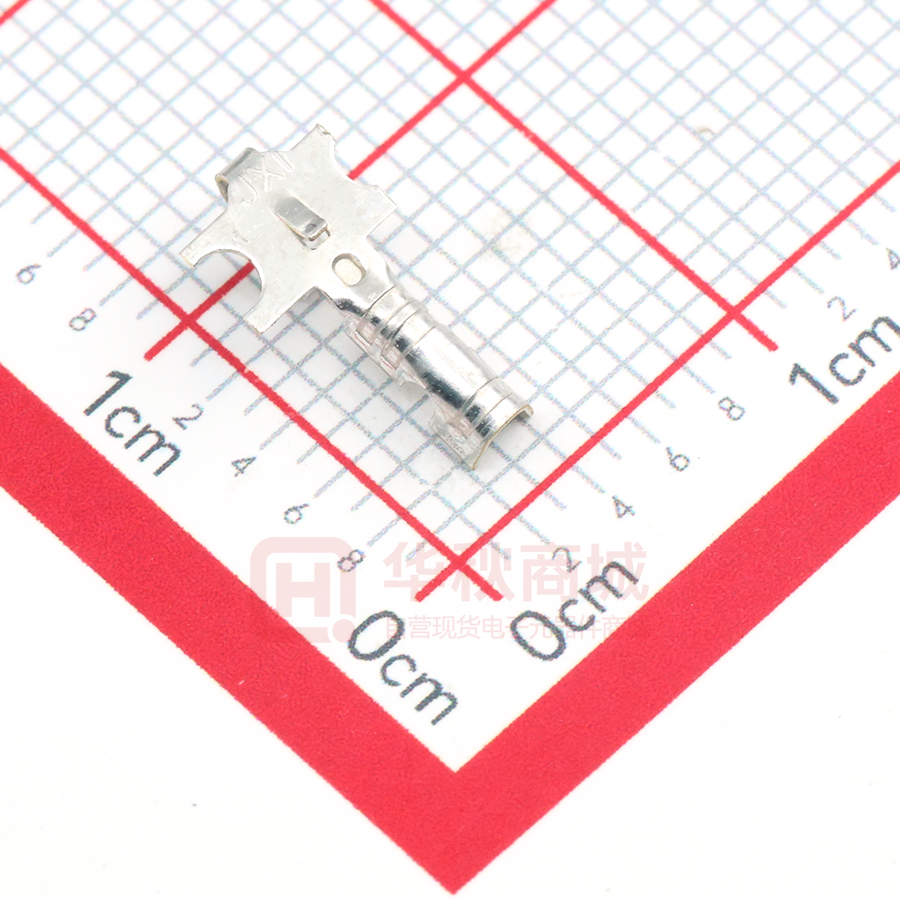

    MOLEX10(莫仕)
    KK254 压接母端子,30-22AWG, 镀锡
08-50-0113 数据手册
20 19 18 17 16 15 14 13 12 11 10 9 7 8 5 6 4 3 2 1 M M NOTES: 1. MATERIAL: (0.20)/.008 THICK BRASS 2. FINISH: 122 - OVERALL TIN: (0.00381)/.000150 MIN. TIN OVER (0.00076)/.000030 MIN NICKEL 154 - OVERALL TIN: (0.00254)/.000100 MIN. TIN OVER (0.00127)/.000050 MIN NICKEL P909 - OVERALL HOT TIN DIP: (0.00254)/.000100 MIN. 550 - SELECT GOLD: (0.00038)/.000015 MIN. OVERALL GOLD FLASH: (0.00005)/.000002 MIN. OVERALL NICKEL UNDERPLATE: (0.00076)/.000030 MIN. 555- SELECT GOLD (0.00038)/.000015 MIN. OVERALL NICKEL UNDERPLATE: (0.00076)/.000030 558 - SELECT GOLD: (0.00076)/.000030 MIN. OVERALL GOLD FLASH: (0.00005)/.000002 MIN. OVERALL NICKEL UNDERPLATE: (0.00127)/.000050 MIN. 3. PRODUCT SPEC: PS-10-07 4. PACKAGING SPECIFICATION: LOOSE TERMINALS: PER PK-2759-001 CHAIN FORM TERMINALS: PER PK-2759-002 5. CRIMP IS FOR 22-30 GA WIRE WITH (1.57)/.062 DIA INSULATION MAX. 6. INSERTION FORCE OF TERMINAL INTO (2.54)/.100 CENTERLINE CONNECTOR IS 2.5 LBS. MAX 7. TERMINAL RETENTION IN HOUSING IS 26.7N / 6LBS MIN. WHEN PULLED AT THE RATE OF (25.4MM) / 1 INCH PER MINUTE. 8. DIMENSIONS GIVEN ACROSS CENTERLINES ARE SYMMETRICAL ABOUT THOSE CENTERLINES WITHIN HALF THE TOTAL TOLERANCE. 9. THIS PART CONFORMS TO CLASS B REQUIREMENTS OF COSMETIC SPECIFICATION PS-45499-002. L K J L K J H H 1 G G 19 7 1.98 1.85 .078 .073 F F E E D D CHAIN, PER WINDING DETAIL "A" CHAIN, PER WINDING DETAIL "B" SEE NOTE 2 C THIS DRAWING CONTAINS INFORMATION THAT IS PROPRIETARY TO MOLEX ELECTRONIC TECHNOLOGIES, LLC AND SHOULD NOT BE USED WITHOUT WRITTEN PERMISSION C DIMENSION UNITS SCALE MM/IN 1:1 CURRENT REV DESC: OBSOLETED PART NUMBER AS PER PCN#509451 GENERAL TOLERANCES (UNLESS SPECIFIED) MM B 4 PLACES ± ± 3 PLACES ± ± 0.25 ± 0.014 ± 0.36 ± 0 PLACES ± ± ANGULAR TOL A DOCUMENT STATUS FORMAT: Eng-lega-master-tb-prod-D REVISION: E DATE: 2020/01/14 19 P1 RELEASE DATE 18 2022/02/28 17 ± 0.5 ° DRAFT WHERE APPLICABLE MUST REMAIN WITHIN DIMENSIONS 11:53:39 16 0.01 2 PLACES ± 1 PLACE 15 14 13 12 11 10 9 8 7 CRIMP TERMINAL 22-30 GA WIRE INCH EC NO: 686785 DRWN: SUGEEB CHK'D: GGA APPR: GGA INITIAL REVISION: DRWN: SAMIEC APPR: FSMITH THIRD ANGLE PROJECTION 6 2021/08/31 2022/02/28 2022/02/28 B PRODUCT CUSTOMER DRAWING DOC TYPE DOC PART REVISION DOCUMENT NUMBER 1987/07/28 2012/03/20 DRAWING SERIES D-SIZE 2759 5 SD-2759 MATERIAL NUMBER GENERAL MARKET 3 AW3 SHEET NUMBER CUSTOMER SEE TABLE 4 PSD 001 2 1 OF 2 1 A 20 19 18 17 16 15 14 13 12 11 10 9 7 8 6 5 4 3 2 1 M M L L K K J J H H G G F F E E D D C THIS DRAWING CONTAINS INFORMATION THAT IS PROPRIETARY TO MOLEX ELECTRONIC TECHNOLOGIES, LLC AND SHOULD NOT BE USED WITHOUT WRITTEN PERMISSION C DIMENSION UNITS SCALE MM/IN 1:1 CURRENT REV DESC: OBSOLETED PART NUMBER AS PER PCN#509451 GENERAL TOLERANCES (UNLESS SPECIFIED) MM B 4 PLACES ± ± 3 PLACES ± ± 0.25 ± 0.014 ± 0.36 ± 0 PLACES ± ± ANGULAR TOL A DOCUMENT STATUS FORMAT: Eng-lega-master-tb-prod-D REVISION: E DATE: 2020/01/14 19 P1 RELEASE DATE 18 2022/02/28 17 ± 0.5 ° DRAFT WHERE APPLICABLE MUST REMAIN WITHIN DIMENSIONS 11:53:39 16 0.01 2 PLACES ± 1 PLACE 15 14 13 12 11 10 9 8 7 CRIMP TERMINAL 22-30 GA WIRE INCH EC NO: 686785 DRWN: SUGEEB CHK'D: GGA APPR: GGA INITIAL REVISION: DRWN: SAMIEC APPR: FSMITH THIRD ANGLE PROJECTION 6 2021/08/31 2022/02/28 2022/02/28 B PRODUCT CUSTOMER DRAWING DOC TYPE DOC PART REVISION DOCUMENT NUMBER 1987/07/28 2012/03/20 DRAWING SERIES D-SIZE 2759 5 SD-2759 MATERIAL NUMBER GENERAL MARKET 3 AW3 SHEET NUMBER CUSTOMER SEE TABLE 4 PSD 001 2 2 OF 2 1 A
08-50-0113
1. 物料型号:文档列出了多个型号,例如08-55-0101、08-55-0102、08-55-0126等,它们都与2759系列有关。 2. 器件简介:文档提到了molex品牌的SELECT GOLD和SELECT NICKEL UNDERPLATE等产品规格。 3. 引脚分配:文档中提到了CRIMP TERMINAL,适用于22-30 GA WIRE,最大绝缘直径为(1.57)/.062。 4. 参数特性:包括插入力和保持力的参数,例如插入力最大为2.5磅,保持力最小为26.7N / 6LBS。 5. 功能详解:文档提供了详细的产品规格说明,如镀金和镀镍的最小厚度要求。 6. 应用信息:文档中提到了产品符合的规格和标准,例如CLASS B REQUIREMENTS OF COSMETIC SPECIFICATION。 7. 封装信息:提供了包装规格,如LOOSE TERMINALS和CHAIN FORM TERMINALS的包装方式。
