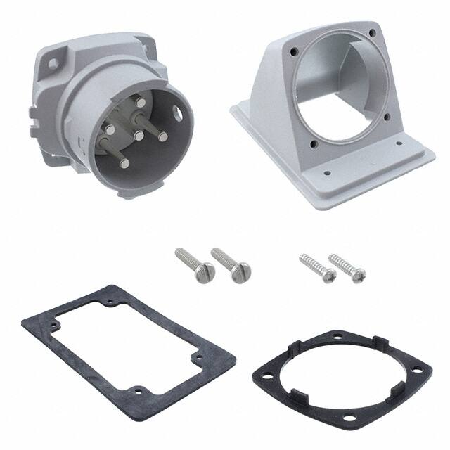

Woodhead ArcArrest 30A Switch-Rated Connector System Incorporating many options and components into a smooth, contoured design, the Woodhead ArcArrest 30A Switch-Rated Connector System delivers the simplest and fastest way to de-energize industrial machines and equipment and perform Lockout/Tagout operations Features and Advantages Inclusion of options such as MAX-LOC cord-grip technology, finger drawplates, lock-out holes and plug caps in a smooth, contoured design Reduces user costs and simplifies ordering. Enhances cleanability in food-processing and other harsh environments. Delivers enhanced durability for use in the toughest industrial applications All critical components are heavily glass-reinforced with 100% Valox materials Delivers unmatched strength and complete UL material compliance. Eliminates nylon components, commonly used by competitors, which are prone to moisture absorption and dimensional instability Laser labelling Provides a clean and permanent record of certifications and specifications. Greatly reduces the harboring of bacteria and dirt in the label NEMA 4X and IP69k rated Eliminates ingress of dust and water in a variety of harsh industrial environments. Sealing is automatic when connected. Achieves sealing while disengaged with closed receptacle lid and plug Furnace-brazed contact tips Produces tips with superior flatness and positioning accuracy compared to the flame brazing process used by competitors Applications Food Processing Conveyors Process Equipment Pumps Packaging Machines General Industrial Conveyors Process Equipment Welding Receptacles Power Distribution Construction Sites Shipyards Server Rack Power Supply Lockout Tagout Apparatus Conveyor Belts Food Processing Plant Woodhead ArcArrest 30A Switch-Rated Connector System Specifications ELECTRICAL – UL 2682 SWITCH RATINGS Voltage (max.): 600V AC Current (max.): 30A Temperature Rise:

物料型号:Molex品牌,型号为987651-4741。
器件简介:该连接器系统设计用于快速、简单地切断工业机器和设备的电源,并执行锁定/标记操作。所有关键组件均采用100% Valox材料,提供无与伦比的强度和完全符合UL材料标准。
引脚分配:提供多种引脚组合,包括1P+N+G、2P+G、2P+N+G、3P+G、3P+N+G。
参数特性:UL 2682开关额定,最大电压600V AC,最大电流30A,温升小于30°C,最小介电电压耐受2200V AC。机械耐久性至少10000次循环。
功能详解:包括MAX-LOC线缆固定技术、手指拉板、锁定孔和插头帽等选项,增强了清洁性、耐用性,并消除了尼龙组件,这些组件容易吸湿和尺寸不稳定。
应用信息:适用于食品加工、输送带、过程设备、泵、包装机、一般工业、焊接插座、电源分配、建筑工地、码头、服务器机架电源供应等。
封装信息:NEMA 4X和IP69k等级,自动密封,防止灰尘和水的侵入。
