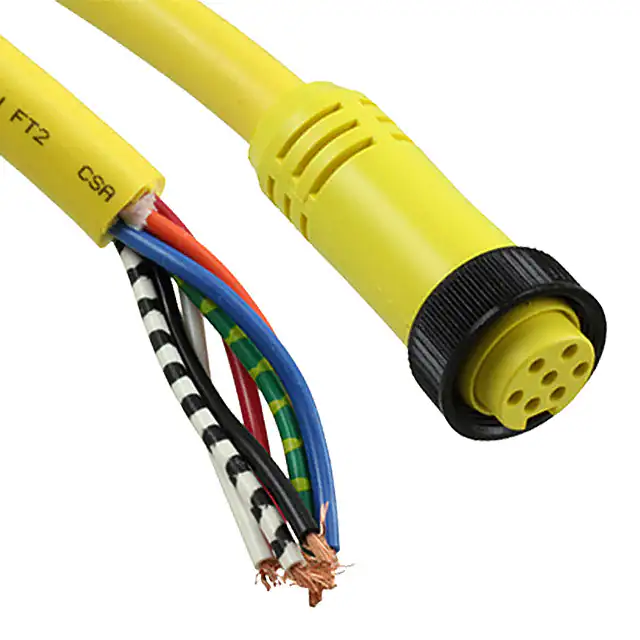

This document was generated on 04/02/2019 PLEASE CHECK WWW.MOLEX.COM FOR LATEST PART INFORMATION Part Number: Status: Overview: Description: 1300070076 Active Brad Mini-Change Connectors Mini-Change B-Size Single-Ended Cordset, 7 Poles, Female (Straight) to Pigtail, 16/7 AWG, PVC Cable, 3.66m (12.0') Length Documents: Drawing (PDF) Agency Certification CSA UL RoHS Certificate of Compliance (PDF) LR6837 E152210 General Product Family Series Connector End A Connector End B IP Rating Material - Contact Overview Product Name Protocol Region Type UPC Industrial Cordsets 130007 Mini-Change Pigtail IP67 Brass Brad Mini-Change Connectors Mini-Change DeviceNet America Single Ended 78678834262 Physical Cable Diameter Cable Length Color - Cable Jacket Coupling Style Gender Keyway LED Indicator Material - Cable Jacket Material - Connector Body Material - Coupling Nut Material - Plating Mating Orientation Poles Temperature Range - Operating Wire Size AWG Wire/Cable Type 13.72mm (.540") 3.66m (12.0') Yellow Threaded Female-Pigtail Single No PVC PVC Black Epoxy Coated Zinc Gold Straight to Pigtail 7 -20°C to +105°C 16 STOOW Electrical Current - Maximum per Contact Voltage - Maximum 8.0A 600V Material Info Engineering Number 207000A01F120 Reference - Drawing Numbers Sales Drawing SD-130007-005 This document was generated on 04/02/2019 Series image - Reference only EU ELV Not Relevant EU RoHS China RoHS Not Reviewed REACH SVHC Not Reviewed Halogen-Free Status Not Reviewed For more information, please visit Contact US China ROHS ELV RoHS Phthalates Not Reviewed Not Relevant Not Reviewed Search Parts in this Series 130007 Series PLEASE CHECK WWW.MOLEX.COM FOR LATEST PART INFORMATION
