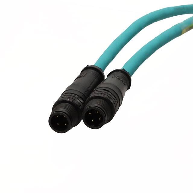

9 CABLE SPECIFICATION E 7 8 5 6 4 3 2 1 REVISION A REVISION A1 REVISION A2 TABLE OF LENGTH TOLERANCES CONDUCTOR: MATERIAL: TINED COPPER SECTION: 24AWG INSULATION: COMPOUND: PE DIAMETER: 0.99mm PAIRS: COLOR CODED SINGLES TWISTED INTO PAIRS. JACKET: COMPOUND: TPE COLOR: TEAL DIAMETER: 5.58mm TEMPERATURE RATING: -50°C TO +75°C VOLTAGE RATING MAX: 300V OVER UP TO AND INCLUDING 0 305 305 915 915 1830 1830 3660 3660 7320 7320 14640 14640 30500 30500 > TOLERANCE (+) +19 +45 +56 +89 +165 +317 +610 +2% OF LENGTH TRANSFERRED TO ECTR NEW PN ADDED ADDED NEW PN WIRING UPDATED E L + TOL. = SEE TABLE 1 100±25 D D 4 WHITE/ORANGE - 1 WHITE/ORANGE - 1 4 WHITE/GREEN - 2 5 5 WHITE/GREEN - 2 ORANGE - 3 9 P1 RELEASE DATE MOLEX PN 1300480108 1300480109 1300480110 1300480111 1300480112 1300480251 1300480252 1300480253 1300480315 1300480316 1300480317 1300480318 1300480319 ENGINEERING No E11A06004M180 E11A06004M200 E11A06004M240 E11A06004M300 E11A06004M500 E11A06004M003 E11A06004M006 E11A06004M250 E11A06004M380 E11A06004M230 E11A06004M270 E11A06004M340 E11A06004M420 24.10.2016 06:30:03 8 L [mm] 18000 20000 24000 30000 50000 300 600 25000 38000 23000 27000 34000 42000 3 7 4 - GREEN VIEW FROM THE FRONT SIDE C VINYL COPPER ALLOY ELASTOLLAN BRASS TPE TPE MATERIAL GOLD OVER NICKEL TEFLON OVER NICKEL BLACK TEAL B FINISH THIS DRAWING CONTAINS INFORMATION THAT IS PROPRIETARY TO MOLEX ELECTRONIC TECHNOLOGIES, LLC AND SHOULD NOT BE USED WITHOUT WRITTEN PERMISSION 2016/09/14 L [mm] 1000 2000 3000 4000 5000 6000 7000 8000 9000 10000 12000 14000 15000 GENERAL TOLERANCES (UNLESS SPECIFIED) ANGULAR TOL ± MOLEX PN 1300480322 1300480323 1300480324 1300480325 1300480326 ENGINEERING No E11A06004M570 E11A06004M650 E11A06004M760 E11A06004M800 E11A06004M850 6 EC NO: 109023 DRWN: DSTACHOWIAK CHK'D: APPR: MIWASIECZKO ENGINEERING No E11A06004M010 E11A06004M020 E11A06004M030 E11A06004M040 E11A06004M050 E11A06004M060 E11A06004M070 E11A06004M080 E11A06004M090 E11A06004M100 E11A06004M120 E11A06004M140 E11A06004M150 RELEASE STATUS FORMAT: tb-prod-A3 REVISION: G DATE: 2015/12/14 2 ITEM QTY. DESCRIPTION TABLE 1 A BRAD LOGO BILL OF MATERIALS LABEL 6 1 5 8 CONTACT MALE 4 2 INSERT D-CODE 4 POLE 3 2 COUPLING NUT M12 2 OVERMOULD MATERIAL 1 ETHERNET CABLE CAT5E NOTES: 1. BRAD LOGO - ONLY IN ONE SIDE ON THE OVERMOULD. MOLEX PN 1300480095 1300480096 1300480097 1300480098 1300480099 1300480100 1300480101 1300480102 1300480103 1300480104 1300480105 1300480106 1300480107 ORANGE - 3 2016/10/24 B VIEW FROM THE FRONT SIDE BRAD LOGO 2 3 1 L [mm] 57000 65000 76000 80000 85000 A2 5 REV C 6 4 - GREEN 4 PLACES ± 3 PLACES ± 2 PLACES ± 1 PLACE ± 0 PLACES ± ° DRAFT WHERE APPLICABLE MUST REMAIN WITHIN DIMENSIONS 4 DIMENSION UNITS SCALE MM 2:1 DRWN BY DATE MMATLA 2016/06/27 CHK'D BY DATE APPR BY DATE MIWASIECZKO DRAWING SIZE MIC 4P M/MP ST/ST D-CODED XM A 2016/07/13 THIRD ANGLE PROJECTION A3 PRODUCT CUSTOMER DRAWING SERIES MATERIAL NUMBER 130048 SEE TABLE 1 DOCUMENT NUMBER GENERAL MARKET DOC TYPE DOC PART SHEET NUMBER 1300480095 3 CUSTOMER 2 PSD 1 OF 1 00P 1 5 6 D PART NO ENGINEERING NO. 4 FINISHED LENGTH 3 2 1 PART NO. MATRIX B E11A06004M003 1300480251 E11A06004M003 0.3M [12 IN] 1300480319 E11A06004M420 42M [137FT 10IN] 1300480326 E11A06004M850 85M [278FT 10IN] FINISHED LENGTH M005 = 0.5 METER M010 = 1 METER M100 = 10 METER D LENGTH (SEE CHART) 4.00 [101.6] 6 1.97 [50.0] 4 Ø.24 B [6.1] 1 4 D-CODE P1 C B 2 P2 3 C Ø.57 TYP. NOTES: [14.5] 1) MATERIAL: SEE TABLE 2) FINISHES: SEE TABLE 3) MATES WITH: MICRO CHANGE, 4 POLE RECEPTACLE 4) ELECTRICAL DATA: ACCORDING TO CAT5e ETHERNET STANDARD INLINE CORDSET MALE D-CODING TO MALE D-CODING 24AWG POLES: 4 MAX. VOLTAGE: 250V MAX. CURRENT 1.5A B CONTACT RESISTANCE: 100M Ohm B TEMPERATURE RANGE: -20 C TO +75 C PROTECTION: IP67 (WHEN MATED) UL E200650 5) ASSEMBLY IS RoHS COMPLIANT. 6) ALL DIMENSIONS ARE FOR REFERENCE UNLESS TOLERANCED OR NOTED OTHERWISE. 2 3 P1 FLEX LIFE: TORSIONAL FLEX: A FUNCTIONAL SYMBOLS INSERTS TPU BLACK 5 1 LABEL PLASTIC FILM BLACK/YELLOW 4 8 MALE TERMINAL COPPER ALLOY GOLD PLATED 3 2 COUPLING NUT BRASS NICKEL PLATED 2 2 OVERMOLD TPC BLACK 1 ITEM 1 QTY. ETHERNET CABLE-CAT5e TPE JACKET TEAL DESCRIPTION MATERIAL FINISH DOCUMENT STATUS FORMAT: IN-ACAD-tb-prod-A REVISION: B DATE: 2020/01/14 6 P1 RELEASE DATE 2020/10/23 5 4 WIRING DIAGRAM (1 LB LOAD, 360º, 71 CYCLES/MIN @ 20º C) 3 MILLION CYCLE TEST 2 3 GN 4 6 2 OG 3 =0 =0 =0 INCH/MM SCALE NTS GENERAL TOLERANCES (UNLESS SPECIFIED) mm INCH 4 PLACES ± ---- ± ---- 3 PLACES ± ---- ± ---- 1 PLACE ± ---- ± ---- ± ---- 0 PLACES ± ---- ± ---- ANGULAR TOL ± ---- ° DRAFT WHERE APPLICABLE MUST REMAIN WITHIN DIMENSIONS 13:29:09 4 B THIS DRAWING CONTAINS INFORMATION THAT IS PROPRIETARY TO MOLEX ELECTRONIC TECHNOLOGIES, LLC AND SHOULD NOT BE USED WITHOUT WRITTEN PERMISSION DIMENSION UNITS DIVISIONAL SYMBOLS 2 PLACES ± ---- B M12 X 1 CABLE LENGTH TOLERANCES
