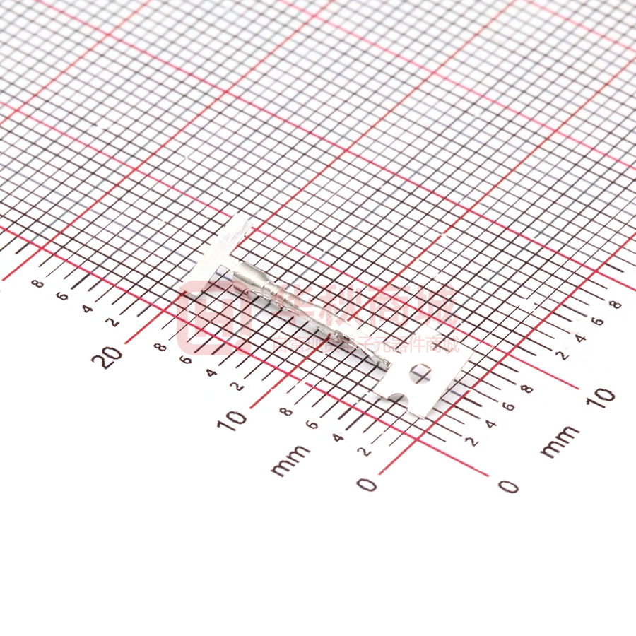

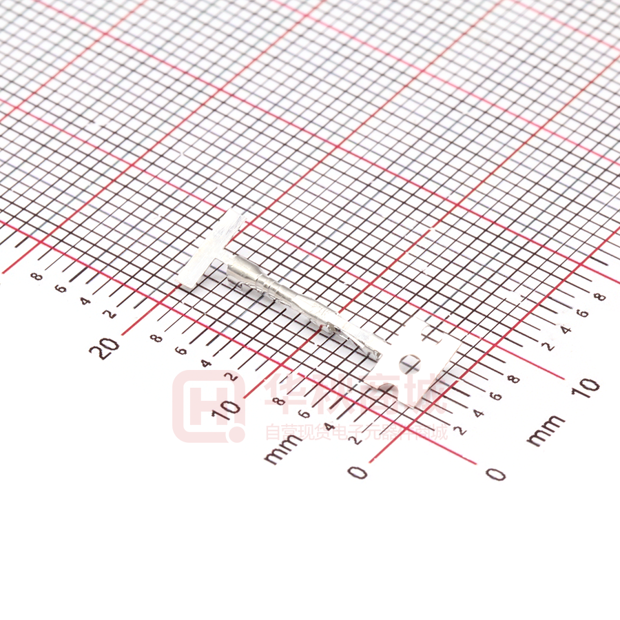

    MOLEX10(莫仕)
    胶壳端子 SL压接端子,母头,22-24AWG
16020086 数据手册
10 9 8 7 6 5 3 2 1 NOTES: 1. MATERIAL: PHOSPHOR BRONZE 2. PLATING: 124 = SELECT BRIGHT TIN: 3.75 MICROMETERS MIN OVER NICKEL 207 = SELECT HARD GOLD: 0.38 MICROMETERS MIN. SELECT TIN: 2.0 MICROMETERS MIN BOTH OVER NICKEL 206 = SELECT HARD GOLD: 0.75 MICROMETERS MIN. SELECT TIN: 2.0 MICROMETERS MIN BOTH OVER NICKEL 216 = SELECT HARD GOLD: 1.27 MICROMETERS MIN. SELECT TIN: 2.54 MICROMETERS MIN BOTH OVER NICKEL P124 = PREPLATED OVERALL BRIGHT TIN: 3.75 MICROMETERS MIN OVER NICKEL (MAY HAVE UNPLATED EDGES) 3. PRODUCT SPECIFICATION: TERMINALS CONFORM TO PS-70058 AND PS-70400 WHEN CRIMPED WITH MOLEX CRIMP TOOLS. 4. COSMETIC SPECIFICATION: PS-45499-002 CLASS B 5. TERMINAL FOR USE WITH HOUSING SERIES 70066 AND 70450 6. WIRE SPECIFICATION: TERMINALS STAMPED WITH THE LETTER: A = ACCEPTS 24-30 AWG STRANDED WIRE WITH A 1.52 MAX INSULATION DIA B = ACCEPTS 32-36 AWG STRANDED WIRE WITH A 0.64 MAX INSULATION DIA. C = ACCEPTS 22-24 AWG STRANDED WIRE WITH A 1.63 MAX INSULATION DIA F 12.88 1.32 E 1.52 4 2.18 ±0.10 0.08 MAX CARRIER CUTOFF F E D D TERMINALS STAMPED WITH THE LETTER "A" ACCEPT 24-30 AWG WIRE WITH A 1.52 MAX INSULATION DIA. CURRENT REPLACEMENT PACKAGING PART NUMBER PART NUMBER C B 16-02-0069 70058-1069 REEL 16-02-0096 70058-1096 LOOSE 70058-4069 70058-0069 REEL 70058-4096 70058-0096 LOOSE 16-02-0082 70058-0082 REEL 16-02-0097 70058-0097 LOOSE 16-02-0083 70058-0083 REEL 16-02-0098 70058-0098 LOOSE 16-02-0139 70058-0139 REEL 16-02-0140 70058-0140 LOOSE SYMBOLS A = 0 = 0 SCALE mm 8:1 DOCUMENT STATUS FORMAT: master-tb-prod-B REVISION: H DATE: 2018/01/18 10 P1 RELEASE DATE 9 2018/06/11 20:29:50 C 8 7 6 5 ANGULAR TOL ± ° 4 PLACES ± = 0 3 PLACES ± = 0 2 PLACES ± 0.25 1 PLACE ± 0.15 0 PLACES ± 0.0 = 0 = 0 124 SELECT TIN C P124 OVERALL TIN 207 0.38 GOLD 24-30 AWG 1.52 DIA MAX 206 0.75 GOLD 216 1.27 GOLD B CURRENT REV DESC: ADD +/-.10 TO 2.18 GENERAL TOLERANCES (UNLESS SPECIFIED) = 0 = 0 MAX INSULATION DIA THIS DRAWING CONTAINS INFORMATION THAT IS PROPRIETARY TO MOLEX ELECTRONIC TECHNOLOGIES, LLC AND SHOULD NOT BE USED WITHOUT WRITTEN PERMISSION DIMENSION UNITS = 0 TERMINALS ON THIS SHEET ARE FOR USE WITH 24-30 AWG WIRE. SEE SHEETS 2 AND 3 FOR OTHER WIRE SIZES WIRE SIZE PLATING SEE NOTE 2 DRAFT WHERE APPLICABLE MUST REMAIN WITHIN DIMENSIONS 4 EC NO: 600382 DRWN: KSAMIEC CHK'D: MKIPPER APPR: FSMITH INITIAL REVISION: DRWN: KSAMIEC APPR: FSMITH THIRD ANGLE PROJECTION 3 2018/04/10 2018/06/08 2018/06/11 SL CRIMP TERMINAL (24-30 AWG WIRE) PRODUCT CUSTOMER DRAWING DOC TYPE DOC PART REVISION DOCUMENT NUMBER 2017/05/03 2017/06/16 DRAWING SERIES B-SIZE 70058 700580000-SD MATERIAL NUMBER SEE CHART 2 PSD 000 CUSTOMER GENERAL MARKET A3 SHEET NUMBER 1 OF 4 1 A 10 9 8 7 6 5 12.88 1.32 E 2.18 ±0.10 0.08 MAX CARRIER CUTOFF D 3 2 1 NOTES: 1. MATERIAL: PHOSPHOR BRONZE 2. PLATING: 124 = SELECT BRIGHT TIN: 3.75 MICROMETERS MIN OVER NICKEL 207 = SELECT HARD GOLD: 0.38 MICROMETERS MIN. SELECT TIN: 2.0 MICROMETERS MIN BOTH OVER NICKEL 206 = SELECT HARD GOLD: 0.75 MICROMETERS MIN. SELECT TIN: 2.0 MICROMETERS MIN BOTH OVER NICKEL 216 = SELECT HARD GOLD: 1.27 MICROMETERS MIN. SELECT TIN: 2.54 MICROMETERS MIN BOTH OVER NICKEL P124 = PREPLATED OVERALL BRIGHT TIN: 3.75 MICROMETERS MIN OVER NICKEL (MAY HAVE UNPLATED EDGES) 3. PRODUCT SPECIFICATION: TERMINALS CONFORM TO PS-70058 AND PS-70400 WHEN CRIMPED WITH MOLEX CRIMP TOOLS. 4. COSMETIC SPECIFICATION: PS-45499-002 CLASS B 5. TERMINAL FOR USE WITH HOUSING SERIES 70066 AND 70450 6. WIRE SPECIFICATION: TERMINALS STAMPED WITH THE LETTER: A = ACCEPTS 24-30 AWG STRANDED WIRE WITH A 1.52 MAX INSULATION DIA B = ACCEPTS 32-36 AWG STRANDED WIRE WITH A 0.64 MAX INSULATION DIA. C = ACCEPTS 22-24 AWG STRANDED WIRE WITH A 1.63 MAX INSULATION DIA F 1.52 4 F E D B CURRENT REPLACEMENT PACKAGING PART NUMBER PART NUMBER TERMINALS STAMPED WITH THE LETTER "B" ACCEPT 32-36 AWG WIRE WITH A 0.64 MAX INSULATION DIA C B 16-02-0084 70058-1084 REEL 16-02-0099 70058-1099 LOOSE 70058-4084 70058-0084 REEL 70058-4099 70058-0099 LOOSE 16-02-0074 70058-0074 REEL 16-02-0100 70058-0100 LOOSE 16-02-0085 70058-0085 REEL 16-02-0101 70058-0101 LOOSE 16-02-0143 70058-0143 REEL 16-02-0144 70058-0144 LOOSE SYMBOLS A = 0 = 0 SCALE mm 8:1 DOCUMENT STATUS FORMAT: master-tb-prod-B REVISION: H DATE: 2018/01/18 10 P1 RELEASE DATE 9 2018/06/11 20:29:50 C 8 7 6 5 ANGULAR TOL ± ° 4 PLACES ± = 0 3 PLACES ± = 0 2 PLACES ± 0.25 1 PLACE ± 0.15 0 PLACES ± 0.0 = 0 = 0 124 SELECT TIN C P124 OVERALL TIN 207 0.38 GOLD 32 - 36 AWG 0.64 DIA MAX 206 0.75 GOLD 216 1.27 GOLD B CURRENT REV DESC: ADD +/-.10 TO 2.18 GENERAL TOLERANCES (UNLESS SPECIFIED) = 0 = 0 MAX INSULATION DIA THIS DRAWING CONTAINS INFORMATION THAT IS PROPRIETARY TO MOLEX ELECTRONIC TECHNOLOGIES, LLC AND SHOULD NOT BE USED WITHOUT WRITTEN PERMISSION DIMENSION UNITS = 0 TERMINALS ON THIS SHEET ARE FOR USE WITH 32-36 AWG WIRE. SEE SHEETS 1 AND 3 FOR OTHER WIRE SIZES WIRE SIZE PLATING SEE NOTE 2 DRAFT WHERE APPLICABLE MUST REMAIN WITHIN DIMENSIONS 4 EC NO: 600382 DRWN: KSAMIEC CHK'D: MKIPPER APPR: FSMITH INITIAL REVISION: DRWN: KSAMIEC APPR: FSMITH THIRD ANGLE PROJECTION 3 2018/04/10 2018/06/08 2018/06/11 SL CRIMP TERMINAL (32-36 AWG WIRE) PRODUCT CUSTOMER DRAWING DOC TYPE DOC PART REVISION DOCUMENT NUMBER 2017/05/03 2017/06/16 DRAWING SERIES B-SIZE 70058 700580000-SD MATERIAL NUMBER SEE CHART 2 PSD 000 CUSTOMER GENERAL MARKET A3 SHEET NUMBER 2 OF 4 1 A 10 9 8 F 7 6 5 1.32 E 2.18 ±0.10 0.08 MAX CARRIER CUTOFF 2 1 F E D C D 3 NOTES: 1. MATERIAL: PHOSPHOR BRONZE 2. PLATING: 124 = SELECT BRIGHT TIN: 3.75 MICROMETERS MIN OVER NICKEL 207 = SELECT HARD GOLD: 0.38 MICROMETERS MIN. SELECT TIN: 2.0 MICROMETERS MIN BOTH OVER NICKEL 206 = SELECT HARD GOLD: 0.75 MICROMETERS MIN. SELECT TIN: 2.0 MICROMETERS MIN BOTH OVER NICKEL 216 = SELECT HARD GOLD: 1.27 MICROMETERS MIN. SELECT TIN: 2.54 MICROMETERS MIN BOTH OVER NICKEL P124 = PREPLATED OVERALL BRIGHT TIN: 3.75 MICROMETERS MIN OVER NICKEL (MAY HAVE UNPLATED EDGES) 3. PRODUCT SPECIFICATION: TERMINALS CONFORM TO PS-70058 AND PS-70400 WHEN CRIMPED WITH MOLEX CRIMP TOOLS. 4. COSMETIC SPECIFICATION: PS-45499-002 CLASS B 5. TERMINAL FOR USE WITH HOUSING SERIES 70066 AND 70450 6. WIRE SPECIFICATION: TERMINALS STAMPED WITH THE LETTER: A = ACCEPTS 24-30 AWG STRANDED WIRE WITH A 1.52 MAX INSULATION DIA B = ACCEPTS 32-36 AWG STRANDED WIRE WITH A 0.64 MAX INSULATION DIA. C = ACCEPTS 22-24 AWG STRANDED WIRE WITH A 1.63 MAX INSULATION DIA 12.88 1.52 4 TERMINALS STAMPED WITH THE LETTER "C" ACCEPT 22-24 AWG WIRE WITH A 1.63 MAX INSULATION DIA CURRENT PART NUMBER C B 16-02-0086 70058-1086 REEL 16-02-0102 70058-1102 LOOSE 70058-4086 70058-0086 REEL 70058-4102 70058-0102 LOOSE 16-02-0087 70058-0087 REEL 16-02-0103 70058-0103 LOOSE 16-02-0088 70058-0088 REEL 16-02-0104 70058-0104 LOOSE 16-02-0131 70058-0131 REEL 16-02-0147 70058-0147 LOOSE SYMBOLS = 0 A = 0 SCALE mm 8:1 DOCUMENT STATUS FORMAT: master-tb-prod-B REVISION: H DATE: 2018/01/18 10 P1 RELEASE DATE 9 2018/06/11 20:29:50 C 8 7 6 5 ANGULAR TOL ± 4 PLACES ± = 0 3 PLACES ± = 0 2 PLACES ± = 0 = 0 MAX INSULATION DIA 124 SELECT TIN C P124 OVERALL TIN 207 0.38 GOLD 22-24 AWG 1.63 DIA MAX 206 0.75 GOLD 216 1.27 GOLD B CURRENT REV DESC: ADD +/-.10 TO 2.18 GENERAL TOLERANCES (UNLESS SPECIFIED) = 0 = 0 WIRE SIZE THIS DRAWING CONTAINS INFORMATION THAT IS PROPRIETARY TO MOLEX ELECTRONIC TECHNOLOGIES, LLC AND SHOULD NOT BE USED WITHOUT WRITTEN PERMISSION DIMENSION UNITS = 0 TERMINALS ON THIS SHEET ARE FOR USE WITH 22-24 AWG WIRE. SEE SHEETS 1 AND 2 FOR OTHER WIRE SIZES REPLACEMENT PLATING PACKAGING PART NUMBER SEE NOTE 2 ° 0.25 1 PLACE ± 0.15 0 PLACES ± 0.0 DRAFT WHERE APPLICABLE MUST REMAIN WITHIN DIMENSIONS 4 EC NO: 600382 DRWN: KSAMIEC CHK'D: MKIPPER APPR: FSMITH INITIAL REVISION: DRWN: KSAMIEC APPR: FSMITH THIRD ANGLE PROJECTION 3 2018/04/10 2018/06/08 2018/06/11 SL CRIMP TERMINAL (22-24 AWG WIRE) PRODUCT CUSTOMER DRAWING DOC TYPE DOC PART REVISION DOCUMENT NUMBER 2017/05/03 2017/06/16 DRAWING SERIES B-SIZE 70058 700580000-SD MATERIAL NUMBER SEE CHART 2 PSD 000 CUSTOMER GENERAL MARKET A3 SHEET NUMBER 3 OF 4 1 A 10 9 8 7 6 5 4 3 LOOSE PACKED F 2 1 REEL PACKED WHEN TERMINALS ARE FULLY INSERTED INTO THE HOUSINGS. F PARTS PER BAG: 10,000 BAGS PER BOX: 2 PARTS PER BOX: 20,000 THE TERMINAL'S LOCKING TANG SHOULD BE VISABLE IN THE HOUSING'S WINDOWS A UNWINDING DIRECT TO CRIMP MACHINE E E PARTS PER REEL: 20,000 REELS PER BOX: 3 PARTS PER BOX: 60,000 D D A HOUSING WINDOWS C C TERMINAL LOCKING TANGS B B SECTION A-A SYMBOLS THIS DRAWING CONTAINS INFORMATION THAT IS PROPRIETARY TO MOLEX ELECTRONIC TECHNOLOGIES, LLC AND SHOULD NOT BE USED WITHOUT WRITTEN PERMISSION DIMENSION UNITS SCALE mm 1:15 = 0 = 0 CRIMPED TERMINALS SHOULD BE INSERTED INTO THE HOUSING IN THIS DIRECTION WITH THE LOCKING TANGS FACING UP TOWARD THE HOUSING WINDOWS = 0 A FORMAT: master-tb-prod-B REVISION: H DATE: 2018/01/18 10 P1 RELEASE DATE 9 2018/06/11 20:29:50 C 8 7 6 5 ANGULAR TOL ± 4 PLACES ± = 0 3 PLACES ± = 0 2 PLACES ± = 0 DOCUMENT STATUS GENERAL TOLERANCES (UNLESS SPECIFIED) = 0 = 0 = 0 CURRENT REV DESC: ADD +/-.10 TO 2.18 ° 0.25 1 PLACE ± 0.15 0 PLACES ± 0.0 DRAFT WHERE APPLICABLE MUST REMAIN WITHIN DIMENSIONS 4 EC NO: 600382 DRWN: KSAMIEC CHK'D: MKIPPER APPR: FSMITH INITIAL REVISION: DRWN: KSAMIEC APPR: FSMITH THIRD ANGLE PROJECTION 3 2018/04/10 2018/06/08 2018/06/11 SL CRIMP TERMINAL PRODUCT CUSTOMER DRAWING DOC TYPE DOC PART REVISION DOCUMENT NUMBER 2017/05/03 2017/06/16 DRAWING SERIES B-SIZE 70058 700580000-SD MATERIAL NUMBER SEE CHART 2 PSD 000 CUSTOMER GENERAL MARKET A3 SHEET NUMBER 4 OF 4 1 A
