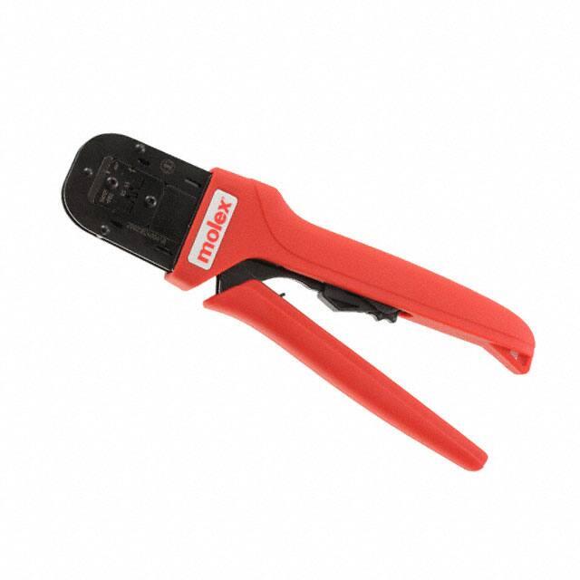

Hand Crimp Tool for CTX-J 50 Receptacle Terminal Sealed Crimp Terminal HAND CRIMP TOOL Application Tooling Specification Sheet TYPE 4D Order No. 200218-2400 FEATURES      A full cycle ratcheting hand tool ensures complete crimps Ergonomic soft grip handles for comfortable crimping A precision user-friendly terminal locator wire stop holds terminals in the proper crimping position Right- and left-handed applications Dies and Locator from this tool can be used in the Battery Powered Tool Order No. 63816-0200 (110 V) or 63816-0250 (220 V) with the use of the 63816-0800 Crimp Head  Many different tool kits can be used with a single Battery Powered Crimp Tool  This tool is IPC/WHMA A-620 Class 2 compliant  This tool is RoHS compliant; however, RoHS compliance is not required SCOPE Products: CTX-J 50 Receptacle Terminal Sealed, 0.30mm2 and 0.50mm2 wires. Wire Size Insulation Diameter (2) Wire Type mm² mm AVSS 0.30 1.40-1.50 560121 560121-0102 AVSSH 0.50 1.60-1.70 AESSX (1) Customer to cut off terminal from reel: 0.15mm (.006”) maximum Cut-Off Tab. (2) Insulation crimp to meet IPC/WHMA-A-620 Class 2 compliance. Terminal Order No. Reel (1) Terminal Series No. DEFINITION OF TERMS Strip Length mm 4.0-4.4 WIRE STRIP LENGTH CONDUCTOR BRUSH SEAM BELL MOUTH CONDUCTOR CRIMP HEIGHT CUT-OFF TAB INSULATION CRIMP BEND UP TWISTING ROLLING Doc No: ATS-2002182400 Revision: A Release Date: 03-28-17 Revision Date: 03-28-17 BEND DOWN UNCONTROLLED COPY Page 1 of 8 Hand Crimp Tool for CTX-J 50 Receptacle Terminal Sealed Crimp Terminal CRIMP SPECIFICATION: After crimping, the conductor profiles should measure the following: Terminal Series No. 560121 Bell Mouth mm 0.30-0.70 Conductor Brush mm 0.10-0.60 Conductor Crimp Terminal Wire Size Width Height Series (Ref.) mm2 mm mm 0.30 0.62-0.67 1.5 560121 0.50 0.72-0.78 1.5 Bend Up Bend Down Degree 1 1 Insulation Crimp Height Width (Ref.) (Ref.) mm mm 1.75 1.65 1.85 1.65 Twist Roll Degree 4 6 Pull Force Minimum N 50.0 90.0 Profile mm2 0.3 X 0.5 X Bell Mouth Bell Mouth (Rear) Front Rear Side N/A 0.3-0.7mm (Ref.) No Bulge No Bulge on Side No Bulge on Side Conductor Brush Height OK Shorter Than Crimp Height Doc No: ATS-2002182400 Revision: A Release Date: 03-28-17 Revision Date: 03-28-17 NG Higher Than Crimp Height UNCONTROLLED COPY Page 2 of 8 Hand Crimp Tool for CTX-J 50 Receptacle Terminal Sealed Crimp Terminal Bulge After Crimping No Bulge on Wire Grip Front Wire Insulation Tool Qualification Notes: 1. Pull force should be measured with no influence from the insulation crimp. 2. The above specifications are guidelines to an optimum crimp. Note: A crimp height chart is provided with this document as reference only. Due to the wide range of wires, strands, insulation diameters and durometers available, actual crimp height measurements may very slightly. An occasional destructive pull force test should be performed to check hand tool crimp. Pull force value must exceed the minimum pull force specifications listed. HANDLE WILL SPRING OPEN OPERATION CAUTION: Crimp only the Molex terminals listed in the scope for this tool. Do not crimp hardened objects as damage can occur to the tool frame and/or crimp dies. Open the tool by squeezing the handles together. At the end of the closing stroke, the ratchet mechanism will release the handles, and the hand tool will spring open. See Figure 1. Figure 1 SQUEEZE HANDLES TOGETHER Doc No: ATS-2002182400 Revision: A Release Date: 03-28-17 Revision Date: 03-28-17 UNCONTROLLED COPY Page 3 of 8 Hand Crimp Tool for CTX-J 50 Receptacle Terminal Sealed Crimp Terminal LOCATOR IN DOWN POSTION Crimping Terminals 1. Select the desired terminal listed from the preceding charts. 2. Make sure the center of the locator is in the down position. With the locator attached, push the locator button on the back of the hand tool to bring the locator forward through the tooling. See Figure 2. 3. While holding in the locator button, load the terminal into the proper nest opening in the locator based on the wire gauge or terminal type markings on the hand tooling. See Figure 3. RELEASE LOCATOR BUTTON TERMINAL LOCATOR PUSHED THRU TOOLING LOCATOR BUTTON PUSHED IN PUSH ON THE LOCATOR BUTTON Figure 2 TOOLING PARTIALLY CLOSED PARTIALLY CLOSE HANDLE Figure 3 TERMINAL 4. Release the locator button, allowing the locator to return to the crimping position. 5. Close the tool handle until the first ratchet position engages. See Figure 4. 6. Insert the properly stripped wire through the terminal and against the wire stop. See Figure 5. 7. Crimp the terminal by squeezing the tool handles until the ratchet mechanism cycle has been completed. Release the handles to open the jaws. OPEN POSITION FIRST RATCHET POSITION Figure 4 Note: The tamper-proof ratchet action will not release the tool until it has been fully closed. WIRE AGAINST THE WIRE STOP TERMINAL WIRE STOP IS PART OF THE LOCATOR WIRE PRE-STRIPPED WIRE Figure 5 TERMINAL Doc No: ATS-2002182400 Revision: A Release Date: 03-28-17 Revision Date: 03-28-17 UNCONTROLLED COPY Page 4 of 8 Hand Crimp Tool for CTX-J 50 Receptacle Terminal Sealed Crimp Terminal WIRE 8. Remove the crimped terminal from the terminal locator by pulling on the wire. 9. Visually inspect the crimped terminal for proper crimp location. 10. On some large O.D. wires, it may not be possible to insert the wire with the tool partially closed. Those wires should be inserted with the hand tool in the open position. Insert the wire above the terminal in the punch and against the wire stop, and then close the tool. See Figure 6. WIRE STOP TERMINAL Locator Installation Figure 6 See the parts list on the last page of this document for the proper locator order number. Follow the steps below to replace the locator. 1. Open the crimp hand tool. 2. Squeeze gently on the lower area shown in Figure 7A with your thumb and index finger. The lower tabs of the locator should disengage from the hand tool. LOCATOR SQUEEZE HERE SQUEEZE HERE MAKE SURE CENTER OF LOCATOR IS IN THE DOWN POSITION TOP SLOTS OF HANDTOOL JAWS OPEN TOOLING PULL OPEN TOOLING M3 BHCS TOP HOOKS Figure 8 Figure 7B PUSH ON HANDLE Figure 7A LOWER TABS 3. Lift and pull away from the hand tool. The top locator hooks should slip out of the top slots easily. See Figure 7A. 4. To reinstall the new locator, make sure the hand tool is in the open position. 5. Press the red insert down as far as it will go, as shown in Figure 7B. 6. Holding onto the lower part of the locator with your thumb and index finger, insert the locator top hooks (2) into the hand tool top slots. 7. Rotate the locator down and press the lower tabs into the two bottom slots of the hand tool. To secure the locator into place, the lower tabs must snap into place on the hand tool frame. Doc No: ATS-2002182400 Revision: A Release Date: 03-28-17 Revision Date: 03-28-17 UNCONTROLLED COPY Page 5 of 8 Hand Crimp Tool for CTX-J 50 Receptacle Terminal Sealed Crimp Terminal Right or Left Hand Operation MATCH UP MARKS This hand tool has an added feature that can be converted from a right-handed application to a lefthanded application. It is necessary to reverse the tooling along with the locator if using the left-handed application. Follow the steps below: Figure 9 1. The locator must be removed before reversing the FRONT tooling. 2. Remove the M3 BHCS, which is holding the upper tooling. 3. Flip the upper tooling to the opposite side, and replace the M3 BHCS. Make sure the small markings on the front and back of the hand tool frame match up and are on the outside of the hand tool frame. See Figures 8 and 9. 4. Do the same thing with the lower tooling, and tighten the M3 screws. Be sure the small markings line up. 5. Reinstall the locator by following the instructions in the locator replacement section. Maintenance It is recommended that each operator of the tool be made aware of and responsible for the following maintenance steps: BACK LUBRICATION POINTS (BOTH SIDES) LIGHT OIL (EVERY 3 MONTHS OR 5,000 CRIMPS) 1. Remove dust, moisture and other contaminants with a clean brush or a Figure 10 soft, lint-free cloth. 2. Do not use any abrasive materials that could damage the tool. 3. Make certain all pins, pivot points and bearing surfaces are protected with a thin coat of high-quality machine oil. Do not oil excessively. The tool was engineered for durability, but like any other equipment, it needs cleaning and lubrication for a maximum service life of trouble-free crimping. Light oil (such as 30 weight automotive oil) used at the oil points every 5,000 crimps or every 3 months will significantly enhance the tool life. 4. Wipe excess oil from hand tool, particularly from crimping area. Oil transferred from the crimping area onto certain terminations may affect the electrical characteristics of an application. 5. When tool is not in use, keep the handles closed to prevent objects from becoming lodged in the crimping dies, and store the tool in a clean, dry area. RATCHET RELEASE LEVER Miscrimps or Jams Should this tool ever become stuck or jammed in a partially closed position, Do Not force the handles open or closed. The tool will open easily by pressing up on the ratchet release lever in the movable handle. See Figure 11. How to Adjust Tool Preload (See Figure 10) This hand tool is factory preset to 25-45 LBS. preload. It may be necessary over the life of the tool to adjust tool handle preload force. Listed below are the steps required to adjust the crimping force of the hand tool to obtain proper crimp conditions: Figure 11 1. Hold the hand tool in the palm of your hand as shown in Figure 12. Using your index finger, squeeze the link toward the top of the hand tool frame. This will release the preload adjustment wheel. Doc No: ATS-2002182400 Revision: A Release Date: 03-28-17 Revision Date: 03-28-17 UNCONTROLLED COPY Page 6 of 8 Hand Crimp Tool for CTX-J 50 Receptacle Terminal Sealed Crimp Terminal 2. Rotate the setting wheel counterclockwise (CCW) to increase handle force. The numbers will display higher. To decrease handle force, rotate the setting wheel clockwise (CW). 3. Release the link to lock the setting wheel in place. 4. Check the crimp specifications or conduct a pull test after tool handle preload force is adjusted. RATCHET RELEASE LEVER SQUEEZE THE LINK IN THE HANDLE HOLD THE HAND TOOL IN POSITION Warranty Figure 12 This tool is for electrical terminal crimping SETTING purposes only. This tool is made of the WHEEL best quality materials. All vital components are long life tested. All tools are warranted to be free of manufacturing defects for a period of 30 days. Should such a defect occur, Molex will repair or exchange the tool free of charge. This repair or exchange will not be applicable to altered, misused or damaged tools. This tool is designed for hand use only. Any clamping, fixturing or use of handle extensions voids this warranty. CAUTION: Molex crimp specifications are valid only when used with Molex terminals and tooling. CAUTIONS: 1. Manually powered hand tools are intended for low volume or field repair. This tool is NOT intended for production use. Repetitive use of this tool should be avoided. 2. Insulated rubber handles are not protection against electrical shock. 3. Wear eye protection at all times. 4. Use only the Molex terminals specified for crimping with this tool. Certification Molex does not certify or re-certify hand tools but rather supplies the following guidelines for customers to re-certify hand tools:    This tool is qualified to pull force only. See the Molex website for the Quality Crimp Handbook for more information on pull testing. If the tool does not meet minimum pull force values, the handle preload should be increased, and the pull test should be rerun (see How to Adjust Tool Preload). When the hand tool is no longer capable of achieving minimum pull force, it should be taken out of service and replaced. Doc No: ATS-2002182400 Revision: A Release Date: 03-28-17 Revision Date: 03-28-17 UNCONTROLLED COPY Page 7 of 8 Hand Crimp Tool for CTX-J 50 Receptacle Terminal Sealed Crimp Terminal PARTS LIST Item Number REF 1 2 3 Order Number 200218-2400 200218-2475 63810-0104 63810-0105 Description Hand Crimp Tool Locator Assembly Spring, Return Spring, Ratchet Quantity Figure 13 1 1 1 2 1 3 Figure 13 Application Tooling Support Phone: +1-402-458-TOOL (8665) E-Mail: applicationtooling@molex.com Website: www.molex.com/applicationtooling Molex is a registered trademark of Molex, LLC in the United States of America and may be registered in other countries; all other trademarks listed herein belong to their respective owners. Doc No: ATS-2002182400 Revision: A Release Date: 03-28-17 Revision Date: 03-28-17 UNCONTROLLED COPY Page 8 of 8
