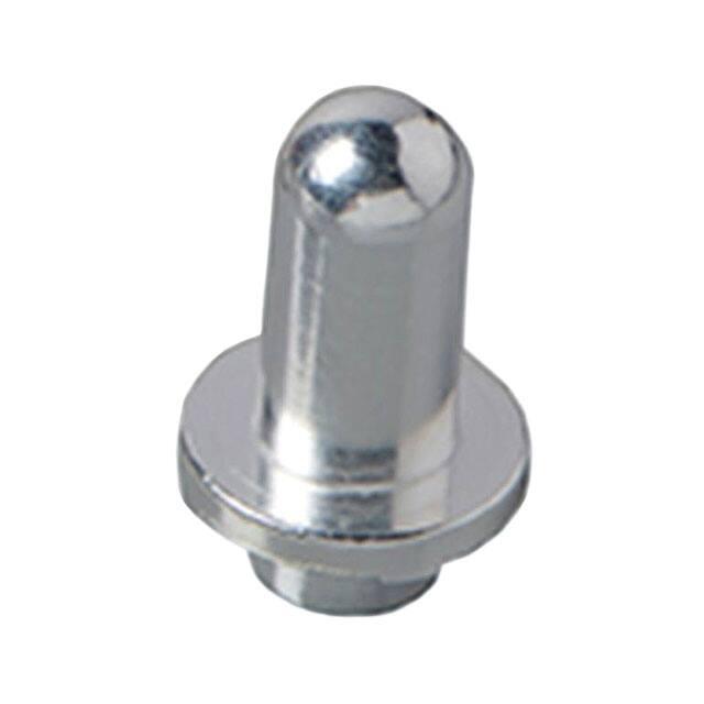

2032630136
    MOLEX10(莫仕)
    功率 引脚 触点 银 焊接,PCB
2032630136 数据手册
20 19 18 17 16 15 14 13 12 11 10 9 7 8 6 5 M L ⌀ 10.50 K ⌀6.00 ISOMETRIC VIEW OF THE PIN (CST MALE PIN, 6.00MM, SURFACE MOUNT) J 4 3 2 1 PART NUMBER DIMENSION "L" (MM) 203263-0106 26.00 203263-0116 20.00 203263-0126 14.00 203263-0136 31.75 203263-0146 29.50 203263-0156 16.00 203263-0176 37.20 203263-0186 31.00 203263-0196 26.75 203263-0206 16.80 203263-0226 21.50 203263-0246 36.00 203263-0256 48.00 203263-0266 27.70 M L K J H H ⌀ 6.05 ±0.05 PTH G G DIM "L" F F NOTES : 1.75 E E ⌀ 11.00 PAD 3.25 1. MATERIALS: - BASE METAL: HIGH CONDUCTIVE COPPER ALLOY - PLATING ON BODY: 3.18 MICRON MIN SILVER OVER 1.27 MICRON MIN NICKEL 2. PRODUCT SPECIFICATION: 2043130006-PS 3. APPLICATION SPECIFICATION: 2043130006-AS 4. PACKAGING SPECIFICATION: 2032630006-PK 5. SILVER COMPONENTS WILL BE SUPPLIED TARNISH FREE BUT MAY TARNISH OVER TIME 6. MINIMUM RECOMMENED PCB THICKNESS 1.58MM RECOMMENDED PCB LAYOUT D ⌀ �5.65� C D THIS DRAWING CONTAINS INFORMATION THAT IS PROPRIETARY TO MOLEX ELECTRONIC TECHNOLOGIES, LLC AND SHOULD NOT BE USED WITHOUT WRITTEN PERMISSION DIMENSION UNITS SCALE mm 5:1 C CURRENT REV DESC: UPDATED THE DESCRIPTION GENERAL TOLERANCES (UNLESS SPECIFIED) B A DOCUMENT STATUS FORMAT: master-tb-prod-D REVISION: J1 DATE: 2021/05/01 19 P1 RELEASE DATE 18 2022/10/28 17 ± 4 PLACES ± 3 PLACES ± 2 PLACES ± 0.15 1 PLACE ± 0.25 0 PLACES ± 0.5 ° DRAFT WHERE APPLICABLE MUST REMAIN WITHIN DIMENSIONS 09:47:21 16 ANGULAR TOL 15 14 13 12 11 10 9 8 7 SENTRALITY 6.00MM MALE TERMINAL SURFACE MOUNT EC NO: 726284 DRWN: SOURAJ CHK'D: SUVARS APPR: GSHARMA INITIAL REVISION: DRWN: RLOW APPR: BPISZCZOR THIRD ANGLE PROJECTION 2022/10/26 2022/10/27 2022/10/28 PRODUCT CUSTOMER DRAWING DOC TYPE DOC PART REVISION DOCUMENT NUMBER 2019/06/05 2019/06/10 DRAWING 5 2032630136-SD MATERIAL NUMBER SERIES D-SIZE 203263 6 B GENERAL MARKET 3 A9 SHEET NUMBER CUSTOMER SEE TABLE 4 PSD 000 2 1 OF 1 1 A
