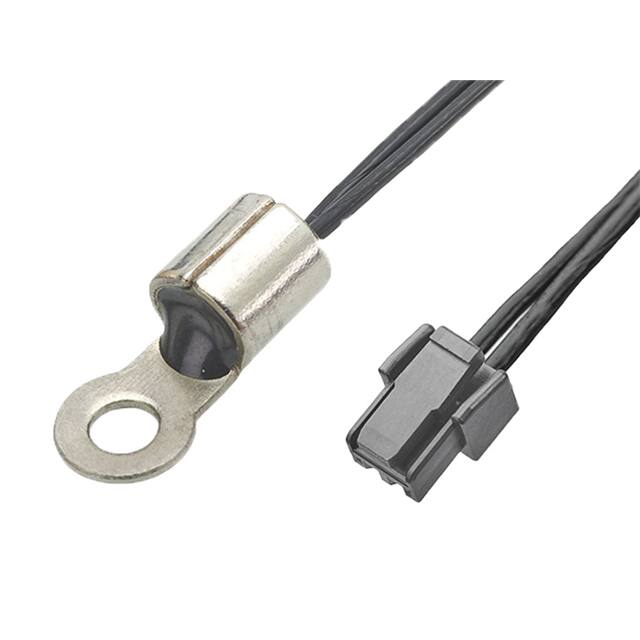

NTC Ring Temperature Sensor Cable Assemblies Molex’s Temperature Sensor Cable Assemblies are available in a variety of beta values, resistances, lengths and temperature ranges to meet a diverse range of applications. The NTC Ring and Epoxy Coated Temperature Sensor Cable Assemblies include a ring terminal, thermal conductive epoxy and/or a Micro-Lock PLUS connector to deliver a market-ready solution for temperature sensing Features and Advantages Ring terminal mounting tab Enables secure surface mounting and heat detection Potted with thermally conductive epoxy Assists in heat transfer from ring terminal to NTC chip UL certified, environmentally friendly connectors Ensures secure connection to the device and ready to use right away Compact temperature sensing solution Supports accurate surface temperature reading in difficult to reach location Micro-Lock Plus Ensures a reliable and easy connection Temperature Sensing Ring Terminal Reference Data Reference Data PARAMETER OPTIONS UNIT Resistance @ 25°C 1, 2.25, 3, 4.7, 5, 10, 12, 20, 30, 47, 50, 100 kohms Resistance Tolerance 1, 2, 3, 5 % Operating Temperature Range -40 to +150; -40 to +105 °C Dissipation Constant (in air) 3.2 mW/K Thermal Time Constant 5 s Temperature Coefficient Resistance -4.4 %/°C Max Power 100 mW Mounting Hole Diameter M2, M3.5, M4 mm Beta Value @ B25/85 3500, 3802, 3964, 3982, 4050, 3892, 4035, 3600 K Molex Connector 5055650201 NTC Ring Temperature Sensor Cable Assemblies Markets and Applications Consumer Vending machines ATMs Computers Printing machines Home Appliance Refrigerators Electric Ovens Freezers Coffee makers Industrial HVAC Motors Note: Molex reserves the right to delay or cancel production of the depicted product without additional notice. Please contact your Molex customer service representative for product availability. www.molex.com/link/temperaturesensorcableassemblies.html Molex is a registered trademark of Molex, LLC in the United States of America and may be registered in other countries; all other trademarks listed herein belong to their respective owners. Order No. 987652-1521 USA/0k/GF/2020.03 ©2020 Molex

物料型号:Molex 5055650201
器件简介:Molex的温度传感器电缆组件有多种beta值、电阻、长度和温度范围,适用于多种应用场景。NTC环形和环氧树脂涂层温度传感器电缆组件包括环形端子、热导电环氧树脂和/或Micro-Lock PLUS连接器,为温度感应提供市场就绪的解决方案。
引脚分配:文档中未明确提供引脚分配信息。
参数特性: - 25°C时的电阻:1, 2.25, 3, 4.7, 5, 10, 12, 20, 30, 47, 50, 100 kOhms - 电阻公差:1%, 2%, 3%, 5% - 工作温度范围:-40至+150°C 或 -40至+105°C - 耗散常数(空气中):3.2 mW/K - 热时间常数:5 秒 - 温度系数电阻:-4.4 %/°C - 最大功率:100 mW - 安装孔直径:M2, M3.5, M4 mm - B25/85时的Beta值:3500, 3802, 3964, 3982, 4050, 3892, 4035, 3600 K
功能详解:环形端子安装片可实现安全的表面安装和热检测;用热导电环氧树脂封装,有助于从环形端子到NTC芯片的热传递;UL认证的环保连接器确保与设备的连接安全且即插即用;紧凑的温度感应解决方案,支持在难以到达的位置进行准确的表面温度读取;Micro-Lock Plus确保可靠的温度感应环形端子和简易连接。
应用信息:适用于消费电子(如自动售货机、ATM、计算机、打印机)、家用电器(如冰箱、电烤箱、冷冻箱、咖啡机)和工业领域(如HVAC、电机)。
