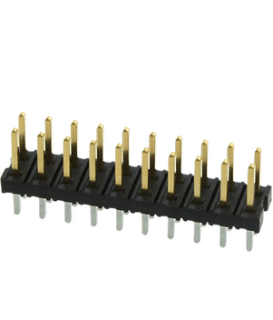

    MOLEX10(莫仕)
    CONN_19.9X4.4MM_TM
    20Pins 19.90 x 4.00mm
87758-2016 数据手册
9 7 8 5 6 A 4 B B 3 2 X M LEGEND 2.00 2.00 E 87758- Y 4.00 E **** CKT SIZE (SEE SHT 2 TABLE) 2.00 1 PLATING (SEE NOTE 2) 2.00 N NOTES: 1. MATERIAL: ⌀ 0.90 ±0.05 ⌖ ⌀0.20 X Y HOUSING: 30% G.F. NYLON 46, 94V-0, COLOR: BLACK PIN: 0.50mm SQ. PHOSPHOR BRONZE 510 2. PLATING: VIEW Q **16 - 0.38µm MIN GOLD IN CONTACT AREA, D D TIN IN SOLDER AREA, BOTH OVER 0.50 TYP BOTH SIDE NICKEL OVERALL. **17 - 0.76µm MIN GOLD IN CONTACT AREA, TIN IN SOLDER AREA, BOTH OVER NICKEL OVERALL. K 4.00 ±0.25 **18 - 2.54µm MIN TIN OVER NICKEL OVERALL. **19 - 0.05-0.25µm GOLD IN CONTACT AREA, 1.50 TIN IN SOLDER AREA, BOTH OVER C 2.60 ±0.30 C NICKEL OVERALL. L 3. 12 CKT USED FOR ILLUSTRATION ONLY 4. PACKED IN POCKET TRAY 5. PIN PUSHOUT FORCE: 1kg MIN IN EITHER DIRECTION 6 CKT 4 AND 6 IS CUT FROM CKT 8 AND 12 RESPECTIVELY. CKT 2 ARE CUT FROM ANY LARGER CKT SIZE,ROUGH EDGES VIEW P ARE EXPECTED ALONG THE CUTTING EDGES. 7. PRODUCT SPEC PS-87761-100 APPLIES. 8. RECOMMENDED PCB THICKNESS IS 1.60±0.10 B ⌀ 0.71 ±0.07 B ⌀ 0.71 ±0.07 ⌖ 0.30Ⓜ K M N ⌖ 0.30Ⓜ L M N THIS DRAWING CONTAINS INFORMATION THAT IS PROPRIETARY TO MOLEX ELECTRONIC TECHNOLOGIES, LLC AND SHOULD NOT BE USED WITHOUT WRITTEN PERMISSION SCALE mm NTS A MM 4 PLACES ± 2 PLACES ± ± 0.2 ± 0 PLACES ± ± ANGULAR TOL 9 P1 RELEASE DATE 2018/07/19 8 ± ± 1 PLACE DOCUMENT STATUS INCH ± 3 PLACES ± FORMAT: Met-lega-master-tb-prod-A3 REVISION: D DATE: 2018/01/18 CURRENT REV DESC: REMASTERED IN NX GENERAL TOLERANCES (UNLESS SPECIFIED) VIEW Q VIEW P DIMENSION UNITS ± 3.0 ° DRAFT WHERE APPLICABLE MUST REMAIN WITHIN DIMENSIONS 05:01:08 7 6 5 4 EC NO: 172192 SALES DRAWING DRWN: NVELUSAMY CHK'D: CD APPR: GGA INITIAL REVISION: DRWN: KSEE APPR: SKTOH THIRD ANGLE PROJECTION 3 2017/12/18 2MM DUAL ROW SINGLE WAFER, VERTICAL T/H HDR 2018/07/18 2018/07/19 PRODUCT CUSTOMER DRAWING DOC TYPE DOC PART REVISION DOCUMENT NUMBER 2003/10/30 2004/01/05 SD-87758-107 MATERIAL NUMBER DRAWING SERIES A3-SIZE 87758 2 SEE TABLE PSD 001 A5 SHEET NUMBER CUSTOMER GENERAL MARKET 1 1 OF 2 A 9 E D C 7 8 5 6 4 3 PART NUMBER CKT SIZE A B CKT SIZE 87758-02** 6 2 NA NA 87758-04** 6 4 NA 2.00 8 22 87758-06** 6 6 NA 4.00 87758-08** 8 7.90 6.00 87758-10** 10 9.90 8.00 87758-12** 12 11.90 10.00 87758-14** 14 13.90 12.00 87758-16** 16 15.90 14.00 87758-18** 18 17.90 16.00 87758-20** 20 19.90 18.00 87758-22** 22 21.90 20.00 87758-24** 24 23.90 22.00 87758-26** 26 25.90 24.00 87758-28** 28 27.90 26.00 87758-30** 30 29.90 28.00 87758-32** 32 31.90 30.00 87758-34** 34 33.90 32.00 87758-36** 36 35.90 34.00 87758-38** 38 37.90 36.00 87758-40** 40 39.90 38.00 87758-42** 42 41.90 44 43.90 42.00 87758-46** 46 45.90 44.00 87758-48** 48 47.90 46.00 87758-50** 50 49.90 48.00 1 PART NO. PART NO. WITH CAP IN TUBE WITH CAP IN TAPE/REEL 87758-0814 87758-5126 87758-0815 87758-5111 PLATING TYPE **16 MOLEX INC. E WITH CAP IN TUBE (22 CKT SHOWN FOR MOLEX INC.) WITH CAP IN TAPE/REEL (22 CKT SHOWN FOR MOLEX INC.) 12.00 ⌀ 1.55 0.40 2.00 4.00 CAP 5.20 �560� 23.00 40.40 D 44.00 HSG. TERMINALS SEE DETAIL A 6.35 10° 6.00 R 0.75 40.00 87758-44** 2 3° 12.00 �4.40� �9.45� DETAIL A C 9.90 �0.20� 8.00 B B THIS DRAWING CONTAINS INFORMATION THAT IS PROPRIETARY TO MOLEX ELECTRONIC TECHNOLOGIES, LLC AND SHOULD NOT BE USED WITHOUT WRITTEN PERMISSION DIMENSION UNITS SCALE mm NTS CURRENT REV DESC: REMASTERED IN NX GENERAL TOLERANCES (UNLESS SPECIFIED) A MM 4 PLACES ± 3 PLACES ± 2 PLACES ± ± 0.2 ± 0 PLACES ± ± ANGULAR TOL DOCUMENT STATUS 9 P1 RELEASE DATE 2018/07/19 8 ± ± 1 PLACE FORMAT: Met-lega-master-tb-prod-A3 REVISION: D DATE: 2018/01/18 INCH ± ± 3.0 ° DRAFT WHERE APPLICABLE MUST REMAIN WITHIN DIMENSIONS 05:01:08 7 6 5 4 EC NO: 172192 SALES DRAWING DRWN: NVELUSAMY CHK'D: CD APPR: GGA INITIAL REVISION: DRWN: KSEE APPR: SKTOH THIRD ANGLE PROJECTION 3 2017/12/18 2MM DUAL ROW SINGLE WAFER, VERTICAL T/H HDR 2018/07/18 2018/07/19 PRODUCT CUSTOMER DRAWING DOC TYPE DOC PART REVISION DOCUMENT NUMBER 2003/10/30 2004/01/05 SD-87758-107 MATERIAL NUMBER DRAWING SERIES A3-SIZE 87758 2 SEE TABLE PSD 001 A5 SHEET NUMBER CUSTOMER GENERAL MARKET 1 2 OF 2 A
