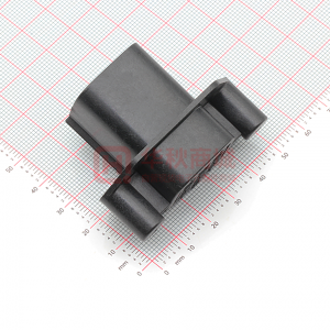

1801 Morgan Street Rockford, Illinois 61102 800-435-2931 www.molexkits.com Datasheet for 76650-0157 General Information Part Number: 76650-0157 Manufacturer: Title: Description: Product Family: Certificates: Molex / Waldom MLX Power Connector Kit Panel Mount Plug and Receptacle MLX™ (Molex Parts within this kit) - EU RoHS Compliant, UL and CSA Country of Origin: Kit assembled in U.S.A. Specifications Design Configuration: Pitch: Connector Type: Circuit Sizes: Current Rating: Voltage: Wire size: Product Highlights The MLX Series is an industry compatible line of 2.13mm (.084") diameter plug and cap power connections. The MLX Series is interchangeable, intermateable and intermountable with industry standard products. This allows for greater flexibility in mating with existing wire harnesses, connectors or PCB headers. The housings are designed for both male and female Molex terminals, and industry compatible terminals. Molex has provided circuit identification grooves for circuits 2 and 3 along with the industry standard identification rib for circuit 1. Wire to Wire 6.35mm (.250") Receptacles and Plugs 2, 3, 4, 6 and 9 Dep. on Circuit Size: 11 Amps (15-6) circuits or 13.5 Amps (4-1) circuits 600 Volts 20-14 AWG For additional Molex / Waldom Design and Solution Kits please go to www.molexkits.com Page 1 of 2 1801 Morgan Street Rockford, Illinois 61102 800-435-2931 www.molexkits.com Datasheet for 76650-0157 Features and Benefits • Housings: both male or female terminals • Positive locks • Fully isolated contacts • Systems are intermateable, intermountable, and interchangeable with industry standard versions • Cross compatible tested to assure industry compatibility • Circuit ID grooves to reduce assembly errors Applications • Vending and Gaming • White Goods • Construction • Mining • Material Handling • Energy and Power • Environmental Equipment and Controls • Production Equipment • Non-Automotive Transportation: Recreational vehicles, Travel trailers, Boats Bill of Materials for Part No. 76650-0157 Country Molex Part No. of Origin 02-08-1002-C 02-08-2004-C 50-84-1020 50-84-1030 50-84-1040 50-84-1060 50-84-1090 50-84-2020 50-84-2030 50-84-2040 50-84-2060 50-84-2090 India India India India India India India India India India India India Description MLX™ Female Socket Contacts (20-14) AWG MLX™ Male Pin Contacts (20-14) AWG .250" (6.35mm) Pitch MLX™ Pin & Socket Plug 2 Circuit .250" (6.35mm) Pitch MLX™ Pin & Socket Plug 3 Circuit .250" (6.35mm) Pitch MLX™ Pin & Socket Plug 4 Circuit .250" (6.35mm) Pitch MLX™ Pin & Socket Plug 6 Circuit .250" (6.35mm) Pitch MLX™ Pin & Socket Plug 9 Circuit .250" (6.35mm) Pitch MLX™ Pin & Socket Receptacle, Panel Mount 2 Circuit .250" (6.35mm) Pitch MLX™ Pin & Socket Receptacle, Panel Mount 3 Circuit .250" (6.35mm) Pitch MLX™ Pin & Socket Receptacle, Panel Mount 4 Circuit .250" (6.35mm) Pitch MLX™ Pin & Socket Receptacle, Panel Mount 6 Circuit .250" (6.35mm) Pitch MLX™ Pin & Socket Receptacle, Panel Mount 9 Circuit Quantity in Kit 100 100 10 6 7 5 4 10 6 7 5 4 Recommended Molex Tool(s) for Part No. 76650-0157* Country Molex Part No. of Origin 63811-6800 * 11-01-0168 * Germany Hand Crimp Tool USA Extraction Tool Description *Tool(s) not included in kit. Tool(s) ordered separately. For additional Molex / Waldom Design and Solution Kits please go to www.molexkits.com Page 2 of 2
50-84-2030
1. 物料型号: - 型号:76650-0157 - 制造商:Molex / Waldom
2. 器件简介: - 标题:MLX Power Connector Kit - 描述:Panel Mount Plug and Receptacle - 产品家族:MLX™ - 认证:EU RoHS Compliant, UL 和 CSA - 产地:在美国组装
3. 引脚分配: - 配置:Wire to Wire - 间距:6.35mm (.250") - 连接器类型:Receptacles 和 Plugs - 电路尺寸:2, 3, 4, 6 和 9 - 电流额定值:根据电路尺寸不同,11安培(15-6)电路或13.5安培(4-1)电路 - 电压:600伏特 - 线径:20-14 AWG
4. 参数特性: - MLX系列是2.13mm(.084")直径的插头和帽电源连接的行业兼容线。 - MLX系列与行业标准产品可互换、可互配、可互装,提高了与现有线束、连接器或PCB头的配合灵活性。 - 外壳设计适用于Molex公端和母端端子以及行业兼容端子。 - Molex提供了电路识别凹槽,用于2和3电路,以及行业标准的识别肋用于1电路。
5. 功能详解: - 外壳:适用于公端或母端端子 - 正锁定:确保连接牢固 - 完全隔离的接触点:提高安全性 - 系统可互配、可互换、可互装,与行业标准版本一致 - 交叉兼容性测试,确保行业兼容性 - 电路ID凹槽,减少装配错误
6. 应用信息: - 应用领域包括:自动售货和游戏、白色家电、建筑、矿业、物料处理、能源和电力、环境设备和控制、生产设备、非汽车运输(如休闲车、旅行拖车、船只)。
7. 封装信息: - 提供了不同电路尺寸的插头和插座,包括2、3、4、6和9电路的配置,以及面板安装的插座。
