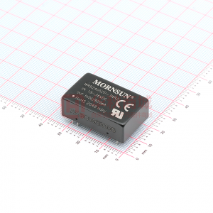

WRA_ZP-3W & WRB_ZP-3W Series 3W, WIDE INPUT, ISOLATED & REGULATED DUAL/SINGLE OUTPUT, DIP DC-DC CONVERTER m ulti-country patent protection RoHS FEATURES Wide (2:1) Input Range Operating Temperature:-40 to +85°C Short circuit protection(automatic recovery) 1500VDC Isolation Internal SMD construction Metal Shielding Package No Heat Sink Required Industry Standard Pinout MTBF>1,000,000 hours RoHS Compliance PRODUCT PROGRAM Input Part Number W RA0505ZP-3W W RA0509ZP-3W W RA0512ZP-3W W RA0515ZP-3W W RB0503ZP-2W W RB0505ZP-3W W RB0512ZP-3W W RB0515ZP-3W W RA1205ZP-3W W RA1209ZP-3W 5 4.5-9 11 Voltage (VDC) Nominal R ange Max* Voltage (VDC) ±5 ±9 ±12 ±15 3.3 5 12 15 ±5 ±9 ±12 12 9-18 22 ±15 3.3 5 12 15 ±5 ±9 ±12 24 18-36 40 ±15 3.3 5 12 15 ±5 ±9 ±12 48 36-72 80 ±15 3.3 5 12 15 Output Current (mA) Max ±300 ±166 ±125 ±100 600 600 250 200 ±300 ±166 ±125 ±100 600 600 250 200 ±300 ±166 ±125 ±100 909 600 250 200 ±300 ±166 ±125 ±100 909 600 250 200 Min ±30 ±16 ±12 ±10 60 60 25 20 ±30 ±16 ±12 ±10 60 60 25 20 ±30 ±16 ±12 ±10 90 60 25 20 ±30 ±16 ±12 ±10 90 60 25 20 68 70 71 71 65 68 71 71 76 78 79 80 71 76 79 80 78 79 80 81 76 78 81 82 78 79 80 81 76 78 80 81 Effiecincy (%, Typ) APPLICATIONS The WRB_ZP-3W &WRA_ZP-3W Series are specially designed for applications where a wide range input voltage power supplies are isolated from the input power supply in a distributed power supply system on a circuit board. These products apply to: 1) Where the voltage of the input power supply is wide range (voltage range≤ 2:1); 2) Where isolation is necessary between input and output(isolation voltage≤1500VDC); 3) Where the regulation of the output voltage and the output ripple noise are demanded. W RA1212ZP-3W W RA1215ZP-3W W RB1203ZP-2W W RB1205ZP-3W W RB1212ZP-3W W RB1215ZP-3W W RA2405ZP-3W W RA2409ZP-3W W RA2412ZP-3W W RA2415ZP-3W W RB2403ZP-3W W RB2405ZP-3W W RB2412ZP-3W W RB2415ZP-3W W RA4805ZP-3W W RA4809ZP-3W MODEL SELECTION WRB0512ZP-3W Ra ted Power Packag e Style Output Voltage Input Voltage Produ ct S eries W RA4812ZP-3W W RA4815ZP-3W WRB4803ZP-3W WRB4805ZP-3W WRB4812ZP-3W WRB4815ZP-3W *Input voltage can’t exceed this value, or will cause the permanent damage. Note: The load shouldn't be less than 10%, otherwise ripple will increase dramatically. Operation under 10% load will not damage the converter; However, they may not meet all specification listed. ISOLATION SPECIFICATIONS MORNSUN Science & Technology co.,Ltd. Address: 2th floor 6th building, Hangzhou Industrial District, Guangzhou, China Tel: 86-20-38601850 Fax: 86-20-38601272 http://www.mornsun-power.com Item Isolation voltage Isolation resistance Test conditions Tested for 1 minute and 1 mA max Test at 500VDC Min 1500 1000 Typ Max Units VDC MΩ Isolation capacitance Input/Output 85 pF MORNSUN reserves the copyright Specifications subject to change without notice. WRA_ZP-3W & WRB_ZP-3W A/1-2008 Page 1 of 2 OUTPUT SPECIFICATIONS Item Test conditions Min 0.3 Typ Max Units W Output power See below products program Positive voltage accuracy R efer to recommended circuit N egative voltage accuracy R efer to recommended circuit 10% to 100% load(WRB_ZP_3W) Load regulation 10% to 100% load(WRA_ZP_3W)* Line regulation Temperature drift Ripple & Noise** Switching frequency Input voltage from low to high R efer to recommended circuit 20MHz bandwidth 100% load, nominal input voltage 50 300 3 ±1 ±3 ±3 ±5 ±0.5 ±0.75 ±0.5 ±0.2 ±1 ±0.5 ±0.03 %/°C 100 mVp-p KHz APPLICATION NOTE Requirement on output load In order to ensure the product operate efficiently and reliably, in addition to a max load (namely full load), a minimum load is specified for this kind of DC/DC converter. Make sure the specified range of input voltage is not exceeded, the minimum output load no less than 10% load. If the actual load is less than the specified minimum load, the output ripple may increase sharply while its efficiency and reliability will reduce greatly. If the actual output power is very small, please add an appropriate resistor as extra loading, or contact our company for other lower output power products. Recommended Circuit All the WRA_ZP-3W & WRB_ZP-3W Series Min -40 -55 15 Typ Max 95 85 125 300 0.2 Free air convection Continuous, automatic recovery Copper, Nickel Coated 1000 15 K hours g W GND Single Output Vin Cin % *Dual output models unbalanced load: ±5%. **Test ripple and noise by “parallel cable” method. See detailed operation instructions at Testing of Power Converter section, application notes. COMMON SPECIFICATIONS Item Storage humidity Operating temperature Storage temperature Temp. rise at full load Lead temperature N o-load power consumption C ooling Short circuit protection C ase material MTBF Weight 1.5mm from case for 10 seconds Test Conditions Units % °C have been tested according to the following r ecommended testing circuit before leaving factory (Figure 1). This series should be tested under load. Vin Cin +Vout DC DC 0V -Vout +Vout DC DC 0V GND Note: 1.All specifications measured at TA=25°C, humidity
