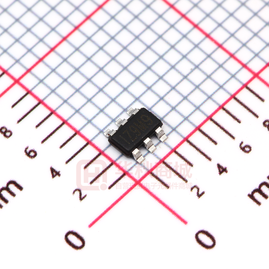

TOP MARKING
Z9: product code of MP1488DJ;
Y: year code;
W: week code:
PACKAGE REFERENCE
TSOT23-6
