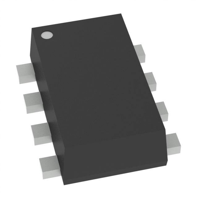

MP2182GTL-Z 数据手册
MP2182 2A, Synchronous Step-Down Converter with SS & PG DESCRIPTION FEATURES The MP2182 is a monolithic, step-down, switchmode converter with built-in internal power MOSFETs. It achieves 2A continuous output current from a 2.5V to 5.5V input voltage with excellent load and line regulation. The output voltage can be regulated to as low as 0.6V.         The constant-on-time (COT) control scheme provides fast transient response and eases loop stabilization. Fault protections include cycle-bycycle current limiting and thermal shutdown. The MP2182 is available in an ultra-small SOT583 package and requires a minimal number of readily available, standard external components. The MP2182 is ideal for a wide range of applications including high-performance DSPs, wireless power, portable and mobile devices, and other low-power systems.        Low IQ: 21μA 1.2MHz Switching Frequency EN for Power Sequencing 1% FB Accuracy Wide 2.5V to 5.5V Operating Input Range Output Adjustable from 0.6V Up to 2A Output Current 80mΩ and 40mΩ Internal Power MOSFET Switches 100% Duty On Output Discharge VO OVP External Soft-Start Control Short-Circuit Protection with Hiccup Mode Power Good Available in a SOT583 Package APPLICATIONS      Wireless/Networking Cards Portable Instruments Battery-Powered Devices Low-Voltage I/O System Power Multi-Function Printers All MPS parts are lead-free and adhere to the RoHS directive. For MPS green status, visit the MPS website under Quality Assurance. “MPS”, the MPS logo, and “Simple, Easy Solutions” are registered trademarks of Monolithic Power Systems, Inc. or its subsidiaries. TYPICAL APPLICATION L1 1μH SW VIN R1 100kΩ EN EN SS SS C3 2.2nF MP2182 FB R2 100kΩ PG GND L = 1µH (DCR = 27mΩ) 100 OUT C1 10μF Efficiency vs. Output Current VOUT 1.2V/2A C2 22μF 95 EFFICIENCY (%) VIN 5V 90 85 80 75 Vin=2.5V,Vo=1.2V Vin=3.6V,Vo=1.2V Vin=5V,Vo=1.2V 70 0.001 MP2182 Rev. 1.0 5/8/2019 0.01 0.1 OUTPUT CURRENT (A) www.MonolithicPower.com MPS Proprietary Information. Patent Protected. Unauthorized Photocopy and Duplication Prohibited. © 2019 MPS. All Rights Reserved. 1 1 MP2182 – 2A SYNCHRONOUS STEP-DOWN SWITCHER WITH SS & PG ORDERING INFORMATION Part Number* MP2182GTL Package SOT583 Top Marking See Below * For Tape & Reel, add suffix –Z (e.g. MP2182GTL–Z). TOP MARKING BEX: Product code of MP2182GTL Y: Year code LLL: Lot number PACKAGE REFERENCE TOP VIEW PG 1 8 VIN FB OUT SW SS GND 4 5 EN SOT583 PIN FUNCTIONS Pin # Name 1 PG 2 VIN 3 SW 4 GND 5 EN 6 SS 7 OUT 8 FB MP2182 Rev. 1.0 5/8/2019 Description Power good indicator. The output of this pin is an open drain. Supply voltage. The MP2182 operates from a +2.5V to +5.5V unregulated input. A decoupling capacitor is needed to prevent large voltage spikes from appearing at the input. Output switching node. SW is the drain of the internal high-side P-Channel MOSFET. Connect the inductor to SW to complete the converter. Ground. On/off control. Soft start. Connect a capacitor across SS and GND to set the soft-start time to avoid start-up inrush current. Output voltage power rail and input sense pin for output voltage. Connect load to this pin. An output capacitor is needed to decrease the output voltage ripple. Feedback pin. An external resistor divider from the output to GND, tapped to the FB pin, sets the output voltage. www.MonolithicPower.com MPS Proprietary Information. Patent Protected. Unauthorized Photocopy and Duplication Prohibited. © 2019 MPS. All Rights Reserved. 2 MP2182 – 2A SYNCHRONOUS STEP-DOWN SWITCHER WITH SS & PG ABSOLUTE MAXIMUM RATINGS (1) Supply voltage (VIN) .................................... 6.5V VSW ...................................................................... -0.3V (-5V for
