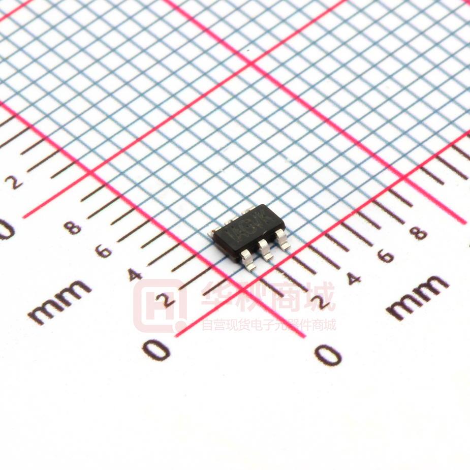

    TSOT23-6中的0.5A、50V、1.2MHz降压转换器
MP2456GJ-Z 数据手册
MP2456 0.5A, 50V, 1.2MHz Step-Down Converter in a TSOT23-6 The Future of Analog IC Technology DESCRIPTION FEATURES The MP2456 is a monolithic, step-down, switchmode converter with a built-in power MOSFET. It achieves a 0.5A peak-output current over a wide input supply range with excellent load and line regulation. Current-mode operation provides a fast transient response and eases loop stabilization. Fault condition protections include cycle-by-cycle current limiting and thermal shutdown.             The MP2456 requires a minimal number of readily-available external components. The MP2456 is available in a TSOT23-6 package. 0.5A Peak Output Current 1Ω Internal Power MOSFET Capable to Start Up with Big Output Capacitor Stable with Low-ESR Ceramic Output Capacitors Up to 90% Efficiency 0.1μA Shutdown Mode Fixed 1.2MHz Frequency Thermal Shutdown Cycle-by-Cycle Over-Current Protection Wide 4.5V-to-50V Operating Input Range Output Adjustable from 0.81V to 0.9xVIN Available in a TSOT23-6 Package APPLICATIONS      Power Meters Distributed Power Systems Battery Chargers Pre-Regulator for Linear Regulators WLED Drivers All MPS parts are lead-free and adhere to the RoHS directive. For MPS green status, please visit MPS website under Products, Quality Assurance page. “MPS” and “The Future of Analog IC Technology” are registered trademarks of Monolithic Power Systems, Inc. TYPICAL APPLICATION 5 VIN BST 1 IN C2 100nF MP2456 C1 4.7µF GND U1 SW L1 10µH 6 D1 EN MP2456 Rev. 1.01 1/24/2017 4 EN GND 2 FB 5V C3 10µF VOUT R2 124k 3 R1 23.7k GND www.MonolithicPower.com MPS Proprietary Information. Patent Protected. Unauthorized Photocopy and Duplication Prohibited. © 2017 MPS. All Rights Reserved. 1 MP2456 – 0.5A, 50V, 1.2MHz, STEP-DOWN CONVERTER IN A TSOT23-6 ORDERING INFORMATION Part Number* Package TSOT23-6 MP2456GJ Top Marking AGV * For Tape & Reel, add suffix –Z (eg. MP2456GJ–Z); PACKAGE REFERENCE TOP VIEW BST 1 6 SW GND 2 5 IN FB 3 4 EN ABSOLUTE MAXIMUM RATINGS (1) Thermal Resistance Supply Voltage VIN ......................... −0.3V to 52V VSW ......................................... −0.3V to VIN+0.3V VBS ....................................................... VSW + 6V All Other Pins ................................. −0.3V to +6V EN Sink Current ....................................... 100μA Continuous Power Dissipation (TA = +25°C) (2) TSOT23-6 .............................................. 0.568W Junction Temperature ...............................150°C Lead Temperature ....................................260°C Storage Temperature .............. −65°C to +150°C TSOT23-6 ............................... 220 ... 110 °C/W Recommended Operating Conditions (3) Supply Voltage VIN ........................... 4.5V to 50V Output Voltage VOUT ................. 0.81V to 0.9×VIN Operating Junction Temp. ...... −40°C to +125°C MP2456 Rev. 1.01 1/24/2017 (4) θJA θJC Notes: 1) Exceeding these ratings may damage the device. 2) The maximum allowable power dissipation is a function of the maximum junction temperature TJ(MAX), the junction-toambient thermal resistance θJA, and the ambient temperature TA. The maximum allowable continuous power dissipation at any ambient temperature is calculated by PD(MAX)=(TJ(MAX)TA)/θJA. Exceeding the maximum allowable power dissipation will cause excessive die temperature, and the regulator will go into thermal shutdown. Internal thermal shutdown circuitry protects the device from permanent damage. 3) The device function is not guaranteed outside of the recommended operating conditions. 4) Measured on JESD51-7, 4-layer PCB.. www.MonolithicPower.com MPS Proprietary Information. Patent Protected. Unauthorized Photocopy and Duplication Prohibited. © 2017 MPS. All Rights Reserved. 2 MP2456 – 0.5A, 50V, 1.2MHz, STEP-DOWN CONVERTER IN A TSOT23-6 ELECTRICAL CHARACTERISTICS VIN = 12V, TA = +25°C, unless otherwise noted. Parameters Symbol Condition Feedback Voltage VFB 4.5V  VIN  50V Feedback Current IFB VFB = 0.85V Switch-On Resistance RDS(ON) Switch Leakage ISW_LKG Min Typ Max Units 0.792 0.812 0.832 V 0.1 μA 1 VEN = 0V, VSW = 0V Current Limit ILIM Oscillator Frequency fSW Foldback Frequency fSW_F VFB = 0V Maximum Duty Cycle DMAX VFB = 0.6V VFB = 0.6V Ω 1 μA 1.0 1.25 1.5 A 0.95 1.2 1.45 MHz 89 200 kHz 91 % 50 ns (5) τON Under-Voltage Lockout Threshold, Rising VUVLO_R 2.9 3.3 3.7 V Under-Voltage Lockout Threshold, Falling VUVLO_F 2.65 3.05 3.45 V Minimum ON-Time Under-Voltage Lockout Threshold, Hysteresis VUVLO_HYS 250 mV EN Threshold, Rising VEN_R 1.2 1.35 1.5 V EN Threshold, Falling VEN_F 1 1.17 1.35 V EN Threshold, Hysteresis VEN_HYS 3.1 VEN = 0V 0.1 IS VEN = 0V 0.1 1.0 μA IQ VEN = 2V, VFB = 1V 0.73 0.85 mA IEN Supply Current (Shutdown) Supply Current (Quiescent) Thermal Shutdown Hysteresis (5) mV VEN = 2V EN Input Current Thermal Shutdown (5) 180 μA TSD 165 °C TSD_HYS 20 °C Notes: 5) Derived from bench characterization. Not tested in production. MP2456 Rev. 1.01 1/24/2017 www.MonolithicPower.com MPS Proprietary Information. Patent Protected. Unauthorized Photocopy and Duplication Prohibited. © 2017 MPS. All Rights Reserved. 3 MP2456 – 0.5A, 50V, 1.2MHz, STEP-DOWN CONVERTER IN A TSOT23-6 TYPICAL CHARACTERISTICS VIN=12V, unless otherwise noted. MP2456 Rev. 1.01 1/24/2017 www.MonolithicPower.com MPS Proprietary Information. Patent Protected. Unauthorized Photocopy and Duplication Prohibited. © 2017 MPS. All Rights Reserved. 4 MP2456 – 0.5A, 50V, 1.2MHz, STEP-DOWN CONVERTER IN A TSOT23-6 TYPICAL PERFORMANCE CHARACTERISTICS (continued) VIN=12V, VOUT=5V, L=10μH, TA=25°C, unless otherwise noted. MP2456 Rev. 1.01 1/24/2017 www.MonolithicPower.com MPS Proprietary Information. Patent Protected. Unauthorized Photocopy and Duplication Prohibited. © 2017 MPS. All Rights Reserved. 5 MP2456 – 0.5A, 50V, 1.2MHz, STEP-DOWN CONVERTER IN A TSOT23-6 TYPICAL PERFORMANCE CHARACTERISTICS (continued) VIN=12V, VOUT=5V, L=10μH, TA=25°C, unless otherwise noted. MP2456 Rev. 1.01 1/24/2017 www.MonolithicPower.com MPS Proprietary Information. Patent Protected. Unauthorized Photocopy and Duplication Prohibited. © 2017 MPS. All Rights Reserved. 6 MP2456 – 0.5A, 50V, 1.2MHz, STEP-DOWN CONVERTER IN A TSOT23-6 TYPICAL PERFORMANCE CHARACTERISTICS (continued) VIN=12V, VOUT=5V, L=10μH, TA=25°C, unless otherwise noted. MP2456 Rev. 1.01 1/24/2017 www.MonolithicPower.com MPS Proprietary Information. Patent Protected. Unauthorized Photocopy and Duplication Prohibited. © 2017 MPS. All Rights Reserved. 7 MP2456 – 0.5A, 50V, 1.2MHz, STEP-DOWN CONVERTER IN A TSOT23-6 PIN FUNCTIONS Pin # Name Description 1 BST 2 GND 3 FB 4 EN 5 IN 6 SW MP2456 Rev. 1.01 1/24/2017 Bootstrap. Connect a capacitor between the SW and BST pins to form a floating supply across the power switch driver. This capacitor drives the power switch’s gate above the supply voltage. Ground. Voltage reference for the regulated output voltage. Requires special layout considerations. Isolate this node from the D1 to C1 ground path to prevent switching current spikes from inducing. Feedback. Sets the output voltage. Connect to the tap of an external resistor divider from the output to GND. The frequency foldback comparator lowers the oscillator frequency when the FB voltage is below 250mV to prevent current-limit runaway during a short-circuit fault. On/Off. Pull EN above 1.35V to turn the device ON. For automatic enable, connect to VIN using a resistor. Note that make sure the sink current of EN pin not exceed 100μA. Supply Voltage. The MP2456 operates from a 4.5V-to-50V unregulated input. Requires C1 to prevent large voltage spikes from appearing at the input. Switch Output. www.MonolithicPower.com MPS Proprietary Information. Patent Protected. Unauthorized Photocopy and Duplication Prohibited. © 2017 MPS. All Rights Reserved. 8 MP2456 – 0.5A, 50V, 1.2MHz, STEP-DOWN CONVERTER IN A TSOT23-6 OPERATION The MP2456 is a current mode buck regulator. That is, the EA output voltage is proportional to the peak inductor current. At the beginning of a cycle, M1 is off. The EA output voltage is higher than the current sense amplifier output, and the current comparator’s output is low. The rising edge of the 1.2MHz CLK signal sets the RS Flip-Flop. Its output turns on M1 thus connecting the SW pin and inductor to the input supply. The increasing inductor current is sensed and amplified by the Current Sense Amplifier. Ramp compensation is summed to the Current Sense Amplifier output and compared to the Error Amplifier output by the PWM Comparator. When the sum of the Current Sense Amplifier output and the Ramp Compensation signal exceeds the EA output voltage, the RS FlipFlop is reset and M1 is turned off. The external Schottky rectifier diode (D1) conducts the inductor current. If the sum of the Current Sense Amplifier output and the Ramp Compensation signal does not exceed the EA output for a whole cycle, then the falling edge of the CLK resets the Flip-Flop. MP2456 Rev. 1.01 1/24/2017 The output of the Error Amplifier integrates the voltage difference between the feedback and the 0.81V bandgap reference. The polarity is such that lower than 0.81V FB pin voltage increases the EA output voltage. Since the EA output voltage is proportional to the peak inductor current, an increase in its voltage also increases current delivered to the output. The MP2456 has 0.6ms internal soft-start. Softstart prevents the converter output voltage from overshooting during startup. When the chip starts, the internal circuit generates a soft-start voltage (SS) ramping up with fixed rising rate. When it is less than the internal reference (REF), SS overrides REF so the error amplifier uses SS as the reference. When SS exceeds REF, REF regains control. When there is extreme big capacitor at output (e.g. 2200uF or even bigger), output voltage would rises slower than SS because the current that needed to charge up the big output capacitor is higher than chip's max output current ability. Current limit would be kicked in the whole startup period untill Vo rises to its regulated value. www.MonolithicPower.com MPS Proprietary Information. Patent Protected. Unauthorized Photocopy and Duplication Prohibited. © 2017 MPS. All Rights Reserved. 9 MP2456 – 0.5A, 50V, 1.2MHz, STEP-DOWN CONVERTER IN A TSOT23-6 Figure 1: Functional Block Diagram MP2456 Rev. 1.01 1/24/2017 www.MonolithicPower.com MPS Proprietary Information. Patent Protected. Unauthorized Photocopy and Duplication Prohibited. © 2017 MPS. All Rights Reserved. 10 MP2456 – 0.5A, 50V, 1.2MHz, STEP-DOWN CONVERTER IN A TSOT23-6 APPLICATION INFORMATION Setting Output Voltage The external resistor divider sets the output voltage (see the Typical Application schematic). Table 1 lists resistors for common output voltages. The feedback resistor (R2) also sets the feedback loop bandwidth with the internal compensation network (see Figure 1). R1 is: R1  R2 VOUT 1 0.812V Table 1: Resistor Selection for Common Output Voltages VOUT (V) R1 (kΩ) R2 (kΩ) 1.8 2.5 3.3 5 12 102 (1%) 59 (1%) 40.2 (1%) 23.7 (1%) 8.2 (1%) 124 (1%) 124 (1%) 124 (1%) 124 (1%) 113 (1%) Selecting the Inductor Use an inductor with a DC current rating at least 25% percent higher than the maximum load current for most applications. For best efficiency, the inductor’s DC resistance should be less than 200m. Refer to Table 2 for suggested surface-mount inductors. For most designs, the required inductance value can be derived from the following equation. L VOUT  ( VIN  VOUT ) VIN  IL  f SW Selecting the Input Capacitor The input capacitor reduces the surge current drawn from the input supply and the switching noise from the device. The input capacitor impedance at the switching frequency should be less than the input source impedance to prevent high-frequency-switching current from passing through the input. Use ceramic capacitors with X5R or X7R dielectrics for their low ESRs and small temperature coefficients. For most applications, a 4.7µF capacitor will sufficient. Selecting the Output Capacitor The output capacitor keeps the output voltage ripple small and ensures feedback loop stability. The output capacitor impedance should be low at the switching frequency. Use ceramic capacitors with X5R or X7R dielectrics for their low ESR characteristics. For most applications, a 22µF ceramic capacitor will sufficient. PCB Layout Guide PCB layout is very important to stability. Please follow these guidelines and use Figure 2 as reference. 1) Keep the path of switching current short and minimize the loop area formed by the input capacitor, high-side MOSFET, and Schottky diode. 2) Keep the connection from the power ground→Schottky diode→SW pin as short and wide as possible. 3) Ensure all feedback connections are short and direct. Place the feedback resistors and compensation components as close to the chip as possible. 4) Route SW away from sensitive analog areas such as FB. 5) Connect IN, SW, and especially GND to large copper areas to cool the chip for improved thermal performance and longterm reliability. For single layer PCBs, avoid soldering the exposed pad. Where ∆IL is the inductor ripple current. Choose the inductor ripple current to be 30% of the maximum load current. The maximum inductor peak current is: IL(MAX )  ILOAD  I L 2 Under light-load conditions (below 100mA), use a larger inductance to improve efficiency. MP2456 Rev. 1.01 1/24/2017 www.MonolithicPower.com MPS Proprietary Information. Patent Protected. Unauthorized Photocopy and Duplication Prohibited. © 2017 MPS. All Rights Reserved. 11 MP2456 – 0.5A, 50V, 1.2MHz, STEP-DOWN CONVERTER IN A TSOT23-6 1 R2 External Bootstrap Diode An external bootstrap diode may enhance regulator efficiency under the following conditions: R12 SGND C3 1 BST SW 6 EN 4 2 GND IN 5 3 FB R3 C1  VOUT=5V or 3.3V; and  High duty cycle: D= VOUT >65% VIN In these cases, add an external BST diode from the output of the voltage regulator to the BST pin, as shown in Figure 3. L1 External BST Diode IN4148 D1 BST C2 PGND MP2456 SW Figure 2: PCB Layout 5V or 3.3V L COUT Figure 3: Optional Bootstrap Diode for Enhanced Efficiency The recommended external BST diode is IN4148, and the BST capacitor is 0.1µF-1µF. Table 2: Inductor Selection Guide Inductance(uH) Max DCR() Current Rating(A) Dimensions LWH(mm3) 74408943047 4.7 0.05 2.2 4.84.83.8 74408942100 10 0.125 1.38 4.84.82.8 744775133 33 0.13 1.35 7.875 VLCF4028T-4R7N1R5-2 4.7 0.06 1.5 44.32.8 CLF5030NIT-100M-D 10 0.1 1.6 55.32.7 VLS5045EX-330M 33 0.24 1.3 554.5 Part Number Wurth TDK MP2456 Rev. 1.01 1/24/2017 www.MonolithicPower.com MPS Proprietary Information. Patent Protected. Unauthorized Photocopy and Duplication Prohibited. © 2017 MPS. All Rights Reserved. 12 MP2456 – 0.5A, 50V, 1.2MHz, STEP-DOWN CONVERTER IN A TSOT23-6 TYPICAL APPLICATION CIRCUIT U1 VIN C1 4.7µF 50V 5 C2 0.1µF 50V BST IN D2 NS 1 R6 0 MP2456 GND SW R5 500k 4 EN EN R4 NS GND L1 10µH C3 100nF 6 D1 DFLS160 R2 124k 3 FB VOUT GND R1 23.7k 2 5V C5 10µF 16V R3 C4 0 47pF Figure 4: 5V Output Typical Application Circuit: U1 VIN C1 4.7µF 50V 5 C2 0.1µF 50V BST IN 1 R6 0 MP2456 GND SW R5 500k 4 EN R4 NS EN GND 2 FB L1 33µH C3 100nF 6 12V C5 22µF 16V D1 DFLS160 R2 113k 3 R1 8.2k VOUT GND R3 0 C4 47pF Figure 5: 12V Output Typical Application Circuit MP2456 Rev. 1.01 1/24/2017 www.MonolithicPower.com MPS Proprietary Information. Patent Protected. Unauthorized Photocopy and Duplication Prohibited. © 2017 MPS. All Rights Reserved. 13 MP2456 – 0.5A, 50V, 1.2MHz, STEP-DOWN CONVERTER IN A TSOT23-6 PACKAGE INFORMATION TSOT23-6 See note 7 EXAMPLE TOP MARK PIN 1 ID IAAAA RECOMMENDED LAND PATTERN TOP VIEW SEATING PLANE SEE DETAIL''A'' FRONT VIEW SIDE VIEW NOTE: DETAIL "A" 1) ALL DIMENSIONS ARE IN MILLIMETERS . 2) PACKAGE LENGTH DOES NOT INCLUDE MOLD FLASH , PROTRUSION OR GATE BURR. 3) PACKAGE WIDTH DOES NOT INCLUDE INTERLEAD FLASH OR PROTRUSION. 4) LEAD COPLANARITY(BOTTOM OF LEADS AFTER FORMING) SHALL BE 0.10 MILLIMETERS MAX. 5) DRAWING CONFORMS TO JEDEC MO-193, VARIATION AB. 6) DRAWING IS NOT TO SCALE. 7) PIN 1 IS LOWER LEFT PIN WHEN READING TOP MARK FROM LEFT TO RIGHT, (SEE EXAMPLE TOP MARK) NOTICE: The information in this document is subject to change without notice. Users should warrant and guarantee that third party Intellectual Property rights are not infringed upon when integrating MPS products into any application. MPS will not assume any legal responsibility for any said applications. MP2456 Rev. 1.01 1/24/2017 www.MonolithicPower.com MPS Proprietary Information. Patent Protected. Unauthorized Photocopy and Duplication Prohibited. © 2017 MPS. All Rights Reserved. 14
