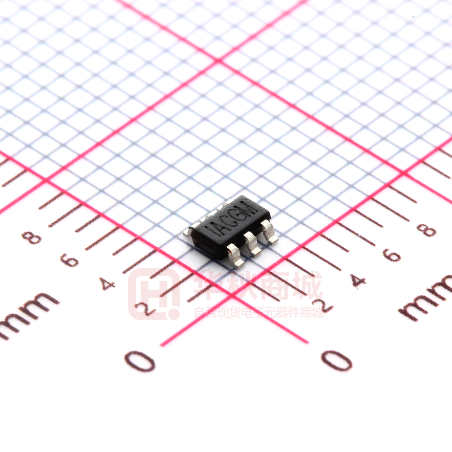

The MP24894 is available in TSOT6 package.

ORDERING INFORMATION
Part Number*
Package
TSOT6
MP24894GJ
Top Marking
ACG
* For Tape & Reel, add suffix –Z (e.g. MP24894GJ–Z);
