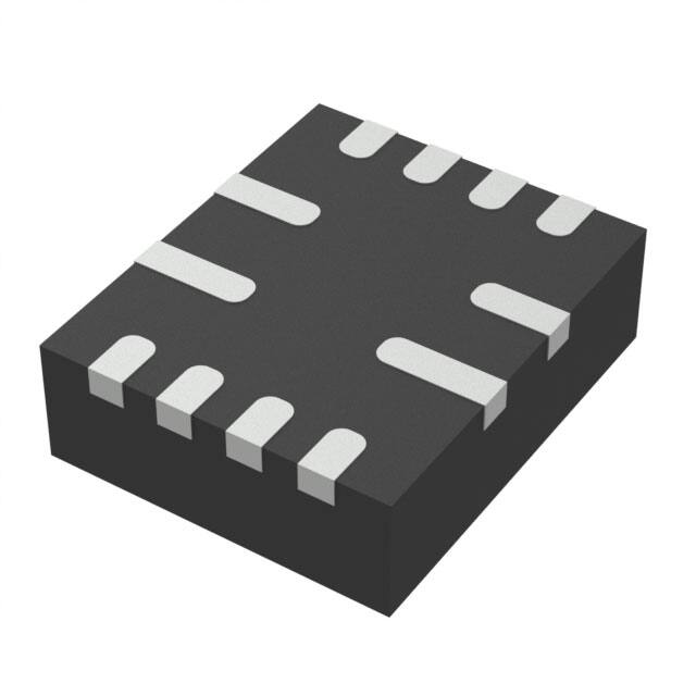

MP4571 High-Efficiency, 1A, 60V, Fully Integrated Synchronous Buck Converter DESCRIPTION FEATURES The MP4571 is a fully integrated, fixedfrequency, synchronous step-down converter. It can achieve up to 1A of continuous output current with peak current control for excellent transient response.          The wide 4.5V to 60V input voltage range accommodates a variety of step-down applications in an automotive input environment. A 2μA shutdown mode quiescent current makes it ideal for battery-powered applications. The MP4571 integrates internal high-side and low-side power MOSFETs for high efficiency without an external Schottky diode, and is available in a 12-pin QFN package. The MP4571 employs advanced asynchronous modulation (AAM), which achieves high efficiency during light load by scaling down the frequency to reduce the switching and gate driver losses. The MP4571 offers standard features including built-in soft start, enable control, and a power good indicator. High duty cycle and low-dropout mode are provided for automotive cold crank conditions. In addition, the chip provides overcurrent protection with valley current detection, which helps prevent current runaway. It also has hiccup short-circuit protection (SCP), input undervoltage lockout (UVLO), and auto-recovery thermal protection. With internal compensation, the MP4571 offers a very compact solution with a minimum number of readily available, standard external components. It is available in a QFN-12 (2.5mmx3mm) package. MP4571 Rev. 1.0 3/9/2020           Wide 4.5V to 60V Operating Input Range 1A Continuous Output Current High-Efficiency Synchronous Mode Control 250mΩ/45mΩ Internal Power MOSFETs Configurable Frequency Up to 2.2MHz 180° Out-of-Phase SYNCO Clock 40μA Quiescent Current Low Shutdown Mode Current: 2μA FB Tolerance: 1% at Room Temp, 2% at Full Temp Selectable AAM or Forced CCM Operation at Light Load Internal 0.45ms Soft Start Remote EN Control Power Good (PG) Indicator Low-Dropout Mode Over-Current Protection (OCP) Short-Circuit Protection with Hiccup Mode VIN Under-Voltage Lockout (UVLO) Thermal Shutdown Available in a QFN-12 (2.5mmx3mm) Package APPLICATIONS     Automotive Infotainment Automotive Lamps and LEDs Automotive Motor Control Industrial Power Systems All MPS parts are lead-free, halogen-free, and adhere to the RoHS directive. For MPS green status, please visit the MPS website under Quality Assurance. “MPS”, the MPS logo, and “Simple, Easy Solutions” are trademarks of Monolithic Power Systems, Inc. or its subsidiaries. www.MonolithicPower.com MPS Proprietary Information. Patent Protected. Unauthorized Photocopy and Duplication Prohibited. © 2020 MPS. All Rights Reserved. 1 MP4571 – 60V, 1A, SYNCHRONOUS STEP-DOWN CONVERTER TYPICAL APPLICATION GND Efficiency vs. Load Current VOUT = 5V, L = 15μH, fSW = 400kHz, AAM BST IN 100 VOUT SW GND MP4571 VCC EN EN FREQ GND FB CCM/SYNCO PG PG VIN=8V VIN=12V VIN=24V VIN=36V Vin=48V VIN=60V 90 80 1.40 1.20 70 1.00 60 0.80 50 0.60 40 0.40 30 0.20 20 1 MP4571 Rev. 1.0 3/9/2020 1.60 10 100 LOAD CURRENT (mA) www.MonolithicPower.com MPS Proprietary Information. Patent Protected. Unauthorized Photocopy and Duplication Prohibited. © 2020 MPS. All Rights Reserved. POWER LOSS (W) 4.5V to 60V EFFICIENCY (%) VIN 0.00 1000 2 MP4571 – 60V, 1A, SYNCHRONOUS STEP-DOWN CONVERTER ORDERING INFORMATION Part Number* Package Top Marking MSL Rating** MP4571GQB QFN-12 (2.5mmx3mm) See Below 1 * For Tape & Reel, add suffix –Z (e.g. MP4571GQB–Z). ** Moisture Sensitivity Level Rating. TOP MARKING BFF: Product code of MP4571GQB Y: Year code WW: Week code LLL: Lot number PACKAGE REFERENCE TOP VIEW EN 12 CCM/ SYNCO NC 11 10 NC 9 BST 1 8 IN SW 2 7 GND 3 4 PG FB 5 6 FREQ VCC QFN-12 (2.5mmx3mm) MP4571 Rev. 1.0 3/9/2020 www.MonolithicPower.com MPS Proprietary Information. Patent Protected. Unauthorized Photocopy and Duplication Prohibited. © 2020 MPS. All Rights Reserved. 3 MP4571 – 60V, 1A, SYNCHRONOUS STEP-DOWN CONVERTER PIN FUNCTIONS Pin # Name 1 BST 2 SW 3 PG 4 FB 5 FREQ 6 VCC 7 GND 8 IN 9, 10 NC 11 CCM/ SYNCO 12 EN MP4571 Rev. 1.0 3/9/2020 Description Bootstrap. Connect a capacitor between SW and BST to form a floating supply across the high-side switch driver. Switch output. SW is the output of the internal power switches. A wide PCB trace is recommended. Power good indicator. The pin is an open drain; it requires a pull-up resistor to the power source. PG is pulled up to the power source if the output voltage is within 90% to 108% of the nominal voltage. It goes low when the output voltage exceeds 116% or falls below 94% of the nominal voltage. Feedback point. FB is the negative input of the error amplifier. Connect FB to the tap of an external resistor divider between the output and GND to set the regulation voltage. In addition, power good and under-voltage lockout circuits use FB to monitor the output voltage. Configurable switching frequency. Connect a resistor to GND to set the switching frequency. Internal bias supply. VCC supplies power to the internal control circuit and gate drivers. A minimum 1µF decoupling capacitor to ground is required close to this pin. IC ground. Connect the pin to larger copper areas to the negative terminals of the input and output capacitors. Input supply. This pin supplies all power to the converter. Place a decoupling capacitor to ground, as close as possible to the IC, to reduce switching spikes. No connection. These pins can be connected to GND to improve thermal and EMI performance in PCB layout. Mode selection/synchronization output. Connect the CCM pin to GND through a 10kΩ to 300kΩ resistor to force the converter into CCM. Float the CCM pin for nonsynchronous AAM mode under light-load conditions. CCM/SYNCO is a synchronization output pin. It outputs a 180° out-of-phase clock to the other devices. Enable. Drive EN high to turn on the device; float or drive it low to turn off the device. www.MonolithicPower.com MPS Proprietary Information. Patent Protected. Unauthorized Photocopy and Duplication Prohibited. © 2020 MPS. All Rights Reserved. 4 MP4571 – 60V, 1A, SYNCHRONOUS STEP-DOWN CONVERTER θJA θJC ABSOLUTE MAXIMUM RATINGS (1) Thermal Resistance VIN……………………………………………… 65V VSW ...................................... -0.3V to VIN + 0.3V VBST .....................................................VSW + 6V All Other Pins ................................ -0.3V to +6V Continuous power dissipation (TA = 25°C) (2) QFN-12 (2.5mmx3mm) ............................ 2.08W Junction temperature .............................. 150°C Lead temperature ................................... 260°C Storage temperature ............... -65°C to +150°C QFN-12 (2.5mmx3mm) JESD51-7 (4).............................60......13....°C/W EVQ4571-QB-00A (5)................45......11....°C/W Electrostatic Discharge (ESD) Rating Human body model (HBM) ....................... ±2kV Charged device model (CDM) ................ ±750V Recommended Operating Conditions Continuous supply voltage (VIN) ...... 4.5V to 60V Output voltage (VOUT) .................. 1V to 0.9 x VIN Load current range ............................. 0A to 1A Operating junction temp (TJ)…………………….. ……………………………….. -40°C to +125°C (3) MP4571 Rev. 1.0 3/9/2020 Notes: 1) Absolute maximum ratings are rated under room temperature unless otherwise noted. Exceeding these ratings may damage the device. 2) The maximum allowable power dissipation is a function of the maximum junction temperature, TJ (MAX), the junction-toambient thermal resistance, θJA, and the ambient temperature TA. The maximum allowable continuous power dissipation at any ambient temperature is calculated by PD (MAX) = (TJ (MAX) - TA) / θJA. Exceeding the maximum allowable power dissipation will cause excessive die temperature, and the module will go into thermal shutdown. Internal thermal shutdown circuitry protects the device from permanent damage. 3) This device is not guaranteed to function outside its operating conditions. 4) Measured on JESD51-7, 4-layer PCB. 5) Measured on MPS standard EVB: 8.9cmx8.9cm, 2oz. copper, 4-layer PCB. www.MonolithicPower.com MPS Proprietary Information. Patent Protected. Unauthorized Photocopy and Duplication Prohibited. © 2020 MPS. All Rights Reserved. 5 MP4571 – 60V, 1A, SYNCHRONOUS STEP-DOWN CONVERTER ELECTRICAL CHARACTERISTICS VIN = 24V, VEN = 2V, TJ = -40°C to +125°C noted. Parameters Input Supply and UVLO Supply current (quiescent) Supply current (shutdown) VIN under-voltage lockout rising threshold VIN under-voltage lockout falling threshold VIN UVLO threshold hysteresis Output and Regulation Regulated FB reference FB input current Switches and Frequency High-side switch on resistance Low-side switch on resistance SW leakage current Switching frequency Symbol MP4571 Rev. 1.0 3/9/2020 Condition Min Typ Max Units No load, VFB = 0.85V, AAM 40 65 μA ISD VEN = 0V 2 5 μA INUVVth-R 3.8 4.0 4.2 V INUVVth-F 3.3 3.5 3.7 V INUVHYS VREF IFB RDSON-H RDSON-L ISW-LKG fSW tPG-DELAY PG leakage current PG rising threshold (VFB / VREF) PG falling threshold (VFB / VREF) Enable (EN) Control EN input rising threshold EN input falling threshold EN threshold hysteresis EN input current EN turn-off delay BST BST-SW UVLO BST-SW UVLO hysteresis Soft Start and VCC Soft-start time VCC regulator , typical values are at TJ = 25°C, unless otherwise IQ Minimum on time (7) tON-MIN Minimum off time (7) tOFF-MIN Power Good (PG) Indicator PG sink current capacity VPG-SINK PG delay time (6) TJ = 25°C TJ = -40°C to +125°C VFB = 0.85V VBST - VSW = 5V, TJ = 25°C VBST - VSW = 5V, TJ = -40°C to +125°C TJ = 25°C TJ = -40°C to +125°C VEN = 0V, VSW = 0V or 60V RFREQ = 76.8kΩ RFREQ = 28kΩ RFREQ = 12.1kΩ 500 mV 0.792 0.800 0.808 0.784 0.816 10 50 V V nA 150 100 30 20 300 750 1800 Sink 4mA Rising edge Falling edge PGFALLING 0.1 400 1000 2200 90 100 350 500 60 90 30 500 1250 2700 300 VFB rising VFB falling VFB falling VFB rising VEN-RISING VEN-FALLING VEN-HYS IEN VEN = 2V tEN-DELAY 45 70 25 10 90 108 84 116 IPG-LKG PGRISING 250 1.38 1.05 1000 ICC = 0mA μA kHz kHz kHz ns ns mV μs μs nA % % % % 1.52 1.19 V V mV μA μs 1.4 2.5 V 5 4.6 mΩ 1.45 1.12 330 0.7 60 tSS VCC mΩ 0.45 4.9 www.MonolithicPower.com MPS Proprietary Information. Patent Protected. Unauthorized Photocopy and Duplication Prohibited. © 2020 MPS. All Rights Reserved. mV 5.2 ms V 6 MP4571 – 60V, 1A, SYNCHRONOUS STEP-DOWN CONVERTER ELECTRICAL CHARACTERISTICS (continued) VIN = 24V, VEN = 2V, TJ = -40°C to +125°C noted. Parameters Protections Peak current limit Valley current limit Zero cross threshold Negative current limit Thermal shutdown (7) Thermal shutdown hysteresis (7) Symbol IPEAK-LIMIT IVALLEY-LIMIT IZCD INEG-LIMIT TSD (6) , typical values are at TJ = 25°C, unless otherwise Condition Min Typ Max Units 20% duty cycle 1.4 1.4 -100 -2 1.95 2.5 140 -1.3 170 +300 -0.8 A A mA A °C AAM FCCM Temperature rising TSD-SYS 25 °C Notes: 6) Not tested in production. Guaranteed by over-temperature correlation. 7) Derived from the bench characterization. Not tested in production. MP4571 Rev. 1.0 3/9/2020 www.MonolithicPower.com MPS Proprietary Information. Patent Protected. Unauthorized Photocopy and Duplication Prohibited. © 2020 MPS. All Rights Reserved. 7 MP4571 – 60V, 1A, SYNCHRONOUS STEP-DOWN CONVERTER TYPICAL CHARACTERISTICS VIN = 24V, TJ = -40°C to +125°C, unless otherwise noted. Quiescent Current vs. Temperature Shutdown Current vs. Temperature 50 2.5 2.4 2.3 ISHUT (μA) IQ (μA) 45 40 2.2 2.1 2.0 35 1.9 30 1.8 -50 -25 0 25 50 75 100 125 -50 -25 TEMPERATURE (oC) VIN UVLO Threshold vs. Temperature 125 0.810 4.0 0.805 3.9 VREF (V) VIN UVLO THRESHOLD (V) 100 Feedback Reference vs. Temperature 4.1 3.8 3.7 Rising Falling 3.6 0.800 0.795 3.5 3.4 0.790 -50 -25 0 25 50 75 TEMPERATURE (°C) 100 125 -50 VCC vs. Temperature -25 0 25 50 75 TEMPERATURE (°C) 100 125 EN Threshold vs. Temperature 4.94 1.5 1.4 VEN (V) 4.92 VCC (V) 0 25 50 75 TEMPERATURE (oC) 4.90 4.88 1.3 Rising Falling 1.2 1.1 4.86 1.0 -50 MP4571 Rev. 1.0 3/9/2020 -25 0 25 50 75 TEMPERATURE (°C) 100 125 -50 -25 0 25 50 75 TEMPERATURE (°C) www.MonolithicPower.com MPS Proprietary Information. Patent Protected. Unauthorized Photocopy and Duplication Prohibited. © 2020 MPS. All Rights Reserved. 100 125 8 MP4571 – 60V, 1A, SYNCHRONOUS STEP-DOWN CONVERTER TYPICAL CHARACTERISTICS (continued) VIN = 24V, TJ = -40°C to +125°C, unless otherwise noted. Zero-Current Detection vs. Temperature Peak Current Limit vs. Temperature 2.10 160 2.05 2.00 140 ILIMIT (A) IZCD (mA) 150 130 120 1.95 1.90 1.85 1.80 110 -50 -25 0 25 50 75 TEMPERATURE (°C) 100 -50 125 -25 0 25 50 75 100 125 100 125 100 125 o TEMPERATURE ( C) Negative Current Limit vs. Temperature Valley Current Limit vs. Temperature 2.10 1.40 ILIMIT-NEGATIVE (A) ILIMIT-VALLEY (A) 2.05 2.00 1.95 1.90 1.35 1.30 1.25 1.85 1.80 1.20 -50 -25 0 25 50 75 TEMPERATURE (°C) 100 125 -50 0 25 50 75 TEMPERATURE (oC) LS-FET On Resistance vs. Temperature 400 70 350 60 RON-LS (mΩ) RON-HS (mΩ) HS-FET On Resistance vs. Temperature -25 300 250 50 40 200 30 -50 MP4571 Rev. 1.0 3/9/2020 -25 0 25 50 75 TEMPERATURE (°C) 100 125 -50 -25 0 25 50 75 TEMPERATURE (°C) www.MonolithicPower.com MPS Proprietary Information. Patent Protected. Unauthorized Photocopy and Duplication Prohibited. © 2020 MPS. All Rights Reserved. 9 MP4571 – 60V, 1A, SYNCHRONOUS STEP-DOWN CONVERTER TYPICAL CHARACTERISTICS (continued) VIN = 24V, TJ = -40°C to +125°C, unless otherwise noted. PG Rising Threshold vs. Temperature PG Falling Threshold vs. Temperature 120 PGVTH (AS PERCENTAGE OF VFB) PGVTH (AS PERCENTAGE OF VFB) 115 115 110 110 105 105 100 100 VFB Falling VFB Rising 95 90 85 -50 MP4571 Rev. 1.0 3/9/2020 -25 0 25 50 75 TEMPERATURE (°C) 100 125 95 VFB Rising VFB Falling 90 85 80 -50 -25 0 25 50 75 TEMPERATURE (°C) www.MonolithicPower.com MPS Proprietary Information. Patent Protected. Unauthorized Photocopy and Duplication Prohibited. © 2020 MPS. All Rights Reserved. 100 125 10 MP4571 – 60V, 1A, SYNCHRONOUS STEP-DOWN CONVERTER TYPICAL PERFORMANCE CHARACTERISTICS VIN = 24V, VOUT = 5V, L = 15µH, fSW = 400kHz, AAM, TA = 25°C, unless otherwise noted. Efficiency vs. Load Current Efficiency vs. Load Current 0.80 50 0.60 40 0.40 30 0.20 1 EFFICIENCY (%) 80 1 10 100 LOAD CURRENT (mA) Efficiency vs. Load Current Efficiency vs. Load Current fSW = 1MHz, L = 10μH, AAM fSW = 1MHz, L = 10μH, CCM VIN=8V VIN=12V VIN=24V VIN=36V Vin=48V VIN=60V 90 0.00 1000 3.20 2.80 2.40 70 2.00 60 1.60 50 1.20 40 0.80 30 0.40 20 1 10 100 LOAD CURRENT (mA) 0.00 1000 100 90 80 70 60 50 40 30 20 10 0 VIN=8V VIN=12V VIN=24V VIN=36V Vin=48V VIN=60V EFFICIENCY (%) 100 10 100 LOAD CURRENT (mA) 1 10 100 LOAD CURRENT (mA) Efficiency vs. Load Current Efficiency vs. Load Current fSW = 2.2MHz, L = 4.7μH, AAM fSW = 2.2MHz, L = 4.7μH, CCM 100 VIN=8V VIN=12V VIN=24V VIN=36V Vin=48V VIN=60V 90 80 3.20 2.80 2.40 70 2.00 60 1.60 50 1.20 40 0.80 30 0.40 20 1 MP4571 Rev. 1.0 3/9/2020 10 100 LOAD CURRENT (mA) 0.00 1000 100 90 80 70 60 50 40 30 20 10 0 VIN=8V VIN=12V VIN=24V VIN=36V Vin=48V VIN=60V 1 10 100 LOAD CURRENT (mA) www.MonolithicPower.com MPS Proprietary Information. Patent Protected. Unauthorized Photocopy and Duplication Prohibited. © 2020 MPS. All Rights Reserved. POWER LOSS (W) 60 1.50 1.35 1.20 1.05 0.90 0.75 0.60 0.45 0.30 0.15 0.00 1000 3.00 2.70 2.40 2.10 1.80 1.50 1.20 0.90 0.60 0.30 0.00 1000 POWER LOSS (W) 1.00 VIN=8V VIN=12V VIN=24V VIN=36V Vin=48V VIN=60V EFFICIENCY (%) 70 20 EFFICIENCY (%) 1.20 100 90 80 70 60 50 40 30 20 10 0 EFFICIENCY (%) 80 1.40 POWER LOSS (W) EFFICIENCY (%) 90 POWER LOSS (W) VIN=8V VIN=12V VIN=24V VIN=36V Vin=48V VIN=60V fSW = 400kHz, L = 15μH, CCM 1.60 POWER LOSS (W) 100 3.00 2.70 2.40 2.10 1.80 1.50 1.20 0.90 0.60 0.30 0.00 1000 POWER LOSS (W) fSW = 400kHz, L = 15μH, AAM 11 MP4571 – 60V, 1A, SYNCHRONOUS STEP-DOWN CONVERTER TYPICAL PERFORMANCE CHARACTERISTICS (continued) VIN = 24V, VOUT = 5V, L = 15µH, fSW = 400kHz, AAM, TA = 25°C, unless otherwise noted. Line Regulation 0.20 0.20 0.15 0.15 LINE REGULATION (%) LOAD REGULATION (%) Load Regulation 0.10 0.05 0.00 Vin=8V Vin=12V Vin=24V Vin=36V Vin=48V Vin=60V -0.05 -0.10 -0.15 -0.20 0.10 0.05 0.00 -0.05 -0.10 Io=0.5A Io=1A -0.15 -0.20 10 100 1000 5 10 15 20 25 30 35 40 45 50 55 60 LOAD CURRENT (mA) VIN (V) Dropout vs. Input Voltage Case Temp Rise vs. Load Current 50 CASE TEMPERATURE RISE (°C) 5.2 5.0 VOUT (V) 4.8 4.6 4.4 Io=0.1A Io=0.5A 4.2 Io=1A 30 20 10 0 4.0 5.0 5.2 5.4 5.6 5.8 VIN (V) 6.0 6.2 0.0 6.4 Switching Frequency vs. RFREQ 2400 2200 2000 1800 1600 1400 1200 1000 800 600 400 200 10 20 30 40 50 60 RFREQ (kΩ) MP4571 Rev. 1.0 3/9/2020 70 80 90 100 0.2 0.4 0.6 IOUT (A) 0.8 1.0 Switching Frequency vs. VIN fSW (kHz) fSW (kHz) Vin=12V Vin=24V Vin=60V 40 2400 2200 2000 1800 1600 1400 1200 1000 800 600 400 200 Rfreq=76.8k Rfreq=12.1k 5 10 15 20 25 30 35 40 45 50 55 60 VIN (V) www.MonolithicPower.com MPS Proprietary Information. Patent Protected. Unauthorized Photocopy and Duplication Prohibited. © 2020 MPS. All Rights Reserved. 12 MP4571 – 60V, 1A, SYNCHRONOUS STEP-DOWN CONVERTER TYPICAL PERFORMANCE CHARACTERISTICS (continued) VIN = 12V, VOUT = 5V, L = 15µH, fSW = 450kHz, AAM, TA = 25°C, unless otherwise noted. (8) CISPR25 Class 5 Average Conducted Emissions CISPR25 Class 5 Peak Conducted Emissions 150kHz to 108MHz 150kHz to 108MHz 75 70 65 60 55 50 45 40 35 30 25 20 15 10 5 0 -5 -10 -15 -20 PEAK CONDUCTED EMI (dBuV) AVERAGE CONDUCTED EMI (dBuV) CISPR25 CLASS 5 LIMITS 75 70 65 60 CISPR25 CLASS 5 LIMITS 55 50 45 40 35 30 25 20 15 10 5 0 -5 -10 -15 NOISE FLOOR -20 0.1 NOISE FLOOR 0.1 1 10 Frequency (MHz) 108 60 55 55 CISPR25 CLASS 5 LIMITS 50 AVERAGE RADIATED EMI (dBuV/m) 50 PEAK RADIATED EMI (dBuV/m) 108 10 150kHz to 30MHz 150kHz to 30MHz 60 45 40 35 30 25 20 15 10 NOISE FLOOR 5 45 40 35 CISPR25 CLASS 5 LIMITS 30 25 20 15 10 5 0 0 -5 -5 -10 1 0.1 Frequency (MHz) 30 NOISE FLOOR -10 Frequency (MHz) 30 CISPR25 Class 5 Average Radiated Emissions Horizontal, 30MHz to 200MHz Horizontal, 30MHz to 200MHz 55 55 HORIZONTAL POLARIZATION 50 1 0.1 CISPR25 Class 5 Peak Radiated Emissions HORIZONTAL POLARIZATION 50 45 AVERAGE RADIATED EMI (dBuV/m) PEAK RADIATED EMI (dBuV/m) Frequency (MHz) CISPR25 Class 5 Average Radiated Emissions CISPR25 Class 5 Peak Radiated Emissions 45 1 CISPR25 CLASS 5 LIMITS 40 35 30 25 20 15 10 NOISE FLOOR 5 40 35 30 25 15 10 5 0 0 -5 30 40 50 CISPR25 CLASS 5 LIMITS 20 60 MP4571 Rev. 1.0 3/9/2020 70 80 90 100 110 120 Frequency (MHz) 130 140 150 160 170 180 190 200 NOISE FLOOR -5 30 40 50 60 70 80 90 100 110 120 Frequency (MHz) 130 140 150 www.MonolithicPower.com MPS Proprietary Information. Patent Protected. Unauthorized Photocopy and Duplication Prohibited. © 2020 MPS. All Rights Reserved. 160 170 180 190 200 13 MP4571 – 60V, 1A, SYNCHRONOUS STEP-DOWN CONVERTER TYPICAL PERFORMANCE CHARACTERISTICS (continued) VIN = 12V, VOUT = 5V, L = 15µH, fSW = 450kHz, AAM, TA = 25°C, unless otherwise noted. CISPR25 Class 5 Average Radiated Emissions CISPR25 Class 5 Peak Radiated Emissions Vertical, 30MHz to 200MHz Vertical, 30MHz to 200MHz 55 55 VERTICAL POLARIZATION 50 45 CISPR25 CLASS 5 LIMITS AVERAGE RADIATED EMI (dBuV/m) PEAK RADIATED EMI (dBuV/m) 45 40 35 30 25 20 15 10 40 35 30 25 15 10 5 0 0 -5 30 40 50 60 70 80 90 100 110 120 Frequency (MHz) 130 140 150 160 170 180 190 30 50 60 70 80 90 100 110 120 Frequency (MHz) 130 140 150 160 170 180 190 200 Horizontal, 200MHz to 1GHz 55 55 HORIZONTAL POLARIZATION 50 40 CISPR25 Class 5 Average Radiated Emissions Horizontal, 200MHz to 1GHz HORIZONTAL POLARIZATION 50 45 AVERAGE RADIATED EMI (dBuV/m) 45 PEAK RADIATED EMI (dBuV/m) NOISE FLOOR -5 200 CISPR25 Class 5 Peak Radiated Emissions CISPR25 CLASS 5 LIMITS 40 35 30 25 20 15 10 NOISE FLOOR 5 40 35 30 25 CISPR25 CLASS 5 LIMITS 20 15 10 5 0 0 -5 200 300 400 500 600 Frequency (MHz) 700 800 900 NOISE FLOOR -5 1000 200 300 400 500 600 Frequency (MHz) 700 800 900 1000 900 1000 CISPR25 Class 5 Average Radiated Emissions CISPR25 Class 5 Peak Radiated Emissions Vertical, 200MHz to 1GHz Vertical, 200MHz to 1GHz 55 55 VERTICAL POLARIZATION 50 VERTICAL POLARIZATION 50 45 AVERAGE RADIATED EMI (dBuV/m) 45 PEAK RADIATED EMI (dBuV/m) CISPR25 CLASS 5 LIMITS 20 NOISE FLOOR 5 VERTICAL POLARIZATION 50 CISPR25 CLASS 5 LIMITS 40 35 30 25 20 15 10 NOISE FLOOR 5 40 35 30 25 CISPR25 CLASS 5 LIMITS 20 15 10 5 0 0 -5 200 300 400 500 600 Frequency (MHz) 700 800 900 1000 NOISE FLOOR -5 200 300 400 500 600 Frequency (MHz) 700 800 Note: 8) The EMC test results are based on the application circuit with EMI filters (see Figure 8) and are tested on the EVQ4571-QB-00A. MP4571 Rev. 1.0 3/9/2020 www.MonolithicPower.com MPS Proprietary Information. Patent Protected. Unauthorized Photocopy and Duplication Prohibited. © 2020 MPS. All Rights Reserved. 14 MP4571 – 60V, 1A, SYNCHRONOUS STEP-DOWN CONVERTER TYPICAL PERFORMANCE CHARACTERISTICS (continued) VIN = 24V, VOUT = 5V, L = 15µH, fSW = 400kHz, TA = 25°C, unless otherwise noted. Start-Up through Input Voltage Start-Up through Input Voltage IOUT = 0A, AAM IOUT = 0A, CCM CH3: VIN 10V/div. CH3: VIN 10V/div. CH2: VOUT 2V/div. CH1: VSW CH2: VOUT 2V/div. CH4: IL 500mA/div. 20V/div. CH4: IL 500mA/div. CH1: VSW 20V/div. 1ms/div. 1ms/div. Start-Up through Input Voltage Shutdown through Input Voltage IOUT = 1A IOUT = 0A, AAM CH3: VIN 10V/div. CH3: VIN 10V/div. CH2: VOUT 2V/div. CH2: VOUT 2V/div. CH1: VSW CH4: IL 1A/div. CH1: VSW 20V/div. 10V/div. CH4: IL 500mA/div. 1ms/div. 20ms/div. Shutdown through Input Voltage Shutdown through Input Voltage IOUT = 0A, CCM IOUT = 1A CH3: VIN 10V/div. CH3: VIN 10V/div. CH2: VOUT 2V/div. CH2: VOUT 2V/div. CH4: IL 500mA/div. CH1: VSW 20V/div. CH4: IL 1A/div. CH1: VSW 20V/div. 10ms/div. MP4571 Rev. 1.0 3/9/2020 10ms/div. www.MonolithicPower.com MPS Proprietary Information. Patent Protected. Unauthorized Photocopy and Duplication Prohibited. © 2020 MPS. All Rights Reserved. 15 MP4571 – 60V, 1A, SYNCHRONOUS STEP-DOWN CONVERTER TYPICAL PERFORMANCE CHARACTERISTICS (continued) VIN = 24V, VOUT = 5V, L = 15µH, fSW = 400kHz, TA = 25°C, unless otherwise noted. Start-Up through EN Start-Up through EN IOUT = 0A, AAM IOUT = 0A, CCM CH3: VEN 2V/div. CH3: VEN 2V/div. CH2: VOUT 2V/div. CH2: VOUT 2V/div. CH1: VSW 20V/div. CH4: IL 500mA/div. CH4: IL 500mA/div. CH1: VSW 20V/div. 1ms/div. 1ms/div. Start-Up through EN Shutdown through EN IOUT = 1A IOUT = 0A, AAM CH3: VEN 2V/div. CH3: VEN 2V/div. CH2: VOUT 2V/div. CH2: VOUT 2V/div. CH1: VSW CH4: IL 1A/div. 10V/div. CH1: VSW 20V/div. CH4: IL 500mA/div. 1ms/div. 1s/div. Shutdown through EN Shutdown through EN IOUT = 0A, CCM IOUT = 1A CH3: VEN 2V/div. CH3: VEN 2V/div. CH2: VOUT 2V/div. CH2: VOUT 2V/div. CH4: IL 500mA/div. CH1: VSW 20V/div. CH4: IL 1A/div. CH1: VSW 20V/div. 200ms/div. MP4571 Rev. 1.0 3/9/2020 100μs/div. www.MonolithicPower.com MPS Proprietary Information. Patent Protected. Unauthorized Photocopy and Duplication Prohibited. © 2020 MPS. All Rights Reserved. 16 MP4571 – 60V, 1A, SYNCHRONOUS STEP-DOWN CONVERTER TYPICAL PERFORMANCE CHARACTERISTICS (continued) VIN = 24V, VOUT = 5V, L = 15µH, fSW = 400kHz, TA = 25°C, unless otherwise noted. Output Ripple Output Ripple IOUT = 0A, AAM IOUT = 0A, CCM CH2: VOUT/AC 10mV/div. CH1: VSW 10V/div. CH2: VOUT/AC 20mV/div. CH1: VSW 10V/div. CH4: IL 500mA/div. CH4: IL 1A/div. 400µs/div. 2µs/div. Output Ripple SCP Entry IOUT = 1A IOUT = 0A, AAM CH2: VOUT 2V/div. CH3: VPG 5V/div. CH1: VSW 10V/div. CH2: VOUT/AC 20mV/div. CH1: VSW 20V/div. CH4: IL 2A/div. CH4: IL 1A/div. 2µs/div. 4ms/div. SCP Entry SCP Entry IOUT = 0A, CCM IOUT = 1A CH2: VOUT 2V/div. CH2: VOUT 2V/div. CH3: VPG 5V/div. CH3: VPG 5V/div. CH4: IL 2A/div. CH4: IL 2A/div. CH1: VSW 20V/div. CH1: VSW 20V/div. 4ms/div. MP4571 Rev. 1.0 3/9/2020 4ms/div. www.MonolithicPower.com MPS Proprietary Information. Patent Protected. Unauthorized Photocopy and Duplication Prohibited. © 2020 MPS. All Rights Reserved. 17 MP4571 – 60V, 1A, SYNCHRONOUS STEP-DOWN CONVERTER TYPICAL PERFORMANCE CHARACTERISTICS (continued) VIN = 24V, VOUT = 5V, L = 15µH, fSW = 400kHz, TA = 25°C, unless otherwise noted. SCP Recovery SCP Recovery IOUT = 0A, AAM IOUT = 0A, CCM CH2: VOUT 2V/div. CH2: VOUT 2V/div. CH3: VPG 5V/div. CH3: VPG 5V/div. CH4: IL 2A/div. CH4: IL 2A/div. CH1: VSW 20V/div. CH1: VSW 20V/div. 4ms/div. 4ms/div. SCP Recovery SCP Steady State IOUT = 1A CH2: VOUT 2V/div. CH2: VOUT 2V/div. CH3: VPG 5V/div. CH3: VPG 5V/div. CH4: IL 2A/div. CH4: IL 2A/div. CH1: VSW 20V/div. CH1: VSW 20V/div. 4ms/div. 4ms/div. Load Transient Cold Crank IOUT = 0A to 1A, AAM VIN = 24V to 4V to 5V, IOUT = 0A CH2: VOUT/AC 200mV/div. CH3: VIN 10V/div. CH1: VSW 10V/div. CH2: VOUT 5V/div. CH4: IOUT 500mA/div. CH4: IL 500mA/div. 100µs/div. MP4571 Rev. 1.0 3/9/2020 40ms/div. www.MonolithicPower.com MPS Proprietary Information. Patent Protected. Unauthorized Photocopy and Duplication Prohibited. © 2020 MPS. All Rights Reserved. 18 MP4571 – 60V, 1A, SYNCHRONOUS STEP-DOWN CONVERTER TYPICAL PERFORMANCE CHARACTERISTICS (continued) VIN = 24V, VOUT = 5V, L = 15µH, fSW = 400kHz, TA = 25°C, unless otherwise noted. VIN Ramp Down and Up Cold Crank VIN = 18V to 4.5V to 0V to 4.5V to 18V, IOUT = 0A VIN = 24V to 4V to 5V, IOUT = 1A CH3: VIN 10V/div. CH1: VSW 10V/div. CH2: VOUT 5V/div. CH3: VIN 5V/div. CH1: VSW 5V/div. CH2: VOUT 5V/div. CH4: IL 1A/div. CH4: IL 2A/div. 40ms/div. 10s/div. VIN Ramp Down and Up Load Dump VIN = 18V to 4.5V to 0V to 4.5V to 18V, IOUT = 1A VIN = 24V to 48V to 24V, IOUT = 1A CH3: VIN 20V/div. CH3: VIN 5V/div. CH1: VSW 5V/div. CH2: VOUT 5V/div. CH1: VSW 20V/div. CH2: VOUT 5V/div. CH4: IL 1A/div. CH4: IL 1A/div. 10s/div. MP4571 Rev. 1.0 3/9/2020 100ms/div. www.MonolithicPower.com MPS Proprietary Information. Patent Protected. Unauthorized Photocopy and Duplication Prohibited. © 2020 MPS. All Rights Reserved. 19 MP4571 – 60V, 1A, SYNCHRONOUS STEP-DOWN CONVERTER FUNCTIONAL BLOCK DIAGRAM IN CSA VCC Internal Regulator UVLO ILIMIT EN Reference Soft Start RSEN VCC BST Reg OCP BST Slope Comp HS Driver COMP VREF Error Amplifier FB 18kΩ 600kΩ 36pF 0.4pF VAAM COMP AAM Control Logic Oscillator CLK PLL CCM/ SYNCO SW VCC LS Driver FREQ 50% of VREF SCP Hiccup IVALLEY PG COMP UV PG REF CSA ZCD RSEN GND Figure 1: Functional Block Diagram MP4571 Rev. 1.0 3/9/2020 www.MonolithicPower.com MPS Proprietary Information. Patent Protected. Unauthorized Photocopy and Duplication Prohibited. © 2020 MPS. All Rights Reserved. 20 MP4571 – 60V, 1A, SYNCHRONOUS STEP-DOWN CONVERTER OPERATION The MP4571 is a fully integrated, synchronous, rectified, step-down, non-isolated switch-mode converter. It offers a wide 4.5V to 60V input supply range, and can achieve up to 1A of continuous output current with excellent load and line regulation across an ambient temperature range of -40°C to +125°C. Figure 1 shows a block diagram of the device. PWM Control At moderate to high output currents, the MP4571 operates in fixed-frequency, peak current control mode to regulate the output voltage. An internal clock initiates a PWM cycle. At the rising edge of the clock, the high-side switch (HSFET) turns on, and the inductor current rises linearly to provide energy to the load. The HSFET remains on until the current reaches the value set by the COMP voltage (VCOMP), which is the output of the internal error amplifier. VCOMP is based on the difference between the output feedback voltage and internal high-precision reference. VCOMP determines how much energy should be transferred to the load. A higher load current creates a higher VCOMP. Once the HS-FET is on, it remains on for at least 90ns. When the HS-FET is off, the low-side switch (LSFET) turns on immediately, and stays on until the next clock starts. During this time, the inductor current flows through the LS-FET. Once the LSFET is on, it remains on for at least 100ns before the next cycle starts. To avoid shoot-through, a dead time is inserted to prevent the HS-FET and LS-FET from turning on simultaneously. If the current in the HS-FET does not reach the COMP set current value within one PWM period, the HS-FET remains on, saving a turn-off operation. Light-Load Operation The MP4571 features configurable forced continuous conduction mode (FCCM) and lightload asynchronous advanced mode (AAM), which can be set by the CCM/SYNCO pin. FCCM maintains a constant switching frequency and smaller output ripple. However, FCCM has low efficiency during light-load conditions, while AAM achieves high efficiency (see Figure 2). MP4571 Rev. 1.0 3/9/2020 To force the device into FCCM, connect the CCM/SYNCO pin to GND using a 10kΩ to 300kΩ resistor. In FCCM, the converter works with a fixed frequency across a no-load to full-load range. Float the CCM/SYNCO pin to force the device into AAM under light-load conditions. The device cannot change modes while it is operating, so the mode must be selected before start-up. Inductor Current Load Decreased Inductor Current AAM FCCM t t Load t Decreased t t t Figure 2: AAM and FCCM When AAM is enabled, the switching frequency is scaled down according to VCOMP during light-load conditions. The MP4571 first enters nonsynchronous operation while the inductor current approaches zero at light-load. If the load further decreases or is at no-load, VCOMP drops below the internally set AAM value (VAAM). The MP4571 then enters sleep mode and consumes a low quiescent current to improve light-load efficiency. In sleep mode, the internal clock is blocked, so the MP4571 skips some pulses. VFB is below VREF, so VCOMP ramps up until it exceeds VAAM. Then the internal clock is reset, and the crossover time is used as the benchmark for the next clock. This control scheme helps the device achieve high efficiency by scaling down the frequency to reduce switching and gate driver losses. As the output current increases from light load, both VCOMP and the switching frequency rise. If the output current exceeds the critical level set by VCOMP, the MP4571 enters discontinuous conduction operation (DCM) or CCM, which has a constant switching frequency. Enable (EN) Control The MP4571 can be enabled or disabled via a remote EN signal that is referenced to ground. The remote EN control operates with a positive logic www.MonolithicPower.com MPS Proprietary Information. Patent Protected. Unauthorized Photocopy and Duplication Prohibited. © 2020 MPS. All Rights Reserved. 21 MP4571 – 60V, 1A, SYNCHRONOUS STEP-DOWN CONVERTER that is compatible with popular logic devices. Positive logic indicates that when the input voltage exceeds the under-voltage lockout (UVLO) threshold (about 4.0V), the converter is enabled by pulling the EN pin above 1.45V. Drive the EN pin below 1.12V to disable the MP4571. An internal resistor (REN) from EN to GND allows EN to be floated to shut down the chip (REN = 2.8MΩ when EN is on; REN = 1.8MΩ when EN is off). SYNCO The MP4571 has a SYNCO pin. During start-up, SYNCO stays low and quickly outputs a 180° phase-shift clock to the internal oscillator once soft start is ready. Note that the falling edge of SYNCO is a 180° phase-shift to the rising edge of the internal oscillator. This function allows two devices to operate in the same frequency, but 180° out of phase, which reduces the total input current ripple. This allows a smaller input bypass capacitor to be used. Internal Regulator A 4.9V internal regulator powers most of the internal circuitries. This regulator takes VIN and operates in the full VIN range. When VIN exceeds 4.9V, the output of the regulator is in full regulation. Lower VIN values result in lower output voltages. The regulator is enabled when VIN exceeds its under-voltage lockout (UVLO) threshold and EN is high. In EN shutdown mode, the internal VCC regulator is disabled to reduce power dissipation. the duration of the switch-off time of the HS-FET, which results in an automatic reduction of fSW. Compliance with the minimum on time of the HSFET is guaranteed. An advantage of this method is that the device works at the desired fSW as long as possible, and a correction is only made at high VIN. For the Switching Frequency vs. VIN curve, see the Typical Performance Characteristics section on page 12, where RFREQ equals 12.1kΩ. Internal Soft Start (SS) To avoid overshoot during start-up, the MP4571 has built-in soft start (SS) that ramps up the output voltage at a controlled slew rate when the EN pin goes high. When the SS voltage (VSS) is below the internal reference (VREF), VSS overrides VREF as the error amplifier reference. When VSS exceeds VREF, VREF acts as the reference. At this point, soft start finishes and the MP4571 enters steady-state. The SS time is internally set to 0.45ms. When the output voltage is shorted to GND, the feedback voltage is pulled low and VSS is discharged. The part initiates soft start again when it returns to a normal state. Pre-Biased Start-Up If VFB exceeds VSS during start-up, that means the output has a pre-biased voltage. Neither the HS-FET nor LS-FET turns on until VSS exceeds VFB. Note that the pre-biased capability is only available when the device is set to AAM. The calculated resistance may need fine-tuning with a bench test. Power Good (PG) Indicator The MP4571 has power good (PG) indication. The PG pin is the open drain of a MOSFET. It should be connected to a voltage source through a resistor (e.g. 100kΩ). In the presence of an input voltage, the MOSFET turns on so that the PG pin is pulled to GND before soft start is ready. PG goes high if the output voltage is between 90% and 108% of the nominal voltage after a 70μs delay. PG goes low when the output voltage is above 116% or below 94% of the nominal voltage after a 25μs delay. It is not possible to use a high fSW with a high VIN, since the minimum on time required for the HSFET is limited. The MP4571 control loop automatically sets the maximum possible fSW up to the set frequency, which also reduces excessive power loss in the IC. VOUT is regulated by varying Under-Voltage Lockout Protection (UVLO) The MP4571 has input under-voltage lockout protection (UVLO) to ensure reliable output power. Assuming EN is active, the MP4571 is powered on when the input voltage exceeds the UVLO rising threshold. The device is powered off Frequency Programmable and Foldback The oscillating frequency (fSW) of the MP4571 is configured by an external frequency resistor. The frequency resistor should be located between FREQ pin and GND, as close as possible to the device. Select a proper RFREQ, calculated with Equation (1): RFREQ (MΩ)  MP4571 Rev. 1.0 3/9/2020 30 fSW(kHz) (1) www.MonolithicPower.com MPS Proprietary Information. Patent Protected. Unauthorized Photocopy and Duplication Prohibited. © 2020 MPS. All Rights Reserved. 22 MP4571 – 60V, 1A, SYNCHRONOUS STEP-DOWN CONVERTER when input voltage drops below the UVLO falling threshold. This function prevents the device from operating at an insufficient voltage. It is a nonlatch protection. device resumes operation by initiating a soft start. Over-Current Protection (OCP) The MP4571 has a 1.95A peak current limit. Once the inductor current reaches the current limit, the HS-FET turns off immediately. Then the LS-FET turns on to discharge the energy, and the inductor current decreases. The HS-FET does not turn on again until the inductor current drops below the current threshold (the valley current limit). This protection prevents the inductor current from running away and damaging the components. Short-Circuit Protection (SCP) When a short-circuit condition occurs, the MP4571 immediately reaches its current limit. Meanwhile, the output voltage drops until VFB falls below 50% of VREF. The device considers this an output dead short, and triggers hiccup short-circuit protection (SCP) mode to periodically restart the part. In hiccup mode, the MP4571 disables its output power stage, slowly discharges the soft-start capacitor, then initiates a soft start. If the shortcircuit condition remains after soft start ends, the device repeats this operation until the short circuit disappears and the output returns to the regulation level. This protection mode greatly reduces the average short-circuit current to alleviate thermal issues and protect the regulator. Negative Current Protection The MP4571 has a -1.3A negative current limit. Once the inductor current reaches the current limit, the LS-FET immediately turns off and the HS-FET turns on. The current limit prevents the negative current from dropping too low and damaging the components. Thermal Shutdown For thermal protection, the MP4571 monitors the IC temperature internally. This function prevents the chip from operating at exceedingly high temperatures. If the junction temperature exceeds the threshold value (about 170°C), it shuts down the whole chip. This is a non-latch protection. There is a 25°C hysteresis. Once the junction temperature drops to about 145°C, the MP4571 Rev. 1.0 3/9/2020 www.MonolithicPower.com MPS Proprietary Information. Patent Protected. Unauthorized Photocopy and Duplication Prohibited. © 2020 MPS. All Rights Reserved. 23 MP4571 – 60V, 1A, SYNCHRONOUS STEP-DOWN CONVERTER Floating Driver and Bootstrap Charging An external bootstrap capacitor powers the floating HS-FET driver. There are two methods to charge the bootstrap capacitor (see Figure 3). The first method is through the main charging circuit from VCC through a diode. When the HSFET is on, VSW is about equal to VIN but exceeds VCC, and the bootstrap capacitor is not charged. The best charging period occurs when the LSFET is on, and VCC - VSW is at its largest. When there is no current in the inductor, VSW equals VOUT, so VCC can only charge BST when VOUT is very small. The second method is through the auxiliary charging circuit from VIN. When the voltage difference between BST and SW is below the internal 5V bootstrap regulator, a PMOS pass transistor (M1) turns on to charge the bootstrap capacitor. The charging current is much smaller than that from VCC, but as long as VIN exceeds VSW, BST can be charged. This function is useful in sleep mode, when there is not always a switch. Figure 3: Internal Bootstrap Charging Circuit Low-Dropout Operation (BST Refresh) To improve dropout, the MP4571 is designed to operate at close to 100% duty cycle as long as the BST-to-SW voltage exceeds 1.4V. When the BST-to-SW voltage drops below 1.34V, the HSFET turns off using a UVLO circuit, which allows the LS-FET to conduct and refresh the charge on the BST capacitor. When the input voltage drops, the HS-FET remains on and close to 100% duty cycle to maintain output regulation until the BSTto-SW voltage falls below 1.34V. Since the supply current sourced from the BST capacitor is low, the HS-FET can remain on for more switching cycles than are required to refresh the capacitor. The means the effective duty cycle of the switching regulator is high. MP4571 Rev. 1.0 3/9/2020 www.MonolithicPower.com MPS Proprietary Information. Patent Protected. Unauthorized Photocopy and Duplication Prohibited. © 2020 MPS. All Rights Reserved. 24 MP4571 – 60V, 1A, SYNCHRONOUS STEP-DOWN CONVERTER The effective duty cycle during regulator dropout is mostly influenced by the voltage drops across the power MOSFET, inductor resistance, lowside diode, and PCB resistance. Start-Up and Shutdown If both VIN and VEN exceed their respective thresholds, the chip starts. The reference block starts first, generating a stable reference voltage and current, and then the internal regulator is enabled. The regulator provides a stable supply for the remaining circuitries. Three events can shut down the chip: EN going low, VIN UVLO, and thermal shutdown. In the shutdown procedure, the signaling path is blocked first to avoid any fault triggering. The COMP voltage and the internal supply rail are then pulled down. The floating driver is not subject to this shutdown command, but its charging path is disabled. While the internal supply rail is up, an internal timer holds the power MOSFET off for about 50µs to blank the start-up glitches. When the soft-start block is enabled, it first holds its SS output low to ensure the circuitries are ready, then slowly ramps up. MP4571 Rev. 1.0 3/9/2020 www.MonolithicPower.com MPS Proprietary Information. Patent Protected. Unauthorized Photocopy and Duplication Prohibited. © 2020 MPS. All Rights Reserved. 25 MP4571 – 60V, 1A, SYNCHRONOUS STEP-DOWN CONVERTER APPLICATION INFORMATION Setting the Output Voltage The external resistor divider connected to the FB pin sets the output voltage (see the Typical Application Circuits on page 29). The feedback resistor (R1) must account for both stability and dynamic response, so it cannot be too large or too small. Choose an R1 value of about 40kΩ. R2 is then estimated with Equation (2): R2  Figure 4 shows feedback network. R1 VOUT 1 0.8 the (2) recommended R3 T-type VOUT V  (1  OUT ) fSW  IL VIN (3) Where ΔIL is the peak-to-peak inductor ripple current. Choose an inductor that will not saturate under the maximum inductor peak current. Calculate the peak inductor current with Equation (4): R1 VOUT ILP  IOUT  R2 Figure 4: Feedback Network R3 + R1 is used to set the loop bandwidth. A higher R3 + R1 indicates a lower bandwidth. To ensure loop stability, it is strongly recommended to limit the bandwidth between 1/10 of the switching frequency and 100kHz. The calculated resistance may need fine-tuning via bench testing. Table 1 lists the recommended feedback divider resistor values for common output voltages. Use check loop analysis before using the device in an application, and change the resistance of R3 for loop stability if necessary. Table 1: Resistor Values for Typical VOUT VOUT (V) R1 (kΩ) R2 (kΩ) 3.3 5.0 41.2 41.2 13 7.68 Selecting the Inductor The inductor must supply constant current to the output load while being driven by the switching input voltage. For the highest efficiency, choose an inductor with a low DC resistance. High inductance will result in less ripple current and lower output ripple voltage. However, a larger MP4571 Rev. 1.0 3/9/2020 A good rule to determine the ideal inductance value is to make the inductor ripple current about 30% of the maximum load current. Ensure that the peak inductor current is below the device peak current limit. The inductance value can be calculated with Equation (3): L MP4571 FB 5 inductance value results in a physically larger inductor, higher series resistance, and lower saturation current. VOUT V  (1  OUT ) 2fSW  L VIN (4) Selecting the Input Capacitor The step-down converter has a discontinuous input current, and requires a capacitor to supply the AC current to the converter while maintaining the DC input voltage. Use low-ESR capacitors for the best performance. Ceramic capacitors with X5R or X7R dielectrics are strongly recommended because of their low ESR and small temperature coefficients. Other capacitors, such as Y5V and Z5U, should not be used since they lose too much capacitance with frequency, temperature, and bias voltage. Place the input capacitors as close to the IN pin as possible. For most applications, a 22µF capacitor is sufficient. For higher output voltages, use a 47μF capacitor to improve system stability. To maintain a small solution size, choose a properly sized capacitor that has a voltage rating compliant with the input spec. Since the input capacitor absorbs the input switching current, it requires an adequate ripple current rating that should exceed the converter’s maximum input ripple current. The input ripple current can be estimated with Equation (5): ICIN  IOUT  VOUT V  (1  OUT ) VIN VIN www.MonolithicPower.com MPS Proprietary Information. Patent Protected. Unauthorized Photocopy and Duplication Prohibited. © 2020 MPS. All Rights Reserved. (5) 26 MP4571 – 60V, 1A, SYNCHRONOUS STEP-DOWN CONVERTER The worst-case condition occurs at VIN = 2VOUT, calculated with Equation (6): ICIN  IOUT 2 (6) For simplification, choose an input capacitor with an RMS current rating greater than half of the maximum load current. The input capacitor can be electrolytic, tantalum, or ceramic. When using electrolytic or tantalum capacitors, use a small, high-quality ceramic capacitor (0.1μF), placed as close to the IC as possible. The input capacitance value determines the input voltage ripple of the converter. If there is an input voltage ripple requirement in the system design, choose an input capacitor that meets the specification. The input voltage ripple caused by the capacitance can be estimated with Equation (7): VIN  IOUT V V  OUT  (1  OUT ) fSW  CIN VIN VIN (7) The worst-case condition occurs at VIN = 2VOUT, estimated with Equation (8): VIN  I 1  OUT 4 fSW  CIN (8) Selecting the Output Capacitor The output capacitor maintains the output DC voltage. Ceramic capacitors with low ESR are recommended for their small size and low output voltage ripple. Electrolytic and polymer capacitors may also be used. The output voltage ripple can be estimated with Equation (9): VOUT  VOUT V 1  (1  OUT )  (RESR  ) (9) fSW  L VIN 8fSW  COUT Where RESR is the equivalent series resistance of the output capacitor. For tantalum or electrolytic capacitors, the ESR dominates the impedance at the switching frequency. For simplification, the output ripple can be calculated with Equation (11): VOUT  VOUT V  (1  OUT )  RESR fSW  L VIN (11) Another consideration for the output capacitance is the allowable overshoot in VOUT if the load is suddenly removed. In this case, energy stored in the inductor is transferred to COUT, causing its voltage to rise. To achieve a desired overshoot relative to the regulated voltage, the output capacitance can be estimated with Equation (12): COUT  IOUT 2  L (12) VOUT 2  ((VOUTMAX / VOUT )2  1) Where VOUTMAX / VOUT is the allowable maximum overshoot. After calculating the capacitance required for both the ripple and overshoot, choose the larger value. The characteristics of the output capacitor also affect the stability of the regulation system. The MP4571 can be optimized for a wide range of capacitance and ESR values. VIN Under-Voltage Lockout (UVLO) Setting The MP4571 has an internal, fixed under-voltage lockout (UVLO) threshold. The rising threshold is 4.0V, while the falling threshold is about 3.5V. For applications that require a higher UVLO point, place an external resistor divider between EN and IN to obtain a higher equivalent UVLO threshold (see Figure 5 and Figure 6). Add a 6V Zener diode between EN to GND if the EN pin is connected to VIN through a resistor. 8 VIN IN R4 For ceramic capacitors, the capacitance dominates the impedance at the switching frequency and causes most of the output voltage ripple. For simplification, the output voltage ripple can be calculated with Equation (10): VOUT  MP4571 Rev. 1.0 3/9/2020 VOUT V  (1  OUT ) (10) 8  fSW  L  COUT VIN 2 12 Zener 6V R5 EN 1.8MΩ Figure 5: Adjustable UVLO Using EN Divider when EN Rises www.MonolithicPower.com MPS Proprietary Information. Patent Protected. Unauthorized Photocopy and Duplication Prohibited. © 2020 MPS. All Rights Reserved. 27 MP4571 – 60V, 1A, SYNCHRONOUS STEP-DOWN CONVERTER 8 VIN IN R4 12 Zener R5 6V EN 2.8MΩ Figure 6: Adjustable UVLO Using EN Divider when EN Falls The UVLO threshold can be calculated with Equation (13) and Equation (14) when EN is rising or falling, respectively: INUVRISING  (1  R4 )  VEN_RISING 1.8M//R5 INUVFALLING  (1  R4 )  VEN_FALLING 2.8M//R5 BST Resistor and Capacitor A resistor in series with the BST capacitor (RBST) can reduce the SW rising rate and voltage spikes. This enhances EMI performance and reduces voltage stress at a high VIN. A higher resistance is better for SW spike reduction, but compromises efficiency. To make a tradeoff between EMI and efficiency, it is recommended to keep RBST below 20Ω. It is also recommended for the BST capacitor to be between 0.1µF and 1μF. (13) (14) Where VEN_RISING = 1.45V, VEN_FALLING = 1.12V. When choosing R4, ensure it is big enough to limit the current flowing into EN pin below 100µA. MP4571 Rev. 1.0 3/9/2020 www.MonolithicPower.com MPS Proprietary Information. Patent Protected. Unauthorized Photocopy and Duplication Prohibited. © 2020 MPS. All Rights Reserved. 28 MP4571 – 60V, 1A, SYNCHRONOUS STEP-DOWN CONVERTER PCB Layout Guidelines (9) An optimized PCB layout is critical for proper operation. A 4-layer layout is strongly recommended to improve thermal performance. For the best results, refer to Figure 7 and follow the guidelines below: 1. Place high-current paths (GND, IN, and SW) very close to the device with short, direct, and wide traces. 2. Use large copper areas to minimize conduction loss and thermal stress. Top Layer and Top Silk 3. Place the ceramic input capacitors as close to the IN and GND pins as possible to minimize high frequency noise. 4. Place the T-type feedback resistors as close as possible to the FB pin to ensure the trace connecting to the FB pin is as short as possible. 5. Route SW and BST away from sensitive analog areas, such as FB. 6. Use multiple vias to connect the power planes to the internal layer. Inner Layer 1 Note: 9) The recommended PCB layout is based on the circuit in Figure 8. Inner Layer 2 Bottom Layer and Bottom Silk Figure 7: Recommended PCB Layout MP4571 Rev. 1.0 3/9/2020 www.MonolithicPower.com MPS Proprietary Information. Patent Protected. Unauthorized Photocopy and Duplication Prohibited. © 2020 MPS. All Rights Reserved. 29 MP4571 – 60V, 1A, SYNCHRONOUS STEP-DOWN CONVERTER TYPICAL APPLICATION CIRCUITS C4 0.1µF CIN9 22µF GND C1A C1B C1C BST VEMI L3 15µH 1 U1 8 IN C1D SW VOUT R1 100kΩ 10µF 10µF 0.1µF 0.1µF 1210 1210 0603 0603 12 EN D1 3 PG PG C2B 22µF GND R5 7.68kΩ MP4571 BZT52C6V2 C2A 22µF R4 41.2kΩ R6 20kΩ 4 FB EN 5V/1A 2 5 FREQ R11 76.8kΩ R9 100kΩ 6 VCC 11 CCM/SYNCO R10 100kΩ 7 GND C3 1µF CCM/SYNCO JP1 1 2 Figure 8: Typical Application Circuit L1 240nH DFE201612E-R24M 5V to 60V L2 4.7µH FDSD0402-H-4R7M VIN VEMI CIN1 CIN2 CIN3 CIN4 CIN5 CIN6 1nF 10nF 1nF 10nF 1µF 1µF GND 0603 0603 0603 0603 0805 CIN7 CIN8 10µF 10µF 0805 1210 CIN9 22µF C1A C1B C1C C1D 10µF 10µF 0.1µF 0.1µF 1210 1210 1210 0603 0603 C4 0.1µF 8 R23 10Ω/0603 IN 1 L3 15µH BST U1 VIN SW R1 100kΩ C12 0.1µF/100V 12 EN D1 4 3 PG FREQ R11 76.8kΩ CCM/ SYNCO VCC VOUT C2C 1nF C2D 10nF C2E 1nF C2F 10nF GND 11 VOUT CCM/SYNCO R10 100kΩ C10 R20 0.1µF 10Ω C11 R21 7 GND 6 C2B 22µF 5 R9 100kΩ C3 1µ F R4 41.2kΩ R6 20kΩ C2A 22µF R5 7.68kΩ MP4571 BZT52C6V2 PG FB EN 5V/1A VOUT 2 JP1 1 0.1µF 10Ω 2 Figure 9: Typical Application Circuit with EMI Filters MP4571 Rev. 1.0 3/9/2020 www.MonolithicPower.com MPS Proprietary Information. Patent Protected. Unauthorized Photocopy and Duplication Prohibited. © 2020 MPS. All Rights Reserved. 30 MP4571 – 60V, 1A, SYNCHRONOUS STEP-DOWN CONVERTER PACKAGE INFORMATION QFN-12 (2.5mmX3mm) QFN-12 (2.5mmx3mm) PIN 1 ID MARKING PIN 1 ID INDEX AREA TOP VIEW BOTTOM VIEW SIDE VIEW NOTE: 1) LAND PATTERNS OF PINS 2, 7, AND 8 HAVE THE SAME LENGTH AND WIDTH. 2) ALL DIMENSIONS ARE IN MILLIMETERS. 3) LEAD COPLANARITY SHALL BE 0.10 MILLIMETERS MAX. 4) JEDEC REFERENCE IS MO-220. 5) DRAWING IS NOT TO SCALE. RECOMMENDED LAND PATTERN MP4571 Rev. 1.0 3/9/2020 www.MonolithicPower.com MPS Proprietary Information. Patent Protected. Unauthorized Photocopy and Duplication Prohibited. © 2020 MPS. All Rights Reserved. 31 MP4571 – 60V, 1A, SYNCHRONOUS STEP-DOWN CONVERTER CARRIER INFORMATION Part Number Package Description Quantity/ Reel Reel/ Diameter Carrier Tape Width Carrier Tape Pitch MP4571GQB–Z QFN-12 (2.5mmx3mm) 5000 13in 12mm 8mm Notice: The information in this document is subject to change without notice. Please contact MPS for current specifications. Users should warrant and guarantee that third-party Intellectual Property rights are not infringed upon when integrating MPS products into any application. MPS will not assume any legal responsibility for any said applications. MP4571 Rev. 1.0 3/9/2020 www.MonolithicPower.com MPS Proprietary Information. Patent Protected. Unauthorized Photocopy and Duplication Prohibited. © 2020 MPS. All Rights Reserved. 32
