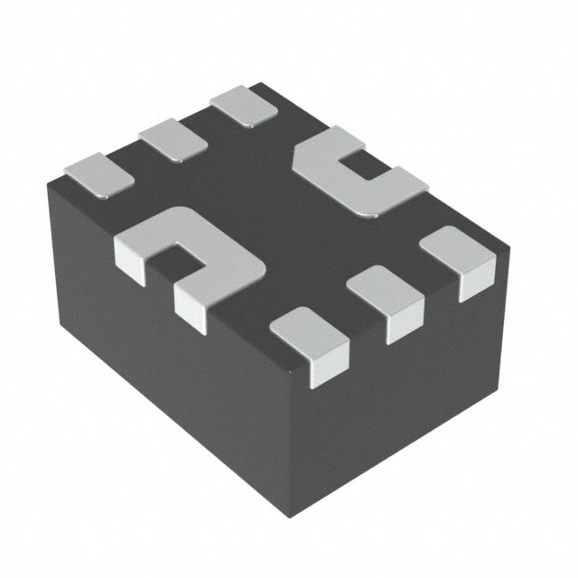

MP5016 The Future of Analog IC Technology 2.7 - 15V, 0.7 - 5A, Current Limit Switch with Over-Voltage Clamp and Reverse Blocking DESCRIPTION FEATURES The MP5016 is a protection device designed to protect circuitry on the output from transients on the input. The MP5016 also protects the input from undesired shorts and transients coming from the output.   During start-up, the inrush current is limited by limiting the slew rate at the output. The slew rate is controlled by the DV/DT pin setting and MODE pin setting. The maximum load at the output is currentlimited. The magnitude of the current limit is controlled by an external resistor from ILIMIT to GND. There is a fixed 2.5A current limit when ILIMIT is floating.         Wide 2.7V to 15V Operating Input Range 26V Absolute Maximum Transient Input Voltage Selectable Over-Voltage Clamp Threshold Fast Output Over-Voltage Protection (OVP) Response Integrated 43mΩ Power MOSFET Adjustable Current Limit or Fixed Current Limit when Floating ILIMIT Reverse-Blocking MOSFET Driver Soft-Start Time Programmable through DV/DT and MODE Fast Response for Hard Short Protection Over-Current Protection (OCP) Hiccup Protection Thermal Shutdown and Auto-Retry Available in a QFN-10 (1.5mmx2mm) Package The output voltage is limited by the output overvoltage protection (OVP) function. The clamp voltage can be set by the MODE connection.   The MP5016 offers a GATE drive signal connected to an external N-channel MOSFET gate to block current flowing from the output to the input when the IC is in enable off, power shutdown, or thermal shutdown. APPLICATIONS The MP5016 is available (1.5mmx2mm) package. in a QFN-10        HDD, SSD Hot Swaps Wireless Modem Data Cards PC Cards USB Power Distribution USB Protection USB3.1 Power Delivery All MPS parts are lead-free, halogen-free, and adhere to the RoHS directive. For MPS green status, please visit the MPS website under Quality Assurance. “MPS” and “The Future of Analog IC Technology” are Registered Trademarks of Monolithic Power Systems, Inc. TYPICAL APPLICATION MP5016 Rev.1.1 6/14/2019 www.MonolithicPower.com MPS Proprietary Information. Patent Protected. Unauthorized Photocopy and Duplication Prohibited. © 2019 MPS. All Rights Reserved. 1 MP5016 – 2.7 - 15V, 0.7 - 5A, PROGRAMMABLE, CURRENT-LIMITED SWITCH ORDERING INFORMATION Part Number* MP5016GQH Package QFN-10 (1.5mmx2mm) Top Marking See Below * For Tape & Reel, add suffix –Z (e.g.MP5016GQH-Z) TOP MARKING EK: Product code of MP5016GQH LL: Lot number PACKAGE REFERENCE TOP VIEW QFN-10 (1.5mmx2mm) MP5016 Rev.1.1 6/14/2019 www.MonolithicPower.com MPS Proprietary Information. Patent Protected. Unauthorized Photocopy and Duplication Prohibited. © 2019 MPS. All Rights Reserved. 2 MP5016 – 2.7 - 15V, 0.7 - 5A, PROGRAMMABLE, CURRENT-LIMITED SWITCH ABSOLUTE MAXIMUM RATINGS (1) VCC, SOURCE ............................... -0.3V to 26V MODE.............................................. -0.3V to 26V GATE......................................... SOURCE+ 5.5V All other pins ................................ -0.3V to +5.5V Junction temperature ................-40°C to +150°C Lead temperature...................................... 260°C Continuous power dissipation (TA = +25°C) (2) (4) QFN-10 (1.5mmx2mm) ............................. 2.23W Recommended Operating Conditions (3) Supply voltage (VCC) ...................... 2.7V to 15V Output voltage (SOURCE)............... 2.7V to 15V Operating junction temp. (TJ) ....-40°C to +125°C MP5016 Rev.1.1 6/14/2019 Thermal Resistance θJA θJC QFN-10 (1.5mmx2mm) EV5016H-QH-00A (4) ............. 56 ...... 18 ... °C/W JESD51-7 (5) ......................... 130 ..... 25 ... °C/W NOTES: 1) Exceeding these ratings may damage the device. 2) The maximum allowable power dissipation is a function of the maximum junction temperature TJ (MAX), the junction-toambient thermal resistance θJA, and the ambient temperature TA. The maximum allowable continuous power dissipation at any ambient temperature is calculated by PD (MAX) = (TJ (MAX)-TA)/θJA. Exceeding the maximum allowable power dissipation produces the excessive die temperature, causing the regulator to go into thermal shutdown. Internal thermal shutdown circuitry protects the device from permanent damage. 3) The device is not guaranteed to function outside of its operating conditions. 4) Measured on EV5016-QH-00A, 2-layer PCB, 50mmx50mm. 5) Measured on JESD51-7, 4-layer PCB. www.MonolithicPower.com MPS Proprietary Information. Patent Protected. Unauthorized Photocopy and Duplication Prohibited. © 2019 MPS. All Rights Reserved. 3 MP5016 – 2.7 - 15V, 0.7 - 5A, PROGRAMMABLE, CURRENT-LIMITED SWITCH ELECTRICAL CHARACTERISTICS VCC = 5V, RLIMIT = NS, COUT = 10µF, TJ = -40°C + 125°C unless otherwise noted. Parameter Symbol (6) , typical value is tested at TJ = +25°C Condition Min Typ Max Units Supply Current Supply current (quiescent) IQ EN = high, MODE = VCC/GND/float EN = high, MODE connect resistor to GND EN = GND Supply current (shutdown) IS Power MOSFET On resistance RDSon IOUT = 1A Turn-on delay Tdelay DV/DT float, MODE float Off-state leakage current IOFF VIN = 12V, EN = 0V Under-/Over-Voltage Protection (UVP, OVP) Under-voltage lockout rising VUVLO threshold UVLO hysteresis VUVLOHYS VMODE = GND, TJ = 25°C VMODE = VCC, TJ = 25°C Output over-voltage clamp RMODE = 76.8kΩ, VCC = 5V, VCLAMP voltage TJ = 25°C RMODE = 115kΩ, TJ = 25°C RMODE = 324kΩ, TJ = 25°C DV/DT DV/DT float, VMODE = GND DV/DT slew rate dv/dt DV/DT float, VMODE = VCC DV/DT float, MODE float DV/DT current IDV/DT VDV/DT = 0.5V Current Limit Float ILIMIT, TJ = 25°C Current limit at normal ILimit_NO RLIMIT = 604Ω, TJ = 25°C operation RLIMIT = 3kΩ, TJ = 25°C Enable (EN) Enable rising threshold VEN_RISING Enable hysteresis VEN_HYS Enable pull-down resistor REN_DOWN GATE GATE maximum source IG_SOURCE_MAX IOUT = 1A current VCC = VSOURCE = 5V, GATE maximum sink IG_SINK_MAX current VGATE = 10.5V Output Discharge Discharge resistance RDIS VCC = 5V MP5016 Rev.1.1 6/14/2019 50 μA 90 μA 9 μA 43 500 0.1 1 mΩ μs μA 2.38 2.53 2.68 V 5.5 14.2 200 5.75 15.2 6 16.2 mV V V 3.71 3.95 4.19 V 5.3 14.2 5.7 15.5 6.1 16.7 V V 0.4 1.3 2.8 4.5 0.8 2 3.8 6.5 1.2 2.7 4.8 8.5 2.3 3.3 0.6 2.5 3.5 0.75 2.7 3.7 0.9 A A A 1.86 2 350 2.2 2.16 V mV MΩ 7 12 μA 1.3 mA 540 Ω www.MonolithicPower.com MPS Proprietary Information. Patent Protected. Unauthorized Photocopy and Duplication Prohibited. © 2019 MPS. All Rights Reserved. V/ms μA 4 MP5016 – 2.7 - 15V, 0.7 - 5A, PROGRAMMABLE, CURRENT-LIMITED SWITCH ELECTRICAL CHARACTERISTICS (continued) VCC = 5V, RLIMIT = NS, COUT = 10µF, TJ = -40°C + 125°C unless otherwise noted. Parameter Symbol OTP Thermal shutdown (7) Thermal hysteresis (7) Condition TSD TSD_HYS (6) , typical value is tested at TJ = +25°C Min Typ 175 50 Max Units °C °C NOTES: 6) Not tested in production, guaranteed by over-temperature correlation. 7) Guaranteed by engineering sample characterization. MP5016 Rev.1.1 6/14/2019 www.MonolithicPower.com MPS Proprietary Information. Patent Protected. Unauthorized Photocopy and Duplication Prohibited. © 2019 MPS. All Rights Reserved. 5 MP5016 – 2.7 - 15V, 0.7 - 5A, PROGRAMMABLE, CURRENT-LIMITED SWITCH TYPICAL PERFORMANCE CHARACTERISTICS VIN = VCC = 5V, VEN = 5V, RLIMIT = 604Ω, COUT = 10μF, TA = 25°C, unless otherwise noted. MP5016 Rev.1.1 6/14/2019 www.MonolithicPower.com MPS Proprietary Information. Patent Protected. Unauthorized Photocopy and Duplication Prohibited. © 2019 MPS. All Rights Reserved. 6 MP5016 – 2.7 - 15V, 0.7 - 5A, PROGRAMMABLE, CURRENT-LIMITED SWITCH TYPICAL PERFORMANCE CHARACTERISTICS (continued) VIN = VCC = 5V, VEN = 5V, RLIMIT = 604Ω, MODE floating, DV/DT floating, COUT = 10μF, TA = 25°C, unless otherwise noted. Start-Up through Input Voltage Start-Up through Input Voltage No Load CC Load =3A VOUT 2V/div. VOUT 2V/div. VOUT 2V/div. VIN 5V/div. VIN 5V/div. VIN 5V/div. IOUT 2A/div. IOUT 2A/div. IOUT 2A/div. Shutdown through Input Voltage Shutdown through Input Voltage No Load CC Load =3A Start-Up through Enable No Load VOUT 2V/div. VOUT 2V/div. VOUT 2V/div. VIN 2V/div. VIN 2V/div. VIN 5V/div. VEN 5V/div. IOUT 2A/div. IOUT 2A/div. IOUT 500mA/div. Start-Up through Enable Shutdown through Enable CC Load =3A No Load VOUT 2V/div. VOUT 2V/div. VIN 5V/div. VEN 5V/div. VIN 5V/div. VEN 5V/div. IOUT 2A/div. IOUT 2A/div. MP5016 Rev.1.1 6/14/2019 VOUT 2V/div. VIN 5V/div. VEN 5V/div. IOUT 5A/div. www.MonolithicPower.com MPS Proprietary Information. Patent Protected. Unauthorized Photocopy and Duplication Prohibited. © 2019 MPS. All Rights Reserved. 7 MP5016 – 2.7 - 15V, 0.7 - 5A, PROGRAMMABLE, CURRENT-LIMITED SWITCH TYPICAL PERFORMANCE CHARACTERISTICS (continued) VIN = VCC = 5V, VEN = 5V, RLIMIT = 604Ω, MODE floating, DV/DT floating, COUT = 10μF, TA = 25°C, unless otherwise noted. Shutdown through Enable Short Circuit during Normal Operation and Hiccup CC Load = 3A VOUT 2V/div. VOUT 2V/div. VOUT 2V/div. VIN 5V/div. VEN 5V/div. IOUT 5A/div. VIN 5V/div. VEN 5V/div. VIN 5V/div. VEN 5V/div. IOUT 2A/div. IOUT 2A/div. VOUT 2V/div. VIN 5V/div. VEN 5V/div. IOUT 2A/div. MP5016 Rev.1.1 6/14/2019 Reverse Current Protection during EN Shutdown Short Circuit before Input Voltage Start-Up Short Circuit Entry during Normal Operation VOUT 2V/div. VIN 5V/div. VEN 5V/div. IOUT 2A/div. VOUT = 5V, Pull EN Low VIN 2V/div. VEN 5V/div. VGATE 5V/div. IREVER 1A/div. www.MonolithicPower.com MPS Proprietary Information. Patent Protected. Unauthorized Photocopy and Duplication Prohibited. © 2019 MPS. All Rights Reserved. 8 MP5016 – 2.7 - 15V, 0.7 - 5A, PROGRAMMABLE, CURRENT-LIMITED SWITCH PIN FUNCTIONS Pin # Name 1, 2 VCC 3 GND 4 ILIMIT 5 MODE 6, 7 SOURCE 8 GATE 9 EN 10 DV/DT MP5016 Rev.1.1 6/14/2019 Description Supply voltage. The MP5016 operates from a 2.7V to 15V input rail. A ceramic capacitor is required to decouple the input rail. Connect VCC using a wide PCB trace. System ground. Current limit set. Place a resistor between ILIMIT and ground to set the value of the current limit. Float ILIMIT to achieve a 2.5A fixed current limit. Output over-voltage protection (OVP) clamp voltage select. The output OVP clamp voltage is selected by the MODE connection. A resistor connected from MODE to ground sets the OVP threshold voltage. Three digital inputs are provided for MODE. Drive MODE high to VCC to set the output OVP clamp voltage at 15.2V. Drive MODE low to GND to set the output OVP clamp voltage at 5.75V. Float MODE for no OVP clamp protection. Source of the internal power MOSFET and the output terminal of the IC. Gate driver for the reverse-current block MOSFET. A 100pF capacitor is required on GATE if the reverse-current block MOSFET is not being used. Enable. Force EN high to enable the MP5016. Float EN or pull EN to ground to disable the IC. For quick start-up, pull EN up to VCC through a 300kΩ resistor. DV/DT. Connect a capacitor from DV/DT to ground to set the DV/DT slew rate. www.MonolithicPower.com MPS Proprietary Information. Patent Protected. Unauthorized Photocopy and Duplication Prohibited. © 2019 MPS. All Rights Reserved. 9 MP5016 – 2.7 - 15V, 0.7 - 5A, PROGRAMMABLE, CURRENT-LIMITED SWITCH 6.5µA BLOCK DIAGRAM Figure 1: Functional Block Diagram MP5016 Rev.1.1 6/14/2019 www.MonolithicPower.com MPS Proprietary Information. Patent Protected. Unauthorized Photocopy and Duplication Prohibited. © 2019 MPS. All Rights Reserved. 10 MP5016 – 2.7 - 15V, 0.7 - 5A, PROGRAMMABLE, CURRENT-LIMITED SWITCH OPERATION The MP5016 is designed to limit the inrush current to the load when a circuit card is inserted into a live backplane power source, thereby limiting the backplane’s voltage drop and the dV/dt of the voltage to the load. The MP5016 offers an integrated solution that monitors the input voltage, output voltage, output current, and die temperature, which eliminates the requirement of an external current sense power resistor, power MOSFET, and thermal sense device. Under-Voltage Lockout (UVLO) The MP5016 can be used in the 2.7V to 15V input supply system. There are high-energy transients during normal operation or hot swaps. These transients depend on the parasitic inductance and resistance of the wire and the capacitor at the VCC node. If a power clamp (TVS, Tranzorb) diode is not used, the E-fuse must be able to withstand this transient voltage. The MP5016 integrates a high-voltage MOSFET with up to 15V of continuous voltage and 26V of maximum transient input voltage. The MP5016 also uses a high-voltage circuit for the VCC node to guarantee safe operation. MODE MODE is used to select the output over-voltage protection (OVP) threshold. Three digital inputs are provided for MODE. Drive MODE high to VCC to set the output OVP clamp voltage at 15.2V. Drive MODE low to GND to set the output OVP clamp voltage at 5.75V. Float MODE for no OVP clamp protection. The OVP threshold can be set by connecting a resistor from MODE to ground. For more details, refer to the Application Information section on page 14. Soft Start (SS) The soft-start time is related to the dV/dt slew rate and input voltage and can be calculated with Equation (1): t_ss(ms)  Vin(V) dv/dt (V/ms) (1) Fast Output and Input OVP To protect the downstream load when there is a surge voltage at the input, the MP5016 provides an output OVP function. An accurate and fast comparator monitors the over-voltage condition of the output. If the output voltage rises above the threshold set by MODE, the gate of the internal MOSFETs is pulled down quickly and is regulated to a certain value to keep the output voltage clamped at the OVP threshold. The fast loop response speed keeps the over-voltage overshoot small. Current Limit The MP5016 provides a constant current limit, and the current limit can be programmed by an external resistor. The desired current limit is a function of the external current limit resistor and can be approximated with Equation (2): ILIMIT (A)  0.55(V)  3870 RLIMIT (Ω) (2) Where 3870 is the current sense ratio. Once the current limit threshold is reached, the internal circuit regulates the gate voltage to hold the current in the power MOSFET constant. To limit the current, the gate to the source voltage must be regulated from 5V to around 1V. The typical response time is about 15µs. During this period, the output current may have a small overshoot. If the current limit condition lasts longer than 2ms, the IC enters hiccup mode with 2ms of on time and 700ms of off time. The MP5016 allows ILIMIT to be floated during operation. If ILIMIT is floating, the current limit is set at a fixed 2.5A internally. When shorting ILIMIT to GND, the normal current limit is disabled, but the secondary current limit still works. The secondary current limit is set to 8A internally. When the secondary current limit is triggered, the IC shuts down the power MOSFET. The dV/dt slew rate is controlled by an external DV/DT capacitor setting and the MODE setting. MP5016 Rev.1.1 6/14/2019 www.MonolithicPower.com MPS Proprietary Information. Patent Protected. Unauthorized Photocopy and Duplication Prohibited. © 2019 MPS. All Rights Reserved. 11 MP5016 – 2.7 - 15V, 0.7 - 5A, PROGRAMMABLE, CURRENT-LIMITED SWITCH Short-Circuit Protection (SCP) If the load current increases rapidly due to a short-circuit event, the current may exceed the current-limit threshold before the control loop can respond. If the current reaches the 8A secondary current limit level, a fast turn-off circuit activates to turn off the power MOSFET. This can help limit the peak current through the switch, keeping the input voltage from dropping too much. The total short-circuit response time is about 1µs. After the MOSFET has switched off, the part restarts. During the restart process, if the short still exists, the MP5016 regulates the gate voltage to hold the current at a normal current limit level. The IC enters hiccup mode with 2ms of on time and 700ms of off time. To prevent safe operating area (SOA) damage during a high input voltage short-circuit protection (SCP) condition, the IC current limit folds back when the power MOSFET VDS voltage is above the typical 11V and the junction temperature is over 110°C. Reverse Blocking MOSFET Driver The MP5016 has a GATE pin to provide an external N-channel MOSFET gate drive signal for reverse-current protection (RCP). Three events can pull down the GATE voltage: VIN below the under-voltage lockout (UVLO), the enable (EN) voltage below the low-level threshold, or thermal shutdown. If any of these conditions occur, GATE sinks the current from the gate of the external MOSFET to initiate a fast turn-off. For 3.3V low input voltage applications, choose an external reverse blocking MOSFET with a small gate threshold voltage (VGSth < 1.6V) to reduce the voltage drop caused by the reverseblocking MOSFET. Setting an appropriate OVP threshold also can protect the reverse voltage (from the output to the input) when using an external N-channel MOSFET. When VOUT rises too high during normal operation, the MP5016 SOURCE voltage is higher than the OVP threshold. In this case, the GATE voltage is regulated to maintain the SOURCE clamped at the OVP threshold. This action protects the reverse current from the high VOUT to the low VIN. MP5016 Rev.1.1 6/14/2019 A 100pF capacitor is required on GATE if it is not connected to the external MOSFET. Output Discharge The MP5016 involves a discharge function that provides a resistive discharge path for the external output capacitor. The function is active when the part is disabled (VIN UVLO, EN shutdown) and is done in a very limited amount of time. When using the external reversecurrent block MOSFET, the output discharge path is blocked by the reverse current block MOSFET. Therefore, the output cannot be discharged when the reverse-current block MOSFET is used. Enable (EN) The MP5016 is enabled when EN is high. The MP5016 is disabled when EN is low. Floating EN shuts down the MP5016 because there is an internal 2.2MΩ resistor pulling EN down to ground. For automatic start-up, connect a pullup resistor from VCC to EN. EN is clamped internally using a 5.5V Zener diode (see Figure 2). Connecting the EN input through a pull-up resistor to VCC limits the EN input current below 100μA to prevent damage to the Zener diode. For example, when connecting a 300kΩ pull-up resistor to 15V VCC, IZener = (15V - 5.5V) / 300kΩ - 5.5V / 2.2MΩ = 29µA. Figure 2: Zener Diode between EN and GND When using a pull-up resistor to set the poweron threshold, avoid using a pull-up resistor that is too small to increase the operational quiescent current. www.MonolithicPower.com MPS Proprietary Information. Patent Protected. Unauthorized Photocopy and Duplication Prohibited. © 2019 MPS. All Rights Reserved. 12 MP5016 – 2.7 - 15V, 0.7 - 5A, PROGRAMMABLE, CURRENT-LIMITED SWITCH Thermal Shutdown – Auto-Retry Thermal shutdown prevents the chip from operating at exceedingly high temperatures. When the silicon die temperature exceeds 175°C, the entire chip shuts down, and EN reports a fail mode. When the temperature drops below its lower threshold (typically 125°C), the chip is enabled again after a 700ms delay, typically. MP5016 Rev.1.1 6/14/2019 www.MonolithicPower.com MPS Proprietary Information. Patent Protected. Unauthorized Photocopy and Duplication Prohibited. © 2019 MPS. All Rights Reserved. 13 MP5016 – 2.7 - 15V, 0.7 - 5A, PROGRAMMABLE, CURRENT-LIMITED SWITCH APPLICATION INFORMATION Setting the Current Limit The MP5016 current limit value should exceed the normal maximum load current, allowing for tolerances in the current sense value. The current limit is a function of the external current limit resistor. Table 1 and Figure 3 list examples of typical current limit values as a function of the resistor value. Table 2: MODE High/Low Digital Voltage Min. Max. VMODE_HIGH VCC - 0.2V VMODE_LOW 0.2V The OVP threshold can also be set by connecting a resistor from MODE to ground. In this case, the OVP clamp threshold is given by Equation (3): Vclamp (V)  0.047  RMODE (KΩ) 0.3(V) (3) Table 1: Typical Current Limit vs. Current Limit Resistor (8) 3000 1050 604 470 422 RLIMIT (Ω) 0.75 2 3.5 4.5 5 ILIMIT (A) RMODE should be above 68kΩ. For example, an RMODE value of 76.8kΩ can set the OVP clamp threshold to 3.9V. NOTE: 8) The current limit in Table 1 is a typical value for the reference design. When RMODE is used, place a 39pF capacitor from MODE to GND. Setting the Soft-Start Time The soft-start time is related to the dV/dt slew rate and input voltage and can be calculated with Equation (4): 5 4 .5 4 t_ss(ms)  3 .5 3 2 .5 (4) The dV/dt slew rate is controlled by external DV/DT capacitor setting and MODE setting. 2 1 .5 1 0 .5 0 300 600 900 1200 1500 1800 2100 2400 2700 3000 Figure 3: Current Limit vs. Current Limit Resistor The MP5016 current limit can be programmed from 0.7A to 5A by connecting the correct resistor (RLIMIT). The current limit cannot be set too low, because the MP5016 works in sleep mode when the load is lower than 0.38A, typically. The current limit logic is disabled in sleep mode, also. Setting the Over-Voltage Clamp Threshold Drive MODE high to VCC to set the output OVP clamp voltage at 15.2V. Drive MODE low to GND to set the output OVP clamp voltage at 5.75V. Refer to Table 2 to set the MODE high/low digital voltage. MP5016 Rev.1.1 6/14/2019 Vin(V) dv/dt (V/ms) Table 3 shows the dV/dt slew rate when DV/DT is floating. Table 3: dV/dt Slew Rate Value when DV/DT is Floating MODE Connection Low High Float RMODE dV/dt Slew Rate (V/ms) 0.8 2 3.8 Vclamp (V) 7ms For cases with an external DV/DT capacitor, the dV/dt slew rate can be calculated with Equation (5): dv/dt (V/ms)  6.5(μΑ)  K1 CDV/DT (nF) (5) See Table 4 for the K1 factor value. www.MonolithicPower.com MPS Proprietary Information. Patent Protected. Unauthorized Photocopy and Duplication Prohibited. © 2019 MPS. All Rights Reserved. 14 MP5016 – 2.7 - 15V, 0.7 - 5A, PROGRAMMABLE, CURRENT-LIMITED SWITCH Table 4: K1 Factor Value at External DV/DT Capacitor MODE Connection Low High Float RMODE K1 5.75 15.2 27 Vclamp 7 μ* RMODE For example, when the external DV/DT cap is 47nF and RMODE = 76.8kΩ, the dV/dt slew rate is 1V/ms. Large Output Capacitor With large output capacitor, if the charge current during soft start triggers the current limit, the MP5016 enters hiccup when the current limit is triggered for 2ms. To avoid start-up failure with a large output capacitor, a proper dV/dt slew rate must be set during the soft start to avoid triggering the current limit. PCB Layout Guide Efficient PCB layout is critical for stable operation. For best results, refer to Figure 4 and follow the guidelines below. 1. Place the high-current paths (VCC, VOUT) close to the device using short, direct, and wide traces. 2. Place the input capacitors close to the VCC and GND. Figure 4: Recommended Layout Design Example Table 5 is a design example following the application guidelines for the given specifications. Table 5: Design Example 2.7 to 15 VIN (V) 3.5 Current Limit (A) DV/DT Slew Rate (V/ms) 3.8 The detailed application circuits are shown in Figure 5 and Figure 6. The typical performance and circuit waveforms are shown in the Typical Performance Characteristics section. For more detailed device applications, please refer to the related evaluation board datasheet. 3. Connect the VCC and VOUT pads to large VCC and VOUT planes respectively to achieve better thermal performance. 4. Place a current-limit resistor close to ILIMIT. 5. Place a DV/DT capacitor close to DV/DT. MP5016 Rev.1.1 6/14/2019 www.MonolithicPower.com MPS Proprietary Information. Patent Protected. Unauthorized Photocopy and Duplication Prohibited. © 2019 MPS. All Rights Reserved. 15 MP5016 – 2.7 - 15V, 0.7 - 5A, PROGRAMMABLE, CURRENT-LIMITED SWITCH TYPICAL APPLICATION CIRCUITS VIN 1,2 C1 1μF 6,7 5 R2 300kΩ VOUT C2 10μF 8 C4 100pF 9 10 4 R1 604Ω 3 C3 NS Figure 5: Typical Application Circuit without Reverse-Current Blocking MOSFET Figure 6: Typical Application Circuit with Reverse-Current Blocking MOSFET (9) NOTE: 9) For 3.3V low input voltage applications, it is recommended to choose an external reverse-blocking MOSFET with a small gate threshold voltage (VGSth < 1.6V) to reduce the voltage drop caused by the reverse-blocking MOSFET. MP5016 Rev.1.1 6/14/2019 www.MonolithicPower.com MPS Proprietary Information. Patent Protected. Unauthorized Photocopy and Duplication Prohibited. © 2019 MPS. All Rights Reserved. 16 MP5016 – 2.7 - 15V, 0.7 - 5A, PROGRAMMABLE, CURRENT-LIMITED SWITCH PACKAGE INFORMATION QFN-10 (1.5mmx2mm) NOTICE: The information in this document is subject to change without notice. Users should warrant and guarantee that third party Intellectual Property rights are not infringed upon when integrating MPS products into any application. MPS will not assume any legal responsibility for any said applications. MP5016 Rev.1.1 6/14/2019 www.MonolithicPower.com MPS Proprietary Information. Patent Protected. Unauthorized Photocopy and Duplication Prohibited. © 2019 MPS. All Rights Reserved. 17
