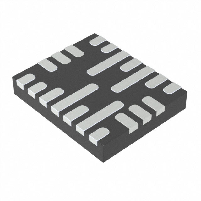

MP5403 Configurable 2.7V-6V Mini PMIC with Dual 2.5A/3.5A Buck, One Load Switch, and Input Power Supervisory DESCRIPTION FEATURES The MP5403 is a monolithic power management unit containing two highefficiency, step-down, switching converters and a load switch. The two regulators supply current up to 3.5A and 2.5A separately, and the load switch supplies up to 3A of load current with an extremely low RDS(ON). With an input range of up to 6V, the MP5403 is ideal for powering ASIC and SOC for solid-state drives and other compact power systems.   The peak-current-mode control scheme with pulse-skip-mode operation provides the two switchers with fast transient response, high light-load efficiency, and minimum capacitance by using an interleaving PWM clock between the two switchers. The 3A load switch with a low 20mΩ on resistance provides flexible system configuration. A full set of enable control pins and power good open-drain indicators allow for easy implementation of the start-up and shutdown sequences. Full protection features include over-current protection (OCP) and thermal shutdown. The MP5403 requires a minimal number of readily available, standard, external components and is available in a small UTQFN20 (2.5mmx3mm) package.       Low Iq: 85µA for Two Switchers Total Two Buck Converters o 3.5A with 55mΩ/20mΩ RDS(ON) o 2.5A with 60mΩ/22mΩ RDS(ON) o 1.5MHz Switching Frequency o 180° Interleaving Operation o 100% Duty Cycle o Load Switch Mode by Pulling FB Low o Latch-Off Short-Circuit Protection (SCP) o Parallel Capability by Connecting SW Nodes Together o Internal Soft Start and Output Discharge o Optimized Light-Load Efficiency Available Fixed Output Options via Package Trim: Ch1: 0.9V, 1.1V, 2.5V, 2.85V Ch2: 0.9V, 1.2V, 1.8V, 2.5V One Load Switch o 3A with 20mΩ RDS(ON) o Soft Start and Output Discharge o Over-Current Protection (OCP) EN and Power Good for Power Sequencing Input Power Failure Indicator (PFL) with Adjustable Threshold and Delay Thermal Shutdown Available in Ultra-Thin UTQFN-20 (2.5mmx3mm) Package APPLICATIONS    Solid-State Drives Hybrid Drives Low Voltage System Power All MPS parts are lead-free, halogen-free, and adhere to the RoHS directive. For MPS green status, please visit the MPS website under Quality Assurance. “MPS” and “The Future of Analog IC Technology” are registered trademarks of Monolithic Power Systems, Inc. MP5403 Rev. 1.0 9/20/2016 www.MonolithicPower.com MPS Proprietary Information. Patent Protected. Unauthorized Photocopy and Duplication Prohibited. © 2016 MPS. All Rights Reserved. 1 MP5403 – CONFIGURABLE 2.7V-6V MINI PMIC WITH DUAL 2.5A/3.5A BUCK, ONE LOAD SWITCH, AND INPUT POWER SUPERVISORY TYPICAL APPLICATION VSUS PFL CDELAY SW1 R6 R5 Input Voltage C1 PFL_ADJ VIN1 C2 SW2 FB2 VIN2 C1A R1 FB1 MP5403 Output Voltage 1 3.5A DC L1 R2 Output Voltage 2 2.5A DC L2 C1B R3 R4 VIN3 EN1 EN2 EN3 C2A PG2 PG3 Output Voltage 3 3A DC OUT3 PG1 GND, AGND Two Bucks and One Load Switch VSUS PFL CDELAY R6 R5 Input Voltage C1 PFL_ADJ VIN1 C2 SW1 SW2 L1 R1 FB1 FB2 C1A C1B R2 MP5403 VIN2 VIN3 EN1 EN2 EN3 OUT3 PG1 C2A PG2 PG3 GND, AGND One Parallel Buck and One Load Switch MP5403 Rev. 1.0 9/20/2016 www.MonolithicPower.com MPS Proprietary Information. Patent Protected. Unauthorized Photocopy and Duplication Prohibited. © 2016 MPS. All Rights Reserved. 2 MP5403 – CONFIGURABLE 2.7V-6V MINI PMIC WITH DUAL 2.5A/3.5A BUCK, ONE LOAD SWITCH, AND INPUT POWER SUPERVISORY ORDERING INFORMATION Part Number* MP5403GQBU Package UTQFN-20 (2.5mmx3mm) Top Marking See Below * For Tape & Reel, add suffix –Z (e.g. MP5403GQBU–Z) TOP MARKING APZ: Product code of MP5403GQBU Y: Year code WW: Week code LLL: Lot number PACKAGE REFERENCE OUT3 VIN3 CDELAY 1 PFL TOP VIEW 20 19 18 17 PG3 15 PG1 AGND 4 14 SW1 GND 5 13 VSUS VIN2 6 12 SW2 FB1 7 8 9 10 EN2 VIN1 3 EN1 16 PG2 FB2 PFL_ADJ 2 11 EN3 UTQFN-20 (2.5mmx3mm) MP5403 Rev. 1.0 9/20/2016 www.MonolithicPower.com MPS Proprietary Information. Patent Protected. Unauthorized Photocopy and Duplication Prohibited. © 2016 MPS. All Rights Reserved. 3 MP5403 – CONFIGURABLE 2.7V-6V MINI PMIC WITH DUAL 2.5A/3.5A BUCK, ONE LOAD SWITCH, AND INPUT POWER SUPERVISORY ABSOLUTE MAXIMUM RATINGS (1) Supply voltage (VIN1/2/3) ...........................6.5V VSW1/2 ................................ -0.3V (-5V for UVLO, supply voltage (VIN3) .............. ......................................................... 0.5V to 6V If VIN1 < UVLO, supply voltage (VIN3) .............. ......................................................... 2.7V to 6V Output voltage (VOUT1/2) ............... 0.6V to VIN1/2 Output voltage (VOUT3)................................ VIN3 Operating junction temp. (TJ) ... -40°C to +125°C MP5403 Rev. 1.0 9/20/2016 Thermal Resistance (4) θJA θJC UTQFN-20 (2.5mmx3mm) ..... 60 ....... 13 ... °C/W NOTES: 1) Exceeding these ratings may damage the device. 2) The maximum allowable power dissipation is a function of the maximum junction temperature TJ (MAX), the junction-toambient thermal resistance θJA, and the ambient temperature TA. The maximum allowable continuous power dissipation at any ambient temperature is calculated by PD (MAX) = (TJ (MAX)-TA)/θJA. Exceeding the maximum allowable power dissipation produces an excessive die temperature, causing the regulator to go into thermal shutdown. Internal thermal shutdown circuitry protects the device from permanent damage. 3) The device is not guaranteed to function outside of its operating conditions. 4) Measured on JESD51-7, 4-layer PCB. www.MonolithicPower.com MPS Proprietary Information. Patent Protected. Unauthorized Photocopy and Duplication Prohibited. © 2016 MPS. All Rights Reserved. 4 MP5403 – CONFIGURABLE 2.7V-6V MINI PMIC WITH DUAL 2.5A/3.5A BUCK, ONE LOAD SWITCH, AND INPUT POWER SUPERVISORY ELECTRICAL CHARACTERISTICS VIN1/2 = 3.6V, VIN3 = 3.6V, TJ = -40°C to 125°C (7), typical value is tested at TJ = 25°C unless otherwise noted. Parameters Symbol Buck Regulators Condition Min VIN1 For VIN1 2.7 VIN1_R For VIN1 2.3 VIN1_HYS For VIN1 Input voltage range Under-voltage lockout threshold rising Under-voltage lockout threshold hysteresis Input voltage range for Rail2 VIN2 under-voltage lockout threshold rising VIN2 under-voltage lockout threshold hysteresis Supply current (shutdown) Supply current (quiescent) High-side switch on resistance for 3.5A switcher Low-side switch on resistance for 3.5A switcher High-side switch on resistance for 2.5A switcher Low-side switch on resistance for 2.5A switcher Switch leakage current High-side current limit for 3.5A switcher High-side current limit for 2.5A switcher Low-side zero crossing current Oscillator frequency Phase shift Minimum on time (6) Minimum off time (6) Maximum duty cycle (6) VIN2 VIN1 > VIN1_R 2.5 Max Units 6 V 2.65 V 250 2 VIN2_R For VIN2 1.8 VIN2 _HYS For VIN2 300 ISD IQ1+Q2 VEN1/2/3 = 0V, TJ = 25°C VEN1/2 = 2V, VEN3 = 0V, VFB1/2 = 1V 85 mV 6 V 1.85 V mV 1 μA 110 μA RDS(ON)1_H 55 mΩ RDS(ON)1_L 20 mΩ RDS(ON)2_H 65 mΩ RDS(ON)2_L 22 mΩ ILK_SW1/2 VEN1/2 = 0V, VIN1/2 = 6V, VSW1/2 = 0V and 6V, TJ = 25°C 0 1 μA ILIM1_H Duty = 33% 4.5 5.6 A ILIM2_H Duty = 33% 3.5 4.7 A IZCD1/2 FSW1/2 For both channels CCM 1.2 0.1 1.5 A MHz PhS TMIN_ON TMIN_OFF DMAX CCM 1.8 180 70 100 100 degree ns ns % TJ = 25°C 594 600 606 mV TJ = -40°C to 125°C (7) 591 600 609 mV 10 50 nA Feedback voltage VFB1/2 Feedback currents IFB1/2 FB1/2 = 0.65V Internal soft-start time TSS1/2 From 10% VOUT to 90% VOUT Output discharge resistor RDIS1/2 MP5403 Rev. 1.0 9/20/2016 Typ (5) 0.35 ms 13 Ω www.MonolithicPower.com MPS Proprietary Information. Patent Protected. Unauthorized Photocopy and Duplication Prohibited. © 2016 MPS. All Rights Reserved. 5 MP5403 – CONFIGURABLE 2.7V-6V MINI PMIC WITH DUAL 2.5A/3.5A BUCK, ONE LOAD SWITCH, AND INPUT POWER SUPERVISORY ELECTRICAL CHARACTERISTICS (continued) VIN1/2 = 3.6V, VIN3 = 3.6V, TJ = -40°C to 125°C (7), typical value is tested at TJ = 25°C unless otherwise noted. Parameters Symbol EN high logic EN hysteresis EN1/2_H EN1/2_HYS EN1/2 input current IEN1/2 EN1 turn-on delay ENTD_1 EN2 turn-on delay ENTD_2 Power good upper trip threshold PG1/2_H Power good lower trip threshold PG1/2_L Power good hysteresis Power good delay for rising Power good delay for falling Power good sink current capability Power good leakage current Load Switch Input voltage range Under-voltage lockout threshold rising Under-voltage lockout threshold hysteresis Supply current (quiescent) Max Units 1.05 1.3 150 1 0 1.5 V mV VEN = 2V VEN = 0V For channel 1 For channel 2, VIN1 > VIN1_R FB with respect to the regulation FB with respect to the regulation μs 100 μs +30 % -10 % 5 20 60 % μs μs V μA 0.4 1 VIN3_R For VIN3 2.3 VIN3_HYS For VIN3 200 From VIN3, VEN1/2 = 0V, VEN3 = 3.6V 160 IQ3 ENTD_3 EN3 input current IEN3 PG3 high logic threshold PG3_H PG3 low logic threshold PG3_L PDTD_3 VPG_LO_3 PGLK_3 ILIM3 μA 100 0.6 2.7 EN3 turn-on delay MP5403 Rev. 1.0 9/20/2016 Typ VIN1 > VIN1_R VIN1 < VIN1_R VIN3 RDSON EN3_H EN3_HYS Current limit Min PGHY PDTD_1/2 H PDTD_1/2 L VPG_LO_1/2 Sink 1mA PGLK_1/2 VPG = 1.8V On resistor EN3 high logic threshold EN3 hysteresis Power good delay for rising Power good sink current capability Power good leakage current Condition 1.05 2.5 20 1.3 150 6 6 V V 2.65 V mV 250 μA 1.5 mΩ V mV VIN1 > VIN1_R 70 VIN1 < VIN1_R 70 VEN3 = 2V VEN3 = 0V VIN3 - VOUT3 is smaller than the range VIN3 - VOUT3 is larger than the range 1 0 μA 200 mV 250 mV 40 1 μs V μA 5.6 A Sink 1mA VPG = 1.8V 150 µs 0.4 www.MonolithicPower.com MPS Proprietary Information. Patent Protected. Unauthorized Photocopy and Duplication Prohibited. © 2016 MPS. All Rights Reserved. 6 MP5403 – CONFIGURABLE 2.7V-6V MINI PMIC WITH DUAL 2.5A/3.5A BUCK, ONE LOAD SWITCH, AND INPUT POWER SUPERVISORY ELECTRICAL CHARACTERISTICS (continued) VIN1/2 = 3.6V, VIN3 = 3.6V, TJ = -40°C to 125°C (7), typical value is tested at TJ = 25°C unless otherwise noted. Parameters Symbol Internal soft-start time Tss3 Output resistor Power Failure Circuitry VSUS voltage VSUS leakage current PFL_ADJ reference PFL hysteresis PFL high-to-low delay CDELAY internal current source Power good sink current capability Power good leakage current Thermal shutdown (6) Thermal hysteresis (6) Condition Min From 10% VOUT to 90% VOUT Typ Max Units 0.35 ms RDIS 13 Ω VSUS 3.6 V VSUS = 3.6V, VIN1 = VIN3 = 3.6V, TJ = 25°C TA = 25°C PFL_ADJ TA = -40°C to 125°C (7) PFL_HYS ISUS_LK TPFL_HL IDELAY VPFL_LO PFLLK TSD THYS 594 591 0 1 μA 600 600 3 606 609 mV % 1 3.1 Sink 1mA VPFL = 1.8V 0.4 1 160 30 μs μA V μA °C °C NOTES: 5) VIN1 provides control voltage if VIN3 is lower than 2.7V. 6) Guaranteed by design. 7) Guaranteed by characterization test, not production tested. MP5403 Rev. 1.0 9/20/2016 www.MonolithicPower.com MPS Proprietary Information. Patent Protected. Unauthorized Photocopy and Duplication Prohibited. © 2016 MPS. All Rights Reserved. 7 MP5403 – CONFIGURABLE 2.7V-6V MINI PMIC WITH DUAL 2.5A/3.5A BUCK, ONE LOAD SWITCH, AND INPUT POWER SUPERVISORY TYPICAL PERFORMANCE CHARACTERISTICS VIN = 5V, VOUT1 = 1.8V, VOUT2 = 1.2V, L1 = 0.47µH, L2 = 0.47µH, TA = +25°C, unless otherwise noted. MP5403 Rev. 1.0 9/20/2016 www.MonolithicPower.com MPS Proprietary Information. Patent Protected. Unauthorized Photocopy and Duplication Prohibited. © 2016 MPS. All Rights Reserved. 8 MP5403 – CONFIGURABLE 2.7V-6V MINI PMIC WITH DUAL 2.5A/3.5A BUCK, ONE LOAD SWITCH, AND INPUT POWER SUPERVISORY TYPICAL PERFORMANCE CHARACTERISTICS (continued) VIN = 5V, VOUT1 = 1.8V, VOUT2 = 1.2V, L1 = 0.47µH, L2 = 0.47µH, TA = +25°C, unless otherwise noted. MP5403 Rev. 1.0 9/20/2016 www.MonolithicPower.com MPS Proprietary Information. Patent Protected. Unauthorized Photocopy and Duplication Prohibited. © 2016 MPS. All Rights Reserved. 9 MP5403 – CONFIGURABLE 2.7V-6V MINI PMIC WITH DUAL 2.5A/3.5A BUCK, ONE LOAD SWITCH, AND INPUT POWER SUPERVISORY TYPICAL PERFORMANCE CHARACTERISTICS (continued) VIN = 5V, VOUT1 = 1.8V, VOUT2 = 1.2V, L1 = 0.47µH, L2 = 0.47µH, TA = +25°C, unless otherwise noted. MP5403 Rev. 1.0 9/20/2016 www.MonolithicPower.com MPS Proprietary Information. Patent Protected. Unauthorized Photocopy and Duplication Prohibited. © 2016 MPS. All Rights Reserved. 10 MP5403 – CONFIGURABLE 2.7V-6V MINI PMIC WITH DUAL 2.5A/3.5A BUCK, ONE LOAD SWITCH, AND INPUT POWER SUPERVISORY TYPICAL PERFORMANCE CHARACTERISTICS (continued) VIN = 5V, VOUT1 = 1.2V, VOUT2 = 1.2V, L1 = 0.47µH, L2 = 0.47µH, TA = +25°C, unless otherwise noted. MP5403 Rev. 1.0 9/20/2016 www.MonolithicPower.com MPS Proprietary Information. Patent Protected. Unauthorized Photocopy and Duplication Prohibited. © 2016 MPS. All Rights Reserved. 11 MP5403 – CONFIGURABLE 2.7V-6V MINI PMIC WITH DUAL 2.5A/3.5A BUCK, ONE LOAD SWITCH, AND INPUT POWER SUPERVISORY TYPICAL PERFORMANCE CHARACTERISTICS (continued) VIN = 5V, VOUT1 = 1.2V, VOUT2 = 1.2V, L1 = 0.47µH, L2 = 0.47µH, TA = +25°C, unless otherwise noted. MP5403 Rev. 1.0 9/20/2016 www.MonolithicPower.com MPS Proprietary Information. Patent Protected. Unauthorized Photocopy and Duplication Prohibited. © 2016 MPS. All Rights Reserved. 12 MP5403 – CONFIGURABLE 2.7V-6V MINI PMIC WITH DUAL 2.5A/3.5A BUCK, ONE LOAD SWITCH, AND INPUT POWER SUPERVISORY TYPICAL PERFORMANCE CHARACTERISTICS (continued) VIN = 5V, VOUT1 = 1.2V, VOUT2 = 1.2V, L1 = 0.47µH, L2 = 0.47µH, TA = +25°C, unless otherwise noted. MP5403 Rev. 1.0 9/20/2016 www.MonolithicPower.com MPS Proprietary Information. Patent Protected. Unauthorized Photocopy and Duplication Prohibited. © 2016 MPS. All Rights Reserved. 13 MP5403 – CONFIGURABLE 2.7V-6V MINI PMIC WITH DUAL 2.5A/3.5A BUCK, ONE LOAD SWITCH, AND INPUT POWER SUPERVISORY PIN FUNCTIONS Pin # 1 2 3 4 5 6 7 8 9 10 11 12 13 14 15 16 17 18 19 20 MP5403 Rev. 1.0 9/20/2016 Name Description Programmable PFL low-to-high delay time. When CDELAY is floated, the delay time is CDELAY minimized. Power failure threshold adjust. A resistor divider connected to the voltage rails is PFL_ADJ used to program the power failure threshold. The resistor divider needs to be monitored. Input supply voltage to the 3.5A switching regulators and internal logic module. VIN1 Place a small decoupling capacitor as close to VIN1 and GND as possible. Analog ground. AGND Ground. GND Input supply voltage to the 2.5A switching regulators. Place a small decoupling VIN2 capacitor as close to VIN2 and GND as possible. Feedback voltage sensing for the 3.5A regulator. Connect the output voltage of the FB1 3.5A regulator through a resistor divider to FB1 to achieve output voltage regulation. Pull FB1 to ground to operate the 3.5A regulator in 100% duty cycle on mode. Feedback voltage sensing for the 2.5A regulator. Connect the output voltage of the FB2 2.5A regulator through a resistor divider to FB2 to achieve output voltage regulation. Pull FB2 to ground to operate the 2.5A regulator in 100% duty cycle on mode. Enable on/off control for the 3.5A regulator. There is a 2MΩ resistor from EN1 to EN1 GND internally. Float or ground EN1 to turn off the 3.5A regulator. Enable on/off control for the 2.5A regulator. There is a 2MΩ resistor from EN2 to EN2 GND internally. Float or ground EN2 to turn off the 2.5A regulator. Enable on/off control for the load switch. There is a 2MΩ resistor from EN3 to GND EN3 internally. Float or ground EN3 to turn off the load switch. Switch output for the 2.5A regulator. A thick and wide power routing trace is SW2 recommended for SW2 to conduct current. Sustain voltage. Place a small decoupling capacitor as close to VSUS and GND as VSUS possible. Switch output for the 3.5A regulator. A thick and wide power routing trace is SW1 recommended for SW1 to conduct current. Power good for the 3.5A regulator. PG1 is an open-drain output. When the output PG1 voltage is between -10% to +30% of the regulation, PG1 is pulled high externally. When there is no supply, PG1 is pulled low internally. Power good for the 2.5A regulator. PG2 is an open-drain output. When the output PG2 voltage is between -10% to +30% of the regulation, PG2 is pulled high externally. When there is no supply, PG2 is pulled low internally. Power good for the load switch. PG3 is an open-drain output. When the output PG3 voltage is below 200mV compared with the input voltage, PG3 is pulled high externally. Input supply voltage for the load switch. VIN3 Output voltage for the load switch. OUT3 Power failure indicator. PFL is an open-drain output. When the PFL_ADJ voltage is PFL less than 0.6V, PFL is pulled low immediately. www.MonolithicPower.com MPS Proprietary Information. Patent Protected. Unauthorized Photocopy and Duplication Prohibited. © 2016 MPS. All Rights Reserved. 14 MP5403 – CONFIGURABLE 2.7V-6V MINI PMIC WITH DUAL 2.5A/3.5A BUCK, ONE LOAD SWITCH, AND INPUT POWER SUPERVISORY BLOCK DIAGRAM PFL CDELAY Vsus PFL_ADJ Delay Control + _ PG1 Vsus Ctrl 0.6V Ref1 + _ VIN1 ULVO FB1 Internal Soft Start HS FB1 Ref1 + + _ PWM SW1 Driver LS Mode Ctrl Slope Comp EN1 Output Discharge + _ 1.5MHz Osc VIN2 Slope Comp EN2 Internal Soft Start FB2 Ref2 HS + + _ PWM SW2 Driver LS Output Discharge Mode Ctrl PG2 + _ Ref2 + _ FB2 Output Clamping VIN3 OUT3 VIN1 EN3 Charge Pump Soft Start Output Discharge PG3 + _ Ctrl GND, AGND Figure 1: Functional Block Diagram MP5403 Rev. 1.0 9/20/2016 www.MonolithicPower.com MPS Proprietary Information. Patent Protected. Unauthorized Photocopy and Duplication Prohibited. © 2016 MPS. All Rights Reserved. 15 MP5403 – CONFIGURABLE 2.7V-6V MINI PMIC WITH DUAL 2.5A/3.5A BUCK, ONE LOAD SWITCH, AND INPUT POWER SUPERVISORY OPERATION The MP5403 has two step-down regulators and one load switch integrated into an ultra-small UTQFN-20 package. The two buck regulators are able to run up to 3.5A and 2.5A of load current, respectively. With a peak current mode control scheme and an interleaving PWM clock, the MP5403 minimizes the input voltage ripple and achieves a fast dynamic load response. The load switch has 3A and only 20mΩ of RDS(ON), achieves extremely small conduction loss, and provides tight regulation with a high load current. The load switch can also clamp VOUT to 5.5V. The MP5403 can be used in compact solid-state drives (SSD), portable instruments, and battery-powered devices. Peak-Current Mode Control The two buck regulators of the MP5403 operate at an 180° phase shift to reduce the input current ripple and the required input capacitor. In continuous conduction mode (CCM), two internal clocks control the switching behavior. The high-side MOSFET (HS-FET) turns on at the corresponding clock’s rising edge. The two clocks are at an 180o phase shift. When the high-side switch current increases and reaches the internal compensation voltage, the high-side switch is turned off, and the low-side switch is turned on to conduct current. Figure 2: Phase Shift The switching frequency is 1.5MHz, typically, running in CCM. With a lower input voltage, the switching frequency falls and works with a large duty cycle and a fixed off-time mode. MP5403 Rev. 1.0 9/20/2016 Light-Load Operation In light load mode, the MP5403 uses a proprietary control scheme to save power and improve efficiency. The MP5403 turns off the low-side switch when the inductor current begins reversing. The MP5403 then works in discontinuous conduction mode (DCM) operation. With light-load mode control, the switching loss can be greatly reduced due to the lower switching frequency. A zero-current cross detection (ZCD) circuit is used to detect if the inductor current begins reversing. Considering the internal circuit propagation time, the typical delay is 50ns. This means that the inductor current continues falling after ZCD is triggered in this delay. If the inductor current falling slew rate is fast (VOUT is high or close to VIN), the low-side MOSFET (LS-FET) is turned off, and the inductor current may be negative. This prevents the MP5403 from entering DCM operation. If DCM operation is required, the off time of the LS-FET in CCM should be longer than 100ns. For example, if VIN is 3.6V and VOUT is 3.4V, then the off time in CCM is 37ns. It is difficult to enter DCM at light load. Using a smaller inductor can improve this and make it easier to enter DCM. Enable (EN) When VIN1 is greater than the under-voltage lockout (UVLO) threshold (typically 2.5V), the regulators or the load switch can be enabled by pulling its EN pins above the EN UVLO threshold. Leave the EN pins floating or pull the EN pins down to ground to disable the corresponding channel. There is an internal 2MΩ resistor from the EN pins to ground. There is a delay of about 100µs for the VIN1 and VIN2 enable start-up. The VIN3 enable start-up delay is shorter (around 70µs). Soft Start (SS) and Output Discharge The MP5403 has a built-in soft start (SS) that ramps up the output voltage at a controlled slew rate to prevent overshooting at start-up for both step-down regulators and the load switch. For the step-down regulator, the soft-start time is about 500µs, typically. For the load switch, the soft-start time is set to around 350µs. When the regulators are disabled, the internal discharge www.MonolithicPower.com MPS Proprietary Information. Patent Protected. Unauthorized Photocopy and Duplication Prohibited. © 2016 MPS. All Rights Reserved. 16 MP5403 – CONFIGURABLE 2.7V-6V MINI PMIC WITH DUAL 2.5A/3.5A BUCK, ONE LOAD SWITCH, AND INPUT POWER SUPERVISORY resistor discharges VOUT. The discharge resistor is biased by VSUS (see Table 1). Table 1: Output Discharge Conditions Output Discharge VIN EN No >UVLO High Yes >UVLO Low Yes
