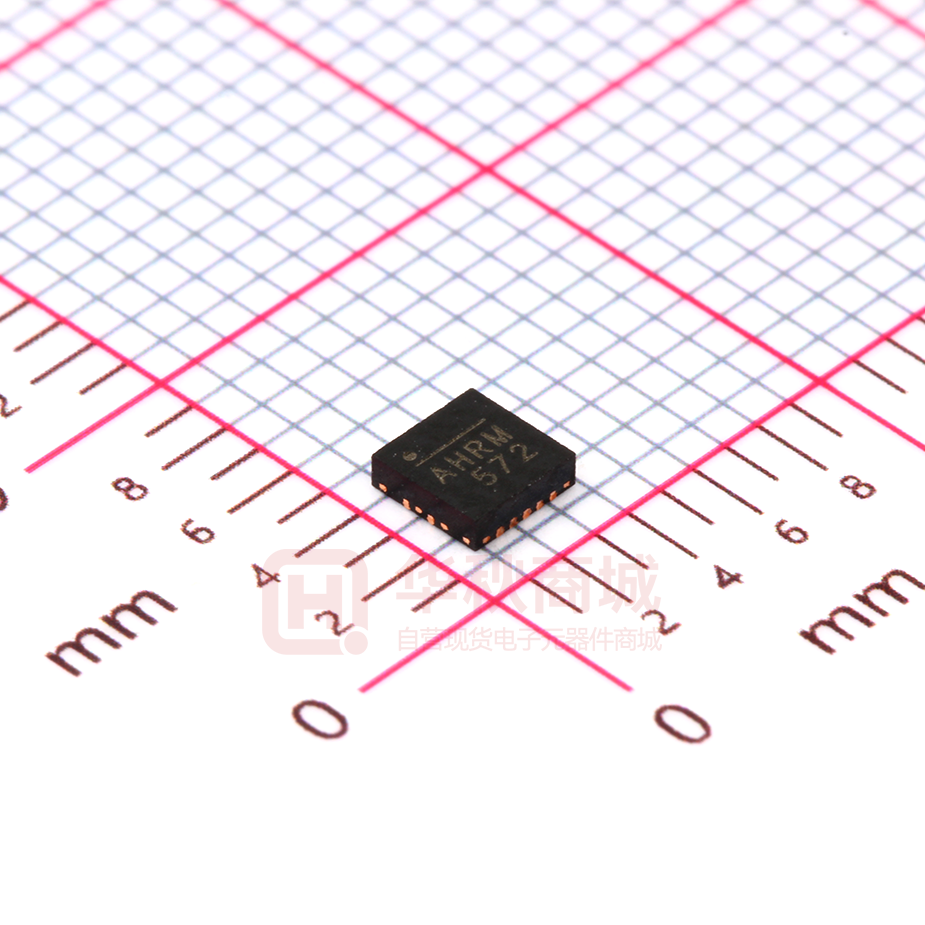

MP8765GQ-Z
MP8765GQ-Z
    MPS(美国芯源)
    QFN-16(3x3)
    24V,6A高效同步降压变换器
MP8765GQ-Z 数据手册
MP8765 24V, 6A High Efficiency Synchronous Step-down Converter The Future of Analog IC Technology DESCRIPTION FEATURES The MP8765 is a fully integrated high frequency synchronous rectified step-down switch mode converter. It offers very compact solutions to achieve 6A continuous output current over a wide input supply range with excellent load and line regulation. The MP8765 operates at high efficiency over a wide output current load range.      Constant-On-Time (COT) control mode provides fast transient response and eases loop stabilization. Under voltage lockout is internally set as 4.6 V, An open drain power good signal indicates the output is within its nominal voltage range. Full protection features include OCP and thermal shut down. The converter requires minimum number of external components and is available in QFN16 (3mmx3mm) package.        Wide 5V to 24V Operating Input Range 6A Continuous Output Current PFM/PWM Mode Selectable Low RDS(ON) Internal Power MOSFETs Proprietary Switching Loss Reduction Technique 1% Reference Voltage 7ms Internal Soft Start Output Discharge 500kHz Switching Frequency Hiccup OCP Protection and Thermal Shutdown Auto Retry OVP Protection Output Adjustable from 0.604V to 5.5V APPLICATIONS       Laptop Computer Tablet PC Networking Systems Personal Video Recorders Flat Panel Television and Monitors Distributed Power Systems All MPS parts are lead-free and adhere to the RoHS directive. For MPS green status, please visit MPS website under Products, Quality Assurance page. “MPS” and “The Future of Analog IC Technology” are registered trademarks of Monolithic Power Systems, Inc. TYPICAL APPLICATION MP8765 Rev. 1.1 7/23/2019 www.MonolithicPower.com MPS Proprietary Information. Patent Protected. Unauthorized Photocopy and Duplication Prohibited. © 2019 MPS. All Rights Reserved. 1 MP8765 ─ 24V, HIGH CURRENT SYNCHRONOUS STEP-DOWN CONVERTER ORDERING INFORMATION Part Number* Package Top Marking MP8765GQ QFN16(3x3mm) AHR * For Tape & Reel, add suffix –Z (e.g.MP8765GQ-Z) PACKAGE REFERENCE TOP VIEW VIN AGND EN FB VCC BST 14 13 12 11 10 1 15 SW PGND 9 SW 8 SW 2 16 SW 3 4 NC PG 5 6 7 NC MODE VOUT ABSOLUTE MAXIMUM RATINGS (1) Thermal Resistance (5) Supply Voltage VIN ........................................ 24V VSW ............................................... -0.3V to 24.3V VSW (30ns) .......................................... -3V to 28V VSW (5ns) ............................................ -6V to 28V VBST.....................................................VSW + 5.5V VEN ................................................................. 12V Enable Current IEN(2)................................ 2.5mA All Other Pins .............................. –0.3V to +5.5V Continuous Power Dissipation (TA=+25) (3) QFN16...……………………….…..…………1.8W Junction Temperature ............................... 150C Lead Temperature .................................... 260C Storage Temperature ................-65C to +150C Notes: 1) Exceeding these ratings may damage the device. 2) Refer to “Configuring the EN Control”. 3) The maximum allowable power dissipation is a function of the maximum junction temperature TJ(MAX), the junction-toambient thermal resistance θJA, and the ambient temperature TA. The maximum allowable continuous power dissipation at any ambient temperature is calculated by PD(MAX)=(TJ(MAX)TA)/θJA. Exceeding the maximum allowable power dissipation will cause excessive die temperature, and the regulator will go into thermal shutdown. Internal thermal shutdown circuitry protects the device from permanent damage. 4) The device is not guaranteed to function outside of its operating conditions. 5) Measured on JESD51-7, 4-layer PCB. θJA θJC QFN16 (3mmx3mm)................ 70 ...... 15... C/W Recommended Operating Conditions (4) Supply Voltage VIN .............................. 5V to 22V Output Voltage VOUT .................... 0.604V to 5.5V Enable Current IEN................................... 1mA Operating Junction Temp. (TJ). -40°C to +125°C MP8765 Rev. 1.1 7/23/2019 www.MonolithicPower.com MPS Proprietary Information. Patent Protected. Unauthorized Photocopy and Duplication Prohibited. © 2019 MPS. All Rights Reserved. 2 MP8765 ─ 24V, HIGH CURRENT SYNCHRONOUS STEP-DOWN CONVERTER ELECTRICAL CHARACTERISTICS VIN = 12V, TJ = 25C, unless otherwise noted. Parameters Symbol Condition Min Typ Max Units 100 0 160 1 200 μA μA 38 15 0 1 mΩ mΩ μA 6.6 7.6 A 0.4 V V μA Supply Current Supply Current (Shutdown) Supply Current (Quiescent) MOSFET High-side Switch On Resistance Low-side Switch On Resistance Switch Leakage IIN IIN HSRDS-ON LSRDS-ON SWLKG VEN = 0V VEN = 2V, VFB = 0.65V VEN = 0V, VSW = 0V Current Limit Low-side Valley Current Limit Mode Pin PWM Mode Threshold PFM Mode Threshold Pull-up Current ILIMIT TJ = 25C VMODE_H VMODE_L IMODE_PU 6 2 2.5 Switching frequency and minimum off timer Switching frequency Minimum Off Time(6) FS TOFF 400 500 300 600 kHz ns VOVP TOVPDEL 125% 130% 2 135% VREF μs VREF IFB TSS 598 604 10 7 610 50 8 mV nA ms 1.25 100 3 0 1.35 V mV VCCVth 4.6 4.85 VCCHYS 480 Over-voltage Protection OVP Threshold OVP Delay Reference And Soft Start Reference Voltage Feedback Current Soft Start Time Enable And UVLO Enable Input Low Voltage Enable Hysteresis Enable Input Current VCC Under Voltage Lockout Threshold Rising VCC Under Voltage Lockout Threshold Hysteresis MP8765 Rev. 1.1 7/23/2019 VFB = 604mV 6 VILEN VEN-HYS IEN 1.15 VEN = 2V VEN = 0V www.MonolithicPower.com MPS Proprietary Information. Patent Protected. Unauthorized Photocopy and Duplication Prohibited. © 2019 MPS. All Rights Reserved. μA V mV 3 MP8765 ─ 24V, HIGH CURRENT SYNCHRONOUS STEP-DOWN CONVERTER ELECTRICAL CHARACTERISTICS (continued) VIN = 12V, TJ = 25C, unless otherwise noted. Parameters Symbol Condition Min Typ Max Units 4.8 5.1 5.3 V VCC Regulator VCC Regulator VCC VCC Load Regulation Icc=5mA 5 % Power Good FB Rising (Good) FB Falling (Fault) FB Rising (Fault) FB Falling (Good) Power Good Lower to High Delay Power Good Sink Current Capability Power Good Leakage Current PGVth-Hi PGVth-Lo PGVth-Hi PGVth-Lo PGTd 95 85 115 105 0.5 %VREF ms VPG Sink 4mA 0.4 V IPG_LEAK VPG = 3.3V 12 μA Thermal Protection Thermal Shutdown(6) Thermal Shutdown Hysteresis(6) TSD 150 25 °C °C Note: 6) Guaranteed by design. MP8765 Rev. 1.1 7/23/2019 www.MonolithicPower.com MPS Proprietary Information. Patent Protected. Unauthorized Photocopy and Duplication Prohibited. © 2019 MPS. All Rights Reserved. 4 MP8765 ─ 24V, HIGH CURRENT SYNCHRONOUS STEP-DOWN CONVERTER TYPICAL PERFORMANCE CHARACTERISTICS Performance waveforms are tested on the evaluation board of the Design Example section. VIN=12V, VOUT =1.05V, L=1.2µH, PFM Mode, TJ=+25°C, unless otherwise noted. MP8765 Rev. 1.1 7/23/2019 www.MonolithicPower.com MPS Proprietary Information. Patent Protected. Unauthorized Photocopy and Duplication Prohibited. © 2019 MPS. All Rights Reserved. 5 MP8765 ─ 24V, HIGH CURRENT SYNCHRONOUS STEP-DOWN CONVERTER TYPICAL PERFORMANCE CHARACTERISTICS (continued) Performance waveforms are tested on the evaluation board of the Design Example section. VIN=12V, VOUT =1.05V, L=1.2µH, PFM Mode, TJ=+25°C, unless otherwise noted. MP8765 Rev. 1.1 7/23/2019 www.MonolithicPower.com MPS Proprietary Information. Patent Protected. Unauthorized Photocopy and Duplication Prohibited. © 2019 MPS. All Rights Reserved. 6 MP8765 ─ 24V, HIGH CURRENT SYNCHRONOUS STEP-DOWN CONVERTER TYPICAL PERFORMANCE CHARACTERISTICS (continued) Performance waveforms are tested on the evaluation board of the Design Example section. VIN=12V, VOUT =1.05V, L=1.2µH, PFM Mode, TJ=+25°C, unless otherwise noted. MP8765 Rev. 1.1 7/23/2019 www.MonolithicPower.com MPS Proprietary Information. Patent Protected. Unauthorized Photocopy and Duplication Prohibited. © 2019 MPS. All Rights Reserved. 7 MP8765 ─ 24V, HIGH CURRENT SYNCHRONOUS STEP-DOWN CONVERTER TYPICAL PERFORMANCE CHARACTERISTICS (continued) Performance waveforms are tested on the evaluation board of the Design Example section. VIN=12V, VOUT =1.05V, L=1.2µH, PFM Mode, TJ=+25°C, unless otherwise noted. MP8765 Rev. 1.1 7/23/2019 www.MonolithicPower.com MPS Proprietary Information. Patent Protected. Unauthorized Photocopy and Duplication Prohibited. © 2019 MPS. All Rights Reserved. 8 MP8765 ─ 24V, HIGH CURRENT SYNCHRONOUS STEP-DOWN CONVERTER PIN FUNCTIONS PIN # Name 1 VIN 2 PGND 4 PG 3, 5 NC 6 MODE 7 VOUT 8,9 Exposed Pad 15, 16 SW 10 BST 11 VCC 12 FB 13 EN 14 AGND MP8765 Rev. 1.1 7/23/2019 Description Supply Voltage. The IN pin supplies power for internal MOSFET and regulator. The MP8765 operate from a +5V to +22V input rail. An input capacitor is needed to decouple the input rail. Use wide PCB traces and multiple vias to make the connection. Power Ground. Use wide PCB traces and multiple vias to make the connection Power good output, the output of this pin is an open drain signal and is high if the output voltage is higher than 95% of the nominal voltage. There is a delay from FB ≥ 95% to PGOOD goes high. Note: If PG is pulled up to an external voltage, PG will not de-assert (Logic low) if EN is low or if input power is off. It is recommended that PG is pulled up to VCC pin and in this case PG will de-assert (Logic low) when EN is Low or if input power is off. Refer to Applications section for additional details. PFM/PWM mode selection pin. Float MODE pin or pull it higher than 2V, MP8765 always works in force PWM mode; Connecting MODE pin to ground enables PFM mode at light load condition. VOUT pin is used to sense the output voltage of the Buck regulator, connect this pin to the output capacitor of the regulator directly. Switch Output. Connect this pin to the inductor and bootstrap capacitor. This pin is driven up to the VIN voltage by the high-side switch during the on-time of the PWM duty cycle. The inductor current drives the SW pin negative during the off-time. The on-resistance of the low-side switch and the internal diode fixes the negative voltage. Use wide and short PCB traces to make the connection. Try to minimize the area of the SW pattern. Bootstrap. A capacitor connected between SW and BS pins is required to form a floating supply across the high-side switch driver. Internal 5V LDO output. The driver and control circuits are powered from this voltage. Decouple with a minimum 1µF ceramic capacitor as close to the pin as possible. X7R or X5R grade dielectric ceramic capacitors are recommended for their stable temperature characteristics. Feedback. An external resistor divider from the output to GND, tapped to the FB pin, sets the output voltage. It is recommended to place the resistor divider as close to FB pin as possible. Vias should be avoided on the FB traces. Enable pin. EN is a digital input that turns the regulator on or off. Drive EN high to turn on the regulator, drive it low to turn it off. Connect EN with VIN through a pull-up resistor or a resistive voltage divider for automatic startup. Do not float this pin. Analog ground. The internal reference is referred to AGND. Connect the GND of the FB divider resistor to AGND for better load regulation. www.MonolithicPower.com MPS Proprietary Information. Patent Protected. Unauthorized Photocopy and Duplication Prohibited. © 2019 MPS. All Rights Reserved. 9 MP8765 ─ 24V, HIGH CURRENT SYNCHRONOUS STEP-DOWN CONVERTER BLOCK DIAGRAM Figure 1: Functional Block Diagram MP8765 Rev. 1.1 7/23/2019 www.MonolithicPower.com MPS Proprietary Information. Patent Protected. Unauthorized Photocopy and Duplication Prohibited. © 2019 MPS. All Rights Reserved. 10 MP8765 ─ 24V, HIGH CURRENT SYNCHRONOUS STEP-DOWN CONVERTER OPERATION PWM Operation The MP8765 is fully integrated synchronous rectified step-down switch mode converter. Constant-on-time (COT) control is employed to provide fast transient response and easy loop stabilization. At the beginning of each cycle, the high-side MOSFET (HS-FET) is turned ON when the feedback voltage (VFB) is below the reference voltage (VREF), which indicates insufficient output voltage. The ON period is determined by both the output voltage and input voltage to make the switching frequency fairy constant over input voltage range. After the ON period elapses, the HS-FET is turned off, or becomes OFF state. It is turned ON again when VFB drops below VREF. By repeating operation this way, the converter regulates the output voltage. The integrated lowside MOSFET (LS-FET) is turned on when the HS-FET is in its OFF state to minimize the conduction loss. There will be a dead short between input and GND if both HS-FET and LSFET are turned on at the same time. It’s called shoot-through. In order to avoid shoot-through, a dead-time (DT) is internally generated between HS-FET off and LS-FET on, or LS-FET off and HS-FET on. An internal compensation is applied for COT control to make a more stable operation even when ceramic capacitors are used as output capacitors, this internal compensation will then improve the jitter performance without affect the line or load regulation. Heavy-Load Operation When the output current is high and the inductor current is always above zero amps, it is called continuous-conduction-mode (CCM). The CCM mode operation is shown in Figure 2 shown. When VFB is below VREF, HS-MOSFET is turned on for a fixed interval which is determined by one-shot on-timer. When the HS-MOSFET is turned off, the LS-MOSFET is turned on until next period. In CCM mode operation, the switching frequency is fairly constant and it is called PWM mode. Light-Load Operation With the load decrease, the inductor current decrease too. Once the inductor current touch zero, the operation is transition from continuousconduction-mode (CCM) to discontinuousconduction-mode (DCM). The light load operation is shown in Figure 3. When VFB is below VREF, HS-MOSFET is turned on for a fixed interval which is determined by one-shot on-timer. When the HS-MOSFET is turned off, the LS-MOSFET is turned on until the inductor current reaches zero. In DCM operation, the VFB does not reach VREF when the inductor current is approaching zero. The LS-FET driver turns into tri-state (high Z) whenever the inductor current reaches zero. A current modulator takes over the control of LS-FET and limits the inductor current to less than -1mA. Hence, the output capacitors discharge slowly to GND through LSFET. As a result, the efficiency at light load condition is greatly improved. At light load condition, the HS-FET is not turned ON as frequently as at heavy load condition. This is called skip mode. At light load or no load condition, the output drops very slowly and the MP8765 reduces the switching frequency naturally and then high efficiency is achieved at light load. Figure 2: Heavy Load Operation Figure 3: Light Load Operation MP8765 Rev. 1.1 7/23/2019 www.MonolithicPower.com MPS Proprietary Information. Patent Protected. Unauthorized Photocopy and Duplication Prohibited. © 2019 MPS. All Rights Reserved. 11 MP8765 ─ 24V, HIGH CURRENT SYNCHRONOUS STEP-DOWN CONVERTER As the output current increases from the light load condition, the time period within which the current modulator regulates becomes shorter. The HS-FET is turned ON more frequently. Hence, the switching frequency increases correspondingly. The output current reaches the critical level when the current modulator time is zero. The critical level of the output current is determined as follows: IOUT  (VIN  VOUT )  VOUT 2  L  FSW  VIN (1) It turns into PWM mode once the output current exceeds the critical level. After that, the switching frequency stays fairly constant over the output current range. PFM/PWM Mode Selection The MP8765 has a MODE pin which provides selectable operation mode for light load. Floating the MODE pin or pulling it higher than 2V will set MP8765 always work at force PWM mode. Connecting MODE pin to ground enables PFM (Pulse Frequency Modulation) mode at light load condition. MP8765 skips some pulses for PFM mode and achieves the light load power save. Jitter and FB Ramp Slope Jitter occurs in both PWM and skip modes when noise in the VFB ripple propagates a delay to the HS-FET driver, as shown in Figures 4 and 5. Jitter can affect system stability, with noise immunity proportional to the steepness of VFB’s downward slope. However, VFB ripple does not directly affect noise immunity. VNOISE V S L O PE1 VS LOPE 2 VNOISE V FB V REF HS D river Jitter Figure 5: Jitter in Skip Mode Operating without external ramp The traditional constant-on-time control scheme is intrinsically unstable if output capacitor’s ESR is not large enough as an effective current-sense resistor. Ceramic capacitors usually can not be used as output capacitor. To realize the stability, the ESR value should be chosen as follow: TSW T  ON 2 RESR  0.7   COUT TSW is the switching period. (2) The MP8765 has built in internal ramp compensation to make sure the system is stable even without the help of output capacitor’s ESR; and thus the pure ceramic capacitor solution can be applicant. The pure ceramic capacitor solution can significantly reduce the output ripple, total BOM cost and the board area. Figure 6 shows a typical output circuit in PWM mode without an external ramp circuit. Turn to application information section for design steps without external compensation. SW VFB L Vo VREF HS D river J itter FB R1 R2 ESR CAP Figure 4: Jitter in PWM Mode Figure 6: Simplified Circuit in PWM Mode without External Ramp Compensation MP8765 Rev. 1.1 7/23/2019 www.MonolithicPower.com MPS Proprietary Information. Patent Protected. Unauthorized Photocopy and Duplication Prohibited. © 2019 MPS. All Rights Reserved. 12 MP8765 ─ 24V, HIGH CURRENT SYNCHRONOUS STEP-DOWN CONVERTER When using a large-ESR capacitor on the output, add a ceramic capacitor with a value of 10uF or less to in parallel to minimize the effect of ESL. Operating with external ramp compensation The MP8765 is usually able to support ceramic output capacitors without external ramp, however, in some of the cases, the internal ramp may not be enough to stabilize the system, and external ramp compensation is needed. Skip to application information section for design steps with external ramp compensation. L SW R4 TSW T + ON -RESRCOUT Io  10-3 (7) -Vslope1  0.7  π 2 VOUT + 2  L  COUT TSW -Ton Io is the load current. In skip mode, the downward slope of the VFB ripple is the same whether the external ramp is used or not. Figure 8 shows the simplified circuit of the skip mode when both the HS-FET and LSFET are off. Vo Vo C4 IR4 IC4 R9 FB R1 R2 Figure 7 shows a simplified external ramp compensation (R4 and C4) for PWM mode, with HS-FET off. Chose R1, R2, R9 and C4 of the external ramp to meet the following condition: 2  FSW  1  R  R2   1  R9   C 4 5  R1  R 2  (3) IR4  IC4  IFB  IC4 (4) Where: And the Vramp on the VFB can then be estimated as: VRAMP  VIN  VOUT R1 // R2  TON  R 4  C4 R1 // R2  R9 (5) The downward slope of the VFB ripple then follows VSLOPE1   VOUT  VRAMP  Toff R 4  C4 (6) As can be seen from equation 6, if there is instability in PWM mode, we can reduce either R4 or C4. If C4 can not be reduced further due to limitation from equation 3, then we can only reduce R4. For a stable PWM operation, the Vslope1 should be design follow equation 7. MP8765 Rev. 1.1 7/23/2019 Cout R2 Figure 7: Simplified Circuit in PWM Mode with External Ramp Compensation 1 ESR Ro I FB Ceramic FB R1 Figure 8: Simplified Circuit in skip Mode The downward slope of the VFB ripple in skip mode can be determined as follow: VSLOPE2   VREF (R1  R2  // Ro)  COUT (8) Where Ro is the equivalent load resistor. As described in Figure 5, VSLOPE2 in the skip mode is lower than that is in the PWM mode, so it is reasonable that the jitter in the skip mode is larger. If one wants a system with less jitter during light load condition, the values of the VFB resistors should not be too big, however, that will decrease the light load efficiency. Configuring the EN Control EN is used to enable or disable the whole chip. Pull En high to turn on the regulator and pull EN low to turn it off. Do not float the pin. For automatic start-up the EN pin can be pulled up to input voltage through a resistive voltage divider. Choose the values of the pull-up resistor (Rup from Vin pin to EN pin) and the pull-down resistor (Rdown from EN pin to GND) to determine the automatic start-up voltage: VINSTART  1.35  (Rup  Rdown ) Rdown www.MonolithicPower.com MPS Proprietary Information. Patent Protected. Unauthorized Photocopy and Duplication Prohibited. © 2019 MPS. All Rights Reserved. (V) (9) 13 MP8765 ─ 24V, HIGH CURRENT SYNCHRONOUS STEP-DOWN CONVERTER For example, for Rup=150kΩ Rdown=51kΩ,the VINSTART is set at 5.32V. and To avoid noise, a 10nF ceramic capacitor from EN to GND is recommended. There is an internal Zener diode on the EN pin, which clamps the EN pin voltage to prevent it from running away. The maximum pull up current assuming a worst case 12V internal Zener clamp should be less than 1mA. Therefore, when EN is driven by an external logic signal, the EN voltage should be lower than 12V; when EN is connected with VIN through a pull-up resistor or a resistive voltage divider, the resistance selection should ensure the maximum pull up current less than 1mA. If using a resistive voltage divider and VIN higher than 12V, the allowed minimum pull-up resistor Rup should meet the following equation: VIN -12V 12V (10) =1mA Rup Rdown Especially, just using the pull-up resistor Rup(the pull-down resistor is not connected), the VIN-START is determined by input UVLO, and the minimum resistor value is: V -12V (11) Rup = IN (W) 1mA A typical pull-up resistor is 499kΩ. Soft Start The MP8765 employs soft start (SS) mechanism to ensure smooth output during power-up. When the EN pin becomes high, the internal reference voltage ramps up gradually; hence, the output voltage ramps up smoothly, as well. Once the reference voltage reaches the target value, the soft start finishes and it enters into steady state operation. If the output is pre-biased to a certain voltage during startup, the IC will disable the switching of both high-side and low-side switches until the voltage on the internal reference exceeds the sensed output voltage at the FB node. MP8765 Rev. 1.1 7/23/2019 Power Good (PGOOD) The MP8765 has power-good (PGOOD) output used to indicate whether the output voltage of the Buck regulator is ready or not. The PGOOD pin is the open drain of a MOSFET. It should be connected to VCC or other voltage source through a resistor (e.g. 100k). After the input voltage is applied, the MOSFET is turned on so that the PGOOD pin is pulled to GND before SS is ready. After FB voltage reaches 95% of REF voltage, the PGOOD pin is pulled high after a delay. The PGOOD delay time is 0.5ms. When the FB voltage drops to 85% of REF voltage, the PGOOD pin will be pulled low. Note: If PG is pulled up to an external voltage, PG will not de-assert (Logic low) if EN is low or if Vin < 1.75V (typ). If PG is pulled up to the VCC pin, PG will de-assert (Logic low) if either EN is Low or if Vin < 1.75V (typ). If connecting two or more PG together, please refer to Application section. Hiccup Over Current Protection MP8765 has cycle-by-cycle over current limiting control. The current-limit circuit employs a "valley" current-sensing algorithm. The part uses the Rds(on) of the low side MOSFET as a current-sensing element. If the magnitude of the current-sense signal is above the current-limit threshold, the PWM is not allowed to initiate a new cycle. The trip level is fixed internally. The inductor current is monitored by the voltage between GND pin and SW pin. GND is used as the positive current sensing node so that GND should be connected to the source terminal of the bottom MOSFET. Since the comparison is done during the high side MOSFET OFF and low side MOSFET ON state, the OC trip level sets the valley level of the inductor current. Thus, the load current at overcurrent threshold, IOC, can be calculated as follows: IOC  I _ limit  Iinductor 2 www.MonolithicPower.com MPS Proprietary Information. Patent Protected. Unauthorized Photocopy and Duplication Prohibited. © 2019 MPS. All Rights Reserved. (12) 14 MP8765 ─ 24V, HIGH CURRENT SYNCHRONOUS STEP-DOWN CONVERTER In an over-current condition, the current to the load exceeds the current to the output capacitor; thus the output voltage tends to fall off. The output voltage drops until VFB is below the UnderVoltage (UV) threshold—typically 60% below the reference. Once UV is triggered, the MP8765 enters hiccup mode to periodically restart the part. This protection mode is especially useful when the output is dead-shorted to ground, and greatly reduces the average short circuit current to alleviate thermal issues and protect the regulator. The MP8765 exits the hiccup mode once the over-current condition is removed. Over Voltage Protection (OVP) MP8765 monitors a resistor divided feedback voltage to detect over voltage. When the feedback voltage becomes higher than 115% of the target voltage, the controller will enter Dynamic Regulation Period. During this period, the LS is on until the LS current goes to -2.5A, this will then discharge the output and try to keep it within the normal range. Part will exit this regulation period when feedback voltage is decreased to below 105% of the reference voltage. If the dynamic regulation can not limit the increasing of the Vout, once the feedback voltage becomes higher than 130% of the feedback voltage, the HS turns off and the LS works at saturated mode as a current source to discharge the output. This state will keep on until the feedback voltage drops to below 115% of the reference voltage. IN RUP RDOWN EN Comparator EN Figure 9: Adjustable UVLO Thermal Shutdown Thermal shutdown is employed in the MP8765. The junction temperature of the IC is internally monitored. If the junction temperature exceeds the threshold value (typical 150ºC), the converter shuts off. This is a non-latch protection. There is about 25ºC hysteresis. Once the junction temperature drops to about 125ºC, it initiates a SS. Output Discharge MP8765 discharges the output when EN is low, or the controller is turned off by the protection functions (UVP & OCP, OCP, OVP, UVLO, and thermal shutdown). The part discharges outputs using an internal 6Ω MOSFET which is connected to VOUT and GND. The external lowside MOSFET is not turned on for the output discharge operation to avoid the possibility of causing negative voltage at the output. UVLO Protection The MP8765 has under-voltage lock-out protection (UVLO). When the VCC voltage is higher than the UVLO rising threshold voltage, the part will be powered up. It shuts off when the VIN voltage is lower than the UVLO falling threshold voltage. This is non-latch protection. The part is disabled when the VCC voltage falls below 4.6V. If an application requires a higher under-voltage lockout (UVLO), use the EN pin as shown in Figure 9 to adjust the input voltage UVLO by using two external resistors. It is recommended to use the enable resistors to set the UVLO falling threshold (VSTOP) above 4.6V. The rising threshold (VSTART) should be set to provide enough hysteresis to allow for any input supply variations. MP8765 Rev. 1.1 7/23/2019 www.MonolithicPower.com MPS Proprietary Information. Patent Protected. Unauthorized Photocopy and Duplication Prohibited. © 2019 MPS. All Rights Reserved. 15 MP8765 ─ 24V, HIGH CURRENT SYNCHRONOUS STEP-DOWN CONVERTER APPLICATION INFORMATION Setting the Output Voltage---without external compensation For applications that electrolytic capacitor or POS capacitor with a controlled output of ESR is set as output capacitors, or the internal compensation is enough for a stable operation when ceramic capacitors is used, then the external compensation is not need. The output voltage is set by feedback resistors R1 and R2. As Figure 10 shows. SW L Vo ESR R1 FB POSCAP R2 If the system is not stable enough when low ESR ceramic capacitor is used in the output, an external voltage ramp should be added to FB through resistor R4 and capacitor C4. The output voltage is influenced by ramp voltage VRAMP besides R divider as shown in Figure 11. The VRAMP can be calculated as shown in equation 7. R2 should be chosen reasonably, a small R2 will lead to considerable quiescent current loss while too large R2 makes the FB noise sensitive. It is recommended to choose a value within 5kΩ100kΩ for R2. Typically, set the current through R2 between 5-30uA will make a good balance between system stability and also the no load loss. And the value of R1 then is determined as follow: R2 (14) R= 1 Figure10: Simplified Circuit of POS Capacitor First, choose a value for R2. R2 should be chosen reasonably, a small R2 will lead to considerable quiescent current loss while too large R2 makes the FB noise sensitive. It is recommended to choose a value within 5kΩ100kΩ for R2. Typically, set the current through R2 between 5-30uA will make a good balance between system stability and also the no load loss. Then R1 is determined as follow with the output ripple considered: 1 VOUT  VOUT  VREF 2 (13) R1   R2 VREF VOUT is the output ripple. Setting the Output Voltage---with external compensation SW Vo L FB R4 C4 R1 R9 Ceramic R2 Figure11: Simplified Circuit of Ceramic Capacitor MP8765 Rev. 1.1 7/23/2019 VFB(AVG) R2 (VOUT -VFB(AVG) ) R4 +R9 The VFB(AVG) is the average value on the FB, VFB(AVG) varies with the Vin, Vo, and load condition, etc., its value on the skip mode would be lower than that of the PWM mode, which means the load regulation is strictly related to the VFB(AVG). Also the line regulation is related to the VFB(AVG). If one wants to gets a better load or line regulation, a lower Vramp is suggested, as long as the criterion shown in equation 8 can be met. For PWM operation, VFB(AVG) value can be deduced from the equation below. R1 //R2 1 (15) VFB(AVG)  VREF  VRAMP  2 R1 //R2  R9 Usually, R9 is set to 0Ω, and it can also be set following equation 14 for a better noise immunity. It should also set to be 5 times smaller than R1//R2 to minimize its influence on Vramp. R9  1 2 C4  2FSW (16) Using equation 13 to calculate the R1 can be complicated. To simplify the calculation, a DCblocking capacitor Cdc can be added to filter the DC influence from R4 and R9. Figure 12 shows a simplified circuit with external ramp compensation and a DC-blocking capacitor. With this capacitor, R1 can easily be obtained by www.MonolithicPower.com MPS Proprietary Information. Patent Protected. Unauthorized Photocopy and Duplication Prohibited. © 2019 MPS. All Rights Reserved. 16 MP8765 ─ 24V, HIGH CURRENT SYNCHRONOUS STEP-DOWN CONVERTER using the simplified equation for PWM mode operation: 1 (VOUT  VREF  VRAMP ) 2 (17) R1  R2 1 VREF  VRAMP 2 Cdc is suggested to be at least 10 times larger than C4 for better DC blocking performance, and should also not larger than 0.47uF considering start up performance. In case one wants to use larger Cdc for a better FB noise immunity, combined with reduced R1 and R2 to limit the Cdc in a reasonable value without affecting the system start up. Be noted that even when the Cdc is applied, the load and line regulation are still Vramp related. SW L FB R4 Ceramic The input voltage ripple can be estimated as follows: VIN  IOUT V V  OUT  (1  OUT ) FSW  CIN VIN VIN IOUT 1  4 FSW  CIN (21) The output capacitor is required to maintain the DC output voltage. Ceramic or POSCAP capacitors are recommended. The output voltage ripple can be estimated as: VOUT  Input Capacitor The input current to the step-down converter is discontinuous and therefore requires a capacitor to supply the AC current to the step-down converter while maintaining the DC input voltage. Ceramic capacitors are recommended for best performance and should be placed as close to the VIN pin as possible. Capacitors with X5R and X7R ceramic dielectrics are recommended because they are fairly stable with temperature fluctuations. The capacitors must also have a ripple current rating greater than the maximum input ripple current of the converter. The input ripple current can be estimated as follows: VOUT V  (1  OUT ) VIN VIN (20) Output Capacitor Figure12: Simplified Circuit of Ceramic Capacitor with DC blocking capacitor (18) The worst-case condition occurs at VIN = 2VOUT, where: MP8765 Rev. 1.1 7/23/2019 The input capacitance value determines the input voltage ripple of the converter. If there is an input voltage ripple requirement in the system, choose the input capacitor that meets the specification. VIN  R2 ICIN  IOUT  (19) For simplification, choose the input capacitor with an RMS current rating greater than half of the maximum load current. R1 Cdc IOUT 2 Under worst-case conditions where VIN = 2VOUT: Vo C4 ICIN  VOUT V 1  (1  OUT )  (RESR  ) (22) FSW  L VIN 8  FSW  COUT In the case of ceramic capacitors, the impedance at the switching frequency is dominated by the capacitance. The output voltage ripple is mainly caused by the capacitance. For simplification, the output voltage ripple can be estimated as: VOUT  VOUT V  (1  OUT ) 2 8  FSW  L  COUT VIN (23) The output voltage ripple caused by ESR is very small. Therefore, an external ramp is needed to stabilize the system. The external ramp can be generated through resistor R4 and capacitor C4. In the case of POSCAP capacitors, the ESR dominates the impedance at the switching frequency. The ramp voltage generated from the ESR is high enough to stabilize the system. Therefore, an external ramp is not needed. A minimum ESR value around 12mΩ is required to ensure stable operation of the converter. For www.MonolithicPower.com MPS Proprietary Information. Patent Protected. Unauthorized Photocopy and Duplication Prohibited. © 2019 MPS. All Rights Reserved. 17 MP8765 ─ 24V, HIGH CURRENT SYNCHRONOUS STEP-DOWN CONVERTER simplification, the approximated as: VOUT  output ripple can VOUT V  (1  OUT )  RESR FSW  L VIN be (24) Maximum output capacitor limitation should be also considered in design application. MP8765 has an around 7ms soft-start time period. If the output capacitor value is too high, the output voltage can’t reach the design value during the soft-start time, and then it will fail to regulate. The maximum output capacitor value Co_max can be limited approximately by: CO _ MAX  (ILIM _ AVG  IOUT )  Tss / VOUT (25) PG Pull-Up It is recommended that PG is pulled up to VCC for proper operation. If PG is pulled up to external voltage or if connecting two or more PG together, connect a diode from PG to EN as shown in Figure 13 and Figure 14. In this case PG will deassert low when EN signal is low. But PG will not de-assert low when input power is off and EN signal is high condition. External 3.3V 100kΩ PG MP8765 EN Where, ILIM_AVG is the average start-up current during soft-start period. Tss is the soft-start time. Inductor The inductor is necessary to supply constant current to the output load while being driven by the switched input voltage. A larger-value inductor will result in less ripple current that will result in lower output ripple voltage. However, a larger-value inductor will have a larger physical footprint, higher series resistance, and/or lower saturation current. A good rule for determining the inductance value is to design the peak-topeak ripple current in the inductor to be in the range of 30% to 40% of the maximum output current, and that the peak inductor current is below the maximum switch current limit. The inductance value can be calculated by: VOUT V L  (1  OUT ) FSW  IL VIN Figure 13: PG Pull up to external power supply with enable control signal --- Single PG Output External 3.3V 100kΩ PG MP8765 EN PG MP8765 EN (26) Where ∆IL is the peak-to-peak inductor ripple current. Figure 14: PG Pull up to external power supply with enable control signal --- PG parallel Output The inductor should not saturate under the maximum inductor peak current, where the peak inductor current can be calculated by: ILP  IOUT  MP8765 Rev. 1.1 7/23/2019 VOUT V  (1  OUT ) 2FSW  L VIN (27) www.MonolithicPower.com MPS Proprietary Information. Patent Protected. Unauthorized Photocopy and Duplication Prohibited. © 2019 MPS. All Rights Reserved. 18 MP8765 ─ 24V, HIGH CURRENT SYNCHRONOUS STEP-DOWN CONVERTER PCB Layout Guide 1. The high current paths (GND, IN, and SW) should be placed very close to the device with short, direct and wide traces. 2. Put the input capacitors as close to the IN and GND pins as possible. 3. Put the decoupling capacitor as close to the VCC and GND pins as possible. Place the Cap close to AGND if the distance is long. And place >3 Vias if via is required to reduce the leakage inductance. 4. Keep the switching node SW short and away from the feedback network. 5. The external feedback resistors should be placed next to the FB pin. Make sure that there is no via on the FB trace. 6. Keep the BST voltage path (BST, C3, and SW) as short as possible. 7. Keep the IN and GND pads connected with large copper to achieve better thermal performance. Add several Vias with 10mil_drill/18mil_copper_width close to the IN and GND pads to help on thermal dissipation. 8. Four-layer layout is strongly recommended to achieve better thermal performance. Note: Please refer to the PCB Layout Application Note for more details. A G N D K L E V IN CO NNE CT T O P G ND AG ND EN 14 13 12 11 10 SW V IN 1 15 SW 9 16 SW 8 2 3 4 5 6 7 MOD E PG V O UT GN D V OU T Figure 15: Recommend Layout Recommend Design Example A design example is provided below when the ceramic capacitors are applied: Table 1: Design Example VOUT (V) Cout (F) 1.05 22μx2+47μ 5.0 22μx3 MP8765 Rev. 1.1 7/23/2019 L (μH) R4 (Ω) C4 (F) R9 (Ω) R1 (kΩ) R2 (kΩ) 1.2 1M 220p 499 63.4 82 2 1M 220p 499 150 18 The detailed application schematic is shown in Figure 16 when low ESR caps are used. The typical performance and circuit waveforms have been shown in the Typical Performance Characteristics section. For more possible applications of this device, please refer to related Evaluation Board Data Sheets. www.MonolithicPower.com MPS Proprietary Information. Patent Protected. Unauthorized Photocopy and Duplication Prohibited. © 2019 MPS. All Rights Reserved. 19 MP8765 ─ 24V, HIGH CURRENT SYNCHRONOUS STEP-DOWN CONVERTER TYPICAL APPLICATION Note: Recommend to pull-up PG to IC VCC pin. If need pull-up PG to external power supply, please refer to the PG description in application information section. Figure 16: Typical Application Circuit with Low ESR Ceramic Output Capacitor VIN=6.5-22V, VOUT=1.05V, IOUT=6A Note: Recommend to pull-up PG to IC VCC pin. If need pull-up PG to external power supply, please refer to the PG description in application information section. Figure 17: Typical Application Circuit with Low ESR Ceramic Output Capacitor VIN=7-22V, VOUT=5V, IOUT=6A MP8765 Rev. 1.1 7/23/2019 www.MonolithicPower.com MPS Proprietary Information. Patent Protected. Unauthorized Photocopy and Duplication Prohibited. © 2019 MPS. All Rights Reserved. 20 MP8765 ─ 24V, HIGH CURRENT SYNCHRONOUS STEP-DOWN CONVERTER PACKAGE INFORMATION QFN16 (3mm x 3mm) PIN 1 ID MARKING PIN 1 ID 0.10x45° TYP. PIN 1 ID INDEX AREA TOP VIEW BOTTOM VIEW SIDE VIEW NOTE: 0.10x45° 1) ALL DIMENSIONS ARE IN MILLIMETERS. 2) EXPOSED PADDLE SIZE DOES NOT INCLUDE MOLD FLASH. 3) LEAD COPLANARITY SHALL BE 0.10 MILLIMETERS MAX. 4) JEDEC REFERENCE IS MO-220. 5) DRAWING IS NOT TO SCALE. RECOMMENDED LAND PATTERN NOTICE: The information in this document is subject to change without notice. Users should warrant and guarantee that third party Intellectual Property rights are not infringed upon when integrating MPS products into any application. MPS will not assume any legal responsibility for any said applications. MP8765 Rev. 1.1 7/23/2019 www.MonolithicPower.com MPS Proprietary Information. Patent Protected. Unauthorized Photocopy and Duplication Prohibited. © 2019 MPS. All Rights Reserved. 21 Mouser Electronics Authorized Distributor Click to View Pricing, Inventory, Delivery & Lifecycle Information: Monolithic Power Systems (MPS): MP8765GQ-P MP8765GQ-Z
