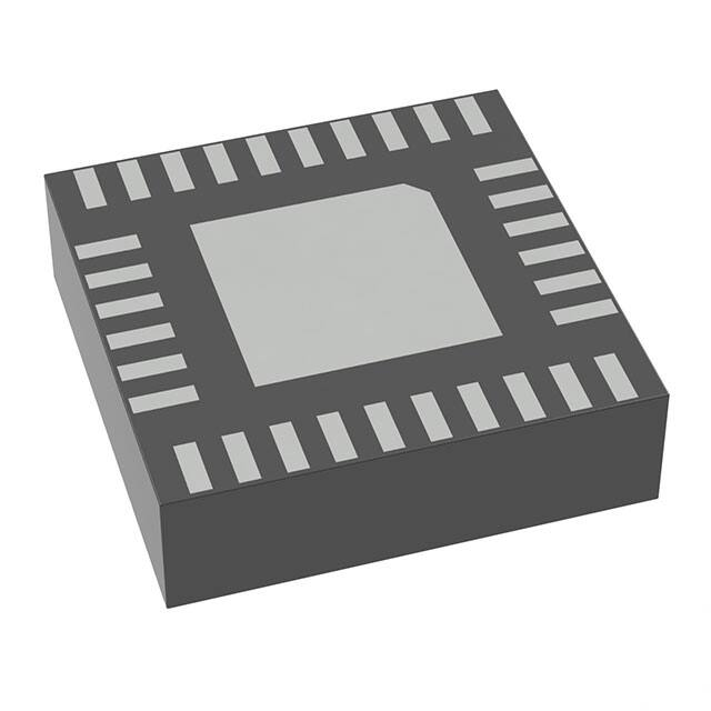

MPM54304 4V to 16V Input, Quad-Output Power Module with I2C and MTP in Ultra-Thin Package DESCRIPTION FEATURES The MPM54304 is a quad-output, DC/DC stepdown power module with up to 3A per output (channel 1 and 2) and 2A per output (channel 3 and 4). Channels 1 and 2 can be paralleled to provide up to 6A of current, and channels 3 and 4 can be paralleled to provide up to 4A of current.   4V to 16V Operating Input Range Wide Output Voltage: o I2C Programmable: 0.55V to 5.4V o External Resistor Divider: 0.6V to 7V or VIN * DMAX if VIN < 7V Channel 1 and 2: 3A Continuous Current Channel 3 and 4: 2A Continuous Current Interleaved Operation Configurable, Multi-Functional GPIO Pin I2C and Configurable Parameters: o Paralleling Channel 1 and 2 o Paralleling Channel 3 and 4 o Switching Frequency o Output Voltage o Over-Current and Over-Voltage Protection Threshold o Power-On and Power-Off Sequencing o Forced PWM or Auto-PWM/PFM     Operating over a 4V to 16V input voltage range, the MPM54304 can support an output voltage range of 0.55V to 7V. The output voltage can be set via the I2C or external resistor divider. The module has internal auto-compensation, which eliminates the need for an external compensation network. The MPM54304 employs a constant-on-time (COT) control scheme to provide ultra-fast load transient responses. This minimizes the required output capacitance. APPLICATIONS The MPM54304 features a two-time, nonvolatile programmable memory. Its operating parameters are programmable via the I2C.    The MPM54304 requires a minimal number of external components, and is available in ultrathin LGA-33 (7mmx7mmx2mm) package. FPGA Power Supplies Multi-Rail Power Systems MCU/DSP Power Supplies All MPS parts are lead-free, halogen-free, and adhere to the RoHS directive. For MPS green status, please visit the MPS website under Quality Assurance. “MPS”, the MPS logo, and “Simple, Easy Solutions” are trademarks of Monolithic Power Systems, Inc. or its subsidiaries. TYPICAL APPLICATION SW1 4V to 16V SW2 FB1 SGND1 VIN C1 22µF GND 0.85V/3A VOUT1 VOUT1 VOUT2 FB2 C4 22µFx2 1V/3A VOUT2 C5 22µFx2 VIN C2 22µF MPM54304 VOUT3 GND FB3 SGND2 I2 C { 1.8V/2A VOUT3 C6 22µF Note: SCL SDA VOUT4 FB4 EN VCC AGND 3.3V/2A VOUT4 C7 22µF GPIO C3 1µF 1) Maximum current per rail is subject to total package power loss derating. See the Max PLOSS vs. Temperature Curve on page 11 for the maximum allowed package power loss rating. The total package power loss is determined as the sum of power loss of all rails: PLOSS = (PLOSS1 + PLOSS2 + … + PLOSSn), where n represents the utilized number of rails. 4V to 16V Input and Quad Output MPM54304 Rev. 1.0 www.MonolithicPower.com 11/6/2019 MPS Proprietary Information. Patent Protected. Unauthorized Photocopy and Duplication Prohibited. © 2019 MPS. All Rights Reserved. 1 MPM54304 – QUAD-OUTPUT POWER MODULE WITH I2C ORDERING INFORMATION Part Number* MPM54304GMN-XXXX MPM54304GMN-0000 MPM54304GMN-0001 MPM54304GMN-0002 MPM54304GMN-0003 MPM54304GMN-0004 Package LGA-33 (7mmx7mm) LGA-33 (7mmx7mm) LGA-33 (7mmx7mm) LGA-33 (7mmx7mm) LGA-33 (7mmx7mm) LGA-33 (7mmx7mm) Top Marking Note MSL Rating See Below See Below Pre-programmed output voltage or I2C adjustable See Below Set output voltage with resistor divider See Below See Below See Below Set output voltage with resistor divider; buck 1 & 2 in parallel Set output voltage with resistor divider; buck 3 & 4 parallel Set output voltage with resistor divider; buck 1 & 2, buck 3 & 4 in parallel 3 * -XXXX is the configuration code identifier for register settings stored in the MTP memory. For default configuration with an I2C programmed output voltage, the code is “0000”. See Tables 3 to 12 on page 42 for the detailed configuration information and the register map of codes “0001” to “0004”. TOP MARKING MPS: MPS prefix YY: Year code WW: Week code MP54304: Part number LLLLLLLLL: Lot number M: Module MPM54304 Rev. 1.0 www.MonolithicPower.com 11/6/2019 MPS Proprietary Information. Patent Protected. Unauthorized Photocopy and Duplication Prohibited. © 2019 MPS. All Rights Reserved. 2 MPM54304 – QUAD-OUTPUT POWER MODULE WITH I2C PACKAGE REFERENCE TOP VIEW VOUT3 FB3 SGND2 VIN VIN GND GPIO VCC 32 VOUT3 FB4 VOUT4 23 1 22 GND GND GND SDA 33 GND SCL EN GND FB2 VOUT4 FB1 6 17 7 GND SGND1 16 VOUT2 VOUT2 GND SW2 SW1 GND VOUT1 VOUT1 GND LGA-33 (7mmx7mm) MPM54304 Rev. 1.0 www.MonolithicPower.com 11/6/2019 MPS Proprietary Information. Patent Protected. Unauthorized Photocopy and Duplication Prohibited. © 2019 MPS. All Rights Reserved. 3 MPM54304 – QUAD-OUTPUT POWER MODULE WITH I2C PIN FUNCTIONS Pin # Name 1, 32 VOUT3 2, 5, 7, 10, 13, 16, 20, 21, 27, 33 3 4 Power ground. Connect to GND with wide copper plane and sufficient vias. SDA SCL I2C data signal pin. I2C clock signal pin. Feedback of buck 2. Connect buck 2’s output directly to this pin or through a feedback resistor divider. Channel 2 output. Buck 2 switching node. Connect to SW1 in parallel mode. Buck 1 switching node. Connect to SW2 in parallel mode. FB2 8, 9 11 12 VOUT2 SW2 SW1 18 19 22, 23 24 25 26 Channel 3 output. GND 6 14, 15 17 Description Channel 1 output. Signal ground 1. Channel 1 and 2 output voltage feedback sense ground. Feedback of buck 1. Connect buck 1’s output directly to this pin or through a FB1 feedback resistor divider. Enable control. Apply a logic high voltage on this pin to enable the IC; pull EN/SYNCI to logic low to disable the IC. The EN pin has a 2MΩ internal pullEN/SYNCI down resistor. Apply a clock on EN/SYNCI to synchronize the switching frequency to the external clock. VOUT4 Channel 4 output. Feedback of buck 4. Connect buck 4’s output directly to this pin or through a FB4 feedback resistor divider. Internal 3.3V LDO output. The driver and control circuits are powered from VCC this voltage. Connect a 1µF decoupling capacitor to this pin. General purpose input/output (GPIO) pin – ADD mode. When the MTP/I2C configure this pin as “ADD,” the pin can program four different I2C slave addresses. General purpose input/output (GPIO) pin – PG mode. When the MTP/I2C configure this pin as “PG,” it is the open-drain power good output. Pull low when any enabled regulator falls below the UV threshold or when all regulators are disabled. GPIO General purpose input/output (GPIO) pin – Output Port mode. When the MTP/I2C configure this pin as “Output Port,” it outputs high/low logics determined by the related register. Open-drain structure. General purpose input/output (GPIO) pin – SYNCO mode. When the MTP/I2C configure this pin as “SYNCO,” it is the sync output. Phase-shift the clock output to sync another device’s switching frequency. VOUT1 SGND1 28, 29 30 VIN SGND2 31 FB3 Supply voltage input. Requires a ceramic capacitor to decouple the input rail. Signal ground 2. Channel 3 and 4 output voltage feedback sense ground. Feedback of buck 3. Connect buck 3’s output directly to this pin or through a feedback resistor divider. MPM54304 Rev. 1.0 www.MonolithicPower.com 11/6/2019 MPS Proprietary Information. Patent Protected. Unauthorized Photocopy and Duplication Prohibited. © 2019 MPS. All Rights Reserved. 4 MPM54304 – QUAD-OUTPUT POWER MODULE WITH I2C θJA θJC ABSOLUTE MAXIMUM RATINGS (2) Thermal Resistance (6) VIN ................................................ -0.3V to +18V VSWx ................................................................... -0.6V (-7V for UVLO Rising Power Off Detect power-on factor Disable power-on factor detection PG switches low Power-Off Sequence Power-On Sequence Power On Detect poweroff factor DC/DC turns on sequentially depending on the I2C register setting PG switches high Figure 6: Power Control State Machine Diagram State Machine Description The state machine has the following statuses: Shutdown The PMIC’s EN/SYNCI pin is pulled low. All of the PMIC’s switcher functions are disabled, but the I2C and MTP are live as long as the input is above the UVLO threshold. No Supply The PMIC’s input pin has a UVLO detection circuit. If input voltage VIN is below the UVLO rising threshold, all PMIC functions are disabled. Power Off All buck regulators are turned off. In this state, the PMIC is always monitoring the power-on factor. Once a power-on factor is detected, it changes to the power-on sequence state. Power-On Sequence Buck 1 to buck 4 turn on sequentially, according to the order programmed by the MTP e-fuse. If a power-off factor is detected during the poweron sequence, the PMIC returns to its power-off state. Power On Buck 1 to buck 4 are turned on. The PG output switches high. In this state, the PMIC is always monitoring the power-off factor. Power-Off Sequence The PMIC changes to this state when it detects a power-off factor in the power-on state. Buck 1 to buck 4 either turn off sequentially in the reverse order of the power-on sequence, or turn off at the same time, depending on the Shutdown_Delay_EN bit’s setting. MPM54304 Rev. 1.0 www.MonolithicPower.com 11/6/2019 MPS Proprietary Information. Patent Protected. Unauthorized Photocopy and Duplication Prohibited. © 2019 MPS. All Rights Reserved. 32 MPM54304 – QUAD-OUTPUT POWER MODULE WITH I2C Power-On Factors The PMIC has the following power-on factors: die temperature exceeding the thermal protection threshold. Once the die’s temperature decreases, the PMIC enters the power-on sequence again. EN/SYNCI Pin If the EN/SYNCI pin is pulled high, the system changes from its power-off state to the poweron sequence. The related EN bit determines each buck’s on or off state. Power-On Sequence There are four slots for power-on sequence timing. All buck regulators can be programmed with 0 to 2 time slots by the MTP e-fuse (see Figure 7). Thermal Recovery The part may be in its power-off state due to the Time Slot Number 0 1 2 3 VIN1, VIN2, VCC EN All registers and MTP are enabled I2C Interface DC/DC Outputs 1ms 1ms 200µs PG Shutdown No Supply 1ms Power Off Figure 7: Power-On Sequence Buck Regulators Turn On The MPM54304 provides a programmable power-on sequence. The MTP configuration tables on page 42 have bits to set the time slot number (start-up delay timer) for each channel. The default power-on sequence is shown in the default MTP configuration table (see page 42). Power-Off Factor EN/SYNCI Pin Hardware-Initiated Power-Off The MPM54304 supports controlled power-off the through the EN/SYNCI pin. When the EN/SYCNI pin is pulled low, the system enters the power-off sequence. MPM54304 Rev. 1.0 www.MonolithicPower.com 11/6/2019 MPS Proprietary Information. Patent Protected. Unauthorized Photocopy and Duplication Prohibited. © 2019 MPS. All Rights Reserved. 33 MPM54304 – QUAD-OUTPUT POWER MODULE WITH I2C Power-Off Sequence VIN1, VIN2, VCC Time Slot Number 3 2 1 0 UVLO EN turn-on signal is blanked EN DC/DC Outputs 1ms 1ms 1ms PG Power On Power-Off Sequence Power Off No Supply Figure 8: Power-Off Sequence when Shutdown_Delay_EN = 1 PG is pulled low before the device starts to turn off. The DC/DC power-off sequence is in the reverse order of the power-on sequence when Shutdown_Delay_EN is set to 1. In order to fully discharge the output voltage, the EN signal is blanked during the power-off VIN1, VIN2, VCC sequence period. Within this power-off sequence period, the MPM54304 continues working in output discharge mode regardless of whether the external EN/SYNCI pin is pulled high or low. Time Slot Number UVLO EN turn-on function is blanked EN All DC/DC Outputs PG Power On Power-Off Sequence No Supply Figure 9: Power-Off Sequence when Shutdown_Delay_EN = 0 MPM54304 Rev. 1.0 www.MonolithicPower.com 11/6/2019 MPS Proprietary Information. Patent Protected. Unauthorized Photocopy and Duplication Prohibited. © 2019 MPS. All Rights Reserved. 34 MPM54304 – QUAD-OUTPUT POWER MODULE WITH I2C All the DC/DC outputs power off at the same time when Shutdown_Delay_EN is set to 0. Shutdown Sequence When the input voltage is below the UVLO falling threshold or the IC is over-temperature, the PMIC enters the shutdown sequence immediately. All the DC/DC regulators turn off at the same time (see Figure 10). Detect shutdown event DC/DC1 ... DC/DC4 PG Figure 10: Shutdown Sequence Thermal Warning and Shutdown Thermal warning and shutdown prevent the part from operating at exceedingly high temperatures. When the silicon die temperature exceeds 120°C, the MPM54304 sets the OT WARNING bit to 1. If the die temperature exceeds 160°C, the system begins the shutdown sequence. When the temperature recovers to 140°C, the regulator begins the power-on sequence again. MPM54304 Rev. 1.0 www.MonolithicPower.com 11/6/2019 MPS Proprietary Information. Patent Protected. Unauthorized Photocopy and Duplication Prohibited. © 2019 MPS. All Rights Reserved. 35 MPM54304 – QUAD-OUTPUT POWER MODULE WITH I2C I2C INTERFACE I2C Serial Interface Description The I2C is a two-wire, bidirectional serial interface, consisting of a data line (SDA) and a clock line (SCL). The lines are externally pulled to a bus voltage when they are idle. Connecting to the line, a master device generates the SCL signal and device address, then arranges the communication sequence. The MPM54304 interface is an I2C slave. The I2C interface adds flexibility to the power supply solution. The output voltage, transition slew rate, and other parameters can be instantaneously controlled by the I2C interface. Data Validity One clock pulse is generated for each data bit transferred. The data on the SDA line must be stable during the high period of the clock. The high or low state of the data line can only change when the clock signal on the SCL line is low (see Figure 11). Data line Stable; Data valid Change of data allowed after a stop condition. The bus stays busy if a repeated start (Sr) is generated instead of a stop condition. The start and repeated start conditions are functionally identical. Transfer Data Every byte put on the SDA line must be 8 bits long. Each byte has to be followed by an acknowledge (ACK) bit. The acknowledgerelated clock pulse is generated by the master. The transmitter releases the SDA line (high) during the acknowledge clock pulse. The receiver must pull down the SDA line during the acknowledge clock pulse so that it remains stable low during the high period of this clock pulse. Figure 13 shows the format that data transfers follow. After the start condition, a slave address is sent. This address is 7 bits long, followed by an 8th data direction bit (R/W). A 0 indicates a transmission (write), and a 1 indicates a request for data (read). A data transfer is always terminated by a stop condition generated by the master. However, if a master still wishes to communicate on the bus, it can generate a repeated start condition and address another slave without first generating a stop condition. Figure 11: Bit Transfer on the I2C Bus The start (S) and stop (P) commands are signaled by the master device, which signifies the beginning and the end of the I2C transfer. A start condition is defined as the SDA signal transitioning from high to low while the SCL is high. A stop condition is defined as the SDA signal transitioning from low to high while the SCL is high (see Figure 12). Start Condition Stop Condition Figure 12: Start and Stop Conditions Start and stop conditions are always generated by the master. The bus is considered to be busy after a start condition. The bus is considered to be free again a minimum of 4.7μs 1To7 Start Condition 8 9 1To7 8 9 1To7 8 9 Address Stop Condition Figure 13: A Complete Data Transfer The MPM54304 includes a full I2C slave controller. The I2C slave fully complies with the I2C specification requirements. It requires a start condition, a valid I2C address, a register address byte, and a data byte for a single data update. After receipt of each byte, the MPM54304 acknowledges by pulling the SDA line low during the high period of a single clock pulse. A valid I2C address selects the MPM54304. The MPM54304 then performs an update on the falling edge of the LSB byte. Figure 14 shows examples of an I2C write and read sequence. MPM54304 Rev. 1.0 www.MonolithicPower.com 11/6/2019 MPS Proprietary Information. Patent Protected. Unauthorized Photocopy and Duplication Prohibited. © 2019 MPS. All Rights Reserved. 36 MPM54304 – QUAD-OUTPUT POWER MODULE WITH I2C 8 bits S 8 bits Slave Address WR A 8 bits Register Address K A Write Data A P Master to Slave A = Acknowledge (SDA = Low) S = Start Condition WR Write = 0 Slave to Master NA = NOT Acknowledge (SDA = High) P = Stop Condition RD Read = 1 Figure 14a: I2C Write Example – Write Single Register S Slave Address 8 bits 8 bits 8 bits WR A Register Address K A Write Data K A Write Data K + 1 A Write Data K + N A P Multi-byte write executed from current register location (the read-only register will be skipped) Master to Slave A = Acknowledge (SDA = Low) S = Start Condition WR Write = 0 Slave to Master NA = NOT Acknowledge (SDA = High) P = Stop Condition RD Read = 1 Figure 14b: I2C Write Example – Write Multi-Register 8 bits S Slave Address 8 bits WR A Register Address K 8 bits 8 bits A Register address to read specified Sr Slave Address RD A Read Data K NA P Read register data from current register location Master to Slave A = Acknowledge (SDA = Low) S = Start Condition Slave to Master NA = NOT Acknowledge (SDA = High) P = Stop Condition Sr = Repeat Start Condition WR Write = 0 RD Read = 1 Figure 14c: I2C Read Example – Read Single Register MPM54304 Rev. 1.0 www.MonolithicPower.com 11/6/2019 MPS Proprietary Information. Patent Protected. Unauthorized Photocopy and Duplication Prohibited. © 2019 MPS. All Rights Reserved. 37 MPM54304 – QUAD-OUTPUT POWER MODULE WITH I2C APPLICATION INFORMATION Internal Inductor Fixed inductors in the module are 1µH (channels 1 and 2) and 2.2µH (channels 3 and 4). Selecting the Input Capacitor The step-down converter has a discontinuous input current, and requires a capacitor to supply AC current to the converter while maintaining the DC input voltage. Use low-ESR capacitors for the best performance. Ceramic capacitors with X5R or X7R dielectrics are recommended because of their low ESR and small temperature coefficients. For most applications, a 22µF capacitor is sufficient. Since C1 absorbs the input switching current, it requires an adequate ripple current rating. The RMS current in the input capacitor can be estimated with Equation (2): IC1  ILOAD  VOUT  VOUT   1 VIN  VIN  (2) The worst-case condition occurs at VIN = 2VOUT, calculated with Equation (3): IC1  ILOAD 2 (3) For simplification, choose an input capacitor with an RMS current rating greater than half of the maximum load current. The input capacitor can be electrolytic, tantalum, or ceramic. When using electrolytic or tantalum capacitors, add a small, high-quality ceramic capacitor (e.g. 0.1μF) as close to the IC as possible. When using ceramic capacitors, ensure that they have enough capacitance to provide sufficient charge to prevent excessive voltage ripple at the input. The input voltage ripple caused by the capacitance can be estimated with Equation (4): VIN  IOUT V V  OUT  (1  OUT ) fSW  CIN VIN VIN Selecting the Step-Down Regulator Output Capacitor The output capacitor for the step-down regulator maintains the DC output voltage. Use ceramic, tantalum, or low-ESR electrolytic capacitors. For best results, use low-ESR capacitors to keep the output voltage ripple low. The output voltage ripple can be estimated with Equation (5): VOUT  VOUT V 1  (1  OUT )  (RESR  ) fSW  L VIN 8  fSW  COUT (5) Where L1 is the inductor value, and RESR is the equivalent series resistance (ESR) value of the output capacitor. For ceramic capacitors, the capacitance dominates the impedance at the switching frequency and causes the majority of the output voltage ripple. For simplification, the output voltage ripple can be estimated with Equation (6): VOUT  VOUT V  (1  OUT ) 8  fSW 2  L  COUT VIN (6) For tantalum or electrolytic capacitors, the ESR dominates the impedance at the switching frequency. For simplification, the output ripple can be estimated with Equation (7): VOUT  VOUT V  (1  OUT )  RESR fSW  L VIN (7) The characteristics of the output capacitor also affect the stability of the regulation. (4) MPM54304 Rev. 1.0 www.MonolithicPower.com 11/6/2019 MPS Proprietary Information. Patent Protected. Unauthorized Photocopy and Duplication Prohibited. © 2019 MPS. All Rights Reserved. 38 MPM54304 – QUAD-OUTPUT POWER MODULE WITH I2C PCB Layout Guidelines (13) Efficient PCB layout is critical for stable operation. A 4-layer layout is recommended to achieve better thermal performance. For best results, refer to Figure 15 and follow the guidelines below: 1. Keep the power loop as small as possible. 2. Use a large ground plane to connect directly to PGND. If the bottom layer is a ground plane, add vias near PGND. 3. Ensure the high-current paths at GND and VIN have short, direct, and wide traces. 4. Place the ceramic input capacitor as close to the device as possible. 5. Keep the input capacitor and IN as short and wide as possible. Figure 15: Recommended PCB Layout Notes: 13) The recommended layout is based on the Typical Application Circuit section on page 40. 6. Place the VCC capacitor as close to the VCC and GND pins as possible. 7. Connect VIN, VOUT, and GND to a large copper area to improve thermal performance and long-term reliability. 8. Separate the input GND area from other GND areas on the top layer, and connect them together on the internal layers and bottom layer through multiple vias. 9. Ensure there is an integrated GND area on the internal layer or bottom layer. 10. Use multiple vias to connect the power planes to internal layers. MPM54304 Rev. 1.0 www.MonolithicPower.com 11/6/2019 MPS Proprietary Information. Patent Protected. Unauthorized Photocopy and Duplication Prohibited. © 2019 MPS. All Rights Reserved. 39 MPM54304 – QUAD-OUTPUT POWER MODULE WITH I2C TYPICAL APPLICATION CIRCUITS SW1 SW2 VOUT1 VOUT1 = 0.85V C4 22µFx2 FB1 SGND1 VIN1 = 4V to 16V VIN C1 22µF VOUT2 GND VOUT2 = 1V C5 22µFx2 FB2 VIN C2 22µF MPM54304 GND VOUT3 = 1.8V VOUT3 C6 22µF FB3 SGND2 I2C { SCL SDA VOUT4 VOUT4 = 3.3V C7 22µF FB4 EN VCC AGND GPIO C3 1µF Figure 16: 4V to 16V Input and Quad-Output SW1 SW2 VOUT1 VOUT1 = 0.85V R1 FB1 VIN = 4V to 16V C1 22µF C4 22µFx2 R1A VIN SGND1 GND VOUT2 VOUT2 = 1V R2 FB2 R2A C5 22µFx2 VIN C2 22µF MPM54304 GND VOUT3 = 1.8V VOUT3 R3 FB3 R3A I2C { SCL SGND2 SDA VOUT4 R4 FB4 R4A EN VCC AGND C6 22µF VOUT4 = 3.3V C7 22µF GPIO C3 1µF Figure 17: 4V to 16V Input and Quad-Output with External Divider MPM54304 Rev. 1.0 www.MonolithicPower.com 11/6/2019 MPS Proprietary Information. Patent Protected. Unauthorized Photocopy and Duplication Prohibited. © 2019 MPS. All Rights Reserved. 40 MPM54304 – QUAD-OUTPUT POWER MODULE WITH I2C TYPICAL APPLICATION CIRCUITS (continued) SW1 SW2 VOUT1 FB1 VIN1 = 4V to 16V SGND1 C4 22µFx2 VIN C1 22µF VOUT2 GND FB2 C5 22µFx2 VIN C2 22µF MPM54304 GND VOUT3 FB3 SGND2 I2C { C6 22µF SCL SDA VOUT4 FB4 EN VCC AGND C7 22µF GPIO C3 1µF Figure 18: 4V to 16V Input, Dual-Output with Parallel Operation Mode MPM54304 Rev. 1.0 www.MonolithicPower.com 11/6/2019 MPS Proprietary Information. Patent Protected. Unauthorized Photocopy and Duplication Prohibited. © 2019 MPS. All Rights Reserved. 41 MPM54304 – QUAD-OUTPUT POWER MODULE WITH I2C DEFAULT MTP CONFIGURATION Table 3: 0000 Suffix Code Configuration OTP Items Output Voltage Set Method Output Voltage Initial On/Off Mode Soft-Start Delay Time Slot Soft-Start Time (VO = 0% to 100%) Valley Current Limit Buck Output Discharge EN Buck Output Limit EN Buck Parallel Mode Operation Switching Frequency VIN UVLO Rising GPIO Shutdown Delay EN PG Delay Time Software Initial I2C Slave Address MTP Configure Code Buck 1 Buck 2 Buck 3 I2C I2C I2C Buck 4 I2C 1V 3.3V 1.8V 1.5V On On On On FCCM FCCM FCCM FCCM 0ms 3ms 1ms 2ms 1ms 1.6ms 1.1ms 0.9ms 4.2A 3A 2A 3A Enabled Enabled Enabled Enabled Enabled Disabled Disabled Disabled Unparalleled Unparalleled 800kHz 4.5V PG Enabled 0.2ms 0x68 0x00 Table 4: 0000 Suffix Code Register Value Suffix Code Register Hex Value 0000 0x40 02h 0000 0x41 EBh 0000 0x42 2Dh 0000 0x43 33h 0000 0x44 5Dh 0000 0x45 B7h 0000 0x46 11h 0000 0x47 4Fh 0000 0x48 7Dh 0000 0x49 21h 0000 0x4A 59h 0000 0x4B 5Fh 0000 0x4C F3h 0000 0x4D 68h 0000 0x4E 40h 0000 0x4F 00h MPM54304 Rev. 1.0 www.MonolithicPower.com 11/6/2019 MPS Proprietary Information. Patent Protected. Unauthorized Photocopy and Duplication Prohibited. © 2019 MPS. All Rights Reserved. 42 MPM54304 – QUAD-OUTPUT POWER MODULE WITH I2C Table 5: 0001 Suffix Code Configuration Suffix Code: 0001 OTP Items Output Voltage Set Method FB Voltage Initial On/Off Mode Buck 1 Buck 2 Buck 3 Buck 4 External divider External divider External divider External divider 0.6V 0.6V 0.6V 0.6V On On On On FCCM FCCM FCCM FCCM Soft-Start Delay Time Slot # Soft-Start Time (VO = 0% to 100%) Valley Current Limit 0ms 2ms 1ms 3ms 0.9ms 0.9ms 0.9ms 0.9ms 4.2A 4.2A 3A 3A Buck Output Discharge EN Enabled Enabled Enabled Enabled Buck Output Limit EN Enabled Enabled Disabled Disabled Buck Parallel Mode Operation Unparalleled Switching Frequency Unparalleled 800kHz VIN UVLO Rising 4.5V GPIO PG Shutdown Delay EN Enabled PG Delay Time Software Initial I2C Slave Address MTP Configure Code 0.2ms MTP Revision Number 0x00 0x68 0x01 Table 6: 0001 Suffix Code Register Value Suffix Code Register Hex Value 0001 0x40 03h 0001 0x41 EBh 0001 0x42 05h 0001 0x43 23h 0001 0x44 EDh 0001 0x45 05h 0001 0x46 13h 0001 0x47 5Fh 0001 0x48 05h 0001 0x49 33h 0001 0x4A 5Fh 0001 0x4B 05h 0001 0x4C F3h 0001 0x4D 68h 0001 0x4E 40h 0001 0x4F 01h MPM54304 Rev. 1.0 www.MonolithicPower.com 11/6/2019 MPS Proprietary Information. Patent Protected. Unauthorized Photocopy and Duplication Prohibited. © 2019 MPS. All Rights Reserved. 43 MPM54304 – QUAD-OUTPUT POWER MODULE WITH I2C Table 7: 0002 Suffix Code Configuration Suffix Code: 0002 OTP Items Output Voltage Set Method FB Voltage Initial On/Off Mode Buck 1 Buck 2 Buck 3 Buck 4 External divider External divider External divider External divider 0.6V 0.6V 0.6V 0.6V On On On On FCCM FCCM FCCM FCCM Soft-Start Delay Time Slot # Soft-Start Time (VO = 0% to 100%) Valley Current Limit 0ms 0ms 1ms 3ms 0.9ms 0.9ms 0.9ms 0.9ms 4.2A 4.2A 3A 3A Buck Output Discharge EN Enabled Enabled Enabled Enabled Buck Output Limit EN Enabled Enabled Disabled Disabled Buck Parallel Mode Operation Paralleled Switching Frequency Unparalleled 800kHz VIN UVLO Rising 4.5V GPIO PG Shutdown Delay EN Enabled PG Delay Time Software Initial I2C Slave Address MTP Configure Code 0.2ms MTP Revision Number 0x00 0x68 0x02 Table 8: 0002 Suffix Code Register Value Suffix Code Register Hex Value 0002 0x40 03h 0002 0x41 EBh 0002 0x42 05h 0002 0x43 23h 0002 0x44 EDh 0002 0x45 05h 0002 0x46 13h 0002 0x47 5Fh 0002 0x48 05h 0002 0x49 33h 0002 0x4A 5Fh 0002 0x4B 05h 0002 0x4C F3h 0002 0x4D 68h 0002 0x4E 41h 0002 0x4F 02h MPM54304 Rev. 1.0 www.MonolithicPower.com 11/6/2019 MPS Proprietary Information. Patent Protected. Unauthorized Photocopy and Duplication Prohibited. © 2019 MPS. All Rights Reserved. 44 MPM54304 – QUAD-OUTPUT POWER MODULE WITH I2C Table 9: 0003 Suffix Code Configuration Suffix Code: 0003 OTP Items Output Voltage Set Method FB Voltage Initial On/Off Mode Buck 1 Buck 2 Buck 3 Buck 4 External divider External divider External divider External divider 0.6V 0.6V 0.6V 0.6V On On On On FCCM FCCM FCCM FCCM Soft-Start Delay Time Slot # Soft-Start Time (VO = 0% to 100%) Valley Current Limit 0ms 2ms 1ms 1ms 0.9ms 0.9ms 0.9ms 0.9ms 4.2A 4.2A 3A 3A Buck Output Discharge EN Enabled Enabled Enabled Enabled Buck Output Limit EN Enabled Enabled Disabled Disabled Buck Parallel Mode Operation Unparalleled Switching Frequency Paralleled 800kHz VIN UVLO Rising 4.5V GPIO PG Shutdown Delay EN Enabled PG Delay Time Software Initial I2C Slave Address MTP Configure Code 0.2ms MTP Revision Number 0x00 0x68 0x03 Table 10: 0003 Suffix Code Register Value Suffix Code Register Hex Value 0003 0x40 03h 0003 0x41 EBh 0003 0x42 05h 0003 0x43 23h 0003 0x44 EDh 0003 0x45 05h 0003 0x46 13h 0003 0x47 5Fh 0003 0x48 05h 0003 0x49 33h 0003 0x4A 5Fh 0003 0x4B 05h 0003 0x4C F3h 0003 0x4D 68h 0003 0x4E 42h 0003 0x4F 03h MPM54304 Rev. 1.0 www.MonolithicPower.com 11/6/2019 MPS Proprietary Information. Patent Protected. Unauthorized Photocopy and Duplication Prohibited. © 2019 MPS. All Rights Reserved. 45 MPM54304 – QUAD-OUTPUT POWER MODULE WITH I2C Table 11: 0004 Suffix Code Configuration Suffix Code: 0004 OTP Items Output Voltage Set Method FB Voltage Initial On/Off Mode Buck1 Buck2 Buck3 Buck4 External divider External divider External divider External divider 0.6V 0.6V 0.6V 0.6V On On On On FCCM FCCM FCCM FCCM Soft-Start Delay Time Slot # Soft-Start Time (VO = 0% to 100%) Valley Current Limit 0ms 0ms 1ms 1ms 0.9ms 0.9ms 0.9ms 0.9ms 4.2A 4.2A 3A 3A Buck Output Discharge EN Enabled Enabled Enabled Enabled Buck Output Limit EN Enabled Enabled Enabled Disabled Buck Parallel Mode Operation Paralleled Switching Frequency Paralleled 800kHz VIN UVLO Rising 4.5V GPIO PG Shutdown Delay EN Enabled PG Delay Time Software Initial I2C Slave Address MTP Configure Code 0.2ms MTP Revision Number 0x00 0x68 0x04 Table 12: 0004 Suffix Code Register Value Suffix Code Register Hex Value 0004 0x40 03h 0004 0x41 EBh 0004 0x42 05h 0004 0x43 23h 0004 0x44 EDh 0004 0x45 05h 0004 0x46 13h 0004 0x47 5Fh 0004 0x48 05h 0004 0x49 33h 0004 0x4A 5Fh 0004 0x4B 05h 0004 0x4C F3h 0004 0x4D 68h 0004 0x4E 43h 0004 0x4F 04h MPM54304 Rev. 1.0 www.MonolithicPower.com 11/6/2019 MPS Proprietary Information. Patent Protected. Unauthorized Photocopy and Duplication Prohibited. © 2019 MPS. All Rights Reserved. 46 MPM54304 – QUAD-OUTPUT POWER MODULE WITH I2C PACKAGE INFORMATION LGA-33 (7mmx7mm) PIN 1 ID MARKING PIN 1 ID 0.30X45º TYP PIN 1 ID INDEX AREA BOTTOM VIEW TOP VIEW SIDE VIEW NOTE: 1) ALL DIMENSIONS ARE IN MILLIMETERS. 2) LEAD COPLANARITY SHALL BE 0.10 MILLIMETERS MAX. 3) JEDEC REFERENCE IS MO-303. 4) DRAWING IS NOT TO SCALE. RECOMMENDED LAND PATTERN NOTICE: The information in this document is subject to change without notice. Please contact MPS for current specifications. Users should warrant and guarantee that third-party Intellectual Property rights are not infringed upon when integrating MPS products into any application. MPS will not assume any legal responsibility for any said applications. MPM54304 Rev. 1.0 MonolithicPower.com 11/6/2019 MPS Proprietary Information. Patent Protected. Unauthorized Photocopy and Duplication Prohibited. © 2019 MPS. All Rights Reserved. 47
