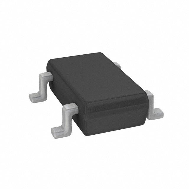

MPQ2013AGJE-C672-Z 数据手册
MPQ2013A The Future of Analog IC Technology DESCRIPTION The MPQ2013A is a low power linear regulator that supplies power to systems with high voltage batteries. It includes a wide 2.5V to 40V input range, low dropout voltage and low quiescent supply current. The low quiescent current and low dropout voltage allow operations at extremely low power levels. Therefore, the MPQ2013A are ideal for the low power microcontrollers and the battery-powered equipments. The MPQ2013A provides wide variety of fixed output voltage options (if request): 1.8V, 1.9V, 2.3V, 2.5V, 3.0V, 3.3V, 3.45V, 5.0V; and also provides the output adjustable option (from 1.215V to 15V). The regulator output current is internally limited and the device is protected against over-load and over-temperature conditions. The MPQ2013A also includes thermal shutdown and current limiting fault protection, and is available in QFN-6 (2mmx2mm), and QFN-8 (3mmx3mm) packages. 40V, 150mA, Low Quiescent Current Linear Regulator AEC-Q100 Qualified FEATURES             2.5V to 40V Input Range 3.3µA Quiescent Supply Current Stable With Low-value Output Ceramic Capacitor (> 0.47 μF) 150mA Specified Current for QFN-6 and QFN-8 Packages 620mV Dropout at 150mA Load Available in Fixed and Adjustable Output (1.215 V to 15 V) Versions Output ±2% Accuracy for QFN-8 Package Output ±4% Accuracy for QFN-6 Package Specified Current Limit Thermal Shutdown -40°C to +150°C Specified Junction Temperature Range Available in QFN-6 (2mmx2mm), or QFN-8 (3mmx3mm) Packages Available in AEC-Q100 Grade 1 APPLICATIONS      Industrial/Automotive Applications Portable/Battery-Powered Equipment Ultra low power Microcontrollers Cellular Handsets Medical Imaging All MPS parts are lead-free and adhere to the RoHS directive. For MPS green status, please visit MPS website under Products, Quality Assurance page. “MPS” and “The Future of Analog IC Technology” are registered trademarks of Monolithic Power Systems, Inc. TYPICAL APPLICATION Output Adjustable Version Output Fixed Version MPQ2013A Rev. 1.07 www.MonolithicPower.com 8/24/2017 MPS Proprietary Information. Patent Protected. Unauthorized Photocopy and Duplication Prohibited. © 2017 MPS. All Rights Reserved. 1 MPQ2013A - 40V, 150mA, LOW QUIESCENT CURRENT LINEAR REGULATOR, AEC-Q100 QUALIFIED ORDERING INFORMATION Part Number* MPQ2013AGQ MPQ2013AGQ-18 MPQ2013AGQ-25 MPQ2013AGQ-33 MPQ2013AGQ-5 MPQ2013AGQ-AEC1 MPQ2013AGQ-18-AEC1 MPQ2013AGQ-25-AEC1 MPQ2013AGQ-33-AEC1 MPQ2013AGQ-5-AEC1 Package QFN-8 (3mmx3mm) QFN-8 (3mmx3mm) QFN-8 (3mmx3mm) QFN-8 (3mmx3mm) QFN-8 (3mmx3mm) QFN-8 (3mmx3mm) QFN-8 (3mmx3mm) QFN-8 (3mmx3mm) QFN-8 (3mmx3mm) QFN-8 (3mmx3mm) Top Marking See Below * For Tape & Reel, add suffix –Z (e.g. MPQ2013AGQ–Z) EXPOSED PAD ON BACKSIDE CONNECT TO GND QFN-8 (3mmx3mm) TOP MARKING AJD: part code of MPQ2013AGQ; Y: year code; LLL: lot number; AZB: part code of MPQ2013AGQ-18; Y: year code; LLL: lot number; AQN: part code of MPQ2013AGQ-25; Y: year code; LLL: lot number; AJZ: part code of MPQ2013AGQ-33; Y: year code; LLL: lot number; ALJ: part code of MPQ2013AGQ-5; Y: year code; LLL: lot number; MPQ2013A Rev. 1.07 www.MonolithicPower.com 8/24/2017 MPS Proprietary Information. Patent Protected. Unauthorized Photocopy and Duplication Prohibited. © 2017 MPS. All Rights Reserved. 2 MPQ2013A - 40V, 150mA, LOW QUIESCENT CURRENT LINEAR REGULATOR, AEC-Q100 QUALIFIED ORDERING INFORMATION Part Number* MPQ2013AGG MPQ2013AGG-33 MPQ2013AGG-5 MPQ2013AGG-AEC1 MPQ2013AGG-33-AEC1 MPQ2013AGG-5-AEC1 Package QFN-6 (2mmx2mm) QFN-6 (2mmx2mm) QFN-6 (2mmx2mm) QFN-6 (2mmx2mm) QFN-6 (2mmx2mm) QFN-6 (2mmx2mm) Top Marking See Below * For Tape & Reel, add suffix –Z (e.g. MPQ2013AGG–Z) QFN-6 (2mmx2mm) TOP MARKING CD: part code of MPQ2013AGG; Y: year code; LLL: lot number; CP: part code of MPQ2013AGG-33; Y: year code; LLL: lot number; FR: part code of MPQ2013AGG-5; Y: year code; LLL: lot number; MPQ2013A Re v. 1.07 www.MonolithicPower.com 8/24/2017 MPS Proprietary Information. Patent Protected. Unauthorized Photocopy and Duplication Prohibited. © 2017 MPS. All Rights Reserved. 3 MPQ2013A - 40V, 150mA, LOW QUIESCENT CURRENT LINEAR REGULATOR, AEC-Q100 QUALIFIED ABSOLUTE MAXIMUM RATINGS (1) IN, EN .........................................-0.3V to +42V OUT ..............................................-0.3V to +17V FB .................................................-0.3V to +6V Junction Temperature ............................ +150C Lead Temperature ................................. +260C Storage Temperature ............... -65C to +150C (2) Continuous Power Dissipation (TA = +25°C) QFN-8(3mmx3mm) .................................. 2.08W QFN-6(2mmx2mm) .................................. 1.25W ESD SUSCEPTIBILITY (3) HBM (Human Body Model) ..........................2kV MM (Machine Model) ............................... 200V Recommended Operating Conditions (4) Supply Voltage VIN ........................... 2.5V to 40V Output Voltage VOUT .................... 1.215V to 15V Operating Temperature....................................... ............. TA = -40°C to +125°C, TA ≤ TJ ≤ +150°C Thermal Resistance (5) θJA θJC QFN-6 (2mmx2mm) ................ 80 ...... 16... C/W QFN-8 (3mmx3mm) ................ 48 ...... 11... C/W Notes: 1) Exceeding these ratings may damage the device. 2) The maximum allowable power dissipation is a function of the maximum junction temperature TJ (MAX), the junction-toambient thermal resistance θJA, and the ambient temperature TA. The maximum allowable continuous power dissipation at any ambient temperature is calculated by PD (MAX) = (TJ (MAX)-TA)/θJA. Exceeding the maximum allowable power dissipation will cause excessive die temperature, and the regulator will go into thermal shutdown. Internal thermal shutdown circuitry protects the device from permanent damage. 3) Devices are ESD sensitive. Handling precaution recommended. 4) The device is not guaranteed to function outside of its operating conditions. 5) Measured on JESD51-7, 4-layer PCB. MPQ2013A Rev. 1.07 www.MonolithicPower.com 8/24/2017 MPS Proprietary Information. Patent Protected. Unauthorized Photocopy and Duplication Prohibited. © 2017 MPS. All Rights Reserved. 4 MPQ2013A - 40V, 150mA, LOW QUIESCENT CURRENT LINEAR REGULATOR, AEC-Q100 QUALIFIED ELECTRICAL CHARACTERISTICS VEN=VIN, COUT = 1μF, TA = -40°C to +125°C, TA ≤ TJ ≤ +150°C, unless otherwise noted. Typical values are at TA = +25°C. Parameter Input Voltage Output Voltage Range GND Pin Current Symbol Condition VIN VOUT IGND Min Typ 2.5 1.215 MPQ2013AGQ, 0
