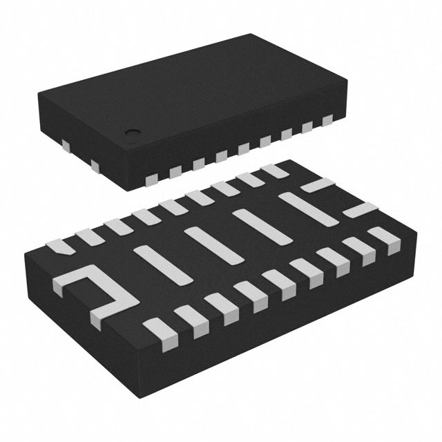

    是一款热插拔保护设备,旨在保护其输出端的电路免受输入端瞬态影响。它还能保护其输入端免受来自输出端的意外短路和瞬态影响。
MPQ5069GQV-AEC1-Z 数据手册
MPQ5069 7mΩ Protection Switch with Current Monitor for Automotive Battery Systems AEC-Q100 Qualified DESCRIPTION FEATURES The MPQ5069 is a hot-swap protection device designed to protect circuitry on its output from transients on its input. It also protects its input from undesired shorts and transients coming from its output.              During start-up, the slew rate at the output limits the inrush current. An external capacitor at the SS pin controls the slew rate. The maximum output load is current-limited using a sense FET topology whereby a low-power resistor from the ISET pin to ground controls the magnitude of the current limit. An internal charge pump drives the gate of the power device, allowing for a power FET with a very low on resistance of 7mΩ. The MPQ5069 includes an IMON option to produce a voltage proportional to the current through the power device, as set by a resistor from the IMON pin to ground. Integrated 7mΩ Power MOSFET Adjustable Current Limit (5A to 15A) Output Current Measurement ±10% Current Monitor Accuracy Fast Response (200ns) for Short Protection PG Detector and FLTB Indication PG Asserts Low when VIN = 0V Damaged MOSFET Detection External Soft Start Under-Voltage Lockout Thermal Protection Available in a QFN-22 (3mmx5mm) Package Available in AEC-Q100 Grade 1 APPLICATIONS     The MPQ5069’s fault protections include currentlimit protection, thermal shutdown, and damagedMOSFET detection. Both the current limit and thermal shutdown offer configurable auto-retry and latch-off mode. The device also features under-voltage protection. Automotive Infotainment Automotive Clusters Advanced Driver Assistance Systems Automotive Systems All MPS parts are lead-free, halogen-free, and adhere to the RoHS directive. For MPS green status, please visit the MPS website under Quality Assurance. “MPS”, the MPS logo, and “Simple, Easy Solutions” are trademarks of Monolithic Power Systems, Inc. or its subsidiaries. The MPQ5069 is available in a QFN-22 (3mmx5mm) package and is AEC-Q100 qualified. TYPICAL APPLICATION VIN 21-22 VOUT OUT 1 EN 13-20 VIN R1 2 COUT EN AUTO MPQ5069 PD FB 4 12 5V R3 11 R4 TIMER PG CT 5 R2 10 PG ISET FLTB RSET IMON SS 6 CSS 9 R5 FAULT 8 IMON GND 7 CMON RMON MPQ5069 Rev. 1.1 www.MonolithicPower.com 11/19/2020 MPS Proprietary Information. Patent Protected. Unauthorized Photocopy and Duplication Prohibited. © 2020 MPS. All Rights Reserved. 1 MPQ5069 – 7mΩ PROTECTION SWITCH WITH CURRENT MONITOR ORDERING INFORMATION Part Number* MPQ5069GQV-AEC1–Z Package QFN-22 (3mmx5mm) Top Marking See Below MSL Rating** 1 * For Tape & Reel, add suffix –Z (e.g. MPQ5069GQV-AEC1–Z). ** Moisture Sensitivity Level Rating TOP MARKING MP: MPS prefix Y: Year code W: Week code 5069: First four digits of the part number LLL: Lot number PACKAGE REFERENCE TOP VIEW EN 1 AUTO 2 N/C 3 TIMER 4 ISET 5 SS 6 VIN VIN 22 21 20 VOUT VIN 19 VOUT VIN 18 VOUT 17 VOUT VIN 16 VOUT 15 VOUT VIN GND 7 IMON 8 FLTB 9 14 VOUT 13 VOUT VIN 12 PD 10 11 PG FB QFN-22 (3mmx5mm) MPQ5069 Rev. 1.1 www.MonolithicPower.com 11/19/2020 MPS Proprietary Information. Patent Protected. Unauthorized Photocopy and Duplication Prohibited. © 2020 MPS. All Rights Reserved. 2 MPQ5069 – 7mΩ PROTECTION SWITCH WITH CURRENT MONITOR PIN FUNCTIONS Pin # Name Description Enable input. Pull the EN pin above its threshold enable the chip. Pull it below its threshold to shut down the chip. Auto-reset enable. Float or pull above 2.5V to enable auto-reset upon fault removal. Ground for the MPQ5069 to latch off when a fault occurs. Not connected. Float this pin in application. 1 EN 2 AUTO 3 NC 4 TIMER 5 ISET 6 SS 7 GND 8 IMON 9 FLTB 10 PG 11 FB 12 PD 13–20 21, 22, exposed pads OUT Output current monitor. Provides a voltage proportional to the current flowing through the power device. Place a resistor to ground to set the gain. Floating this pin is not recommended. Fault bar. This is an open-drain output that drives to ground when an over-current or a thermal shutdown occurs. Pull up to an external power supply through a 100kΩ resistor. Power good. This is an open-drain output. Pull up to an external power supply through a resistor. High = power good. Low indicates output is outside the UVLO window. PG starts to work when the pull-up supply is enabled, even if VIN and EN are still disabled. Feedback. An external resistor divider from the output sets the output voltage where the PG pin switches. The rising threshold is 0.6V, with a 60mV hysteresis. Output discharge. Connect to the output to provide a 500Ω load to discharge the output when VIN is below its UVLO threshold or the EN pin is within 0.6V of the rising threshold. Floating PD disables this function. Output. The output voltage is controlled by the IC. VIN Input power supply. Timer set. An external capacitor sets the hot-plug insertion time delay, fault timeout period, and restart time. Current-limit set. Place a resistor to ground to set the value of the current limit. Soft start. A connected external capacitor sets the soft-start time of the output voltage. The internal circuit controls the slew rate of the output voltage during start-up. Float this pin to set the soft-start time at its minimum of 1ms. Ground. MPQ5069 Rev. 1.1 www.MonolithicPower.com 11/19/2020 MPS Proprietary Information. Patent Protected. Unauthorized Photocopy and Duplication Prohibited. © 2020 MPS. All Rights Reserved. 3 MPQ5069 – 7mΩ PROTECTION SWITCH WITH CURRENT MONITOR θJA θJC ABSOLUTE MAXIMUM RATINGS (1) Thermal Resistance VIN .............................................. -0.3V to +36V VIN (Max load dump voltage) …………… +39V (2) OUT, PD ...................................... -0.3V to +30V All other pins ............................... -0.3V to +6.5V Continuous power dissipation (TA = 25°C) (3) ….. .. ..........................................................2.7W Power dissipation (TA = 25°C, 10ms single pulse) ….. ........................................................... 215W Maximum current (TA = 25°C)……………… 25A Junction temperature ............................... 150°C Lead temperature .................................... 260°C Storage temperature ................ -65°C to +150°C QFN-22 (3mmx5mm) JESD51-7 (4)... ........................ 46 ...... 10 ... °C/W EV5069-QV-00A (5)..................30.........2.... °C/W Electrostatic Discharge (ESD) Rating HBM (human body model) ........................ ±2kV CDM (charged device model) ................. ±750V Recommended Operating Conditions Notes: 1) Absolute maximum ratings are rated under room temperature unless otherwise noted. Exceeding these ratings may damage the device. 2) Suppressed Load Dump acc. to ISO16750-2 (2012). 3) The maximum allowable power dissipation is a function of the maximum junction temperature TJ (MAX), the junction-toambient thermal resistance θJA, and the ambient temperature TA. The maximum allowable continuous power dissipation at any ambient temperature is calculated by PD (MAX) = (TJ (MAX) - TA) / θJA. Exceeding the maximum allowable power dissipation will cause excessive die temperature, and the regulator will go into thermal shutdown. Internal thermal shutdown circuitry protects the device from permanent damage. 4) Measured on JESD51-7, 4-layer PCB. 5) Measured on MPS standard EVB, 8.5cmx8.5cm, 2-layer PCB. Input voltage operating range ........... 6V to 28V Operating junction temp (TJ). ... -40°C to +125°C MPQ5069 Rev. 1.1 www.MonolithicPower.com 11/19/2020 MPS Proprietary Information. Patent Protected. Unauthorized Photocopy and Duplication Prohibited. © 2020 MPS. All Rights Reserved. 4 MPQ5069 – 7mΩ PROTECTION SWITCH WITH CURRENT MONITOR ELECTRICAL CHARACTERISTICS VIN = 12V, RSET = 10kΩ, COUT = 220μF, TJ = -40°C to +125°C, typical values are at TJ = 25°C, unless otherwise noted. Parameters Supply Current Quiescent current Power FET On resistance Off-state leakage current Symbol IQ Condition Min EN = high, no load Fault latch-off EN = 0V, VIN = 12V RDS(ON) IOFF Thermal Shutdown Shutdown temperature (6) Hysteresis (6) Under-Voltage Protection VUVLO UVLO hysteresis AUTO Pin Low-level input voltage High-level input voltage Soft Start SS pull-up current Current Limit Current limit at normal operation Current monitor accuracy Current limit response time (6) Secondary current limit (6) Short-circuit protection response time (6) Timer Upper threshold voltage Lower threshold voltage Fault restart duty cycle Insertion delay charge current Fault detection charge current Fault restart sink current Discharge RON VUVLOHYS VAUTOL VAUTOH ISS ILIMIT_NO ILIMIT_H VTMRH VTMRL Max Units 1 0.7 1 2 1.2 10 mA mA μA 7 12 mΩ 1 μA VIN = 28V, EN = 0V, OUT = 0V, TJ = 25°C 167 28 Auto-retry mode only Under-voltage lockout threshold Typ Rising Falling 2.7 Latch-off mode Auto-retry mode 2.5 ISS changes with input RSET = 10kΩ 6A < IOUT < 10A ILIMIT = 3A, add a 3Ω load Any value of RSET Over-current restart cycles IINSERT IFLTD IFLTS IOUT < ILIMIT 4.15 3.8 250 °C °C 5.5 5 V V mV 1 V V 3 6 9 μA 10.5 -10 12.5 14.5 +10 20 25 A % μs A 200 ns 1 0.09 0.1 15 80 0.15 15 1.23 0.20 0.25 40 200 0.5 35 MPQ5069 Rev. 1.1 www.MonolithicPower.com 11/19/2020 MPS Proprietary Information. Patent Protected. Unauthorized Photocopy and Duplication Prohibited. © 2020 MPS. All Rights Reserved. 1.4 0.35 0.5 60 300 0.8 80 V V % μA μA μA Ω 5 MPQ5069 – 7mΩ PROTECTION SWITCH WITH CURRENT MONITOR ELECTRICAL CHARACTERISTICS (continued) VIN = 12V, RSET = 10kΩ, COUT = 220μF, TJ = -40°C to +125°C, typical values are at TJ = 25°C, unless otherwise noted. Parameters Enable Rising threshold Falling threshold Hysteresis FB (Power Good Feedback) Feedback rising threshold Feedback falling threshold Hysteresis Fault Bar/Power Good Low-level output voltage Off-state leakage current Fault bar propagation delay Symbol Min Typ Max Units VENRS VENFS VENHYS 1.4 1.2 1.8 1.6 200 2.2 2 V V mV VFBRS VFBFS VFBHYS 0.51 0.45 0.6 0.54 60 0.69 0.63 V V mV 0.1 20 0.3 1 40 V μA μs 500 800 mV 600 800 mV VOL IFLT_LKG VOL_100 PG low-level output voltage VOL_10 Condition 1mA sink current VFLTB = 5V Pull up ISET from 0V to 1V VIN = 0V, pull up to 3.3V through a 100kΩ resistor VIN = 0V, pull up to 3.3V through a 10kΩ resistor 5 Note: 6) Derived from bench characterization. Not tested in production. MPQ5069 Rev. 1.1 www.MonolithicPower.com 11/19/2020 MPS Proprietary Information. Patent Protected. Unauthorized Photocopy and Duplication Prohibited. © 2020 MPS. All Rights Reserved. 6 MPQ5069 – 7mΩ PROTECTION SWITCH WITH CURRENT MONITOR TYPICAL CHARACTERISTICS VIN = 12V, COUT = 220μF, CT = 220nF, RSET = 10kΩ, unless otherwise noted. MPQ5069 Rev. 1.1 www.MonolithicPower.com 11/19/2020 MPS Proprietary Information. Patent Protected. Unauthorized Photocopy and Duplication Prohibited. © 2020 MPS. All Rights Reserved. 7 MPQ5069 – 7mΩ PROTECTION SWITCH WITH CURRENT MONITOR TYPICAL PERFORMANCE CHARACTERISTICS Performance waveforms are tested on the evaluation board of the Design Example section on page 18. VIN = 12V, COUT = 220μF, CT = 220nF, CSS = 10nF, RSET = 10kΩ, TA = 25°C, unless otherwise noted. MPQ5069 Rev. 1.1 www.MonolithicPower.com 11/19/2020 MPS Proprietary Information. Patent Protected. Unauthorized Photocopy and Duplication Prohibited. © 2020 MPS. All Rights Reserved. 8 MPQ5069 – 7mΩ PROTECTION SWITCH WITH CURRENT MONITOR TYPICAL PERFORMANCE CHARACTERISTICS (continued) Performance waveforms are tested on the evaluation board of the Design Example section on page 18. VIN = 12V, COUT = 220μF, CT = 220nF, CSS = 10nF, RSET = 10kΩ, TA = 25°C, unless otherwise noted. MPQ5069 Rev. 1.1 www.MonolithicPower.com 11/19/2020 MPS Proprietary Information. Patent Protected. Unauthorized Photocopy and Duplication Prohibited. © 2020 MPS. All Rights Reserved. 9 MPQ5069 – 7mΩ PROTECTION SWITCH WITH CURRENT MONITOR TYPICAL PERFORMANCE CHARACTERISTICS (continued) Performance waveforms are tested on the evaluation board of the Design Example section on page 18. VIN = 12V, COUT = 220μF, CT = 220nF, CSS = 10nF, RSET = 10kΩ, TA = 25°C, unless otherwise noted. MPQ5069 Rev. 1.1 www.MonolithicPower.com 11/19/2020 MPS Proprietary Information. Patent Protected. Unauthorized Photocopy and Duplication Prohibited. © 2020 MPS. All Rights Reserved. 10 MPQ5069 – 7mΩ PROTECTION SWITCH WITH CURRENT MONITOR FUNCTIONAL BLOCK DIAGRAM VIN VCC Regulator Charge Pump : 1 1 : 4331 4µA VCC IMON OUT Soft Start ISET 6.9kΩ 450kΩ 230Ω 300Ω 1.32V 50kΩ VIN/900 kΩ Fast-Off Comp Logic Current-Limit Amplifier SS 615mV PG FLTB UVLO PD Control Logic 500Ω EN VCC VCC VCC 200µA Thermal Sense 40µA 8µA AUTO TIMER VREF_TSD FB 0.5µA 0.6V GND Figure 1: Functional Block Diagram MPQ5069 Rev. 1.1 www.MonolithicPower.com 11/19/2020 MPS Proprietary Information. Patent Protected. Unauthorized Photocopy and Duplication Prohibited. © 2020 MPS. All Rights Reserved. 11 MPQ5069 – 7mΩ PROTECTION SWITCH WITH CURRENT MONITOR OPERATION The MPQ5069 protects circuitry on its output from transients on its input. It also protects its input from undesired shorts and transients coming from its output. It provides an integrated solution to monitor the input voltage, output voltage, output current, and die temperature to eliminate the need for an external current-sense resistor, power MOSFET, and thermal sense device. Current Limit The MPQ5069 provides a constant current limit that can be programmed by an external resistor. Once the device reaches its current limit threshold, the internal circuit regulates the gate voltage to hold the current in the MOSFET constant. In order to limit the current, the gate-tosource voltage needs to drop from 5V to about 1V. The typical response time is about 20µs, and the output current may have a small overshoot during this time period. When the current limit triggers, the fault timer starts. If the output current falls below the current-limit threshold before the end of the fault timeout period, the MPQ5069 resumes normal operation. If the current limit duration remains beyond the fault timeout period, the MOSFET turns off. The subsequent behavior relates to the AUTO pin configuration. If the temperature reaches the thermal protection threshold during the fault timeout period, the MOSFET turns off. When the AUTO pin is floating, the part functions in auto-retry mode for over-current protection. The part enters latch-off mode when the AUTO pin pulls to ground (once it detects an overcurrent condition) and the duration exceeds the preset value. When the device reaches either its current limit or its over-temperature threshold, the FLTB pin is driven low with a 20μs propagation delay to indicate a fault. The desired current limit during normal operation is a function of the external current-limit resistor. Short-Circuit Protection If the load current increases rapidly due to a short circuit, the current may significantly exceed the current-limit threshold before the control loop can respond. If the current reaches the 25A secondary current limit level, a fast turn-off circuit activates to turn off the MOSFET using a 100mA pull-down gate discharge current (see Figure 2). This limits the peak current through the switch to limit the input voltage drop. The total short circuit response time is about 200ns. The FLTB switches low once it reaches a 25A current limit, and asserts low until the circuit resumes normal operation. Fault Timer and Restart When the current reaches its over-current limit threshold, a 200µA fault timer current source charges the external capacitor (CT) at the TIMER pin. If the current-limit state ceases before the TIMER pin reaches 1.23V, the MPQ5069 returns to normal operation mode and a low-value resistor discharges CT after the TIMER voltage reaches 1.23V. If the current-limit state continues after the TIMER pin voltage reaches 1.23V, the MOSFET switches off. The subsequent restart procedure then depends on the selected retry configuration. If the AUTO pin connects to ground or is pulled low, the MPQ5069 latches off. Restart the input power or cycle the EN signal to resume functioning. Floating the AUTO pin or pulling it above 2.5V causes the device to operate in hiccup mode (see Figure 3). At the end of the fault timeout period, the MOSFET turns off and a low-current (0.5µA) sink discharges the external capacitor (CT). When the TIMER voltage reaches the low threshold (0.2V), the part restarts. If the fault condition remains, the fault timeout period and restart timer repeat. MPQ5069 Rev. 1.1 www.MonolithicPower.com 11/19/2020 MPS Proprietary Information. Patent Protected. Unauthorized Photocopy and Duplication Prohibited. © 2020 MPS. All Rights Reserved. 12 MPQ5069 – 7mΩ PROTECTION SWITCH WITH CURRENT MONITOR Figure 2: Over-Current Protection (Latch-Off Mode, AUTO = Low) Figure 3: Over-Current Protection (Auto-Retry Mode, AUTO = High) MPQ5069 Rev. 1.1 www.MonolithicPower.com 11/19/2020 MPS Proprietary Information. Patent Protected. Unauthorized Photocopy and Duplication Prohibited. © 2020 MPS. All Rights Reserved. 13 MPQ5069 – 7mΩ PROTECTION SWITCH WITH CURRENT MONITOR Power Good (PG) Power good (PG) indicates whether the output voltage is in the normal range relative to the input voltage. It is the open drain of a MOSFET. Pull the PG pin up to the external power supply through a 100kΩ resistor. During start-up, PG’s output is driven low. This directs the system to remain off and minimizes the output load to reduce inrush current and power dissipation during start-up. When the device reaches all the following conditions:  VFB > 0.6V  VGS > 3V  VOUT > VIN - 1V and EN is disabled. Use a 100kΩ pull-up resistor for PG and FLTB. Power-Up Sequence For hot-swap capable applications, the MPQ5069’s input can experience a voltage spike or transient during the hot swap. This spike is caused by the parasitic inductance of the input trace and the input capacitor. An insertion delay determined by the external capacitor at the TIMER pin stabilizes the input voltage. The input voltage rises immediately, and a 30Ω resistor pulls the internal VGS voltage low (see Figure 4). The PG signal is pulled high. The system can now draw full power. When the FB voltage drops below 0.54V, the MOSFET’s VGS voltage is less than 3V, or the output voltage is less than VIN - 1V, PG is pulled low. The PG output is also pulled low when either the EN pin is below its threshold or the input UVLO is triggered. With no input, PG remains at logic low in the presence of a pull-up supply. FLTB Pin The fault bar (FLTB) pin is an open-drain output used to indicate whether a fault has occurred. Pull the FLTB pin up to the external power supply through a 100kΩ resistor. When the device reaches its current limit, the die temperature exceeds the thermal shutdown threshold, or the MOSFET is shorted before power-up, the fault output is driven low with a 20µs propagation delay. If a short occurs and the current reaches its 25A secondary current limit, FLTB goes low with an ~8μs delay. FLTB goes high when the MPQ5069 resumes normal operation, which means the output voltage exceeds the set voltage of the PG rising threshold and the MOSFET is fully on (VGS > 3V). Figure 4: Start-Up Sequence The TIMER pin charges through a 40µA constant-current source when the input voltage reaches its UVLO threshold. When the TIMER pin voltage reaches 1.23V, a 4µA current source pulls up the MOSFET’s gate-source voltage. Meanwhile, the TIMER pin voltage drops. Once the gate voltage reaches its threshold (VGSTH), the output voltage rises. The soft-start capacitor determines the rise time. Soft Start A capacitor connected to the SS pin determines the soft-start time: When the insertion delay time ends, a constant-current source that is proportional to the input voltage ramps up the voltage on the SS pin. The output voltage rises at a similar slew rate to the SS voltage. External Pull-Up Voltage for PG and FLTB PG and FLTB require an external power supply. The open-drain output of PG can work well from the external pull-up voltage, even when VIN = 0 MPQ5069 Rev. 1.1 www.MonolithicPower.com 11/19/2020 MPS Proprietary Information. Patent Protected. Unauthorized Photocopy and Duplication Prohibited. © 2020 MPS. All Rights Reserved. 14 MPQ5069 – 7mΩ PROTECTION SWITCH WITH CURRENT MONITOR The SS capacitor value is calculated with Equation (1): CSS  10  t SS RSS (1) Where tSS is the soft-start time, and RSS = 2MΩ. For example, a 100nF capacitor gives a soft-start time of 20ms. If the load capacitance is extremely large, the current required to maintain the preset soft-start time will exceed the current limit. At this point, the load capacitor and the current limit control the rise time. Float the SS pin to generate a fast ramp-up voltage. A 4μA current source pulls up the gate of the MOSFET. The gate charge current controls the output voltage rise time. The approximate soft-start time is about 1ms, which is the minimum soft-start time. EN Pin When the EN pin is above its rising threshold, the part is enabled; when it is below that threshold, the part is disabled. When EN < 0.6V, the chip goes into the lowest shutdown current mode. When EN is above 0.6V but below its rising threshold, the chip remains in shutdown mode with a slightly larger current. When EN enables the part, the insertion delay timer starts. When the insertion delay time ends, the internal 4μA current source charges the MOSFET’s gate. Charging takes about 1.5ms for VGS to reach its threshold. Then the output voltage rises following the SS-controlled slew rate. Damaged MOSFET Detection The MPQ5069 can detect a shorted pass MOSFET during start-up by treating an output voltage that exceeds VIN - 1V during start-up as a short on the MOSFET. The FLTB pin goes low to indicate a fault condition, and the MOSFET remains off. Once VOUT ≤ VIN - 1V, the device starts up and resumes normal operation. regulator takes the input voltage (VIN) and operates in the full VIN range. When VIN is above 5.0V, the output of the regulator is in full regulation. Lower VIN values result in lower output voltages. The regulator is enabled when VIN exceeds its UVLO threshold and EN is high. In EN shutdown mode, the internal VCC regulator is disabled to reduce power dissipation. PD Pin When the PD pin connects to the output, the part is in pull-down mode. In this mode, when VIN is below its UVLO or the EN pin is between 0.6V and its rising threshold, an integrated 500Ω pulldown resistor attached to the output discharges the output. Adding a resistor between the PD pin and the output results in a slower output drop. If the PD pin is floating, pull-down mode is disabled. AUTO Pin When the AUTO pin is floating, the part is in auto-retry mode. In auto-retry mode, the part turns off when it exceeds its thermal limit or current limit timeout, and turns back on when the part cools by 28°C or the restart timer completes. When the AUTO pin is tied to ground, the part is in latched-fault mode. In latched-fault mode, a thermal fault or current limit fault latches the output off until EN is toggled from low to high or the input voltage restarts. Under-Voltage Lockout (UVLO) If the input supply falls below the under-voltage lockout (UVLO) threshold, the output is disabled and the PG pin goes low. When the supply exceeds the UVLO threshold, the output is enabled and PG is released. Monitoring the Output Current The IMON pin provides a voltage proportional to the output current (the current through the power device). Tie a resister to ground to set the gain of the output. Place a 100nF capacitor from IMON to GND to smooth the indicator voltage. Internal VCC Sub-Regulator The MPQ5069 has an internal 5V linear subregulator that powers low-voltage circuitry. This MPQ5069 Rev. 1.1 www.MonolithicPower.com 11/19/2020 MPS Proprietary Information. Patent Protected. Unauthorized Photocopy and Duplication Prohibited. © 2020 MPS. All Rights Reserved. 15 MPQ5069 – 7mΩ PROTECTION SWITCH WITH CURRENT MONITOR APPLICATION INFORMATION Setting the Current Limit (RSET) The MPQ5069 current-limit value should exceed the normal maximum load current, allowing for the tolerances in the current-sense value. Estimate the current limit using Equation (2): ILIMIT = 0.6(V)  20 104 (A) RSET (2) Table 1 shows the bench results from the evaluation board. Table 1: Current Limit vs. Current Limit Resistor Current Limit Resistor (kΩ) Current Limit (A) 7.5 15.9 10 12 20 6.08 Figure 5 shows the relationship between the set resistance (RSET) and the current limit. Current Monitoring The MPQ5069 provides a MOSFET currentmonitoring function. Place a resistor (RMON) to ground to set the gain of the output, calculated with Equation (3): IIMON  IPOWERFET 105 (3) Where IPOWERFET is the power MOSFET current. The IMON pin provides a voltage proportional to the output current. Place a 10kΩ resistor from the IMON pin to GND to obtain a 100mV/A, which is the voltage proportional to the output current. Place a 100nF capacitor from IMON to GND to smooth the indicator voltage. Design Example Figure 7 shows the detailed application schematic. For the typical performance and circuit waveforms, see the Typical Performance Characteristics section on page 8. For more detailed device applications, refer to the related evaluation board datasheet. Figure 5: RSET vs. Current Limit MPQ5069 Rev. 1.1 www.MonolithicPower.com 11/19/2020 MPS Proprietary Information. Patent Protected. Unauthorized Photocopy and Duplication Prohibited. © 2020 MPS. All Rights Reserved. 16 MPQ5069 – 7mΩ PROTECTION SWITCH WITH CURRENT MONITOR PCB Layout Guidelines (7) Efficient PCB layout is crucial proper device performance. For the best results, refer to Figure 6 and follow the guidelines below: 1. Place the high-current paths (GND, IN, and OUT) very close to the device using short, direct, and wide traces. 2. Place a small bypass capacitor to VIN to help minimize transients that may occur on the input supply line. 3. Place the external feedback resistors next to the FB pin. Bottom Layer & Bottom Silk Figure 6: Recommended PCB Layout 4. Avoid placing any vias on the FB trace. 5. Connect the IN and GND pads to a large copper plane to achieve better thermal performance. 6. Place the input and output capacitors as close to the device as possible to minimize the effect of parasitic inductance. 7. Put vias in the thermal pad, and provide a large copper area near the IN pin to improve thermal performance. Ensure that all pins are connected to get equal current distribution in all legs. 8. Put vias in the thermal pad, and provide a large copper area near the OUT pin to improve thermal performance. Ensure that all pins are connected to get equal current distribution in all legs. Note: 7) The recommended PCB layout is based on the Typical Application Circuit (see Figure 7). Top Layer & Top Silk MPQ5069 Rev. 1.1 www.MonolithicPower.com 11/19/2020 MPS Proprietary Information. Patent Protected. Unauthorized Photocopy and Duplication Prohibited. © 2020 MPS. All Rights Reserved. 17 MPQ5069 – 7mΩ PROTECTION SWITCH WITH CURRENT MONITOR TYPICAL APPLICATION CIRCUIT U1 VIN = 12V 21 C1A 10µF C1 B 10µF C1C 100nF 22 OUT OUT OUT OUT OUT OUT OUT OUT VIN VIN VOUT 20 19 18 17 16 15 14 13 R3 0 1 CN2 GND 3 2 1 2 AUTO VCC EN PD AUTO FB 3 C5 220nF 4 R7 10k 5 12 MPQ5069 C3 220µF CN1 GND 11 NC PG C2 4.7µF R2 15.4k 1 EN 2 GND R1 180k 10 R4 510k 9 R5 100k GND +5V TIMER GND 6 SS IMON 8 IMON R6 10k GND PG Fault GND 10nF FLTB 7 C6 ISET C4 100nF GND GND Figure 7: Typical Application Circuit with 12A Current Limit MPQ5069 Rev. 1.1 www.MonolithicPower.com 11/19/2020 MPS Proprietary Information. Patent Protected. Unauthorized Photocopy and Duplication Prohibited. © 2020 MPS. All Rights Reserved. 18 MPQ5069 – 7mΩ PROTECTION SWITCH WITH CURRENT MONITOR OUTLINE DRAWING FOR 22L FCQFN (3X5MM) PACKAGEPACKAGE INFORMATION MF-PO-D-0136 revision 1.0 QFN-22 (3mmx5mm) PIN 1 ID 0.125X45ºTYP PIN 1 ID MARKING PIN 1 ID INDEX AREA BOTTOM VIEW TOP VIEW SIDE VIEW NOTE: 0.125X45º 1) ALL DIMENSIONS ARE IN MILLIMETERS. 2) EXPOSED PADDLE SIZE DOES NOT INCLUDE MOLD FLASH. 3) LEAD COPLANARITY SHALL BE 0.10 MILLIMETERS MAX. 4) JEDEC REFERENCE IS MO-220. 5) DRAWING IS NOT TO SCALE. RECOMMENDED LAND PATTERN MPQ5069 Rev. 1.1 www.MonolithicPower.com 11/19/2020 MPS Proprietary Information. Patent Protected. Unauthorized Photocopy and Duplication Prohibited. © 2020 MPS. All Rights Reserved. 19 MPQ5069 – 7mΩ PROTECTION SWITCH WITH CURRENT MONITOR CARRIER INFORMATION Part Number MPQ5069GQV-AEC1–Z Package Description QFN-22 (3mmx5mm) Quantity/ Reel Reel Diameter Carrier Tape Width Carrier Tape Pitch 5000 13in 12mm 8mm MPQ5069 Rev. 1.1 www.MonolithicPower.com 11/19/2020 MPS Proprietary Information. Patent Protected. Unauthorized Photocopy and Duplication Prohibited. © 2020 MPS. All Rights Reserved. 20 MPQ5069 – 7mΩ PROTECTION SWITCH WITH CURRENT MONITOR Revision History 1.0 Revision Date 5/11/2020 1.1 11/16/2020 Revision # Description Initial Release Delete the 28V description of the title Add the comment: “VIN (Max load dump voltage) ……………. +39V” and add note (2) Pages Updated Page 1 Page 4 NOTICE: The information in this document is subject to change without notice. Please contact MPS for current specifications. Users should warrant and guarantee that third-party Intellectual Property rights are not infringed upon when integrating MPS products into any application. MPS will not assume any legal responsibility for any said applications. MPQ5069 Rev. 1.1 www.MonolithicPower.com 11/19/2020 MPS Proprietary Information. Patent Protected. Unauthorized Photocopy and Duplication Prohibited. © 2020 MPS. All Rights Reserved. 21
