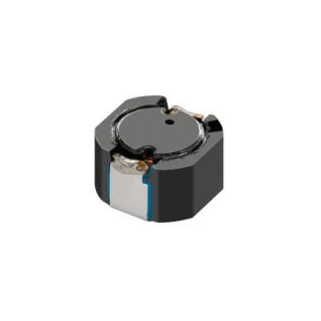

Ferrite Inductors 铁氧体功率电感器 DS85LCB Inductance Range: 1.0~100µH Recommended patterns 推荐焊盘尺寸 (Unit: mm) (Unit: mm) Note (*) 5.0mm Max. height. FEATURES 特点 • 8.4 × 8.3mm Max. square, 5.0mm Max. height). • Magnetically shielded construction and low DC resistance. • Suitable for large currents. • Operating temperature : -40~+85°C • • • • 最大8.4×8.3毫米的平面,最大高度5.0毫米 磁性屏蔽结构和低直流电阻 适合大电流 使用温度范围:-40~+85°C STANDARD PART NUMBERS 标准零件号码 TYPE DS85LCB (Quantity/reel; 500 PCS) 零件号码 电感值(1) 公差 最大直流电阻(2) (典型) Part Number Inductance(1) (µH) Tolerance (%) DC Resistance(2) (mΩ) Max. (Typ.) B1135AS-1R0N=P3 B1135AS-1R5N=P3 B1135AS-2R2N=P3 B1135AS-2R7N=P3 B1135AS-3R6N=P3 B1135AS-4R7N=P3 B1135AS-6R8N=P3 B1135AS-100M=P3 B1135AS-150M=P3 B1135AS-220M=P3 B1135AS-330M=P3 B1135AS-470M=P3 B1135AS-680M=P3 B1135AS-101M=P3 1.0 1.5 2.2 2.7 3.6 4.7 6.8 10 15 22 33 47 68 100 ±30 ±30 ±30 ±30 ±30 ±30 ±30 ±20 ±20 ±20 ±20 ±20 ±20 ±20 9.6 (8.0) 11 (9.3) 13 (11) 14 (12) 17 (14) 21 (17) 29 (25) 45 (38) 64 (53) 84 (70) 110 (90) 150 (125) 235 (195) 330 (275) (1) Inductance is measured with a LCR meter 4284A (Agilent Technologies) or equivalent. Test frequency at 100kHz (2) DC resistance is measured with 34420A (Agilent Technologies) or 3541(HIOKI). (Reference ambient temperature 25°C) (3) Maximum allowable DC current is that which causes a 10% inductance reduction from the initial value, or coil temperature to rise by 40°C, whichever is smaller. (Reference ambient temperature 20°C) 最大电感值减小电流(3) (典型) Inductance Decrease Current(3) (A) Max. (Typ.) ∆L L =10% 7.8 (10.4) 6.3 (8.4) 5.5 (7.3) 4.7 (6.3) 4.2 (5.6) 3.7 (5.0) 3.1 (4.1) 2.4 (3.2) 2.0 (2.7) 1.7 (2.3) 1.4 (1.9) 1.2 (1.6) 0.97 (1.3) 0.79 (1.1) ∆L L =30% 10.1 (13.4) 8.3 (11.0) 7.1 (9.5) 6.2 (8.3) 5.6 (7.4) 4.9 (6.6) 4.1 (5.4) 3.2 (4.3) 2.6 (3.5) 2.2 (3.0) 1.8 (2.4) 1.5 (2.1) 1.3 (1.7) 1.1 (1.4) 最大温度上升电流(3) (典型) Temperature Rise Current(3) ∆T=40°C (A) Max. (Typ.) 8.5 (10.0) 7.6 (9.0) 7.3 (8.6) 6.5 (7.6) 5.5 (6.5) 5.1 (6.0) 4.0 (4.7) 3.3 (3.8) 2.5 (2.9) 2.3 (2.7) 1.9 (2.3) 1.6 (1.9) 1.3 (1.5) 1.1 (1.3) (1) LCR仪表4284A (Agilent技术)或者功能相同的仪器在100kHz下测 试电感值。 (2) 通过数码万用表34420A(Agilent技术)或者3541(HIOKI)测试直 流电阻。(环境温度为25°C) (3) 允许最大直流电的范围是以下两者中比较小的一个:引起电感值 从最初值降低10%,或者线圈温度升高40°C。 (参考周围环境温度20°C)。
