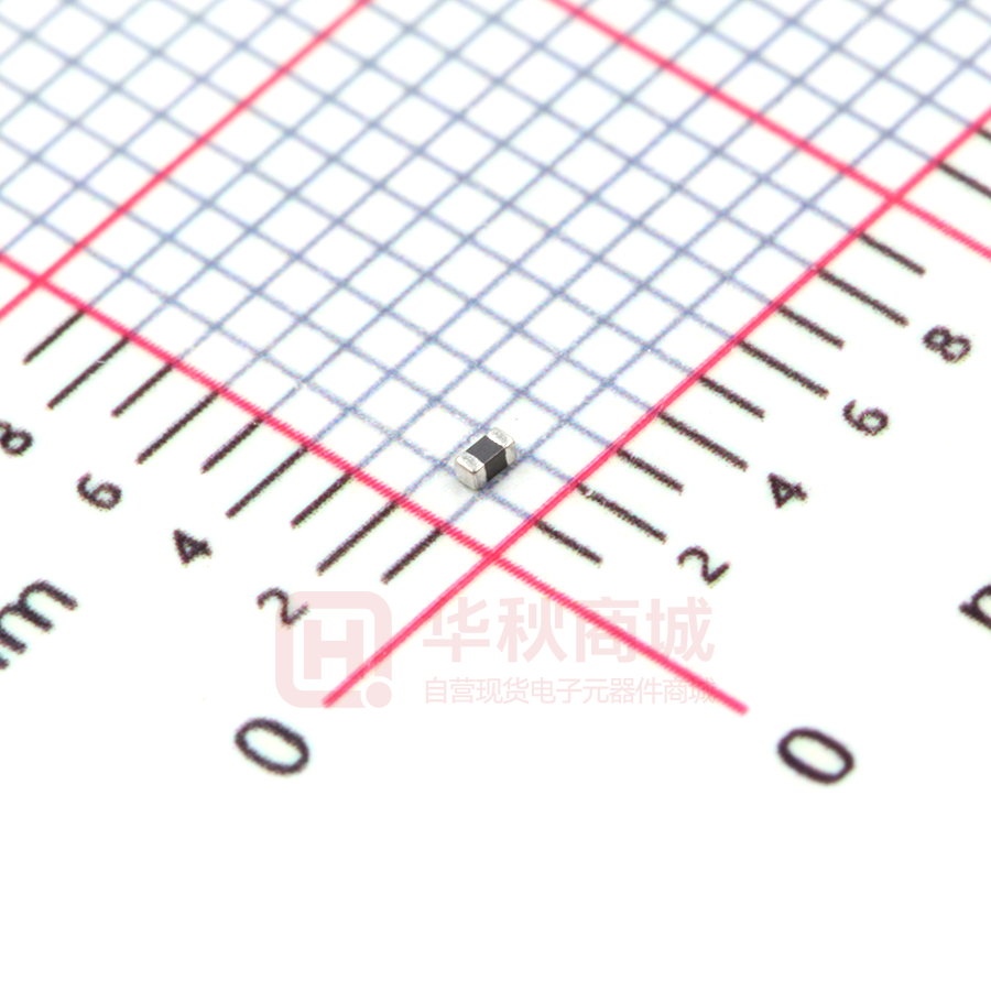

    贴片磁珠 120Ω@100MHz ±25% 0402 130mΩ 700mA
BLM15AX121SN1D 数据手册
Reference Only Reference Spec.No.JENF243A-0018AJ-01 P1/11 Chip Ferrite Bead BLM15□□□□□SN1□ REFERENCE SPECIFICATION 1.Scope This reference specification applies to Chip Ferrite Bead BLM15_SN series. 2.Part Numbering (ex.) BL M 15 AG 100 S N 1 D (1) (2) (3) (4) (5) (6) (7) (8) (9) (1)Product ID (2)Type (3)Dimension(L×W) (4)Characteristics (5)Typical Impedance at 100MHz (6)Performance (7)Category (8)Numbers of Circuit (9)Packaging(D:Taping / B:Bulk) 3.Rating Customer Part Number MURATA Part Number BLM15AG100SN1D BLM15AG100SN1B BLM15AG700SN1D BLM15AG700SN1B BLM15AG121SN1D BLM15AG121SN1B BLM15AG221SN1D BLM15AG221SN1B BLM15AG601SN1D BLM15AG601SN1B BLM15AG102SN1D BLM15AG102SN1B BLM15AX100SN1D BLM15AX100SN1B BLM15AX300SN1D BLM15AX300SN1B BLM15AX700SN1D BLM15AX700SN1B BLM15AX121SN1D BLM15AX121SN1B BLM15AX221SN1D BLM15AX221SN1B BLM15AX601SN1D BLM15AX601SN1B BLM15AX102SN1D BLM15AX102SN1B BLM15BA050SN1D BLM15BA050SN1B BLM15BB050SN1D BLM15BB050SN1B BLM15BA100SN1D BLM15BA100SN1B BLM15BB100SN1D BLM15BB100SN1B BLM15BA220SN1D BLM15BA220SN1B BLM15BB220SN1D BLM15BB220SN1B BLM15BA330SN1D BLM15BA330SN1B Impedance () DC Resistance ( max.) (at 100MHz,Under Standard Rated Current Testing Condition) Initial Values (mA) Values After Typical Testing Remark 5~15 10 1000 0.025 0.05 40~100 70 600 0.15 0.20 120±25% 120 550 0.19 0.29 220±25% 220 450 0.29 0.39 600±25% 600 300 0.52 0.62 1000±25% 1000 300 0.65 0.75 5~15 10 1740 0.015 30 1100 0.06 For 0.025 general use 0.11 70±25% 70 780 0.10 0.15 120±25% 120 700 0.13 0.18 220±25% 220 600 0.18 0.23 600±25% 600 500 0.34 0.39 1000±25% 1000 350 0.49 0.54 5±25% 5 300 0.10 0.15 5±25% 5 500 0.08 0.15 10±25% 10 300 0.20 0.25 10±25% 10 300 0.10 0.15 22±25% 22 300 0.30 0.35 22±25% 22 300 0.20 0.30 33±25% 33 300 0.40 0.45 30±25% MURATA MFG.CO.,LTD. For high speed signal line Reference Only Reference Spec.No.JENF243A-0018AJ-01 Customer Part Number MURATA Part Number BLM15BA470SN1D BLM15BA470SN1B BLM15BB470SN1D BLM15BB470SN1B BLM15BA750SN1D BLM15BA750SN1B BLM15BB750SN1D BLM15BB750SN1B BLM15BD750SN1D BLM15BD750SN1B BLM15BB121SN1D BLM15BB121SN1B BLM15BD121SN1D BLM15BD121SN1B BLM15BB221SN1D BLM15BB221SN1B BLM15BC121SN1D BLM15BC121SN1B BLM15BD221SN1D BLM15BD221SN1B BLM15BD471SN1D BLM15BD471SN1B BLM15BC241SN1D BLM15BC241SN1B BLM15BD601SN1D BLM15BD601SN1B BLM15BD102SN1D BLM15BD102SN1B BLM15BD152SN1D BLM15BD152SN1B BLM15BD182SN1D BLM15BD182SN1B BLM15BX750SN1D BLM15BX750SN1B BLM15BX121SN1D BLM15BX121SN1B BLM15BX221SN1D BLM15BX221SN1B BLM15BX471SN1D BLM15BX471SN1B BLM15BX601SN1D BLM15BX601SN1B BLM15BX102SN1D BLM15BX102SN1B BLM15BX182SN1D BLM15BX182SN1B P2/11 Impedance () DC Resistance (at 100MHz,Under Standard (Note) ( max.) Testing Condition) Rated Current Initial Values (mA) Values After Typical Testing 47±25% 47 200 0.60 0.65 47±25% 47 300 0.35 0.45 75±25% 75 200 0.80 0.85 75±25% 75 300 0.40 0.50 75±25% 75 300 0.20 0.30 120±25% 120 300 0.55 0.65 120±25% 120 300 0.30 0.4 220±25% 220 200 0.80 0.90 120±25% 120 350 0.45 0.50 220±25% 220 300 0.40 0.50 470±25% 470 200 0.60 0.70 240±25% 240 250 0.70 0.75 600±25% 600 200 0.65 0.75 1000±25% 1000 200 0.90 1.0 1500±25% 1500 190 1.0 1.1 1800±25% 1800 100 1.4 1.5 75±25% 75 600 0.15 0.20 120±25% 120 600 0.17 0.22 220±25% 220 450 0.27 0.32 470±25% 470 350 0.41 0.46 600±25% 600 350 0.46 0.51 1000±25% 1000 300 0.65 0.75 1800±25% 1800 250 0.90 1.0 MURATA MFG.CO.,LTD. Remark For high speed signal line Reference Only Reference Spec.No.JENF243A-0018AJ-01 Customer Part Number MURATA Part Number BLM15PG100SN1D BLM15PG100SN1B BLM15PD300SN1D BLM15PD300SN1B BLM15PD600SN1D BLM15PD600SN1B BLM15PD800SN1D BLM15PD800SN1B BLM15PD121SN1D BLM15PD121SN1B BLM15PX330SN1D BLM15PX330SN1B BLM15PX600SN1D BLM15PX600SN1B BLM15PX800SN1D BLM15PX800SN1B BLM15PX121SN1D BLM15PX121SN1B BLM15PX181SN1D BLM15PX181SN1B BLM15PX221SN1D BLM15PX221SN1B BLM15PX331SN1D BLM15PX331SN1B BLM15PX471SN1D BLM15PX471SN1B BLM15PX601SN1D BLM15PX601SN1B BLM15KD200SN1D BLM15KD200SN1B BLM15KD300SN1D BLM15KD300SN1B BLM15KD121SN1D BLM15KD121SN1B P3/11 Impedance () DC Resistance (Note) ( max.) (at 100MHz,Under Standard Rated Current Testing Condition) (mA) Initial Values Values After Typical at 85℃ at 125℃ Testing 5~15 10 30±25% 30 2200*1 60±25% 60 80±25% 0.025 0.05 1400*1 0.035 0.05 1700*1 1100*1 0.06 0.075 80 1500*1 1000*1 0.07 0.085 120±25% 120 1300*1 900*1 0.09 0.105 33±25% 33 3000*1 1700*1 0.022 0.037 60±25% 60 2500*1 1400*1 0.032 0.047 80±25% 80 2300*1 1300*1 0.038 0.053 120±25% 120 2000*1 1100*1 0.055 0.070 180±25% 180 1500*1 800*1 0.090 0.105 220±25% 220 1400*1 800*1 0.10 0.115 330±25% 330 1200*1 700*1 0.15 0.165 470±25% 470 1000*1 600*1 0.20 0.22 600±25% 600 900*1 500*1 0.23 0.25 20±25% 20 3800*1 2350*1 0.011 0.016 30±25% 30 3100*1 1900*1 0.017 0.022 120±25% 120 1500*1 930*1 0.070 0.085 (Note) As for the Rated current marked with *1, Rated Current is derated as right figure depending on the operating temperature. ■Storage Temperature : -55°C to +125°C R a te d C u rre n t ( A ) ■Operating Temperature : -55°C to +125°C 1000 Rated current at 85°C Rated current at 125°C 0 85 125 Operating Temperature (°C) MURATA MFG.CO.,LTD. Remark For DC power line Reference Only Reference Spec.No.JENF243A-0018AJ-01 4.Style and Dimensions 1.0±0.05 P4/11 0.5±0.05 0.5±0.05 ■ Equivalent Circuit ( 0.25±0.1 ) Resistance element becomes dominant at high frequencies. : Electrode (in mm) ■ Unit Mass(Typical value) 0.001g 5.Marking No marking. 6.Standard Testing Conditions  Unless otherwise specified  Temperature : Ordinary Temp. (15 °C to 35 °C ) Humidity : Ordinary Humidity (25%(RH) to 85%(RH))  In case of doubt  Temperature : 20°C±2 °C Humidity : 60%(RH) to 70%(RH) Atmospheric pressure : 86kPa to 106kPa 7.Specifications 7-1.Electrical Performance No. Item 7-1-1 Impedance Specification Meet item 3. 7-1-2 Meet item 3. DC Resistance Test Method Measuring Frequency : 100MHz±1MHz Measuring Equipment : KEYSIGHT4291A or the equivalent Test Fixture : KEYSIGHT16192A or the equivalent Measuring Equipment : Digital multi meter *Except resistance of the Substrate and Wire 7-2.Mechanical Performance No. Item 7-2-1 Appearance And Dimensions 7-2-2 Bonding Strength Specification Meet item 4. Test Method Visual Inspection and measured with Slide Calipers. Meet Table 1. It shall be soldered on the substrate. Applying Force(F) : 5N Applying Time : 5s±1s Applying Direction: Parallel to the substrate. Table 1 Appearance Impedance Change (at 100MHz) DC Resistance No damage Within ±30% Side view F F R0.5 Meet item 3. Substrate 7-2-3 Bending Strength It shall be soldered on the substrate. Substrate: Glass-epoxy 100mm40mm0.8mm Deflection : 2.0mm Speed of Applying Force : 0.5mm/s Pressure Keeping Time : 30s R340 jig F Deflection 45mm MURATA MFG.CO.,LTD. 45mm Product Reference Only Reference Spec.No.JENF243A-0018AJ-01 No. Item 7-2-4 Vibration Specification Meet Table 1. 7-2-5 Resistance to Soldering Heat 7-2-6 Drop Products shall be no failure after tested. 7ー2-7 Solderability The electrodes shall be at least 95% covered with new solder coating. P5/11 Test Method It shall be soldered on the substrate. Oscillation Frequency : 10Hz to 55Hz to 10Hz for 1 min Total Amplitude : 1.5mm Testing Time : A period of 2 hours in each of 3 mutually perpendicular directions. (Total 6 h) Pre-Heating : 150°C±10°C, 60s~90s Solder : Sn-3.0Ag-0.5Cu Solder Temperature : 270°C±5°C Immersion Time : 10s±0.5s Immersion and emersion rates : 25mm/s Then measured after exposure in the room conditionfor 48h±4h. It shall be dropped on concrete or steel board. Method : free fall Height : 75cm Attitude from which the product is dropped : 3 direction The number of times : 3 times for each direction(Total 9 times) Flux : Ethanol solution of rosin,25(wt)% Pre-Heating : 150°C±10°C, 60s~90s Solder : Sn-3.0Ag-0.5Cu Solder Temperature : 240°C±5°C Immersion Time : 3s±1s Immersion and emersion rates : 25mm/s 7-3.Environmental Performance It shall be soldered on the substrate. No. Item Specification 7-3-1 Temperature Meet Table 1. Cycle 7-3-2 Humidity 7-3-3 Heat Life Meet Table 2. Table 2 Appearance Impedance Change (at 100MHz) DC Resistance 7-3-4 Cold Resistance Meet Table 1. No damage Within ±30% (for BLM15PD Within ±40%) Test Method 1 cycle : 1 step : -55 °C(+0 °C,-3 °C) / 30min±3min 2 step : Ordinary temp. / 10min to 15min 3 step : +125 °C(+3 °C,-0 °C) / 30min±3min 4 step : Ordinary temp. / 10min to 15min Total of 100 cycles Then measured after exposure in the room condition for 48h±4h. Temperature : 40°C±2°C Humidity : 90%RH to 95%RH Time : 1000h(+48h,-0h) Then measured after exposure in the room condition for 48h±4h. Temperature : 125°C±3°C Applying Current : Rated Current(at 125°C) Time : 1000h(+48h,-0h) Then measured after exposure in the room condition for 48h±4h. Meet item 3. Temperature : -55±2°C Time : 1000h(+48h,-0h) Then measured after exposure in the room condition for 48h±4h. MURATA MFG.CO.,LTD. Reference Only +0.1 1.15(Typ.) 3.5±0.05  1.5 -0 0.65(Typ.) 8.0±0.3 2.0±0.05 2.0±0.05 4.0±0.1 P6/11 1.75±0.1 Reference Spec.No.JENF243A-0018AJ-01 8.Specification of Packaging 8-1.Appearance and Dimensions (8mm-wide paper tape) 0.8max. (in mm) Direction of Feed (1) Taping Products shall be packaged in the cavity of the base tape of 8mm-wide, 2mm-pitch continuously and sealed by top tape and bottom tape. (2) Sprocket hole:Sprocket hole shall be located on the right hand side toward the direction of feed. (3) Spliced point:The base tape and top tape have no spliced point (4) Cavity:There shall not be burr in the cavity. (5) Missing components number Missing components number within 0.1% of the number per reel or 1 pc., whichever is greater, and are not continuous. The specified quantity per reel is kept. 8-2.Tape Strength (1)Pull Strength Top tape 5N min. Bottom tape (2)Peeling off force of Cover tape 0.1N to 0.6N (Minimum value is typical.) *Speed of Peeling off:300mm/min 165 to 180 degree Bottom tape Top tape F Base tape 8-3.Taping Condition (1)Standard quantity per reel Quantity per 180mm reel 10000 pcs. / reel (2)There shall be leader-tape(top tape and empty tape) and trailer- tape(empty tape) as follows. (3)On paper tape, the top tape and the base tape shall not be adhered at the tip of the empty leader tape for more than 5 pitch. (4)Marking for reel The following items shall be marked on a label and the label is stuck on the reel. (Customer part number, MURATA part number, Inspection number(1) , RoHS marking(2) , Quantity, etc) 1) « Expression of Inspection No. » □□ OOOO  (1) (1) Factory Code (2) Date (2) (3) First digit : Year / Last digit of year Second digit : Month / Jan. to Sep.  1 to 9, Oct. to Dec.  O,N,D Third, Fourth digit : Day (3) Serial No. 2) « Expression of RoHS marking » ROHS – Y (△) (1) (2) (1) RoHS regulation conformity parts. (2) MURATA classification number (5)Outside package These reels shall be packed in the corrugated cardboard package and the following items shall be marked on a label and the label is sticked on the box. (Customer name, Purchasing order number, Customer part number, MURATA part number, RoHS marking(2) ,Quantity, etc) MURATA MFG.CO.,LTD. Reference Only Reference Spec.No.JENF243A-0018AJ-01 P7/11 (6)Dimensions of reel and taping(leader-tape, trailer-tape) Trailer 160 min. 2.0±0.5 Leader Label 190 min. Empty tape 210 min. Top tape  13.0±0.2 +1  60 -0  21.0±0.8 9.0 +1 -0 Direction of feed 13.0±1.4 +0  180 -3 (in mm) 8-4. Specification of Outer Case Label H D Outer Case Dimensions Standard Reel Quantity in Outer Case (mm) (Reel) W D H 186 186 93 5 Above Outer Case size is typical. It depends on a quantity of an order. W 9. ! Caution 9-1. Surge current Excessive surge current ( pulse current or rush current) than specified rated current applied to the product may cause a critical failure, such as an open circuit, burnout caused by excessive temperature rise. Please contact us in advance in case of applying the surge current. 9-2.Limitation of Applications Please contact us before using our products for the applications listed below which require especially high reliability for the prevention of defects which might directly cause damage to the third party's life, body or property. (1)Aircraft equipment (2)Aerospace equipment (3)Undersea equipment (4)Power plant control equipment (5)Medical equipment (6)Transportation equipment(automobiles,trains,ships,etc.) (7)Traffic signal equipment (8)Disaster prevention / crime prevention equipment (9)Data-processing equipment (10)Applications of similar complexity or with reliability requirements comparable to the applications listed in the above 10.Notice This product is designed for solder mounting. Please consult us in advance for applying other mounting method such as conductive adhesive. 10-1.Land pattern designing Standard land dimensions (Reflow soldering) < For BLM15 series (except BLM15P□, BLM15AX, BLM15KD type) > Chip Ferrite Bead 0.5 0.4 1.2~1.4 Solder Resist Pattern (in mm) MURATA MFG.CO.,LTD. Reference Only Reference Spec.No.JENF243A-0018AJ-01 P8/11 < For BLM15P□, BLM15AX, BLM15KD type > Chip Ferrite Bead d c Land pad thickness and dimension d 18µm 35µm 70µm 0.5 0.5 0.5 0.4 1.2 to 1.4 0.5 1.2 0.7 0.5 2.4 1.2 0.5 (in mm) The excessive heat by land pads may cause deterioration at joint of products with substrate. Rated Current (A) 1.5 Max 2.2 Max 3.0 Max Solder Resist a Pattern b a b c 10-2.Soldering Conditions Products can be applied to reflow soldering. (1) Flux,Solder Flux Solder Use rosin-based flux, but not highly acidic flux (with chlorine content exceeding 0.2(wt)%. ) Do not use water-soluble flux. Use Sn-3.0Ag-0.5Cu solder Standard thickness of solder paste : 100 µm to 200 m (2) Soldering conditions Pre-heating should be in such a way that the temperature difference between solder and ferrite surface is limited to 150℃ max. Also cooling into solvent after soldering should be in such a way that the temperature difference is limited to 100℃ max. Insufficient pre-heating may cause cracks on the ferrite, resulting in the deterioration of product quality. Standard soldering profile and the limit soldering profile is as follows. The excessive limit soldering conditions may cause leaching of the electrode and / or resulting in the deterioration of product quality. (3) Soldering profile Temp. (℃) 260℃ 245℃±3℃ 220℃ 230℃ Limit Profile 180 150 Standard Profile 30s~60s 60s max. 90s±30s Pre-heating Heating Peak temperature Cycle of reflow Time. (s) Standard Profile 150~180°C 、90s±30s above 220°C、30s~60s 245±3°C 2 times Limit Profile above 230°C、60s max. 260°C,10s 2 times 10-3. Reworking with soldering iron Pre-heating: 150°C, 1 min Tip temperature: 350°C max. Soldering time : 3(+1,-0) seconds. Soldering iron output: 80W max.  Tip diameter:φ3mm max.  Times : 2times max. Note :Do not directly touch the products with the tip of the soldering iron in order to prevent the crack on the ferrite material due to the thermal shock. MURATA MFG.CO.,LTD. Reference Only Reference Spec.No.JENF243A-0018AJ-01 10-4.Solder Volume P9/11 Solder shall be used not to be exceed as shown below. Upper Limit Recommendable t 1/3T≦t≦T (T:Chip thickness) Accordingly increasing the solder volume, the mechanical stress to product is also increased. Exceeding solder volume may cause the failure of mechanical or electrical performance. 10-5.Attention regarding P.C.B. bending The following shall be considered when designing and laying out P.C.B.'s. (1) P.C.B. shall be designed so that products are not subject to the mechanical stress for board warpage. a b 〈 Poor example 〉 Products shall be located in the sideways direction (Length:ab) to the mechanical stress. 〈 Good example〉 (2) Components location on P.C.B. separation. It is effective to implement the following measures, to reduce stress in separating the board. It is best to implement all of the following three measures; however, implement as many measures as possible to reduce stress. Contents of Measures (1) Turn the mounting direction of the component parallel to the board separation surface. (2) Add slits in the board separation part. (3) Keep the mounting position of the component away from the board separation surface. Perforation Stress Level A > D *1 A > B A > C C B D A Slit *1 A > D is valid when stress is added vertically to the perforation as with Hand Separation. If a Cutting Disc is used, stress will be diagonal to the PCB, therefore A > D is invalid. (3) Mounting Components Near Screw Holes When a component is mounted near a screw hole, it may be affected by the board deflection that occurs during the tightening of the screw. Mount the component in a position as far away from the screw holes as possible. Screw Hole Recommended 10-6.Mounting density Add special attention to radiating heat of products when mounting the inductor near the products with heating. The excessive heat by other products may cause deterioration at joint of this product with substrate. MURATA MFG.CO.,LTD. Reference Only Reference Spec.No.JENF243A-0018AJ-01 10-7.Operating Environment P10/11 Do not use this product under the following environmental conditions, on deterioration of the Insulation Resistance of the Ferrite material and/or corrosion of Inner Electrode may result from the use. (1) in the corrodible atmosphere such as acidic gases, alkaline gases, chlorine, sulfur gases, organic gases and etc. (the sea breeze, Cl2, H2S, NH3, SO2, NO2,etc) (2) in the atmosphere where liquid such as organic solvent, may splash on the products. (3) in the atmosphere where the temperature / humidity changes rapidly and it is easy to dew. 10-8.Resin coating The impedance value may change and/or it may affect on the product's performance due to high cure-stress of resin to be used for coating / molding products. So please pay your careful attention when you select resin. In prior to use, please make the reliability evaluation with the product mounted in your application set. 10-9.Cleaning Conditions Products shall be cleaned on the following conditions. (1)Cleaning temperature shall be limited to 60°C max. (40°C max. for IPA.) (2)Ultrasonic cleaning shall comply with the following conditions, avoiding the resonance phenomenon at the mounted products and P.C.B. Power:20W/ max. Frequency:28kHz to 40kHz Time:5 min max. (3)Cleaner 1.Alternative cleaner Isopropyl alcohol (IPA) 2.Aqueous agent PINE ALPHA ST-100S (4)There shall be no residual flux and residual cleaner after cleaning. In the case of using aqueous agent, products shall be dried completely after rinse with de-ionized water in order to remove the cleaner. (5)Other cleaning Please contact us. 10-10. Handling of a substrate After mounting products on a substrate, do not apply any stress to the product caused by bending or twisting to the substrate when cropping the substrate, inserting and removing a connector from the substrate or tightening screw to the substrate. Excessive mechanical stress may cause cracking in the product. Bending Twisting 10-11.Storage Conditions (1)Storage period Use the products within 6 months after delivered. Solderability should be checked if this period is exceeded. (2)Storage conditions Products should be stored in the warehouse on the following conditions. Temperature : -10°C to 40°C Humidity : 15% to 85% relative humidity No rapid change on temperature and humidity Don't keep products in corrosive gases such as sulfur, chlorine gas or acid, or it may cause oxidization of electrode, resulting in poor solderability.  Products should be stored on the palette for the prevention of the influence from humidity, dust and so on. Products should be stored in the warehouse without heat shock, vibration, direct sunlight and so on. Products should be stored under the airtight packaged condition. (3)Delivery Care should be taken when transporting or handling product to avoid excessive vibration or mechanical shock. MURATA MFG.CO.,LTD. Reference Only Reference Spec.No.JENF243A-0018AJ-01 11. ! P11/11 Note (1)Please make sure that your product has been evaluated in view of your specifications with our product being mounted to your product. (2) You are requested not to use our product deviating from the reference specifications. (3) The contents of this reference specification are subject to change without advance notice. Please approve our product specifications or transact the approval sheet for product specifications before ordering. MURATA MFG.CO.,LTD.
BLM15AX121SN1D
物料型号:BLM15系列,具体型号包括BLM15AG100SN1D、BLM15AX102SN1B等,型号中包含尺寸、特性、典型阻抗值等信息。
器件简介:BLM15系列是Murata制造的芯片铁氧体珠,用于抑制高频噪声,常用于电源线、信号线等。
引脚分配:文档中未明确提供引脚分配图,但通常这类器件为直列引脚或表面贴装形式。
参数特性:包括典型阻抗值(在100MHz下的值)、额定电流、直流电阻等。例如,BLM15AG100SN1D的典型阻抗为10Ω,额定电流为1000mA,最大直流电阻为0.05Ω。
功能详解:主要用于抑制电源线或信号线上的高频噪声,不同型号的铁氧体珠适用于不同的频率范围和电流需求。
应用信息:适用于一般用途的高速信号线、DC电源线等。某些型号特别适用于高速信号线。
封装信息:封装形式包括胶带封装和散装,具体尺寸和封装方式在文档中有详细说明。
