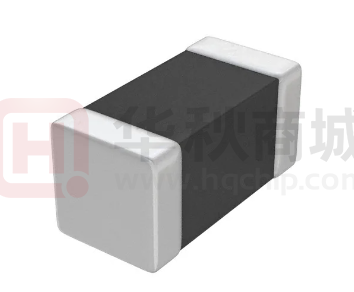

    贴片磁珠 220Ω@100MHz ±25% 0603 300mΩ 200mA
BLM18RK221SN1D 数据手册
Spec. No. JENF243A-0003W-01 Reference Only P.1/12 Chip Ferrite Bead BLM18□□□□□□N1□ Reference Specification 1.Scope This Reference Specification applies to Chip Ferrite Bead BLM18_□N Series. 2.Part Numbering (ex.) BL M 18 AG 121 S N 1 D (1) (2) (3) (4) (5) (6) (7) (8) (9) (1)Product ID (2)Type (3)Dimension(L×W) (4)Characteristics (5)Typical Impedance at 100MHz (6)Performance (7)Category (8)Numbers of Circuit (9)Packaging(D:Taping / B:Bulk) 3.Rating Customer Part Number MURATA Part Number BLM18RK121SN1D BLM18RK121SN1B BLM18RK221SN1D BLM18RK221SN1B BLM18RK471SN1D BLM18RK471SN1B BLM18RK601SN1D BLM18RK601SN1B BLM18RK102SN1D BLM18RK102SN1B BLM18PG300SN1D BLM18PG300SN1B BLM18PG330SN1D BLM18PG330SN1B BLM18PG600SN1D BLM18PG600SN1B BLM18PG121SN1D BLM18PG121SN1B BLM18PG181SN1D BLM18PG181SN1B BLM18PG221SN1D BLM18PG221SN1B BLM18PG331SN1D BLM18PG331SN1B BLM18PG471SN1D BLM18PG471SN1B BLM18KG221SN1D BLM18KG221SN1B BLM18KG331SN1D BLM18KG331SN1B BLM18KG471SN1D BLM18KG471SN1B BLM18KG601SN1D BLM18KG601SN1B BLM18AG121SN1D BLM18AG121SN1B BLM18AG151SN1D BLM18AG151SN1B BLM18AG221SN1D BLM18AG221SN1B DC Resistance Rated ( max.) Current Initial Values (mA) Values After at at Typical Testing 85℃ 125℃ Impedance () (at 100MHz, Under Standard Testing Condition) 120±25% 120 200 0.25 0.35 220±25% 220 200 0.30 0.40 470±25% 470 200 0.50 0.60 600±25% 600 200 0.60 0.70 1000±25% 1000 200 0.80 0.90 20 min. 30 1000 0.05 0.10 33±25% 33 3000*1 1000*1 0.025 0.050 40 min. 60 500 0.1 0.2 120±25% 120 2000*1 1000*1 0.05 0.10 180±25% 180 1500*1 1000*1 0.09 0.18 220±25% 220 1400*1 1000*1 0.10 0.14 330±25% 330 1200*1 1000*1 0.15 0.20 470±25% 470 1000 0.20 0.26 220±25% 220 2200*1 1000*1 0.050 0.060 330±25% 330 1700*1 1000*1 0.080 0.095 470±25% 470 1500*1 1000*1 0.130 0.145 600±25% 600 1300*1 1000*1 0.150 0.165 120±25% 120 500 0.18 0.28 150±25% 150 500 0.25 0.35 220±25% 220 500 0.25 0.35 MURATA MFG.CO., LTD. Remark For Digital Interface For DC power line For general use Spec. No. JENF243A-0003W-01 Customer Part Number MURATA Part Number BLM18AG331SN1D BLM18AG331SN1B BLM18AG471SN1D BLM18AG471SN1B BLM18AG601SN1D BLM18AG601SN1B BLM18AG102SN1D BLM18AG102SN1B BLM18BB050SN1D BLM18BB050SN1B BLM18BA050SN1D BLM18BA050SN1B BLM18BB100SN1D BLM18BB100SN1B BLM18BA100SN1D BLM18BA100SN1B BLM18BB220SN1D BLM18BB220SN1B BLM18BA220SN1D BLM18BA220SN1B BLM18BB470SN1D BLM18BB470SN1B BLM18BD470SN1D BLM18BD470SN1B BLM18BA470SN1D BLM18BA470SN1B BLM18BB600SN1D BLM18BB600SN1B BLM18BA750SN1D BLM18BA750SN1B BLM18BB750SN1D BLM18BB750SN1B BLM18BB121SN1D BLM18BB121SN1B BLM18BD121SN1D BLM18BD121SN1B BLM18BA121SN1D BLM18BA121SN1B BLM18BB141SN1D BLM18BB141SN1B BLM18BB151SN1D BLM18BB151SN1B BLM18BD151SN1D BLM18BD151SN1B BLM18BB221SN1D BLM18BB221SN1B BLM18BD221SN1D BLM18BD221SN1B BLM18BB331SN1D BLM18BB331SN1B BLM18BD331SN1D BLM18BD331SN1B BLM18BD421SN1D BLM18BD421SN1B Reference Only Impedance () (at 100MHz, Under Standard Testing Condition) Rated Current (mA) at at Typical 85℃ 125℃ P.2/12 DC Resistance ( max.) Initial Values Values After Testing Remark 330±25% 330 500 0.30 0.40 470±25% 470 500 0.35 0.45 600±25% 600 500 0.38 0.48 1000±25% 1000 400 0.50 0.60 5±25% 5 700 0.05 0.10 5±25% 5 500 0.2 0.3 10±25% 10 700 0.10 0.20 10±25% 10 500 0.25 0.35 22±25% 22 600 0.20 0.30 22±25% 22 500 0.35 0.45 47±25% 47 550 0.25 0.35 47±25% 47 500 0.3 0.4 47±25% 47 300 0.55 0.65 60±25% 60 550 0.25 0.35 75±25% 75 300 0.70 0.80 75±25% 75 500 0.30 120±25% 120 500 0.30 For 0.40 high speed signal line 0.40 120±25% 120 300 0.4 0.5 120±25% 120 200 0.9 1.0 140±25% 140 450 0.35 0.45 150±25% 150 450 0.37 0.47 150±25% 150 300 0.4 0.5 220±25% 220 450 0.45 0.55 220±25% 220 250 0.45 0.55 330±25% 330 400 0.58 0.68 330±25% 330 250 0.5 0.6 420±25% 420 250 0.55 0.65 MURATA MFG.CO., LTD. For general use Spec. No. JENF243A-0003W-01 Customer Part Number  MURATA Part Number BLM18BB471SN1D BLM18BB471SN1B BLM18BD471SN1D BLM18BD471SN1B BLM18BD601SN1D BLM18BD601SN1B BLM18BD102SN1D BLM18BD102SN1B BLM18BD152SN1D BLM18BD152SN1B BLM18BD182SN1D BLM18BD182SN1B BLM18BD222SN1D BLM18BD222SN1B BLM18BD252SN1D BLM18BD252SN1B BLM18TG121TN1D BLM18TG121TN1B BLM18TG221TN1D BLM18TG221TN1B BLM18TG601TN1D BLM18TG601TN1B BLM18TG102TN1D BLM18TG102TN1B BLM18SG260TN1D BLM18SG260TN1B BLM18SG700TN1D BLM18SG700TN1B BLM18SG121TN1D BLM18SG121TN1B BLM18SG221TN1D BLM18SG221TN1B BLM18SG331TN1D BLM18SG331TN1B BLM18SN220TN1D BLM18SN220TN1B BLM18KG260TN1D BLM18KG260TN1B BLM18KG300TN1D BLM18KG300TN1B BLM18KG700TN1D BLM18KG700TN1B BLM18KG101TN1D BLM18KG101TN1B BLM18KG121TN1D BLM18KG121TN1B Reference Only Impedance () (at 100MHz, Under Standard Testing Condition) Rated Current (mA) at at Typical 85℃ 125℃ P.3/12 DC Resistance ( max.) Initial Values Values After Testing Remark 470±25% 470 300 0.85 0.95 470±25% 470 250 0.55 0.65 600±25% 600 200 0.65 0.75 1000±25% 1000 200 0.85 0.95 1500±25% 1500 150 1.2 1.3 1800±25% 1800 150 1.5 1.6 2200±25% 2200 150 1.5 1.6 2500±25% 2500 150 1.5 1.6 120±25% 120 200 0.25 0.3 220±25% 220 200 0.3 0.4 600±25% 600 200 0.45 0.6 1000±25% 1000 100 0.6 0.8 26±25% 26 6000*1 1000*1 0.007 0.012 70±25% 70 4000*1 1000*1 0.020 0.030 120±25% 120 3000*1 1000*1 0.025 0.035 220±25% 220 2500*1 1000*1 0.040 0.055 330±25% 330 1500*1 1000*1 0.070 0.085 22±7 22 8000*1 5000*1 0.004 26±25% 26 6000*1 1000*1 0.007 For DC 0.005 power line (Thin type) 0.012 30±25% 30 5000*1 1000*1 0.010 0.015 70±25% 70 3500*1 1000*1 0.022 0.032 100±25% 100 3000*1 1000*1 0.030 0.040 120±25% 120 3000*1 1000*1 0.030 0.040  Operating Temperature : -55°C to +125°C  Storage Temperature : -55°C to +125°C MURATA MFG.CO., LTD. For high speed signal line For general use (Thin type) Reference Only R a te d C u rre n t ( A ) Spec. No. JENF243A-0003W-01 (*1)In case of Rated current is more than 1A, Rated Current is derated as right figure depending on the operating temperature. P.4/12 Rated current at 85°C Rated current at 125°C 0 85 125 Operating Temperature (°C) 4.Style and Dimensions 1.6±0.15 0.8±0.15 ■ Equivalent Circuit T 0.4 ±0.2 : Electrode ( ) Resistance element becomes dominant at high frequencies. ■ Unit Mass (Typical value) BLM18*****SN1*:0.005g BLM18*****TN1*:0.004g (in mm) 5.Marking No marking. 6.Standard   Unless Testing BLM18SG***TN1* BLM18SN***TN1* BLM18TG***TN1* BLM18KG***TN1* BLM18*****SN1* 0.5±0.15 0.6±0.15 0.6±0.1 0.6±0.15 0.8±0.15 otherwise Temperature : Ordinary Temp. (15 °C to 35 °C ) Humidity : Ordinary Humidity (25%(RH) to 85%(RH)) Conditions specified   In case of doubt Temperature : 20°C±2 °C Humidity : 60%(RH) to 70%(RH) Atmospheric pressure : 86kPa to 106kPa 7.Specifications 7-1.Electrical Performance No. Item 7-1-1 Impedance Specification Meet item 3. 7-1-2 DC Resistance Meet item 3. Test Method Measuring Frequency : 100MHz±1MHz Measuring Equipment : Agilent 4291A or the equivalent Test Fixture : Agilent 16192A or the equivalent Measuring Equipment : Digital multi meter For BLM18SN_TN Measuring Equipment : YOKOGAWA 755611 or the equivalent Test Fixture : Agilent 16044A or the equivalent *Except resistance of the Substrate and Wire MURATA MFG.CO., LTD. Spec. No. JENF243A-0003W-01 Reference Only P.5/12 7-2.Mechanical Performance No. Item 7-2-1 Appearance and Dimensions 7-2-2 Bonding Strength Specification Meet item 4. Test Method Visual Inspection and measured with Slide Calipers. Meet Table 1. It shall be soldered on the substrate. Applying Force(F) : 6.8N Applying Time : 5s±1s Applied direction :Parallel to substrate Table 1 Appearance Impedance Change (at 100MHz) DC Resistance No damage Within ±30% (for BLM18SN Within ±50%) Side view F F R0.5 Substrate Meet item 3. 7-2-3 Bending Strength It shall be soldered on the substrate. Substrate: Glass-epoxy 100mm40mm1.6mm Deflection : 1.0mm Speed of Applying Force : 0.5mm/s Pressure jig Keeping Time : 30s R340 F Deflection 45mm 7-2-4 Vibration 7-2-5 Resistance to Soldering Heat Meet Table 2. Table 2 Appearance Impedance Change (at 100MHz) DC Resistance No damage Within ±30% (for BLM18KG Within ±40%) (for BLM18SN Within ±50%) 45mm Product It shall be soldered on the substrate. Oscillation Frequency : 10Hz to 55Hz to 10Hz for 1 min Total Amplitude : 1.5mm Testing Time : A period of 2 hours in each of 3 mutually perpendicular directions. (Total 6 h) Pre-Heating : 150°C±10°C, 60s~90s Solder : Sn-3.0Ag-0.5Cu Solder Temperature : 270°C±5°C Immersion Time : 10s±0.5s Immersion and emersion rates : 25mm/s Then measured after exposure in the room condition for 48h±4h. Meet item 3. 7-2-6 Drop Products shall be no failure after tested. 7-2-7 Solderability The electrodes shall be at least 95% covered with new solder coating. It shall be dropped on concrete or steel board. Method : free fall Height : 75cm Attitude from which the product is dropped : 3 direction The number of times : 3 times for each direction(Total 9 times) Flux : Ethanol solution of rosin,25(wt)% Pre-Heating : 150°C±10°C, 60s~90s Solder : Sn-3.0Ag-0.5Cu Solder Temperature : 240°C±5°C Immersion Time : 3s±1s Immersion and emersion rates : 25mm/s MURATA MFG.CO., LTD. Spec. No. JENF243A-0003W-01 Reference Only P.6/12 7-3.Environmental Performance It shall be soldered on the substrate. No. Item Specification 7-3-1 Temperature Meet Table 3. Cycle Table 3 Appearance No damage Impedance Within ±30% Change (for BLM18KG (at 100MHz) Within-10%to +50%) (for BLM18SN Within ±50%) DC Meet item 3. Resistance 7-3-2 Humidity Meet Table 1. 7-3-3 Heat Life 7-3-4 Cold Resistance Test Method 1 cycle: 1 step:-55 °C(+0 °C,-3 °C) / 30min±3min 2 step:Ordinary temp. / 10min to 15min 3 step:+125 °C(+3 °C,-0 °C) / 30min±3min 4 step: Ordinary temp. / 10min to 15min Total of 100 cycles Then measured after exposure in the room condition for 48h±4h. Temperature : 40°C±2°C Humidity : 90%(RH) to 95%(RH) Time : 1000h(+48h,-0h) Then measured after exposure in the room condition for 48h±4h. Temperature : 125°C±3°C (in case of Rated current is more than 1A, do the test at : +85 °C±3°C) Applying Current : Rated Current Time : 1000h(+48h,-0h) Then measured after exposure in the room condition for 48h±4h. Temperature : -55±2°C Time : 1000h(+48h,-0h) Then measured after exposure in the room condition for 48h±4h. MURATA MFG.CO., LTD. Spec. No. JENF243A-0003W-01 Reference Only P.7/12 8.Specification of Packaging 8-1.Appearance and Dimensions (8mm-wide paper tape) Appearance and Dimensions 2.0±0.05 4.0±0.1 4.0±0.1 3.5±0.05 1.85±0.1 BLM18RK***SN1D BLM18PG***SN1D 8mmBLM18AG***SN1D wide Paper tape BLM18B****SN1D 4mm-pitch BLM18KG****N1D +0.1  1.5 -0 BLM18SN***TN1D 8.0±0.3 Type 1.75±0.1 Part Number 1.05±0.1 a Direction of feed 2mm-pitch 3.5±0.05 8mmwide Paper tape 1.85±0.1 BLM18SG***TN1D BLM18TG***TN1D +0.1  1.5 -0 8.0±0.3 2.0±0.05 2.0±0.05 2.0±0.1 4.0±0.1 2.0±0.05 Dimension “a” 1.1 max. 0.85 max. 1.75±0.1 Item BLM18*****SN1D BLM18KG***TN1D BLM18SN***TN1D 0.9max. 1.05±0.1 Direction of Feed (in mm) (1) Taping Products shall be packaged in the cavity of the base tape continuously and sealed by top tape and bottom tape. (2) Sprocket hole:The sprocket holes are to the right as the tape is pulled toward the user. (3) Spliced point:The base tape and top tape have no spliced point (4) Cavity:There shall not be burr in the cavity. (5) Missing components number Missing components number within 0.1% of the number per reel or 1 pc., whichever is greater, and are not continuous. The specified quantity per reel is kept. 8-2.Tape Strength (1)Pull Strength Top tape Bottom tape 5N min. 165 to 180 degree (2)Peeling off force of Top tape 0.1N to 0.6N (Minimum value is typical.) *Speed of Peeling off:300mm/min Bottom tape MURATA MFG.CO., LTD. Top tape F Base tape Reference Only Spec. No. JENF243A-0003W-01 P.8/12 8-3.Taping Condition (1)Standard quantity per reel Type Quantity per 180mm reel BLM18(except BLM18SG/BLM18TG) 4000 pcs. / reel BLM18SG/BLM18TG 10000 pcs. / reel (2)There shall be leader-tape (top tape and empty tape ) and trailer- tape (empty tape) as follows. (3)On paper tape, the top tape and the base tape shall not be adhered at the tip of the empty leader tape for more than 5 pitch. (4)Marking for reel The following items shall be marked on a label and the label is stuck on the reel. (Customer part number, MURATA part number, Inspection number(1), RoHS Marking(2), Quantity, etc) 1) « Expression of Inspection No. » □□ OOOO  (1) (1) Factory Code (2) Date (2) (3) First digit : Year / Last digit of year Second digit : Month / Jan. to Sep.  1 to 9, Oct. to Dec.  O, N, D Third, Fourth digit : Day (3) Serial No. 2) « Expression of RoHS Marking » ROHS – Y (△) (1) (2) (1) RoHS regulation conformity parts. (2) MURATA classification number (5)Outside package These reels shall be packed in the corrugated cardboard package and the following items shall be marked on a label and the label is stuck on the box. (Customer name, Purchasing order number, Customer part number, MURATA part number, RoHS discrimination(2), Quantity, etc) (6)Dimensions of reel and taping(leader-tape, trailer-tape) 2.0±0.5 Trailer 160 min. Leader Label 190 min. Empty tape 210 min. Top tape  13.0±0.2 +1  60 -0  21.0±0.8 9.0 +1 -0 Direction of feed 13.0±1.4 +0  180 -3 (in mm) 8-4. Specification of Outer Case Label H D W Outer Case Dimensions Standard Reel Quantity in Outer Case (mm) (Reel) W D H 186 186 93 5 Above Outer Case size is typical. It depends on a quantity of an order. MURATA MFG.CO., LTD. Reference Only Spec. No. JENF243A-0003W-01 P.9/12 9. ! Caution 9-1.Surge current Excessive surge current (pulse current or rush current) than specified rated current applied to the product may cause a critical failure, such as an open circuit, burnout caused by excessive temperature rise. Please contact us in advance in case of applying the surge current. 9-2.Limitation of Applications Please contact us before using our products for the applications listed below which require especially high reliability for the prevention of defects which might directly cause damage to the third party's life, body or property. (1) Aircraft equipment (6) Disaster prevention / crime prevention equipment (2) Aerospace equipment (7) Traffic signal equipment (3) Undersea equipment (8) Transportation equipment (vehicles,trains,ships,etc.) (4) Power plant control equipment (9) Applications of similar complexity and /or reliability requirements (5) Medical equipment to the applications listed in the above 10. Notice This product is designed for solder mounting. Please consult us in advance for applying other mounting method such as conductive adhesive. 10-1.Land pattern designing Standard land dimensions < For BLM18 series (except BLM18PG/BLM18SG/BLM18KG/ BLM18SN type) > Chip Ferrite Bead Type BLM18 (except18PG/18SG/ BLM18KG/18SN type) c a Solder Resist b Pattern Soldering Flow Reflow a b c 2.2 to 2.6 0.7 0.7 1.8 to 2.0 (in mm) < For BLM18PG/BLM18SG/BLM18KG/BLM18SN type > Chip Ferrite Bead Type c d BLM18PG BLM18SG BLM18KG a BLM18SN b Rated Current a b (A) 0.5 to 1.5 Flow 1.7 to 2.5 2.2 to 2.6 0.7 Reflow 3 to 4 1.8 to 2.0 5 to 6 8 0.7 2.0 c 0.7 0.7 Land pad thickness and dimension d 18µm 35µm 70µm 0.7 0.7 0.7 1.2 0.7 0.7 2.4 1.2 0.7 6.4 3.3 1.65 6.4 3.3 (in mm) Solder Resist Pattern The excessive heat by land pads may cause deterioration at joint of products with substrate. 10-2.Soldering Conditions Products can be applied to reflow and flow soldering. (1) Flux,Solder Flux Use rosin-based flux, but not highly acidic flux (with chlorine content exceeding 0.2(wt)%. ) Do not use water-soluble flux. Solder Use Sn-3.0Ag-0.5Cu solder Standard thickness of solder paste : 100 µm to 200 m (2) Soldering conditions Pre-heating should be in such a way that the temperature difference between solder and ferrite surface is limited to 150℃ max. Also cooling into solvent after soldering should be in such a way that the temperature difference is limited to 100℃ max. Insufficient pre-heating may cause cracks on the ferrite, resulting in the deterioration of product quality. MURATA MFG.CO., LTD. Spec. No. JENF243A-0003W-01 Reference Only  Standard soldering profile and the limit soldering profile is as follows. The excessive limit soldering conditions may cause leaching of the electrode and / or resulting in the deterioration of product quality. (3)soldering profile □Flow soldering profile Temp. (℃) 265℃±3℃ 250℃ Limit Profile 150 Heating Time 60s min. Pre-heating Heating Cycle of flow Standard Profile Time. (s) Standard Profile 150℃、60s min. 250℃、4~6s 2 times Limit Profile 265℃±3℃、5s max. 2 times □Reflow soldering profile Temp. (℃) 260℃ 245℃±3℃ 220℃ 230℃ Limit Profile 180 150 Standard Profile 30s~60s 60s max. 90s±30s Pre-heating Heating Peak temperature Cycle of reflow Standard Profile 150~180°C 、90s±30s above 220°C、30s~60s 245±3°C 2 times Time. (s) Limit Profile above 230°C、60s max. 260°C,10s 2 times 10-3.Reworking with soldering iron Pre-heating: 150°C, 1 min Tip temperature: 350°C max. Soldering time : 3(+1,-0) seconds. Soldering iron output: 80W max.  Tip diameter:φ3mm max.  Times : 2times max. Note :Do not directly touch the products with the tip of the soldering iron in order to prevent the crack on the ferrite material due to the thermal shock. MURATA MFG.CO., LTD. P.10/12 Spec. No. JENF243A-0003W-01 10-4.Solder Volume Reference Only P.11/12 Solder shall be used not to be exceeded as shown below. Upper Limit Recommendable t 1/3T≦t≦T (T: Chip thickness) Accordingly increasing the solder volume, the mechanical stress to product is also increased. Exceeding solder volume may cause the failure of mechanical or electrical performance. 10-5.Attention regarding P.C.B. bending The following shall be considered when designing and laying out P.C.B.'s. (1) P.C.B. shall be designed so that products are not subject to the mechanical stress for board warpage. a Products shall be located in the sideways direction (Length: ab) to the mechanical stress. b 〈 Poor example〉 〈 Good example〉 (2)Products location on P.C.B. separation. Products (A, B, C, D) shall be located carefully so that products are not subject to the mechanical stress due to warping the board. Because they may be subjected the mechanical stress in order of ACB  D. Seam b C B D A Slit Length:a b a 10-6.Mounting density Add special attention to radiating heat of products when mounting the inductor near the products with heating. The excessive heat by other products may cause deterioration at joint of this product with substrate. 10-7. Operating Environment Do not use this product under the following environmental conditions, on deterioration of the Insulation Resistance of the Ferrite material and/or corrosion of Inner Electrode may result from the use. (1) in the corrodible atmosphere (acidic gases, alkaline gases, chlorine, sulfur gases, organic gases and etc.) (2) in the atmosphere where liquid such as organic solvent, may splash on the products (3) in the atmosphere where the temperature / humidity changes rapidly and it is easy to dew 10-8. Resin coating The impedance value may change and/or it may affect on the product's performance due to high cure-stress of resin to be used for coating / molding products. So please pay your careful attention when you select resin. In prior to use, please make the reliability evaluation with the product mounted in your application set. 10-9.Cleaning Conditions Products shall be cleaned on the following conditions. (1)Cleaning temperature shall be limited to 60°C max. (40°C max. for IPA.) (2)Ultrasonic cleaning shall comply with the following conditions, avoiding the resonance phenomenon at the mounted products and P.C.B. Power:20W/ max. Frequency:28kHz to 40kHz Time:5 min max. (3)Cleaner 1.Alternative cleaner Isopropyl alcohol (IPA) 2.Aqueous agent PINE ALPHA ST-100S (4)There shall be no residual flux and residual cleaner after cleaning. In the case of using aqueous agent, products shall be dried completely after rinse with de-ionized water in order to remove the cleaner. (5)Other cleaning Please contact us. MURATA MFG.CO., LTD. Spec. No. JENF243A-0003W-01 Reference Only P.12/12 10-10. Handling of a substrate After mounting products on a substrate, do not apply any stress to the product caused by bending or twisting to the substrate when cropping the substrate, inserting and removing a connector from the substrate or tightening screw to the substrate. Excessive mechanical stress may cause cracking in the product. Bending Twisting 10-11.Storage Conditions (1)Storage period Use the products within 6 months after delivered. Solderability should be checked if this period is exceeded. (2)Storage conditions Products should be stored in the warehouse on the following conditions. Temperature : -10°C to 40°C Humidity : 15% to 85% relative humidity No rapid change on temperature and humidity Don't keep products in corrosive gases such as sulfur, chlorine gas or acid, or it may cause oxidization of electrode, resulting in poor solderability.  Products should be stored on the palette for the prevention of the influence from humidity, dust and so on. Products should be stored in the warehouse without heat shock, vibration, direct sunlight and so on. Products should be stored under the airtight packaged condition. (3)Delivery Care should be taken when transporting or handling product to avoid excessive vibration or mechanical shock. 11 . ! Note (1)Please make sure that your product has been evaluated in view of your specifications with our product being mounted to your product. (2)You are requested not to use our product deviating from the reference specifications. (3)The contents of this reference specification are subject to change without advance notice. Please approve our product specifications or transact the approval sheet for product specifications before ordering. MURATA MFG.CO., LTD.
BLM18RK221SN1D
物料型号:BLM18系列 器件简介:该系列为村田制作所生产的片式铁珠,用于抑制高频噪声。
引脚分配:未明确提供,但通常为双端子。
参数特性:包括阻抗、额定电流、直流电阻等。
功能详解:主要用于高频噪声抑制,适用于数字接口、电源线等。
应用信息:适用于一般用途、高速信号线、DC电源线等。
封装信息:提供多种封装类型,如SN1D、SN1B等。
具体型号如BLM18RK121SN1D的阻抗为120Ω,额定电流为200mA,DC电阻在85°C时最大为0.25mΩ,125°C时为0.30mΩ。
封装类型为SN1D(卷带包装)和SN1B(散装)。
其他型号也有不同的阻抗、电流和电阻规格。
