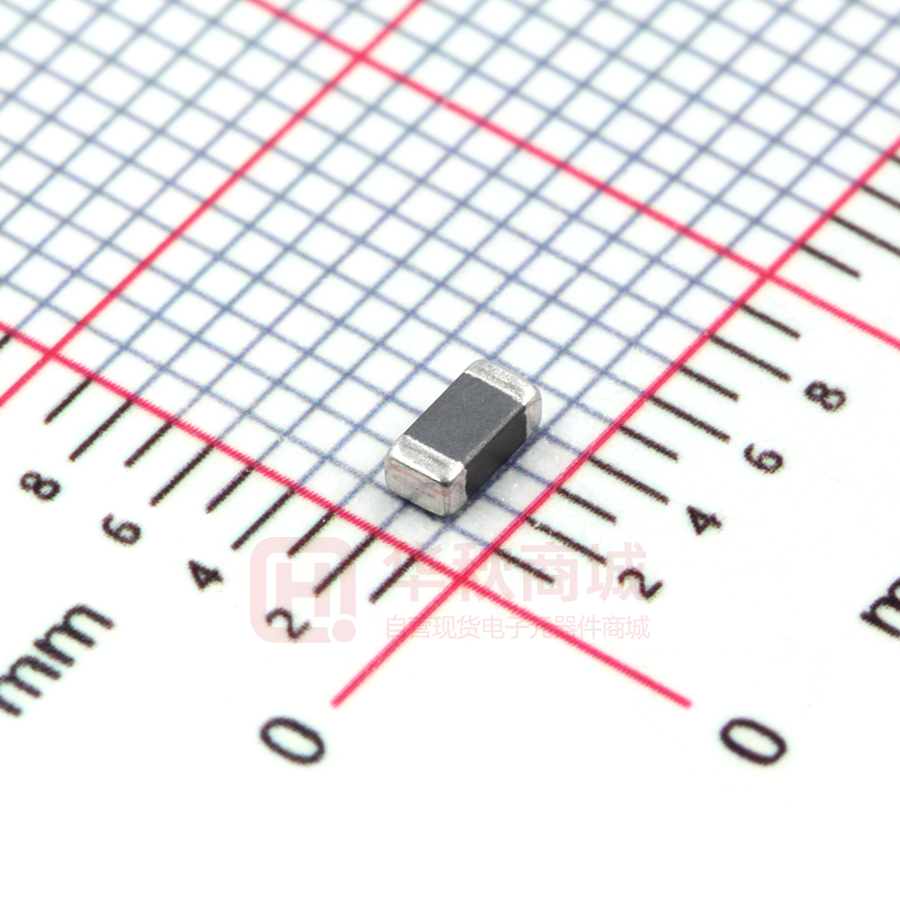

    贴片磁珠 1206 120Ω@100MHz ±25% 3.5A 20mΩ
BLM31PG121SZ1L 数据手册
Reference Only Spec. No. JENF243A-9115E-01 P.1/9 Chip Ferrite Bead BLM31□□□□□SZ1□ Murata Standard Reference Specification [AEC-Q200] 1. Scope This reference specification applies to Chip Ferrite Bead for Automotive Electronics BLM31_SZ Series based on AEC-Q200 except for Power train and Safety. 2. Part Numbering (ex.) BL M 31 (1) (2) (3) (1)Product ID (2)Type (3)Dimension (L×W) PG 601 S Z 1 L (4) (5) (6) (7) (8) (9) (4)Characteristics (5)Typical Impedance at 100MHz (6)Performance (7)Category (for Automotive Electronics) (8)Numbers of Circuit (9)Packaging (L: Taping) 3. Rating Customer Part Number MURATA Part Number Impedance (Ω) (at 100MHz, Under Standard Testing Condition) Rated Current (mA) (Note1) DC Resistance (Ω max.) ESD Rank 2:2kV Values After Testing Initial Values at 85℃ at 125℃ BLM31PG330SZ1L 33±25% 6000 3500 0.009 BLM31PG330SZ1B BLM31PG500SZ1L 35 min. 3500 2300 0.015 BLM31PG500SZ1B BLM31PG121SZ1L 120±25% 3500 2000 0.02 BLM31PG121SZ1B BLM31PG391SZ1L 390±25% 2000 1250 0.05 BLM31PG391SZ1B BLM31PG601SZ1L 600±25% 1500 1000 0.08 BLM31PG601SZ1B BLM31SN500SZ1L 50±12.5Ω 12000 10000 0.0016 BLM31SN500SZ1B • Operating Temperature: -55°C to +125°C • Storage Temperature: -55°C to +125°C 0.018 0.03 0.04 2 0.10 0.16 0.0021 Standard Testing Conditions (Note1)Rated Current is derated as right figure depending on the operating temperature. < In case of doubt > Temperature : 20°C±2 °C Humidity : 60%(RH) to 70%(RH) Atmospheric pressure : 86kPa to 106kPa R a te d C u r re n t ( A ) < Unless otherwise specified > Temperature : Ordinary Temp. (15 °C to 35 °C ) Humidity : Ordinary Humidity (25%(RH) to 85%(RH)) 85℃x Describe the Rated current as x[A] in case of more than 1A. 1 125℃ 0 85 125 Operating Temperature (°C) MURATA MFG.CO., LTD. Reference Only Spec. No. JENF243A-9115E-01 P.2/9 4. Style and Dimensions ■ Equivalent Circuit 1.6±0.2 1.1±0.2 3.2±0.2 ( 0.7±0.3 ) Resistance element becomes dominant at high frequencies. ■ Unit Mass (Typical value) 0.025 g : Electrode (in mm) (in mm) 5.Marking No marking. 6. Specifications 6-1. Electrical No. Item 6-1-1 Impedance Specification Meet item 3. 6-1-2 DC Resistance Meet item 3. Test Method Measuring Frequency : 100MHz±1MHz Measuring Equipment : KEYSIGHT4291A or the equivalent Test Fixture : KEYSIGHT16192A or the equivalent Measuring Equipment : Digital multi meter *Except resistance of the Substrate and Wire 6-2. Mechanical Performance (based on Table 13 for FILTER EMI SUPPRESSORS/ FILTERS) AEC-Q200 Rev.D issued June. 1 2010 AEC-Q200 No. Stress Test Method 3 High 1000hours at 125 deg C Temperature Set for 24hours at room Exposure temperature, then measured. Murata Specification / Deviation Meet Table A after testing. Table A Appearance No damage Impedance Within ±30% Change (for BLM31SN within±50%) (at 100MHz) DC Meet item 3. Resistance 1000cycles -55 deg C to +125 deg C Set for 24hours at room temperature, then measured. Per EIA469 No electrical tests Meet Table A after testing. Biased Humidity 1000hours at 85 deg C, 85%RH Apply max rated current. Meet Table A after testing. 8 Operational Life Apply 125 deg C 1000hours Set for 24hours at room temperature, then measured Meet Table A after testing. If the rated current of parts exceed 1A, the operating temperature should be 85 deg C. 9 External Visual Visual inspection No abnormalities 4 Temperature Cycling 5 Destructive Physical Analysis 7 No defects MURATA MFG.CO., LTD. Spec. No. JENF243A-9115E-01 Reference Only AEC-Q200 No. Stress Test Method 10 Physical Dimension Meet ITEM 4 No defects (Style and Dimensions) Murata Specification / Deviation 12 Resistance to Solvents Per MIL-STD-202 Method 215 Not Applicable 13 Mechanical Shock Meet Table B after testing. Table B 14 Vibration Per MIL-STD-202 Method 213 Condition F: 1500g’s(14.7N)/0.5ms/ Half sine Appearance Impedance Change (at 100MHz) DC Resistance No damage Within ±30% Meet item 3. Meet Table B after testing. 17 ESD 5g's(0.049N) for 20 minutes, 12cycles each of 3 orientations Test from 10-2000Hz. Solder temperature 260C+/-5 deg C Immersion time 10s Per AEC-Q200-002 18 Solderability Per J-STD-002 19 Electrical Characterization 20 Flammability Measured : Impedance Method b : Not Applicable 95% of the terminations is to be soldered. No defects Per UL-94 Not Applicable 21 Board Flex Epoxy-PCB(1.6mm) Deflection 2mm(min) 60s minimum holding time Per AEC-Q200-006 Meet Table B after testing. Per ISO-7637-2 Not Applicable 15 Resistance to Soldering Heat 22 Terminal Strength 30 Electrical Transient Conduction Pre-heating:150C +/-10 deg,60s to 90s Meet Table A after testing. Meet Table A after testing. ESD Rank: Refer to Item 3. Rating No defects -0 3.5±0.1 +0.3 φ 1.0- 0 1.9±0.1 1.3±0.1 1.3±0.1 0.2±0.1 8.0±0.3 φ 1.5+0.1 3.5±0.05 2.0±0.05 4.0±0.1 4.0±0.1 1.75±0.1 7. Specification of Packaging 7-1. Appearance and Dimensions (8mm-wide plastic tape) Direction of feed (in mm) *Dimension of the Cavity is measured at the bottom side. MURATA MFG.CO., LTD. P.3/9 Reference Only Spec. No. JENF243A-9115E-01 P.4/9 (1) Taping Products shall be packaged in the each embossed cavity of 8mm-wide, 4mm-pitch and plastic tape continuously and sealed by cover tape. (2) Sprocket hole : Sprocket hole shall be located on the left hand side toward the direction of feed. (3) Spliced point : The cover tape has no spliced point. (4) Missing components number Missing components number within 0.1% of the number per reel or 1 pc., whichever is greater, and are not continuous. The specified quantity per reel is kept. 7-2. Tape Strength (1) Pull Strength Plastic tape Cover tape 5N min. 10N min. 165 to 180 degree (2) Peeling off force of Cover tape 0.2N to 0.7N (Minimum value is typical.) *Speed of Peeling off:300mm/min F Cover tape Plastic tape 7-3. Taping Condition (1) Standard quantity per reel Quantity per 180mm reel : 3000 pcs. / reel (2) There shall be leader-tape (cover tape only and empty tape ) and trailer- tape (empty tape) as follows. (3) Marking for reel The following items shall be marked on a label and the label is stuck on the reel. (Customer part number, MURATA part number, Inspection number(∗1), RoHS marking(∗2), Quantity, etc) ∗1) « Expression of Inspection No. » □□ OOOO ××× (1) Factory Code (2) Date (3) Serial No. (1) (2) (3) First digit : Year / Last digit of year Second digit : Month / Jan. to Sep. → 1 to 9, Oct. to Dec. → O, N, D Third, Fourth digit : Day ∗2) « Expression of RoHS marking » ROHS – Y (△) (1) RoHS regulation conformity parts. (2) MURATA classification number (1) (2) (4) Outside package These reels shall be packed in the corrugated cardboard package and the following items shall be marked on a label and the label is stuck on the box. (Customer name, Purchasing order number, Customer part number, MURATA part number, RoHS marking (∗2), Quantity, etc) (5) Dimensions of reel and taping (leader-tape, trailer-tape) Trailer 160 min. 2.0±0.5 Leader Label 190 min. 210 min. Empty tape Cover tape φ 13.0±0.2 +1 φ 60 -0 φ 21.0±0.8 9.0 +1 -0 Direction of feed 13.0±1.4 +0 φ 180 -3 (in mm) MURATA MFG.CO., LTD. Reference Only Spec. No. JENF243A-9115E-01 P.5/9 7-4. Specification of Outer Case Label H D W Outer Case Dimensions Standard Reel Quantity in Outer Case (mm) (Reel) W D H 186 186 93 5 ∗ Above Outer Case size is typical. It depends on a quantity of an order. 8. ! Caution 8-1. Rating Do not use products beyond the Operating Temperature Range and Rated Current. 8-2. Surge current Excessive surge current (pulse current or rush current) than specified rated current applied to the product may cause a critical failure, such as an open circuit, burnout caused by excessive temperature rise. Please contact us in advance in case of applying the surge current. 8-3. Fail Safe Be sure to provide an appropriate fail-safe function on your product to prevent from a second damage that may be caused by the abnormal function or the failure of our products. 8-4. Limitation of Applications Please contact us before using our products for the applications listed below which require especially high reliability for the prevention of defects which might directly cause damage to the third party's life, body or property. (1)Aircraft equipment (6)Disaster prevention / crime prevention equipment (2)Aerospace equipment (7)Traffic signal equipment (3)Undersea equipment (8)Transportation equipment (trains,ships,etc.) (4)Power plant control equipment (9) Data-processing equipment (5)Medical equipment (10)Applications of similar complexity and /or reliability requirements to the applications listed in the above 9. Notice This product is designed for solder mounting. Please consult us in advance for applying other mounting method such as conductive adhesive. 9-1. Land pattern designing • Standard land dimensions (Flow and Reflow soldering) Chip Ferrite Bead Rated Current (A) Type c d BLM31PG BLM31SN a 1.5/2 3.5 6 10~12 Land pad thickness and dimension d 18µm 1.8 2.4 6.4 - 35µm 1.8 1.8 3.3 9.8 70µm 1.8 1.8 1.8 4.9 (in mm) b Solder Resist *The excessive heat by land pads may cause deterioration at joint of products with substrate. Pattern Type BLM31PG BLM31SN MURATA MFG.CO., LTD. Soldering Flow Reflow a 2.4 2.0 b 4.7 4.3 c 1.2 1.8 Reference Only Spec. No. JENF243A-9115E-01 P.6/9 • Land dimensions on Flow soldering for 2.5mm pitch mounting Chip Ferrite Bead *As for BLM31PG type, taking land pad thickness and rated current into account. 2 .5 m m p itc h a 2.4 e e a c 1.2 d 1.3 e 1.35 (in mm) *The pattern shall be designed to above drawing to prevent causing the solder bridge when products are mounted by 2.5mm pitch flow soldering. c b b 4.7 d c e a Solder Resist e b Pattern d 9-2. Soldering Conditions Products can be applied to reflow and flow soldering. (1) Flux,Solder Flux Use rosin-based flux, but not highly acidic flux (with chlorine content exceeding 0.2(wt)%. ) Do not use water-soluble flux. Solder Use Sn-3.0Ag-0.5Cu solder Standard thickness of solder paste : 100 µm to 200 μm (2) Soldering conditions • Pre-heating should be in such a way that the temperature difference between solder and ferrite surface is limited to 150℃ max. Also cooling into solvent after soldering should be in such a way that the temperature difference is limited to 100℃ max. Insufficient pre-heating may cause cracks on the ferrite, resulting in the deterioration of product quality. • Standard soldering profile and the limit soldering profile is as follows. The excessive limit soldering conditions may cause leaching of the electrode and / or resulting in the deterioration of product quality. (3) soldering profile □Flow soldering profile Temp. (℃) 265℃±3℃ 250℃ Limit Profile 150 Heating Time 60s min. Pre-heating Heating Cycle of flow Standard Profile 150℃、60s min. 250℃、4~6s 2 times Standard Profile Time. (s) Limit Profile 265℃±3℃、5s max. 2 times MURATA MFG.CO., LTD. Reference Only Spec. No. JENF243A-9115E-01 □Reflow soldering profile Temp. (℃) 260℃ 245℃±3℃ 230℃ 220℃ Limit Profile 180 150 Standard Profile 30s~60s 60s max. 90s±30s Pre-heating Heating Peak temperature Cycle of reflow Standard Profile 150~180°C 、90s±30s above 220°C、30s~60s 245±3°C 2 times Time. (s) Limit Profile above 230°C、60s max. 260°C,10s 2 times 9-3. Reworking with soldering iron • Pre-heating: 150°C, 1 min • Soldering iron output: 80W max. • Tip temperature: 350°C max. • Tip diameter:φ3mm max. • Soldering time : 3 (+1, -0) seconds. • Times : 2times max. Note: Do not directly touch the products with the tip of the soldering iron in order to prevent the crack on the ferrite material due to the thermal shock. 9-4. Solder Volume Solder shall be used not to be exceed as shown below. Upper Limit Recommendable 1/3T≦t≦T (T: Chip thickness) t Accordingly increasing the solder volume, the mechanical stress to product is also increased. Exceeding solder volume may cause the failure of mechanical or electrical performance. 9-5. Attention regarding P.C.B. bending The following shall be considered when designing and laying out P.C.B.'s. (1) P.C.B. shall be designed so that products are not subject to the mechanical stress for board warpage. a Products shall be located in the sideways direction (Length: a D *1 A > B A > C C B D A Slit *1 A > D is valid when stress is added vertically to the perforation as with Hand Separation. If a Cutting Disc is used, stress will be diagonal to the PCB, therefore A > D is invalid. (3) Mounting Components Near Screw Holes When a component is mounted near a screw hole, it may be affected by the board deflection that occurs during the tightening of the screw. Mount the component in a position as far away from the screw holes as possible. Screw Hole Recommended 9-6. Mounting density Add special attention to radiating heat of products when mounting the inductor near the products with heating. The excessive heat by other products may cause deterioration at joint of this product with substrate. 9-7. Operating Environment Do not use this product under the following environmental conditions, on deterioration of the Insulation Resistance of the Ferrite material and/or corrosion of Inner Electrode may result from the use. (1) in the corrodible atmosphere such as acidic gases, alkaline gases, chlorine, sulfur gases, organic gases and etc (the sea breeze, Cl2, H2S, NH3, SO2, NO2,etc) (2) in the atmosphere where liquid such as organic solvent, may splash on the products. (3) in the atmosphere where the temperature / humidity changes rapidly and it is easy to dew. 9-8. Resin coating The impedance value may change and/or it may affect on the product's performance due to high cure-stress of resin to be used for coating / molding products. So please pay your careful attention when you select resin. In prior to use, please make the reliability evaluation with the product mounted in your application set. MURATA MFG.CO., LTD. Spec. No. JENF243A-9115E-01 Reference Only P.9/9 9-9.Cleaning Conditions Products shall be cleaned on the following conditions. (1) Cleaning temperature shall be limited to 60°C max. (40°C max. for IPA.) (2) Ultrasonic cleaning shall comply with the following conditions, avoiding the resonance phenomenon at the mounted products and P.C.B. Power:20W/ max. Frequency:28kHz to 40kHz Time:5 min max. (3) Cleaner 1.Alternative cleaner •Isopropyl alcohol (IPA) 2.Aqueous agent •PINE ALPHA ST-100S (4) There shall be no residual flux and residual cleaner after cleaning. In the case of using aqueous agent, products shall be dried completely after rinse with de-ionized water in order to remove the cleaner. (5) Other cleaning Please contact us. 9-10. Handling of a substrate After mounting products on a substrate, do not apply any stress to the product caused by bending or twisting to the substrate when cropping the substrate, inserting and removing a connector from the substrate or tightening screw to the substrate. Excessive mechanical stress may cause cracking in the product. Bending Twisting 9-11. Storage Conditions (1) Storage period Use the products within 6 months after delivered. Solderability should be checked if this period is exceeded. (2) Storage conditions • Products should be stored in the warehouse on the following conditions. Temperature : -10°C to 40°C Humidity : 15% to 85% relative humidity No rapid change on temperature and humidity • Don't keep products in corrosive gases such as sulfur, chlorine gas or acid, or it may cause oxidization of electrode, resulting in poor solderability. • Products should be stored on the palette for the prevention of the influence from humidity, dust and so on. • Products should be stored in the warehouse without heat shock, vibration, direct sunlight and so on. • Products should be stored under the airtight packaged condition. (3) Delivery Care should be taken when transporting or handling product to avoid excessive vibration or mechanical shock. 10. ! Note (1)Please make sure that your product has been evaluated in view of your specifications with our product being mounted to your product. (2)You are requested not to use our product deviating from the agreed specifications. (3) The contents of this reference specification are subject to change without advance notice. Please approve our product specifications or transact the approval sheet for product specifications before ordering. MURATA MFG.CO., LTD.
