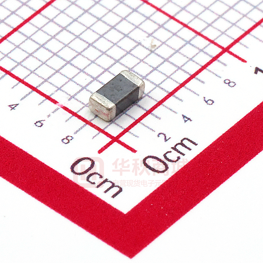

BLM31SN500SH1L 数据手册
Spec No.: JENF243A_9105Q-01 P1/9 CHIP FERRITE BEAD BLM31□□□□□SH1□ Murata Standard Reference Specification [AEC-Q200] 1. Scope This reference specification applies to chip ferrite bead BLM31_SH series for automotive electronics based on AEC-Q200. 2. Part Numbering (Ex.) BL M 31 PG 601 S H 1 Product Type Dimension Characteristics Impedance Performance Category Numbers ID (L × W) (Typical value (For of circuit at 100 MHz) automotive) L Packaging L: taping 3. Part Number and Rating Operating temperature range Storage temperature range -55°C to +125°C -55°C to +125°C Murata Part number Impedance (Ω) at 100 MHz BLM31PG330SH1L 33±25% Customer Part number Rated current*1 (mA) DC resistance (Ω) max. ESD rank 5B: 12 kV Values after 6: 25kV testing Ambient temperature 85°C Ambient temperature 125°C Initial values 6000 3500 0.009 0.018 6 BLM31PG500SH1L 35 min. 3500 2300 0.015 0.03 6 BLM31PG121SH1L 120±25% 3500 2000 0.02 0.04 6 BLM31PG391SH1L 390±25% 2000 1250 0.05 0.10 6 BLM31PG601SH1L 600±25% 1500 1000 0.08 0.16 6 BLM31SN500SH1L 50±25% 12000 10000 0.0016 0.0021 6 *1 As shown in the diagram below, derating is applied to the rated current based on the operating temperature. 4. Testing Conditions Unless otherwise specified Temperature: ordinary temperature (15°C to 35°C) Humidity: ordinary humidity [25% to 85% (RH)] In case of doubt Temperature: 20°C±2°C Humidity: 60% to 70% (RH) Atmospheric pressure: 86 kPa to 106 kPa MURATA MFG CO., LTD Spec No.: JENF243A_9105Q-01 P2/9 5. Appearance and Dimensions Equivalent circuit Unit mass (typical value): 0.025 g 6. Marking No marking. 7. Electrical Performance No. Item Specification Test method 7.1 Impedance Meet chapter 3 ratings. Measuring equipment: Keysight 4291A or the equivalent Measuring frequency: 100 MHz±1 MHz Measuring fixture: Keysight 16192A or the equivalent 7.2 DC resistance Meet chapter 3 ratings. Measuring equipment: digital multimeter Substrate wiring resistance is excluded. 8. AEC-Q200 Requirement 8.1 Performance [(based on table 13 for filter EMI suppressors/filters) AEC-Q200 Rev.D issued June 1, 2010] AEC-Q200 No. 3 Stress High temperature exposure Murata specification/deviation Test method 1000 h at 125°C Set for 24 h at room condition, then measured. Meet table A after testing. Table A Appearance No damage Impedance change (at 100 MHz) Within ±30% (within ±50% for BLM31SN) DC Resistance Meet chapter 3 ratings. 4 Temperature cycling 1000 cycles -55°C to +125°C Set for 24 h at room condition, then measured. Meet table A after testing. 5 Destructive physical analysis Per EIA469 No electrical tests No defects 7 Biased humidity 1000 h at 85°C, 85% (RH). Apply max rated current. Set for 24 h at room condition, then measured. Meet table A after testing. 8 Operational life Apply 125°C 1000 h Set for 24 h at room condition, then measured. Meet table A after testing. If the rated current of parts exceed 1A, the operating temperature should be 85 °C. 9 External visual Visual inspection No abnormalities 10 Physical dimension Meet chapter 5, "Appearance and Dimensions". No defects 12 Resistance to solvents Per MIL-STD-202 Method 215 Not applicable MURATA MFG CO., LTD Spec No.: JENF243A_9105Q-01 P3/9 AEC-Q200 No. Stress 13 Mechanical shock Murata specification/deviation Test method Per MIL-STD-202 Method 213 Condition F: 1500 g’s (14.7 N), 0.5 ms, half sine Meet table B after testing. Table B Appearance No damage Impedance change (at 100 MHz) Within ±30% DC Resistance Meet chapter 3 ratings. 14 Vibration 5 g's (0.049 N) for 20 min, 12 cycles each of 3 orientations Test from 10 Hz to 2000 Hz Meet table B after testing. 15 Resistance to soldering heat Solder temperature 260°C±5°C Immersion time 10 s Pre-heating: 150°C±10°C, 60 s to 90 s Meet table A after testing. 17 ESD Per AEC-Q200-002 Meet table A after testing. ESD rank: Refer to chapter 3 ratings. 18 Solderability Per J-STD-002 Method b: not applicable 95% of the terminations is to be soldered. 19 Electrical Measured: impedance characterization No defects 20 Flammability Per UL-94 Not applicable 21 Board flex Epoxy-PCB (1.6 mm) Deflection 2 mm (min.) 60 s minimum holding time Meet table B after testing. 22 Terminal strength Per AEC-Q200-006 No defects 30 Electrical transient conduction Per ISO-7637-2 Not applicable 9. Specification of Packaging 9.1 Appearance and dimensions of tape (8 mm width/plastic tape) A 1.9±0.1 B 3.5±0.1 t 1.3±0.1 t' 0.2±0.1 (in mm) * The dimensions of the cavity are measured at its bottom. 9.2 Taping specifications Packing quantity (Standard quantity) 3000 pcs/reel Packing method The products are placed in cavities of a carrier tape and sealed by a cover tape (top tape and bottom tape when the cavities of the carrier tape are punched type). Feed hole position The feed holes on the carrier tape are on the right side when the cover tape (top tape when the cavities of the carrier tape are punched type) is pulled toward the user. Joint The carrier tape and cover tape (top tape when the cavities of the carrier tape are punched type) are seamless. Number of missing products Number of missing products within 0.025% of the number per reel or 1 pc., whichever is greater, and are not continuous. The specified quantity per reel is kept. MURATA MFG CO., LTD Spec No.: JENF243A_9105Q-01 P4/9 9.3 Break down force of tape Cover tape (or top tape) 10 N min. Bottom tape (only when the cavities of the carrier tape are punched type) 5 N min. 9.4 Peeling off force of tape Speed of peeling off Peeling off force 300 mm/min 0.2 N to 0.7 N (The lower limit is for typical value.) 9.5 Dimensions of leader section, trailer section and reel A vacant section is provided in the leader (start) section and trailer (end) section of the tape for the product. The leader section is further provided with an area consisting only of the cover tape (or top tape). (See the diagram below.) 9.6 Marking for reel Customer part number, Murata part number, inspection number (*1), RoHS marking (*2), quantity, etc. *1 Expression of inspection No.: (1) Factory code  (2) Date □□ ○○○○ First digit: year/last digit of year (1) (2) (3) Second digit: month/Jan. to Sep.→1 to 9, Oct. to Dec.→O, N, D Third, Fourth digit: day (3) Serial No. *2 Expression of RoHS marking: (1) RoHS regulation conformity ROHSY () (2) Murata classification number (1) (2) 9.7 Marking on outer box (corrugated box) Customer name, purchasing order number, customer part number, Murata part number, RoHS marking (*2), quantity, etc. 9.8 Specification of outer box Label H D W Dimensions of outer box (mm) W D H 186 186 93 Standard reel quantity in outer box (reel) 5 * Above outer box size is typical. It depends on a quantity of an order. MURATA MFG CO., LTD Spec No.: JENF243A_9105Q-01 10. P5/9 Caution 10.1 Restricted applications Please contact us before using our products for the applications listed below which require especially high reliability for the prevention of defects which might directly cause damage to the third party's life, body or property. (1) Aircraft equipment (2) Aerospace equipment (3) Undersea (4) Power plant equipment control equipment (5) Medical equipment (6) Transportation equipment (7) Traffic signal (8) Disaster/crime (trains, ships, etc.) equipment prevention equipment (9) Data-processing (10) Applications of similar complexity and/or equipment reliability requirements to the applications listed in the above 10.2 Precautions on rating Avoid using in exceeded the rated temperature range, rated voltage, or rated current. Usage when the ratings are exceeded could lead to wire breakage, burning, or other serious fault. 10.3 Fail-safe Be sure to provide an appropriate fail-safe function on your product to prevent a second damage that may be caused by the abnormal function or the failure of our product. 10.4 Inrush current If an inrush current (or pulse current or rush current) that significantly exceeds the rated current is applied to the product, overheating could occur, resulting in wire breakage, burning, or other serious fault. 10.5 Corrosive gas Please refrain from use since contact with environments with corrosive gases (sulfur gas [hydrogen sulfide, sulfur dioxide, etc.], chlorine, ammonia, etc.) or oils (cutting oil, silicone oil, etc.) that have come into contact with the previously stated corrosive gas environment will result in deterioration of product quality or an open from deterioration due to corrosion of product electrode, etc. We will not bear any responsibility for use under these environments. 11. Precautions for Use This product is designed to be mounted by soldering. If you want to use other mounting method, for example, using a conductive adhesive, please consult us beforehand. Also, if repeatedly subjected to temperature cycles or other thermal stress, due to the difference in the coefficient of thermal expansion with the mounting substrate, the solder (solder fillet part) in the mounting part may crack. The occurrence of cracks due to thermal stress is affected by the size of the land where mounted, the solder volume, and the heat dissipation of the mounting substrate. Carefully design it when a large change in ambient temperature is assumed. 11.1 Land dimensions The following diagram shows the recommended land dimensions for flow and reflow soldering. a Flow Reflow 2.4 2.0 b 4.7 4.3 c 1.2 1.8 (in mm) Pattern thickness and dimension d Type Rated current (A) BLM31PG 1.5/2 BLM31PG 3.5 2.4 1.8 1.8 BLM31PG 6 6.4 3.3 1.8 BLM31SN 10 to 12 - 9.8 4.9 18 μm 35 μm 70 μm 1.8 1.8 1.8 If heat generation from patterns is large, please pay attention since the joint of products with substrates may deteriorate. (in mm) MURATA MFG CO., LTD Spec No.: JENF243A_9105Q-01 P6/9 *If products are mounted by 2.5 mm pitch flow soldering, design the pattern so the pattern is in a staggered arrangement as shown below to prevent solder bridges. *For BLM31PG types, consider the pattern thickness and rated current. a b c d e 2.4 4.7 1.2 1.3 1.35 (in mm) 11.2 Flux and solder used Flux • Use a rosin-based flux. • Do not use a highly acidic flux with a halide content exceeding 0.2(wt)% (chlorine conversion value). • Do not use a water-soluble flux. Solder • Use Sn-3.0Ag-0.5Cu solder. • Standard thickness of solder paste: 100 μm to 200 μm If you want to use a flux other than the above, please consult our technical department. 11.3 Soldering conditions (flow, reflow) • Pre-heating should be in such a way that the temperature difference between solder and product surface is limited to 150°C max. Cooling into solvent after soldering also should be in such a way that the temperature difference is limited to 100°C max. Insufficient pre-heating may cause cracks on the product, resulting in the deterioration of product quality. • Standard soldering profile and the limit soldering profile is as follows. The excessive limit soldering conditions may cause leaching of the electrode and/or resulting in the deterioration of product quality. (1) Flow Temp. (℃) 265℃±3℃ 250℃ Limit Profile 150 Heating Time 60s min. Standard Profile Time. (s) Standard profile Limit profile Pre-heating 150°C/60 s min. 150°C/60 s min. Heating 250°C/4 s to 6 s 265°C±3°C/5 s 2 times 2 times Number of flow cycles MURATA MFG CO., LTD Spec No.: JENF243A_9105Q-01 P7/9 (2) Reflow Temp. (℃) 260℃ 245℃±3℃ 230℃ 220℃ Limit Profile 180 150 Standard Profile 30s~60s 60s max. 90s±30s Time. (s) Standard profile Limit profile Pre-heating 150°C to 180°C/90 s±30 s 150°C to 180°C/90 s±30 s Heating Above 220°C/30 s to 60 s Above 230°C/60 s max. 245°C±3°C 260°C/10 s 2 times 2 times Peak temperature Number of reflow cycles 11.4 Reworking with soldering iron The following requirements must be met to rework a soldered product using a soldering iron. Item Requirement Pre-heating Tip temperature of soldering iron 150°C/approx. 1 min 350°C max. Power consumption of soldering iron Tip diameter of soldering iron Soldering time Number of reworking operations 80 W max. ø3 mm max. 3 s (+1 s, -0 s) 2 times max. * Avoid a direct contact of the tip of the soldering iron with the product. Such a direction contact may cause cracks in the ceramic body due to thermal shock. 11.5 Solder volume Solder shall be used not to be exceeded the upper limits as shown below. An increased solder volume increases mechanical stress on the product. Exceeding solder volume may cause the failure of mechanical or electrical performance. 11.6 Product's location The following shall be considered when designing and laying out PCBs. (1) PCB shall be designed so that products are not subject to mechanical stress due to warping the board. [Products direction] Products shall be located in the sideways direction (length: a < b) to the mechanical stress. a b 〈 Poor example〉 〈 Good example〉 MURATA MFG CO., LTD Spec No.: JENF243A_9105Q-01 P8/9 (2) Components location on PCB separation It is effective to implement the following measures, to reduce stress in separating the board. It is best to implement all of the following three measures; however, implement as many measures as possible to reduce stress. Contents of measures Stress level (1) Turn the mounting direction of the component parallel to the board separation surface. A > D*1 (2) Add slits in the board separation part. A>B (3) Keep the mounting position of the component away from the board separation surface. A>C *1 A > D is valid when stress is added vertically to the perforation as with hand separation. If a cutting disc is used, stress will be diagonal to the PCB, therefore A > D is invalid. (3) Mounting components near screw holes When a component is mounted near a screw hole, it may be affected by the board deflection that occurs during the tightening of the screw. Mount the component in a position as far away from the screw holes as possible. 11.7 Handling of substrate After mounting products on a substrate, do not apply any stress to the product caused by bending or twisting to the substrate when cropping the substrate, inserting and removing a connector from the substrate or tightening screw to the substrate. Excessive mechanical stress may cause cracking in the product. Bending Twisting 11.8 Cleaning Excessive ultrasonic oscillation during cleaning can cause the PCBs to resonate, resulting in cracked chips or broken solder joints. Before starting your production process, test your cleaning equipment / process to insure it does not degrade this product. MURATA MFG CO., LTD Spec No.: JENF243A_9105Q-01 P9/9 11.9 Storage and transportation Storage period Use the product within 6 months after delivery. If you do not use the product for more than 6 months, check solderability before using it. Storage conditions • The products shall be stored in a room not subject to rapid changes in temperature and humidity. The recommended temperature range is -10°C to +40°C. The recommended relative humidity range is 15% to 85%. Keeping the product in corrosive gases, such as sulfur, chlorine gas or acid may cause the poor solderability. • Do not place the products directly on the floor; they should be placed on a palette so that they are not affected by humidity or dust. • Avoid keeping the products in a place exposed to direct sunlight, heat or vibration. • Do not keep products in bulk packaging. Bulk storage could result in collisions between the products or between the products and other parts, resulting in chipping or wire breakage. • Avoid storing the product by itself bare (i.e. exposed directly to air). Transportation Excessive vibration and impact reduces the reliability of the products. Exercise caution when handling the products. 11.10 Resin coating (including moisture-proof coating) When the product is coated/molded with resin, its electrical characteristics may change. A wire breakage issue may occur by mechanical stress caused by the resin, amount/cured shape of resin, or operating condition etc. Some resins contain impurities or hydrolyzable chlorine, which could result in corrosion of the conducting materials, leading to wire breakage. So, please pay your careful attention when you select resin in case of coating/molding the products with the resin. Prior to use the coating resin, please make sure no reliability issue is observed by evaluating products mounted on your board. 11.11 Mounting conditions Check the mounting condition before using. Using mounting conditions (nozzles, equipment conditions, etc.) that are not suitable for products may lead to pick up errors, misalignment, or damage to the product. 11.12 Operating environment Do not use this product under the following environmental conditions as it may cause deterioration of product quality. (1) In the corrodible atmosphere such as acidic gases, alkaline gases, chlorine, sulfur gases, organic gases and etc. (the sea breeze, Cl2, H2S, NH3, SO2, NO2, etc) (2) In the atmosphere where liquid such as organic solvent, may splash on the products. (3) In the atmosphere where the temperature/humidity changes rapidly and it is easy to dew. 11.13 Mounting density If this product is placed near heat-generating products, be sure to implement sufficient heat-dissipating measures. If this product is subjected to a significant amount of heat from other products, this could adversely affect product quality, resulting in a circuit malfunction or failure of the mounted section. Also, be sure that the product is used in a manner so that the heat that the product is subjected to from other products does not exceed the upper limit of the rated operating temperature for the product. 12. Note (1) Please make sure that your product has been evaluated in view of your specifications with our product being mounted to your product. (2) You are requested not to use our product deviating from the reference specifications. (3) The contents of this reference specification are subject to change without advance notice. Please approve our product specifications or transact the approval sheet for product specifications before ordering. MURATA MFG CO., LTD
