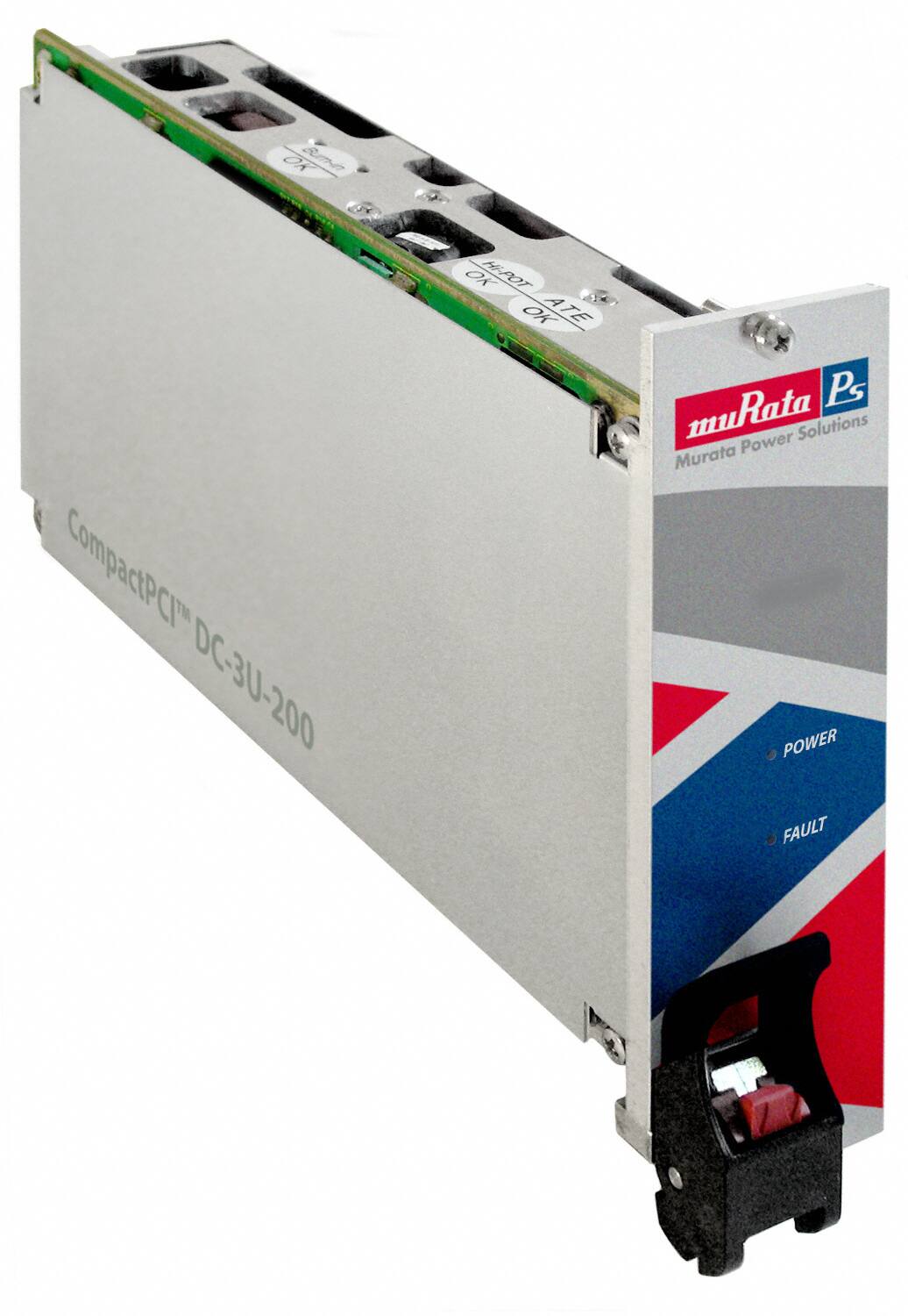

cPCI200D Series 200W 3Ux4HP DC/DC CompactPCI™ Power Supply SELECTION GUIDE Model Number Output Current Power 5V 3.3V 12V -12V 180W 18A1 27A 4A1 4A1 No Consult Factory No cPCI200D-2 225W 27A 27A2 4A2 4A2 No Consult Factory No cPCI200D-3 180W 1 18A 27A 4A 1 1 Yes Consult Factory No cPCI200D-4 225W 27A 27A2 4A2 4A2 Yes Consult Factory No 1 27A 1 4A 4A 1 No Active Yes 27A2 4A2 4A2 No Active Yes 1 1 Yes Active Yes 4A2 Yes Active Yes cPCI200D-1C 180W 18A  3Ux4HP Package cPCI200D-2C 225W 27A cPCI200D-3C 180W 1 18A 27A 4A cPCI200D-4C 225W 27A 27A2 4A2  PICMG 2.11 Compliant  RoHS Compliant INPUT CHARACTERISTICS  Wide range 36-72Vdc Input Range Parameter  IPMI Option Input Operating Voltage  47-pin I/O Connector Input Voltage Withstand  70% Efficiency Inrush Current The cPCI200 is a family of high-reliability, 200W, 3Ux4HP CompactPCI™ power supplies operating from a nominal 48Vdc input. The use of our patented V-Series topology yields high efficiency which consequently permits packaging of this product in a compact, single card slot format (4HP). ORing diodes and current sharing allow the cPCI200 to be operated in N+n parallel-redundant configurations. Available with an IPMI interface option, the cPCI200 was designed for hot-swap, redundant configurations to support high-availability (HA) telecom applications. With a widerange input of 36-72Vdc, safety agency approvals to UL60950 and EN60950, EMI compliance to ETSI and Telcordia standards, the cPCI200 was designed with globally-deployed systems in mind. Additional features include remote sense compensation, unit enable control (EN#), output inhibit control (INH#), output fault signal (FAL#), and thermal warning signal (DEG#). LEDs are provided for visual indication of input power presence, output inhibit, and output fault condition. The 4HP package and complement of global safety agency approvals provide for an advanced, high-density, high-efficiency power solution for your CompactPCI requirements. 4A 4A Conditions Min  Hot-Swap Capable DESCRIPTION Production Status cPCI200D-1 FEATURES  180/225W Power at 0-50ºC IPMI Typ Max Units 36 72 Vdc 34 75 Vdc 36Vdc input 20 Apk 72Vdc input 40 Apk OUTPUT CHARACTERISTICS Parameter Conditions Output Voltage Regulation3 Min Typ -2 +4 %Vnom Outputs V3 &V4 -10 +10 %Vnom PARD (V1 & V2) 20MHz bandwidth PARD (V3 & V4) 20MHz bandwidth Output Power, CPCI200D-2 & -4 Transient Response Over-Voltage Protection 120 Current Share Tolerance mVp-p 180 mVp-p 0 180 W 0 90 W 50ºC, 300lfm airflow 0 225 W 70ºC, 300lfm airflow 0 110 W ΔV, 50% load step ±10 %Vnom Settling time 500 μsec 135 %Vnom 125 V1 & V2 500 mA 50 mV V1&V2; full load Pri-Sec Isolation %/ºC 50 70ºC, 300lfm airflow Minimum Load4 5 0.02 50ºC, 300lfm airflow V1 & V2 Remote Sense Compensation Units Outputs V1 & V2 Temperature Coefficient Output Power, CPCI200D-1 & -3 Max ±10 %Itot 1.5 kVac Pri-Chassis 1.5 kVac Sec-Chassis 500 Vac Notes: 1. Maximum combined power from outputs V1, V3, & V4 not to exceed 90W. 2. Maximum combined power from outputs V2, V3, & V4 not to exceed 90W. 3. Total regulation includes line, load, and cross regulation. 4. Minimum load requirement of 500mA is required on V1 for 180W models and on V2 for 225W models. 5. Current share circuit is primary-referenced. For full details go to www.murata-ps.com/rohs ISO9001 CERTIFIED www.murata-ps.com Technical enquiries email: sales@murata-ps.com, tel: +1 508 339 3000 cPCI200D Series.B01 Page 1 of 5 cPCI200D Series 200W 3Ux4HP DC/DC CompactPCI™ Power Supply GENERAL CHARACTERISTICS Parameter Efficiency Conditions Min 48Vdc input, full load Max Units 440 kHz 70 Switching Frequency Weight Typ 400 Unpackaged % 420 636 g PROTECTION Parameter Thermal Shutdown Conditions/Response Inception Min Automatic recovery upon restoration to operational temperatures Typ Max Units 100 ºC Input Protection Internal line fuse, all models, Littlefuse R251010 or equivalent Over-Voltage Protection V1 & V2 Output Overload Protection Outputs are individually protected against overloads and indefinite short circuit with automatic recovery upon removal of the fault condition. Overload response for all outputs is constant-current mode. Hot-Swap Capability Design Verification Testing (DVT) confirms that voltage excursions on the output buses resulting from insertion/extraction events do not exceed the specified maximum of 10%. However, routing of power and signal lines in the mating backplane is critical to minimization of such excursions. In addition, performance can be critically affected by load characteristics including resistance, negative resistance, and reactive components. While the control loop responses have been designed for optimum hot-swap performance over a wide range of characteristics, there may be instances where the voltage excursions exceed published specifications. In such cases, the control loop responses can be modified to perform optimally. Output Fault Isolation Output isolation devices are present in all outputs to isolate faults within a failed power supply. Remote Sense Lead Protection Outputs V1 & V2 are capable of compensating for >50mV of line drop. Unit automatically reverts to local sensing in the event that the sense lines are opened for any reason. Unit is also protected against reversed or shorted sense leads. 125 10 A 135 %Vnom STATUS & CONTROL SIGNALS & INDICATORS Name Description Enable (EN#) Short pin on connector will enable the outputs when the mating pin is grounded. Supply will not power up until this pin is engaged to its mate in the backplane. Unit output will be inhibited as pin is disengaged from the mating connector. Output Inhibit (INH#) Secondary referenced; active low, TTL compatible. Logic “0” or short circuit to output return inhibits all outputs. Output Fault (FAL#) Secondary referenced. Open collector signal denotes that one of the output voltages has fallen below the lower regulation limit. Remote Sense (RS+, RS-) Connection of the sense leads across the load at the desired point of regulation will compensate for voltage distribution drops up to 50mV between the output terminals of the power supply and the point of connection. The unit reverts to local sensing if the sense lines are opened for any reason. The output is protected against shorted or open leads. Applies to outputs V1 & V2. Thermal Warning (DEG#) Secondary referenced. Open collector denotes a thermal warning; nominally, 10ºC prior to thermal shutdown. Fault Indicator LED An LED will illuminate red if the output voltages are not within specification, coincident with assertion of the FAL# signal. Power Present Indicator LED A green LED will be illuminated when the input voltage is present and above the minimum requirement. Output Inhibit Indicator LED An amber LED will be illuminated when the output is inhibited. IPMI Interface Option An I2C interface board is available as a factory-installed option to provide an IPMI interface to the SMBus. Status functions include output voltage and current levels as well as the DEG# warning. Output inhibit control can also be toggled via software command. See application note ACAN-02 for the satellite controller specification, ACAN-03 for the firmware update procedure, and ACAN-04 for the test procedure. www.murata-ps.com Technical enquiries email: sales@murata-ps.com, tel: +1 508 339 3000 cPCI200D Series.B01 Page 2 of 5 cPCI200D Series 200W 3Ux4HP DC/DC CompactPCI™ Power Supply ENVIRONMENTAL CHARACTERISTICS Parameter Conditions Min Max Units AmbientOperatingTemperature De-rate output power linearly above 50ºC to half-power at 70ºC. 0 70 ºC -20 85 Ambient Storage Temperature Cooling Airflow Humidity Altitude Typ ºC 50ºC ambient, full load 300 lfm Operating; non-condensing 10 90 % Storage; non-condensing 5 90 % Operating. De-rate operating ambient temperature by 2Cº per 1000ft above 5000ft. -200 10000 ft Storage -200 50000 ft ELECTROMAGNETIC COMPATIBILITY (EMC) Characteristic Compliance EN 300 386 Conducted Emissions NEBS GR-1089 CERTIFICATIONS Agency/Characteristic Standard UL UL1950 CSA CSA950 (per cUL) VDE EN60950 CE LVD Directive; self-certified RoHS EN Directive 2002/95/EC; self-certified; see Selection Guide table for specific model compliance SELV Self-certified Vibration MIL-STD-810D, Method 514.3, Procedure I; self-certified Shock MIL-STD-810D, Method 516.3, Procedure I; self-certified IPMI/IPMB POWER SUPPLY SATELLITE CONTROLLER FEATURES            Complies with IPMI V1.5 Rev 1.1 and IPMB V1.0 Complies with PICMG 2.9 (CompactPCI Systems Management Specification) 8 analog inputs configured for monitoring voltages and currents on power supply outputs V1 - V4 Monitors the thermal sensor (DEG#) and fault signal (FAL#) Output inhibit can be controlled by IPMI commands Self Test with LED indicator (can be read and overridden by IPMI commands) 6 programmable thresholds on each analog sensor; each threshold on each sensor can be enabled to generate event messages if that threshold is crossed Thermal sensor can be enabled to generate event messages Responds to all mandatory IPMI commands and numerous optional commands as indicated in the functional specification Firmware can be upgraded via the IPMB bus Includes Device SDR’s (Sensor Data Records) – These specify the type of sensor for each input (voltage, current, temperature, etc.) as well as the conversion formulas for raw ADC data to voltages, currents, etc.  Includes FRU data such as model number, serial number and firmware creation date www.murata-ps.com Technical enquiries email: sales@murata-ps.com, tel: +1 508 339 3000 cPCI200D Series.B01 Page 3 of 5 cPCI200D Series 200W 3Ux4HP DC/DC CompactPCI™ Power Supply PACKAGE SPECIFICATIONS (PIN ASSIGMENTS) PIN ASSIGNMENT: Pin assignment consistent with PICMG™ 2.11R1.0 specification. The table below details the PICMG™ assignment. Pin #1 Staging2 Signal Name Description 1-4 M V1 V1 Output 5-12 M RTN V1 and V2 Return 13-18 M V2 V2 Output 19 M RTN V3 Return 20 M V3 V3 Output 21 M V4 V4 Output 22 M RTN Signal Return 23 M RESERVED Reserved 24 M RTN V4 Return 25 M GA0 Geographic Address Bit 0 26 M RESERVED Reserved 27 S EN# Enable 28 M GA1 Geographic Address Bit 1 29 M V1ADJ V1 Adjust3 30 M V1 SENSE V1 Remote Sense 31 M GA2 Geographic Address Bit 2 32 M V2ADJ V2 Adjust3 33 M V2 SENSE V2 Remote Sense 34 M S RTN Sense Return 35 M V1 SHARE V1 Current Share3 36 M V3 SENSE V3 Remote Sense 37 M IPMB SCL IPMB Serial Clock Line 38 M DEG# Degrade Signal 39 M INH# Inhibit 40 M IPMB SDA IPMB Serial Data Line 41 M V2 SHARE V2 Current Share3 42 M FAL# Fail Signal 43 M IPMB PWR IPMB Power Input 44 M V3 SHARE V3 Current Share3 45 L CGND Chassis Grnd (Safety Grnd) 46 M ACN/+DC IN AC Input Neutral/+DC Input 47 M ACL/-DC IN AC Input Line/-DC Input 1. Pin numbers correspond to the female backplane connector. 2. Length Pins; S = Short Length Pins (Last Make, First Break) L = Long Length Pin (First Make, Last Break); M = Medium. 3. These functions are not used in the cPCI200D Series. www.murata-ps.com Technical enquiries email: sales@murata-ps.com, tel: +1 508 339 3000 cPCI200D Series.B01 Page 4 of 5 cPCI200D Series 200W 3Ux4HP DC/DC CompactPCI™ Power Supply PACKAGE SPECIFICATIONS MECHANICAL DIMENSIONS POSITRONICS CONNEC PART NO. PCIH47M400 6.68 [169.58] 6.40 [162.54] 0.1 [2.5] MIN MODEL NO. cPCI200DC PIN 21 3.937 -0.3 [100.00 ] +0.0 +.000 -.012 PIN 1 0.1 [2.5] MIN AIRFLOW MECHANICAL Shock: MIL-STD-810d, Method 516.3, Procedure 1. Vibration: MIL-STD-810d, Method 514.3, Procedure 1. Dimensions: 3U x 4HP x 160mm (see Mechanical above) EMC & SAFETY EMI: NEBS Compliant to GR1089 conducted emissions limit ETSI Compliant to ETS 300-386 conducted emissions limit Safety Agency Ratings 180 Watt 225 Watt Input Voltage: 36-72 VDC 36-72 VDC Input Current: 7A 9A Input Power: 260W 320W Agency Approvals: UL1950/CSA950, EN60950, CE Mark (Low Voltage Directive). USA: Murata Power Solutions, Inc. 11 Cabot Boulevard, Mansfield, MA 02048-1151 U.S.A. Tel: (508) 339-3000 (800) 233-2765 Fax: (508) 339-6356 www.murata-ps.com email: sales@murata-ps.com ISO 9001 and 14001 REGISTERED 10/30/08 Murata Power Solutions, Inc. makes no representation that the use of its products in the circuits described herein, or the use of other technical information contained herein, will not infringe upon existing or future patent rights. The descriptions contained herein do not imply the granting of licenses to make, use, or sell equipment constructed in accordance therewith. Specifications are subject to change without notice. © 2008 Murata Power Solutions, Inc. www.murata-ps.com Mansfield (MA), Tel: (508) 339-3000, email: sales@murata-ps.com Canada: Toronto, Tel: (866) 740-1232, email: toronto@murata-ps.com UK: Milton Keynes, Tel: +44 (0)1908 615232, email: mk@murata-ps.com France: Montigny Le Bretonneux, Tel: +33 (0)1 34 60 01 01, email: france@murata-ps.com Germany: München, Tel: +49 (0)89-544334-0, email: munich@murata-ps.com Japan: Tokyo, Tel: 3-3779-1031, email: sales_tokyo@murata-ps.com Osaka, Tel: 6-6354-2025, email: sales_osaka@murata-ps.com China: Shanghai, Tel: +86 215 027 3678, email: shanghai@murata-ps.com Guangzhou, Tel: +86 208 221 8066, email: guangzhou@murata-ps.com Singapore: Parkway Centre, Tel: +65 6348 9096, email: singapore@murata-ps.com Technical enquiries email: sales@murata-ps.com, tel: +1 508 339 3000 cPCI200D Series.B01 Page 5 of 5
