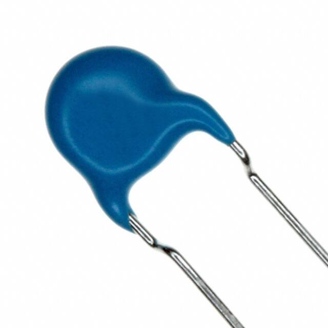

DEA1X3D271JA2B 数据手册
o Part Numbering Lead Type Disc Ceramic Capacitors (2kVdc-6.3kVdc) (Part Number) DE B B3 3D 102 K N2 A 1 2 3 4 7 8 9 5 6 6Capacitance Tolerance 1Product ID 2Series Category Product ID Code Contents Code Capacitance Tolerance C ±0.25pF A Class 1 (Char. SL) 2kVdc-3.15kVdc Rated D ±0.5pF J ±5% B Class 2 2kVdc-3.15kVdc Rated K ±10% Z +80%, –20% C DE Outline High Voltage Class 1, 2 6.3kVdc Rated LCD Backlight Inverter Circuit 6.3kVp-p F High Temperature Guaranteed, Low-dissipation Factor (Char. R) 2kVdc-3.15kVdc Rated H The first three digits (1Product ID and 2Series Category) express "Series Name." 7Lead Style Dimensions (mm) Code Lead Style A2 Vertical Crimp Long A3 A4 B2 Pitch of Components ø0.6±0.05 – ø0.6±0.05 – 5 7.5 5 B4 Vertical Crimp Short 7.5 10 C1 5 C3 7.5 ø0.5±0.05 Code Temperature Characteristics Cap. Change or Temp. Coeff. B3 B ±10% E3 E +20%, –55% CD 7.5 ø0.5±0.05 F3 F +30%, –80% D1 5 ø0.5±0.05 7.5 ø0.6±0.05 7.5 ø0.5±0.05 R3 R D3 D 1X SL 2C CH Temperature Range Lead Diameter 10 B3/J3 3Temperature Characteristics Lead Spacing –25 to +85°C ±15% –25 to +85°C D3 +15%, –30% +85 to +125°C DD +20%, –30% –25 to +125°C N2 +350 to –1000ppm/°C +20 to +85°C N3 +20 to +85°C N7 0±60ppm/°C Straight Long C4 Straight Short ø0.6±0.05 5 Vertical Crimp Taping 7.5 Straight Taping P3 5 7.5 – – 12.7 ø0.6±0.05 7.5 P2 4Rated Voltage 10 15 30 ø0.6±0.05 Code Rated Voltage 3D 2kVdc 3F 3.15kVdc Code Packaging 3J 6.3kVdc A Ammo Pack Taping LH 6.3kVp-p B Bulk 12.7 15 8Packaging 5Capacitance 9Individual Specification Code Expressed by three figures. The unit is pico-farad (pF). The first and second figures are significant digits, and the third figure expresses the number of zeros that follow the two numbers. For part number that cannot be identified without "Individual Specification," it is added at the end of part number, expressed by three-digit alphanumerics.
DEA1X3D271JA2B
物料型号:文档列出了不同类别的高压陶瓷电容器,包括DE、B、C、F和H系列,它们具有不同的额定电压和特性。
器件简介:这些电容器适用于高电压环境,如DE系列适用于1类和2类额定电压2kVdc至3.15kVdc,而F系列适用于6.3kVp-p的LCD背光逆变器电路。
引脚分配:文档中没有提供具体的引脚分配图,但通常这类电容器会有标记以指示极性。
参数特性:包括温度特性、额定电压、电容值和电容公差。例如,B3代码表示在-25至+85°C的温度范围内,电容变化率为+10%。
功能详解:文档详细描述了不同系列电容器的功能和应用,例如H系列强调了高温保证和低耗散因子。
应用信息:电容器可广泛应用于需要高电压和稳定性能的场合,如逆变器、电源模块等。
封装信息:提供了不同引脚样式的尺寸信息,包括引脚间距、直径和组件间距。
