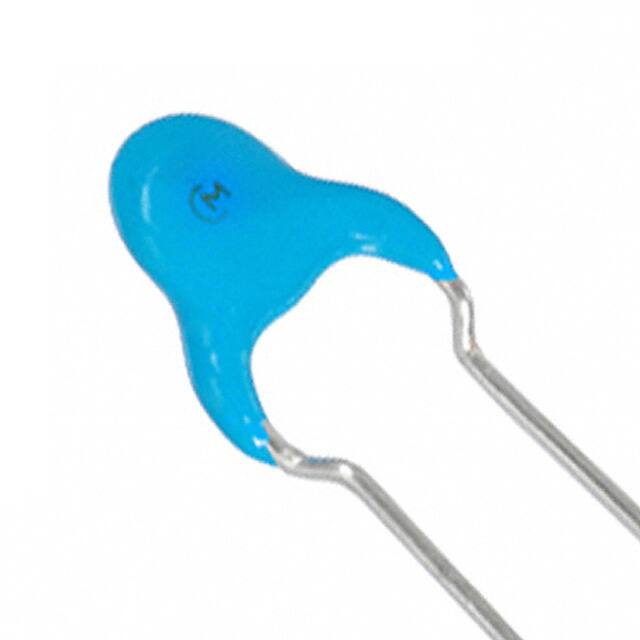

DEA1X3F150JDDB
DEA1X3F150JDDB
    MURATA-PS(村田)
    Radial
    贴片电容(MLCC) 3.15KV SL 15pF Radial, Disc ±5%
DEA1X3F150JDDB 数据手册
o Part Numbering Lead Type Disc Ceramic Capacitors (2kVdc-6.3kVdc) (Part Number) DE B B3 3D 102 K N2 A 1 2 3 4 7 8 9 5 6 6Capacitance Tolerance 1Product ID 2Series Category Product ID Code Contents Code Capacitance Tolerance C ±0.25pF A Class 1 (Char. SL) 2kVdc-3.15kVdc Rated D ±0.5pF J ±5% B Class 2 2kVdc-3.15kVdc Rated K ±10% Z +80%, –20% C DE Outline High Voltage Class 1, 2 6.3kVdc Rated LCD Backlight Inverter Circuit 6.3kVp-p F High Temperature Guaranteed, Low-dissipation Factor (Char. R) 2kVdc-3.15kVdc Rated H The first three digits (1Product ID and 2Series Category) express "Series Name." 7Lead Style Dimensions (mm) Code Lead Style A2 Vertical Crimp Long A3 A4 B2 Pitch of Components ø0.6±0.05 – ø0.6±0.05 – 5 7.5 5 B4 Vertical Crimp Short 7.5 10 C1 5 C3 7.5 ø0.5±0.05 Code Temperature Characteristics Cap. Change or Temp. Coeff. B3 B ±10% E3 E +20%, –55% CD 7.5 ø0.5±0.05 F3 F +30%, –80% D1 5 ø0.5±0.05 7.5 ø0.6±0.05 7.5 ø0.5±0.05 R3 R D3 D 1X SL 2C CH Temperature Range Lead Diameter 10 B3/J3 3Temperature Characteristics Lead Spacing –25 to +85°C ±15% –25 to +85°C D3 +15%, –30% +85 to +125°C DD +20%, –30% –25 to +125°C N2 +350 to –1000ppm/°C +20 to +85°C N3 +20 to +85°C N7 0±60ppm/°C Straight Long C4 Straight Short ø0.6±0.05 5 Vertical Crimp Taping 7.5 Straight Taping P3 5 7.5 – – 12.7 ø0.6±0.05 7.5 P2 4Rated Voltage 10 15 30 ø0.6±0.05 Code Rated Voltage 3D 2kVdc 3F 3.15kVdc Code Packaging 3J 6.3kVdc A Ammo Pack Taping LH 6.3kVp-p B Bulk 12.7 15 8Packaging 5Capacitance 9Individual Specification Code Expressed by three figures. The unit is pico-farad (pF). The first and second figures are significant digits, and the third figure expresses the number of zeros that follow the two numbers. For part number that cannot be identified without "Individual Specification," it is added at the end of part number, expressed by three-digit alphanumerics.
