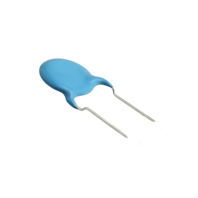

DEHR32E331KA2B
DEHR32E331KA2B
    MURATA-PS(村田)
    插件
DEHR32E331KA2B 数据手册
Reference Specification Type KY Safety Standard Certified Lead Type Disc Ceramic Capacitors for General Purpose Product specifications in this catalog are as of Mar. 2021, and are subject to change or obsolescence without notice. Please consult the approval sheet before ordering.Please read rating and Cautions first. Reference only CAUTION 1. OPERATING VOLTAGE When DC-rated capacitors are to be used in AC or ripple current circuits, be sure to maintain the Vp-p value of the applied voltage or the Vo-p which contains DC bias within the rated voltage range. When the voltage is started to apply to the circuit or it is stopped applying, the irregular voltage may be generated for a transit period because of resonance or switching. Be sure to use a capacitor within rated voltage containing these irregular voltage. Voltage Positional Measurement DC Voltage Vo-p DC+AC Voltage Vo-p AC Voltage Vp-p Pulse Voltage(1) Vp-p Pulse Voltage(2) Vp-p 2. OPERATING TEMPERATURE AND SELF-GENERATED HEAT Keep the surface temperature of a capacitor below the upper limit of its rated operating temperature range. Be sure to take into account the heat generated by the capacitor itself. When the capacitor is used in a high-frequency current, pulse current or the like, it may have the selfgenerated heat due to dielectric-loss. Applied voltage should be the load such as self-generated heat is within 20 °C on the condition of atmosphere temperature 25 °C. When measuring, use a thermocouple of small thermal capacity-K of φ0.1mm and be in the condition where capacitor is not affected by radiant heat of other components and wind of surroundings. Excessive heat may lead to deterioration of the capacitor’s characteristics and reliability.(Never attempt to perform measurement with the cooling fan running. Otherwise, accurate measurement cannot be ensured.) 3. TEST CONDITION FOR WITHSTANDING VOLTAGE (1) TEST EQUIPMENT Test equipment for AC withstanding voltage should be used with the performance of the wave similar to 50/60 Hz sine wave. If the distorted sine wave or over load exceeding the specified voltage value is applied, the defective may be caused. (2) VOLTAGE APPLIED METHOD When the withstanding voltage is applied, capacitor’s lead or terminal should be firmly connected to the out-put of the withstanding voltage test equipment, and then the voltage should be raised from near zero to the test voltage. If the test voltage without the raise from near zero voltage would be applied directly to capacitor, test voltage should be applied with the *zero cross. At the end of the test time, the test voltage should be reduced to near zero, and then capacitor’s lead or terminal should be taken off the out-put of the withstanding voltage test equipment. If the test voltage without the raise from near zero voltage would voltage sine wave be applied directly to capacitor, the surge voltage may arise, and therefore, the defective may be caused. 0V *ZERO CROSS is the point where voltage sine wave pass 0V. zero cross - See the right figure 4. FAIL-SAFE When capacitor would be broken, failure may result in a short circuit. Be sure to provide an appropriate fail-safe function like a fuse on your product if failure would follow an electric shock, fire or fume. 5. VIBRATION AND IMPACT Do not expose a capacitor or its leads to excessive shock or vibration during use. EGD08E 1 / 22 Reference only 6. SOLDERING When soldering this product to a PCB/PWB, do not exceed the solder heat resistance specification of the capacitor. Subjecting this product to excessive heating could melt the internal junction solder and may result in thermal shocks that can crack the ceramic element. When soldering capacitor with a soldering iron, it should be performed in following conditions. Temperature of iron-tip : 400 °C max. Soldering iron wattage : 50W max. Soldering time : 3.5s max. 7. BONDING, RESIN MOLDING AND COATING In case of bonding, molding or coating this product, verify that these processes do not affect the quality of capacitor by testing the performance of the bonded, molded or coated product in the intended equipment. In case of the amount of applications, dryness / hardening conditions of adhesives and molding resins containing organic solvents (ethyl acetate, methyl ethyl ketone, toluene, etc.) are unsuitable, the outer coating resin of a capacitor is damaged by the organic solvents and it may result, worst case, in a short circuit. The variation in thickness of adhesive, molding resin or coating may cause a outer coating resin cracking and/or ceramic element cracking of a capacitor in a temperature cycling. 8. TREATMENT AFTER BONDING, RESIN MOLDING AND COATING When the outer coating is hot (over 100 ℃) after soldering, it becomes soft and fragile. So please be careful not to give it mechanical stress. Failure to follow the above cautions may result, worst case, in a short circuit and cause fuming or partial dispersion when the product is used. 9. OPERATING AND STORAGE ENVIRONMENT The insulating coating of capacitors does not form a perfect seal; therefore, do not use or store capacitors in a corrosive atmosphere, especially where chloride gas, sulfide gas, acid, alkali, salt or the like are present. And avoid exposure to moisture. Before cleaning, bonding, or molding this product, verify that these processes do not affect product quality by testing the performance of a cleaned, bonded or molded product in the intended equipment. Store the capacitors where the temperature and relative humidity do not exceed -10 to 40 °C and 15 to 85%. Use capacitors within 6 months after delivered. Check the solderability after 6 months or more. 10. LIMITATION OF APPLICATIONS Please contact us before using our products for the applications listed below which require especially high reliability for the prevention of defects which might directly cause damage to the third party’s life, body or property. 1. Aircraft equipment 2. Aerospace equipment 3. Undersea equipment 4. Power plant control equipment 5. Medical equipment 6. Transportation equipment (vehicles, trains, ships, etc.) 7. Traffic signal equipment 8. Disaster prevention / crime prevention equipment 9. Data-processing equipment exerting influence on public 10. Application of similar complexity and/or reliability requirements to the applications listed in the above. EGD08E 2 / 22 Reference only NOTICE 1. CLEANING (ULTRASONIC CLEANING) To perform ultrasonic cleaning, observe the following conditions. Rinse bath capacity : Output of 20 watts per liter or less. Rinsing time : 5 min maximum. Do not vibrate the PCB/PWB directly. Excessive ultrasonic cleaning may lead to fatigue destruction of the lead wires. 2. CAPACITANCE CHANGE OF CAPACITORS ⋅ Class 1 capacitors Capacitance might change a little depending on a surrounding temperature or an applied voltage. Please contact us if you use for the strict time constant circuit. ⋅ Class 2 and 3 capacitors Class 2 and 3 capacitors like temperature characteristic B, E and F have an aging characteristic, whereby the capacitor continually decreases its capacitance slightly if the capacitor leaves for a long time. Moreover, capacitance might change greatly depending on a surrounding temperature or an applied voltage. So, it is not likely to be able to use for the time constant circuit. Please contact us if you need a detail information. 3. PERFORMANCE CHECK BY EQUIPMENT Before using a capacitor, check that there is no problem in the equipment's performance and the specifications. Generally speaking, CLASS 2 ceramic capacitors have voltage dependence characteristics and temperature dependence characteristics in capacitance. So, the capacitance value may change depending on the operating condition in a equipment. Therefore, be sure to confirm the apparatus performance of receiving influence in a capacitance value change of a capacitor, such as leakage current and noise suppression characteristic. Moreover, check the surge-proof ability of a capacitor in the equipment, if needed, because the surge voltage may exceed specific value by the inductance of the circuit. NOTE 1.Please make sure that your product has been evaluated in view of your specifications with our product being mounted to your product. 2.You are requested not to use our product deviating from this specification. EGD08E 3 / 22 Reference only 1. Application This specification is applied to Safety Standard Certified Lead Type Disc Ceramic Capacitors Type KY used for General Electric equipment. Type KY is Safety Standard Certified capacitors of Class X1,Y2. Do not use these products in any automotive power train or safety equipment including battery chargers for electric vehicles and plug-in hybrids. Approval standard and certified number Standard number *Certified number UL UL60384-14 E37921 CSA CSA E60384-14 1283280 VDE IEC60384-14, EN60384-14 40006273 BSI EN62368-1, IEC60384-14, EN60384-14 KM37901 SEMKO DEMKO FIMKO 1905546 X1:250 Y2:250 D-07244 IEC60384-14, EN60384-14 FI 40130 NEMKO P19223459 ESTI 21.0061 NSW AC Rated volt. V(r.m.s.) IEC60384-14, AS3250 6824 CQC GB/T6346.14 CQC06001017447 *Above Certified number may be changed on account of the revision of standards and the renewal of certification. 2. Rating 2-1. Operating temperature range -40 ∼ +125°C 2-2. Part number configuration ex.) DE2 E3 Product Temperature code characteristic KY 472 Type Capacitance name M A2 B M01F Capacitance Lead Packing Individual tolerance code style code specification • Product code DE2 denotes class X1,Y2. •Temperature characteristic Code Temperature characteristic 1X SL B3 B E3 E F3 F Please confirm detailed specification on [ Specification and test methods ]. • Type name This denotes safety certified type name Type KY. ETKY04J 4 / 22 . Reference only • Capacitance The first two digits denote significant figures ; the last digit denotes the multiplier of 10 in pF. ex.) In case of 472. 47×102 = 4700pF • Capacitance tolerance Please refer to [ Part number list ]. • Lead code Code Lead style Vertical crimp long type A∗ Lead Length:5mm B∗ Vertical crimp short type Lead Length:3.5mm J∗ Vertical crimp taping type N∗ ∗ Please refer to [ Part number list ]. • Packing style code Code Packing type B Bulk type A Ammo pack taping type • Individual specification In case part number cannot be identified without ‘individual specification’ , it is added at the end of part number. Code Specification M01F Dielectric strength between lead wires: AC2000V(r.m.s.) M02F Dielectric strength between lead wires: AC2600V(r.m.s.) ‣ Simplicity marking ‣ Halogen Free Br ≤ 900ppm, Cl ≤ 900ppm Br + Cl ≤ 1500ppm ‣ CP wire Note) Murata part numbers might be changed depending on lead code or any other changes. Therefore, please specify only the type name(KY) and capacitance of products in the parts list when it is required for applying safety standard of electric equipment. ETKY04J 5 / 22 Reference only 3. Marking Nominal capacitance Capacitance tolerance Type name Rated voltage mark Class code Halogen Free mark Manufacturing year Manufacturing month Company name code : Actual value(under 100pF) 3 digit system(100pF and over) : Code : KY : 250~ : X1Y2 : : Letter code(The last digit of A.D. year.) : Code Feb./Mar.  2 Aug./Sep.  8 Apr./May  4 Oct./Nov.  O Jun./Jul.  6 Dec./Jan.  D : (Made in Thailand) (Example) 472M KY250~ X1Y2 5D ETKY04J 6 / 22 Reference only 4. Part number list Unit : mm T.C. Cap. (pF) Cap. tol. Dimension (mm) Customer Part Number Murata Part Number D T F d Lead code Pack qty. (pcs) SL 10 ±5% DE21XKY100JA2BM01F 8.0 5.0 5.0 0.6 A2 250 SL 15 ±5% DE21XKY150JA2BM01F 8.0 5.0 5.0 0.6 A2 250 SL 22 ±5% DE21XKY220JA2BM01F 8.0 5.0 5.0 0.6 A2 250 SL 33 ±5% DE21XKY330JA2BM01F 8.0 5.0 5.0 0.6 A2 250 SL 47 ±5% DE21XKY470JA2BM01F 8.0 5.0 5.0 0.6 A2 250 SL 68 ±5% DE21XKY680JA2BM01F 8.0 5.0 5.0 0.6 A2 250 B 100 ±10% DE2B3KY101KA2BM01F 7.0 5.0 5.0 0.6 A2 500 B 150 ±10% DE2B3KY151KA2BM01F 7.0 5.0 5.0 0.6 A2 500 B 220 ±10% DE2B3KY221KA2BM01F 7.0 5.0 5.0 0.6 A2 500 B 330 ±10% DE2B3KY331KA2BM01F 7.0 5.0 5.0 0.6 A2 500 B 470 ±10% DE2B3KY471KA2BM01F 7.0 5.0 5.0 0.6 A2 500 B 680 ±10% DE2B3KY681KA2BM01F 8.0 5.0 5.0 0.6 A2 250 E 1000 ±20% DE2E3KY102MA2BM01F 7.0 5.0 5.0 0.6 A2 500 E 1500 ±20% DE2E3KY152MA2BM01F 7.0 5.0 5.0 0.6 A2 500 E 2200 ±20% DE2E3KY222MA2BM01F 8.0 5.0 5.0 0.6 A2 250 E 3300 ±20% DE2E3KY332MA2BM01F 9.0 5.0 5.0 0.6 A2 250 E 4700 ±20% DE2E3KY472MA2BM01F 10.0 5.0 5.0 0.6 A2 250 7 / 22 Reference only Unit : mm T.C. Cap. (pF) Cap. tol. Dimension (mm) Customer Part Number Murata Part Number D T F d Lead code Pack qty. (pcs) SL 10 ±5% DE21XKY100JA3BM02F 8.0 5.0 7.5 0.6 A3 250 SL 15 ±5% DE21XKY150JA3BM02F 8.0 5.0 7.5 0.6 A3 250 SL 22 ±5% DE21XKY220JA3BM02F 8.0 5.0 7.5 0.6 A3 250 SL 33 ±5% DE21XKY330JA3BM02F 8.0 5.0 7.5 0.6 A3 250 SL 47 ±5% DE21XKY470JA3BM02F 8.0 5.0 7.5 0.6 A3 250 SL 68 ±5% DE21XKY680JA3BM02F 8.0 5.0 7.5 0.6 A3 250 B 100 ±10% DE2B3KY101KA3BM02F 7.0 5.0 7.5 0.6 A3 250 B 150 ±10% DE2B3KY151KA3BM02F 7.0 5.0 7.5 0.6 A3 250 B 220 ±10% DE2B3KY221KA3BM02F 7.0 5.0 7.5 0.6 A3 250 B 330 ±10% DE2B3KY331KA3BM02F 7.0 5.0 7.5 0.6 A3 250 B 470 ±10% DE2B3KY471KA3BM02F 7.0 5.0 7.5 0.6 A3 250 B 680 ±10% DE2B3KY681KA3BM02F 8.0 5.0 7.5 0.6 A3 250 E 1000 ±20% DE2E3KY102MA3BM02F 7.0 5.0 7.5 0.6 A3 250 E 1500 ±20% DE2E3KY152MA3BM02F 7.0 5.0 7.5 0.6 A3 250 E 2200 ±20% DE2E3KY222MA3BM02F 8.0 5.0 7.5 0.6 A3 250 E 3300 ±20% DE2E3KY332MA3BM02F 9.0 5.0 7.5 0.6 A3 250 E 4700 ±20% DE2E3KY472MA3BM02F 10.0 5.0 7.5 0.6 A3 250 F 10000 ±20% DE2F3KY103MA3BM02F 14.0 5.0 7.5 0.6 A3 200 8 / 22 Reference only Unit : mm T.C. Cap. (pF) Cap. tol. Dimension (mm) Customer Part Number Murata Part Number D T F d Lead code Pack qty. (pcs) SL 10 ±5% DE21XKY100JB2BM01F 8.0 5.0 5.0 0.6 B2 500 SL 15 ±5% DE21XKY150JB2BM01F 8.0 5.0 5.0 0.6 B2 500 SL 22 ±5% DE21XKY220JB2BM01F 8.0 5.0 5.0 0.6 B2 500 SL 33 ±5% DE21XKY330JB2BM01F 8.0 5.0 5.0 0.6 B2 500 SL 47 ±5% DE21XKY470JB2BM01F 8.0 5.0 5.0 0.6 B2 500 SL 68 ±5% DE21XKY680JB2BM01F 8.0 5.0 5.0 0.6 B2 500 B 100 ±10% DE2B3KY101KB2BM01F 7.0 5.0 5.0 0.6 B2 500 B 150 ±10% DE2B3KY151KB2BM01F 7.0 5.0 5.0 0.6 B2 500 B 220 ±10% DE2B3KY221KB2BM01F 7.0 5.0 5.0 0.6 B2 500 B 330 ±10% DE2B3KY331KB2BM01F 7.0 5.0 5.0 0.6 B2 500 B 470 ±10% DE2B3KY471KB2BM01F 7.0 5.0 5.0 0.6 B2 500 B 680 ±10% DE2B3KY681KB2BM01F 8.0 5.0 5.0 0.6 B2 500 E 1000 ±20% DE2E3KY102MB2BM01F 7.0 5.0 5.0 0.6 B2 500 E 1500 ±20% DE2E3KY152MB2BM01F 7.0 5.0 5.0 0.6 B2 500 E 2200 ±20% DE2E3KY222MB2BM01F 8.0 5.0 5.0 0.6 B2 500 E 3300 ±20% DE2E3KY332MB2BM01F 9.0 5.0 5.0 0.6 B2 500 E 4700 ±20% DE2E3KY472MB2BM01F 10.0 5.0 5.0 0.6 B2 500 9 / 22 Reference only Unit : mm T.C. Cap. (pF) Cap. tol. Dimension (mm) Customer Part Number Murata Part Number D T F d Lead code Pack qty. (pcs) SL 10 ±5% DE21XKY100JB3BM02F 8.0 5.0 7.5 0.6 B3 500 SL 15 ±5% DE21XKY150JB3BM02F 8.0 5.0 7.5 0.6 B3 500 SL 22 ±5% DE21XKY220JB3BM02F 8.0 5.0 7.5 0.6 B3 500 SL 33 ±5% DE21XKY330JB3BM02F 8.0 5.0 7.5 0.6 B3 500 SL 47 ±5% DE21XKY470JB3BM02F 8.0 5.0 7.5 0.6 B3 500 SL 68 ±5% DE21XKY680JB3BM02F 8.0 5.0 7.5 0.6 B3 500 B 100 ±10% DE2B3KY101KB3BM02F 7.0 5.0 7.5 0.6 B3 500 B 150 ±10% DE2B3KY151KB3BM02F 7.0 5.0 7.5 0.6 B3 500 B 220 ±10% DE2B3KY221KB3BM02F 7.0 5.0 7.5 0.6 B3 500 B 330 ±10% DE2B3KY331KB3BM02F 7.0 5.0 7.5 0.6 B3 500 B 470 ±10% DE2B3KY471KB3BM02F 7.0 5.0 7.5 0.6 B3 500 B 680 ±10% DE2B3KY681KB3BM02F 8.0 5.0 7.5 0.6 B3 500 E 1000 ±20% DE2E3KY102MB3BM02F 7.0 5.0 7.5 0.6 B3 500 E 1500 ±20% DE2E3KY152MB3BM02F 7.0 5.0 7.5 0.6 B3 500 E 2200 ±20% DE2E3KY222MB3BM02F 8.0 5.0 7.5 0.6 B3 500 E 3300 ±20% DE2E3KY332MB3BM02F 9.0 5.0 7.5 0.6 B3 500 E 4700 ±20% DE2E3KY472MB3BM02F 10.0 5.0 7.5 0.6 B3 500 F 10000 ±20% DE2F3KY103MB3BM02F 14.0 5.0 7.5 0.6 B3 250 10 / 22 Reference only Unit : mm T.C. Cap. (pF) Cap. tol. Dimension (mm) Customer Part Number Murata Part Number D T F d Lead code Pack qty. (pcs) SL 10 ±5% DE21XKY100JJ2BM01F 8.0 5.0 5.0 0.6 J2 500 SL 15 ±5% DE21XKY150JJ2BM01F 8.0 5.0 5.0 0.6 J2 500 SL 22 ±5% DE21XKY220JJ2BM01F 8.0 5.0 5.0 0.6 J2 500 SL 33 ±5% DE21XKY330JJ2BM01F 8.0 5.0 5.0 0.6 J2 500 SL 47 ±5% DE21XKY470JJ2BM01F 8.0 5.0 5.0 0.6 J2 500 SL 68 ±5% DE21XKY680JJ2BM01F 8.0 5.0 5.0 0.6 J2 500 B 100 ±10% DE2B3KY101KJ2BM01F 7.0 5.0 5.0 0.6 J2 500 B 150 ±10% DE2B3KY151KJ2BM01F 7.0 5.0 5.0 0.6 J2 500 B 220 ±10% DE2B3KY221KJ2BM01F 7.0 5.0 5.0 0.6 J2 500 B 330 ±10% DE2B3KY331KJ2BM01F 7.0 5.0 5.0 0.6 J2 500 B 470 ±10% DE2B3KY471KJ2BM01F 7.0 5.0 5.0 0.6 J2 500 B 680 ±10% DE2B3KY681KJ2BM01F 8.0 5.0 5.0 0.6 J2 500 E 1000 ±20% DE2E3KY102MJ2BM01F 7.0 5.0 5.0 0.6 J2 500 E 1500 ±20% DE2E3KY152MJ2BM01F 7.0 5.0 5.0 0.6 J2 500 E 2200 ±20% DE2E3KY222MJ2BM01F 8.0 5.0 5.0 0.6 J2 500 E 3300 ±20% DE2E3KY332MJ2BM01F 9.0 5.0 5.0 0.6 J2 500 E 4700 ±20% DE2E3KY472MJ2BM01F 10.0 5.0 5.0 0.6 J2 500 11 / 22 Reference only Unit : mm T.C. Cap. (pF) Cap. tol. Dimension (mm) Customer Part Number Murata Part Number D T F d Lead code Pack qty. (pcs) SL 10 ±5% DE21XKY100JJ3BM02F 8.0 5.0 7.5 0.6 J3 500 SL 15 ±5% DE21XKY150JJ3BM02F 8.0 5.0 7.5 0.6 J3 500 SL 22 ±5% DE21XKY220JJ3BM02F 8.0 5.0 7.5 0.6 J3 500 SL 33 ±5% DE21XKY330JJ3BM02F 8.0 5.0 7.5 0.6 J3 500 SL 47 ±5% DE21XKY470JJ3BM02F 8.0 5.0 7.5 0.6 J3 500 SL 68 ±5% DE21XKY680JJ3BM02F 8.0 5.0 7.5 0.6 J3 500 B 100 ±10% DE2B3KY101KJ3BM02F 7.0 5.0 7.5 0.6 J3 500 B 150 ±10% DE2B3KY151KJ3BM02F 7.0 5.0 7.5 0.6 J3 500 B 220 ±10% DE2B3KY221KJ3BM02F 7.0 5.0 7.5 0.6 J3 500 B 330 ±10% DE2B3KY331KJ3BM02F 7.0 5.0 7.5 0.6 J3 500 B 470 ±10% DE2B3KY471KJ3BM02F 7.0 5.0 7.5 0.6 J3 500 B 680 ±10% DE2B3KY681KJ3BM02F 8.0 5.0 7.5 0.6 J3 500 E 1000 ±20% DE2E3KY102MJ3BM02F 7.0 5.0 7.5 0.6 J3 500 E 1500 ±20% DE2E3KY152MJ3BM02F 7.0 5.0 7.5 0.6 J3 500 E 2200 ±20% DE2E3KY222MJ3BM02F 8.0 5.0 7.5 0.6 J3 500 E 3300 ±20% DE2E3KY332MJ3BM02F 9.0 5.0 7.5 0.6 J3 500 E 4700 ±20% DE2E3KY472MJ3BM02F 10.0 5.0 7.5 0.6 J3 500 F 10000 ±20% DE2F3KY103MJ3BM02F 14.0 5.0 7.5 0.6 J3 250 12 / 22 Reference only Unit : mm T.C. Cap. (pF) Cap. tol. Dimension (mm) Customer Part Number Murata Part Number D T F d P Pack Lead qty. code (pcs) SL 10 ±5% DE21XKY100JN2AM01F 8.0 5.0 5.0 0.6 12.7 N2 1000 SL 15 ±5% DE21XKY150JN2AM01F 8.0 5.0 5.0 0.6 12.7 N2 1000 SL 22 ±5% DE21XKY220JN2AM01F 8.0 5.0 5.0 0.6 12.7 N2 1000 SL 33 ±5% DE21XKY330JN2AM01F 8.0 5.0 5.0 0.6 12.7 N2 1000 SL 47 ±5% DE21XKY470JN2AM01F 8.0 5.0 5.0 0.6 12.7 N2 1000 SL 68 ±5% DE21XKY680JN2AM01F 8.0 5.0 5.0 0.6 12.7 N2 1000 B 100 ±10% DE2B3KY101KN2AM01F 7.0 5.0 5.0 0.6 12.7 N2 1000 B 150 ±10% DE2B3KY151KN2AM01F 7.0 5.0 5.0 0.6 12.7 N2 1000 B 220 ±10% DE2B3KY221KN2AM01F 7.0 5.0 5.0 0.6 12.7 N2 1000 B 330 ±10% DE2B3KY331KN2AM01F 7.0 5.0 5.0 0.6 12.7 N2 1000 B 470 ±10% DE2B3KY471KN2AM01F 7.0 5.0 5.0 0.6 12.7 N2 1000 B 680 ±10% DE2B3KY681KN2AM01F 8.0 5.0 5.0 0.6 12.7 N2 1000 E 1000 ±20% DE2E3KY102MN2AM01F 7.0 5.0 5.0 0.6 12.7 N2 1000 E 1500 ±20% DE2E3KY152MN2AM01F 7.0 5.0 5.0 0.6 12.7 N2 1000 E 2200 ±20% DE2E3KY222MN2AM01F 8.0 5.0 5.0 0.6 12.7 N2 1000 E 3300 ±20% DE2E3KY332MN2AM01F 9.0 5.0 5.0 0.6 12.7 N2 1000 E 4700 ±20% DE2E3KY472MN2AM01F 10.0 5.0 5.0 0.6 12.7 N2 1000 13 / 22 Reference only Unit : mm T.C. Cap. (pF) Cap. tol. Dimension (mm) Customer Part Number Murata Part Number D T F d P Pack Lead qty. code (pcs) SL 10 ±5% DE21XKY100JN3AM02F 8.0 5.0 7.5 0.6 15.0 N3 900 SL 15 ±5% DE21XKY150JN3AM02F 8.0 5.0 7.5 0.6 15.0 N3 900 SL 22 ±5% DE21XKY220JN3AM02F 8.0 5.0 7.5 0.6 15.0 N3 900 SL 33 ±5% DE21XKY330JN3AM02F 8.0 5.0 7.5 0.6 15.0 N3 900 SL 47 ±5% DE21XKY470JN3AM02F 8.0 5.0 7.5 0.6 15.0 N3 900 SL 68 ±5% DE21XKY680JN3AM02F 8.0 5.0 7.5 0.6 15.0 N3 900 B 100 ±10% DE2B3KY101KN3AM02F 7.0 5.0 7.5 0.6 15.0 N3 900 B 150 ±10% DE2B3KY151KN3AM02F 7.0 5.0 7.5 0.6 15.0 N3 900 B 220 ±10% DE2B3KY221KN3AM02F 7.0 5.0 7.5 0.6 15.0 N3 900 B 330 ±10% DE2B3KY331KN3AM02F 7.0 5.0 7.5 0.6 15.0 N3 900 B 470 ±10% DE2B3KY471KN3AM02F 7.0 5.0 7.5 0.6 15.0 N3 900 B 680 ±10% DE2B3KY681KN3AM02F 8.0 5.0 7.5 0.6 15.0 N3 900 E 1000 ±20% DE2E3KY102MN3AM02F 7.0 5.0 7.5 0.6 15.0 N3 900 E 1500 ±20% DE2E3KY152MN3AM02F 7.0 5.0 7.5 0.6 15.0 N3 900 E 2200 ±20% DE2E3KY222MN3AM02F 8.0 5.0 7.5 0.6 15.0 N3 900 E 3300 ±20% DE2E3KY332MN3AM02F 9.0 5.0 7.5 0.6 15.0 N3 900 E 4700 ±20% DE2E3KY472MN3AM02F 10.0 5.0 7.5 0.6 15.0 N3 900 F 10000 ±20% DE2F3KY103MN3AM02F 14.0 5.0 7.5 0.6 15.0 N3 900 14 / 22 Reference only 5. Specification and test methods No. Item 1 Appearance and dimensions 2 3 Marking Dielectric strength Between lead wires Body insulation Specification No marked defect on appearance form and dimensions. Please refer to [Part number list]. To be easily legible. No failure. No failure. 4 Insulation Resistance (I.R.) 10000MΩ min. 5 Capacitance Within specified tolerance. 6 Q Char. SL : 400+20C*2min.(30pF under) 1000min. (30pF min.) Char. B, E : 2.5% max. Char. F : 5.0% max. Char. SL : +350 to –1000 ppm/°C (Temp. range : +20 to +85°C ) Char. B : Within ±10 % Char. E : Within +20/-55% Char. F : Within +30/-80% (Temp. range : -25 to +85°C ) Dissipation Factor (D.F.) 7 Temperature characteristic Test method The capacitor should be inspected by naked eyes for visible evidence of defect. Dimensions should be measured with slide calipers. The capacitor should be inspected by naked eyes. The capacitor should not be damaged when AC2000V(r.m.s.) [in case of individual specification :M01] or AC2600V(r.m.s.) [in case of individual specification:M02] is applied between the lead wires for 60 s. First, the terminals of the capacitor should be connected together. Then, a metal foil should be closely wrapped around the body of the capacitor Metal About foil to the distance of 3 to 4 mm about 3 to 4mm Metal from each terminal. balls Then, the capacitor should be inserted into a container filled with metal balls of about 1mm diameter. Finally, AC2600V (r.m.s.) is applied for 60 s between the capacitor lead wires and metal balls. The insulation resistance should be measured with DC500±50V within 60±5 s of charging. The voltage should be applied to the capacitor through a resistor of 1MΩ. The capacitance should be measured at 20°C with 1±0.1kHz(Char. SL : 1±0.1MHz) and AC5V(r.m.s.) max.. The dissipation factor and Q should be measured at 20°C with 1±0.1kHz(Char. SL : 1±0.1MHz) and AC5V(r.m.s.) max.. The capacitance measurement should be made at each step specified in Table. Step 1 2 3 4 5 Temp.(°C) 20±2 -25±2 20±2 85±2 20±2 *2 ‘’C’’ expresses nominal capacitance value(pF) ESKY03E 15 / 22 Reference only No. 8 Item Active flammability Specification The cheese-cloth should not be on fire. Test method The capacitors should be individually wrapped in at least one but more than two complete layers of cheese-cloth. The capacitor should be subjected to 20 discharges. The interval between successive discharges should be 5 s. The UAc should be maintained for 2min after the last discharge. C1,2 : 1µF±10%, C3 : 0.033µF±5% 10kV L1 to L4 : 1.5mH±20% 16A Rod core choke R : 100Ω±2%, Ct : 3µF±5% 10kV UAc : UR ±5% UR : Rated working voltage Cx : Capacitor under test F : Fuse, Rated 10A Ut : Voltage applied to Ct 9 Robustness of terminations Tensile Lead wire should not cut off. Capacitor should not be broken. Bending 10 Vibration resistance Appearance Capacitance Q D.F. 11 Solderability of leads No marked defect. Within the specified tolerance. Char. SL : 400+20C*2min.(30pF under) 1000min. (30pF min.) Char. B, E : 2.5% max. Char. F : 5.0% max. Lead wire should be soldered with uniformly coated on the axial direction over 3/4 of the circumferential direction. *2 "C" expresses nominal capacitance value(pF) ESKY03E 16 / 22 Fix the body of capacitor, apply a tensile weight gradually to each lead wire in the radial direction of capacitor up to 10N and keep it for 10±1 s. With the termination in its normal position, the capacitor is held by its body in such a manner that the axis of the termination is vertical; a mass applying a force of 5N is then suspended from the end of the termination. The body of the capacitor is then inclined, within a period of 2 to 3 s, through an angle of about 90° in the vertical plane and then returned to its initial position over the same period of time; this operation constitutes one bend. One bend immediately followed by a second bend in the opposite direction. The capacitor should be firmly soldered to the supporting lead wire and vibration which is 10 to 55Hz in the vibration frequency range,1.5mm in total amplitude, and about 1min in the rate of vibration change from 10Hz to 55Hz and back to 10Hz is applied for a total of 6 h; 2 h each in 3 mutually perpendicular directions. The lead wire of a capacitor should be dipped into a ethanol solution of 25wt% rosin and then into molten solder for 2±0.5 s. In both cases the depth of dipping is up to about 1.5 to 2.0mm from the root of lead wires. Temp. of solder : 245±5°C Lead Free Solder (Sn-3Ag-0.5Cu) 235±5°C H63 Eutectic Solder Reference only No. 12 13 14 15 Item Soldering effect Appearance (Non-preheat) Capacitance change I.R. Dielectric strength Soldering effect (On-preheat) Flame test Passive flammability Appearance Capacitance change I.R. Dielectric strength Specification No marked defect. Within ±10% 1000MΩ min. Per item 3 Test method Solder temperature: 350±10°C or 260±5°C Immersion time : 3.5±0.5 s (In case of 260±5°C : 10±1 s) The depth of immersion is up to about 1.5 to 2.0mm from the root of lead wires. Pre-treatment : Capacitor should be stored at 85±2°C for 1 h, then placed at *1room condition for 24±2 h before initial measurements. Post-treatment : Capacitor should be stored for 1 to 2 h at *1room condition. First the capacitor should be stored at 120+0/-5°C for 60+0/-5 s. Then, as in figure, the lead wires should be immersed solder of 260+0/-5°C up to 1.5 to 2.0mm from the root of terminal for 7.5+0/-1 s. No marked defect. Within ±10% 1000MΩ min. Per item 3 The capacitor flame discontinue as follows. Cycle Time 1 to 4 30 s max. 5 60 s max. The burning time should not be exceeded the time 30 s. The tissue paper should not ignite. Pre-treatment : Capacitor should be stored at 85±2°C for 1 h, then placed at *1room condition for 24±2 h before initial measurements. Post-treatment : Capacitor should be stored for 1 to 2 h at *1room condition. The capacitor should be subjected to applied flame for 15 s. and then removed for 15 s until 5 cycle. The capacitor under test should be held in the flame in the position which best promotes burning. Time of exposure to flame is for 30 s. Length of flame : 12±1mm Gas burner : Length 35mm min. Inside Dia. 0.5±0.1mm Outside Dia. 0.9mm max. Gas : Butane gas Purity 95% min. Capacitor About 8mm Flame Gas burner 45° 200±5mm Tissue About 10mm thick board *1 "room condition" Temperature: 15 to 35°C, Relative humidity: 45 to 75%, Atmospheric pressure: 86 to 106kPa ESKY03E 17 / 22 Reference only No. 16 Item Humidity (Under steady state) Appearance Capacitance change Q D.F. 17 Humidity loading I.R. Dielectric strength Appearance Capacitance change Q D.F. 18 19 Life Temperature and immersion cycle I.R. Dielectric strength Appearance Capacitance change I.R. Dielectric strength Appearance Capacitance change Q D.F. I.R. Dielectric strength Specification No marked defect. Char. SL : Within ±5% Char. B : Within ±10% Char. E, F : Within ±15% Char. SL : 275+5/2C*2min.(30pF under) 350min. (30pF min.) Char. B, E : 5.0% max. Char. F : 7.5% max. 3000MΩ min. Per item 3 Test method Set the capacitor for 500±12 h at 40±2°C in 90 to 95% relative humidity. No marked defect. Char. SL : Within ±5% Char. B : Within ±10% Char. E, F : Within ±15% Char. SL : 275+5/2C*2min.(30pF under) 350min. (30pF min.) Char. B, E : 5.0% max. Char. F : 7.5% max. 3000MΩ min. Per item 3 Apply the rated voltage for 500±12 h at 40±2°C in 90 to 95% relative humidity. No marked defect. Within ±20% Impulse voltage Each individual capacitor should be subjected to a 5kV impulses for three times. Then the capacitors are applied to life test. 3000MΩ min. Per item 3 Post-treatment : Capacitor should be stored for 1 to 2 h at *1 room condition. Post-treatment : Capacitor should be stored for 1 to 2 h at *1room condition. Front time (T1) = 1.7μs=1.67T Time to half-value (T2) = 50μs No marked defect. Char. SL : Within ±5% Char. B : Within ±10% Char. E, F: Within ±20% Char. SL : 275+5/2C*2min.(30pF under) 350min. (30pF min.) Char. B, E : 5.0% max. Char. F : 7.5% max. 3000MΩ min. Per item 3 The capacitors are placed in a circulating air oven for a period of 1000 h. The air in the oven is maintained at a temperature of 125+2/-0 °C, and relative humidity of 50% max.. Throughout the test, the capacitors are subjected to a AC425V(r.m.s.) alternating voltage of mains frequency, except that once each hour the voltage is increased to AC1000V(r.m.s.) for 0.1 s. Post-treatment : Capacitor should be stored for 1 to 2 h at *1room condition. The capacitor should be subjected to 5 temperature cycles, then consecutively to 2 immersion cycles. Step Temperature(°C) 1 -40+0/-3 2 Room temp. 3 +125+3/-0 4 Room temp. Time 30 min 3 min 30 min 3 min Cycle time : 5 cycle Step Temperature(°C) 1 +65+5/-0 2 0±3 Immersion water Clean 15 min water Salt 15 min water Cycle time : 2 cycle Time Pre-treatment : Capacitor should be stored at 85±2°C for 1 h, then placed at *1room condition for 24±2 h. Post-treatment : Capacitor should be stored for 24±2 h at *1room condition. 1 * "room condition" Temperature: 15 to 35°C, Relative humidity: 45 to 75%, Atmospheric pressure: 86 to 106kPa *2 "C" expresses nominal capacitance value(pF) ESKY03E 18 / 22 Reference only 6.Packing specification •Bulk type (Packing style code : B) ∗1 ∗2 The number of packing = Packing quantity × n The size of packing case and packing way ∗1 : Please refer to [Part number list]. ∗2 : Standard n = 20 (bag) Polyethylene bag Partition 270 max. 125 max. 340 max. Note) The outer package and the number of outer packing be changed by the order getting amount. Unit : mm •Ammo pack taping type (Packing style code : A) ⋅ The tape with capacitors is packed zigzag into a case. ⋅ When body of the capacitor is piled on other body under it. ⋅ There should be 3 pitches and over without capacitors in leader and trailer. The size of packing case and packing way 240 max. Position of label 340 max. 60 max. Capacitor Hold down tape Base tape Hold down tape upper EKBCDE01 19 / 22 Unit : mm Reference only 7. Taping specification 7-1. Dimension of capacitors on tape Vertical crimp taping type < Lead code : N2 > Pitch of component 12.7mm / Lead spacing 5.0mm ∗ Unit : mm Item Code Dimensions Remarks Pitch of component P 12.7±1.0 Pitch of sprocket hole P0 12.7±0.3 Lead spacing F 5.0±0.2 Length from hole center to component center P2 6.35±1.3 Length from hole center to lead P1 3.85±0.7 Body diameter D Please refer to [Part number list ]. Deviation along tape, left or right ∆S 0±1.0 Carrier tape width W 18.0±0.5 Position of sprocket hole W1 9.0±0.5 H0 18.0± 0 Lead distance between reference and bottom planes 0.8 Deviation of progress direction They include deviation by lead bend . Deviation of tape width direction 2.0 +0.5∼−1.0 Protrusion length Diameter of sprocket hole φD0 4.0±0.1 Lead diameter φd 0.60±0.05 Total tape thickness t1 0.6±0.3 Total thickness, tape and lead wire t2 1.5 max. Deviation across tape, front ∆h1 Deviation across tape, rear ∆h2 Portion to cut in case of defect L 11.0± 1.0 Hold down tape width W0 11.5 min. Hold down tape position W2 1.5±1.5 Coating extension on lead e Up to the end of crimp Body thickness T Please refer to [Part number list ]. They include hold down tape thickness. 1.0 max. 0 ETP1N201A 20 / 22 Reference only Vertical crimp taping type < Lead code : N3 > Pitch of component 15.0mm / Lead spacing 7.5mm ∗ Unit : mm Item Code Dimensions Remarks Pitch of component P 15.0±2.0 Pitch of sprocket hole P0 15.0±0.3 Lead spacing F 7.5±1.0 Length from hole center to component center P2 7.5±1.5 Length from hole center to lead P1 3.75±1.0 Body diameter D Please refer to [ Part number list ]. Deviation along tape, left or right ∆S 0±2.0 Carrier tape width W 18.0±0.5 Position of sprocket hole W1 9.0±0.5 H0 18.0±2.0 0 Lead distance between reference and bottom planes Deviation of progress direction They include deviation by lead bend . Deviation of tape width direction +0.5∼−1.0 Protrusion length Diameter of sprocket hole φD0 4.0±0.1 Lead diameter φd 0.60±0.05 Total tape thickness t1 0.6±0.3 Total thickness, tape and lead wire t2 1.5 max. Deviation across tape, front ∆h1 Deviation across tape, rear ∆h2 Portion to cut in case of defect L 11.0± 1.0 Hold down tape width W0 11.5 min. Hold down tape position W2 1.5±1.5 Coating extension on lead e Up to the end of crimp Body thickness T Please refer to [ Part number list ]. They include hold down tape thickness. 2.0 max. 0 ETP1N30101A 21 / 22 Reference only 7-2. Splicing way of tape 1) Adhesive force of tape is over 3N at test condition as below. W Hold down tape Base tape 2) Splicing of tape a) When base tape is spliced •Base tape should be spliced by cellophane tape. (Total tape thickness should be less than 1.05mm.) Progress direction in production line Hold down tape Base tape About 30 to 50 Cellophane tape No lifting for the direction of progressing Unit : mm b) When hold down tape is spliced •Hold down tape should be spliced with overlapping. (Total tape thickness should be less than 1.05mm.) ape are spliced •Base tape and adhesive tape should be spliced with splicing tape. 20 to 60 Hold down tape Progress direction in production line Base tape Unit : mm c) When both tape are spliced •Base tape and hold down tape should be spliced with splicing tape. 3 ) Missing components •There should be no consecutive missing of more than three components. •The number of missing components should be not more than 0.5% of total components that should be present in a Ammo pack. ETP2D03 22 / 22 Mouser Electronics Authorized Distributor Click to View Pricing, Inventory, Delivery & Lifecycle Information: Murata: DE2B3KY331KA3BM02F DE2E3KY102MN3AM02F DE2B3KY471KB2BM01F DE21XKY470JN2AM01F DE21XKY680JA3BM02F DE2E3KY332MN3AM02F DE21XKY330JB3BM02F DE2F3KY103MB3BM02F DE2E3KY222MA3BM02F DE21XKY330JA2BM01F DE2E3KY102MA2BM01F DE2E3KY102MB2BM01F DE21XKY100JA3BM02F DE2E3KY332MA2BM01F DE2B3KY471KN2AM01F DE2B3KY151KA2BM01F DE21XKY220JB2BM01F DE2B3KY151KB2BM01F DE2B3KY681KA3BM02F DE21XKY220JN3AM02F DE2E3KY102MN2AM01F DE2B3KY331KN3AM02F DE21XKY680JN2AM01F DE2B3KY681KB3BM02F DE21XKY150JA3BM02F DE2E3KY222MA2BM01F DE2E3KY332MB2BM01F DE2B3KY101KN3AM02F DE21XKY330JB2BM01F DE2B3KY151KN2AM01F DE2E3KY472MN2AM01F DE2B3KY681KN3AM02F DE2E3KY332MN2AM01F DE2E3KY472MA3BM02F DE21XKY150JN2AM01F DE21XKY680JA2BM01F DE2E3KY152MB3BM02F DE21XKY330JN3AM02F DE2B3KY221KB3BM02F DE2E3KY152MN3AM02F DE21XKY330JA3BM02F DE2B3KY331KN2AM01F DE21XKY470JN3AM02F DE2B3KY681KN2AM01F DE21XKY150JA2BM01F DE2E3KY152MB2BM01F DE2E3KY102MA3BM02F DE2E3KY332MB3BM02F DE2E3KY472MB2BM01F DE2E3KY472MN3AM02F DE21XKY100JN3AM02F DE2E3KY472MB3BM02F DE21XKY220JN2AM01F DE2E3KY222MN3AM02F DE21XKY470JB2BM01F DE2B3KY101KB2BM01F DE2F3KY103MA3BM02F DE21XKY150JB3BM02F DE2E3KY222MB2BM01F DE2B3KY101KN2AM01F DE2E3KY472MA2BM01F DE2B3KY221KB2BM01F DE21XKY330JN2AM01F DE21XKY680JN3AM02F DE2B3KY471KA2BM01F DE21XKY470JB3BM02F DE2B3KY331KA2BM01F DE2B3KY221KA3BM02F DE21XKY150JB2BM01F DE2E3KY152MA3BM02F DE21XKY220JA3BM02F DE2E3KY152MA2BM01F DE2B3KY471KA3BM02F DE2B3KY681KB2BM01F DE21XKY220JA2BM01F DE2B3KY471KN3AM02F DE2E3KY222MN2AM01F DE2B3KY151KA3BM02F DE2E3KY332MA3BM02F DE2B3KY151KN3AM02F DE21XKY150JN3AM02F DE21XKY100JN2AM01F DE2B3KY331KB3BM02F DE21XKY470JA2BM01F DE2B3KY101KA3BM02F DE21XKY100JA2BM01F DE2E3KY222MB3BM02F DE2F3KY103MN3AM02F DE2B3KY101KB3BM02F DE2B3KY331KB2BM01F DE2B3KY681KA2BM01F DE2B3KY101KA2BM01F DE21XKY680JB3BM02F DE21XKY100JB3BM02F DE2B3KY221KN3AM02F DE2B3KY471KB3BM02F DE2B3KY221KA2BM01F DE21XKY680JB2BM01F DE21XKY100JB2BM01F DE2E3KY102MB3BM02F
DEHR32E331KA2B
1. 物料型号:文档中提到的物料型号为“Type KY”,这是一款安全标准认证的铅型圆盘陶瓷电容器,适用于一般用途。
2. 器件简介:这些电容器符合2021年3月的产品规格,并且可能会在不通知的情况下更改或淘汰。在订购前应咨询批准表,并首先阅读额定值和注意事项。
3. 引脚分配:文档中提到了不同的引脚代码,例如“A”代表垂直压接长型,“B”代表垂直压接短型,“J·”代表引脚长度为3.5mm,“N”代表垂直压接胶带型。具体的引脚分配和长度在文档中有详细的表格说明。
4. 参数特性: - 操作电压:当直流额定电容器用于交流或纹波电流电路时,必须保持应用电压的Vp-p值或包含直流偏置的Vo-p在额定电压范围内。 - 操作温度和自生热:保持电容器表面温度在其额定操作温度范围的上限以下,并考虑电容器自身产生的热量。
5. 功能详解:文档详细描述了电容器的使用注意事项,包括耐电压测试条件、故障安全、振动和冲击的影响、焊接条件、粘接、树脂成型和涂层处理,以及粘接、树脂成型和涂层后的处理。
6. 应用信息:这些电容器适用于一般电气设备,但不适用于汽车动力传动系统或安全设备,包括电动汽车和插电式混合动力车的电池充电器。
7. 封装信息:文档提供了不同封装类型的详细尺寸和包装数量,例如垂直压接长型、短型和胶带型。
