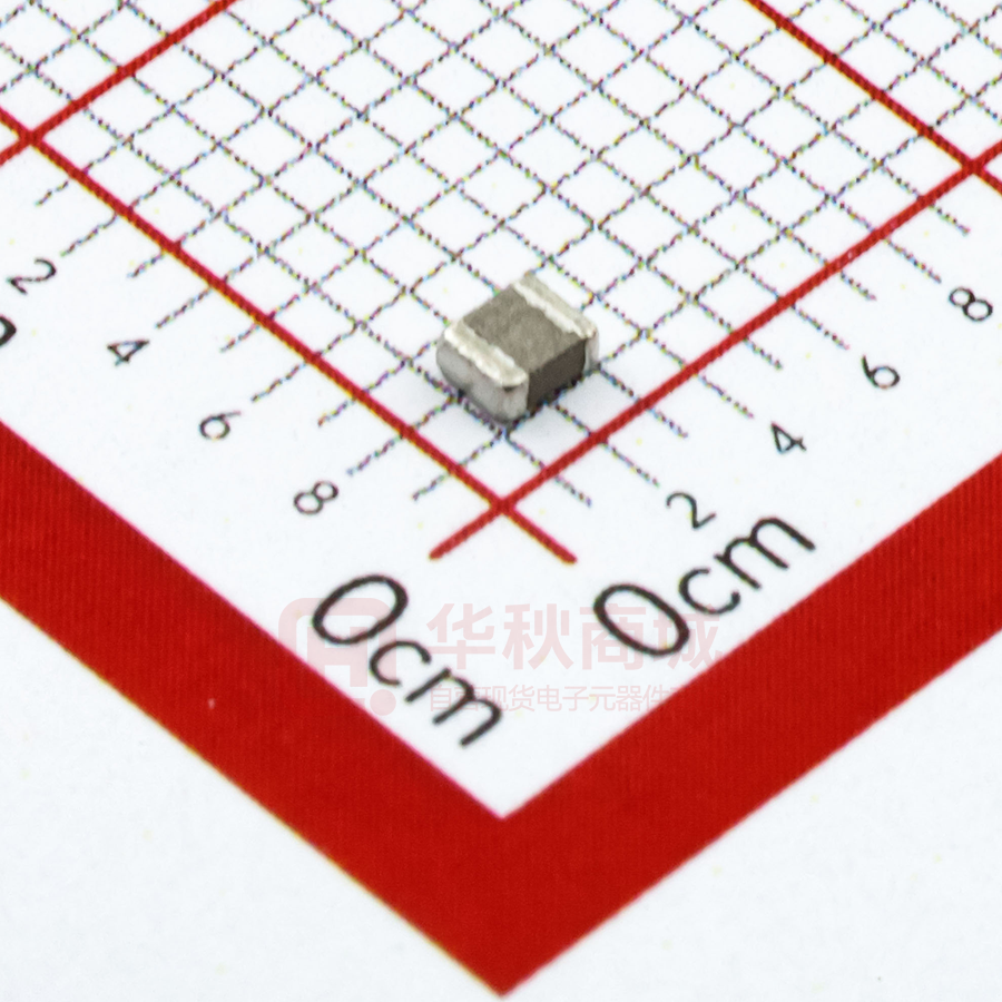

    功率电感 1.4A ±20% 0806 2.2µH 2.00 x 1.60mm 1.00mm 168mΩ
DFE201610P-2R2M=P2 数据手册
Metal Alloy Inductors 金属合金功率电感器 DFE201610P Recommended patterns Inductance Range: 0.24~2.2µH 推荐焊盘尺寸 (Unit: mm) FEATURES (Unit: mm) 特点 • Miniature size: 2016 footprint (2.0mm×1.6mm) and low profile(1.0mm Max. height) • The use of magnetic iron powder ensure capability for large current. • The use of Flat wire for Low DC resistance. • Magnetically shielded, low audible core noise. • Reflow solderable. • Operating temperature : -40~+125°C • 小型薄型构造(2.0x1.6mm、高度1.0mm Max.) • 使用合金系磁性粉,保证了大电流 • • • • 采用平角线、低直流电阻 闭磁路构造、低芯片噪音 适合回流焊接 使用温度范围:-40~+125°C STANDARD PART NUMBERS 标准零件号码 TYPE DFE201610P (Quantity/reel; 3,000 PCS) 零件号码 电感值(1) 公差 测试频率 最大直流电阻(2) Part Number Inductance(1) L(µH) Tolerance (%) Test Frequency (MHz) DC Resistance(2) (mΩ) Max. (Typ.) DFE201610P-R24M=P2 DFE201610P-R33M=P2 DFE201610P-R47M=P2 DFE201610P-R68M=P2 DFE201610P-1R0M=P2 DFE201610P-1R5M=P2 DFE201610P-2R2M=P2 0.24 0.33 0.47 0.68 1.0 1.5 2.2 ±20 ±20 ±20 ±20 ±20 ±20 ±20 1 1 1 1 1 1 1 (1) Inductance is measured with a LCR meter 4284A (Agilent Technologies) or equivalent. Test frequency at 1MHz (2) DC resistance is measured with 34420A (Agilent Technologies) or 3541(HIOKI). (Reference ambient temperature 20°C) (3) Maximum allowable DC current is that which causes a 30% inductance reduction from the initial value, coil temperature to rise by 40°C whichever is smaller. (Reference ambient temperature 20°C) 26 (20) 34 (26) 40 (32) 48 (40) 70 (58) 110 (92) 168 (140) 最大电感值减小电流(3) Inductance Decrease Current(3) (A) Max. (Typ.) ΔL/L=30% 5.4 (6.0) 4.7 (5.2) 4.0 (4.5) 3.6 (4.0) 3.1 (3.4) 2.5 (2.8) 2.0 (2.2) 最大温度上升电流(3) Temperature Rise Current(3) ∆T=40°C (A) Max. (Typ.) 3.8 (4.5) 3.5 (4.0) 3.1 (3.6) 2.7 (3.2) 2.2 (2.6) 1.8 (2.1) 1.4 (1.6) (1)LCR仪表4284A (Agilent Technologies)或者功能相同的仪器在 1MHz下测试电感值。 (2)通过数码万用表34420A (Agilent Technologies)/ 3541(HIOKI)或者 相类似的工具测试直流电阻。(环境温度为20°C) (3)允许最大直流电的范围是以下两者中比较小的一个:从开始值降低 30%的电感值,或者线圈温度升高40°C。 (参考周围环境温度20°C)。
