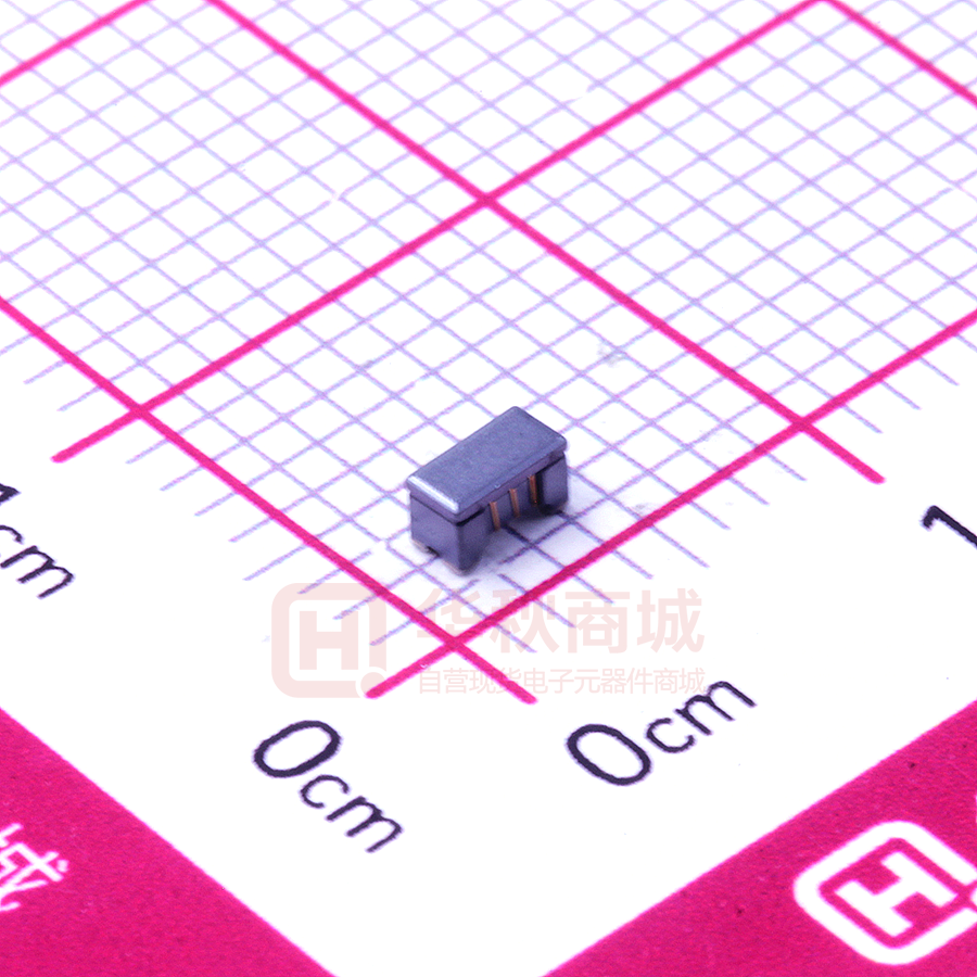

    CHOKE_3.2X1.6MM_SM
    共模电感 OriginalμH 370mA 300mΩ 90Ω CHOKE_3.2X1.6MM_SM
DLW31SN900SQ2L 数据手册
Reference Only Spec No. JEFL243C-0002U-01 P 1/9 Wire Wound Chip Common Mode Choke Coil DLW31SN□□□SQ2□ Reference Specification 1. Scope This reference specification applies to Chip Common Mode Choke Coil DLW31SN Series. 2. Part Numbering (ex.) DL W 31 S N (1) (2) (3) (4) (5) (1) Chip Common Mode Choke Coil (2) Structure (W : Winding Type) (3) Dimension (L×W) (4) Type (5) Category 222 (6) S Q 2 L (7) (8) (9) (10) (6) Impedance (Typ. at 100MHz) (7) Circuit (8) Features (9) Number of Line (10) Packaging Code L : Taping / B : Bulk 3. Rating Customer Part Number Murata Part Number Rated Common Mode Impedance Voltage (at 100MHz, Under Standard Testing Condition) V(DC) Withstanding Voltage V(DC) Rated Current (mA) DC Resistance (Ω max.) 2200 200 1.2 1000 230 1.0 260 0.8 260 310 0.5 160 340 0.4 90 370 0.3 Insulation Resistance (MΩ min.) (Ω ± 25%) DLW31SN222SQ2L DLW31SN222SQ2B DLW31SN102SQ2L DLW31SN102SQ2B DLW31SN601SQ2L DLW31SN601SQ2B DLW31SN261SQ2L DLW31SN261SQ2B DLW31SN161SQ2L DLW31SN161SQ2B DLW31SN900SQ2L DLW31SN900SQ2B 600 50 Operating Temperature : -40 to +85°C Storage Temperature 4. Standard Testing Condition Temperature : Ordinary Temperature 15 to 35°C Humidity : Ordinary Humidity 25 to 85%(RH) 125 10 : -40 to +85°C Temperature : 20 ± 2°C Humidity : 60 to 70%(RH) Atmospheric Pressure : 86 to106kPa 5. Style and Dimensions 1 .9 ±0 .2 ) 5 2 . 0 ( (0.6) (0.6) ■ Equivalent Circuits (1) (2) (4) (3) No polarity 1.6±0.2 3.2±0.2 ■ Unit Mass (Typical value) 0.039g (1) (2) Electrode ( ): Reference value (4) (3) (in mm) 6. Marking No Marking. MURATA MFG.CO.,LTD Spec No. JEFL243C-0002U-01 Reference Only P 2/9 7. Electrical Performance No. 7.1 Item Common Mode Impedance (Zc) Specification Meet item 3. 7.2 Withstanding Voltage Products shall not be damaged. 7.3 DC Resistance (Rdc) Meet item 3. 7.4 Insulation Resistance (I.R.) Test Method Measuring Equipment : KEYSIGHT 4291A or the equivalent Measuring Frequency :100±1MHz(ref.item 10,11) Test Voltage : 2.5 times for Rated Voltage Time : 1 to 5 seconds Charge Current : 1 mA max. (ref.item 10) Measuring current : 100mA max. (ref.item 10) (In case of doubt in the above mentioned standard condition, measure by 4 terminal method.) Measuring voltage : Rated Voltage Measuring time : 1 minute max. (ref.item 10) 8. Mechanical Performance No. 8.1 8.2 Item Appearance and Dimensions Bonding Strength Specification Meet item 5. No evidence of coming off substrate. Products shall not be mechanical damaged. Test Method Visual Inspection and measured with Slide Calipers. It shall be soldered on the substrate. Applying Force(F) : 9.8N Applying Time : 5±1 seconds Pressure Substrate Product Test board fixture 8.3 Bending Strength 8.4 Drop 8.5 Vibration 8.6 Solderability Meet Table 1. Table 1 Appearance Common Mode Impedance Change I.R. Withstanding Voltage No damaged It shall be soldered on the Glass-epoxy substrate Deflection : 2mm (t=1.0mm) Keeping time : 30 seconds Speed of Applying Force : 0.5mm/s Pressure jig R230 within ±20% Deflection 10MΩ min. No damaged The electrodes shall be at least 90% covered with new solder coating. F 45 45 Product It shall be dropped on concrete or steel board. Method : free fall Height : 75 cm The Number of Times : 3 times It shall be soldered on the substrate. Oscillation Frequency : 10 to 55 to 10Hz for 1 minute Total Amplitude : 1.5mm Testing Time : A period of 2 hours in each of 3 mutually perpendicular directions. (Total 6 hours) Flux : Ethanol solution of rosin,25(wt)% includes activator equivalent to 0.06 to 0.10(wt)% chlorine Pre-Heating : 80 to 120°C 1minute Solder : Sn-3.0Ag-0.5Cu Solder Temperature : 245±3°C Immersion Time : 4±1 s Immersion and emersion rates : 25mm / s Stainless tweezers Please hold product except these part. 8.7 Resistance to Soldering Heat Meet Table 1. Flux : Ethanol solution of rosin,25(wt)% includes activator equipment to 0.06 to 0.10(wt)% chlorine Pre-Heating : 80 to 120°C ,1minute Solder : Sn-3.0Ag-0.5Cu Solder Temperature : 260±5°C Immersion Time : 5±0.5 seconds Immersion and emersion rates : 25mm / s Then measured after exposure in the room condition for 4 to 48 hours. MURATA MFG.CO.,LTD Spec No. JEFL243C-0002U-01 Reference Only P 3/9 9. Environmental Performance(Products shall be soldered on the substrate.) No. 9.1 Item Temperature Cycle Specification Meet Table 1. 9.2 Humidity 9.3 Heat life 9.4 Cold Resistance Test Method 1 Cycle Step 1 -40°C(+0°C,-3°C) / 30±3 min Step 2 Ordinary Temp. / 10 to 15 minutes Step 3 +85°C(+3°C,-0°C) / 30±3 min Step 4 Ordinary Temp. / 10 to 15 minutes Total of 10 cycles Then measured after exposure in the room condition for 4 to 48 hours Temperature : 40±2°C Humidity : 90~95%(RH) Time : 1000(+48 hours,-0 hours) Then measured after exposure in the room condition for 4 to 48 hours. Temperature : 85±2°C Applying Voltage : 2times for Rated Voltage Time : 1000(+48 hours,-0 hours) Then measured after exposure in the room condition for 4 to 48 hours. Temperature : -40± 2°C Time : 1000(+48 hours,-0 hours) Then measured after exposure in the room condition for 4 to 48 hours. 10. Terminal to be Tested. When measuring and supplying the voltage,the following terminal is applied. No. Item Terminal to be Tested 10.1 Common Mode Impedance Terminal Terminal (Measurement Terminal) 10.2 10.3 10.4 10.5 Withstanding Voltage (Measurement Terminal) Terminal Terminal DC Resistance (Measurement Terminal) Insulation Resistance (Measurement Terminal) Heat Life(Supply Terminal) Terminal Terminal Terminal Terminal Terminal Terminal 11. Measuring method for common mode impedance. Measured common mode impedance may be included measurement error due to stray capacitance, residual inductance of test fixture. To correct this error, the common mode impedance should be calculate as follows; (1) Measure admittance of the fixture(opened), Go Bo. (2) Measure impedance of the fixture(shorted), Rs Xs. (3) Measure admittance of the specimen, Gm Bm. (4) Calculate corrected impedance Z using the formula below. Z = (Rx2+Xx2) 1/2 Where Gm-GO Rx = (Gm-Go)2 + (Bm-Bo)2 - Rs -(Bm- Bo) Xx = (Gm-Go) 2 + (Bm-Bo)2 - Xs 12. P.C.B., Flux, Solder and Soldering condition Test shall be done using P.C.B., Flux, Solder and Soldering condition which are specified in item 16 except the case of being specified special condition. MURATA MFG.CO.,LTD Reference Only Spec No. JEFL243C-0002U-01 P 4/9 13. Impedance Frequency Characteristics(Typical) 10000 |Z|(Ω) Common Mode DLW31SN222SQ2 DLW31SN102SQ2 DLW31SN601SQ2 1000 DLW31SN261SQ2 DLW31SN161SQ2 DLW31SN900SQ2 100 DLW31SN222SQ2 DLW31SN102SQ2 DLW31SN601SQ2 DLW31SN261SQ2 DLW31SN161SQ2 DLW31SN900SQ2 Differential Mode 10 1 1 10 100 1000 f (MHz) 14. Specification of Packaging 14.1 Appearance and Dimensions ( 8mm-wide,Plastic tape) 0.1 φ 1.5± 0 2.0±0.05 4.0±0.1 0.3±0.05 *Dimension of the Cavity is measured 3.6±0.1 3.5±0.05 8.0±0.2 1.75±0.1 Sprocket Hole at the bottom side. 2.1±0.1 4.0±0.1 2.0±0.1 Cavity Direction of feed 14.2 Specification of Taping (in mm) (1)Packing quantity(Standard quantity) 2000 pcs. / reel (2)Packing Method Products shall be packaged in each embossed cavity of plastic tape and sealed with cover tape. (3) Spliced point The cover tape have no spliced point. (4) Sprocket Hole The sprocket holes are to the right as the tape is pulled toward the user. (5)Missing components number Missing components number within 0.1% of the number per reel or 1 pc., whichever is greater,and are not continuous.The specified quantity per reel is kept. 14.3 Pull Strength of Plastic Tape Plastic Tape 5N min. Cover Tape 10N min. 14.4 Peeling off force of Cover Tape 165 to 180 degree F Cover tape 0.2 to 0.7N(Minimum value is Typical) Speed of Peeling off : 300 mm / min Plastic tape 14.5 Dimensions of Leader-tape, Trailer and Reel Leader Trailer 2.0±0.5 160 min. 190 min. 210 min. Empty tape Top tape Label φ 13.0±0.2 1 φ 60± 0 φ 21.0±0.8 9± 10 Direction of feed 13±1.4 (in:mm) 0 φ 180± 3 MURATA MFG.CO.,LTD Reference Only Spec No. JEFL243C-0002U-01 P 5/9 14.6 Marking for reel Customer part number, MURATA part number, Inspection number(∗1), RoHS Marking(∗2), Quantity, etc ∗1) « Expression of Inspection No. » □□ OOOO ××× (1) Factory Code (2) Date (3) Serial No. (1) (2) (3) First digit : Year / Last digit of year Second digit : Month / Jan. to Sep. → 1 to 9, Oct. to Dec. → O,N,D Third, Fourth digit : Day ∗2) « Expression of RoHS Marking » ROHS – Y (△) (1) (2) (1) RoHS regulation conformity parts. (2) MURATA classification number 14.7 Marking for Outside package Customer name Purchasing Order Number, Customer Part Number, MURATA part number, RoHS Marking(∗2), Quantity, etc 14.8 Specification of Outer Case H D 15. ! △ Caution Outer Case Dimensions Standard Reel Quantity in Outer Case (mm) (Reel) Label W D H 186 186 93 5 ∗ Above Outer Case size is typical. It depends on a quantity of an order. W 15.1 Mounting Direction Mount products in right direction. Wrong direction which is 90°rotated from right direction causes not only open or short circuit but also flames or other serious trouble. Z right direction Z wrong direction 15.2 Limitation of Applications Please contact us before using our products for the applications listed below which require especially high reliability for the prevention of defects which might directly cause damage to the third party's life,body or property. (1) Aircraft equipment (6) Transportation equipment (vehicles, trains, ships, etc.) (2) Aerospace equipment (7) Traffic signal equipment (3) Undersea equipment (8) Disaster prevention / crime prevention equipment (4) Power plant control equipment (9) Data-processing equipment (5) Medical equipment (10) Applications of similar complexity and /or reliability requirements to the applications listed in the above 16. Notice This product is designed for solder mounting. Please consult us in advance for applying other mounting method such as conductive adhesive. 16.1 Flux and Solder Flux Use rosin-based flux,(with converting chlorine content 0.06 to 0.1(wt)%. ), but not highly acidic flux (with Halogen content exceeding 0.2(wt)% conversion to chlorine). Do not use water-soluble flux. Solder Use Sn-3.0Ag-0.5Cu solder 16.2 Assembling Products can only be soldered with reflow. Flow soldering may cause deterioration in insulation resistance. So,reflow soldering shall be applied for this product. MURATA MFG.CO.,LTD Reference Only Spec No. JEFL243C-0002U-01 P 6/9 16.3 Claening Conditions Do not clean after soldering. Some cleaning agents may degrade bonding strength,and characteristics of products by detaching. If cleaning,please contact us. 16.4 Resin coating The impedance value may change due to high cure-stress of resin to be used for coating/molding products. An open circuit issue may occur by mechanical stress caused by the resin, amount/cured shape of resin, or operating condition etc. Some resin contains some impurities or chloride possible to generate chlorine by hydrolysis under some operating condition may cause corrosion of wire of coil, leading to open circuit. So, please pay your careful attention when you select resin in case of coating/molding the products with the resin. Prior to use the coating resin, please make sure no reliability issue is observed by evaluating products mounted on your board. 16.5 Attention regarding P.C.B. bending The following shall be considered when designing and laying out P.C.B.'s. (1) P.C.B. shall be designed so that products are not subject to the mechanical stress due to warping the board. [Products direction] a Products shall be location the sideways b Direction (Length : a D *1 (2) Add slits in the board separation part. A > B (3) Keep the mounting position of the component away from the board separation surface. A C Perforation A > C B D Slit *1 A > D is valid when stress is added vertically to the perforation as with Hand Separation. If a Cutting Disc is used, stress will be diagonal to the PCB, therefore A > D is invalid. (3) Mounting Components Near Screw Holes When a component is mounted near a screw hole, it may be affected by the board deflection that occurs during the tightening of the screw. Mount the component in a position as far away from the screw holes as possible. Screw Hole Recommended MURATA MFG.CO.,LTD Reference Only Spec No. JEFL243C-0002U-01 16.6 Attention Regarding P.C.B. Design < The Arrangement of Products > P.C.B. shall be designed so that products are far from the portion of perforation. P 7/9 Portion of Perforation × P.C.B. The portion of perforation shall be designed as narrow as possible, and shall be designed so as not to be applied the stress in the case of P.C.B. separation. ○ ○ Portion of Perforation Products shall not be arranged on the line of a series of holes when there are big holes in P.C.B. (Because the stress concentrate on the line of holes.) Product × ○ P.C.B. × Product Hole < Products Placing > Support pins shall be set under P.C.B . to prevent causing a warp to P.C.B. during placing the products on the other side of P.C.B. Pick- up nozzle Product P.C.B. < P.C.B. Separation > P.C.B. shall not be separated with hand. P.C.B. shall be separated with the fixture so as not to cause P.C.B. bending. Support pin 1.6 ∗1 0.4 16.7 Standard Land Dimensions (Reflow) ∗2 1.6 3.7 Resist Copper foil pattern No Pattern (in mm) ∗1 If the pattern is made with wider than 1.6mm. It will result to let component turn around, because melting speed is different. In the worst case, short circuit between lines may be occured. 1.6 3.7 1.6 16.8 Standard Soldering Condition 1.Reflow Soldering (1) Standard printing pattern of solder paste • Standard thickness of the solder paste should be 100 to 150 µm. • Use the solder paste printing pattern of the right pattern. • For the resist and copper foil pattern, use standard land dimensions. • Use the Solder Sn-3.0Ag-0.5Cu for pattern printing. • Spread of soldering paste between lines may cause short circuit of lines. 0.4 ∗2 If the pattern is made with wider than 1.6mm, the strength of bending will be reduced. ∗3 Do not use gilded pattern. A copper wire may cause open by dissolution of metallization. (in mm) (2) Soldering Temperature Temperature difference between soldering and surface of components must be within 150°C, in preheating. When components are immersed in liquid after soldering, temperature difference should be within 100°C. If preheating is not enough, components may be cracked and cause deterioration in insulation resistance. MURATA MFG.CO.,LTD Spec No. JEFL243C-0002U-01 Reference Only (3) Soldering Condition Standard soldering profile and the limit soldering profile is as follows. The excessive limit soldering conditions may cause leaching of the electrode and / or resulting in the deterioration of product quality. Temp. (℃) 260℃/10s 245±3℃ 220℃ 230℃ Limit Profile 180 150 Standard Profile 30~60s 60s max. 90s±30s Pre-heating Heating Peak temperature Cycle of reflow Standard Profile 150~180°C 、90s±30s above 220°C、30s~60s 245±3°C 2 times Time(s) Limit Profile above 230°C、60s max. 260°C、10s 2 times 2. Reworking with Soldering iron The following conditions must be strictly followed when using a soldering iron after being mounted by reflow soldering. · Pre-heating: 150°C, 1 min · Soldering iron output: 30W max. · Tip temperature: 350°C max. · Tip diameter:φ3mm max. · Soldering time : 3(+1,-0) seconds. · Times : 2times max. Notes : Do not touch the products directly with the soldering iron. 3. Solder Volume Solder shall be used not to be exceeded the upper limits as shown below. Upper limit Recommendable t T 1/3T≦t≦T (T:Thickness of electrode) Accordingly increasing the solder volume, the mechanical stress to Chip is also increased. Exceeding solder volume may cause the failure of mechanical or electrical performance. 16.9 Caution for use ・When you hold products with a tweezer, please hold like a figure of the right side, and sharp material, such as a pair of tweezers, shall not be touched to the winding portion to prevent the breaking of wire. ・Mechanical shock should not be applied to the products mounted on the board to prevent the breaking of the core. MURATA MFG.CO.,LTD tweezer P 8/9 Spec No. JEFL243C-0002U-01 Reference Only P 9/9 16.10 Handling of a substrate After mounting products on a substrate, do not apply any stress to the product caused by bending or twisting to the substrate when cropping the substrate, inserting and removing a connector from the substrate or tightening screw to the substrate. Excessive mechanical stress may cause cracking in the product. Bending Twisting 16.11 Brushing of neighborhood of products When you clean the neighborhood of products such as connector pins, bristles of cleaning brush shall not be touched to the winding portion to prevent the breaking of wire. 16.12 Operating Environment Do not use this product under the following environmental conditions, on deterioration of the performance, such as insulation resistance may result from the use. (1) in corrosive gases (acidic gases, alkaline gases, chlorine, sulfur gases, organic gases and etc.) (2) in the atmosphere where liquid such as organic solvent, may splash on the products. 16.13 Storage Condition (1) Storage period Use the products within 12 months after delivered. Solderability should be checked if this period is exceeded. (2) Storage environment conditions ·Products should be stored in the warehouse on the following conditions. Temperature : .-10 ~ +40°C Humidity : 15 to 85% relative humidity No rapid change on temperature and humidity. · Products should not be stored in corrosive gases, such as sulfureous, acid gases, alkaline gases, to prevent the following deterioration. Poor solderability due to the oxidized electrode. · Products should be stored on the palette for the prevention of the influence from humidity,dust and so on. · Products should be stored in the warehouse without heat shock, vibration, direct sunlight and so on. · Products shoud not be stored under the air tights packaged condition. (3) Delivery Care should be taken when transporting or handling product to avoid excessive vibration or mechanical shock. ! 17.△ Note (1)Please make sure that your product has been evaluated in view of your specifications with our product being mounted to your product. (2)You are requested not to use our product deviating from the reference specifications. (3)The contents of this reference specification are subject to change without advance notice. Please approve our product specifications or transact the approval sheet for product specifications before ordering. MURATA MFG.CO.,LTD
