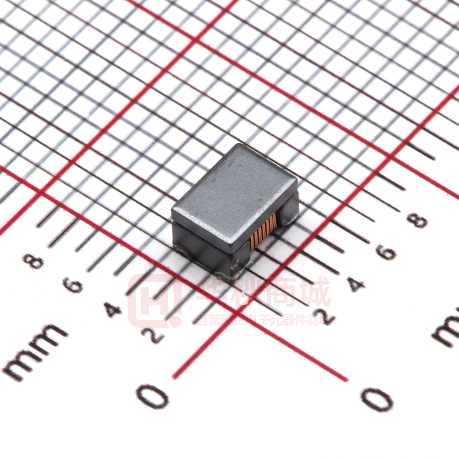

    共模电感 11µH 360mA -30~+50% 500mΩ Original CHOKE_4.5X3.2MM_SM
DLW43SH110XK2L 数据手册
Reference Only Spec No. JEFL243C-9101M-01 P1/9 Wire Wound Chip Common Mode Choke Coil DLW43SH□□□XK2□ Murata Standard reference Specification [AEC-Q200] 1. Scope This reference specification applies to Wire Wound Chip Common Mode Choke Coil DLW43SH_XK Series for Automotive Electronics based on AEC-Q200. 2. Part Numbering (ex.) DL W 43 S H (1) (2) (3) (4) (5) (1) Chip Common Mode Choke Coil (2) Structure (W : Winding Type) (3) Dimension (L×W) (4) Type (5) Category 101 X K 2 L (6) (7) (8) (9) (10) (6) Inductance (7) Circuit (8) Features (9) Number of Line (10) Packaging Code 3. Rating Customer Part Number L : Taping (Φ180mm/reel) K : Taping (Φ330mm/reel) B : Bulk Common Mode Inductance Rated Withstanding Rated DC (Under Standard Testing Voltage Voltage Current Resistance Condition) V(DC) V(DC) (mA) (Ω max.) Murata Part Number DLW43SH110XK2L DLW43SH110XK2K DLW43SH110XK2B DLW43SH220XK2L DLW43SH220XK2K DLW43SH220XK2B DLW43SH510XK2L DLW43SH510XK2K DLW43SH510XK2B DLW43SH101XK2L DLW43SH101XK2K DLW43SH101XK2B 11uH (-30%/+50%) at 0.1MHz 360 0.5 22uH (-30%/+50%) at 0.1MHz 310 0.6 50 125 51uH (-30%/+50%) at 1MHz 230 1.0 100uH(-30%/+50%) at 1MHz 200 2.0 Operating Temperature : -40 to +125°C Storage Temperature 4.Standard Testing Condition Temperature : Ordinary Temperature 15 to 35°C Humidity : Ordinary Humidity 25 to 85%(RH) : -40 to +125°C Temperature : 20 ± 2°C Humidity : 60 to 70%(RH) Atmospheric Pressure : 86 to106kPa 5. Style and Dimensions ■ Equivalent Circuits 2.6±0.2 (1) (2) (4) (3) (0.3) (0.8) 4.5±0.2 3.2±0.2 No polarity : Electrode ( ) : R e feren ce Va lu e ■ Unit Mass (Typical value) ( in m m ) 6. Marking (0.6) : 100uH (0.7) : 11,22,51uH No Marking. MURATA MFG.CO., LTD 0.17g Insulation Resistance (MΩ min.) ESD Rank 6:25kV 10 6 Reference Only Spec No. JEFL243C-9101M-01 P2/9 7. Electrical Performance No. 7.1 Item Common Mode Inductance (Lc) 7.2 Insulation Resistance (I.R.) Withstanding Voltage 7.3 7.4 Specification Meet item 3. Products shall not be damaged. DC Resistance (Rdc) Meet item 3. Test Method Measuring Equipment : KEYSIGHT 4294A or the equivalent Measuring Frequency:0.1MHz / 11uH, 22uH 1MHz / 51uH, 100uH (ref.item 9.1) Measuring voltage : Rated Voltage Measuring time : 1 minute max. (ref.item 9.3) Test Voltage : 2.5 times for Rated Voltage Time : 1 to 5 seconds Charge Current : 1 mA max. (ref.item 9.2) Measuring current : 10mA max. (ref.item 9.4) (In case of doubt in the above mentioned standard condition, measure by 4 terminal method.) 8. Q200 Requirement 8.1.Performance (based on Table 13 for Ferrite EMI SUPPRESSORS/FILTERS) AEC-Q200 Rev.D issued June 1. 2010 AEC-Q200 No. 3 Item High Temperature Exposure Murata Specification / Deviation Specification 1000hours at 125 deg C Set for 24hours at room temperature, then measured. Meet Table A after testing. Table A 1000cycles -40 deg C to +125 deg C Set for 24hours at room temperature, then measured. Per EIA469 No electrical tests Meet Table A after testing. Appearance No damage Common Mode Inductance (at 0.1MHz / 11uH, 22uH Meet item 3. at 1MHz / 51uH, 100uH) 4 Temperature Cycling 5 Destructive Physical Analysis 7 Biased Humidity 1000hours at 85 deg C, 85%RH Apply max rated current. Meet Table A after testing. 8 Operational Life Apply 125 deg C1000hours Set for 24hours at room temperature, then measured. Meet Table A after testing. Apply rated current. 9 External Visual 10 Physical Dimension Visual inspection Meet ITEM 4 (Style and Dimensions) No abnormalities No defects 12 Resistance to Solvents Per MIL-STD-202 Method 215 Not Applicable 13 Mechanical Shock Per MIL-STD-202 Method 213 Meet Table A after testing. Conditon F: 1500g’s(14.7N)/0.5ms/Half sine Not Applicable (ref.item 9.5) (ref.item 9.6) MURATA MFG.CO., LTD Spec No. JEFL243C-9101M-01 Reference Only AEC-Q200 15 Resistance to Soldering Heat 17 ESD 18 Solderbility Per J-STD-002 19 20 Electrical Characterization Flammability Measured : Common mode Inductance Per UL-94 21 Board Flex 22 Terminal Strength 30 Electrical Transient Conduction Epoxy-PCB(1.6mm) Meet Table A after testing. Deflection 2mm(min) 60 sec minimum holding time Per AEC-Q200-006 No defects A force of 17.7N for 60sec Per ISO-7637-2 Not Applicable 14 Stress Vibration Murata Specification / Deviation Test Method 5g's(0.049N) for 20 minutes, 12cycles each of 3 oritentations Test from 10-2000Hz. 12cycles each of 3 oritentations No-heating Solder temperature 260C+/-5 deg C Immersion time 10s Per AEC-Q200-002 No. P3/9 Meet Table A after testing. Pre-heating:150 to 180C / 90±30s Meet Table A after testing. Meet Table A after testing. ESD Rank: Refer to Item 3. Rating. Method b : Not Applicable 90% of the terminations is to be soldered.(except partly-exposed wire) Flux:Ethanol solution of rosin,25(wt)% includes activator equivalent to 0.06 to 0.10(wt)% chlorine No defects Not Applicable 9. Terminal to be Tested. When measuring and supplying the voltage, the following terminal is applied. No. 9.1 9.2 9.3 9.4 9.5 9.6 Item Common Mode Inductance (Measurement Terminal) Withstanding Voltage (Measurement Terminal) Insulation Resistance (Measurement Terminal) DC Resistance (Measurement Terminal) Biased Humidity (Supply Terminal) Operational Life (Supply Terminal) Terminal to be Tested Terminal Terminal Terminal Terminal Terminal Terminal Terminal Terminal Terminal Terminal MURATA MFG.CO., LTD Reference Only Spec No. JEFL243C-9101M-01 P4/9 10. P.C.B., Flux, Solder and Soldering condition Test shall be done using P.C.B., Flux, Solder and Soldering condition which are specified in item 13 except the case of being specified special condition. 4.9±0.1 5.5 ±0.05 φ 1.5±0.1 0 4.0±0.1 2.0±0.05 3.6±0.1 8.0±0.1 0.3±0.05 12.0±0.2 11.1 Appearance and Dimensions ( 12mm-wide,Plastic tape) 1.75±0.1 11. Specification of Packaging *Dimension of the Cavity is measured at the bottom side. Direction of feed 2.7±0.1 (in mm) 11.2. Specification of Taping (1) Packing quantity (Standard quantity) φ 180 mm reel : 500 pcs. / reel φ 330 mm reel : 2500 pcs. / reel (2) Packing Method Products shall be packaged in each embossed cavity of plastic tape and sealed with cover tape. (3) Sprocket Hole The sprocket holes are to the right as the tape is pulled toward the user. (4) Spliced point The cover tape have no spliced point. (5) Missing components number Missing components number within 0.1% of the number per reel or 1 pc., whichever is greater, and are not continuous. The specified quantity per reel is kept. 11.3. Pull Strength of Plastic Tape Plastic Tape Cover Tape 5 N min. 10 N min. 11.4. Peeling off force of Cover Tape 0.2N to 0.7N (minimum value is typical.) 165 to 180 degree Speed of Peeling off : 300 mm / min F Cover tape Plastic tape 11.5. Dimensions of Leader-tape, Trailer and Reel There shall be leader-tape (cover tape only and empty tape) and trailer-tape (empty tape) as follows. « Packaging Code : L (Φ180mm reel) » 2.0±0.5 Trailer 160 min. Leader 210 min. 190 min. Empty Tape Cover tape Label φ 13.0±0.2 φ 60± 1 0 φ 21.0±0.8 13± 1 0 Direction of feed 17±1.4 0 φ 180± 3 (in mm) « Packaging Code : K (Φ330mm reel) » 2.0±0.5 Trailer Leader 160 min. 190 min. 210 min. Empty Tape Cover tape Label φ 13.0±0.5 φ 50 min. φ 21.0±0.8 2.0±0.5 14±1.5 Direction of feed φ 330±2.0 (in mm) MURATA MFG.CO., LTD Spec No. JEFL243C-9101M-01 Reference Only P5/9 11.6 Marking for reel Customer part number, MURATA part number, Inspection number(∗1), RoHS marking(∗2), Quantity, etc ∗1) « Expression of Inspection No. » □□ OOOO ××× (1) (2) (3) (1) Factory Code (2) Date First digit : Year / Last digit of year Second digit : Month / Jan. to Sep. → 1 to 9, Oct. to Dec. → O,N,D Third, Fourth digit : Day (3) Serial No. ∗2) « Expression of RoHS marking » ROHS – Y (△) (1) (2) (1) RoHS regulation conformity parts. (2) MURATA classification number 11.7 Marking for Outside package Customer name Purchasing Order Number, Customer Part Number, MURATA part number, RoHS marking (∗2), Quantity, etc W D H Standard Reel Quantity in Outer Case (Reel) φ180mm 186 186 93 4 φ330mm 340 340 85 4 11.8 Specification of Outer Case Reel Label H D W 12. △Caution Outer Case Dimensions (mm) *Above Outer Case size is typical. It depends on a quantity of an order. ! 12.1 Mounting Direction Mount products in right direction. Wrong direction which is 90°rotated from right direction causes not only open or short circuit but also flames or other serious trouble. Z Z right direction wrong direction 12.2 Limitation of Applications Please contact us before using our products for the applications listed below which require especially high reliability for the prevention of defects which might directly cause damage to the third party's life, body or property. (1) Aircraft equipment (2) Aerospace equipment (3) Undersea equipment (4) Power plant control equipment (5) Medical equipment (6) Transportation equipment (trains, ships, etc.) (7) Traffic signal equipment (8) Disaster prevention / crime prevention equipment (9) Data-processing equipment (10) Applications of similar complexity and / or reliability requirements to the applications listed in the above. 12.3 Caution(Rating) Do not exceed maximum rated current of the product. Thermal stress may be transmitted to the product and short/open circuit of the product or falling off the product may be occurred. 12.4 Fail-safe Be sure to provide an appropriate fail-safe function on your product to prevent a second damage that may be caused by the abnormal function or the failure of our product. 13. Notice Products can only be soldered with reflow. This product is designed for solder mounting. Please consult us in advance for applying other mounting method such as conductive adhesive. 13.1 Flux and Solder Flux Use rosin-based flux,(with converting chlorine content 0.06 to 0.1(wt)%. ), but not highly acidic flux (with Halogen content exceeding 0.2(wt)% conversion to chlorine). Do not use water-soluble flux. Solder Use Sn-3.0Ag-0.5Cu solder Standard thickness of the solder paste should be 150µm. MURATA MFG.CO., LTD Spec No. JEFL243C-9101M-01 Reference Only P6/9 13.2 Assembling Flow soldering may cause deterioration in insulation resistance. So, reflow soldering shall be applied for this product. 13.3 Cleaning Conditions Do not clean after soldering. Some cleaning agents may degrade bonding strength,and characteristics of products by detaching. If cleaning,please contact us. 13.4 Resin coating The inductance value may change due to high cure-stress of resin to be used for coating/molding products. An open circuit issue may occur by mechanical stress caused by the resin, amount/cured shape of resin, or operating condition etc. Some resin contains some impurities or chloride possible to generate chlorine by hydrolysis under some operating condition may cause corrosion of wire of coil, leading to open circuit. So, please pay your careful attention when you select resin in case of coating/molding the products with the resin. Prior to use the coating resin, please make sure no reliability issue is observed by evaluating products mounted on your board. 13.5 Attention regarding P.C.B. bending The following shall be considered when designing and laying out P.C.B.'s. (1) P.C.B. shall be designed so that products are not subject to the mechanical stress due to warping the board. [Products direction] a Products shall be location the sideways b Direction (Length : a D *1 A > B A > C C B D Slit *1 A > D is valid when stress is added vertically to the perforation as with Hand Separation. If a Cutting Disc is used, stress will be diagonal to the PCB, therefore A > D is invalid. (3) Mounting Components Near Screw Holes When a component is mounted near a screw hole, it may be affected by the board deflection that occurs during the tightening of the screw. Mount the component in a position as far away from the screw holes as possible. Screw Hole Recommended MURATA MFG.CO., LTD Spec No. JEFL243C-9101M-01 Reference Only 13.6 Attention Regarding P.C.B. Design < The Arrangement of Products > P.C.B. shall be designed so that products are far from the portion of perforation. The portion of perforation shall be designed as narrow as possible, and shall be designed so as not to be applied the stress in the case of P.C.B. separation. Products shall not be arranged on the line of a series of holes when there are big holes in P.C.B. (Because the stress concentrate on the line of holes.) P7/9 Portion of Perforation × P.C.B. ○ ○ Portion of Perforation Product × ○ P.C.B. × Product Hole < Products Placing > Support pins shall be set under P.C.B . to prevent causing a warp to P.C.B. during placing the products on the other side of P.C.B. Pick- up nozzle Product P.C.B. < P.C.B. Separation > Support pin P.C.B. shall not be separated with hand. P.C.B. shall be separated with the fixture so as not to cause P.C.B. bending. *2 3.4 1.6 13.7 Standard Land Dimensions (Reflow) *3 A 5.9 *1 Part Number A DLW43SH110XK2 DLW43SH220XK2 DLW43SH510XK2 3.0 DLW43SH101XK2 Resist Copper foil pattern No Pattern (in mm) 3.2 ∗1 If the pattern is made with wider than 3.4mm. It will result to let component turn around, because melting speed is different. In the worst case, short circuit between lines may be occured. ∗2 If the pattern is made with less than 1.6mm , in the worst case , short circuit between lines may be occurred due to the spread of soldering paste or mount placing accuracy. ∗3 If the pattern is made with wider, the strength of bending will be reduced. Moreover, if the pattern is made with less than "A" dimension , in the worst case short circuit may be occurred. ∗4 Do not use gilded pattern. A copper wire may cause open by dissolution of metallization. 13.8 Standard Soldering Condition 1.Reflow Soldering (1) Soldering Temperature Temperature difference between soldering and surface of components must be within 150°C, in preheating. When components are immersed in liquid after soldering, temperature difference should be within 100°C. If preheating is not enough, components may be cracked and cause deterioration in insulation resistance. (2) Soldering Condition Standard soldering profile and the limit soldering profile is as follows. The excessive limit soldering conditions may cause leaching of the electrode and / or resulting in the deterioration of product quality. MURATA MFG.CO., LTD Spec No. JEFL243C-9101M-01 Reference Only Soldering Profile for Lead Free solder (Sn-3.0Ag-0.5Cu solder ) Temp. (°C) 260°C 245±3°C 220°C 240°C Limit Profile 180 150 Standard Profile 30~60s 30s max. 90s±30s Pre-heating Heating Peak temperature Cycle of reflow Standard Profile 150~180°C 、90s±30s above 220°C、30s~60s 245±3°C 2 times Time(s) Limit Profile above 240°C、30s max. 260°C、10s 2 times 2. Reworking with Soldering iron The following conditions must be strictly followed when using a soldering iron after being mounted by reflow soldering. · Pre-heating: 150°C, 1 min · Soldering iron output: 30W max. · Tip temperature: 350°C max. · Tip diameter:φ3mm max. · Soldering time : 3(+1,-0) seconds. · Times : 2times max. Notes : Do not touch the products directly with the soldering iron. 3. Solder Volume Solder shall be used not to be exceeded the upper limits as shown below. Upper limit Recommendable T t 1/3T≦t≦T (T:Thickness of electrode) Accordingly increasing the solder volume, the mechanical stress to Chip is also increased. Exceeding solder volume may cause the failure of mechanical or electrical performance. In case if the solder volume is much, we recommend to make the size of the solder paste with less than the land pattern. 4.Solder fillet Solder fillet in lateral direction is not formed in some case because of product's structure, but it is not something that affects product's performance and reliability. 13.9 Caution for use ・When you hold products with a tweezer, please hold like a figure of the right side, and sharp material, such as a pair of tweezers, shall not be touched to the winding portion to prevent the breaking of wire. ・Mechanical shock should not be applied to the products mounted on the board to prevent the breaking MURATA MFG.CO., LTD tweezer P8/9 Spec No. JEFL243C-9101M-01 Reference Only P9/9 of the core. 13.10 Handling of a substrate After mounting products on a substrate, do not apply any stress to the product caused by bending or twisting to the substrate when cropping the substrate, inserting and removing a connector from the substrate or tightening screw to the substrate. Excessive mechanical stress may cause cracking in the product. Bending Twisting 13.11 Brushing of neighborhood of products When you clean the neighborhood of products such as connector pins, bristles of cleaning brush shall not be touched to the winding portion to prevent the breaking of wire. 13.12 Operating Environment Do not use this product under the following environmental conditions, on deterioration of the performance, such as insulation resistance may result from the use. (1) in corrosive gases (acidic gases, alkaline gases, chlorine, sulfur gases, organic gases and etc.) (2) in the atmosphere where liquid such as organic solvent, may splash on the products. 13.13 Storage Condition (1) Storage period Use the products within 12 months after delivered. Solderability should be checked if this period is exceeded. (2) Storage environment conditions ·Products should be stored in the warehouse on the following conditions. Temperature : -10 ~ +40°C Humidity : 15 to 85% relative humidity No rapid change on temperature and humidity. · Products should not be stored in corrosive gases, such as sulfureous, acid gases, alkaline gases, to prevent the following deterioration. Poor solderability due to the oxidized electrode. · Products should be stored on the palette for the prevention of the influence from humidity,dust and so on. · Products should be stored in the warehouse without heat shock, vibration, direct sunlight and so on. · Products should not be stored under the air tights packaged condition. (3) Delivery Care should be taken when transporting or handling product to avoid excessive vibration or mechanical shock. 14.! Note (1)Please make sure that your product has been evaluated in view of your specifications with our product being mounted to your product. (2)You are requested not to use our product deviating from the reference specifications. (3)The contents of this reference specification are subject to change without advance notice. Please approve our product specifications or transact the approval sheet for product specifications before ordering. MURATA MFG.CO., LTD
