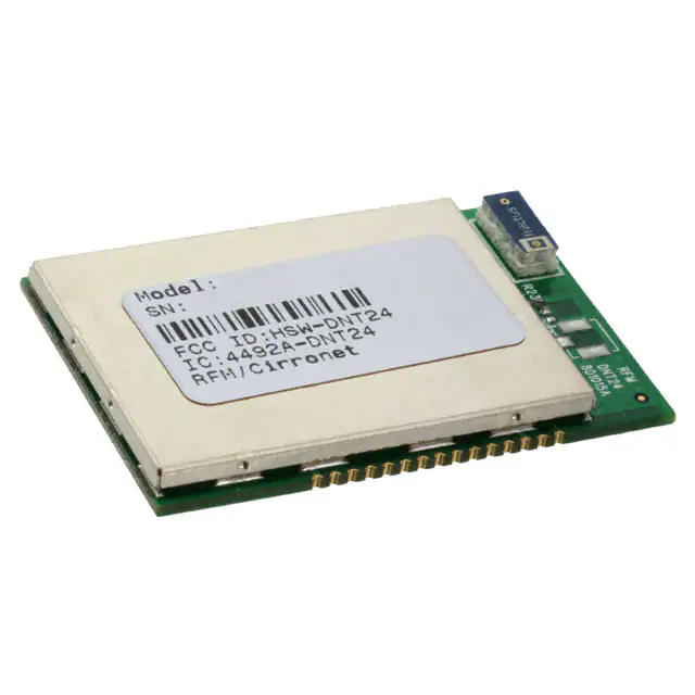

DNT24CA DNT24PA - 2.4 GHz Frequency Hopping Spread Spectrum Transceiver - Point-to-point, Point-to-multipoint, Peer-to-peer and Store & Forward Capabilities - Transmitter RF Power Configurable - 6.3 or 63 mW - Built-in Chip Antenna - 250 kbps RF Data Rate - Serial Port Data Rate up to 250 kbps, SPI Port Data Rate up to 500 kbps - 128-Bit AES Encryption - Separate Serial Port for Diagnostics - Analog and Digital I/O for Sensor Applications - FCC, Canadian IC and ETSI Certified for Unlicensed Operation Low Cost 2.4 GHz FHSS Transceiver Modules with I/O The DNT24CA and DNT24PA FHSS transceiver modules provide a low-cost, versatile solution for wireless data communications in the 2.4 GHz ISM band. The RF output power can be set at 6.3 or 63 mW. The modules include analog, digital and serial I/O, providing the flexibility to serve applications ranging from cable replacements to sensor networks. The builtin chip antenna makes these modules very easy to integrate. DNT24CA/PA Absolute Maximum Ratings Value Units Power Supply Input Rating -0.5 to +6.5 V All Input/Output Pins -0.5 to +3.3 V 0 dBm Input Power to RFIO Port Non-Operating Ambient Temperature Range -40 to +85 o C DNT24CA/PA Electrical Characteristics Characteristic Sym Notes Operating Frequency Range Hop Duration 1 Number of RF Channels 1 Modulation Minimum Typical Maximum Units 2406 2475 MHz 8 100 ms 15 or 24 FSK RF Data Transmission Rate -5 Receiver Sensitivity @ 10 BER Transmitter RF Output Power Antenna System Topologies Access Scheme Copyright © Murata Manufacturing Co., Ltd. All rights reserved. 2015 DNT24CA/PA (R) 01/31/19 1 of 7 1 250 kbps -100 dBm 6.3 or 63 mW Dielectric Chip Antenna Point-to-Point, Point-to-Multipoint, Peer-to-Peer and Store & Forward Ad Hoc TDMA www.murata.com DNT24CA/PA Electrical Characteristics Characteristic Sym Notes ADC Input Range Minimum Typical 0 ADC Input Resolution ADC Sample Rate Maximum 2.7 V 12 bits 100 Signal Source Impedance for ADC Reading ADC External Reference Voltage Range DAC Output Range Hz 10 KΩ 1.0 2.7 V 0 3.3 V 12 bits DAC Output Resolution 1.2, 2.4, 4.8, 9.6, 14.4, 19.2, 28.8, 38.4, 57.6, 115.2, 230.4, 250.0 Primary and Diagnostic Serial Port Baud Rates Serial Peripheral Interface Data Rate Units kbps 125 500 kbps Logic Low Input Level -0.5 0.8 V Logic High Input Level 2.45 3.3 V Digital I/O: Logic Input Internal Pull-up Resistor 20 +5.5 Vdc Power Supply Voltage Ripple 10 mVP-P Peak Transmit Mode Current, 63 mW Output 140 mA Power Supply Voltage Range +3.3 KΩ VCC Average Operating Receive Current: Base and Remote, Continuous Data Stream 55 mA Remote, Linked, No Data Transmission 15 mA Sleep Current 2 3 DNT24CA Mounting Reflow Soldering DNT24PA Mounting Socket 6 µA Operating Temperature Range -40 85 o Operating Relative Humidity Range, Non-condensing 10 90 % C Notes: 1. The DNT24CA and DNT24PA achieve regulatory certification under FHSS rules. 2. Maximum sleep current occurs at +85 oC. CAUTION: Electrostatic Sensitive Device. Observe precautions when handling. Copyright © Murata Manufacturing Co., Ltd. All rights reserved. 2015 DNT24CA/PA (R) 01/31/19 2 of 7 www.murata.com T 2 C A / T 2 P A B lo c k ia g r a m 1 G A C T ( / C 2 IA G _ T X ) ( IR Q 0 G P IO 0 R A IR Q 1 / IO _ T X R A 5 P W R P L L _ L O C K (/H O S T _ C T S ) 8 A C 0 9 G P IO 2 1 0 G P IO 1 1 1 A V ) S S n S S _ I T /R T /R F il e r R F IO O A T A n S S _ C O 1 2 A C 1 2 . G H z T r a n s c e iv e r S C K M ic r o c o n r o lle r G P IO 5 (/H O S T _ R T S ) G P IO 3 ( C L K A T A IO _ R X G P IO C h ip A n e n n a 3 IA G _ R X ) P R E F IG 1 3 V C C 1 1 5 G + 3 .3 V R e g 2 2 2 8 R S V 3 0 C _ E X T _ R E F C 1 C 0 /R E S E T 3 .3 V _ O U T A G 2 9 G 2 5 R S V 2 G 2 3 A 2 2 R S V 2 1 /S S 2 0 S C L K 1 9 M O S I 1 8 M IS O 1 A 1 Figure 1 DNT24CA/PA Hardware DNT24CA/PA Firmware The major components of these modules include a 2.4 GHz FHSS transceiver and a low current 8-bit microcontroller. These modules operate in the 2.4 GHz ISM band. There are 12 selectable hopping patterns providing compatibility with frequency allocations in most regions of the world. The modules also have two selectable RF output power levels: 6.3 mW and 63 mW. DNT24CA/PA firmware operates using hybrid Ad Hoc TDMA channel access optimized for periodic burst transmissions. DNT24CA/PA firmware operates “out of the box” using point-to-point transparent serial mode, with point-to-multipoint, peer-to-peer and store & forward system topologies also supported. The DNT24CA/PA provide a variety of hardware interfaces. There are two serial ports plus one SPI port. Either the primary serial port or the SPI port can be selected for data communications. The second serial port is dedicated to diagnostics. The primary and diagnostic serial ports support most standard baud rates up to 250.0 kbps. The SPI port supports data rates up to 500 kbps. These modules also include three ADC inputs, two DAC outputs, and six general-purpose digital I/O ports. Four of the digital I/O ports support an optional interrupt-from-sleep mode when configured as inputs. The DNT24CA is designed for solder reflow mounting. The DNT24PA is designed for plug-in connector mounting. The firmware provides the user with a rich set of configuration options including a choice of hopping patterns, hopping dwell times, serial and/or SPI data port operation, serial and SPI data rate selection, RF output power selection, plus configurable analog and digital I/O lines. Data integrity is protected by 24-bit error detection, with optional ACK and automatic transmission retries or redundant transmissions. 128-bit AES encryption provides a high level of data security for sensitive applications. Sensor networks can take advantage of timer or event-based data reporting and remote node sleep cycling for extended battery life. Copyright © Murata Manufacturing Co., Ltd. All rights reserved. 2015 DNT24CA/PA (R) 01/31/19 3 of 7 www.murata.com DNT24CA/PA I/O Descriptions Pin Name I/O 1 GND - 2 ACT (DIAG_TX) O (O) This pin’s default configuration is data activity output. On a base, this signal blinks when a valid packet is received. On a remote, this signal blinks when a packet is transmitted. On a router, this signal blinks when a valid upstream packet is received or a downstream packet is transmitted. Alternate pin function is the diagnostic serial port output. 3 /DCD (DIAG_RX) O (I) This pin’s default configuration is data carrier detect output. On a base, this signal is asserted when any valid packet is received, and is cleared if no packets are heard for the configured router/remote registration time-out interval. On a router or remote, this signal is asserted when the radio obtains hopping pattern synchronization, and remains asserted until no beacons are heard for 50 hops. Alternate pin function is the diagnostic serial port input. I/O Configurable digital I/O port 0. When configured as an input, an internal pull-up resistor can be selected and direct interrupt from sleep can be invoked. When configured as an output, the power-on state is configurable. In sleep mode the pin direction, input pull-up selection or output state are also separately configurable. 4 GPIO0 Description Power supply and signal ground. Connect to the host circuit board ground. 5 RADIO_TXD O Serial data output from the radio. 6 RADIO_RXD I Serial data input to the radio. 7 GPOI4 (/HOST_CTS) I/O (O) Default pin function is GPIO4 with the same configuration options as GPIO0. Alternate pin function is UART/SPI flow control output. The module sets this line low when it is ready to accept data from the host on the RADIO_RXD or MOSI input. When the line goes high, the host must stop sending data. 8 GPOI5 (/HOST_RTS) I/O (I) Default pin function is GPIO5 with the same configuration options as GPIO0. Alternate pin function is UART/SPI flow control input. The host sets this line low to allow data to flow from the module on the RADIO_TXD pin. When the host sets this line high, the module will stop sending data to the host. 9 DAC0 O 12-bit DAC 0 output. Full scale output can be referenced to the voltage at pin 25 or the 3.3 V regulated module bus voltage. 10 GPIO2 I/O Configurable digital I/O port 2. Same configuration options as GPIO0. 11 GPIO1 I/O Configurable digital I/O port 1. Same configuration options as GPIO0. 12 GPIO3 (DAV) I/O (O) Default pin function is GPIO3 with the same configuration options as GPIO0. When SPI slave mode operation is enabled, a logic high on this pin indicates when data is available to be clocked out by the SPI master. 13 DAC1 O 12-bit DAC 1 output. Same specifications and configuration options as DAC0. 14 VCC I Power supply input, +3.3 to +5.5 Vdc. 15 GND - Power supply and signal ground. Connect to the host circuit board ground. 16 GND - Power supply and signal ground. Connect to the host circuit board ground. 17 /RESET I Active low module hardware reset. 18 ADC0 I ADC input 0. This pin is a direct ADC input when the ADC is operating in single-ended mode, or the differential negative input for positive inputs applied to ADC1 or ADC2 when the ADC is operating in differential mode. Full-scale reading can be referenced to Pin 25 for ratiometric measurements. For absolute measurements, the ADC can use either the regulated supply voltage divided by 1.6 (about 2.06 V), or an external voltage applied to Pin 25. In single-ended mode, ADC measurements are 11-bit unsigned values with full scale nominally 2.7 V when referenced to a 2.7 V input on Pin 27. In differential mode, ADC measurements are 12-bit signed values. 19 ADC1 I ADC input 1. Direct input when the ADC is operating in single-ended mode, positive differential input relative to ADC0 when the ADC is operating in differential mode. 20 MISO I/O This pin is the SPI master mode input or slave mode output. 21 MOSI I/O This pin is the SPI master mode output or slave mode input. 22 /SS I/O SPI active low slave select. This pin is an output when the module is operating as a master, and an input when it is operating as a slave. Copyright © Murata Manufacturing Co., Ltd. All rights reserved. 2015 DNT24CA/PA (R) 01/31/19 4 of 7 www.murata.com Pin Name I/O Description 23 SCLK I/O 24 ADC2 I ADC input 2. Direct input when the ADC is operating in single-ended mode, positive differential input relative to ADC0 when the ADC is operating in differential mode. 25 ADC_EXT_ REF I/O ADC external reference voltage pin. The voltage at this pin can be used by the ADCs as a reference for ratiometric measurements. With no external voltage or load applied, this pin presents a nominal 2.7 V output through a 2.126 K source resistance. A low impedance external reference voltage in the range of 1 to 2.7 V may be applied to this pin as an option. 26 RSVD - Reserved pin. Leave unconnected. 27 RSVD - Reserved pin. Leave unconnected. 28 GND - Connect to the host circuit board ground plane. 29 RSVD - Reserved pin. Leave unconnected. 30 GND - Connect to the host circuit board ground plane. SPI clock signal. This pin is an output when operating as a master, and an input when operating as a slave. Copyright © Murata Manufacturing Co., Ltd. All rights reserved. 2015 DNT24CA/PA (R) 01/31/19 5 of 7 www.murata.com N T 2 4 C A O u tlin e a n d M o u n tin g 1 .5 0 0 (3 8 .1 0 ) im e n s io n s 0 .0 5 0 (1 .2 A n te n n a 1 1 5 ) 0 .9 8 0 (2 4 .9 0 ) T o p V ie w 1 3 0 0 .4 5 0 (1 1 .4 0 ) 0 .3 5 0 (8 .8 9 ) 0 .1 2 5 (3 .1 8 ) im e n s io n s in in c h e s (m m ) Figure 2 N T 2 4 C A S o ld e r P a d im e n s io n s 1 .5 0 0 (3 8 .1 0 ) 0 .0 5 0 (1 .2 0 .0 ) 0 (1 .5 2 ) 1 5 1 0 .0 3 5 (0 .8 9 ) 0 .9 8 0 1 .0 4 0 (2 4 .9 0 ) (2 .4 2 ) T o p V ie w 1 3 0 im e n s io n s in in c h e s (m m ) Figure 3 Copyright © Murata Manufacturing Co., Ltd. All rights reserved. 2015 DNT24CA/PA (R) 01/31/19 6 of 7 www.murata.com N T 2 P A O u tlin e a n d M o u n tin g im e n s io n s 1 .5 0 0 (3 8 .1 0 ) 0 .0 5 0 (1 .2 ) 1 5 (2 0 .9 8 0 .9 0 ) A n te n n a 0 .0 6 0 (1 .5 2 ) 1 1 .1 0 0 (2 .9 ) T o p V ie w 1 6 3 0 0 . 5 0 (1 1 . 3 ) 0 .3 5 0 (8 .8 9 ) 0 .1 2 5 (3 .1 8 ) 0 .2 2 5 (5 . 2 ) im e n s io n s in in c h e s (m m ) Figure 4 N T 2 0 .1 0 0 (2 .5 ) P A In te r fa c e C o n n e c to r P C B L a y o u t e ta il 0 .0 5 0 (1 .2 ) 0 .8 0 0 (2 0 .3 ) C o n n e c to rs a re S A M T E C S L M -1 1 5 -0 1 -G -S o r E q u iv a le n t 0 . 0 0 (1 .8 ) 0 .9 8 0 (2 .9 ) im e n s io n s a r e in in c h e s (m m ) Figure 5 Note: Specifications subject to change without notice. Part # M-0024-0000, Rev C Copyright © Murata Manufacturing Co., Ltd. All rights reserved. 2015 DNT24CA/PA (R) 01/31/19 7 of 7 www.murata.com
