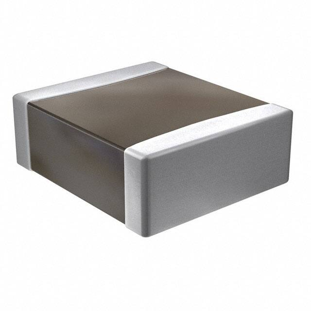

Chip Monolithic Ceramic Capacitor for Automotive GC355XD72J274KX05_ (2220, X7T:EIA, 0.27uF, DC630V) _: packaging code Reference Sheet 1.Scope This product specification is applied to Ripple Current Chip Monolithic Ceramic Capacitor used for Automotive Electronic equipment.    2.MURATA Part NO. System (Ex.) GC3 55 X (2)T Dimensions (1)L/W Dimensions D7 2J (3)Temperature Characteristics 274 K (5)Nominal (6)Capacitance Tolerance Capacitance (4)Rated Voltage X05 3. Type & Dimensions (1)-1 L (1)-2 W (2) T e 5.7±0.4 5.0±0.4 2.7+0/-0.3 0.3 min. (Unit:mm) g 3.0 min. 4.Rated value (3) Temperature Characteristics (Public STD Code):X7T(EIA) Temp. coeff Temp. Range or Cap. Change (Ref.Temp.) -33 to 22 % -55 to 125 °C (25 °C) (4) Rated Voltage DC 630 V (6) (5) Nominal Capacitance Capacitance Tolerance 0.27 uF ±10 % Specifications and Test Methods (Operating Temp. Range) -55 to 125 °C ・Soldering Method Reflow 5.Package mark (8) Packaging Packaging Unit L f180mm Reel EMBOSSED W12P8 500 pcs./Reel Product specifications in this catalog are as of Oct.13,2015,and are subject to change or obsolescence without notice. Please consult the approval sheet before ordering. Please read rating and !Cautions first. GC355XD72J274KX05-01 1 L (7)Murata’s (8)Packaging Control Code Code ■AEC-Q200 Murata Standard Specification and Test Methods No. AEC-Q200 Test Item 1 Pre-and Post-Stress Electrical Test 2 High Temperature Exposure (Storage) Appearance Capacitance Change D.F. I.R. 3 Temperature Cycling Appearance Capacitance Change D.F. I.R. Specification AEC-Q200 Test Method - The measured and observed characteristics should satisfy the specifications in the following table. No marking defects within ±10% 0.02 max. More than 10,000MW or 100 MWF (Whichever is smaller) The measured and observed characteristics should satisfy the specifications in the following table. No marking defects within ±7.5% 0.01 max. More than 10,000MW or 100 MWF (Whichever is smaller) Fix the capacitor to the supporting jig in the same manner and under the same conditions as (19). Perform the 1,000 cycles according to the four heat treatments listed in the following table. Let sit for 24±2h at room condition*, then measure. Step 1 2 3 4 Temp.(C) -55+0/-3 Room Temp. 125+3/-0 Room Temp. Time(min.) 153 1 153 1 •Pretreatment Perform the heat treatment at 150+0/-10°C for 60±5 min and then let sit for 24±2h at room condition*. Per EIA-469 4 Destructive Phisical Analysis No defects or abnormalities 5 Moisture Resistance The measured and observed characteristics should satisfy the specifications in the following table. No marking defects within ±12.5% 0.02 max. More than 10,000MW or 100 MWF (Whichever is smaller) Appearance Capacitance Change D.F. I.R. Sit the capacitor for 1,00012h at 1503C. Let sit for 242h at room temperature, then measure. Apply the 24h heat (25 to 65C) and humidity (80 to 98%) treatment shown below, 10 consecutive times. Let sit for 24±2h at room condition*, then measure. Temperature Humidity 90~98% (℃) 70 65 60 55 50 45 40 35 30 25 20 15 10 5 0 -5 -10 Humidity 80~98% Humidity 90~98% Humidity 80~98% Humidity 90~98% +10 - 2℃ Initial measuremt One cycle 24hours 0 1 2 3 4 5 6 7 8 9 10 11 12 13 14 15 16 17 18 19 20 21 22 23 24 Hours 6 Biased Humidity Appearance Capacitance Change D.F. I.R. 7 Operational Life Appearance Capacitance Change D.F. I.R. 8 9 10 External Visual Phisical Dimension Resistance to Appearance Solvents Capacitance Change D.F. I.R. The measured and observed characteristics should satisfy the specifications in the following table. No marking defects within ±12.5% 0.02 max. More than 1,000MW or 10 MWF (Whichever is smaller) The measured and observed characteristics should satisfy the specifications in the following table. No marking defects within ±12.5% 0.02 max. More than 1,000MW or 10 MWF (Whichever is smaller) No defects or abnormalities Within the specified dimensions No marking defects Within the specified tolerance 0.01 max. More than 10,000MW or 100 MWF (Whichever is smaller) Apply the rated voltage and DC1.3+0.2/-0 V (add 6.8kW resistor) at 85±3°C and 80 to 85% humidity for 1,000±12h. Remove and let sit for 24±2h at room condition*, then measure. The charge/discharge current is less than 50mA. •Pretreatment Perform the heat treatment at 150+0/-10°C for 60±5 min and then let sit for 24±2h at room condition*. Apply 120% of the rated voltage for 1,00012h at 1253C. Let sit for 24±2h at room condition*, then measure. The charge/discharge current is less than 50mA. •Pretreatment Apply test voltage for 60±5 min at test temperature. Remove and let sit for 24±2h at room condition*. Visual inspection Using calipers and micrometers. Per MIL-STD-202 Method 215 Solvent 1 : 1 part (by volume) of isopropyl alcohol 3 parts (by volume) of mineral spirits Solvent 2 : Terpene defluxer Solvent 3 : 42 parts (by volume) of water 1part (by volume) of propylene glycol monomethyl ether 1 part (by volume) of monoethanolamine * “room condition” Temperature:15 to 35°C, Relative humidity:45 to 75%, Atmosphere pressure:86 to 106kPa JEMCGS-03023A 2 ■AEC-Q200 Murata Standard Specification and Test Methods AEC-Q200 Test Item No. 11 Mechanical Shock 12 Vibration 13 14 Appearance Capacitance Change D.F. Appearance Capacitance Change D.F. Resistance to Soldering Heat Appearance Capacitance Change D.F. I.R. Thermal Shock Appearance Capacitance Change D.F. I.R. 15 ESD Appearance Capacitance Change D.F. I.R. 16 Solderability Specification AEC-Q200 Test Method No marking defects Within the specified tolerance 0.01 max. No defects or abnormalities Within the specified tolerance 0.01 max. The measured and observed characteristics should satisfy the specifications in the following table. No marking defects within ±10% 0.01 max. More than 10,000MW or 100 MWF (Whichever is smaller) The measured and observed characteristics should satisfy the specifications in the following table. No marking defects within ±10% 0.01 max. More than 10,000MW or 100 MWF (Whichever is smaller) No marking defects Within the specified tolerance 0.01 max. More than 10,000MW or 100 MWF (Whichever is smaller) 95% of the terminations is to be soldered evenly and continuously. Three shocks in each direction should be applied along 3 mutually perpendicular axes of the test specimen (18 shocks). The specified test pulse should be Half-sine and should have a duration :0.5ms, peak value:1,500g and velocity change: 4.7m/s. Solder the capacitor to the test jig (glass epoxy board) in the same manner and under the same conditions as (19). The capacitor should be subjected to a simple harmonic motion having a total amplitude of 1.5mm, the frequency being varied uniformly between the approximate limits of 10 and 2,000Hz. The frequency range, from 10 to 2,000Hz and return to 10Hz, should be traversed in approximately 20 min. This motion should be applied for 12 items in each 3 mutually perpendicular directions (total of 36 times). Immerse the capacitor in a solder solution at 2605C for 101s.. Let sit for 24±2h at room condition*, then measure. •Pretreatment Perform the heat treatment at 150+0/-10°C for 60±5 min and then let sit for 24±2h at room condition*. Fix the capacitor to the supporting jig in the same manner and under the same conditions as (19). Perform the 300 cycles according to the two heat treatments listed in the following table(Maximum transfer time is 20s.). Let sit for 24±2 h at room condition*, then measure. Step 1 2 Temp.(C) -55+0/-3 125+3/-0 Time(min.) 153 153 •Pretreatment Perform the heat treatment at 150+0/-10°C for 60±5 min and then let sit for 24±2h at room condition*. Per AEC-Q200-004 (a) Preheat at 155C for 4h. After preheating, immerse the capacitor in a solution of ethanol(JIS K 8101) and rosin (JIS K 5902) (25% rosin in weight propotion). Immerse in eutectic solder solution for 5+0/-0.5s at 2355C. (b) Should be placed into steam aging for 8h15 min. After preheating, immerse the capacitor in a solution of Ethanol (JIS K 8101) and rosin (JIS K 5902) (25% rosin in weight propotion). Immerse in eutectic solder solution for 5+0/-0.5s at 2355C. (c) Should be placed into steam aging for 8h15 min. After preheating, immerse the capacitor in a solution of Ethanol (JIS K 8101) and rosin (JIS K 5902) (25% rosin in weight propotion). Immerse in eutectic solder solution for 1205s at 2605C. * “room condition” Temperature:15 to 35°C, Relative humidity:45 to 75%, Atmosphere pressure:86 to 106kPa JEMCGS-03023A 3 ■AEC-Q200 Murata Standard Specification and Test Methods AEC-Q200 Test Item No. 17 Electrical Characterization Apperance Capacitance Change D.F. I.R. 25 C I.R. 125C Dielectric Strength 18 Board Flex Appearance Capacitance Change Specification AEC-Q200 Test Method No defects or abnormalities Within the specified tolerance Visual inspection. The capacitance/D.F. should be measured at 25C at the frequency and voltage shown in the table. 0.01 max. Frequency Voltage 1±0.2kHz 1±0.2V(r.m.s.) The insulation resistance should be measured with DC500±50V at 25 C and 125 C within 2 min. of charging. More than 10,000MW or 100 MWF (Whichever is smaller) More than 1,000MW or 10 MWF (Whichever is smaller) No failure No failure should be observed when voltage in Table is applied between the terminations for 1 to 5s., provided the charge/discharge current is less than 50mA. No marking defects within ±12.5% Rated Voltage Test Voltage DC630V 120% of the rated v oltage Solder the capacitor on the test jig (glass epoxy board) shown in Fig1 using a eutectic solder. Then apply a force in the direction shown in Fig 2 for 51s. The soldering should be done by the reflow method and should be conducted with care so that the soldering is uniform and free of defects such as heat shock. Ty pe a b c GC331 2.0 4.4 1.7 GC332 2.0 4.4 2.6 GC343 3.0 6.0 3.3 GC355 4.2 7.2 5.1 (in mm) 20 50 Pressurizing speed:1.0mm/s Pressurize R4 Capacitance meter 45 Flexure:  2mm 45 Fig.1 Fig.2 19 Terminal Strength Appearance Capacitance Change D.F. I.R. No marking defects Within specified tolerance Solder the capacitor to the test jig (glass epoxy board) shown in Fig.3 using a eutectic solder. Then apply 18N force in parallel with the test jig for 60s. The soldering should be done by the reflow method and should be conducted with care so that the soldering is uniform and free of defects such as heat shock. 0.01 max. More than 10,000MW or 100 MWF (Whichever is smaller) Ty pe a b c GC331 2.2 5.0 2.0 GC332 2.2 5.0 2.9 GC343 3.5 7.0 3.7 GC355 4.5 8.0 5.6 (in mm) b a c (t : 1.6mm) Solder resist Fig.3 JEMCGS-03023A 4 Baked electrode or copper foil ■AEC-Q200 Murata Standard Specification and Test Methods AEC-Q200 Test Item No. 20 Specification Beam Load Test AEC-Q200 Test Method Destruction value should be exceed following one. Place the capacitor in the beam load fixture as Fig 4. Apply a force. Chip thickness < 1.25mm rank : 15N Chip thickness  1.25mm rank : 54.5N L 0.6L Fig.4 21 Capacitance Capacitance Temperature Change Characteristics Speed supplied the Stress Load : 2.5mm / s The capacitance change should be measured after 5min. at each specified temperature stage. within +22/-33% Step Temperature(°C) 1 252 2 -553 3 252 4 1253 5 252 The ranges of capacitance change compared with the above 25°C value over the temperature ranges shown in the table should be within the specified ranges. •Pretreatment Perform the heat treatment at 150+0/-10°C for 60±5 min and then let sit for 24±2h at room condition*. Perform the initial measurement. * “room condition” Temperature:15 to 35°C, Relative humidity:45 to 75%, Atmosphere pressure:86 to 106kPa ESD Voltage HBM : Human Body Model / R=2kΩ,Cp=150pF(Based on AEC-Q200) Rated Voltage Capacitance HBM ESD Voltage 10nF, 12nF 16kV DC250V 15nF and more 25kV DC450V 10nF and more 25kV DC630V 10nF and more 25kV 100MW R DUT V Cp Cp : Dump. Capacitor R : Discharge Resistor V : Applied Voltage JEMCGS-03023A 5 Package (1) Appearance of taping (a) Paper Tape Bottom Tape (Thickness: Around 50m) is attached below Base Tape with sprocket and put Top Tape (Thickness: Around 50m) on capacitor. (b) Plastic Tape Cover Tape (Thickness: Around 60m) is put on capacitor on Base Tape (Blister carrier Tape). (c) The sprocket holes are to the right as the Tape is pulled toward the user. (2) Packed chips Capacitor 1.75±0.1 (3) Dimensions of Tape (a) Type A (Dimensions of chip : Apply to 1.6x0.8 , 2.0x1.25 , 3.2x1.6 , 3.2x2.5) f1.5+0.1/-0 4.0±0.1 (Plastic Tape) 4.0±0.1 0.25±0.1 B 3.5±0.05 2.0±0.05 8.0±0.3 (Paper Tape) 2.5max. A 1.1max. (Unit : mm) Dimensions of chip [L×W] 1.6×0.8 2.0×1.25 3.2×1.6 3.2×2.5 A* B* 1.05 1.45 2.0 2.9 1.85 2.25 3.6 3.6 Dimensions of A,B : Nominal value 1.75±0.1 (b) Type B (Dimensions of chip : Apply to 4.5x2.0) f1.5+0.1/-0 (単位:m 4.0±0.1 4.0±0.1 0.3±0.1 5.5±0.05 B 12.0±0.3 2.0±0.05 3.7max. A (Unit : mm) (単位:m Dimensions of chip [L×W] 4.5×2.0 JEMCGP-03074A A* B* 2.5 5.1 6 Dimensions of A,B : Nominal value Package 1.75±0.1 (c) Type C (Dimensions of chip : Apply to 4.5x3.2 to 5.7x5.0) 2.0±0.05 f1.5+0.1/-0 B 12.0±0.3 0.3±0.1 5.5±0.05 4.0±0.1 8.0±0.1 3.7max. A Dimensions of chip [L×W] 4.5×3.2 5.7×2.8 5.7×5.0 (Unit : mm) A* B* 3.6 3.2 5.4 4.9 6.1 6.1 Dimensions of A,B : Nominal value (4) Dimensions of Reel 13.0±1.0 : Tape width 8mm 17.0±1.0 : Tape width 12mm f21±0.8 f13±0.2 180+0/-1.5 330+0/-3.0 60+1/-0(f180mmReel) 100+1/-0(f330mmReel) 2.0±0.5 (Unit : mm) 9.0+1.0/-0 : Tape width 8mm 13.0+1.0/-0 : Tape width 12mm (5) Part of the leader and part of the empty tape shall be attached to the end of the tape as follows. Vacant section : 160 min. Chip-mounting unit Vacant section : 190 min. 210 min. (Unit : mm) Direction of feed (6) The top tape or cover tape and base tape are not attached at the end of the tape for a minimum of 5 pitches. (7) Missing capacitors number within 0.1% of the number per reel or 1pc, whichever is greater, and not continuous. (8) The top tape or cover tape and bottom tape shall not protrude beyond the edges of the tape and shall not cover sprocket holes. (9) Cumulative tolerance of sprocket holes, 10 pitches : ±0.3mm. (10) Peeling off force : 0.1 to 0.6N in the direction shown on the follows. 165 to 180° Top Tape or Cover Tape Base Tape JEMCGP-03074A 7 ! CAUTION ! ■Storage and Operation Conditions 1. The performance of chip monolithic ceramic capacitors may be affected by the storage conditions. 1-1. Store the capacitors in the following conditions: Room Temperature of +5C to +40°C and a Relative Humidity of 20% to 70%. (1) Sunlight, dust, rapid temperature changes, corrosive gas atmosphere, or high temperature and humidity conditions during storage may affect solderability and packaging performance. Therefore, please maintain the storage temperature and humidity. Use the product within six months, as prolonged storage may cause oxidation of the electrodes. (2) Please confirm solderability before using after six months. Store the capacitors without opening the original bag. Even if the storage period is short, do not exceed the specified atmospheric conditions. 1-2. Corrosive gas can react with the termination (external) electrodes or lead wires of capacitors, and result in poor solderability. Do not store the capacitors in an atmosphere consisting of corrosive gas (e.g., hydrogen sulfide, sulfur dioxide, chlorine, ammonia gas, etc.). 1-3. Due to moisture condensation caused by rapid humidity changes, or the photochemical change caused by direct sunlight on the terminal electrodes and/or the resin/epoxy coatings, the solderability and electrical performance may deteriorate. Do not store capacitors under direct sunlight or in high humidity conditions. ■Rating 1. Temperature Dependent Characteristics 1. The electrical characteristics of a capacitor can change with temperature. 1-1. For capacitors having larger temperature dependency, the capacitance may change with temperature changes. The following actions are recommended in order to ensure suitable capacitance values. (1) Select a suitable capacitance for the operating temperature range. (2) The capacitance may change within the rated temperature. When you use a high dielectric constant type capacitor in a circuit that needs a tight (narrow) capacitance tolerance (e.g., a time-constant circuit), please carefully consider the temperature characteristics, and carefully confirm the various characteristics in actual use conditions and the actual system. 2. Measurement of Capacitance 1. Measure capacitance with the voltage and frequency specified in the product specifications. 1-1. The output voltage of the measuring equipment may decrease occasionally when capacitance is high. Please confirm whether a prescribed measured voltage is impressed to the capacitor. 1-2. The capacitance values of high dielectric constant type capacitors change depending on the AC voltage applied. Please consider the AC voltage characteristics when selecting a capacitor to be used in an AC circuit. 3. Applied Voltage 1. Do not apply a voltage to the capacitor that exceeds the rated voltage as called out in the specifications. 1-1. Applied voltage between the terminals of a capacitor shall be less than or equal to the rated voltage. (1) When AC voltage is superimposed on DC voltage, the zero-to-peak voltage shall not exceed the rated DC voltage. When AC voltage or pulse voltage is applied, the peak-to-peak voltage shall not exceed the rated DC voltage. (2) Abnormal voltages (surge voltage, static electricity, pulse voltage, etc.) shall not exceed the rated DC voltage. Typical Voltage Applied to the DC Capacitor DC Voltage DC Voltage + AC E E AC Voltage E Pulse Voltage 0 E 0 0 0 (E:Maximum possible applied voltage.) JEMCGC-02985 8 ! CAUTION 1-2. Influence of over voltage Over voltage that is applied to the capacitor may result in an electrical short circuit caused by the breakdown of the internal dielectric layers. The time duration until breakdown depends on the applied voltage and the ambient temperature. 2. Use a safety standard certified capacitor in a power supply input circuit (AC filter), as it is also necessary to consider the withstand voltage and impulse withstand voltage defined for each device. 4. Type of Applied Voltage and Self-heating Temperature 1. Confirm the operating conditions to make sure that no large current is flowing into the capacitor due to the continuous application of an AC voltage or pulse voltage. When a DC rated voltage product is used in an AC voltage circuit or a pulse voltage circuit, the AC current or pulse current will flow into the capacitor; therefore check the self-heating condition. Please confirm the surface temperature of the capacitor so that the temperature remains within the upper limits of the operating temperature, including the rise in temperature due to self-heating. When the capacitor is used with a high-frequency voltage or pulse voltage, heat may be generated by dielectric loss. 1-1. Applicable to Temperature Characteristic X7R, X7T The load should be contained so that the self-heating of the capacitor body remains below 20°C, when measuring at an ambient temperature of 25°C. In addition, use a K thermocouple of 0.1mm with less heat capacity when measuring, and measure in a condition where there is no effect from the radiant heat of other components or air flow caused by convection. Excessive generation of heat may cause deterioration of the characteristics and reliability of the capacitor. (Absolutely do not perform measurements while the cooling fan is operating, as an accurate measurement may not be performed.) 5. DC Voltage and AC Voltage Characteristics 1. The capacitance value of a high dielectric constant type capacitor changes depending on the DC voltage applied. Please consider the DC voltage characteristics when a capacitor is selected for use in a DC circuit. 1-1. The capacitance of ceramic capacitors may change sharply depending on the applied voltage (see figure). Please confirm the following in order to secure the capacitance. (1) Determine whether the capacitance change caused by the applied voltage is within the allowed range. (2) In the DC voltage characteristics, the rate of capacitance change becomes larger as voltage increases, even if the applied voltage is below the rated voltage. When a high dielectric constant type capacitor is used in a circuit that requires a tight (narrow) capacitance tolerance (e.g., a time constant circuit), please carefully consider the voltage characteristics, and confirm the various characteristics in actual operating conditions in an actual system. 2. The capacitance values of high dielectric constant type capacitors changes depending on the AC voltage applied. Please consider the AC voltage characteristics when selecting a capacitor to be used in an AC circuit. 6. Capacitance Aging 1. The high dielectric constant type capacitors have the characteristic in which the capacitance value decreases with the passage of time. When you use high dielectric constant type capacitors in a circuit that needs a tight (narrow) capacitance tolerance (e.g., a time-constant circuit), please carefully consider the characteristics of these capacitors, such as their aging, voltage, and temperature characteristics. In addition, check capacitors using your actual appliances at the intended environment and operating conditions. JEMCGC-02985 9 注意 ! CAUTION 7. Vibration and Shock 1. Please confirm the kind of vibration and/or shock, its condition, and any generation of resonance. Please mount the capacitor so as not to generate resonance, and do not allow any impact on the terminals. 2. Mechanical shock due to being dropped may cause damage or a crack in the dielectric material of the capacitor. Do not use a dropped capacitor because the quality and reliability may be deteriorated. Crack Floor 3. When printed circuit boards are piled up or handled, the corner of another printed circuit board should not be allowed to hit the capacitor, in order to avoid a crack or other damage to the capacitor. Mounting printed circuit board Crack ■Soldering and Mounting 1. Mounting Position 1. Confirm the best mounting position and direction that minimizes the stress imposed on the capacitor during flexing or bending the printed circuit board. 1-1. Choose a mounting position that minimizes the stress imposed on the chip during flexing or bending of the board.  [Component Direction]  [Chip Mounting Close to Board Separation Point] It is effective to implement the following measures, to reduce stress in separating the board. It is best to implement all of the following three measures; however, implement as many measures as possible to reduce stress. C Perforation A B D Slit Contents of Measures (1) Turn the mounting direction of the component parallel to the board separation surface. (2) Add slits in the board separation part. (3) Keep the mounting position of the component away from the board separation surface. Stress Level A>D A>B A>C  [Mounting Capacitors Near Screw Holes] When a capacitor is mounted near a screw hole, it may be affected by the board deflection that occurs during the tightening of the screw. Mount the capacitor in a position as far away from the screw holes as possible. Screw Hole JEMCGC-02985 Recommended 推 10 ! CAUTION 2. Information before Mounting 1. Do not re-use capacitors that were removed from the equipment. 2. Confirm capacitance characteristics under actual applied voltage. 3. Confirm the mechanical stress under actual process and equipment use. 4. Confirm the rated capacitance, rated voltage and other electrical characteristics before assembly. 5. Prior to use, confirm the solderability of capacitors that were in long-term storage. 6. Prior to measuring capacitance, carry out a heat treatment for capacitors that were in long-term storage. 7. The use of Sn-Zn based solder will deteriorate the reliability of the MLCC. Please contact our sales representative or product engineers on the use of Sn-Zn based solder in advance. 8. We have also produced a DVD which shows a summary of our opinions, regarding the precautions for mounting. Please contact our sales representative to request the DVD. 3. Maintenance of the Mounting (pick and place) Machine 1. Make sure that the following excessive forces are not applied to the capacitors. 1-1. In mounting the capacitors on the printed circuit board, any bending force against them shall be kept to a minimum to prevent them from any bending damage or cracking. Please take into account the following precautions and recommendations for use in your process. (1) Adjust the lowest position of the pickup nozzle so as not to bend the printed circuit board. (2) Adjust the nozzle pressure within a static load of 1N to 3N during mounting. 2. Dirt particles and dust accumulated between the suction nozzle and the cylinder inner wall prevent the nozzle from moving smoothly. This imposes greater force upon the chip during mounting, causing cracked chips. Also, the locating claw, when worn out, imposes uneven forces on the chip when positioning, causing cracked chips. The suction nozzle and the locating claw must be maintained, checked, and replaced periodically. JEMCGC-02985 11 注意 注意 ! 4-1. Reflow Soldering 1. When sudden heat is applied to the components, the mechanical strength of the components will decrease because a sudden temperature change causes deformation inside the components. In order to prevent mechanical damage to the components preheating is required for both the components and the PCB. Preheating conditions are shown in table 1. It is required to keep the temperature differential between the solder and the components surface (T) as small as possible. 2. Solderability of tin plating termination chips might be deteriorated when a low temperature soldering profile where the peak solder temperature is below the melting point of tin is used. Please confirm the solderability of tin plated termination chips before use. 3. When components are immersed in solvent after mounting, be sure to maintain the temperature difference (T) between the component and the solvent within the range shown in the table 1. CAUTION [Standard Conditions for Reflow Soldering] Reflow Temperature (℃) Soldering Peak Temperature Gradual Cooling 220℃(200℃) 190℃(170℃) 170℃(150℃) 150℃(130℃) ΔT Preheating Time Temperature 60 - 120 s Incase of Lead Splder ( ):In case of Pb-Sn Solder 30 - 60 s Vapor Reflow Temperature (℃) Soldering Peak Temperature 190℃ (170℃) 170℃ (150℃) 150℃ (130℃) Gradual Cooling ΔT Preheating Time 60 - 120 s Table 1 [Allowable Soldering Temperature and Time] Temperature Differential T≦190°C T≦130°C 280 Recommended Conditions Pb-Sn Solder Reflow Vapor Reflow Lead Free Solder Peak Temperature 230 to 250°C 230 to 240°C 240 to 260°C Atmosphere Air Saturated vapor of inactive solvent Air or N2 Soldering Temperature (℃) Part Number G□□18/21/31 G□□32/42/43/52/55 20 s max. 270 260 250 240 230 220 0 30 60 90 120 Soldering Time (s) In case of repeated soldering, the accumulated soldering time must be within the range shown above. Pb-Sn Solder : Sn-37Pb Lead Free Solder : Sn-3.0Ag-0.5Cu 4. Optimum Solder Amount for Reflow Soldering 4-1. Overly thick application of solder paste results in a excessive solder fillet height. This makes the chip more susceptible to mechanical and thermal stress on the board and may cause the chips to crack. 4-2. Too little solder paste results in a lack of adhesive strength on the outer electrode, which may result in chips breaking loose from the PCB. 4-3. Make sure the solder has been applied smoothly to the end surface to a height of 0.2mm min. Inverting the PCB Make sure not to impose any abnormal mechanical shocks to the PCB. JEMCGC-02985 12 0.2mm min. CAUTION ! 4-2. Flow Soldering 1. Do not apply flow soldering to chips not listed in table 2. [Standard Conditions for Flow Soldering] Temperature (℃) Table 2 Temperature Differential T≦150°C Soldering Soldering Peak Temperature 2. When sudden heat is applied to the components, the mechanical strength of the components will decrease because a sudden temperature change causes deformation inside the components. In order to prevent mechanical damage to the components, preheating is required for both of the components and the PCB. Preheating conditions are shown in table 2. It is required to keep the temperature differential between the solder and the components surface ( T) as low as possible. 3. Excessively long soldering time or high soldering temperature can result in leaching of the outer electrodes, causing poor adhesion or a reduction in capacitance value due to loss of contact between the electrodes and end termination. 4. When components are immersed in solvent after mounting, be sure to maintain the temperature differential ( T) between the component and solvent within the range shown in the table 2. Gradual Cooling ΔT Preheating Peak Temperature Preheating 5 s max. 30 - 90 s Time [Allowable Soldering Temperature and Time] 280 Soldering Temperature (℃) Part Number G□□18/21/31 270 260 250 240 230 220 0 10 20 30 40 Soldering Time (s) In case of repeated soldering, the accumulated soldering time must be within the range shown above. Recommended Conditions Pb-Sn Solder Preheating Peak Temperature Soldering Peak Temperature Atmosphere Lead Free Solder 90 to 110°C 100 to 120°C 240 to 250°C 250 to 260°C Air N2 Pb-Sn Solder : Sn-37Pb Lead Free Solder : Sn-3.0Ag-0.5Cu 5. Optimum Solder Amount for Flow Soldering 5-1. The top of the solder fillet should be lower than the thickness of the components. If the solder amount is excessive, the risk of cracking is higher during board bending or any other stressful condition. JEMCGC-02985 13 Up to Chip Thickness Adhesive 注意 ! CAUTION 4-3. Correction of Soldering Portion When sudden heat is applied to the capacitor, distortion caused by the large temperature difference occurs internally, and can be the cause of cracks. Capacitors also tend to be affected by mechanical and thermal stress depending on the board preheating temperature or the soldering fillet shape, and can be the cause of cracks. Please refer to "1. PCB Design" or "3. Optimum solder amount" for the solder amount and the fillet shapes. 1. Correction with a Soldering Iron 1-1. In order to reduce damage to the capacitor, be sure to preheat the capacitor and the mounting board. Preheat to the temperature range shown in Table 3. A hot plate, hot air type preheater, etc. can be used for preheating. 1-2. After Soldering, do not allow the component/PCB to cool down repidly. 1-3. Perform the corrections with a soldering iron as quickly as possible. If the soldering iron is applied too long, there is a possibility of causing solder leaching on the terminal electrodes, which will cause deterioration of the adhesive strength and other problems. Table 3 Part Number G□□18/21/31 G□□32/42/43/52/55 Temperature of Soldering Iron tip 350°C max. 280°C max. Preheating Temperature 150°C min. 150°C min. Temperature Differential (T) T≦190°C T≦130°C Atmosphere air air *Applicable for both Pb-Sn and Lead Free Solder. Pb-Sn Solder : Sn-37Pb Lead Free Solder : Sn-3.0Ag-0.5Cu 2. Correction with Spot Heater Compared to local heating with a soldering iron, hot air heating by a spot heater heats the overall component and board, therefore, it tends to lessen the thermal shock. In the case of a high density mounted board, a spot heater can also prevent concerns of the soldering iron making direct contact with the component. 2-1. If the distance from the hot air outer of the spot heater to the component is too close, cracks may occur due to thermal shock. To prevent this problem, follow the conditions shown in Table 4. 2-2. In order to create an appropriate solder fillet shape, it is recommended that hot air be applied at the angle shown in Figure 1. Table 4 Distance Hot Air Application angle Hot Air Temperature Nozzle Outlet Application Time 5mm or more 45° *Figure 1 400°C max. Less than 10 seconds (1206 (3216 in mm) size or smaller) Less than 30 seconds (1206 (3225 in mm) size or larger) [Figure 1] One-hole An Angle of 45° 3. Optimum solder amount when re-working with a soldering Iron 3-1. In the case of sizes smaller than 0603, (G□□18), the top of the solder fillet should be lower than 2/3 of the thickness of the component or 0.5mm, whichever is smaller. In the case of 0805 and larger sizes, (G□□21/31/32/42/43/52/55 seizes), the top of the solder fillet should be lower than 2/3's of the thickness of the component. If the solder amount is excessive, the risk of cracking is higher during board bending or under any other stressful conditions. 3-2. A soldering iron with a tip ofφ3mm or smaller should be used. It is also necessary to keep the soldering iron from touching the components during the re-work. 3-3. Solder wire withφ0.5mm or smaller is required for soldering. JEMCGC-02985 14 Solder Amount 注意 ! CAUTION 5. Washing Excessive ultrasonic oscillation during cleaning can cause the PCBs to resonate, resulting in cracked chips or broken solder joints. Take note not to vibrate PCBs. 6. Electrical Test on Printed Circuit Board 1. Confirm position of the backup pin or specific jig, when inspecting the electrical performance of a capacitor after mounting on the printed circuit board. 1-1. Avoid bending the printed circuit board by the pressure of a test-probe, etc. The thrusting force of the test probe can flex the PCB, resulting in cracked chips or open solder joints. Provide backup pins on the back side of the PCB to prevent warping or flexing. Install backup pins as close to the capacitor as possible. 1-2. Avoid vibration of the board by shock when a test-probe contacts a printed circuit board. 7. Printed Circuit Board Cropping 1. After mounting a capacitor on a printed circuit board, do not apply any stress to the capacitor that causes bending or twisting the board. 1-1. In cropping the board, the stress as shown at right may cause the capacitor to crack. Cracked capacitors may cause deterioration of the insulation resistance, and result in a short. Avoid this type of stress to a capacitor. [Twisting] [Bending] 2. Check the cropping method for the printed circuit board in advance. 2-1. Printed circuit board cropping shall be carried out by using a jig or an apparatus (Disk separator , router type separator, etc.) to prevent the mechanical stress that can occur to the board. *When a board separation jig or disk separator is used, if the following precautions are not observed, a large board deflection stress will occur and the capacitors may crack. Use router type separator if at all possible. JEMCGC-02985 15 注意 ! CAUTION (1) Example of a suitable jig [In the case of Single-side Mounting] An outline of the board separation jig is shown as follows. Recommended example : Stress on the component mounting position can be minimized by holding the portion close to the jig, and bend in the direction towards the side where the capacitors are mounted. Not recommended example : The risk of cracks occurring in the capacitors increases due to large stress being applied to the component mounting position, if the portion away from the jig is held and bent in the direction opposite the side where the capacitors are mounted. Recommended [Outline of jig] Print circuit Board Not recommended Direction of Load Print circut Board Components V-groove Load Point Load Point Print circuit Board Direction of Load Components Board Cropping Jig [In the case of Double-sided Mounting] Since components are mounted on both sides of the board, the risk of cracks occurring can not be avoided with the above method. Therefore, implement the following measure to prevent stress from being applied to the components. (Measures) (1) Consider introducing a router type separator. If it is difficult to introduce a router type separator, implement the following measures. (Refer to item 1. Mounting Position) (2) Mount the components at a right angle to the board separation surface. (3) When mounting components near the board separation point, add slits in the separation position near the component. (4) Keep the mounting position of the components away from the board separation point. (2) Example of a Disk Separator An outline of a disk separator is shown as follows. As shown in the Principle of Operation, the top blade and bottom blade are aligned with the V-grooves on the printed circuit board to separate the board. In the following case, board deflection stress will be applied and cause cracks in the capacitors. (1) When the adjustment of the top and bottom blades are misaligned, such as deviating in the top-bottom, left-right or front-rear directions (2) The angle of the V groove is too low, depth of the V groove is too shallow, or the V groove is misaligned top-bottom If V grove is too deep, it is possible to brake when you handle and carry it. Carefully design depth of the V groove with consideration about strength of material of the printed circuit board. [Outline of [Principle of [Cross-section Top Blade Top Blade Printed Circuit Board Bottom Blade Print Circuit Board Top Blade Recommended V-groove V-groove Top-bottom Misalignment Not Recommended Left-right Misalignment Front-rear Misalignment Top Blade Top Blade Top Blade Top Blade Bottom Blade Bottom Blade Bottom Blade Bottom Blade JEMCGC-02985 16 ! Example of Recommended V-groove Design Left-right Misalignment Low-Angle Not Recommended Depth too Shallow CAUTION Depth too Deep (3) Example of Router Type Separator The router type separator performs cutting by a router rotating at a high speed. Since the board does not bend in the cutting process, stress on the board can be suppressed during board separation. When attaching or removing boards to/from the router type separator, carefully handle the boards to prevent bending. [Outline Drawing] Router 8. Assembly 1. Handling If a board mounted with capacitors is held with one hand, the board may bend. Firmly hold the edges of the board with both hands when handling. If a board mounted with capacitors is dropped, cracks may occur in the capacitors. Do not use dropped boards, as there is a possibility that the quality of the capacitors may be impaired. 2. Attachment of Other Components 2-1. Mounting of Other Components Pay attention to the following items, when mounting other components on the back side of the board after capacitors have been mounted on the opposite side. When the bottom dead point of the suction nozzle is set too low, board deflection stress may be applied to the capacitors on the back side (bottom side), and cracks may occur in the capacitors.  After the board is straightened, set the bottom dead point of the nozzle on the upper surface of the board.  Periodically check and adjust the bottom dead point. Suction Nozzle JEMCGC-02985 17 ! CAUTION 2-2. Inserting Components with leads into Boards When inserting components (transformers, IC, etc.) into boards, bending the board may cause cracks in the capacitors or cracks in the solder. Pay attention to the following. Increase the size of the holes to insert the leads, to reduce the stress on the board during insertion. Fix the board with backup pins or a dedicated jig before insertion. Support below the board so that the board does not bend, periodically confirm that there is no difference in the height of each backup pin. Component with Leads 2-3. Attaching/Removing Sockets When the board itself is a connector, the board may bend when a socket is attached or removed. Plan the work so that the board does not bend when a socket is attached or removed. Socket 2-4. Tightening Screws The board may be bent, when tightening screws, etc. during the attachment of the board to a shield or chassis. Pay attention to the following items before performing the work.  Plan the work to prevent the board from bending.  Use a torque screwdriver, to prevent over-tightening of the screws.  The board may bend after mounting by reflow soldering, etc. Please note, as stress may be applied to the chips by forcibly flattening the board when tightening the screws. Screwdriver JEMCGC-02985 18 ! CAUTION ■Other 1. Under Operation Equipment 1-1. Do not touch a capacitor directly with bare hands during operation in order to avoid the danger of an electric shock. 1-2. Do not allow the terminals of a capacitor to come in contact with any conductive objects (short-circuit). Do not expose a capacitor to a conductive liquid, including any acid or alkali solutions. 1-3. Confirm the environment in which the equipment will operate is under the specified conditions. Do not use the equipment under the following environments. (1) Being spattered with water or oil. (2) Being exposed to direct sunlight. (3) Being exposed to ozone, ultraviolet rays, or radiation. (4) Being exposed to toxic gas (e.g., hydrogen sulfide, sulfur dioxide, chlorine, ammonia gas, etc.) (5) Any vibrations or mechanical shocks exceeding the specified limits. (6) Moisture condensing environments. 1-4. Use damp proof countermeasures if using under any conditions that can cause condensation. 2. Other 2-1. In an Emergency (1) If the equipment should generate smoke, fire, or smell, immediately turn off or unplug the equipment. If the equipment is not turned off or unplugged, the hazards may be worsened by supplying continuous power. (2) In this type of situation, do not allow face and hands to come in contact with the capacitor or burns may be caused by the capacitor's high temperature. 2-2. Disposal of Waste When capacitors are disposed of, they must be burned or buried by an industrial waste vendor with the appropriate licenses. 2-3. Circuit Design (1) Addition of Fail Safe Function Capacitors that are cracked by dropping or bending of the board may cause deterioration of the insulation resistance, and result in a short. If the circuit being used may cause an electrical shock smoke or fire when a capacitor is shorted, be sure to install fail-safe function, such as a fuse, to prevent secondary accidents. (2) Capacitors used to prevent electromagnetic interference in the primary AC side circuit, or as a connection/insulation, must be a safety standard certified product, or satisfy the contents stipulated in the Electrical Appliance and Material Safety Law. Install a fuse for each line in case of a short. (3) This series is not safety standard certified products. 2-4. Remarks Failure to follow the cautions may result, worst case, in a short circuit and smoking when the product is used. The above notices are for standard applications and conditions. Contact us when the products are used in special mounting conditions. Select optimum conditions for operation as they determine the reliability of the product after assembly. The data herein are given in typical values, not guaranteed ratings. 3. LIMITATION OF APPLICATIONS Please contact us before using our products for the applications listed below which require especially high reliability for the prevention of defects which might directly cause damage to the third party's life, body or property. (1) Aircraft equipment (2) Aerospace equipment (3) Undersea equipment (4) Power plant control equipment (5) Medical equipment (6) Transportation equipment (vehicles, trains, ships, etc.) (7) Traffic signal equipment (8) Disaster prevention/crime prevention equipment (9) Data-processing equipment exerting influence on public (10) Application of similar complexity and/or reliability requirements to the applications listed in the above. JEMCGC-02985 19 NOTICE ■Rating 1. Operating Temperature 1. The operating temperature limit depends on the capacitor. 1-1. Do not apply temperatures exceeding the upper operating temperature. It is necessary to select a capacitor with a suitable rated temperature that will cover the operating temperature range. It is also necessary to consider the temperature distribution in equipment and the seasonal temperature variable factor. 1-2. Consider the self-heating factor of the capacitor. The surface temperature of the capacitor shall be the upper operating temperature or less when including the self-heating factors. 2. Atmosphere Surroundings (gaseous and liquid) 1. Restriction on the operating environment of capacitors. 1-1. Capacitors, when used in the above, unsuitable, operating environments may deteriorate due to the corrosion of the terminations and the penetration of moisture into the capacitor. 1-2. The same phenomenon as the above may occur when the electrodes or terminals of the capacitor are subject to moisture condensation. 1-3. The deterioration of characteristics and insulation resistance due to the oxidization or corrosion of terminal electrodes may result in breakdown when the capacitor is exposed to corrosive or volatile gases or solvents for long periods of time. 3. Piezo-electric Phenomenon 1. When using high dielectric constant type capacitors in AC or pulse circuits, the capacitor itself vibrates at specific frequencies and noise may be generated. Moreover, when the mechanical vibration or shock is added to the capacitor, noise may occur. ■Soldering and Mounting 1. PCB Design 1. Notice for Pattern Forms 1-1. Unlike leaded components, chip components are susceptible to flexing stresses since they are mounted directly on the substrate. They are also more sensitive to mechanical and thermal stresses than leaded components. Excess solder fillet height can multiply these stresses and cause chip cracking. When designing substrates, take land patterns and dimensions into consideration to eliminate the possibility of excess solder fillet height. 1-2. There is a possibility of chip cracking caused by PCB expansion/contraction with heat, because stress on a chip is different depending on PCB material and structure. When the thermal expansion coefficient greatly differs between the board used for mounting and the chip, it will cause cracking of the chip due to the thermal expansion and contraction. Prohibited Correct Chassis Solder (ground) Solder Resist Placing Close to chassis Electrode Pattern Placing of Chip Components and Leaded Components Placing of Leaded Components after Chip Components Solder Resist Lead Wire Soldering Iron Lead Wire Soldr Resist Solder Resist Lateral Mounting JEMCGC-02985 20 NOTICE Chip Capacitor Land c 2. Land Dimensions 2-1. Chip capacitors can be cracked due to the stress of PCB bending, etc. if the land area is larger than needed and has an excess amount of solder. Please refer to the land dimensions in table 1 for flow soldering, table 2 for reflow soldering. Please confirm the suitable land dimension by evaluating of the actual SET/PCB. b a Solder Resist Table 1 Flow Soldering Method Part Number G□□18 G□□21 G□□31 Chip (L x W) 1.6×0.8 2.0×1.25 3.2×1.6 a 0.6 to 1.0 1.0 to 1.2 2.2 to 2.6 b 0.8 to 0.9 0.9 to 1.0 1.0 to 1.1 Flow soldering can only be used for products with a chip size of 3.2x1.6mm or less c 0.6 to 0.8 0.8 to 1.1 1.0 to 1.4 (in mm) Table 2 Reflow Soldering Method Part Number G□□18 G□□21 G□□31 G□□32 G□□42 G□□43 G□□52 G□□55 (L W) 1.6×0.8 2.0×1.25 3.2×1.6 3.2×2.5 4.5×2.0 4.5×3.2 5.7×2.8 5.7×5.0 a 0.6 to 0.8 1.0 to 1.2 2.2 to 2.4 2.0 to 2.4 2.8 to 3.4 3.0 to 3.5 4.0 to 4.6 4.0 to 4.6 b 0.6 to 0.7 0.6 to 0.7 0.8 to 0.9 1.0 to 1.2 1.2 to 1.4 1.2 to 1.4 1.4 to 1.6 1.4 to 1.6 c 0.6 to 0.8 0.8 to 1.1 1.0 to 1.4 1.8 to 2.3 1.4 to 1.8 2.3 to 3.0 2.1 to 2.6 3.5 to 4.8 (in mm) 3. Board Design When designing the board, keep in mind that the amount of strain which occurs will increase depending on the size and material of the board. [Relationship with amount of strain to the board thickness, length, width, etc.] 3PL 2Ewh2 ε= Relationship between load and strain : Strain on center of board (st) L: Distance between supporting point (mm) w: Board width (mm) h: Board thickness (mm) E: Elastic modulus of board(N/m2=Pa) Y: Deflection (mm) P Y h L w When the load is constant, the following relationship can be established.  As the distance between the supporting points (L) increases, the amount of strain also increases.  Reduce the distance between the supporting points.  As the elastic modulus (E) decreases, the amount of strain increases.  Increase the elastic modulus.  As the board width (w) decrease, the amount of strain increases.  Increase the width of the board.  As the board thickness of the board.  Increase the thickness of the board. Since the board thickness is squared, the effect on the amount of strain becomes even greater. JEMCGC-02985 21 NOTICE 2. Adhesive Application 1. Thin or insufficient adhesive can cause the ships to loosen or become disconnected during flow soldering. The amount of adhesive must be more than dimension c, shown in the drawing at right, to obtain the correct bonding strength. The chip's electrode thickness and land thickness must also be taken into consideration. Chip Capacitor チップコンデンサ a a=20 to 70μm b=30 to 35μm c=50 to 105μm c 接着剤 Adhesive 基板 Board b ランド Land 2. Low viscosity adhesive can cause chips to slip after mounting. The adhesive must have a viscosity of 5000Pa・s(500ps) min. (at 25°C). 3. Adhesive Coverage Size (L x W) 1.6×0.8 2.0×1.25 3.2×1.6 Adhesive Coverage* 0.05mg min. 0.1mg min. 0.15mg min. *Nominal Value 3. Adhesive Curing 1. Insufficient curing of the adhesive can cause chips to disconnect during flow soldering and causes deterioration in the insulation resistance between the outer electrodes due to moisture absorption. Control curing temperature and time in order to prevent insufficient hardening. 4. Flux Application 1. An excessive amount of flux generates a large quantity of flux gas, which can cause a deterioration of solder ability, so apply flux thinly and evenly throughout. (A foaming system is generally used for flow soldering.) 2. Flux containing too high a percentage of halide may cause corrosion of the outer electrodes unless there is sufficient cleaning. Use flux with a halide content of 0.1% max. 3. Do not use strong acidic flux. 4. Do not use water-soluble flux.* (*Water-soluble flux can be defined as non-rosin type flux including wash-type flux and non-wash-type flux.) 5. Flow Soldering ●Set temperature and time to ensure that leaching of the outer electrode does not exceed 25% of the chip end area as a single chip (full length of the edge A-B-C-D shown at right) and 25% of the length A-B shown as mounted on substrate. 6. Washing 1. Please evaluate the capacitor using actual cleaning equipment and conditions to confirm the quality, and select the solvent for cleaning. 2. Unsuitable cleaning solvent may leave residual flux or other foreign substances, causing deterioration of electrical characteristics and the reliability of the capacitors. 3. Select the proper cleaning conditions. 3-1. Improper cleaning conditions (excessive or insufficient) may result in deterioration of the performance of the capacitors. JEMCGC-02985 22 NOTICE 7. Coating 1. A crack may be cause in the capacitor due to the stress of the thermal contraction of the resin during curing process. The stress is affected by the amount of resin and curing contraction. Select a resin with low curing contraction. The difference in the thermal expansion coefficient between a coating resin or a molding resin and the capacitor may cause the destruction and deterioration of the capacitor such as a crack or peeling, and lead to the deterioration of insulation resistance or dielectric breakdown. Select a resin for which the thermal expansion coefficient is as close to that of the capacitor as possible. A silicone resin can be used as an under-coating to buffer against the stress. 2. Select a resin that is less hygroscopic. Using hygroscopic resins under high humidity conditions may cause the deterioration of the insulation resistance of a capacitor. An epoxy resin can be used as a less hygroscopic resin. ■Other 1. Transportation 1. The performance of a capacitor may be affected by the conditions during transportation. 1-1. The capacitors shall be protected against excessive temperature, humidity, and mechanical force during transportation. (1) Climatic condition ・low air temperature : -40°C ・change of temperature air/air : -25°C/+25°C ・low air pressure : 30kPa ・change of air pressure : 6kPa/min. (2) Mechanical condition Transportation shall be done in such a way that the boxes are not deformed and forced are not directly passed on to the inner packaging. 1-2. Do not apply excessive vibration, shock, or pressure to the capacitor. (1) When excessive mechanical shock or pressure is applied to a capacitor, chipping or cracking may occur in the ceramic body of the capacitor. (2) When the sharp edge of an air driver, a soldering iron, tweezers, a chassis, etc. impacts strongly on the surface of the capacitor, the capacitor may crack and short-circuit. 1-3. Do not use a capacitor to which excessive shock was applied by dropping, etc. A capacitor dropped accidentally during processing may be damaged. 2. Characteristics Evaluation in the Actual System 1. Evaluate the capacitor in the actual system, to confirm that there is no problem with the performance and specification values in a finished product before using. 2. Since a voltage dependency and temperature dependency exists in the capacitance of high dielectric type ceramic capacitors, the capacitance may change depending on the operating conditions in the actual system. Therefore, be sure to evaluate the various characteristics, such as the leakage current and noise absorptivity, which will affect the capacitance value of the capacitor. 3. In addition, voltages exceeding the predetermined surge may be applied to the capacitor by the inductance in the actual system. Evaluate the surge resistance in the actual system as required. ! NOTE 1. Please make sure that your product has been evaluated in view of your specifications with our product being mounted to your product. 2. You are requested not to use our product deviating from this product specification. 3. We consider it not appropriate to include any terms and conditions with regard to the business transaction in the product specifications, drawings or other technical documents. Therefore, if your technical documents as above includes such terms and conditions such as warranty clause, product liability clause, intellectual property infringement liability clause, or export control clause, they will be deemed to be invalid. JEMCGC-02985 23

物料型号:GC355XD72J274KX05_ (2220, X7T:EIA, 0.27uF, DC630V)
器件简介:这是用于汽车电子设备的纹波电流芯片陶瓷电容器的产品规格。
引脚分配:文档中没有提供具体的引脚分配图,但提到了封装代码和尺寸。
参数特性: - 尺寸:长度5.7±0.4mm,宽度5.0±0.4mm,高度2.7+0/-0.3mm - 温度特性:X7T(EIA),-55至125°C - 额定电压:DC630V - 标称电容值:0.27uF - 电容公差:±10%
功能详解: - 电容器在不同温度下的特性,包括温度系数或电容变化。 - 焊接方法推荐使用回流焊。 - 产品符合AEC-Q200标准,包括高温暴露、温度循环、偏置湿度、耐焊热、热冲击等测试。
应用信息: - 该产品适用于汽车电子设备。
封装信息: - 封装类型:180mm卷轴,带有EMBOSSED W12P8标记,每卷500件。
