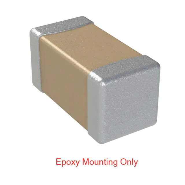

Chip Monolithic Ceramic Capacitor for Automotive limited to Conductive Glue Mounting GCG2165G1H102JA01_ (0805, X8G:EIA, 1000pF, DC50V) _: packaging code Reference Sheet 1.Scope This product specification is applied to Chip Monolithic Ceramic Capacitor limited to Conductive Glue Mounting Type used for Automotive Electronic equipment with conductive glue mounting.    2.MURATA Part NO. System (Ex.) GCG 21 6 (2)T Dimensions (1)L/W Dimensions 5G 1H 102 (4)Rated (3)Temperature Characteristics (5)Nominal Capacitance Voltage J (6)Capacitance Tolerance A01 (7)Murata’s Control Code 3. Type & Dimensions (1)-1 L (1)-2 W (2) T e 2.0±0.3 1.25±0.2 0.6±0.1 0.2 to 0.7 (Unit:mm) g 0.7 min. 4.Rated value (3) Temperature Characteristics (Public STD Code):X8G(EIA) Temp. coeff Temp. Range or Cap. Change (Ref.Temp.) 0±30 ppm/°C 25 to 150 °C (25 °C) (4) Rated Voltage DC 50 V (6) (5) Nominal Capacitance Capacitance Tolerance 1000 pF ±5 % Specifications and Test Methods (Operating Temp. Range) -55 to 150 °C 5.Package mark D J (8) Packaging f180mm Reel PAPER W8P4 f330mm Reel PAPER W8P4 Packaging Unit 4000 pcs./Reel 10000 pcs./Reel Product specifications in this catalog are as of Apr.15,2016,and are subject to change or obsolescence without notice. Please consult the approval sheet before ordering. Please read rating and !Cautions first. GCG2165G1H102JA01-01 1 D (8)Packaging Code ■AEC-Q200 Murata Standard Specification and Test Methods Specification. No AEC-Q200 Test Item Temperature Compensating Type AEC-Q200 Test Method High Dielectric Type Pre-and Post-Stress 1 - Electrical Test 2 High Temperature Exposure (Storage) The measured and observed characteristics should satisfy the Fix the capacitor to the supporting jig in the same manner and specifications in the following table. under the same conditions as No.16. Appearance No marking defects Capacitance Within ±2.5% or ±0.25pF Set the capacitor for 1000±12 hours at 150±3℃. Set for Change (Whichever is larger) Q/D.F. 30pFmin. : Q≧1000 R7/L8 : 0.05 max. 30pFmax.: Q ≧400+20C R9 : 0.075max. R7/L8/R9:Within ±12.5% 24±2 hours at room temperature, then measure. C: Nominal Capacitance(pF) I.R. More than 10,000MΩ or 500Ω・ F R9 : More than 3,000MΩ or 150 Ω・ F (Whichever is smaller) 3 Temperature Cycling The measured and observed characteristics should satisfy the Fix the capacitor to the supporting jig in the same manner and specifications in the following table. under the same conditions as No.16. Perform the 1000 cycles Appearance No marking defects Capacitance Within ±2.5% or ±0.25pF Change (Whichever is larger) Q/D.F. 30pFmin.: Q ≧1000 R7/L8 W.V.: 25Vmin.: 0.03 max. 30pFmax.: Q ≧ 400+20C      W.V.: 16V : 0.05 max C: Nominal Capacitance (pF) according to the four heat treatments listed in the following table. R7/L8/R9: Within ±10.0% Set for 24±2 hours at room temperature, then measure Step 1 2 3 4 Temp. (C) -55+0/-3 Room Temp. 125+3/-0(for C/R7) 150+3/-0(for 5G/L8/R9) Room Temp. 153 1 153 1 Time R9 : 0.075max. (min.) I.R. More than 10,000MΩ or 500Ω ・F (Whichever is smaller) ・ Initial measurement for high dielectric constant type Perform a heat treatment at 150+0/-10 ℃ for one hour and then set for 24±2 hours at room temperature. Perform the initial measurement. 4 Destructive No defects or abnormalities Per EIA-469. The measured and observed characteristics should satisfy the Fix the capacitor to the supporting jig in the same manner and specifications in the following table. under the same conditions as No.16. Apply the 24-hour heat (25 to 65℃) and humidity (80 to 98%) Physical Analysis 5 Moisture Resistance treatment shown below, 10 consecutive times. Appearance No marking defects Capacitance Within ±3.0% or ±0.30pF Change (Whichever is larger) Q/D.F. 30pFmin. : Q≧350 Set for 24±2 hours at room temperature, then measure. R7/L8/R9: Within ±12.5% 70 65 60 55 50 45 40 35 30 25 20 15 10 5 0 -5 -10 R7/L8 : 0.05 max. R9 : 0.075max. 10pFmax.: Q ≧200+10C C: Nominal Capacitance(pF) I.R. Humidity 90~98% (℃) 10pF and over, 30pF and below: Q≧275+5C/2 Temperature More than 10,000MΩ or 500Ω ・F R9 : More than 3,000MΩ or 150 Ω・ F (Whichever is smaller) Humidity 80~98% Humidity 90~98% Humidity 80~98% Humidity 90~98% +10 - 2℃ Initial measuremt One cycle 24hours 0 1 2 3 4 5 6 7 8 9 10 11 12 13 14 15 16 17 18 19 20 21 22 23 24 Hours 6 Biased Humidity The measured and observed characteristics should satisfy the Fix the capacitor to the supporting jig in the same manner and specifications in the following table. under the same conditions as No.16. Apply the rated voltage and 1.3+0.2/-0vdc (add 6.8kΩ resister) Appearance No marking defects Capacitance Within ±3.0% or ±0.30pF Change (Whichever is larger) Q/D.F. 30pF and over: Q≧200 R7/L8 : 0.05 max. 30pF and below: Q≧100+10C/3 R9 : 0.075max. R7/L8/R9: Within ±12.5% Remove and set for 24±2 hours at room temperature, then measure. The charge/discharge current is less than 50mA. C: Nominal Capacitance(pF) I.R. More than 1,000MΩ or 50Ω ・F (Whichever is smaller) JEMCGS-01499C at 85±3℃ and 80 to 85% humidity for 1000±12 hours. 2 ■AEC-Q200 Murata Standard Specification and Test Methods Specification. No AEC-Q200 Test Item 7 Operational Life Fix the capacitor to the supporting jig in the same manner and specifications in the following table. under the same conditions as No.16. Appearance No marking defects Capacitance Within ±3.0% or ±0.30pF Change (Whichever is larger) Q/D.F. 30pFmin. : Q≧350 R7/L8 : 0.05 max. 10pF and over, 30pF and below: R9 : 0.075max. Apply 200% of the rated voltage for 1000±12 hours at 125±3℃(for R7/L8/R9: Within ±12.5% Δ C/R7), 150±3℃(for 5G/L8/R9). Set for 24±2 hours at room temperature, then measure. The charge/discharge current is less than 50mA. ・ Initial measurement for high dielectric constant type. Q≧275+5C/2 10pFmax.: Q ≧200+10C Apply 200% of the rated DC voltage for one hour at the maximum operating temperature ±3℃. Remove and set for 24±2 hours at C: Nominal Capacitance(pF) I.R. AEC-Q200 Test Method Temperature High Dielectric Type Compensating Type The measured and observed characteristics should satisfy the More than 1,000MΩ or 50Ω ・F room temperature. Perform initial measurement. (Whichever is smaller) 8 External Visual No defects or abnormalities Visual inspection 9 Physical Dimension Within the specified dimensions Using calipers 10 Resistance to Appearance No marking defects Per MIL-STD-202 Method 215 Within the specified tolerance Solvent 1 : 1 part (by volume) of isopropyl alcohol Solvents Capacitance 3 parts (by volume) of mineral spirits Change Q/D.F. 30pFmin. : Q≧1000 R7/L8 : W.V.: 25Vmin.: 0.025 max. 30pFmax.: Q ≧400+20C C: Nominal Capacitance(pF) W.V.: 16V : 0.035 max. Solvent 2 : Terpene defluxer Solvent 3 : 42 parts (by volume) of water 1part (by volume) of propylene glycol monomethyl ether R9 : 0.075max. 1 part (by volume) of monoethanolamine I.R. More than 10,000MΩ or 500Ω ・F (Whichever is smaller) 11 Mechanical Shock Appearance No marking defects Fix the capacitor to the test jig in the same manner and under the Capacitance Within the specified tolerance same conditions as No.16.Three shocks in each direction should be applied along 3 mutually perpendicular axes of the test specimen Change Q/D.F. 30pFmin. : Q≧1000 R7/L8 : W.V.: 25Vmin.: 0.025 max. 30pFmax.: Q ≧400+20C C: Nominal Capacitance(pF) I.R. W.V.: 16V : 0.035 max. (18 shocks). The specified test pulse should be Half-sine and should have a duration :0.5ms, peak value:1500g and velocity change: 4.7m/s. R9 : 0.075max. More than 10,000MΩ or 500Ω ・F (Whichever is smaller) 12 Vibration Appearance No defects or abnormalities Fix the capacitor to the test jig in the same manner and under the Capacitance Within the specified tolerance same conditions as No.16. The capacitor should be subjected to a simple harmonic motion having a total amplitude of 1.5mm, the Change Q/D.F. 30pFmin. : Q≧1000 R7/L8 : W.V.: 25Vmin.: 0.025 max. 30pFmax.: Q ≧400+20C C: Nominal Capacitance(pF) W.V.: 16V : 0.035 max. frequency being varied uniformly between the approximate limits of 10 and 2000Hz. The frequency range, from 10 to 2000Hz and return to 10Hz, should be traversed in approximately 20 minutes. R9 : 0.075max. This motion should be applied for 12 cycle in each 3 mutually I.R. perpendicular directions More than 10,000MΩ or 500Ω ・F (Whichever is smaller) 13 Thermal Shock The measured and observed characteristics should satisfy the Fix the capacitor to the supporting jig in the same manner and specifications in the following table. under the same conditions as No.16. Perform the 300 cycles Appearance No marking defects Capacitance Within ±2.5% or ±0.25pF Change (Whichever is larger) Q/D.F. 30pFmin. : Q≧1000 30pFmax.: Q ≧400+20C C: Nominal Capacitance(pF) according to the two heat treatments listed in the following R7/L8/R9: Within ±10.0% room temperature, then measure R7/L8 : W.V.: 25Vmin.: 0.025 max. Step 1 2 Temp.(℃) -55+0/-3 125+3/-0(forΔC/R7) 150+3/-0(for 5G/L8/R9) Time (min.) 15±3 15±3 GCG21BL81H104K: 0.03 max. W.V.: 16V : 0.035 max. R9 : 0.075max I.R. table(Maximum transfer time is 20 seconds). Set for 24±2 hours at More than 10,000MΩ or 500Ω・F (Whichever is smaller) ・ Initial measurement for high dielectric constant type Perform a heat treatment at 150+0/-10 ℃ for one hour and then set for 24±2 hours at room temperature. Perform the initial measurement. JEMCGS-01499C 3 ■AEC-Q200 Murata Standard Specification and Test Methods Specification. No AEC-Q200 Test Item 14 ESD Temperature Compensating Type Appearance No marking defects Capacitance Within the specified tolerance AEC-Q200 Test Method High Dielectric Type Per AEC-Q200-002 Change Q/D.F. 30pFmin. : Q≧1000 R7/L8 : W.V.: 25Vmin.: 0.025 max. 30pFmax.: Q ≧400+20C C: Nominal Capacitance(pF) I.R. W.V.: 16V :0.035 max. R9 : 0.075max. More than 10,000MΩ or 500Ω・F (Whichever is smaller) 15 Electrical Appearance Chatacteri- Capacitance zation No defects or abnormalities Visual inspection. Within the specified tolerance The capacitance/Q/D.F. should be measured at 25℃ at the frequency and voltage shown in the table. Change Q/D.F. 30pFmin. : Q≧1000 R7/L8 : W.V.: 25Vmin.: 0.025 max. 30pFmax.: Q ≧400+20C C: Nominal Capacitance(pF) Char. W.V.: 16V : 0.035 max. Item R9 : 0.075max. Frequency Voltage I.R. 25℃ 1±0.1MHz ΔC,5G (more than 1000pF) R7,R9,L8(C≦10μF) 1±0.1kHz 0.5 to 5Vrms 1±0.2Vrms ΔC,5G (1000 pF and below) More than 100,000MΩ or 1000Ω・F More than 10,000MΩ or 500Ω・F The insulation resistance should be measured with a DC voltage not (Whichever is smaller) (Whichever is smaller) exceeding the rated voltage at 25℃ and 125℃(for Δ C/R7)/ 150℃ More than 10,000MΩ or 100Ω・F More than 1,000MΩ or 10Ω・F (Whichever is smaller) (Whichever is smaller) More than 10,000MΩ or 100Ω・F More than 1,000MΩ or 1Ω・F (Whichever is smaller) (Whichever is smaller) (for 5G/L8/R9)within 2 minutes of charging. I.R. 125℃ I.R. 150℃ Dielectric No failure should be observed when 250% of the rated voltage is No failure applied between the terminations for 1 to 5 seconds, provided the Strength charge/ discharge current is less than 50mA. 16 Terminal Appearance No marking defects Mount the capacitor on the test jig in Fig.1 using a conductive glue Capacitance Within specified tolerance Strength (HEREAUS"PC3000"). The conductive glue is hardened at 140℃ for 30minites. Then apply *shear tension in parallel with the test jig for 60sec. Change Q/D.F. 30pFmin. : Q≧1000 R7/L8 : W.V.: 25Vmin.: 0.025 max. 30pFmax.: Q ≧400+20C C: Nominal Capacitance(pF) W.V.: 16V: 0.035max. *Show in the table 1 R9 : 0.075max. Ag Pd electrode I.R. c More than 10,000MΩ or 500Ω ・F Alumina (Whichever is smaller) b Type GCG15 GCG18 GCG21 GCG31 GCG32 JEMCGS-01499C Share Tension 2.0N 2.7N 4.9N 6.9N 12.6N Table.1 Type GCG15 GCG18 GCG21 GCG31 GCG32 4 a a 0.4 1.0 1.2 2.2 2.2 Fig.1 b 1.5 3.0 4.0 5.0 5.0 c 0.5 1.2 1.65 2.0 2.9 (in mm) ■AEC-Q200 Murata Standard Specification and Test Methods Specification. No AEC-Q200 Test Item 17 Beam Load Test Temperature Compensating Type AEC-Q200 Test Method High Dielectric Type Destruction value should be exceed following one. Place the capacitor in the beam load fixture as Fig 2. Apply a force. < Chip L dimension : 2.5mm max. > Chip thickness > 0.5mm rank : 20N < Chip Length : 2.5mm max. > Chip thickness ≦0.5mm rank : 8N < Chip L dimension : 3.2mm mim. > Iron Board Chip thickness < 1.25mm rank : 15N Chip thickness ≧1.25mm rank : 54.5N < Chip Length : 3.2mm min. > L 0.6L Fig.2 Speed supplied the Stress Load : 0.5mm / sec. 18 Capacitance Temperature Capacitance Within the specified tolerance. Change (Table A) R7 : Within ±15% (-55℃ to +125℃) L8 : Within ±15% Characteristics (-55℃ to +125℃)    Within +15/-40% (+125℃ to +150℃) R9 : Within ±15% (-55℃ to +150℃) The capacitance change should be measured after 5 min. at each specified temperature stage. (1)Temperature Compensating Type The temperature coefficient is determined using the capacitance measured in step 3 as a reference. When cycling the temperature sequentially from step1 through 5 (Δ C: +25℃ to +125℃, 5G:+25℃ to +150℃ other temp. coifficient.:+25℃ to +85℃) the capacitance should be within the specified tolerance for the temperature coefficient and capacitance change as Table A-1. The capacitance drift is calculated by dividing the differences between the maximum and minimum measured values in the step Temperature Within the specified tolerance. Coefficient (Table A) 1,3 and 5 by the cap value in step 3. Step Capacitance Within ±0.2% or ±0.05 pF Drift (Whichever is larger.) Temperature.(C) 1 25±2 2 -55±3(for ΔC to R7) 3 25±2 4 125±3(for ΔC/R7), 150±3(for 5G/R9/L8) 5 25±2 (2) High Dielectric Constant Type The ranges of capacitance change compared with the above 25℃ value over the temperature ranges shown in the table should be within the specified ranges. Initial measurement for high dielectric constant type. Perform a heat treatment at 150+0/-10℃ for one hour and then set for 24±2 hours at room temperature. Perform the initial measurement. Table A Capacitance Change from 25C (%) -30 -10 Max. Min. Max. Min. Max. Min. 5C/5G 0± 30 0.58 -0.24 0.40 -0.17 0.25 -0.11 Note 1: Nominal values denote the temperature coefficient within a range of 25C to 125C(for C)/ 150C(for 5G). Char. Nominal Values (ppm/C) JEMCGS-01499C -55 5 Package GCG Type 1.Tape Carrier Packaging(Packaging Code:D/E/W/F/L/J/K) 1.1 Minimum Quantity(pcs./reel) φ180mm reel Paper Tape Code:D/E Code:W 10000 20000 (W8P2) (W8P1) 4000 4000 4000 Type GCG15 5 GCG18 8 6 GCG21 9 B M GCG31 C D GCG32 E Plastic Tape Code:L 3000 3000 2000 1000 1000 φ330mm reel Paper Tape Plastic Tape Code:J/ F Code:K 50000 (W8P2) 10000 10000 10000 10000 10000 6000 4000 4000 1.2 Dimensions of Tape (1)GCG15(W8P2 CODE:D/E/J/F)  *1,2:2.0±0.05 (in:mm) *1 +0.1 *2 B A 8.0±0.3 3.5±0.05 φ1.5 -0 1.75±0.1 4.0±0.1 0.05 max. Dimensions Tolerance(Chip) L W ±0.1 ±0.05 Type GCG15 5 A *3 0.65 t t B *3 1.15 0.8 max. *3 Nominal value (in:mm) (2)GCG15(W8P1 CODE:W)  +0.1 3.5±0.05 φ1.5 -0 B A 8.0±0.3 1.0±0.05 1.75±0.1 4.0±0.1 1.0±0.05 Type GCG15 JEMCGP-04125 5 Dimensions L W ±0.1 ±0.05 A *3 0.65 6 B *3 t 1.15 0.8 max. *3 Nominal value t Package GCG Type  (3)GCG18/21  (in:mm) 1.75±0.1 +0.1 4.0±0.1 2.0±0.1 3.5±0.05 φ1.5 -0 B A 8.0±0.3 4.0±0.1 t Dimensions Tolerance(Chip) Type GCG18 8 6 GCG21 L W ±0.2 ±0.1 ±0.3 ±0.2 TDimensions (Chip) A B 0.8±0.1 1.05±0.10 1.85±0.10 1.55±0.15 2.30±0.15 t 1.1max. 0.6±0.1 0.85±0.1 9  (4)GCG21/31/32 4.0±0.1 1.75±0.1 2.0±0.1 +0.1 -0 3.5±0.05 φ1.5 B A 0.25±0.1(T≦1.8mm) 0.3±0.1(T:2.5mm) 8.0±0.3 4.0±0.1 t Dimensions Tolerance(Chip) Type GCG21 B M GCG31 W ±0.3 ±0.2 ±0.3 ±0.3 A B t 1.25±0.2 1.45±0.20 2.25±0.20 2.0 max. 1.90±0.20 3.50±0.20 1.6±0.3 D 2.0±0.3 E ±0.4 ±0.3 1.7 max. 1.15±0.2 C GCG32 JEMCGP-04125 L T Dimensions (Chip) 2.5 max. 3.0 max. 2.80±0.20 2.5±0.3 7 3.50±0.20 3.7 max. め状態 (単位:mm) Package GCG Type Fig.1 Package Chips (in:mm) Chip Fig.2 Dimensions of Reel φ13±0.5 φ180+0/-3.0 φ330±2.0 φ21±0.8 φ50 min. 2.0±0.5 w1 W Fig.3 Taping Diagram W 16.5 max. GCG32 max. w1 10±1.5 Top Tape : Thickness 0.06 Feeding Hole :As specified in 1.2. Hole for Chip : As specified in 1.2. Bottom Tape :Thickness 0.05 (Only a bottom tape existence ) Base Tape : As specified in 1.2. JEMCGP-04125 8 チップ詰め状態 Package GCG Type (単位:mm) 1.3 Tapes for capacitors are wound clockwise shown in Fig.3. (The sprocket holes are to the right as the tape is pulled toward the user.) 1.4 Part of the leader and part of the vacant section are attached as follows. Tail vacant Section Chip-mounting Unit Leader vacant Section (in:mm) Leader Unit (Top Tape only) Direction of Feed 160 min. 190 min. 210 min. 1.5 Accumulate pitch : 10 of sprocket holes pitch = 40±0.3mm 1.6 Chip in the tape is enclosed by top tape and bottom tape as shown in Fig.1. 1.7 The top tape and base tape are not attached at the end of the tape for a minimum of 5 pitches. 1.8 There are no jointing for top tape and bottom tape. 1.9 There are no fuzz in the cavity. 1.10 Break down force of top tape : 5N min. Break down force of bottom tape : 5N min. (Only a bottom tape existence ) 1.11 Reel is made by resin and appeaser and dimension is shown in Fig 2. 図1 チップ詰め状態 (単位:mm) There are possibly to change the material and dimension due to some impairment. 1.12 Peeling off force : 0.1N to 0.6N in the direction as shown below. 165~180° Top tape 1.13 Label that show the customer parts number, our parts number, our company name, inspection number and quantity, will be put in outside of reel. JEMCGP-04125 9 ! Caution ■Limitation of Applications Please contact us before using our products for the applications listed below which require especially high reliability   for the prevention of defects which might directly cause damage to the third party's life, body or property.    ①Aircraft equipment ②Aerospace equipment ③Undersea equipment ④Power plant control equipment    ⑤Medical equipment ⑥Transportation equipment(vehicles,trains,ships,etc.) ⑦Traffic signal equipment    ⑧Disaster prevention / crime prevention equipment ⑨Data-processing equipment    ⑩Application of similar complexity and/or reliability requirements to the applications listed in the above. ■Storage and Operation condition 1. If store the chip monolithic ceramic capacitors in an atmosphere consisting of high temperature or humidity, sulfur or chlorine gases, contaminants attach to the surface of external electrode, and bondability with conductive glue may deteriorate. Do not store the capacitors in an atmosphere consisting of corrosive gas (e.g., hydrogen sulfide, sulfur dioxide, chlorine, ammoria gas, etc.). Storage environment must be at room temperature of +5°C to +40°C and a relative humidity of 20% to 70%, and use the product within six months. In case of packaging, do not open the last wrappend, polyethylene bag, till just before using.   After unpacking, immediately reseal, or store in a desiccator containing a desiccant. 2. Due to moisture condensation caused by rapid humidity changes, or the photochemical change caused by direct sunlight on the terminal electrodes and/or the resin/epoxy coatings, the bondability with conductive glue and electrical performance may deteriorate. Do not store capacitors under direct sunlight or in high huimidity conditions. 3. This product is chip monolithic ceramic capacitor limited to conductive glue mounting. Do not apply mounting method other than conductive glue. Flow or reflow soldering can result in a lack of adhesive strength on the outer electrode by poor wettability, which may result in chips breaking loose from the PCB. ■Rating 1.Temperature Dependent Characteristics 1. The electrical characteristics of the capacitor can change with temperature. 1-1. For capacitors having larger temperature dependency, the capacitance may change with temperature changes. The following actions are recommended in order to ensure suitable capacitance values. (1) Select a suitable capacitance for the operating temperature range. (2) The capacitance may change within the rated temperature. When you use a high dielectric constant type capacitor in a circuit that needs a tight (narrow) capacitance tolerance (e.g., a time-constant circuit), please carefully consider the temperature characteristics, and carefully confirm the various characteristics in actual use conditions and the actual system. [Example of Temperature Caracteristics X7R(R7)] Sample: 0.1μF, Rated Voltage 50VDC [Example of Temperature Characteristics X5R(R6)] Sample: 22μF, Rated Voltage 4VDC 20 Capacitance Change (%) Capacitance Change (%) 20 15 10 5 0 -5 -10 10 5 0 -5 -10 -15 -15 -20 -75 15 -50 -25 0 25 50 75 100 125 150 -20 -75 JEMCGC-04887 -50 -25 0 25 Temperature ( C) Temperature ( C) 10 50 75 100 Caution ! 2.Measurement of Capacitance 1. Measure capacitance with the voltage and frequency specified in the product specifications. 1-1. The output voltage of the measuring equipment may decrease occasionally when capacitance is high. Please confirm whether a prescribed measured voltage is impressed to the capacitor. 1-2. The capacitance values of high dielectric constant type capacitors change depending on the AC voltage applied. Please consider the AC voltage characteristics when selecting a capacitor to be used in a AC circuit. 3.Applied Voltage 1. Do not apply a voltage to the capacitor that exceeds the rated voltage as called out in the specifications. 1-1. Applied voltage between the terminals of a capacitor shall be less than or equal to the rated voltage. (1) When AC voltage is superimposed on DC voltage, the zero-to-peak voltage shall not exceed the rated DC voltage. When AC voltage or pulse voltage is applied, the peak-to-peak voltage shall not exceed the rated DC voltage. (2) Abnormal voltages (surge voltage, static electricity, pulse voltage, etc.) shall not exceed the rated DC voltage. Typical Voltage Applied to the DC capacitor DC Voltage DC Voltage+AC E AC Voltage E Pulse Voltage E 0 E 0 0 0 (E:Maximum possible applied voltage.) 1-2. Influence of over voltage Over voltage that is applied to the capacitor may result in an electrical short circuit caused by the breakdown of the internal dielectric layers . The time duration until breakdown depends on the applied voltage and the ambient temperature. 4.Type of Applied Voltage and Self-heating Temperature 1.Confirm the operating conditions to make sure that no large current is flowing into the capacitor due to the continuous application of an AC voltage or pulse voltage. When a DC rated voltage product is used in an AC voltage circuit or a pulse voltage circuit, the AC current or pulse current will flow into the capacitor; therefore check the self-heating condition. Please confirm the surface temperature of the capacitor so that the temperature remains within the upper limits of the operating temperature, including the rise in temperature due to self-heating. When the capacitor is used with a high-frequency voltage or pulse voltage, heat may be generated by dielectric loss. [Example of Temperature Rise (Heat Generation) in Chip Monolithic Ceramic Capacitors in Contrast to Ripple Current] Sample: R(R1) characteristics 10μF, Rated voltage: DC10V Ripple Current 100 Temperature Rise (℃) 1-1. The load should be contained to the level   such that when measuring at atmospheric    temperature of 25°C, the product's self-heating    remains below 20°C and the surface temperature of the capacitor in the actual circuit remains within the maximum operating temperature. 10 100kHz 500kHz 1MHz 1 JEMCGC-04887 11 0 1 2 4 3 Current (Ar.m.s.) 5 6 ! Caution 5. DC Voltage and AC Voltage Characteristic 1. The capacitance value of a high dielectric constant type capacitor changes depending on the DC voltage applied. Please consider the DC voltage characteristics when a capacitor is selected for use in a DC circuit. [Example of DC Voltage Characteristics] Capacitance Change (%) Sample: R(R1) Characteristics 0.1μF, Rated Voltage 50VDC 1-1. The capacitance of ceramic capacitors may change sharply depending on the applied voltage. (See figure) Please confirm the following in order to secure the capacitance. (1) Determine whether the capacitance change caused by the applied voltage is within the allowed range . (2) In the DC voltage characteristics, the rate of capacitance change becomes larger as voltage increases, even if the applied voltage is below the rated voltage. When a high dielectric constant type capacitor is used in a circuit that requires a tight (narrow) capacitance tolerance (e.g., a time constant circuit), please carefully consider the voltage characteristics, and confirm the various characteristics in the actual operating conditions   of the system. 20 0 -20 -40 -60 -80 -100 0 10 20 30 DC Voltage (V) 40 50 [Example of AC Voltage Characteristics] Capacitance Change (%) Sample: X7R(R7) Characteristics 10μF, Rated Voltage 6.3VDC 2. The capacitance values of high dielectric constant type capacitors changes depending on the AC voltage applied. Please consider the AC voltage characteristics when selecting a capacitor to be used in a AC circuit. 30 20 10 0 -10 -20 -30 -40 -50 -60 0 0.5 1 1.5 2 AC Voltage (Vr.m.s.) 6. Capacitance Aging [ Example of Change Over Time (Aging characteristics) ] 20 Capacitance Change(%) 1. The high dielectric constant type capacitors have an Aging characteristic in which the capacitance value decreases with the passage of time. When you use a high dielectric constant type capacitors in a circuit that needs a tight (narrow) capacitance tolerance (e.g., a time-constant circuit), please carefully consider the characteristics of these capacitors, such as their aging, voltage, and temperature characteristics. In addition, check capacitors using your actual appliances at the intended environment and operating conditions. 10 0 -10 C0G(5C) -20 X7R(R7) -30 -40 10 100 1000 10000 Time(h) 7.Vibration and Shock 1. Please confirm the kind of vibration and/or shock, its condition, and any generation of resonance. Please mount the capacitor so as not to generate resonance, and do not allow any impact on the terminals. 2. Mechanical shock due to being dropped may cause damage or a crack in the dielectric material of the capacitor. Do not use a dropped capacitor because the quality and reliability may be deteriorated. 3. When printed circuit boards are piled up or handled, the corner  of another printed circuit board should not be allowed to hit the capacitor in order to avoid a crack or other damage to the capacitor. JEMCGC-04887 12 Crack Floor Mounting printed circuit board Crack ! Caution ■Mounting 1. Selection of Conductive Adhesive, Mounting Process, and Bonding Strength 1.The acuired bonding strength may change greatly depending on the conductive adhesive to be used.   Be sure to confirming the desired performance can be acquired in the assumed monting process   with the conductive adhesive to be used. 2.Maintenance of the Mounting (pick and place) Machine 1. Make sure that the following excessive forces are not applied to the capacitors. 1-1. In mounting the capacitors on the printed circuit board, any bending force against them shall be kept to a minimum to prevent them from any damage or cracking. Please take into account the following precautions and recommendations for use in your process. (1) Adjust the lowest position of the pickup nozzle so as not to bend the printed circuit board. (2) Adjust the nozzle pressure within a static load of 1N to 3N during mounting.   [Incorrect] Suction Nozzle Deflection Board Board Guide   [Correct] Support Pin 2.Dirt particles and dust accumulated between the suction nozzle and the cylinder inner wall prevent the nozzle from moving smoothly. This imposes greater force upon the chip during mounting, causing cracked chips. Also, the locating claw, when worn out, imposes uneven forces on the chip when positioning, causing cracked chips. The suction nozzle and the locating claw must be maintained, checked and replaced periodically. 3.Moisture proof 1.To prevent the silver electrode migration, keep parts under low moisture condition with resin coating and the equivalent. 4.Coating 1. A crack may be caused in the capacitor due to the stress of the thermal contraction of the resin during curing process. The stress is affected by the amount of resin and curing contraction. Select a resin with low curing contraction. The difference in the thermal expansion coefficient between a coating resin or a molding resin and the capacitor may cause the destruction and deterioration of the capacitor such as a crack or peeling, and lead to the deterioration of insulation resistance or dielectric breakdown. Select a resin for which the thermal expansion coefficient is as close to that of the capacitor as possible. A silicone resin can be used as an under-coating to buffer against the stress. 2. Select a resin that is less hygroscopic. Using hygroscopic resins under high humidity conditions may cause the deterioration of the insulation resistance of a capacitor. An epoxy resin can be used as a less hygroscopic resin. 3.The halogen system substance and organic acid are included in coating material, and a chip corrodes   by the kind of Coating material. Do not use strong acid type. JEMCGC-04887 13 ! Caution ■ Others 1. Under Operation of Equipment 1-1. Do not touch a capacitor directly with bare hands during operation in order to avoid the danger of an electric shock. 1-2. Do not allow the terminals of a capacitor to come in contact with any conductive objects (short-circuit). Do not expose a capacitor to a conductive liquid, inducing any acid or alkali solutions. 1-3. Confirm the environment in which the equipment will operate is under the specified conditions. Do not use the equipment under the following environments. (1) Being spattered with water or oil. (2) Being exposed to direct sunlight. (3) Being exposed to ozone, ultraviolet rays, or radiation. (4) Being exposed to toxic gas (e.g., hydrogen sulfide, sulfur dioxide, chlorine, ammonia gas etc.) (5) Any vibrations or mechanical shocks exceeding the specified limits. (6) Moisture condensing environments. 1-4. Use damp proof countermeasures if using under any conditions that can cause condensation. 2. Others 2-1. In an Emergency (1) If the equipment should generate smoke, fire, or smell, immediately turn off or unplug the equipment. If the equipment is not turned off or unplugged, the hazards may be worsened by supplying continuous power. (2) In this type of situation, do not allow face and hands to come in contact with the capacitor or burns may be caused by the capacitor's high temperature. 2-2. Disposal of waste When capacitors are disposed of, they must be burned or buried by an industrial waste vendor with the appropriate licenses. 2-3. Circuit Design (1) Addition of Fail Safe Function Capacitors that are cracked by dropping or bending of the board may cause deterioration of the insulation resistance, and result in a short. If the circuit being used may cause an electrical shock, smoke or fire when a capacitor is shorted, be sure to install fail-safe functions, such as a fuse, to prevent secondary accidents. (2) This series are not safety standard certified products. 2-4. Remarks Failure to follow the cautions may result, worst case, in a short circuit and smoking when the product is used. The above notices are for standard applications and conditions. Contact us when the products are used in special mounting conditions. Select optimum conditions for operation as they determine the reliability of the product after assembly. The data herein are given in typical values, not guaranteed ratings. JEMCGC-04887 14 Notice ■ Rating 1.Operating Temperature 1. The operating temperature limit depends on the capacitor. 1-1. Do not apply temperatures exceeding the maximum operating temperature. It is necessary to select a capacitor with a suitable rated temperature that will cover the operating temperature range. It is also necessary to consider the temperature distribution in equipment and the seasonal temperature variable factor. 1-2. Consider the self-heating factor of the capacitor The surface temperature of the capacitor shall not exceed the maximum operating temperature including self-heating. 2.Atmosphere Surroundings (gaseous and liquid) 1. Restriction on the operating environment of capacitors. 1-1. Capacitors, when used in the above, unsuitable, operating environments may deteriorate due to the corrosion of the terminations and the penetration of moisture into the capacitor. 1-2. The same phenomenon as the above may occur when the electrodes or terminals of the capacitor are subject to moisture condensation. 1-3. The deterioration of characteristics and insulation resistance due to the oxidization or corrosion of terminal   electrodes may result in breakdown when the capacitor is exposed to corrosive or volatile gases or solvents for long periods of time. 3.Piezo-electric Phenomenon 1. When using high dielectric constant type capacitors in AC or pulse circuits, the capacitor itself vibrates at specific frequencies and noise may be generated. Moreover, when the mechanical vibration or shock is added to capacitor, noise may occur. JEMCGC-04887 15 Notice ■ Others 1.Transportation 1. The performance of a capacitor may be affected by the conditions during transportation. 1-1. The capacitors shall be protected against excessive temperature, humidity and mechanical force during transportation. (1) Climatic condition  ・ low air temperature : -40℃ ・ change of temperature air/air : -25℃/+25℃ ・ low air pressure : 30 kPa ・ change of air pressure : 6 kPa/min. (2) Mechanical condition Transportation shall be done in such a way that the boxes are not deformed and forces are not directly passed on to the inner packaging. 1-2. Do not apply excessive vibration, shock, or pressure to the capacitor. (1) When excessive mechanical shock or pressure is applied to a capacitor, chipping or cracking may occur in the ceramic body of the capacitor. (2) When the sharp edge of an air driver, tweezers, a chassis, etc. impacts strongly on the surface of the capacitor, the capacitor may crack and short-circuit. 1-3. Do not use a capacitor to which excessive shock was applied by dropping etc. A capacitor dropped accidentally during processing may be damaged. 2.Characteristics Evaluation in the Actual System 1. Evaluate the capacitor in the actual system,to confirm that there is no problem with the performance and specification values in a finished product before using. 2. Since a voltage dependency and temperature dependency exists in the capacitance of high dielectric type ceramic capacitors, the capacitance may change depending on the operating conditions in the actual system. Therefore,be sure to evaluate the various characteristics, such as the leakage current and noise absorptivity, which will affect the capacitance value of the capacitor. 3. In addition,voltages exceeding the predetermined surge may be applied to the capacitor by the inductance in the actual system. Evaluate the surge resistance in the actual system as required. JEMCGC-04887 16 ! 1.Please make sure that your product has been evaluated in view of your specifications with our product being mounted to your product. 2.Your are requested not to use our product deviating from this product specification. 3.We consider it not appropriate to include any terms and conditions with regard to the business transaction in the product specifications, drawings or other technical documents. Therefore, if your technical documents as above include such terms and conditions such as warranty clause, product liability clause, or intellectual property infringement liability clause, they will be deemed to be invalid. JEMCGC-04887 17 NOTE
