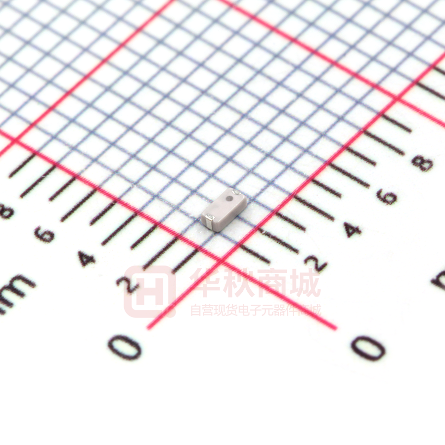

LFB182G45CL3D264
LFB182G45CL3D264
    MURATA-PS(村田)
    SMD,1.6x0.8mm
    中心频率(f0):2450MHz,工作温度:-40~+85℃,长x宽/尺寸:1.60 x 0.80mm,高度:0.65mm
LFB182G45CL3D264 数据手册
No. CD264-04 BAND PASS FILTER 1. Characteristics (at -40 ~ + 85 °C) Part Number LFB182G45CL3D264 Nominal Center Frequency 2450.00 MHz Pass Band Range (BW) fo ± 50.00 MHz Ripple 0.95 dB max. at 25 °C 1.25 dB max. at -40 ~ +85 °C 20.0 dB min. at 500.00 ~ 960.00 MHz 23.0 dB min. at 3200.00 MHz 30.0 dB min. at 4800.00 ~ 5000.00 MHz 32.0 dB min. at 7200.00 ~ 7500.00 MHz 0.50 dB max. V.S.W.R. in BW 2.00 max. Power Capacity 1 W max. Insertion Loss in BW Attenuation (Absolute value) 2. Construction, Dimensions & Marking L A 3. Land Pattern 0.700 0.400 0.420 0.200 a1e a2 T Mark A * 0.300 0.275 0.350 1.550 1.075 0.600 c1 c2 w c3 (3) (2) (1) * Meaning Directional Input Mark (in mm) (in mm) Mark L W T a1 a2 Dimension 1.60 ± 0.15 0.8 ± 0.1 0.65 max. 0.25 ± 0.10 0.40 ± 0.10 Mark c1 c2 c3 e - Dimension 0.55 ± 0.10 0.60 ± 0.10 0.30 ± 0.15 0.23 ± 0.05 - Land Solder resist No pattern Solder resist Through Hole Φ 0.30 * Line width to be designed to match 50 ohm characteristic impedance, Depending on PCB material and thickness. TERMINAL CONFIGURATION Terminal No. Terminal Name Terminal No. Terminal Name (1) IN (3) OUT (2) GND - - All the technical data and Information contained herein are subject tochange without prior notice. No. CD264-04 CAUTION PLEASE READ THIS NOTICE BEFORE USING OUR PRODUCTS. Please make sure that your product has been evaluated and confirmed from the aspect of the fitness for the specifications of our product when our product is mounted to your product. All the items and parameters in this product specification/datasheet/catalog have been prescribed on the premise that our product is used for the purpose, under the condition and in the environment specified in this specification. You are requested not to use our product deviating from the condition and the environment specified in this specification. Please note that the only warranty that we provide regarding the products is its conformance to the specifications provided herein. Accordingly, we shall not be responsible for any defects in products or equipment incorporating such products, which are caused under the conditions other than those specified in this specification. WE HEREBY DISCLAIMS ALL OTHER WARRANTIES REGARDING THE PRODUCTS, EXPRESS OR IMPLIED, INCLUDING WITHOUT LIMITATION ANY WARRANTY OF FITNESS FOR A PARTICULAR PURPOSE, THAT THEY ARE DEFECT-FREE, OR AGAINST INFRINGEMENT OF INTELLECTUAL PROPERTY RIGHTS. The product shall not be used in any application listed below which requires especially high reliability for the prevention of such defect as may directly cause damage to the third party's life, body or property. You acknowledge and agree that, if you use our products in such applications, we will not be responsible for any failure to meet such requirements. Furthermore, YOU AGREE TO INDEMNIFY AND DEFEND US AND OUR AFFILIATES AGAINST ALL CLAIMS, DAMAGES, COSTS, AND EXPENSES THAT MAY BE INCURRED, INCLUDING WITHOUT LIMITATION, ATTORNEY FEES AND COSTS, DUE TO THE USE OF OUR PRODUCTS IN SUCH APPLICATIONS. - Aircraft equipment. - Aerospace equipment - Undersea equipment. - Power plant control equipment - Medical equipment. - Transportation equipment (vehicles, trains, ships, elevator, etc.). - Traffic signal equipment. - Disaster prevention / crime prevention equipment. - Burning / explosion control equipment - Application of similar complexity and/ or reliability requirements to the applications listed in the above. We expressly prohibit you from analyzing, breaking, Reverse-Engineering, remodeling altering, and reproducing our product. Our product cannot be used for the product which is prohibited from being manufactured, used, and sold by the regulations and laws in the world. We do not warrant or represent that any license, either express or implied, is granted under any our patent right, copyright, mask work right, or our other intellectual property right relating to any combination, machine, or process in which our products or services are used. Information provided by us regarding third-party products or services does not constitute a license from us to use such products or services or a warranty or endorsement thereof. Use of such information may require a license from a third party under the patents or other intellectual property of the third party, or a license from us under our patents or other intellectual property. Please do not use our products, our technical information and other data provided by us for the purpose of developing of mass-destruction weapons and the purpose of military use. Moreover, you must comply with "foreign exchange and foreign trade law", the "U.S. export administration regulations", etc. Please note that we may discontinue the manufacture of our products, due to reasons such as end of supply of materials and/or components from our suppliers. Customer acknowledges that Murata will, if requested by you, conduct a failure analysis for defect or alleged defect of Products only at the level required for consumer grade Products, and thus such analysis may not always be available or be in accordance with your request (for example, in cases where the defect was caused by components in Products supplied to Murata from a third party). By signing on specification sheet or approval sheet, you acknowledge that you are the legal representative for your company and that you understand and accept the validity of the contents herein. When you are not able to return the signed version of specification sheet or approval sheet within 90 days from receiving date of specification sheet or approval sheet, it shall be deemed to be your consent on the content of specification sheet or approval sheet. Customer acknowledges that engineering samples may deviate from specifications and may contain defects due to their development status. We reject any liability or product warranty for engineering samples. In particular we disclaim liability for damages caused by ・the use of the engineering sample other than for evaluation purposes, particularly the installation or integration in the product to be sold by you, ・deviation or lapse in function of engineering sample, ・improper use of engineering samples. We disclaims any liability for consequential and incidental damages. If you can’t agree the above contents, you should inquire our sales. All the technical data and Information contained herein are subject tochange without prior notice.
