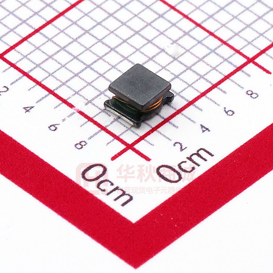

LQH32CN220K53L
LQH32CN220K53L
    MURATA-PS(村田)
    SMD,3.2x2.5mm
    功率电感 22µH ±10% 1210 1.55mm 3.20 x 2.50mm 923mΩ 250mA
LQH32CN220K53L 数据手册
Reference Only SpecNo.JELF243A-0030U-01 P1/8 CHIP COIL (CHIP INDUCTORS) LQH32CN□□□□53L REFERENCE SPECIFICATION 1. Scope This reference specification applies to LQH32CN_53 Series, Chip coil (Chip Inductors). 2. Part Numbering (ex) LQ H 32 C N 1R0 M 5 3 L Product ID Structure Dimension Applications Category Inductance Tolerance Features Electrode Packaging (L×W) and L:Taping Characteristics 3. Rating -40 to +85°C -40 to +85°C ・Operating Temperature Range. ・Storage Temperature Range. Customer Part Number DC Resistance (Ω) Self Resonant Frequency (MHz min) Rated Current (mA) 0.060±30% 100 1000 0.097±30% 64 790 0.12 ±30% 50 710 Inductance MURATA Part Number (µH) LQH32CN1R0M53L 1.0 Tolerance LQH32CN2R2M53L 2.2 LQH32CN3R3M53L 3.3 LQH32CN4R7M53L 4.7 0.15 ±30% 43 650 LQH32CN6R8M53L 6.8 0.25 ±30% 32 540 LQH32CN100K53L 10 0.30 ±30% 26 450 LQH32CN150K53L 15 0.58 ±30% 26 300 LQH32CN220K53L 22 LQH32CN330K53L 33 LQH32CN470K53L LQH32CN680K53L LQH32CN101K53L ±20% 0.71 ±30% 19 250 1.1 ±30% 17 200 47 1.3 ±30% 15 170 68 2.2 ±30% 12 130 100 3.5 ±30% 10 100 ±10% When applied Rated current to the Products , self temperature rise shall be limited to 20℃ max and Inductance will be within ±10% of initial Inductance value. 4. Testing Conditions Temperature : Ordinary Temperature (15 to 35°C) Humidity : Ordinary Humidity (25 to 85 %(RH)) Temperature : 20 ± 2°C Humidity : 60 to 70%(RH) Atmospheric Pressure : 86 to 106 kPa 5. Appearance and Dimensions 2.5 ± 0.2 1.55 ± 0.15 2.5 ± 0.2 A A 2.5 ± 0.2 3.2 ± 0.3 A : 2.8 max. ※ No marking. ■Unit Mass (Typical value) 0.045g (in mm) 0.9 ± 0.31.3 ± 0.2 0.9 ± 0.3 MURATA MFG.CO., LTD SpecNo.JELF243A-0030U-01 Reference Only P2/8 6.Electrical Performance No. 6.1 Item Inductance Specification Inductance shall meet item 3. Test Method Measuring Equipment : KEYSIGHT 4192A or equivalent Measuring Frequency: 1MHz 6.2 DC Resistance DC Resistance shall meet item 3. Measuring Equipment: Digital multi meter 6.3 Self Resonant Frequency(S.R.F) S.R.F shall meet item 3. Measuring Equipment: KEYSIGHT E4991A or equivalent 7.Mechanical Performance No. 7.1 Item Shear Test Specification Chip coil shall not be damaged. Test Method Substrate: Glass-epoxy substrate Applied Direction : Chip coil F Substrate Force: 10N Hold Duration: 5±1s 7.2 Bending Test Substrate:Glass-epoxy substrate (100×40×1.6mm) Speed of Applying Force: 1mm / s Deflection: 2mm Hold Duration: 30seconds. Pressure jig R340 F Deflection 45 45 Product (in mm) 7.3 Vibration Oscillation Frequency : 10~55~10Hz for 1 minute Total Amplitude: 1.5mm Testing Time: A period of 2 hours in each of 3 mutually perpendicular directions. (Total 6 hours) 7.4 Solderability The wetting area of the electrode shall be at least 90% covered with new solder coating. Flux: Ethanol solution of rosin,25(wt)% (Immersed for 5s to 10s) Solder : Sn-3.0Ag-0.5Cu Pre-Heating : 150±10°C / 60 to 90seconds Solder Temperature : 240±5°C Immersion Time : 3±1 s 7.5 Resistance to Soldering Heat Appearance:No damage Inductance Change: within ±5% Flux: Ethanol solution of rosin,25(wt)% (Immersed for 5s to 10s) Solder : Sn-3.0Ag-0.5Cu Pre-Heating: 150±10°C / 60 to 90seconds Solder Temperature: 270±5°C Immersion Time: 10±1 s Then measured after exposure in the room condition for 24±2 hours. MURATA MFG.CO., LTD Reference Only SpecNo.JELF243A-0030U-01 P3/8 8.Environmental Performance (It shall be soldered on the substrate.) No. 8.1 Item Heat Resistance Specification Appearance:No damage Inductance Change: within ± 5% DC Resistance Change: within ± 5% Test Method Temperature: 85±2°C Time: 1000h (+48h , -0h) Then measured after exposure in the room condition for 24±2 hours. 8.2 Cold Resistance Temperature: -40±2°C Time: 1000h (+48h , -0h) Then measured after exposure in the room condition for 24±2 hours. 8.3 Humidity Temperature: 40±2°C Humidity: 90~95%(RH) Time: 1000h (+48h , -0h) Then measured after exposure in the room condition for 24±2 hours. 8.4 Temperature Cycle 1 cycle: 1 step: -40±2°C / 30±3 minutes 2 step: Ordinary temp. / 10 to 15 minutes 3 step: +85±2°C / 30±3 min 4 step: Ordinary temp. / 10 to 15 minutes Total of 10 cycles Then measured after exposure in the room condition for 24±2 hours. 9. Specification of Packaging 3.6±0.2 3.5±0.05 ※ Lead- in/out wire 4.0±0.1 2.9±0.2 ( 0.2 ) positions of the lead wire. Dimension of the Cavity is measured at the bottom side. 4.0±0.1 2.0±0.05 ※The packing directions of the chip coil in taping are unified with the in/out 8.0±0.2 +0.1  1.5 -0 1.75±0.1 9.1 Appearance and Dimensions of plastic tape 1.7±0.2 (in mm) Direction of feed 9.2 Specification of Taping (1) Packing quantity (standard quantity) 2,000 pcs / reel (2) Packing Method Products shall be packed in the each embossed cavity of plastic tape and sealed by cover tape. (3) Sprocket hole The sprocket holes are to the right as the tape is pulled toward the user. (4) Spliced point Plastic tape and Cover tape has no spliced point. (5) Missing components number Missing components number within 0.025 % of the number per reel or 1 pc., whichever is greater, and are not continuous. The specified quantity per reel is kept. 9.3 Pull Strength Embossed carrier tape 10N min. Cover tape 5N min. MURATA MFG.CO., LTD Reference Only SpecNo.JELF243A-0030U-01 9.4 Peeling off force of cover tape Speed of Peeling off Peeling off force 165 to 180 degree 300mm/min F P4/8 Cover tape 0.2 to 0.7N (minimum value is typical) Plastic tape 9.5 Dimensions of Leader-tape, Trailer and Reel There shall be leader-tape (cover tape) and trailer-tape (empty tape) as follows. 9.6 Marking for reel Customer part number, MURATA part number, Inspection number(1), RoHS marking(2), Quantity etc ・・・ 1) (1) Factory Code (2) Date □□ OOOO  (1) (2) (3) First digit : Year / Last digit of year Second digit : Month / Jan. to Sep.  1 to 9, Oct. to Dec.  O, N, D Third, Fourth digit : Day (3) Serial No. 2) « Expression of RoHS marking » ROHS – Y (△) (1) (2) (1) RoHS regulation conformity (2) MURATA classification number 9.7 Marking for Outside package (corrugated paper box) Customer name, Purchasing order number, Customer part number, MURATA part number, RoHS marking (2) , Quantity, etc ・・・ 9.8. Specification of Outer Case Outer Case Dimensions (mm) Label H D W D H Standard Reel Quantity in Outer Case (Reel) 186 186 93 5 Above Outer Case size is typical. It depends on a quantity of an order. W 10. Caution 10.1. Limitation of Applications Please contact us before using our products for the applications listed below which require especially high reliability for the prevention of defects which might directly cause damage to the third party's life, body or property. (1) Aircraft equipment (2) Aerospace equipment (3) Undersea equipment (4) Power plant control equipment (5) Medical equipment (6) Transportation equipment (vehicles, trains, ships, etc.) (7) Traffic signal equipment (8) Disaster prevention / crime prevention equipment (9) Data-processing equipment (10) Applications of similar complexity and /or reliability requirements to the applications listed in the above MURATA MFG.CO., LTD Reference Only SpecNo.JELF243A-0030U-01 P5/8 10.2.Corrosive gas Please refrain from use since contact with environments with corrosive gases (sulfur gas [hydrogen sulfide, sulfur dioxide, etc.], chlorine, ammonia, etc.) or oils (cutting oil, silicone oil, etc.) that have come into contact with the previously stated corrosive gas environment will result in deterioration of product quality or an open from deterioration due to corrosion of product electrode, etc. We will not bear any responsibility for use under these environments. 11. Notice This product is designed for solder mounting. Please consult us in advance for applying other mounting method such as conductive adhesive. 11.1 Land pattern designing Recommended land patterns for flow and reflow soldering are as follows: These have been designed for Electric characteristics and solderability. Please follow the recommended patterns. Otherwise, their performance which includes electrical performance or solderability may be affected, or result to "position shift" in soldering process. Reflow Soldering  Flow Soldering 5.5 Land 5.5 Chip Coil 2.0 1.0 1.0 Solder Resist 1.0 1.3 1.3 1.0 (in mm) Applicable to flow soldering. 11.2 Flux, Solder ・Use rosin-based flux. Flux ・Don’t use highly acidic flux with halide content exceeding 0.2(wt)% (chlorine conversion value). ・Don’t use water-soluble flux. ・Use Sn-3.0Ag-0.5Cu solder. Solder ・Standard thickness of solder paste : 200μm to 300μm 11.3 Flow soldering conditions / Reflow soldering conditions ・Pre-heating should be in such a way that the temperature difference between solder and product surface is limited to 150°C max. Cooling into solvent after soldering also should be in such a way that the temperature difference is limited to 100°C max. Insufficient pre-heating may cause cracks on the product, resulting in the deterioration of product quality. ・Standard soldering profile and the limit soldering profile is as follows. The excessive limit soldering conditions may cause leaching of the electrode and / or resulting in the deterioration of product quality. Soldering profile (1)Flow soldering profile Temp. (℃) 265℃±3℃ 250℃ Limit Profile 150 Heating Time 60s min. Pre-heating Heating Cycle of flow Standard Profile Time. (s) Standard Profile Limit Profile 150°C、60s min. 250°C、4s~6s 265°C±3°C、5s 2 times 1 time MURATA MFG.CO., LTD SpecNo.JELF243A-0030U-01 Reference Only P6/8 (2)Reflow soldering profile Temp. (℃) 260℃ 245℃±3℃ 230℃ 220℃ Limit Profile 180 150 Standard Profile 30s~60s 60s max. 90s±30s Time. (s) Standard Profile Pre-heating Heating Limit Profile 150~180°C 、90s±30s above 220°C、30s~60s above 230°C、60s max. 245±3°C 260°C,10s 2 times 1 time Peak temperature Cycle of reflow 11.4 Reworking with soldering iron. The following conditions must be strictly followed when using a soldering iron. Pre-heating 150°C,1 min Tip temperature 350°C max. Soldering iron output 80W max. Tip diameter φ3mm max. Soldering time 3(+1,-0)s Times 2 times Note : Do not directly touch the products with the tip of the soldering iron in order to prevent the crack on the products due to the thermal shock. 11.5 Solder Volume ・Solder shall be used not to be exceed the upper limits as shown below. ・Accordingly increasing the solder volume, the mechanical stress to Chip is also increased. Exceeding solder volume may cause the failure of mechanical or electrical performance. Upper Limit Recommendable T t 1/3T≦t≦T (T: Lower flange thickness) 11.6 Product's location The following shall be considered when designing and laying out P.C.B.’s. (1) P.C.B. shall be designed so that products are not subject to the mechanical stress due to warping the board. [Products direction] a b 〈 Poor example〉 Products shall be located in the sideways direction (Length: a D *1 (2) Add slits in the board separation part. A > B (3) Keep the mounting position of the component away from the board separation surface. A > C Seam b A C B D Slit *1 A > D is valid when stress is added vertically to the perforation as with Hand Separation. If a Cutting Disc is used, stress will be diagonal to the PCB, therefore A > D is invalid. Length:a b a (3) Mounting Components Near Screw Holes When a component is mounted near a screw hole, it may be affected by the board deflection that occurs during the tightening of the screw. Mount the component in a position as far away from the screw holes as possible. Screw Hole Recommended 11.7 Cleaning Conditions Products shall be cleaned on the following conditions. (1) Cleaning temperature shall be limited to 60°C max.(40°C max for IPA.) (2) Ultrasonic cleaning shall comply with the following conditions with avoiding the resonance phenomenon at the mounted products and P.C.B. Power : 20 W / l max. Frequency : 28kHz to 40kHz Time : 5 minutes max. (3) Cleaner 1. Alternative cleaner ・Isopropyl alcohol (IPA) 2. Aqueous agent ・PINE ALPHA ST-100S (4) There shall be no residual flux and residual cleaner after cleaning. In the case of using aqueous agent, products shall be dried completely after rinse with de-ionized water in order to remove the cleaner. (5) Other cleaning Please contact us. 11.8 Resin coating The inductance value may change due to high cure-stress of resin to be used for coating/molding products. An open circuit issue may occur by mechanical stress caused by the resin, amount/cured shape of resin, or operating condition etc. Some resin contains some impurities or chloride possible to generate chlorine by hydrolysis under some operating condition may cause corrosion of wire of coil, leading to open circuit. So, please pay your careful attention when you select resin in case of coating/molding the products with the resin.Prior to use the coating resin, please make sure no reliability issue is observed by evaluating products mounted on your board. 11.9 Caution for use ・Sharp material such as a pair of tweezers or other material such as bristles of cleaning brush, shall not be touched to the winding portion to prevent the breaking of wire. ・Mechanical shock should not be applied to the products mounted on the board to prevent the breaking of the core 11.10 Handling of a substrate After mounting products on a substrate, do not apply any stress to the product caused by bending or twisting to the substrate when cropping the substrate, inserting and removing a connector from the substrate or tightening screw to the substrate. Excessive mechanical stress may cause cracking in the product. Bending Twisting MURATA MFG.CO., LTD SpecNo.JELF243A-0030U-01 Reference Only P8/8 11.11 Storage and Handling Requirements (1) Storage period Use the products within 12 months after delivered. Solderability should be checked if this period is exceeded. (2) Storage conditions ・Products should be stored in the warehouse on the following conditions. Temperature : -10 ~ 40°C Humidity : 15 to 85% relative humidity No rapid change on temperature and humidity The electrode of the products is coated with solder. Don't keep products in corrosive gases such as sulfur, chlorine gas or acid, or it may cause oxidization of electrode, resulting in poor solderability. ・Products should not be stored on bulk packaging condition to prevent the chipping of the core and the breaking of winding wire caused by the collision between the products. ・Products should be stored on the palette for the prevention of the influence from humidity, dust and so on. ・Products should be s stored in the warehouse without heat shock, vibration, direct sunlight and so on. (3) Handling Condition Care should be taken when transporting or handling product to avoid excessive vibration or mechanical shock. 12. Note (1) Please make sure that your product has been evaluated in view of your specifications with our product being mounted to your product. (2) You are requested not to use our product deviating from the reference specifications. (3) The contents of this reference specification are subject to change without advance notice. Please approve our product specifications or transact the approval sheet for product specifications before ordering. MURATA MFG.CO., LTD
