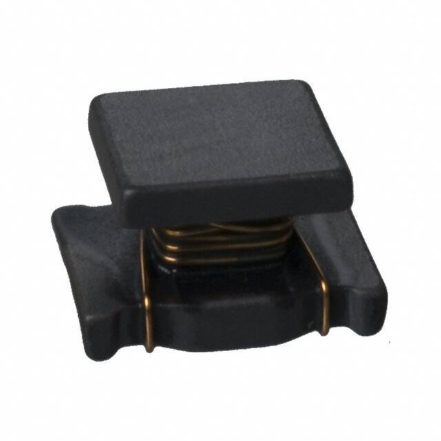

LQH43PH2R2M26L
LQH43PH2R2M26L
    MURATA-PS(村田)
    SMD,4.5x3.2mm
    固定电感器 Nonstandard 2.2µH ±20% 2.5A 50.4mΩ 45MHz
LQH43PH2R2M26L 数据手册
Spec No.: JELF243A_9137G-01 P1/10 CHIP COILS (CHIP INDUCTORS) LQH43PH□□□□26□ Murata Standard Reference Specification [AEC-Q200] 1. Scope This reference specification applies to chip coils (chip inductors) LQH43PH_26 series for automotive electronics based on AEC-Q200. 2. Part Numbering (Ex.) LQ H Product ID Structure 43 P H 1R0 Dimension (L × W) Application and characteristic Category N 26 L Inductance Tolerance Dimension (T) Packaging L: taping *B: bulk *B: Bulk packing is also available. 3. Part Number and Rating Operating temperature range (ambient temperature not including self-temperature rise) -40°C to +105°C (product temperature including self-temperature rise) -40°C to +125°C Storage temperature range -40°C to +125°C Rated current (mA)*3 Inductance Customer Part number Murata Part number Nominal Tolerance value (%) (μH) DC resistance (Ω) Self-resonant Based on temperature ESD frequency rise*2 Based on 5 A :8 kV (MHz min.) inductance Ambient Ambient change*1 temperature temperature 85°C 105°C LQH43PH1R0N26L 1.0 N: ±30 0.026±20% 100 3400 3300 1410 5A LQH43PH2R2M26L 2.2 M: ±20 0.042±20% 45 2300 2500 1120 5A LQH43PH3R3M26L 3.3 M: ±20 0.052±20% 40 1800 2100 1000 5A LQH43PH4R7M26L 4.7 M: ±20 0.075±20% 35 1400 1600 780 5A LQH43PH6R8M26L 6.8 M: ±20 0.098±20% 30 1200 1400 760 5A LQH43PH8R2M26L 8.2 M: ±20 0.128±20% 25 1100 1300 670 5A LQH43PH100M26L 10 M: ±20 0.147±20% 20 1050 1170 620 5A LQH43PH220M26L 22 M: ±20 0.327±20% 15 700 780 400 5A LQH43PH470M26L 47 M: ±20 0.718±20% 8 470 520 280 5A LQH43PH101M26L 100 M: ±20 1.538±20% 4 320 320 180 5A LQH43PH151M26L 150 M: ±20 2.362±20% 3 280 260 140 5A LQH43PH221M26L 220 M: ±20 2.900±20% 2 220 240 130 5A *1 When rated current is applied to the products, inductance will be within ±30% of nominal inductance value. *2 When rated current is applied to the products, temperature rise caused by self-generated heat shall be limited to 40°C max (ambient temperature 85°C max). When rated current is applied to the products, temperature rise caused by self-generated heat shall be limited to 20°C max (ambient temperature 85°C to 105°C). *3 Keep the temperature (ambient temperature plus self-generation of heat) under 125°C. 4. Testing Conditions Unless otherwise specified Temperature: ordinary temperature (15°C to 35°C) Humidity: ordinary humidity [25% to 85% (RH)] In case of doubt Temperature: 20°C±2°C Humidity: 60% to 70% (RH) Atmospheric pressure: 86 kPa to 106 kPa MURATA MFG CO., LTD Spec No.: JELF243A_9137G-01 P2/10 5. Appearance and Dimensions Unit mass (typical value): 0.13 g 6. Marking No marking. 7. Electrical Performance No. Item Specification Test method 7.1 Inductance Meet chapter 3 ratings. Measuring equipment: Keysight 4284A or the equivalent Measuring frequency: 1 MHz 7.2 DC resistance Meet chapter 3 ratings. Measuring equipment: digital multimeter 7.3 Self-resonant frequency Meet chapter 3 ratings. Measuring equipment: Keysight E4991A or the equivalent MURATA MFG CO., LTD Spec No.: JELF243A_9137G-01 P3/10 8. AEC-Q200 Requirement 8.1 Performance [based on table 5 for magnetics (inductors/transformer) AEC-Q200 Rev. D issued June 1, 2010] AEC-Q200 No. 3 Stress High temperature exposure Murata specification/deviation Test method 1000 h at 125°C Set for 24 h at room condition, then measured. 1000 cycles -40°C to +125°C Set for 24 h at room condition, then measured. Meet table A after testing. Table A Appearance No damage Inductance change (at 1 MHz) Within ±10% DC resistance change Within ±10% 4 Temperature cycling Meet table A after testing. 7 Biased humidity 1000 h at 85°C, 85% (RH). Unpowered. Meet table A after testing. 8 Operational life Apply rated current 85°C 1000 h Set for 24 h at room condition, then measured. Meet table A after testing. 9 External visual Visual inspection No abnormalities 10 Physical dimension Meet chapter 5, "Appearance and Dimensions". No defects 12 Resistance to solvents Per MIL-STD-202 Method 215 Not applicable 13 Mechanical shock Per MIL-STD-202 Method 213 100 g’s/6 ms/half sine Meet table A after testing. 14 Vibration 5 g's for 20 min, 12 cycles each of 3 orientations Test from 10 Hz to 2000 Hz Meet table A after testing. 15 Resistance to soldering heat No-heating Solder temperature 260°C±5°C Immersion time 10 s Pre-heating: 150°C to 180°C/90 s±30 s Meet table A after testing. 17 ESD Per AEC-Q200-002 Meet chapter 3 ratings. Appearance: no damage 18 Solderbility Per J-STD-002 Method b: not applicable 95% of the terminations is to be soldered (except exposed wire). 19 Electrical Measured: inductance characterization No defects 20 Flammability Per UL-94 Not applicable 21 Board flex Epoxy-PCB (1.6 mm) Deflection 2 mm (min.) 60 s minimum holding time Holding time: 5 s Meet table A after testing. 22 Terminal strength Per AEC-Q200-006 A force of 17.7 N for 60 s No defects MURATA MFG CO., LTD Spec No.: JELF243A_9137G-01 P4/10 9. Specification of Packaging 9.1 Appearance and dimensions of tape (12 mm width/plastic tape) A 3.6±0.1 B 4.9±0.1 t 2.7±0.1 t' (0.3) (in mm) * The dimensions of the cavity are measured at its bottom. * The packing direction of the chip coils in the taping is unified with the in/out positions of the lead wires. 9.2 Taping specifications Packing quantity (Standard quantity) 500 pcs/reel Packing method The products are placed in embossed cavities of a plastic tape and sealed by a cover tape. Feed hole position The feed holes on the plastic tape are on the right side when the cover tape is pulled toward the user. Joint The plastic tape and the cover tape are seamless. Number of missing products Number of missing products within 0.025% of the number per reel or 1 pc., whichever is greater, and are not continuous. The specified quantity per reel is kept. 9.3 Break down force of tape Break down force of plastic tape 10 N min. Break down force of cover tape 5 N min. 9.4 Peeling off force of cover tape Speed of peeling off 300 mm/min Peeling off force 165 to 180 degree 0.2 N to 0.7 N (The lower limit is for typical value.) F Cover tape Plastic tape MURATA MFG CO., LTD Spec No.: JELF243A_9137G-01 P5/10 9.5 Dimensions of leader section, trailer section and reel A vacant section is provided in the leader (start) section and trailer (end) section of the tape for the product. The leader section is further provided with an area consisting only of the cover tape. (See the diagram below.) 9.6 Marking for reel Customer part number, Murata part number, inspection number (*1), RoHS marking (*2), quantity, etc. *1 Expression of inspection No.: (1) Factory code  (2) Date □□ ○○○○ First digit: year/last digit of year (1) (2) (3) Second digit: month/Jan. to Sep.→1 to 9, Oct. to Dec.→O, N, D Third, Fourth digit: day (3) Serial No. *2 Expression of RoHS marking: (1) RoHS regulation conformity ROHSY () (2) Murata classification number (1) (2) 9.7 Marking on outer box (corrugated box) Customer name, purchasing order number, customer part number, Murata part number, RoHS marking (*2), quantity, etc. 9.8 Specification of outer box Label H D W Dimensions of outer box (mm) W D H 186 186 93 Standard reel quantity in outer box (reel) 4 * Above outer box size is typical. It depends on a quantity of an order. MURATA MFG CO., LTD Spec No.: JELF243A_9137G-01 10. P6/10 Caution 10.1 Restricted applications Please contact us before using our products for the applications listed below which require especially high reliability for the prevention of defects which might directly cause damage to the third party's life, body or property. (1) Aircraft equipment (6) Disaster/crime prevention equipment (2) Aerospace equipment (7) Traffic signal equipment (3) Undersea equipment (8) Transportation equipment (trains, ships, etc.) (4) Power plant control equipment (9) Data-processing equipment (5) Medical equipment (10) Applications of similar complexity and/or reliability requirements to the applications listed in the above 10.2 Precautions on rating Do not use the products in excess of their rated current. Doing so may cause the product to generate heat, resulting in short circuit between wires, wire breakage, or melted solder, which may cause dropping of parts. 10.3 Fail-safe Be sure to provide an appropriate fail-safe function on your product to prevent a second damage that may be caused by the abnormal function or the failure of our product. 11. Precautions for Use This product is for use only with reflow soldering. It is designed to be mounted by soldering. If you want to use other mounting method, for example, using a conductive adhesive, please consult us beforehand. 11.1 Land dimensions The following diagram shows the recommended land dimensions for reflow soldering. The land dimensions are designed in consideration of electrical characteristics and mountability. Use of other land dimensions may preclude achievement of performance. In some cases, it may result in poor solderability, including positional shift. If you use other land pattern, consider it adequately. 4.5 1.5 1.5 1.5 2.8 0.3 2.1 1.2 1.5 7.5 (in mm) 11.2 Flux and solder used Flux • Use a rosin-based flux. • Do not use a highly acidic flux with a halide content exceeding 0.2(wt)% (chlorine conversion value). • Do not use a water-soluble flux. Solder • Use Sn-3.0Ag-0.5Cu solder. • Standard thickness of solder paste: 100 μm to 150 μm If you want to use a flux other than the above, please consult our technical department. MURATA MFG CO., LTD Spec No.: JELF243A_9137G-01 P7/10 11.3 Soldering conditions (reflow) • Pre-heating should be in such a way that the temperature difference between solder and product surface is limited to 100°C max. Cooling into solvent after soldering also should be in such a way that the temperature difference is limited to 100°C max. Insufficient pre-heating may cause cracks on the product, resulting in the deterioration of product quality. • Standard soldering profile and the limit soldering profile is as follows. The excessive limit soldering conditions may cause leaching of the electrode and/or resulting in the deterioration of product quality. Temp. (℃) 260℃ 245℃±3℃ 230℃ 220℃ Limit Profile 180 150 Standard Profile 30s~60s 60s max. 90s±30s Time. (s) Standard profile Limit profile Pre-heating 150°C to 180°C/90 s±30 s 150°C to 180°C/90 s±30 s Heating Above 220°C/30 s to 60 s Above 230°C/60 s max. 245°C±3°C 260°C/10 s 2 times 2 times Peak temperature Number of reflow cycles 11.4 Reworking with soldering iron The following requirements must be met to rework a soldered product using a soldering iron. Item Requirement Pre-heating Tip temperature of soldering iron Power consumption of soldering iron Tip diameter of soldering iron Soldering time Number of reworking operations 150°C/approx. 1 min 350°C max. 80 W max. ø3 mm max. 3 s (+1 s, -0 s) 2 times max. * Avoid a direct contact of the tip of the soldering iron with the product. Such a direction contact may cause cracks in the ceramic body due to thermal shock. 11.5 Solder volume Solder shall be used not to increase the volume too much. An increased solder volume increases mechanical stress on the product. Exceeding solder volume may cause the failure of mechanical or electrical performance. MURATA MFG CO., LTD Spec No.: JELF243A_9137G-01 P8/10 11.6 Product's location The following shall be considered when designing and laying out PCBs. (1) PCB shall be designed so that products are not subject to mechanical stress due to warping the board. [Products direction] Products shall be located in the sideways direction to the mechanical stress. Electrode (Poor example) (Good example) Electrode (2) Components location on PCB separation It is effective to implement the following measures, to reduce stress in separating the board. It is best to implement all of the following three measures; however, implement as many measures as possible to reduce stress. Contents of measures Stress level (1) Turn the mounting direction of the component parallel to the board separation surface. A > D*1 (2) Add slits in the board separation part. A>B (3) Keep the mounting position of the component away from the board separation surface. A>C *1 A > D is valid when stress is added vertically to the perforation as with hand separation. If a cutting disc is used, stress will be diagonal to the PCB, therefore A > D is invalid. Electrode Perforation A C B Slit D Electrode (3) Mounting components near screw holes When a component is mounted near a screw hole, it may be affected by the board deflection that occurs during the tightening of the screw. Mount the component in a position as far away from the screw holes as possible. Screw Hole Recommended 11.7 Handling of substrate After mounting products on a substrate, do not apply any stress to the product caused by bending or twisting to the substrate when cropping the substrate, inserting and removing a connector from the substrate or tightening screw to the substrate. Excessive mechanical stress may cause cracking in the product. Bending Twisting MURATA MFG CO., LTD Spec No.: JELF243A_9137G-01 P9/10 11.8 Cleaning The product shall be cleaned under the following conditions. (1) The cleaning temperature shall be 60°C max. If isopropyl alcohol (IPA) is used, the cleaning temperature shall be 40°C max. (2) Perform ultrasonic cleaning under the following conditions. Exercise caution to prevent resonance phenomenon in mounted products and the PCB. Item Requirement Power Time 20 W/L max. 5 min max. Frequency 28 kHz to 40 kHz (3) Cleaner Alcohol-based cleaner: IPA Aqueous agent: PINE ALPHA ST-100S (4) There shall be no residual flux or residual cleaner. When using aqueous agent, rinse the product with deionized water adequately and completely dry it so that no cleaner is left. * For other cleaning, consult our technical department. 11.9 Storage and transportation Storage period Use the product within 12 months after delivery. If you do not use the product for more than 12 months, check solderability before using it. Storage conditions • The products shall be stored in a room not subject to rapid changes in temperature and humidity. The recommended temperature range is -10°C to +40°C. The recommended relative humidity range is 15% to 85%. Keeping the product in corrosive gases, such as sulfur, chlorine gas or acid, oxidizes the electrode, resulting in poor solderability or corrosion of the coil wire of the product. • Do not keep products in bulk packaging. Doing so may cause collision between the products or between the products and other products, resulting in core chipping or wire breakage. • Do not place the products directly on the floor; they should be placed on a palette so that they are not affected by humidity or dust. • Avoid keeping the products in a place exposed to direct sunlight, heat or vibration. Transportation Excessive vibration and impact reduces the reliability of the products. Exercise caution when handling the products. 11.10 Resin coating The inductance value may change due to high cure-stress of resin to be used for coating/molding products. A wire breakage issue may occur by mechanical stress caused by the resin, amount/cured shape of resin, or operating condition etc. Some resin contains some impurities or chloride possible to generate chlorine by hydrolysis under some operating condition may cause corrosion of wire of coil, leading to wire breakage. So, please pay your careful attention when you select resin in case of coating/molding the products with the resin. Prior to use the coating resin, please make sure no reliability issue is observed by evaluating products mounted on your board. 11.11 Handling of product • Sharp material such as a pair of tweezers or other material such as bristles of cleaning brush, shall not be touched to the winding portion to prevent the breaking of wire. • Mechanical shock should not be applied to the products mounted on the board to prevent the breaking of the core. MURATA MFG CO., LTD Spec No.: JELF243A_9137G-01 12. P10/10 Note (1) Please make sure that your product has been evaluated in view of your specifications with our product being mounted to your product. (2) You are requested not to use our product deviating from the agreed specifications. (3) The contents of this reference specification are subject to change without advance notice. Please approve our product specifications or transact the approval sheet for product specifications before ordering. MURATA MFG CO., LTD
