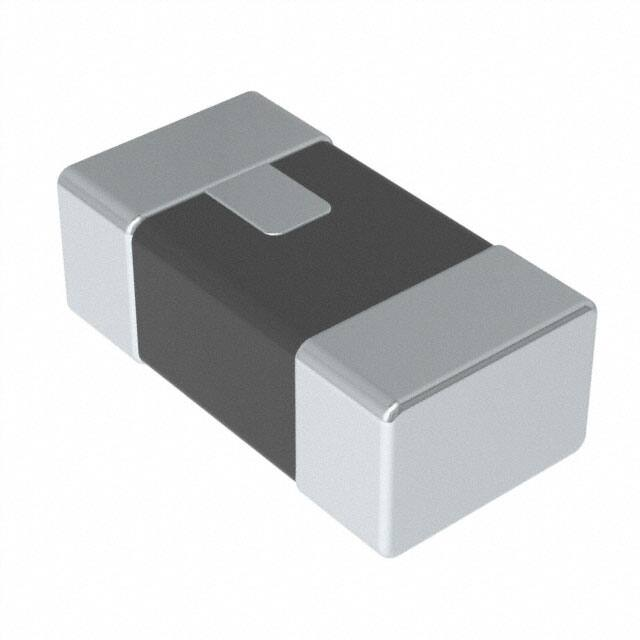

    固定电感器 0603 100nH ±5% 650mA 512.5mΩ 200MHz 8@25MHz
LQM18JNR10J00D 数据手册
Reference Only Spec No. JELF243B-0077-01 P.1/9 CHIP COIL (CHIP INDUCTOR) LQM18JN□□□□00D REFERENCE SPECIFICATION 1.Scope This reference specification applies to LQM18JN_00 series, Chip Coil (Chip Inductors). 2. Part Numbering (ex) LQ M 18 J N R16 Product ID Structure Dimension Applications Category (L×W) and Characteristics J 0 Inductance Tolerance Dimension (T) 0 D Other Packaging D:Taping *B:BULK *B:Bulk packing also available 3. Rating ・Operating Temperature Range ・Storage Temperature Range Customer Part Number – 40°C to + 85°C – 40°C to + 85°C MURATA Part Number Inductance [nH] Q (min.) LQM18JNR10J00D LQM18JNR12J00D LQM18JNR16J00D 100 +/-5% 120 +/-5% 160 +/-5% 8 8 8 Self resonant DC resistance frequency [ohm] [MHz] (min.) 0.41 +/-25% 0.47 +/-25% 0.60 +/-25% 200 150 100 Rated current [mA] 650 610 550 4. Testing Conditions 《Unless otherwise specified》 《In case of doubt》 Temperature : Ordinary Temperature / 15°C to 35°C Temperature : 20°C ± 2°C Humidity : Ordinary Humidity / 25%(RH) to 85%(RH) Humidity : 60%(RH) to 70%(RH) Atmospheric Pressure : 86kPa to 106kPa 5. Appearance and Dimensions ■Unit Mass (Typical value) 0.004g 0.4 ± 0.2 Polarity mark 0.32± 0.20 0.78± 0.20 0.5 5± 0.10 1.6 ± 0.15 0.80± 0.15 (in mm) MURATA MFG.CO., LTD Reference Only Spec No. JELF243B-0077-01 P.2/9 6. Electrical Performance No. 6.1 Item Inductance Specification Please refer to “3.Rating”. Test Method Measuring Equipment: Keysight 4294A or 6.2 Q (1mA) 6.3 DC Resistance Measuring Frequency: 25MHz Measuring Equipment: Digital multi meter equivalent Digital multi meter (TR6846 or equivalent) a terminal1 terminal2 SW b DC resistance shall be measured after putting chip coil between the terminal 2 under the condition of opening between a and b. Every measurement The terminal 1 shall be shorted with a and b are shorted when changing chip coil. 6.4 Self Resonant Frequency 6.5 Rated Current Measuring Equipment: Keysight 4991A or equivalent (1mA) (S.R.F) Self temperature rise shall be limited to 40°C max. The rated current is applied. 7. Mechanical Performance No. 7.1 Item Shear Test Specification Chip coil shall not be damaged after tested as follows. Test Method Applied Direction Chip Coil F Substrate Force: 10N Hold Duration: 5s Applied Direction: Parallel to PCB 7.2 Bending Test Appearance: No damage Substrate: Glass-epoxy substrate (100mm×40mm×1.0mm) Solder: Reflow Pressure jig R230 F Deflection 45 45 Product Speed of Applying Force: 0.5mm / s Deflection: 2mm Hold Duration: 20s MURATA MFG.CO., LTD (in mm) Reference Only Spec No. JELF243B-0077-01 No. Item 7.3 Vibration Specification Appearance: No damage 7.4 Solderability The wetting area of the electrode shall be at least 95% covered with new solder coating. 7.5 Resistance to Soldering Heat Appearance: No damage Inductance Change: within ±30% P.3/9 Test Method Oscillation Frequency: 10Hz to 2000Hz to 10Hz for 20 min Total amplitude 3.0 mm or Acceleration amplitude 245m/s2 whichever is smaller. Testing Time: A period of 2h in each of 3 mutually perpendicular directions. Flux: Ethanol solution of rosin 25(wt)% (Immersed for 5s to 10s) Solder: Sn-3.0Ag-0.5Cu Pre-Heating: 150°C±10°C / 60s to 90s Solder Temperature: 245°C±3°C Immersion Time: 3s Flux: Ethanol solution of rosin 25(wt)% (Immersed for 5s to 10s) Solder: Sn-3.0Ag-0.5Cu Pre-Heating: 150°C±10°C / 60s to 90s Solder Temperature: 260°C±5°C Immersion Time: 10s Then measured after exposure in the room condition for 24h±2h. 8. Environmental Performance It shall be soldered on the substrate. No. 8.1 Item Heat Resistance 8.2 Cold Resistance 8.3 Humidity 8.4 Temperature Cycle Specification Appearance: No damage Inductance Change: within ±20% Appearance: No damage Inductance Change: within ±50% Test Method Temperature: 85°C±2°C Time:1000h (+48h, -0h) Then measured after exposure in the room condition for 24h±2h. Temperature: - 40°C±2°C Time: 1000h (+48h, -0h) Then measured after exposure in the room condition for 24h±2h. Temperature: 70°C±2°C Humidity: 90%(RH) to 95%(RH) Time: 1000h (+48h, -0h) Then measured after exposure in the room condition for 24h±2h. 1 cycle: 1 step: - 40°C±2°C / 30 min±3 min 2 step: Ordinary temp. / 10 min to 15 min 3 step: 85°C±2°C / 30 min to 3 min 4 step: Ordinary temp. / 10 min to15 min Total of 100cycles Then measured after exposure in the room condition for 24h±2h. MURATA MFG.CO., LTD Reference Only Spec No. JELF243B-0077-01 9. Specification of Packaging P.4/9 1. 85±0. 1 3. 5 ± 0. 0 5 +0. 1 φ1. 5 -0 8. 0 ± 0. 3 2. 0 ±0. 05 4. 0 ±0. 1 4. 0 ±0. 1 1. 75 ±0. 1 9.1 Appearance and Dimensions (8mm-wide paper tape) a 1. 05 ±0. 1 Direct ion of feed a=0.85max (in mm) 9.2 Specification of Taping (1) Packing quantity (standard quantity) 4,000 pcs. / reel (2) Packing Method Products shall be packed in the cavity of the base tape and sealed by top tape and bottom tape. (3) Sprocket hole The sprocket holes are to the right as the tape is pulled toward the user. (4) Spliced point Base tape and Top tape has no spliced point. (5) Missing components number Missing components number within 0.1% of the number per reel or 1 pc., whichever is greater, and are not continuous. The specified quantity per reel is kept. 9.3 Pull Strength Top tape Bottom tape 5N min. 9.4 Peeling off force of top tape Speed of Peeling off Peeling off force 300mm/ min 0.1 to 0.6N (minimum value is typical) 165 to 180 degree F Top tape Bottom tape 9.5 Dimensions of Leader-tape, Trailer and Reel There shall be leader-tape (top tape and empty tape) and trailer-tape (empty tape) as follows. 2.0±0.5 Trailer 160 min. Leader Label 190 min. Empty tape 210 min. Top tape  13.0±0.2 +1  60 -0  21.0±0.8 9.0 +1 -0 Direction of feed 13.0±1.4 +0  180 -3 (in mm) MURATA MFG.CO., LTD Base tape Reference Only Spec No. JELF243B-0077-01 P.5/9 9.6 Marking for reel Customer part number, MURATA part number, Inspection number (1), RoHS Marking (2), Quantity etc ・・・ □□ OOOO  1) (1) (2) (3) (1) Factory Code (2) Date First digit : Year / Last digit of year Second digit : Month / Jan. to Sep.  1 to 9, Oct. to Dec.  O, N, D Third, Fourth digit : Day (3) Serial No. 2) ROHS – Y (△) (1) (2) (1) RoHS regulation conformity parts. (2) MURATA classification number 9.7 Marking for Outside package (corrugated paper box) Customer name, Purchasing order number, Customer part number, MURATA part number, RoHS Marking (2), Quantity, etc ・・・ 9.8. Specification of Outer Case Label H D W Outer Case Dimensions (mm) W D H 186 186 93 Standard Reel Quantity in Outer Case (Reel) 5   Above Outer Case size is typical. It depends on a quantity of an order. 10. ! Caution Limitation of Applications Please contact us before using our products for the applications listed below which require especially high reliability for the prevention of defects which might directly cause damage to the third party's life, body or property. (1) Aircraft equipment (6) Transportation equipment (vehicles, trains, ships, etc.) (2) Aerospace equipment (7) Traffic signal equipment (8) Disaster prevention / crime prevention equipment (3) Undersea equipment (4) Power plant control equipment (9) Data-processing equipment (10) Applications of similar complexity and /or reliability (5) Medical equipment requirements to the applications listed in the above 11. Notice This product is designed for solder mounting. Please consult us in advance for applying other mounting method such as conductive adhesive. 11.1 Land pattern designing Chip Coil c Land Solder Resist Soldering Flow Reflow a 0.7 b 2.2 to 2.6 1.8 to 2.0 c 0.7 (in mm) a b MURATA MFG.CO., LTD Reference Only Spec No. JELF243B-0077-01 11.2 Flux, Solder ・Use rosin-based flux. Don’t use highly acidic flux with halide content exceeding 0.2(wt)% (chlorine conversion value). Don’t use water-soluble flux. ・Use Sn-3.0Ag-0.5Cu solder. ・Standard thickness of solder paste: 100μm to 150μm. P.6/9 11.3 Reflow soldering conditions ・Products can be applied to reflow soldering. ・Pre-heating should be in such a way that the temperature difference between solder and product surface is limited to 150°C max. Cooling into solvent after soldering also should be in such a way that the temperature difference is limited to 100°C max. Insufficient pre-heating may cause cracks on the product, resulting in the deterioration of products quality. ・Standard soldering profile and the limit soldering profile is as follows. The excessive limit soldering conditions may cause leaching of the electrode and/or resulting in the deterioration of product quality. Reflow soldering profile (1) Flow soldering profile Temp. (℃) 265℃±3℃ 250℃ Limit Profile 150 Heating Time Time. (s) 60s min. Pre-heating Heating Cycle of flow Standard Profile Standard Profile Limit Profile 150℃, 60s min. 250℃, 4s~6s 265℃±3℃, 5s 2 times 2 times (2) Reflow soldering profile Temp. (℃) 260℃ 245℃±3℃ 220℃ 230℃ Limit Profile 180 150 Standard Profile 30s~60s 60s max. 90s±30s Pre-heating Heating Peak temperature Cycle of reflow Time. (s) Standard Profile Limit Profile 150°C~180°C, 90s±30s above 220°C, 30s~60s above 230°C, 60s max. 245°C±3°C 260°C,10s 2 times 2 times MURATA MFG.CO., LTD Reference Only Spec No. JELF243B-0077-01 11.4 Reworking with soldering iron The following conditions must be strictly followed when using a soldering iron. P.7/9 Pre-heating 150°C, approx 1 minute Tip temperature 350°C max. Soldering iron output 80W max. Tip diameter φ3mm max. Soldering time 3(+1, -0)s Time 2 times max Note : Do not directly touch the products with the tip of the soldering iron in order to prevent the crack on the products due to the thermal shock. 11.5 Solder Volume ・Solder shall be used not to be exceeded the upper limits as shown below. ・Accordingly increasing the solder volume, the mechanical stress to Chip is also increased. Exceeding solder volume may cause the failure of mechanical or electrical performance. Upper Limit Recommendable 1/3T≦t≦T T: thickness of electrode t 11.6 Product’s location The following shall be considered when designing and laying out P.C.B.'s. (1) P.C.B. shall be designed so that products are not subject to the mechanical stress due to warping the board. [Products direction] a b 〈 Poor example 〉 Products shall be located in the sideways direction (Length: a‹b) to the mechanical stress. 〈 Good example 〉 (2)Components location on P.C.B. separation. It is effective to implement the following measures, to reduce stress in separating the board. It is best to implement all of the following three measures; however, implement as many measures as possible to reduce stress. Contents of Measures (1) Turn the mounting direction of the component parallel to the board separation surface. (2) Add slits in the board separation part. (3) Keep the mounting position of the component away from the board separation surface. Perforation Stress Level A > D *1 A > B A > C C B D A Slit *1 A > D is valid when stress is added vertically to the perforation as with Hand Separation. If a Cutting Disc is used, stress will be diagonal to the PCB, therefore A > D is invalid. (3) Mounting Components Near Screw Holes When a component is mounted near a screw hole, it may be affected by the board deflection that occurs during the tightening of the screw. Mount the component in a position as far away from the screw holes as possible. Screw Hole Recommend MURATA MFG.CO., LTD Reference Only Spec No. JELF243B-0077-01 11.7 Cleaning Conditions Products shall be cleaned on the following conditions. P.8/9 (1) Cleaning temperature shall be limited to 60°C max. (40°C max for IPA.) (2) Ultrasonic cleaning shall comply with the following conditions with avoiding the resonance phenomenon at the mounted products and P.C.B. Power : 20 W / l max. Frequency : 28kHz to 40kHz Time : 5 min max. (3) Cleaner 1. Alcohol type cleaner Isopropyl alcohol (IPA) 2. Aqueous agent PINE ALPHA ST-100S (4) There shall be no residual flux and residual cleaner after cleaning. In the case of using aqueous agent, products shall be dried completely after rinse with de-ionized water in order to remove the cleaner. (5) Other cleaning Please contact us. 11.8 Resin coating The inductance value may change and/or it may affect on the product's performance due to high cure-stress of resin to be used for coating/molding products. So please pay your careful attention when you select resin. In prior to use, please make the reliability evaluation with the product mounted in your application set. 11.9 Caution for use There is possibility that the inductance value change due to magnetism. Don‘t use a magnet or a pair of tweezers with magnetism when chip coil are handled. (The tip of the tweezers should be molded with resin or pottery.) 11.10 Magnetic Saturation When the excessive current over rated current is applied, the inductance value may change due to magnetism. 11.11 Handling of a substrate After mounting products on a substrate, do not apply any stress to the product caused by bending or twisting to the substrate when cropping the substrate, inserting and removing a connector from the substrate or tightening screw to the substrate. Excessive mechanical stress may cause cracking in the product. Bending Twisting 11.12 Storage and Handing Requirements (1) Storage period Use the products within 6 months after delivered. Solderability should be checked if this period is exceeded. (2) Storage conditions ・Products should be stored in the warehouse on the following conditions. Temperature : -10°C to 40°C Humidity : 15% to 85% relative humidity No rapid change on temperature and humidity Don't keep products in corrosive gases such as sulfur, chlorine gas or acid, or it may cause oxidization of electrode, resulting in poor solderability. ・Products should be stored on the palette for the prevention of the influence from humidity, dust and so on. ・Products should be stored in the warehouse without heat shock, vibration, direct sunlight and so on. ・Products should be stored under the airtight packaged condition. (3) Handling Condition Care should be taken when transporting or handling product to avoid excessive vibration or mechanical shock. MURATA MFG.CO., LTD Reference Only Spec No. JELF243B-0077-01 P.9/9 12. ! Note (1) Please make sure that your product has been evaluated in view of your specifications with our product being mounted to your product. (2) You are requested not to use our product deviating from the reference specifications. (3) The contents of this reference specification are subject to change without advance notice. Please approve our product specifications or transact the approval sheet for product specifications before ordering. MURATA MFG.CO., LTD
