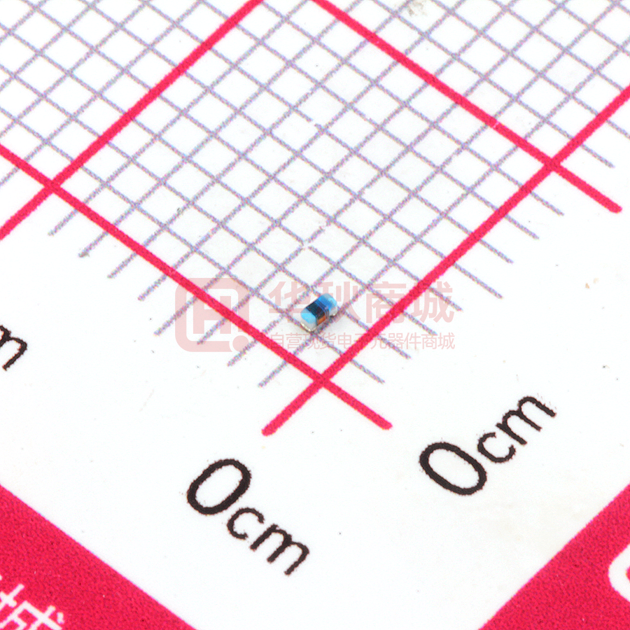

    高频电感 1.82Ω 62nH ±2% 145mA 2.6GHz 0.50mm 1.00 x 0.60mm 0402
LQW15AN62NG00D 数据手册
Spec No.: JELF243A_0050AC-01 P1/15 CHIP COILS (CHIP INDUCTORS) LQW15AN□□□□00□ REFERENCE SPECIFICATION 1. Scope This reference specification applies to chip coils (chip inductors) LQW15AN_00 series for general electronic equipment. 2. Part Numbering (Ex.) LQ W 15 Product Structure Dimension ID (L × W) A N 1N5 B 0 0 Application Category Inductance Tolerance Performance Electrode and specification characteristic *B: Bulk packing is also available (taping condition: however, products without reels are put in plastic bags). D Packaging D: taping *B: bulk 3. Part Number and Rating Operating temperature range Storage temperature range -55°C to +125°C -55°C to +125°C Inductance Customer Part number Tolerance Q (Min.) DC resistance (Ω max.) Self-resonant frequency (GHz min.) Rated current (mA) 1.5 B: ±0.1 nH 10 0.03 18.0 1000 LQW15AN1N5C00D 1.5 C: ±0.2 nH 10 0.03 18.0 1000 LQW15AN1N5D00D 1.5 D: ±0.5 nH 10 0.03 18.0 1000 LQW15AN1N6C00D 1.6 C: ±0.2 nH 10 0.07 17.0 750 LQW15AN1N6D00D 1.6 D: ±0.5 nH 10 0.07 17.0 750 LQW15AN1N7C00D 1.7 C: ±0.2 nH 10 0.10 17.0 640 LQW15AN1N7D00D 1.7 D: ±0.5 nH 10 0.10 17.0 640 LQW15AN1N8C00D 1.8 C: ±0.2 nH 10 0.16 16.0 460 LQW15AN1N8D00D 1.8 D: ±0.5 nH 10 0.16 16.0 460 LQW15AN2N4B00D 2.4 B: ±0.1 nH 20 0.05 15.0 850 LQW15AN2N4C00D 2.4 C: ±0.2 nH 20 0.05 15.0 850 LQW15AN2N4D00D 2.4 D: ±0.5 nH 20 0.05 15.0 850 Murata Part number Nominal value (nH) LQW15AN1N5B00D LQW15AN2N5B00D 2.5 B: ±0.1 nH 20 0.05 15.0 850 LQW15AN2N5C00D 2.5 C: ±0.2 nH 20 0.05 15.0 850 LQW15AN2N5D00D 2.5 D: ±0.5 nH 20 0.05 15.0 850 LQW15AN2N6B00D 2.6 B: ±0.1 nH 20 0.05 15.0 850 LQW15AN2N6C00D 2.6 C: ±0.2 nH 20 0.05 15.0 850 LQW15AN2N6D00D 2.6 D: ±0.5 nH 20 0.05 15.0 850 LQW15AN2N7B00D 2.7 B: ±0.1 nH 20 0.05 15.0 850 LQW15AN2N7C00D 2.7 C: ±0.2 nH 20 0.05 15.0 850 LQW15AN2N7D00D 2.7 D: ±0.5 nH 20 0.05 15.0 850 LQW15AN2N8B00D 2.8 B: ±0.1 nH 20 0.05 15.0 850 LQW15AN2N8C00D 2.8 C: ±0.2 nH 20 0.05 15.0 850 LQW15AN2N8D00D 2.8 D: ±0.5 nH 20 0.05 15.0 850 LQW15AN2N9B00D 2.9 B: ±0.1 nH 20 0.07 15.0 750 LQW15AN2N9C00D 2.9 C: ±0.2 nH 20 0.07 15.0 750 LQW15AN2N9D00D 2.9 D: ±0.5 nH 20 0.07 15.0 750 LQW15AN3N0B00D 3.0 B: ±0.1 nH 20 0.07 15.0 750 LQW15AN3N0C00D 3.0 C: ±0.2 nH 20 0.07 15.0 750 LQW15AN3N0D00D 3.0 D: ±0.5 nH 20 0.07 15.0 750 LQW15AN3N1B00D 3.1 B: ±0.1 nH 20 0.13 14.0 570 MURATA MFG CO., LTD Spec No.: JELF243A_0050AC-01 P2/15 Inductance Customer Part number Tolerance Q (Min.) DC resistance (Ω max.) Self-resonant frequency (GHz min.) Rated current (mA) 3.1 C: ±0.2 nH 20 0.13 14.0 570 3.1 D: ±0.5 nH 20 0.13 14.0 570 Murata Part number Nominal value (nH) LQW15AN3N1C00D LQW15AN3N1D00D LQW15AN3N2B00D 3.2 B: ±0.1 nH 15 0.17 14.0 500 LQW15AN3N2C00D 3.2 C: ±0.2 nH 15 0.17 14.0 500 LQW15AN3N2D00D 3.2 D: ±0.5 nH 15 0.17 14.0 500 LQW15AN3N9B00D 3.9 B: ±0.1 nH 25 0.07 10.0 750 LQW15AN3N9C00D 3.9 C: ±0.2 nH 25 0.07 10.0 750 LQW15AN3N9D00D 3.9 D: ±0.5 nH 25 0.07 10.0 750 LQW15AN4N1B00D 4.1 B: ±0.1 nH 25 0.07 10.0 750 LQW15AN4N1C00D 4.1 C: ±0.2 nH 25 0.07 10.0 750 LQW15AN4N1D00D 4.1 D: ±0.5 nH 25 0.07 10.0 750 LQW15AN4N3B00D 4.3 B: ±0.1 nH 25 0.07 10.0 750 LQW15AN4N3C00D 4.3 C: ±0.2 nH 25 0.07 10.0 750 LQW15AN4N3D00D 4.3 D: ±0.5 nH 25 0.07 10.0 750 LQW15AN4N4B00D 4.4 B: ±0.1 nH 25 0.07 8.0 750 LQW15AN4N4C00D 4.4 C: ±0.2 nH 25 0.07 8.0 750 LQW15AN4N4D00D 4.4 D: ±0.5 nH 25 0.07 8.0 750 LQW15AN4N5B00D 4.5 B: ±0.1 nH 25 0.07 8.0 750 LQW15AN4N5C00D 4.5 C: ±0.2 nH 25 0.07 8.0 750 LQW15AN4N5D00D 4.5 D: ±0.5 nH 25 0.07 8.0 750 LQW15AN4N6B00D 4.6 B: ±0.1 nH 25 0.07 8.0 750 LQW15AN4N6C00D 4.6 C: ±0.2 nH 25 0.07 8.0 750 LQW15AN4N6D00D 4.6 D: ±0.5 nH 25 0.07 8.0 750 LQW15AN4N7B00D 4.7 B: ±0.1 nH 25 0.07 8.0 750 LQW15AN4N7C00D 4.7 C: ±0.2 nH 25 0.07 8.0 750 LQW15AN4N7D00D 4.7 D: ±0.5 nH 25 0.07 8.0 750 LQW15AN4N8B00D 4.8 B: ±0.1 nH 25 0.07 8.0 750 LQW15AN4N8C00D 4.8 C: ±0.2 nH 25 0.07 8.0 750 LQW15AN4N8D00D 4.8 D: ±0.5 nH 25 0.07 8.0 750 LQW15AN4N9B00D 4.9 B: ±0.1 nH 25 0.12 8.0 600 LQW15AN4N9C00D 4.9 C: ±0.2 nH 25 0.12 8.0 600 LQW15AN4N9D00D 4.9 D: ±0.5 nH 25 0.12 8.0 600 LQW15AN5N0B00D 5.0 B: ±0.1 nH 25 0.12 8.0 600 LQW15AN5N0C00D 5.0 C: ±0.2 nH 25 0.12 8.0 600 LQW15AN5N0D00D 5.0 D: ±0.5 nH 25 0.12 8.0 600 LQW15AN5N1B00D 5.1 B: ±0.1 nH 25 0.12 8.0 600 LQW15AN5N1C00D 5.1 C: ±0.2 nH 25 0.12 8.0 600 LQW15AN5N1D00D 5.1 D: ±0.5 nH 25 0.12 8.0 600 LQW15AN5N8B00D 5.8 B: ±0.1 nH 25 0.09 8.0 700 LQW15AN5N8C00D 5.8 C: ±0.2 nH 25 0.09 8.0 700 LQW15AN5N8D00D 5.8 D: ±0.5 nH 25 0.09 8.0 700 LQW15AN6N2B00D 6.2 B: ±0.1 nH 25 0.09 8.0 700 LQW15AN6N2C00D 6.2 C: ±0.2 nH 25 0.09 8.0 700 LQW15AN6N2D00D 6.2 D: ±0.5 nH 25 0.09 8.0 700 LQW15AN6N3B00D 6.3 B: ±0.1 nH 25 0.09 6.0 700 LQW15AN6N3C00D 6.3 C: ±0.2 nH 25 0.09 6.0 700 MURATA MFG CO., LTD Spec No.: JELF243A_0050AC-01 P3/15 Inductance Customer Part number Tolerance Q (Min.) DC resistance (Ω max.) Self-resonant frequency (GHz min.) Rated current (mA) 6.3 D: ±0.5 nH 25 0.09 6.0 700 LQW15AN6N4B00D 6.4 B: ±0.1 nH 25 0.09 6.0 700 LQW15AN6N4C00D 6.4 C: ±0.2 nH 25 0.09 6.0 700 LQW15AN6N4D00D 6.4 D: ±0.5 nH 25 0.09 6.0 700 Murata Part number Nominal value (nH) LQW15AN6N3D00D LQW15AN6N5B00D 6.5 B: ±0.1 nH 25 0.09 6.0 700 LQW15AN6N5C00D 6.5 C: ±0.2 nH 25 0.09 6.0 700 LQW15AN6N5D00D 6.5 D: ±0.5 nH 25 0.09 6.0 700 LQW15AN6N6B00D 6.6 B: ±0.1 nH 25 0.09 6.0 700 LQW15AN6N6C00D 6.6 C: ±0.2 nH 25 0.09 6.0 700 LQW15AN6N6D00D 6.6 D: ±0.5 nH 25 0.09 6.0 700 LQW15AN6N7B00D 6.7 B: ±0.1 nH 25 0.09 6.0 700 LQW15AN6N7C00D 6.7 C: ±0.2 nH 25 0.09 6.0 700 LQW15AN6N7D00D 6.7 D: ±0.5 nH 25 0.09 6.0 700 LQW15AN6N8G00D 6.8 G: ±2% 25 0.09 6.0 700 LQW15AN6N8H00D 6.8 H: ±3% 25 0.09 6.0 700 LQW15AN6N8J00D 6.8 J: ±5% 25 0.09 6.0 700 LQW15AN6N9G00D 6.9 G: ±2% 25 0.13 6.0 570 LQW15AN6N9H00D 6.9 H: ±3% 25 0.13 6.0 570 LQW15AN6N9J00D 6.9 J: ±5% 25 0.13 6.0 570 LQW15AN7N0G00D 7.0 G: ±2% 25 0.13 6.0 570 LQW15AN7N0H00D 7.0 H: ±3% 25 0.13 6.0 570 LQW15AN7N0J00D 7.0 J: ±5% 25 0.13 6.0 570 LQW15AN7N1G00D 7.1 G: ±2% 25 0.13 6.0 570 LQW15AN7N1H00D 7.1 H: ±3% 25 0.13 6.0 570 LQW15AN7N1J00D 7.1 J: ±5% 25 0.13 6.0 570 LQW15AN7N2G00D 7.2 G: ±2% 25 0.13 6.0 570 LQW15AN7N2H00D 7.2 H: ±3% 25 0.13 6.0 570 LQW15AN7N2J00D 7.2 J: ±5% 25 0.13 6.0 570 LQW15AN7N3G00D 7.3 G: ±2% 25 0.13 6.0 570 LQW15AN7N3H00D 7.3 H: ±3% 25 0.13 6.0 570 LQW15AN7N3J00D 7.3 J: ±5% 25 0.13 6.0 570 LQW15AN7N5G00D 7.5 G: ±2% 25 0.13 6.0 570 LQW15AN7N5H00D 7.5 H: ±3% 25 0.13 6.0 570 LQW15AN7N5J00D 7.5 J: ±5% 25 0.13 6.0 570 LQW15AN8N2G00D 8.2 G: ±2% 25 0.14 5.5 540 LQW15AN8N2H00D 8.2 H: ±3% 25 0.14 5.5 540 LQW15AN8N2J00D 8.2 J: ±5% 25 0.14 5.5 540 LQW15AN8N6G00D 8.6 G: ±2% 25 0.14 5.5 540 LQW15AN8N6H00D 8.6 H: ±3% 25 0.14 5.5 540 LQW15AN8N6J00D 8.6 J: ±5% 25 0.14 5.5 540 LQW15AN8N7G00D 8.7 G: ±2% 25 0.14 5.5 540 LQW15AN8N7H00D 8.7 H: ±3% 25 0.14 5.5 540 LQW15AN8N7J00D 8.7 J: ±5% 25 0.14 5.5 540 LQW15AN8N8G00D 8.8 G: ±2% 25 0.14 5.5 540 LQW15AN8N8H00D 8.8 H: ±3% 25 0.14 5.5 540 LQW15AN8N8J00D 8.8 J: ±5% 25 0.14 5.5 540 MURATA MFG CO., LTD Spec No.: JELF243A_0050AC-01 P4/15 Inductance Customer Part number Tolerance Q (Min.) DC resistance (Ω max.) Self-resonant frequency (GHz min.) Rated current (mA) 8.9 G: ±2% 25 0.14 5.5 540 8.9 H: ±3% 25 0.14 5.5 540 Murata Part number Nominal value (nH) LQW15AN8N9G00D LQW15AN8N9H00D LQW15AN8N9J00D 8.9 J: ±5% 25 0.14 5.5 540 LQW15AN9N0G00D 9.0 G: ±2% 25 0.14 5.5 540 LQW15AN9N0H00D 9.0 H: ±3% 25 0.14 5.5 540 LQW15AN9N0J00D 9.0 J: ±5% 25 0.14 5.5 540 LQW15AN9N1G00D 9.1 G: ±2% 25 0.14 5.5 540 LQW15AN9N1H00D 9.1 H: ±3% 25 0.14 5.5 540 LQW15AN9N1J00D 9.1 J: ±5% 25 0.14 5.5 540 LQW15AN9N2G00D 9.2 G: ±2% 25 0.14 5.5 540 LQW15AN9N2H00D 9.2 H: ±3% 25 0.14 5.5 540 LQW15AN9N2J00D 9.2 J: ±5% 25 0.14 5.5 540 LQW15AN9N3G00D 9.3 G: ±2% 25 0.14 5.5 540 LQW15AN9N3H00D 9.3 H: ±3% 25 0.14 5.5 540 LQW15AN9N3J00D 9.3 J: ±5% 25 0.14 5.5 540 LQW15AN9N4G00D 9.4 G: ±2% 25 0.14 5.5 540 LQW15AN9N4H00D 9.4 H: ±3% 25 0.14 5.5 540 LQW15AN9N4J00D 9.4 J: ±5% 25 0.14 5.5 540 LQW15AN9N5G00D 9.5 G: ±2% 25 0.14 5.5 540 LQW15AN9N5H00D 9.5 H: ±3% 25 0.14 5.5 540 LQW15AN9N5J00D 9.5 J: ±5% 25 0.14 5.5 540 LQW15AN9N6G00D 9.6 G: ±2% 25 0.14 5.5 540 LQW15AN9N6H00D 9.6 H: ±3% 25 0.14 5.5 540 LQW15AN9N6J00D 9.6 J: ±5% 25 0.14 5.5 540 LQW15AN9N7G00D 9.7 G: ±2% 25 0.14 5.5 540 LQW15AN9N7H00D 9.7 H: ±3% 25 0.14 5.5 540 LQW15AN9N7J00D 9.7 J: ±5% 25 0.14 5.5 540 LQW15AN9N8G00D 9.8 G: ±2% 25 0.14 5.5 540 LQW15AN9N8H00D 9.8 H: ±3% 25 0.14 5.5 540 LQW15AN9N8J00D 9.8 J: ±5% 25 0.14 5.5 540 LQW15AN9N9G00D 9.9 G: ±2% 25 0.14 5.5 540 LQW15AN9N9H00D 9.9 H: ±3% 25 0.14 5.5 540 LQW15AN9N9J00D 9.9 J: ±5% 25 0.14 5.5 540 LQW15AN10NG00D 10 G: ±2% 25 0.17 5.5 500 LQW15AN10NH00D 10 H: ±3% 25 0.17 5.5 500 LQW15AN10NJ00D 10 J: ±5% 25 0.17 5.5 500 LQW15AN11NG00D 11 G: ±2% 30 0.14 5.5 500 LQW15AN11NH00D 11 H: ±3% 30 0.14 5.5 500 LQW15AN11NJ00D 11 J: ±5% 30 0.14 5.5 500 LQW15AN12NG00D 12 G: ±2% 30 0.14 5.5 500 LQW15AN12NH00D 12 H: ±3% 30 0.14 5.5 500 LQW15AN12NJ00D 12 J: ±5% 30 0.14 5.5 500 LQW15AN13NG00D 13 G: ±2% 25 0.21 5.0 430 LQW15AN13NH00D 13 H: ±3% 25 0.21 5.0 430 LQW15AN13NJ00D 13 J: ±5% 25 0.21 5.0 430 LQW15AN15NG00D 15 G: ±2% 30 0.16 5.0 460 MURATA MFG CO., LTD Spec No.: JELF243A_0050AC-01 P5/15 Inductance Customer Part number Tolerance Q (Min.) DC resistance (Ω max.) Self-resonant frequency (GHz min.) Rated current (mA) 15 H: ±3% 30 0.16 5.0 460 LQW15AN15NJ00D 15 J: ±5% 30 0.16 5.0 460 LQW15AN16NG00D 16 G: ±2% 25 0.24 4.5 370 LQW15AN16NH00D 16 H: ±3% 25 0.24 4.5 370 Murata Part number Nominal value (nH) LQW15AN15NH00D LQW15AN16NJ00D 16 J: ±5% 25 0.24 4.5 370 LQW15AN18NG00D 18 G: ±2% 25 0.27 4.5 370 LQW15AN18NH00D 18 H: ±3% 25 0.27 4.5 370 LQW15AN18NJ00D 18 J: ±5% 25 0.27 4.5 370 LQW15AN19NG00D 19 G: ±2% 25 0.27 4.5 370 LQW15AN19NH00D 19 H: ±3% 25 0.27 4.5 370 LQW15AN19NJ00D 19 J: ±5% 25 0.27 4.5 370 LQW15AN20NG00D 20 G: ±2% 25 0.27 4.0 370 LQW15AN20NH00D 20 H: ±3% 25 0.27 4.0 370 LQW15AN20NJ00D 20 J: ±5% 25 0.27 4.0 370 LQW15AN22NG00D 22 G: ±2% 25 0.30 4.0 310 LQW15AN22NH00D 22 H: ±3% 25 0.30 4.0 310 LQW15AN22NJ00D 22 J: ±5% 25 0.30 4.0 310 LQW15AN23NG00D 23 G: ±2% 25 0.30 3.8 310 LQW15AN23NH00D 23 H: ±3% 25 0.30 3.8 310 LQW15AN23NJ00D 23 J: ±5% 25 0.30 3.8 310 LQW15AN24NG00D 24 G: ±2% 25 0.52 3.5 280 LQW15AN24NH00D 24 H: ±3% 25 0.52 3.5 280 LQW15AN24NJ00D 24 J: ±5% 25 0.52 3.5 280 LQW15AN27NG00D 27 G: ±2% 25 0.52 3.5 280 LQW15AN27NH00D 27 H: ±3% 25 0.52 3.5 280 LQW15AN27NJ00D 27 J: ±5% 25 0.52 3.5 280 LQW15AN30NG00D 30 G: ±2% 25 0.58 3.3 270 LQW15AN30NH00D 30 H: ±3% 25 0.58 3.3 270 LQW15AN30NJ00D 30 J: ±5% 25 0.58 3.3 270 LQW15AN33NG00D 33 G: ±2% 25 0.63 3.2 260 LQW15AN33NH00D 33 H: ±3% 25 0.63 3.2 260 LQW15AN33NJ00D 33 J: ±5% 25 0.63 3.2 260 LQW15AN36NG00D 36 G: ±2% 25 0.63 3.1 260 LQW15AN36NH00D 36 H: ±3% 25 0.63 3.1 260 LQW15AN36NJ00D 36 J: ±5% 25 0.63 3.1 260 LQW15AN39NG00D 39 G: ±2% 25 0.70 3.0 250 LQW15AN39NH00D 39 H: ±3% 25 0.70 3.0 250 LQW15AN39NJ00D 39 J: ±5% 25 0.70 3.0 250 LQW15AN40NG00D 40 G: ±2% 25 0.70 3.0 250 LQW15AN40NH00D 40 H: ±3% 25 0.70 3.0 250 LQW15AN40NJ00D 40 J: ±5% 25 0.70 3.0 250 LQW15AN43NG00D 43 G: ±2% 25 0.70 3.0 250 LQW15AN43NH00D 43 H: ±3% 25 0.70 3.0 250 LQW15AN43NJ00D 43 J: ±5% 25 0.70 3.0 250 LQW15AN47NG00D 47 G: ±2% 25 1.08 2.9 210 LQW15AN47NH00D 47 H: ±3% 25 1.08 2.9 210 MURATA MFG CO., LTD Spec No.: JELF243A_0050AC-01 P6/15 Inductance Tolerance Q (Min.) DC resistance (Ω max.) Self-resonant frequency (GHz min.) Rated current (mA) 47 J: ±5% 25 1.08 2.9 210 51 G: ±2% 25 1.08 2.85 210 LQW15AN51NH00D 51 H: ±3% 25 1.08 2.85 210 LQW15AN51NJ00D 51 J: ±5% 25 1.08 2.85 210 LQW15AN56NG00D 56 G: ±2% 25 1.17 2.8 200 LQW15AN56NH00D 56 H: ±3% 25 1.17 2.8 200 LQW15AN56NJ00D 56 J: ±5% 25 1.17 2.8 200 LQW15AN62NG00D 62 G: ±2% 20 1.82 2.6 145 LQW15AN62NH00D 62 H: ±3% 20 1.82 2.6 145 LQW15AN62NJ00D 62 J: ±5% 20 1.82 2.6 145 LQW15AN68NG00D 68 G: ±2% 20 1.96 2.5 140 LQW15AN68NJ00D 68 J: ±5% 20 1.96 2.5 140 LQW15AN72NG00D 72 G: ±2% 20 2.10 2.5 135 LQW15AN72NJ00D 72 J: ±5% 20 2.10 2.5 135 LQW15AN75NG00D 75 G: ±2% 20 2.10 2.4 135 LQW15AN75NJ00D 75 J: ±5% 20 2.10 2.4 135 LQW15AN82NG00D 82 G: ±2% 20 2.24 2.3 130 LQW15AN82NJ00D 82 J: ±5% 20 2.24 2.3 130 LQW15AN91NG00D 91 G: ±2% 20 2.38 2.1 125 LQW15AN91NJ00D 91 J: ±5% 20 2.38 2.1 125 LQW15ANR10J00D 100 J: ±5% 20 2.52 1.5 120 LQW15ANR12J00D 120 J: ±5% 20 2.66 1.0 110 Customer Part number Murata Part number Nominal value (nH) LQW15AN47NJ00D LQW15AN51NG00D 4. Testing Conditions Unless otherwise specified Temperature: ordinary temperature (15°C to 35°C) Humidity: ordinary humidity [25% to 85% (RH)] In case of doubt Temperature: 20°C±2°C Humidity: 60% to 70% (RH) Atmospheric pressure: 86 kPa to 106 kPa 5. Appearance and Dimensions Unit mass (typical value): 0.0008 g 6. Marking No marking. MURATA MFG CO., LTD Spec No.: JELF243A_0050AC-01 P7/15 7. Electrical Performance No. Item 7.1 Inductance Specification Meet chapter 3 ratings. Test method Measuring equipment: Keysight E4991A or the equivalent Measuring frequency: Inductance 100 MHz Q 250 MHz 1.5 nH to 43 nH 200 MHz 47 nH to 68 nH 7.2 Q 150 MHz 72 nH to 120 nH Measuring conditions: Measurement signal level: Approx. 0 dBm Measurement terminal distance: 0.5 mm Electrical length: 10.0 mm Measuring fixture: Keysight 16197A Position the chip coil under test as shown in the measuring example below and connect it to the electrode by applying weight. Measurement example: Meet chapter 3 ratings. Measuring method: see "Electrical performance: Measuring method for inductance/Q" in the chapter "16. Appendix". 7.3 DC resistance Meet chapter 3 ratings. Measuring equipment: digital multimeter 7.4 Self-resonant frequency Meet chapter 3 ratings. Measuring equipment: Keysight N5230A or the equivalent 7.5 Rated current Product temperature rise: 20°C max. Apply the rated current specified in chapter 3. 8. Mechanical Performance No. 8.1 Item Shear test Specification Test method No significant mechanical damage or no Test substrate: glass-epoxy substrate sign of electrode peeling off shall be Force application direction: observed. Applying force: 5 N Holding time: 5 s±1 s MURATA MFG CO., LTD Spec No.: JELF243A_0050AC-01 No. P8/15 Item Specification Test method 8.2 Bending test No significant mechanical damage or no Test substrate: glass-epoxy substrate (100 mm × 40 sign of electrode peeling off shall be mm × 0.8 mm) observed. Pressurizing speed: 1 mm/s Deflection: 2 mm Holding time: 5 s 8.3 Vibration Appearance shall have no significant mechanical damage. 8.4 Solderability 90% or more of the outer electrode shall Flux: immersed in ethanol solution [including an be covered with new solder seamlessly. activator with a chlorine conversion value of 0.06(wt)%] with a rosin content of 25(wt)% for 5 s to 10 s. Solder: Sn-3.0Ag-0.5Cu solder Pre-heating: 150°C±10°C/60 s to 90 s Solder temperature: 240°C±5°C Immersion time: 3 s±1 s 8.5 Resistance to soldering heat Appearance: No significant mechanical damage shall be observed. Inductance change rate: within ±5% Oscillation frequency: 10 Hz to 55 Hz to 10 Hz, for approx. 1 min Total amplitude: 1.5 mm Test time: 3 directions perpendicular to each other, 2 h for each direction (6 h in total) Flux: immersed in ethanol solution [including an activator with a chlorine conversion value of 0.06(wt)%] with a rosin content of 25(wt)% for 5 s to 10 s. Solder: Sn-3.0Ag-0.5Cu solder Pre-heating: 150°C±10°C/60 s to 90 s Solder temperature: 270°C±5°C Immersion time: 10 s±1 s Post-treatment: left at a room condition for 24 h±2 h 9. Environmental Performance The product is soldered on a substrate for test. No. Item Specification Test method 9.1 Heat resistance Appearance: No significant mechanical damage shall be observed. Inductance change rate: within ±5% Q change rate: within ±20% Temperature: 125°C±2°C Test time: 1000 h (+48 h, -0 h) Post-treatment: left at a room condition for 24 h±2 h 9.2 Cold resistance Appearance: No significant mechanical damage shall be observed. Inductance change rate: within ±5% Q change rate: within ±20% Temperature: -55°C±2°C Test time: 1000 h (+48 h, -0 h) Post-treatment: left at a room condition for 24 h±2 h 9.3 Humidity Appearance: No significant mechanical damage shall be observed. Inductance change rate: within ±5% Q change rate: within ±20% Temperature: 70°C±2°C Humidity: 90% (RH) to 95% (RH) Test time: 1000 h (+48 h, -0 h) Post-treatment: left at a room condition for 24 h±2 h 9.4 Temperature cycle Appearance: No significant mechanical damage shall be observed. Inductance change rate: within ±5% Q change rate: within ±20% Single cycle conditions: Step 1: -55°C±2°C/30 min±3 min Step 2: ordinary temperature/10 min to 15 min Step 3: +125°C±2°C/30 min±3 min Step 4: ordinary temperature/10 min to 15 min Number of testing: 10 cycles Post-treatment: left at a room condition for 24 h±2 h MURATA MFG CO., LTD Spec No.: JELF243A_0050AC-01 P9/15 10. Specification of Packaging 10.1 Appearance and dimensions of tape (8 mm width/paper tape) (in mm) A* (mm) B* (mm) (Dimensional tolerance ±0.03) (Dimensional tolerance ±0.03) 1N5, 2N4 to 2N8, 3N9 to 4N8, 5N8 to 6N8, 8N2 to 9N9, 11N, 12N, 15N 0.69 1.18 1N6 to 1N8, 2N9, 3N0, 3N1, 3N2, 4N9 to 5N1, 6N9 to 7N5, 10N, 13N, 16N to 23N, R10, R12 0.66 1.18 0.64 1.18 Inductance 24N to 91N *Typical value 10.2 Taping specifications Packing quantity (Standard quantity) 10000 pcs/reel Packing method The products are placed in embossed cavities of a base tape and sealed by a cover tape. Feed hole position The feed holes on the base tape are on the right side when the cover tape is pulled toward the user. Joint The base tape and the cover tape are seamless. Number of missing products Number of missing products within 0.025% of the number per reel or 1 pc., whichever is greater, and are not continuous. The specified quantity per reel is kept. 10.3 Break down force of tape Break down force of cover tape 5 N min. 10.4 Peeling off force of cover tape Speed of peeling off Peeling off force 165°to 180゜ 300 mm/min 0.1 N to 0.6 N (The lower limit is for typical value.) F Cover tape Base tape MURATA MFG CO., LTD Spec No.: JELF243A_0050AC-01 P10/15 10.5 Dimensions of leader section, trailer section and reel A vacant section is provided in the leader (start) section and trailer (end) section of the tape for the product. The leader section is further provided with an area consisting only of the cover tape (or top tape). (See the diagram below.) 10.6 Marking for reel Customer part number, Murata part number, inspection number (*1), RoHS marking (*2), quantity, etc. *1 Expression of inspection No.: (1) Factory code  □□ ○○○○ (2) Date First digit: year/last digit of year (1) (2) (3) Second digit: month/Jan. to Sep.→1 to 9, Oct. to Dec.→O, N, D Third, Fourth digit: day (3) Serial No. *2 Expression of RoHS marking: (1) RoHS regulation conformity ROHSY () (2) Murata classification number (1) (2) 10.7 Marking on outer box (corrugated box) Customer name, purchasing order number, customer part number, Murata part number, RoHS marking (*2), quantity, etc. 10.8 Specification of outer box Label H D W Dimensions of outer box (mm) W D H 186 186 93 Standard reel quantity in outer box (reel) 5 * Above outer box size is typical. It depends on a quantity of an order. MURATA MFG CO., LTD Spec No.: JELF243A_0050AC-01 11. P11/15 Caution 11.1 Restricted applications Please contact us before using our products for the applications listed below which require especially high reliability for the prevention of defects which might directly cause damage to the third party's life, body or property. (1) Aircraft equipment (2) Aerospace equipment (3) Undersea (4) Power plant control equipment equipment (5) Medical equipment (6) Transportation equipment (vehicles, (7) Traffic signal (8) Disaster/crime trains, ships, etc.) equipment prevention equipment (9) Data-processing (10) Applications of similar complexity and/or reliability equipment requirements to the applications listed in the above 11.2 Precautions on rating Avoid using in exceeded the rated temperature range, rated voltage, or rated current. Usage when the ratings are exceeded could lead to wire breakage, burning, or other serious fault. 11.3 Inrush current If an inrush current (or pulse current or rush current) that significantly exceeds the rated current is applied to the product, overheating could occur, resulting in wire breakage, burning, or other serious fault. 11.4 Corrosive gas Please refrain from use since contact with environments with corrosive gases (sulfur gas [hydrogen sulfide, sulfur dioxide, etc.], chlorine, ammonia, etc.) or oils (cutting oil, silicone oil, etc.) that have come into contact with the previously stated corrosive gas environment will result in deterioration of product quality or an open from deterioration due to corrosion of product electrode, etc. We will not bear any responsibility for use under these environments. 12. Precautions for Use This product is for use only with reflow soldering. It is designed to be mounted by soldering. If you want to use other mounting method, for example, using a conductive adhesive, please consult us beforehand. Also, if repeatedly subjected to temperature cycles or other thermal stress, due to the difference in the coefficient of thermal expansion with the mounting substrate, the solder (solder fillet part) in the mounting part may crack. The occurrence of cracks due to thermal stress is affected by the size of the land where mounted, the solder volume, and the heat dissipation of the mounting substrate. Carefully design it when a large change in ambient temperature is assumed. 12.1 Land dimensions The following diagram shows the recommended land dimensions for reflow soldering. The land dimensions are designed in consideration of electrical characteristics and mountability. Use of other land dimensions may preclude achievement of performance. In some cases, it may result in poor solderability, including positional shift. If you use other land pattern, consider it adequately. a 0.50 b 1.2 c 0.65 (in mm) 12.2 Flux and solder used Flux • Use a rosin-based flux that includes an activator with a chlorine conversion value of 0.06(wt)% to 0.1(wt)%. • Do not use a highly acidic flux with a halide content exceeding 0.2(wt)% (chlorine conversion value). • Do not use a water-soluble flux. Solder • Use Sn-3.0Ag-0.5Cu solder. • Standard thickness of solder paste: 100 μm to 150 μm If you want to use a flux other than the above, please consult our technical department. MURATA MFG CO., LTD Spec No.: JELF243A_0050AC-01 P12/15 12.3 Soldering conditions (reflow) • Pre-heating should be in such a way that the temperature difference between solder and product surface is limited to 150°C max. Cooling into solvent after soldering also should be in such a way that the temperature difference is limited to 100°C max. Insufficient pre-heating may cause cracks on the product, resulting in the deterioration of product quality. • Standard soldering profile and the limit soldering profile is as follows. The excessive limit soldering conditions may cause leaching of the electrode and/or resulting in the deterioration of product quality. Temp. (℃) 260℃ 245℃±3℃ 220℃ 230℃ Limit Profile 180 150 Standard Profile 30s~60s 60s max. 90s±30s Time. (s) Standard profile Limit profile Pre-heating 150°C to 180°C/90 s±30 s 150°C to 180°C/90 s±30 s Heating Above 220°C/30 s to 60 s Above 230°C/60 s max. 245°C±3°C 260°C/10 s 2 times 2 times Peak temperature Number of reflow cycles 12.4 Reworking with soldering iron The following requirements must be met to rework a soldered product using a soldering iron. Item Requirement Pre-heating 150°C/approx. 1 min Tip temperature of soldering iron 350°C max. Power consumption of soldering iron 80 W max. Tip diameter of soldering iron Soldering time Number of reworking operations ø3 mm max. 3 s (+1 s, -0 s) 2 times max. * Avoid a direct contact of the tip of the soldering iron with the product. Such a direction contact may cause cracks in the ceramic body due to thermal shock. 12.5 Solder volume Solder shall be used not to increase the volume too much. An increased solder volume increases mechanical stress on the product. Exceeding solder volume may cause the failure of mechanical or electrical performance. MURATA MFG CO., LTD Spec No.: JELF243A_0050AC-01 P13/15 12.6 Product's location The following shall be considered when designing and laying out PCBs. (1) PCB shall be designed so that products are not subject to mechanical stress due to warping the board. [Products direction] Products shall be located in the sideways direction (length: a < b) to the mechanical stress. a b 〈 Poor example〉 〈 Good example〉 (2) Components location on PCB separation It is effective to implement the following measures, to reduce stress in separating the board. It is best to implement all of the following three measures; however, implement as many measures as possible to reduce stress. Contents of measures Stress level (1) Turn the mounting direction of the component parallel to the board separation surface. A > D*1 (2) Add slits in the board separation part. A>B (3) Keep the mounting position of the component away from the board separation surface. A>C *1 A > D is valid when stress is added vertically to the perforation as with hand separation. If a cutting disc is used, stress will be diagonal to the PCB, therefore A > D is invalid. (3) Mounting components near screw holes When a component is mounted near a screw hole, it may be affected by the board deflection that occurs during the tightening of the screw. Mount the component in a position as far away from the screw holes as possible. 12.7 Handling of substrate After mounting products on a substrate, do not apply any stress to the product caused by bending or twisting to the substrate when cropping the substrate, inserting and removing a connector from the substrate or tightening screw to the substrate. Excessive mechanical stress may cause cracking in the product. Bending Twisting MURATA MFG CO., LTD Spec No.: JELF243A_0050AC-01 P14/15 12.8 Cleaning The product shall be cleaned under the following conditions. (1) The cleaning temperature shall be 60°C max. If isopropyl alcohol (IPA) is used, the cleaning temperature shall be 40°C max. (2) Perform ultrasonic cleaning under the following conditions. Exercise caution to prevent resonance phenomenon in mounted products and the PCB. Item Requirement Power Time 20 W/L max. 5 min max. Frequency 28 kHz to 40 kHz (3) Cleaner Alcohol-based cleaner: IPA Aqueous agent: PINE ALPHA ST-100S (4) There shall be no residual flux or residual cleaner. When using aqueous agent, rinse the product with deionized water adequately and completely dry it so that no cleaner is left. * For other cleaning, consult our technical department. 12.9 Storage and transportation Storage period Use the product within 12 months after delivery. If you do not use the product for more than 12 months, check solderability before using it. Storage conditions • The products shall be stored in a room not subject to rapid changes in temperature and humidity. The recommended temperature range is -10°C to +40°C. The recommended relative humidity range is 15% to 85%. Keeping the product in corrosive gases, such as sulfur, chlorine gas or acid, oxidizes the electrode, resulting in poor solderability or corrosion of the coil wire of the product. • Do not keep products in bulk packaging. Doing so may cause collision between the products or between the products and other products, resulting in core chipping or wire breakage. • Do not place the products directly on the floor; they should be placed on a palette so that they are not affected by humidity or dust. • Avoid keeping the products in a place exposed to direct sunlight, heat or vibration. Transportation Excessive vibration and impact reduces the reliability of the products. Exercise caution when handling the products. 12.10 Resin coating The inductance value may change due to high cure-stress of resin to be used for coating/molding products. A wire breakage issue may occur by mechanical stress caused by the resin, amount/cured shape of resin, or operating condition etc. Some resin contains some impurities or chloride possible to generate chlorine by hydrolysis under some operating condition may cause corrosion of wire of coil, leading to wire breakage. So, please pay your careful attention when you select resin in case of coating/molding the products with the resin. Prior to use the coating resin, please make sure no reliability issue is observed by evaluating products mounted on your board. 12.11 Handling of product • Sharp material such as a pair of tweezers or other material such as bristles of cleaning brush, shall not be touched to the winding portion to prevent the breaking of wire. • Mechanical shock should not be applied to the products mounted on the board to prevent the breaking of the core. 12.12 Handling with mounting equipment • With some types of mounting equipment, a support pin pushes up the product from the bottom of the base (paper) tape when the product is sucked with the pick-up nozzle. When using this type of equipment, detach the support pin to prevent the breaking of wire on the product. • In some cases, the laser recognition function of the mounting equipment may not recognize this product correctly. Please contact us when using laser recognition. (There is no problem with the permeation and reflection type.) 13. Note (1) Please make sure that your product has been evaluated in view of your specifications with our product being mounted to your product. (2) You are requested not to use our product deviating from the reference specifications. (3) The contents of this reference specification are subject to change without advance notice. Please approve our product specifications or transact the approval sheet for product specifications before ordering. MURATA MFG CO., LTD Spec No.: JELF243A_0050AC-01 P15/15 14. Appendix Electrical performance: Measuring method for inductance/Q (Q measurement is applicable only when the Q value is included in the rating table.) Perform measurement using the method described below. (Perform correction for the error deriving from the measuring terminal.) (1) Residual elements and stray elements of the measuring terminal can be expressed by the F parameter for the 2-pole terminal as shown in the figure below. (2) The product's impedance value (Zx) and measured impedance value (Zm) can be expressed as shown below, by using the respective current and voltage for input/output. Zm= V1 I1 Zx= V2 I2 (3) Thus, the relationship between the product's impedance value (Zx) and measured impedance value (Zm) is as follows. Zx=α Zm-β 1-ZmΓ Here, α = D/A = 1 β = B/D = Zsm - (1 - Yom Zsm) Zss Γ = C/A = Yom Zsm: measured impedance of short chip Zss: residual impedance of short chip (0.556 nH) Yom: measured admittance when measuring terminal is open (4) Calculate inductance Lx and Qx using the equations shown below. Im (Zx) Lx: inductance of chip coil Lx= 2πf Qx: Q of chip coil Im (Zx) f: measuring frequency Qx= Re (Zx) MURATA MFG CO., LTD
LQW15AN62NG00D
物料型号:LQW15AN系列
器件简介:这是Murata生产的一款适用于一般电子设备的芯片电感(CHIP COILS 或 CHIP INDUCTORS)。
引脚分配:文档中没有明确提供具体的引脚分配图,但通常这类器件为表面贴装型,具有两个端点用于连接电路。
参数特性: - 工作温度范围:-55°C 至 +125°C - 存储温度范围:-55°C 至 +125°C - 电感值(Inductance):1.5nH至120nH,具体值取决于型号 - 公差(Tolerance):B(0.1nH)、C(0.2nH)、D(0.5nH)、G(±2%)、H(+3%)、J(±5%) - Q值(Q (Min.)):10至25,具体值取决于型号 - 最大直流电阻(DC resistance (max.)):0.03Ω至1.08Ω,具体值取决于型号 - 自谐振频率(Self-resonant frequency (GHz min.)):8.0GHz至18.0GHz,具体值取决于型号 - 额定电流(Rated current):460mA至1000mA,具体值取决于型号
功能详解:这些芯片电感主要用于电子电路中,提供所需的电感值,以实现滤波、能量存储、信号传输等功能。
应用信息:适用于一般电子设备,具体应用场景取决于所需的电感值和电路设计。
封装信息:封装形式为表面贴装型,具体尺寸和形状未在文档中详述,但通常会在产品规格书中提供。
