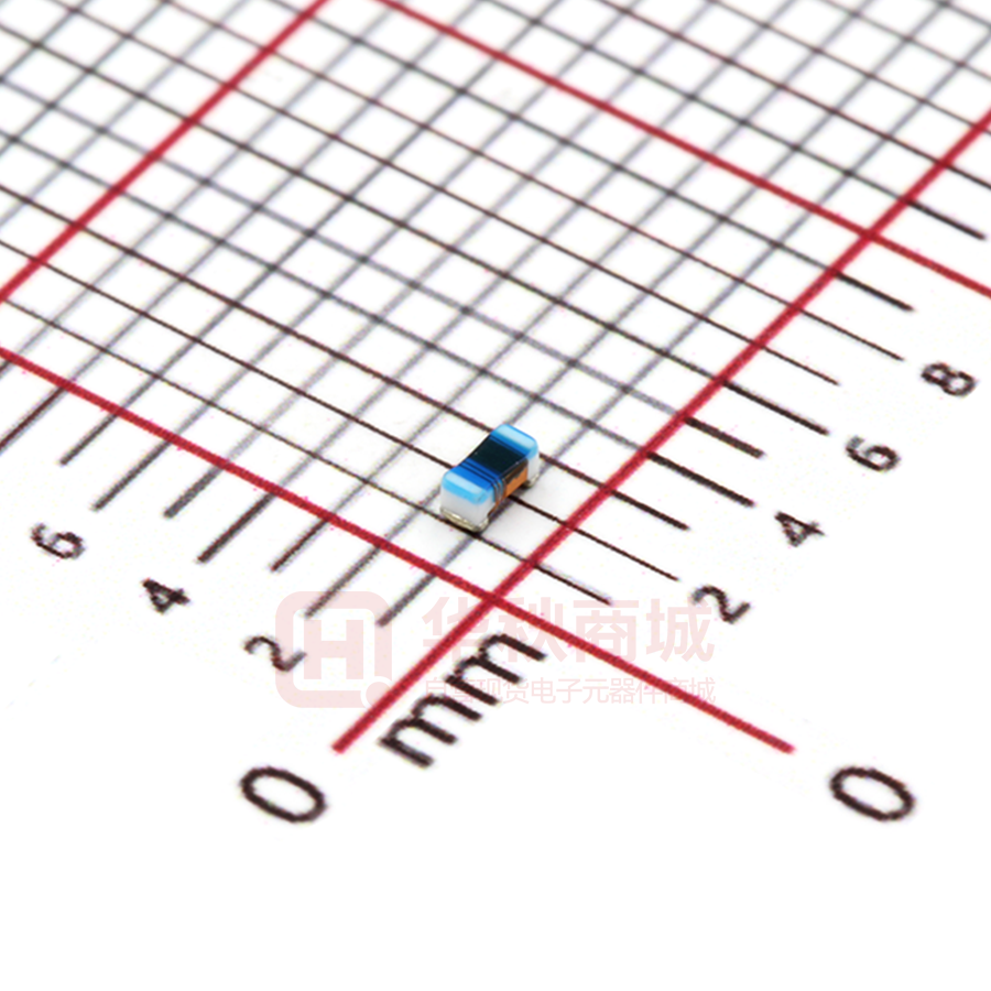

    固定电感器 0603 180nH ±5% 140mA 2.2Ω 1.3GHz 25@100MHz
LQW18ANR18J00D 数据手册
Spec No.: JELF243A_0024Z-01 P1/11 CHIP COILS (CHIP INDUCTORS) LQW18AN□□□□00□ REFERENCE SPECIFICATION 1. Scope This reference specification applies to chip coils (chip inductors) LQW18AN_00 series for general electronic equipment. 2. Part Numbering (Ex.) LQ W 18 Product Structure Dimension ID (L × W) A N 2N2 D 0 0 D Application Category Inductance Tolerance Performance Electrode Packaging and specification D: taping characteristic *B: bulk *B: Bulk packing is also available (taping condition: however, products without reels are put in plastic bags). 3. Part Number and Rating Operating temperature range -55°C to +125°C Storage temperature range -55°C to +125°C Customer Part number Inductance Tolerance Q (Min.) DC resistance (Ω max.) Self-resonant frequency (MHz min.) Rated current (mA) 2.2 D: ±0.5 nH 16 0.042 6000 700 3.6 C: ±0.2 nH 25 0.059 6000 850 LQW18AN3N6D00D 3.6 D: ±0.5 nH 25 0.059 6000 850 LQW18AN3N9C00D 3.9 C: ±0.2 nH 35 0.059 6000 850 LQW18AN3N9D00D 3.9 D: ±0.5 nH 35 0.059 6000 850 LQW18AN4N3C00D 4.3 C: ±0.2 nH 35 0.059 6000 850 LQW18AN4N3D00D 4.3 D: ±0.5 nH 35 0.059 6000 850 LQW18AN4N7D00D 4.7 D: ±0.5 nH 35 0.059 6000 850 LQW18AN5N6C00D 5.6 C: ±0.2 nH 35 0.082 6000 750 LQW18AN5N6D00D 5.6 D: ±0.5 nH 35 0.082 6000 750 LQW18AN6N2C00D 6.2 C: ±0.2 nH 35 0.082 6000 750 LQW18AN6N2D00D 6.2 D: ±0.5 nH 35 0.082 6000 750 LQW18AN6N8C00D 6.8 C: ±0.2 nH 35 0.082 6000 750 LQW18AN6N8D00D 6.8 D: ±0.5 nH 35 0.082 6000 750 LQW18AN7N5C00D 7.5 C: ±0.2 nH 35 0.082 6000 750 Murata Part number Nominal value (nH) LQW18AN2N2D00D LQW18AN3N6C00D LQW18AN7N5D00D 7.5 D: ±0.5 nH 35 0.082 6000 750 LQW18AN8N2C00D 8.2 C: ±0.2 nH 35 0.11 6000 650 LQW18AN8N2D00D 8.2 D: ±0.5 nH 35 0.11 6000 650 LQW18AN8N7C00D 8.7 C: ±0.2 nH 35 0.11 6000 650 LQW18AN8N7D00D 8.7 D: ±0.5 nH 35 0.11 6000 650 LQW18AN9N1C00D 9.1 C: ±0.2 nH 35 0.11 6000 650 LQW18AN9N1D00D 9.1 D: ±0.5 nH 35 0.11 6000 650 LQW18AN9N5D00D 9.5 D: ±0.5 nH 35 0.11 6000 650 LQW18AN10NG00D 10 G: ±2% 35 0.11 6000 650 LQW18AN10NJ00D 10 J: ±5% 35 0.11 6000 650 LQW18AN11NG00D 11 G: ±2% 35 0.11 6000 650 LQW18AN11NJ00D 11 J: ±5% 35 0.11 6000 650 LQW18AN12NG00D 12 G: ±2% 35 0.13 6000 600 LQW18AN12NJ00D 12 J: ±5% 35 0.13 6000 600 LQW18AN13NG00D 13 G: ±2% 35 0.13 6000 600 LQW18AN13NJ00D 13 J: ±5% 35 0.13 6000 600 MURATA MFG CO., LTD Spec No.: JELF243A_0024Z-01 Customer Part number Murata Part number P2/11 Inductance Tolerance Q (Min.) DC resistance (Ω max.) Self-resonant frequency (MHz min.) Rated current (mA) 15 G: ±2% 40 0.13 6000 600 15 J: ±5% 40 0.13 6000 600 16 G: ±2% 40 0.16 5500 550 Nominal value (nH) LQW18AN15NG00D LQW18AN15NJ00D LQW18AN16NG00D LQW18AN16NJ00D 16 J: ±5% 40 0.16 5500 550 LQW18AN18NG00D 18 G: ±2% 40 0.16 5500 550 LQW18AN18NJ00D 18 J: ±5% 40 0.16 5500 550 LQW18AN20NG00D 20 G: ±2% 40 0.16 4900 550 LQW18AN20NJ00D 20 J: ±5% 40 0.16 4900 550 LQW18AN22NG00D 22 G: ±2% 40 0.17 4600 500 LQW18AN22NJ00D 22 J: ±5% 40 0.17 4600 500 LQW18AN24NG00D 24 G: ±2% 40 0.21 3800 500 LQW18AN24NJ00D 24 J: ±5% 40 0.21 3800 500 LQW18AN27NG00D 27 G: ±2% 40 0.21 3700 440 LQW18AN27NJ00D 27 J: ±5% 40 0.21 3700 440 LQW18AN30NG00D 30 G: ±2% 40 0.23 3300 420 LQW18AN30NJ00D 30 J: ±5% 40 0.23 3300 420 LQW18AN33NG00D 33 G: ±2% 40 0.23 3200 420 LQW18AN33NJ00D 33 J: ±5% 40 0.23 3200 420 LQW18AN36NG00D 36 G: ±2% 40 0.26 2900 400 LQW18AN36NJ00D 36 J: ±5% 40 0.26 2900 400 LQW18AN39NG00D 39 G: ±2% 40 0.26 2800 400 LQW18AN39NJ00D 39 J: ±5% 40 0.26 2800 400 LQW18AN43NG00D 43 G: ±2% 40 0.29 2700 380 LQW18AN43NJ00D 43 J: ±5% 40 0.29 2700 380 LQW18AN47NG00D 47 G: ±2% 38 0.29 2600 380 LQW18AN47NJ00D 47 J: ±5% 38 0.29 2600 380 LQW18AN51NG00D 51 G: ±2% 38 0.33 2500 370 LQW18AN51NJ00D 51 J: ±5% 38 0.33 2500 370 LQW18AN56NG00D 56 G: ±2% 38 0.35 2400 360 LQW18AN56NJ00D 56 J: ±5% 38 0.35 2400 360 LQW18AN62NG00D 62 G: ±2% 38 0.51 2300 280 LQW18AN62NJ00D 62 J: ±5% 38 0.51 2300 280 LQW18AN68NG00D 68 G: ±2% 38 0.38 2200 340 LQW18AN68NJ00D 68 J: ±5% 38 0.38 2200 340 LQW18AN72NG00D 72 G: ±2% 34 0.56 2100 270 LQW18AN72NJ00D 72 J: ±5% 34 0.56 2100 270 LQW18AN75NG00D 75 G: ±2% 34 0.56 2050 270 LQW18AN75NJ00D 75 J: ±5% 34 0.56 2050 270 LQW18AN82NG00D 82 G: ±2% 34 0.60 2000 250 LQW18AN82NJ00D 82 J: ±5% 34 0.60 2000 250 LQW18AN91NG00D 91 G: ±2% 34 0.64 1900 230 LQW18AN91NJ00D 91 J: ±5% 34 0.64 1900 230 LQW18ANR10G00D 100 G: ±2% 34 0.68 1800 220 LQW18ANR10J00D 100 J: ±5% 34 0.68 1800 220 LQW18ANR11G00D 110 G: ±2% 32 1.2 1700 200 LQW18ANR11J00D 110 J: ±5% 32 1.2 1700 200 MURATA MFG CO., LTD Spec No.: JELF243A_0024Z-01 Customer Part number P3/11 Murata Part number Inductance Tolerance Q (Min.) DC resistance (Ω max.) Self-resonant frequency (MHz min.) Rated current (mA) 120 G: ±2% 32 1.3 1600 180 120 J: ±5% 32 1.3 1600 180 130 G: ±2% 32 1.4 1450 170 Nominal value (nH) LQW18ANR12G00D LQW18ANR12J00D LQW18ANR13G00D LQW18ANR13J00D 130 J: ±5% 32 1.4 1450 170 LQW18ANR15G00D 150 G: ±2% 32 1.5 1400 160 LQW18ANR15J00D 150 J: ±5% 32 1.5 1400 160 LQW18ANR16G00D 160 G: ±2% 32 2.1 1350 150 LQW18ANR16J00D 160 J: ±5% 32 2.1 1350 150 LQW18ANR18G00D 180 G: ±2% 25 2.2 1300 140 LQW18ANR18J00D 180 J: ±5% 25 2.2 1300 140 LQW18ANR20G00D 200 G: ±2% 25 2.4 1250 120 LQW18ANR20J00D 200 J: ±5% 25 2.4 1250 120 LQW18ANR22G00D 220 G: ±2% 25 2.5 1200 120 LQW18ANR22J00D 220 J: ±5% 25 2.5 1200 120 LQW18ANR27G00D 270 G: ±2% 30 3.4 960 110 LQW18ANR27J00D 270 J: ±5% 30 3.4 960 110 LQW18ANR33G00D 330 G: ±2% 30 5.5 800 85 LQW18ANR33J00D 330 J: ±5% 30 5.5 800 85 LQW18ANR39G00D 390 G: ±2% 30 6.2 800 80 LQW18ANR39J00D 390 J: ±5% 30 6.2 800 80 LQW18ANR47G00D 470 G: ±2% 30 7.0 700 75 LQW18ANR47J00D 470 J: ±5% 30 7.0 700 75 4. Testing Conditions Unless otherwise specified Temperature: ordinary temperature (15°C to 35°C) Humidity: ordinary humidity [25% to 85% (RH)] In case of doubt Temperature: 20°C±2°C Humidity: 60% to 70% (RH) Atmospheric pressure: 86 kPa to 106 kPa 5. Appearance and Dimensions Unit mass (typical value): 0.003 g MURATA MFG CO., LTD Spec No.: JELF243A_0024Z-01 P4/11 6. Marking No marking. 7. Electrical Performance No. Item 7.1 Inductance Specification Meet chapter 3 ratings. Test method Measuring equipment: Keysight E4991A or the equivalent Measuring frequency: Inductance 100 MHz Q 250 MHz 2.2 nH to 39 nH 200 MHz 43 nH to 68 nH 150 MHz 72 nH to 160 nH 7.2 Q 100 MHz 180 nH to 470 nH Measuring conditions: Measurement signal level: Approx. 0 dBm Measurement terminal distance: 1.0 mm Electrical length: 10.0 mm Measuring fixture: Keysight 16197A Position the chip coil under test as shown in the measuring example below and connect it to the electrode by applying weight. Measurement example: Meet chapter 3 ratings. Measuring method: see "Electrical performance: Measuring method for inductance/Q" in the chapter "14. Appendix". 7.3 DC resistance Meet chapter 3 ratings. Measuring equipment: digital multimeter 7.4 Self-resonant frequency Meet chapter 3 ratings. Measuring equipment: Keysight N5230A or the equivalent 7.5 Rated current Product temperature rise: 20°C max. Inductance change rate: within ±10% Apply the rated current specified in chapter 3. 8. Mechanical Performance No. 8.1 Item Shear test Specification No significant mechanical damage or no sign of electrode peeling off shall be observed. Test method Test substrate: glass-epoxy substrate Force application direction: Applying force: 5 N Holding time: 5 s±1 s MURATA MFG CO., LTD Spec No.: JELF243A_0024Z-01 No. P5/11 Item Specification Test method 8.2 Bending test No significant mechanical damage or no sign of electrode peeling off shall be observed. Test substrate: glass-epoxy substrate (100mm × 40 mm × 1.6 mm) Pressurizing speed: 1 mm/s Deflection: 2 mm Holding time: 30 s 8.3 Vibration Appearance shall have no significant mechanical damage. Oscillation frequency: 10 Hz to 55 Hz to 10 Hz, for approx. 1 min Total amplitude: 1.5 mm Test time: 3 directions perpendicular to each other, 2 h for each direction (6 h in total) 8.4 Solderability 90% or more of the outer electrode shall be covered with new solder seamlessly. Flux: immersed in ethanol solution [including an activator with a chlorine conversion value of 0.06(wt)%] with a rosin content of 25(wt)% for 5 s to 10 s. Solder: Sn-3.0Ag-0.5Cu solder Pre-heating: 150°C±10°C/60 s to 90 s Solder temperature: 240°C±5°C Immersion time: 3 s±1 s 8.5 Resistance to soldering heat Appearance: No significant mechanical damage shall be observed. Inductance change rate: within ±5% Flux: immersed in ethanol solution [including an activator with a chlorine conversion value of 0.06(wt)%] with a rosin content of 25(wt)% for 5 s to 10 s. Solder: Sn-3.0Ag-0.5Cu solder Pre-heating: 150°C±10°C/60 s to 90 s Solder temperature: 270°C±5°C Immersion time: 10 s±1 s Post-treatment: left at a room condition for 24 h±2 h 9. Environmental Performance The product is soldered on a substrate for test. No. Item Specification Test method 9.1 Heat resistance Appearance: No significant mechanical damage shall be observed. Inductance change rate: within ±5% Q change rate: within ±20% Temperature: 125°C±2°C Test time: 1000 h (+48 h, -0 h) Post-treatment: left at a room condition for 24 h±2 h 9.2 Cold resistance Appearance: No significant mechanical damage shall be observed. Inductance change rate: within ±5% Q change rate: within ±20% Temperature: -55°C±2°C Test time: 1000 h (+48 h, -0 h) Post-treatment: left at a room condition for 24 h±2 h 9.3 Humidity Appearance: No significant mechanical damage shall be observed. Inductance change rate: within ±5% Q change rate: within ±20% Temperature: 40°C±2°C Humidity: 90% (RH) to 95% (RH) Test time: 1000 h (+48 h, -0 h) Post-treatment: left at a room condition for 24 h±2 h 9.4 Temperature cycle Appearance: No significant mechanical damage shall be observed. Inductance change rate: within ±5% Q change rate: within ±20% Single cycle conditions: Step 1: -55°C±2°C/30 min±3 min Step 2: ordinary temperature/10 min to 15 min Step 3: +125°C±2°C/30 min±3 min Step 4: ordinary temperature/10 min to 15 min Number of testing: 10 cycles Post-treatment: left at a room condition for 24 h±2 h MURATA MFG CO., LTD Spec No.: JELF243A_0024Z-01 P6/11 10. Specification of Packaging 10.1 Appearance and dimensions of tape (8 mm width/paper tape) A 1.0±0.05 B 1.8±0.05 t 1.1 max. (in mm) 10.2 Taping specifications Packing quantity (Standard quantity) 4000 pcs/reel Packing method The products are placed in embossed cavities of a base tape and sealed by a top tape and a bottom tape. Feed hole position The feed holes on the base tape are on the right side when the top tape is pulled toward the user. Joint The base tape and the top tape are seamless. Number of missing products Number of missing products within 0.1% of the number per reel or 1 pc., whichever is greater, and are not continuous. The specified quantity per reel is kept. 10.3 Break down force of tape Break down force of top tape 5 N min. Break down force of bottom tape 5 N min. 10.4 Peeling off force of top tape Speed of peeling off Peeling off force 165 to 180 degree Bottom tape 300 mm/min 0.1 N to 0.6 N (The lower limit is for typical value.) F Top tape Base tape 10.5 Dimensions of leader section, trailer section and reel A vacant section is provided in the leader (start) section and trailer (end) section of the tape for the product. The leader section is further provided with an area consisting only of the top tape. (See the diagram below.) MURATA MFG CO., LTD Spec No.: JELF243A_0024Z-01 P7/11 10.6 Marking for reel Customer part number, Murata part number, inspection number (*1), RoHS marking (*2), quantity, etc. *1 Expression of inspection No.: (1) Factory code  □□ ○○○○ (2) Date First digit: year/last digit of year (1) (2) (3) Second digit: month/Jan. to Sep.→1 to 9, Oct. to Dec.→O, N, D Third, Fourth digit: day (3) Serial No. *2 Expression of RoHS marking: (1) RoHS regulation conformity ROHSY () (2) Murata classification number (1) (2) 10.7 Marking on outer box (corrugated box) Customer name, purchasing order number, customer part number, Murata part number, RoHS marking (*2), quantity, etc. 10.8 Specification of outer box Label H D W 11. Dimensions of outer box (mm) W D H 186 186 93 Standard reel quantity in outer box (reel) 5 * Above outer box size is typical. It depends on a quantity of an order. Caution Restricted applications Please contact us before using our products for the applications listed below which require especially high reliability for the prevention of defects which might directly cause damage to the third party's life, body or property. (1) Aircraft equipment (2) Aerospace equipment (3) Undersea equipment (4) Power plant control equipment (5) Medical equipment (6) Transportation equipment (vehicles, trains, ships, etc.) (7) Traffic signal equipment (8) Disaster/crime prevention equipment (9) Data-processing equipment (10) Applications of similar complexity and/or reliability requirements to the applications listed in the above 12. Precautions for Use This product is for use only with reflow soldering. It is designed to be mounted by soldering. If you want to use other mounting method, for example, using a conductive adhesive, please consult us beforehand. 12.1 Land dimensions The following diagram shows the recommended land dimensions for reflow soldering. The land dimensions are designed in consideration of electrical characteristics and mountability. Use of other land dimensions may preclude achievement of performance. In some cases, it may result in poor solderability, including positional shift. If you use other land pattern, consider it adequately. a 0.6 to 0.8 b 1.9 to 2.0 c 0.7 to 1.0 (in mm) MURATA MFG CO., LTD Spec No.: JELF243A_0024Z-01 P8/11 12.2 Flux and solder used Flux • Use a rosin-based flux that includes an activator with a chlorine conversion value of 0.06(wt)% to 0.1(wt)%. • Do not use a highly acidic flux with a halide content exceeding 0.2(wt)% (chlorine conversion value). • Do not use a water-soluble flux. Solder • Use Sn-3.0Ag-0.5Cu solder. • Standard thickness of solder paste: 100 μm to 150 μm If you want to use a flux other than the above, please consult our technical department. 12.3 Soldering conditions (reflow) • Pre-heating should be in such a way that the temperature difference between solder and product surface is limited to 150°C max. Cooling into solvent after soldering also should be in such a way that the temperature difference is limited to 100°C max. Insufficient pre-heating may cause cracks on the product, resulting in the deterioration of product quality. • Standard soldering profile and the limit soldering profile is as follows. The excessive limit soldering conditions may cause leaching of the electrode and/or resulting in the deterioration of product quality. Temp. (℃) 260℃ 245℃±3℃ 220℃ 230℃ Limit Profile 180 150 Standard Profile 30s~60s 60s max. 90s±30s Time. (s) Standard profile Limit profile Pre-heating 150°C to 180°C/90 s±30 s 150°C to 180°C/90 s±30 s Heating Above 220°C/30 s to 60 s Above 230°C/60 s max. 245°C±3°C 260°C/10 s 2 times 2 times Peak temperature Number of reflow cycles 12.4 Reworking with soldering iron The following requirements must be met to rework a soldered product using a soldering iron. Item Requirement Pre-heating 150°C/approx. 1 min Tip temperature of soldering iron 350°C max. Power consumption of soldering iron 80 W max. Tip diameter of soldering iron Soldering time Number of reworking operations ø3 mm max. 3 s (+1 s, -0 s) 2 times max. * Avoid a direct contact of the tip of the soldering iron with the product. Such a direction contact may cause cracks in the ceramic body due to thermal shock. 12.5 Solder volume Solder shall be used not to increase the volume too much. An increased solder volume increases mechanical stress on the product. Exceeding solder volume may cause the failure of mechanical or electrical performance. MURATA MFG CO., LTD Spec No.: JELF243A_0024Z-01 P9/11 12.6 Product's location The following shall be considered when designing and laying out PCBs. (1) PCB shall be designed so that products are not subject to mechanical stress due to warping the board. [Products direction] Products shall be located in the sideways direction (length: a < b) to the mechanical stress. a b 〈 Poor example〉 〈 Good example〉 (2) Components location on PCB separation It is effective to implement the following measures, to reduce stress in separating the board. It is best to implement all of the following three measures; however, implement as many measures as possible to reduce stress. Contents of measures Stress level (1) Turn the mounting direction of the component parallel to the board separation surface. A > D*1 (2) Add slits in the board separation part. A>B (3) Keep the mounting position of the component away from the board separation surface. A>C *1 A > D is valid when stress is added vertically to the perforation as with hand separation. If a cutting disc is used, stress will be diagonal to the PCB, therefore A > D is invalid. (3) Mounting components near screw holes When a component is mounted near a screw hole, it may be affected by the board deflection that occurs during the tightening of the screw. Mount the component in a position as far away from the screw holes as possible. 12.7 Handling of substrate After mounting products on a substrate, do not apply any stress to the product caused by bending or twisting to the substrate when cropping the substrate, inserting and removing a connector from the substrate or tightening screw to the substrate. Excessive mechanical stress may cause cracking in the product. Bending Twisting MURATA MFG CO., LTD Spec No.: JELF243A_0024Z-01 P10/11 12.8 Cleaning The product shall be cleaned under the following conditions. (1) The cleaning temperature shall be 60°C max. If isopropyl alcohol (IPA) is used, the cleaning temperature shall be 40°C max. (2) Perform ultrasonic cleaning under the following conditions. Exercise caution to prevent resonance phenomenon in mounted products and the PCB. Item Requirement Power Time 20 W/L max. 5 min max. Frequency 28 kHz to 40 kHz (3) Cleaner Alcohol-based cleaner: IPA Aqueous agent: PINE ALPHA ST-100S (4) There shall be no residual flux or residual cleaner. When using aqueous agent, rinse the product with deionized water adequately and completely dry it so that no cleaner is left. * For other cleaning, consult our technical department. 12.9 Storage and transportation Storage period Use the product within 12 months after delivery. If you do not use the product for more than 12 months, check solderability before using it. Storage conditions • The products shall be stored in a room not subject to rapid changes in temperature and humidity. The recommended temperature range is -10°C to +40°C. The recommended relative humidity range is 15% to 85%. Keeping the product in corrosive gases, such as sulfur, chlorine gas or acid, oxidizes the electrode, resulting in poor solderability or corrosion of the coil wire of the product. • Do not keep products in bulk packaging. Doing so may cause collision between the products or between the products and other products, resulting in core chipping or wire breakage. • Do not place the products directly on the floor; they should be placed on a palette so that they are not affected by humidity or dust. • Avoid keeping the products in a place exposed to direct sunlight, heat or vibration. Transportation Excessive vibration and impact reduces the reliability of the products. Exercise caution when handling the products. 12.10 Resin coating The inductance value may change due to high cure-stress of resin to be used for coating/molding products. A wire breakage issue may occur by mechanical stress caused by the resin, amount/cured shape of resin, or operating condition etc. Some resin contains some impurities or chloride possible to generate chlorine by hydrolysis under some operating condition may cause corrosion of wire of coil, leading to wire breakage. So, please pay your careful attention when you select resin in case of coating/molding the products with the resin. Prior to use the coating resin, please make sure no reliability issue is observed by evaluating products mounted on your board. 12.11 Handling of product • Sharp material such as a pair of tweezers or other material such as bristles of cleaning brush, shall not be touched to the winding portion to prevent the breaking of wire. • Mechanical shock should not be applied to the products mounted on the board to prevent the breaking of the core. 12.12 Handling with mounting equipment • With some types of mounting equipment, a support pin pushes up the product from the bottom of the base (paper) tape when the product is sucked with the pick-up nozzle. When using this type of equipment, detach the support pin to prevent the breaking of wire on the product. • In some cases, the laser recognition function of the mounting equipment may not recognize this product correctly. Please contact us when using laser recognition. (There is no problem with the permeation and reflection type.) 13. Note (1) Please make sure that your product has been evaluated in view of your specifications with our product being mounted to your product. (2) You are requested not to use our product deviating from the reference specifications. (3) The contents of this reference specification are subject to change without advance notice. Please approve our product specifications or transact the approval sheet for product specifications before ordering. MURATA MFG CO., LTD Spec No.: JELF243A_0024Z-01 P11/11 14. Appendix Electrical performance: Measuring method for inductance/Q (Q measurement is applicable only when the Q value is included in the rating table.) Perform measurement using the method described below. (Perform correction for the error deriving from the measuring terminal.) (1) Residual elements and stray elements of the measuring terminal can be expressed by the F parameter for the 2-pole terminal as shown in the figure below. (2) The product's impedance value (Zx) and measured impedance value (Zm) can be expressed as shown below, by using the respective current and voltage for input/output. Zm= V1 I1 Zx= V2 I2 (3) Thus, the relationship between the product's impedance value (Zx) and measured impedance value (Zm) is as follows. Zx=α Zm-β 1-ZmΓ Here, α = D/A = 1 β = B/D = Zsm - (1 - Yom Zsm) Zss Γ = C/A = Yom Zsm: measured impedance of short chip Zss: residual impedance of short chip (0.771 nH) Yom: measured admittance when measuring terminal is open (4) Calculate inductance Lx and Qx using the equations shown below. Im (Zx) Lx: inductance of chip coil Lx= 2πf Qx: Q of chip coil Im (Zx) Qx= f: measuring frequency Re (Zx) MURATA MFG CO., LTD
