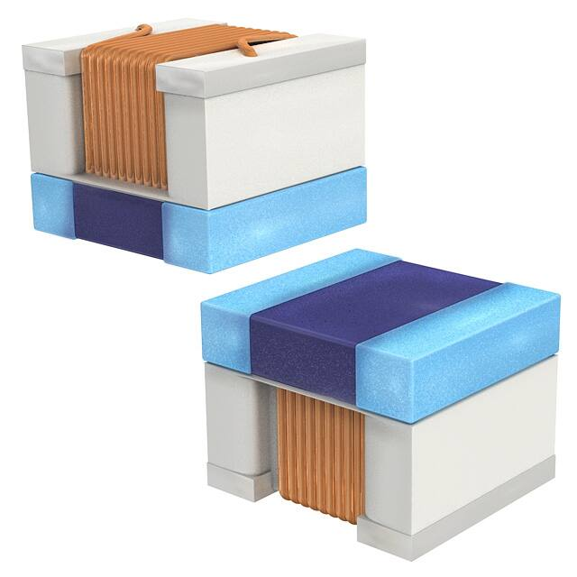

    固定电感器 1008 390nH ±5% 470mA 1.12Ω 500MHz 45@100MHz
LQW2UASR39J00L 数据手册
Spec No.: JELF243A_0085K-01 P1/12 CHIP COILS (CHIP INDUCTORS) LQW2UAS□□□□00□ REFERENCE SPECIFICATION 1. Scope This reference specification applies to chip coils (chip inductors) LQW2UAS_00 series for general electronic equipment. 2. Part Numbering (Ex.) LQ W 2U A S 12N G 0 0 L Product Structure Dimension ID (L × W) Application Category Inductance Tolerance Performance Electrode Packaging and specification L: taping characteristic *B: bulk *B: Bulk packing is also available (taping condition: however, products without reels are put in plastic bags). 3. Part Number and Rating Operating temperature range -55°C to +125°C Storage temperature range -55°C to +125°C Inductance Customer Part number Murata Part number Nominal value (nH) Q (Min.) Tolerance LQW2UAS12NG00L 12 G: ±2% 50 LQW2UAS12NJ00L 12 J: ±5% 50 LQW2UAS18NG00L 18 G: ±2% 50 DC resistance (Ω max.) Self-resonant frequency (MHz min.) Rated current (mA) 0.09 3300 1000 0.09 3300 1000 0.11 2500 1000 LQW2UAS18NJ00L 18 J: ±5% 50 0.11 2500 1000 LQW2UAS22NF00L 22 F: ±1% 55 0.12 2400 1000 LQW2UAS22NG00L 22 G: ±2% 55 0.12 2400 1000 LQW2UAS22NJ00L 22 J: ±5% 55 0.12 2400 1000 LQW2UAS27NG00L 27 G: ±2% 55 0.13 1600 1000 LQW2UAS27NJ00L 27 J: ±5% 55 0.13 1600 1000 LQW2UAS33NF00L 33 F: ±1% 60 0.14 1600 1000 LQW2UAS33NG00L 33 G: ±2% 60 0.14 1600 1000 LQW2UAS33NJ00L 33 J: ±5% 60 0.14 1600 1000 LQW2UAS39NF00L 39 F: ±1% 60 0.15 1500 1000 LQW2UAS39NG00L 39 G: ±2% 60 0.15 1500 1000 LQW2UAS39NJ00L 39 J: ±5% 60 0.15 1500 1000 LQW2UAS47NF00L 47 F: ±1% 65 0.16 1500 1000 LQW2UAS47NG00L 47 G: ±2% 65 0.16 1500 1000 LQW2UAS47NJ00L 47 J: ±5% 65 0.16 1500 1000 LQW2UAS56NF00L 56 F: ±1% 65 0.18 1300 1000 LQW2UAS56NG00L 56 G: ±2% 65 0.18 1300 1000 LQW2UAS56NJ00L 56 J: ±5% 65 0.18 1300 1000 LQW2UAS68NF00L 68 F: ±1% 65 0.20 1300 1000 LQW2UAS68NG00L 68 G: ±2% 65 0.20 1300 1000 LQW2UAS68NJ00L 68 J: ±5% 65 0.20 1300 1000 LQW2UAS82NF00L 82 F: ±1% 60 0.22 1000 1000 LQW2UAS82NG00L 82 G: ±2% 60 0.22 1000 1000 LQW2UAS82NJ00L 82 J: ±5% 60 0.22 1000 1000 LQW2UASR10F00L 100 F: ±1% 60 0.56 1000 650 LQW2UASR10G00L 100 G: ±2% 60 0.56 1000 650 LQW2UASR10J00L 100 J: ±5% 60 0.56 1000 650 MURATA MFG CO., LTD Spec No.: JELF243A_0085K-01 P2/12 Inductance Customer Part number Tolerance Q (Min.) DC resistance (Ω max.) Self-resonant frequency (MHz min.) Rated current (mA) 120 F: ±1% 60 0.63 950 650 120 G: ±2% 60 0.63 950 650 Murata Part number Nominal value (nH) LQW2UASR12F00L LQW2UASR12G00L LQW2UASR12J00L 120 J: ±5% 60 0.63 950 650 LQW2UASR15F00L 150 F: ±1% 45 0.70 850 580 LQW2UASR15G00L 150 G: ±2% 45 0.70 850 580 LQW2UASR15J00L 150 J: ±5% 45 0.70 850 580 LQW2UASR18F00L 180 F: ±1% 45 0.77 750 620 LQW2UASR18G00L 180 G: ±2% 45 0.77 750 620 LQW2UASR18J00L 180 J: ±5% 45 0.77 750 620 LQW2UASR22F00L 220 F: ±1% 45 0.84 700 500 LQW2UASR22G00L 220 G: ±2% 45 0.84 700 500 LQW2UASR22J00L 220 J: ±5% 45 0.84 700 500 LQW2UASR27F00L 270 F: ±1% 45 0.91 600 500 LQW2UASR27G00L 270 G: ±2% 45 0.91 600 500 LQW2UASR27J00L 270 J: ±5% 45 0.91 600 500 LQW2UASR33F00L 330 F: ±1% 45 1.05 570 450 LQW2UASR33G00L 330 G: ±2% 45 1.05 570 450 LQW2UASR33J00L 330 J: ±5% 45 1.05 570 450 LQW2UASR39F00L 390 F: ±1% 45 1.12 500 470 LQW2UASR39G00L 390 G: ±2% 45 1.12 500 470 LQW2UASR39J00L 390 J: ±5% 45 1.12 500 470 LQW2UASR47F00L 470 F: ±1% 45 1.19 450 470 LQW2UASR47G00L 470 G: ±2% 45 1.19 450 470 LQW2UASR47J00L 470 J: ±5% 45 1.19 450 470 LQW2UASR56F00L 560 F: ±1% 45 1.33 415 400 LQW2UASR56G00L 560 G: ±2% 45 1.33 415 400 LQW2UASR56J00L 560 J: ±5% 45 1.33 415 400 LQW2UASR62F00L 620 F: ±1% 45 1.40 375 300 LQW2UASR62G00L 620 G: ±2% 45 1.40 375 300 LQW2UASR62J00L 620 J: ±5% 45 1.40 375 300 LQW2UASR68F00L 680 F: ±1% 45 1.47 375 400 LQW2UASR68G00L 680 G: ±2% 45 1.47 375 400 LQW2UASR68J00L 680 J: ±5% 45 1.47 375 400 LQW2UASR75F00L 750 F: ±1% 45 1.54 360 360 LQW2UASR75G00L 750 G: ±2% 45 1.54 360 360 LQW2UASR75J00L 750 J: ±5% 45 1.54 360 360 LQW2UASR82F00L 820 F: ±1% 45 1.61 350 400 LQW2UASR82G00L 820 G: ±2% 45 1.61 350 400 LQW2UASR82J00L 820 J: ±5% 45 1.61 350 400 LQW2UASR91F00L 910 F: ±1% 35 1.68 320 380 LQW2UASR91G00L 910 G: ±2% 35 1.68 320 380 LQW2UASR91J00L 910 J: ±5% 35 1.68 320 380 LQW2UAS1R0F00L 1000 F: ±1% 35 1.75 290 370 LQW2UAS1R0G00L 1000 G: ±2% 35 1.75 290 370 LQW2UAS1R0J00L 1000 J: ±5% 35 1.75 290 370 LQW2UAS1R2J00L 1200 J: ±5% 35 2.0 210 310 MURATA MFG CO., LTD Spec No.: JELF243A_0085K-01 P3/12 Inductance Customer Part number Tolerance Q (Min.) DC resistance (Ω max.) Self-resonant frequency (MHz min.) Rated current (mA) 1500 J: ±5% 28 2.3 120 330 LQW2UAS1R8J00L 1800 J: ±5% 28 2.6 140 300 LQW2UAS2R2J00L 2200 J: ±5% 28 2.8 130 280 LQW2UAS2R7J00L 2700 J: ±5% 22 3.2 110 290 LQW2UAS3R3J00L 3300 J: ±5% 22 3.4 90 290 LQW2UAS3R9J00L 3900 J: ±5% 20 3.6 70 260 LQW2UAS4R7J00L 4700 J: ±5% 20 4.0 60 260 Murata Part number Nominal value (nH) LQW2UAS1R5J00L 4. Testing Conditions Unless otherwise specified Temperature: ordinary temperature (15°C to 35°C) Humidity: ordinary humidity [25% to 85% (RH)] In case of doubt Temperature: 20°C±2°C Humidity: 60% to 70% (RH) Atmospheric pressure: 86 kPa to 106 kPa 5. Appearance and Dimensions Unit mass (typical value): 0.039 g 6. Marking No marking. MURATA MFG CO., LTD Spec No.: JELF243A_0085K-01 P4/12 7. Electrical Performance No. Item 7.1 Inductance Specification Meet chapter 3 ratings. Test method Measuring equipment: Keysight E4991A or the equivalent Measuring frequency: Inductance 50 MHz 12 nH to 82 nH Q 25 MHz 100 nH to 1000 nH 7.9 MHz 1200 nH to 4700 nH 500 MHz 12 nH to 15 nH 350 MHz 18 nH to 120 nH 100 MHz 150 nH to 820 nH 50 MHz 7.2 Q 910 nH to 2200 nH 25 MHz 2700 nH to 4700 nH Measuring conditions: Measurement signal level: Approx. 0 dBm Measurement terminal distance: 1.5 mm Electrical length: 10.0 mm Weight: Approx. 1 N to 3 N Measuring fixture: Keysight 16197A Position the chip coil under test as shown in the measuring example below and connect it to the electrode by applying weight. Measurement example: Meet chapter 3 ratings. Measuring method: see "Electrical performance: Measuring method for inductance/Q" in the chapter "14. Appendix". 7.3 DC resistance Meet chapter 3 ratings. Measuring equipment: digital multimeter 7.4 Self-resonant frequency Meet chapter 3 ratings. Measuring equipment: Keysight N5230A or the equivalent 7.5 Rated current Product temperature rise: 40°C max. Apply the rated current specified in chapter 3. 8. Mechanical Performance No. 8.1 Item Shear test Specification No significant mechanical damage or no sign of electrode peeling off shall be observed. Test method Test substrate: glass-epoxy substrate Force application direction: Applying force: 10 N Holding time: 5 s±1 s MURATA MFG CO., LTD Spec No.: JELF243A_0085K-01 No. P5/12 Item Specification Test method 8.2 Bending test No significant mechanical damage or no sign of electrode peeling off shall be observed. Test substrate: glass-epoxy substrate (100 mm × 40 mm × 1.0 mm) Pressurizing speed: 1 mm/s Deflection: 3 mm Holding time: 5 s 8.3 Vibration Appearance shall have no significant mechanical damage. Oscillation frequency: 10 Hz to 2000 Hz to 10 Hz, for approx. 15 min Total amplitude: total amplitude of 3.0 mm or acceleration amplitude of 196 m/s2, whichever is smaller Test time: 3 directions perpendicular to each other, 2 h for each direction (6 h in total) 8.4 Solderability 90% or more of the outer electrode shall be covered with new solder seamlessly. Flux: immersed in ethanol solution [including an activator with a chlorine conversion value of 0.06(wt)%] with a rosin content of 25(wt)% for 5 s to 10 s. Solder: Sn-3.0Ag-0.5Cu solder Pre-heating: 150°C±10°C/60 s to 90 s Solder temperature: 240°C±5°C Immersion time: 3 s±1 s 8.5 Resistance to soldering heat Appearance: No significant mechanical damage shall be observed. Inductance change rate: within ±5% Flux: immersed in ethanol solution [including an activator with a chlorine conversion value of 0.06(wt)%] with a rosin content of 25(wt)% for 5 s to 10 s. Solder: Sn-3.0Ag-0.5Cu solder Pre-heating: 150°C±10°C/60 s to 90 s Solder temperature: 270°C±5°C Immersion time: 10 s±1 s Post-treatment: left at a room condition for 24 h±2 h 9. Environmental Performance The product is soldered on a substrate for test. No. Item Specification Test method 9.1 Heat resistance Appearance: No significant mechanical damage shall be observed. Inductance change rate: within ±5% Q change rate: within ±20% Temperature: 125°C±2°C Test time: 1000 h (+48 h, -0 h) Post-treatment: left at a room condition for 24 h±2 h 9.2 Cold resistance Appearance: No significant mechanical damage shall be observed. Inductance change rate: within ±5% Q change rate: within ±20% Temperature: -55°C±2°C Test time: 1000 h (+48 h, -0 h) Post-treatment: left at a room condition for 24 h±2 h 9.3 Humidity Appearance: No significant mechanical damage shall be observed. Inductance change rate: within ±5% Q change rate: within ±20% Temperature: 85°C±2°C Humidity: 85% (RH) Test time: 1000 h (+48 h, -0 h) Post-treatment: left at a room condition for 24 h±2 h 9.4 Temperature cycle Appearance: No significant mechanical damage shall be observed. Inductance change rate: within ±5% Q change rate: within ±20% Single cycle conditions: Step 1: -55°C±2°C/30 min±3 min Step 2: ordinary temperature/10 min to 15 min Step 3: +125°C±2°C/30 min±3 min Step 4: ordinary temperature/10 min to 15 min Number of testing: 10 cycles Post-treatment: left at a room condition for 24 h±2 h MURATA MFG CO., LTD Spec No.: JELF243A_0085K-01 P6/12 10. Specification of Packaging 10.1 Appearance and dimensions of tape (8 mm width/plastic tape) A 2.7±0.1 B 2.8±0.1 t 2.15±0.1 t' 0.25±0.05 (in mm) * The dimensions of the cavity are measured at its bottom. 10.2 Taping specifications Packing quantity (Standard quantity) 2000 pcs/reel Packing method The products are placed in embossed cavities of a plastic tape and sealed by a cover tape. Feed hole position The feed holes on the plastic tape are on the right side when the cover tape is pulled toward the user. Joint The plastic tape and the cover tape are seamless. Number of missing products Number of missing products within 0.1% of the number per reel or 1 pc., whichever is greater, and are not continuous. The specified quantity per reel is kept. 10.3 Break down force of tape Break down force of cover tape 10 N min. 10.4 Peeling off force of cover tape Speed of peeling off 300 mm/min Peeling off force 165 to 180 degree 0.1 N to 0.6 N (The lower limit is for typical value.) F Cover tape Plastic tape 10.5 Dimensions of leader section, trailer section and reel A vacant section is provided in the leader (start) section and trailer (end) section of the tape for the product. The leader section is further provided with an area consisting only of the cover tape. (See the diagram below.) MURATA MFG CO., LTD Spec No.: JELF243A_0085K-01 P7/12 10.6 Marking for reel Customer part number, Murata part number, inspection number (*1), RoHS marking (*2), quantity, etc. *1 Expression of inspection No.: (1) Factory code  □□ ○○○○ (2) Date First digit: year/last digit of year (1) (2) (3) Second digit: month/Jan. to Sep.→1 to 9, Oct. to Dec.→O, N, D Third, Fourth digit: day (3) Serial No. *2 Expression of RoHS marking: (1) RoHS regulation conformity ROHSY () (2) Murata classification number (1) (2) 10.7 Marking on outer box (corrugated box) Customer name, purchasing order number, customer part number, Murata part number, RoHS marking (*2), quantity, etc. 10.8 Specification of outer box Label H D W 11. Dimensions of outer box (mm) W D H 186 186 93 Standard reel quantity in outer box (reel) 5 * Above outer box size is typical. It depends on a quantity of an order. Caution Restricted applications Please contact us before using our products for the applications listed below which require especially high reliability for the prevention of defects which might directly cause damage to the third party's life, body or property. (1) Aircraft equipment (2) Aerospace equipment (3) Undersea equipment (4) Power plant control equipment (5) Medical equipment (6) Transportation equipment (vehicles, trains, ships, etc.) (7) Traffic signal equipment (8) Disaster/crime prevention equipment (9) Data-processing equipment (10) Applications of similar complexity and/or reliability requirements to the applications listed in the above 12. Precautions for Use This product is for use only with reflow soldering. It is designed to be mounted by soldering. If you want to use other mounting method, for example, using a conductive adhesive, please consult us beforehand. 12.1 Land dimensions The following diagram shows the recommended land dimensions for reflow soldering. The land dimensions are designed in consideration of electrical characteristics and mountability. Use of other land dimensions may preclude achievement of performance. In some cases, it may result in poor solderability, including positional shift. If you use other land pattern, consider it adequately. (in mm) Do not use gilded pattern. A copper wire may cause open by dissolution of metallization. MURATA MFG CO., LTD Spec No.: JELF243A_0085K-01 P8/12 12.2 Flux and solder used Flux • Use a rosin-based flux that includes an activator with a chlorine conversion value of 0.06(wt)% to 0.1(wt)%. • Do not use a highly acidic flux with a halide content exceeding 0.2(wt)% (chlorine conversion value). • Do not use a water-soluble flux. Solder • Use Sn-3.0Ag-0.5Cu solder. • Standard thickness of solder paste: 100 μm to 150 μm If you want to use a flux other than the above, please consult our technical department. 12.3 Soldering conditions (reflow) • Pre-heating should be in such a way that the temperature difference between solder and product surface is limited to 150°C max. Cooling into solvent after soldering also should be in such a way that the temperature difference is limited to 100°C max. Insufficient pre-heating may cause cracks on the product, resulting in the deterioration of product quality. • Standard soldering profile and the limit soldering profile is as follows. The excessive limit soldering conditions may cause leaching of the electrode and/or resulting in the deterioration of product quality. Temp. (℃) 260℃ 245℃±3℃ 220℃ 230℃ Limit Profile 180 150 Standard Profile 30s~60s 60s max. 90s±30s Time. (s) Standard profile Limit profile Pre-heating 150°C to 180°C/90 s±30 s 150°C to 180°C/90 s±30 s Heating Above 220°C/30 s to 60 s Above 230°C/60 s max. 245°C±3°C 260°C/10 s 2 times 2 times Peak temperature Number of reflow cycles 12.4 Reworking with soldering iron The following requirements must be met to rework a soldered product using a soldering iron. Item Requirement Pre-heating 150°C/approx. 1 min Tip temperature of soldering iron 350°C max. Power consumption of soldering iron 80 W max. Tip diameter of soldering iron Soldering time Number of reworking operations ø3 mm max. 3 s (+1 s, -0 s) 2 times max. * Avoid a direct contact of the tip of the soldering iron with the product. Such a direction contact may cause cracks in the ceramic body due to thermal shock. 12.5 Solder volume Solder shall be used not to increase the volume too much. An increased solder volume increases mechanical stress on the product. Exceeding solder volume may cause the failure of mechanical or electrical performance. MURATA MFG CO., LTD Spec No.: JELF243A_0085K-01 P9/12 12.6 Product's location The following shall be considered when designing and laying out PCBs. (1) PCB shall be designed so that products are not subject to mechanical stress due to warping the board. [Products direction] Products shall be located in the sideways direction (length: a < b) to the mechanical stress. a b 〈 Poor example〉 〈 Good example〉 (2) Components location on PCB separation It is effective to implement the following measures, to reduce stress in separating the board. It is best to implement all of the following three measures; however, implement as many measures as possible to reduce stress. Contents of measures Stress level (1) Turn the mounting direction of the component parallel to the board separation surface. A > D*1 (2) Add slits in the board separation part. A>B (3) Keep the mounting position of the component away from the board separation surface. A>C *1 A > D is valid when stress is added vertically to the perforation as with hand separation. If a cutting disc is used, stress will be diagonal to the PCB, therefore A > D is invalid. (3) Mounting components near screw holes When a component is mounted near a screw hole, it may be affected by the board deflection that occurs during the tightening of the screw. Mount the component in a position as far away from the screw holes as possible. 12.7 Handling of substrate After mounting products on a substrate, do not apply any stress to the product caused by bending or twisting to the substrate when cropping the substrate, inserting and removing a connector from the substrate or tightening screw to the substrate. Excessive mechanical stress may cause cracking in the product. Bending Twisting MURATA MFG CO., LTD Spec No.: JELF243A_0085K-01 P10/12 12.8 Cleaning The product shall be cleaned under the following conditions. (1) The cleaning temperature shall be 60°C max. If isopropyl alcohol (IPA) is used, the cleaning temperature shall be 40°C max. (2) Perform ultrasonic cleaning under the following conditions. Exercise caution to prevent resonance phenomenon in mounted products and the PCB. Item Requirement Power Time 20 W/L max. 5 min max. Frequency 28 kHz to 40 kHz (3) Cleaner Alcohol-based cleaner: IPA Aqueous agent: PINE ALPHA ST-100S (4) There shall be no residual flux or residual cleaner. When using aqueous agent, rinse the product with deionized water adequately and completely dry it so that no cleaner is left. * For other cleaning, consult our technical department. 12.9 Storage and transportation Storage period Use the product within 12 months after delivery. If you do not use the product for more than 12 months, check solderability before using it. Storage conditions • The products shall be stored in a room not subject to rapid changes in temperature and humidity. The recommended temperature range is -10°C to +40°C. The recommended relative humidity range is 15% to 85%. Keeping the product in corrosive gases, such as sulfur, chlorine gas or acid, oxidizes the electrode, resulting in poor solderability or corrosion of the coil wire of the product. • Do not keep products in bulk packaging. Doing so may cause collision between the products or between the products and other products, resulting in core chipping or wire breakage. • Do not place the products directly on the floor; they should be placed on a palette so that they are not affected by humidity or dust. • Avoid keeping the products in a place exposed to direct sunlight, heat or vibration. Transportation Excessive vibration and impact reduces the reliability of the products. Exercise caution when handling the products. 12.10 Resin coating The inductance value may change due to high cure-stress of resin to be used for coating/molding products. A wire breakage issue may occur by mechanical stress caused by the resin, amount/cured shape of resin, or operating condition etc. Some resin contains some impurities or chloride possible to generate chlorine by hydrolysis under some operating condition may cause corrosion of wire of coil, leading to wire breakage. So, please pay your careful attention when you select resin in case of coating/molding the products with the resin. Prior to use the coating resin, please make sure no reliability issue is observed by evaluating products mounted on your board. 12.11 Handling of product • Sharp material such as a pair of tweezers or other material such as bristles of cleaning brush, shall not be touched to the winding portion to prevent the breaking of wire. • Mechanical shock should not be applied to the products mounted on the board to prevent the breaking of the core. 12.12 Handling with mounting equipment With some types of mounting equipment, a support pin pushes up the product from the bottom of the base (paper) tape when the product is sucked with the pick-up nozzle. When using this type of equipment, detach the support pin to prevent the breaking of wire on the product. 13. Note (1) Please make sure that your product has been evaluated in view of your specifications with our product being mounted to your product. (2) You are requested not to use our product deviating from the reference specifications. (3) The contents of this reference specification are subject to change without advance notice. Please approve our product specifications or transact the approval sheet for product specifications before ordering. MURATA MFG CO., LTD Spec No.: JELF243A_0085K-01 P11/12 14. Appendix Electrical performance: Measuring method for inductance/Q (Q measurement is applicable only when the Q value is included in the rating table.) Perform measurement using the method described below. (Perform correction to ensure that the inductance value is compatible with inductors of other manufacturers.) (1) Residual elements and stray elements of the measuring terminal can be expressed by the F parameter for the 2-pole terminal as shown in the figure below. (2) The product's impedance value (Zx) and measured impedance value (Zm) can be expressed as shown below, by using the respective current and voltage for input/output. Zm= V1 I1 Zx= V2 I2 (3) Thus, the relationship between the product's impedance value (Zx) and measured impedance value (Zm) is as follows. Zx=α Zm-β 1-ZmΓ Here, α = D/A = 1 β = B/D = Zsm - (1 - Yom Zsm) Zss Γ = C/A = Yom Zsm: measured impedance when measuring terminal is shorted Zss: residual impedance of short chip (= Equivalent series inductance X*1) Yom: measured admittance when measuring terminal is open *1 Important X: In consideration of compatibility with other venders' products, Zss is defined as the correction value to fit nominal inductance of other venders' products. When calibrating the measurement, please input X value instead of the equivalent series inductance (ShortL) for each L value. Perform measurement of Q using the residual impedance 0.771 nH obtained through our conventional standard measurement method. (4) Calculate inductance Lx and Qx using the equations shown below. Im (Zx) Lx: inductance of chip coil Lx= 2πf Qx: Q of chip coil Im (Zx) Qx= f: measuring frequency Re (Zx) MURATA MFG CO., LTD Spec No.: JELF243A_0085K-01 P12/12 Table: Equivalent series inductance to fit nominal inductance of other venders' products Inductance Part number LQW2UAS12N_00 X (nH) Equivalent series Inductance 0.511 Measuring frequency (MHz) 50 LQW2UAS18N_00 0.321 50 LQW2UAS22N_00 0.941 50 LQW2UAS27N_00 0.651 50 LQW2UAS33N_00 1.711 50 LQW2UAS39N_00 0.741 50 LQW2UAS47N_00 2.071 50 LQW2UAS56N_00 2.351 50 LQW2UAS68N_00 2.281 50 LQW2UAS82N_00 2.921 50 LQW2UASR10_00 3.351 25 LQW2UASR12_00 3.871 25 LQW2UASR15_00 4.371 25 LQW2UASR18_00 5.271 25 LQW2UASR22_00 3.271 25 LQW2UASR27_00 8.871 25 LQW2UASR33_00 12.771 25 LQW2UASR39_00 22.271 25 LQW2UASR47_00 20.971 25 LQW2UASR56_00 24.971 25 LQW2UASR62_00 28.371 25 LQW2UASR68_00 44.271 25 LQW2UASR75_00 35.371 25 LQW2UASR82_00 47.171 25 LQW2UASR91_00 56.371 25 LQW2UAS1R0_00 79.171 25 LQW2UAS1R2_00 15.771 7.9 LQW2UAS1R5_00 5.771 7.9 LQW2UAS1R8_00 6.771 7.9 LQW2UAS2R2_00 25.771 7.9 LQW2UAS2R7_00 63.771 7.9 LQW2UAS3R3_00 91.771 7.9 LQW2UAS3R9_00 67.771 7.9 LQW2UAS4R7_00 163.771 7.9 MURATA MFG CO., LTD
LQW2UASR39J00L
物料型号:LQW2UAS系列,包括不同的后缀以表示不同的电感值和公差。
器件简介:这是村田制造的片式电感器(CHIP INDUCTORS),适用于一般电子设备。
引脚分配:文档中未明确提供引脚分配图,但通常这类器件为表面贴装型,具有端电极。
参数特性: - 工作温度范围:-55°C 至 +125°C - 存储温度范围:-55°C 至 +125°C - 电感值范围:12nH 至 4700nH - 公差:F(±1%)、G(+2%)、J(±5%) - Q值最小值:50至65 - 最大直流电阻:0.09Ω至1.75Ω - 自谐振频率:1600MHz 至 3300MHz - 额定电流:1000mA(大多数型号),650mA(部分大电感型号)
功能详解:片式电感器用于电子电路中以滤波、振荡、延迟、能量存储和传输等。
应用信息:适用于一般电子设备,具体应用场景未在文档中详述。
封装信息:封装形式为L:胶带包装,B:散装包装。单位质量典型值为0.039g,外观尺寸和封装带规格在文档中有详细描述。
