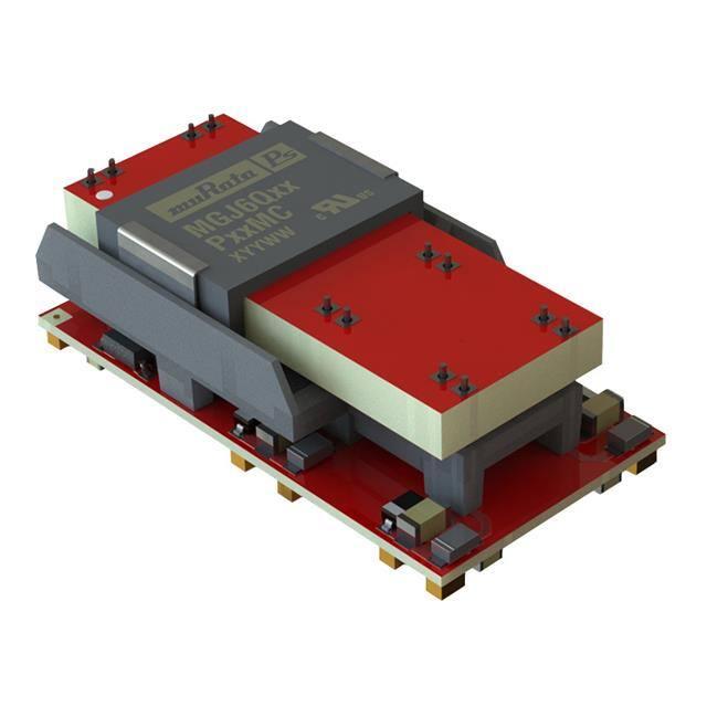

MGJ6 Three Phase Bridge Series www.murata.com 5.7kVDC 6W Quad Output Isolated Gate Drive SM DC-DC Converters SELECTION GUIDE W V mA W 4.5 - 9 24 42 1 24 125 3 MGJ6Q12P24MC 9 - 18 24 42 1 24 125 3 24 42 1 24 125 3 Ripple & Noise (Max)2 „ 5.7kVDC isolation test voltage ‘Hi Pot Test’ Load Regulation (Max) Input Voltage Range Load Regulation (Typ) „ Characterised partial discharge performance Ripple & Noise (Max)2 Order Code1 Output 4 VL Ripple & Noise (Typ)2 „ ANSI/AAMI ES60601-1, 2 MOPP recognised Load Regulation (Max)4 Output 1 VHA / Output 2 VHB Output 3 VHC „ Reinforced insulation to UL60950 with 8mm „ creepage & clearance recognised Ripple & Noise (Typ)2 „ Four isolated output voltages suitable MGJ6Q24P24MC 18 - 36  for powering IGBT/SiC & Mosfet gate drives  simultaneously in a three phase bridge  SELECTION GUIDE (Continued) configuration „ Characterised CMTI >100kV/μS mA MGJ6Q05P24MC Load Regulation (Typ)4 „ Patent protected Output Power V Rated Output Current „ No opto feedback Rated Output Voltage FEATURES Output Power V Order Code1 Output 4 VL Rated Output Current Input Voltage Range Rated Output Voltage Output 1 VHA / Output 2 VHB Output 3 VHC „ Ultra low isolation capacitance typically „ 15pF MGJ6Q05P24MC 4.5 - 9 2 3 100 150 2 3 100 150 „ Continuous barrier withstand voltage 3kVDC MGJ6Q12P24MC 9 - 18 2 3 70 120 2 3 70 120 „ 5V, 12V & 24V input voltages MGJ6Q24P24MC 18 - 36 2 3 70 120 2 3 70 120 For full details go to https://www.murata.com/englobal/products/power/rohs % mVp-p Telecordia MIL 217 Efficiency (Typ) MTTF3 Efficiency (Min) Order Code1 Input Current at Rated Load PRODUCT OVERVIEW Offering four isolated output voltages of 24V, the MGJ6-3P series of DC-DC converters is ideal for powering ‘high side’ and ‘low side’ gate drive circuits simultaneously for IGBTs, Silicon and Silicon Carbide Mosfets in three phase circuits. The MGJ63P series is characterised for high isolation and dv/ dt requirements commonly seen in bridge circuits used in motor drives and inverters. mVp-p SELECTION GUIDE (Continued) Nominal Input Voltage „ 105°C operating temperature % V V mA MGJ6Q05P24MC 5 1500 76 % 79.5 671 kHrs 1842 MGJ6Q12P24MC 12 600 81 84 781 1646 MGJ6Q24P24MC 24 300 82 85 787 1725 1. Components are supplied in tape and reel packaging, please refer to tape and reel specification section. Orderable part numbers are MGJ6QXXP24MC-R7 (23 pieces per reel), or MGJ6QXXP24MC-R13 (92 pieces per reel). 2. See ripple & noise test method. 3. Calculated using MIL-HDBK-217 FN2 and Telecordia SR-332 calculation model at TA=25°C with nominal input voltage at full load. 4. Between 50% and 100% rated output current. All specifications typical at TA=25°C, nominal input voltage and rated output current unless otherwise specified. www.murata.com KDC_MGJ6C-3P.D01 Page 1 of 19 MGJ6 Three Phase Bridge Series 5.7kVDC 6W Quad Output Isolated Gate Drive SM DC-DC Converters INPUT CHARACTERISTICS Parameter Voltage range Under voltage lock out Input ripple current Conditions Min. Typ. Max. Units 5V input types 12V input types 24V input types Turn on threshold MGJ6Q05 Turn off threshold MGJ6Q05 Turn on threshold MGJ6Q12 Turn off threshold MGJ6Q12 Turn on threshold MGJ6Q24 Turn off threshold MGJ6Q24 5V input types 12V input types 24V input types 4.5 9 18 5 12 24 3.8 3.2 8.1 7.5 16.7 16.3 30 45 25 9 18 36 V Typ. Max. V mA p-p OUTPUT CHARACTERISTICS Parameter Conditions Minimum load Below 10% load, output may rise to 30V maximum voltage 5V output types All other output types Voltage set point accuracy Total regulation Line regulation Min. 10 % +4 / -1 +3 / -2 Low line to high line Units % 0.5 10 1 % % Typ. Max. Units GENERAL CHARACTERISTICS Parameter Conditions Power Consumption Switching frequency Disable pin pulled low Min. 45 100 mW kHz ISOLATION CHARACTERISTICS Parameter Isolation test voltage Resistance Continuous barrier withstand voltage UL60950-1 Safety standard ANSI/AAMI ES60601-1 Creepage & clearance Isolation capacitance Conditions Min. Flash tested for 1 second (input to output) Flash tested for 1 second (output to output) Qualification tested for 1 minute (input to output) Qualification tested for 1 minute (output to output) Viso = 1kVDC Non-safety barrier application Reinforced 2 MOPP Input to output Output to output Primary to Output 1 VHA Primary to Output 2 VHB Primary to Output 3 VHC Primary to Output 4 VL 4000 2500 5700 3000 100 Typ. Max. Units VAC VDC 3000 250 250 8 8 15 15 15 15 GΩ VDC Vrms mm pF TEMPERATURE CHARACTERISTICS Parameter Conditions Min. Operation Storage See derating graphs -40 -55 Product temperature rise above ambient 100% Load, Nom VIN, Still Air Typ. 5V input types All other input types Max. 105 125 25 19 Units °C ABSOLUTE MAXIMUM RATINGS Short-circuit protection Input voltage, MGJ6-3P 5V input types Input voltage, MGJ6-3P 12V input types Input voltage, MGJ6-3P 24V input types Continuous 12V 20V 40V www.murata.com KDC_MGJ6C-3P.D01 Page 2 of 19 MGJ6 Three Phase Bridge Series 5.7kVDC 6W Quad Output Isolated Gate Drive SM DC-DC Converters TECHNICAL NOTES ISOLATION VOLTAGE ‘Hi Pot Test’, ‘Flash Tested’, ‘Withstand Voltage’, ‘Proof Voltage’, ‘Dielectric Withstand Voltage’ & ‘Isolation Test Voltage’ are all terms that relate to the same thing, a test voltage, applied for a specified time, across a component designed to provide electrical isolation, to verify the integrity of that isolation. Murata Power Solutions MGJ6-3P series of DC-DC converters are all 100% production tested at 4kVACrms for 1 second from input to output and 2.5kVACrms for 1 second from output to output. Also they are all qualification tested at 5.7kVDC for 1 minute from input to output and 3kVDC for 1 minute from output to output. The MGJ6-3P series is recognised by Underwriters Laboratory, please see safety approval section for more information. When the insulation in the MGJ6-3P series is not used as a safety barrier, i.e. provides functional isolation only, continuous or switched voltages across the barrier up to 3kV are sustainable. This is established by measuring the partial discharge Inception voltage in accordance with IEC 60270. Please contact Murata for further information. REPEATED HIGH-VOLTAGE ISOLATION TESTING It is well known that repeated high-voltage isolation testing of a barrier component can actually degrade isolation capability, to a lesser or greater degree depending on materials, construction and environment. We therefore strongly advise against repeated high voltage isolation testing, but if it is absolutely required, that the voltage be reduced by 20% from specified test voltage. SAFETY APPROVAL ANSI/AAMI ES60601-1 The MGJ6-3P series is recognised by Underwriters Laboratory (UL) to ANSI/AAMI ES60601-1 and provides 2 MOPP (Means Of Patient Protection) based on a working voltage of 250vrms. UL60950 The MGJ6-3P series is recognised by Underwriters Laboratory (UL) to UL60950 for reinforced insulation to a working voltage of 250Vrms with a maximum measured product operating temperature of 130°C. Creepage and clearance 8mm, input to output & across outputs. Working altitude 5000m Over voltage category (OVC) II FUSING The MGJ6-3P Series of converters are not internally fused so to meet the requirements of UL an anti-surge input line fuse should always be used with ratings as defined below. Input Voltage, 5V 4A Input Voltage, 12V 2A Input Voltage, 24V 1A All fuses should be UL recognised, 250Vac rated. RoHS COMPLIANCE, MSL, PSL AND REFLOW SOLDERING INFORMATION This series is compatible with Pb-Free soldering systems and is also backward compatible with Sn/Pb soldering systems. The MGJ6 three phase series has a process, moisture, and reflow sensitivity classification of MSL2 PSL R7F as defined in J-STD-020 and J-STD-075. Please refer to application notes for further information. This translates to: MSL2 = 1 year floor life, PSL R7F = Peak reflow temperature 245°C with a limitation on the time above liquidus (217°C) which for this series is 90sec max. The pin termination finish on this product series is Gold with Nickel Pre-plate. www.murata.com KDC_MGJ6C-3P.D01 Page 3 of 19 MGJ6 Three Phase Bridge Series 5.7kVDC 6W Quad Output Isolated Gate Drive SM DC-DC Converters ENVIRONMENTAL VALIDATION TESTING The following tests have been conducted on this product series, please contact Murata if further information about the tests is required. Test Standard Condition JEDEC JESD22-A101 10 cycles between two chambers set to achieve -55°C and +125°C.The dwell time shall not be less than 10min and the load shall reach the specified temperature in 15min. 85±2°C, 85±5% R.H. for 1000 (+168/-24) hours. JEDEC JESD22-A103, Condition A 125°C +10/-0°C for ≥1000 hours. Temperature cycling MIL-STD-883 Method 1010, Condition B Humidity bias High Temperature Storage life Vibration 5 – 150Hz. Level at each axis – Vertical, Traverse and Longitudinal: 5.72m/s2 rms. 5 hours in each axis. Crest factor: BS EN 61373 with respect to BS EN 60068-2-64, Test Fh Category 1 Class B 3 Sigma. Device is secured via surface mount pins. Solvent cleaning The parts are conditioned in a steam ager for 8 hours ±15 min. at a temperature of 93±3°C. SnPb (Test S): The parts are placed onto a stencil with Sn60Pb40 solder paste on and then placed into the reflow EIA/IPC/JEDEC J-STD-002, Test S and S1 oven at 215 ±5°C for 50–70 seconds. Pb-free (Test S1): The parts are placed onto a stencil with Sn96.5Ag3.0Cu0.5 solder paste on and then placed into the reflow oven at 245 ±5°C for 30–60 seconds. Resistance to cleaning agents. Solvent – Novec 71IPA & Topklean EL-20A. Pulsed ultrasonic immersion 45°C - 65°C Solvent Resistance MIL-STD-883 Method 2015 The parts and the bristle portion of the brush are immersed in Isopropanol for a minimum of 1 minute. The parts are brushed 3 times, after the third time the parts are blown dry and inspected. Moisture sensitivity level (MSL 2) Based on IPC/JEDEC J-STD-020 Bake samples at 125 +5/-0°C for 24hours minimum before conditioning in the temperature/humidity chamber for 168 hours at 85°C/60%RH and Pb Free JEDEC Max profile conditioning with electrical testing, co-planarity inspection before and after. Solderability PART NUMBER STRUCTURE MGJ 6 Q XX P XX M C -RXX Series name Packaging code Power rating R7 - 7 inch reel R13 - 13 inch reel Output type RoHS compliant S - Single D - Dual T - Triple Q - Quad Input voltage Topology Package type S - SIP D - DIP M - Surface mount Z - ZIP Output voltage F - Full bridge H - Half bridge Q - Three phase www.murata.com KDC_MGJ6C-3P.D01 Page 4 of 19 MGJ6 Three Phase Bridge Series 5.7kVDC 6W Quad Output Isolated Gate Drive SM DC-DC Converters CHARACTERISATION TEST METHODS Ripple & Noise Characterisation Method Ripple and noise measurements are performed with the following test configuration. C1 1μF X7R multilayer ceramic capacitor, voltage rating to be a minimum of 3 times the output voltage of the DC-DC converter 10μF tantalum capacitor, voltage rating to be a minimum of 1.5 times the output voltage of the DC-DC converter with an ESR of less than 100mΩ at 100 kHz C3 100nF multilayer ceramic capacitor, general purpose R1 450Ω resistor, carbon film, ±1% tolerance R2 50Ω BNC termination T1 3T of the coax cable through a ferrite toroid RLOAD Resistive load to the maximum power rating of the DC-DC converter. Connections should be made via twisted wires Measured values are multiplied by 10 to obtain the specified values. C2 Differential Mode Noise Test Schematic DC/DC Converter OSCILLOSCOPE C1 C2 C3 + SUPPLY Input - + R1 T1 R2 Y INPUT Output - R LOAD www.murata.com KDC_MGJ6C-3P.D01 Page 5 of 19 MGJ6 Three Phase Bridge Series 5.7kVDC 6W Quad Output Isolated Gate Drive SM DC-DC Converters APPLICATION NOTES Disable/Frequency synchronisation Please refer to application notes for further information. Min Pull Down Current Disable/Sync1 Input High Input Low Frequency Range Synchronisation Duty Cycle The Disable/Synchronization pin has three modes: 1. 2. 3. Typ 0.5 2 -0.6 90 25 100 Max 60 0.8 110 75 Units mA V V kHz % When a DC logic low voltage is applied to this pin the MGJ6-3P is disabled and enters a low quiescent current sleep mode. When this pin is left floating or a DC logic high (CMOS/TTL compatible) voltage is applied the MGJ6-3P is enabled and operates at the programmed frequency of 100kHz. When a square wave of between 90kHz and 110kHz is applied to this pin, the switcher operates at the same frequency as the square wave. The falling edge of the square wave corresponds to the start of the switching cycle. If the signal is slower than 25Hz, it will be interpreted as enabling and disabling the part. If the MGJ6-3P is disabled, it must be disabled for 7 clock cycles before being re-enabled. Note: The Dis/Sync pin is a high impedance TTL input and can be triggered by noise from external circuits if not treated carefully. Please refer to “LAYOUT CONSIDERATIONS” and “SYNCHRONISATION CIRCUIT” for further details. Click here for general guidance for gate drive applications. Layout considerations Unlike standard isolated DC-DC products the MGJ6-3P series has been designed specifically for high side gate drive applications where the outputs are being driven to a high voltage at a very high dV/dT. This is possible due to minimum transformer isolation capacitance and considered circuit design regarding common mode transient immunity. It is important that these few simple pcb layout guidelines are implemented so as not to compromise the performance of the DC-DC and that of the overall system. 1. The keep clear area shown must not have any copper traces even on internal layers. This is not only to avoid compromising the creepage and clearance distance but also to minimise capacitive isolation between the noisy output circuits and input control circuits. In general it is good practice to maintain the same band of clearance area running directly through both the DC-DC and the gate drive isolators as shown so that input and output are kept separate and do not overlap or mesh together at any point. 2. A top layer ground plane copper area connected to –Vin can be used to create an effective screen to the underside of the MGJ6-3P series and can also be used as a guard ring for the gate drive isolator inputs. If the Dis/Synch pin is being used then it is imperative that it follows a route covered by this screen to avoid differential pick up. It should also be kept as short as possible. Please refer to “PACKAGE SPECIFICATIONS” for recommended layout. Synchronisation circuit U1 C1 100nF DIS/Sync D1 R1 Sync Vin- DC-DC 1 U2 C2 100nF DIS/Sync D2 R2 Vin- DC-DC 2 1. A suggested synchronisation circuit is shown. C1 and C2 are 100nF capacitors. D1 and D2 are schottky diodes. The capacitive isolation and close connected diode ensures that a transition from high to low is seen at the input pin even in a noisy environment or when there is a slight ground shift between devices. 2. If the Dis/Sync pin is not used for synchronisation, then a 22nF capacitor can be added between the Dis/Sync pin and –Vin pin to improve noise immunity. If the functionality of Dis/Sync is not required, the Dis/Sync pin can be connected directly to the +Vin pin to improve noise immunity. 3. One very effective method to reduce common mode transient interference is to add a common mode filter to the DC input. It may only be necessary to add one before splitting the supply to each DC-DC. www.murata.com KDC_MGJ6C-3P.D01 Page 6 of 19 MGJ6 Three Phase Bridge Series 5.7kVDC 6W Quad Output Isolated Gate Drive SM DC-DC Converters APPLICATION NOTES (Continued) Start-up times Typical start up times for this series, with recommended maximum additional output capacitance are: Output capacitance must not exceed: Part No. MGJ6Q05P24MC MGJ6Q12P24MC MGJ6Q24P24MC Maximum output capacitance μF 18 18 18 56 Output Voltage Start-up times ms 30 30 30 V 24 VHA 24 VHB 24 VHC 24 VL Output configurations for power switches There are several zener based divider circuits that can be used to configure a bipolar output for gate drives as shown below. The table below shows suggested component values for various power switches using circuit A. Component IGBT SIC MOSFET Zener diode1 9V1 5V1 9V1 Resistor 15K 18K 15K 1. Suggested zener diode is BZX84C. +24V +24V +Vgate +24V +Vgate Vdd IGBT 0V 0V GATE DRIVER Out Vss -Vgate 0V 0V -Vgate 0V A B C www.murata.com KDC_MGJ6C-3P.D01 Page 7 of 19 LO PWM DRIVE D -Vin10 DIS/SYNC 1 +Vin11 HI PWM DRIVE A 9VL RTN 8VL +24V 7 VHC RTN 6VHC +24V 4 VHB RTN 5 VHB +24V 2VHA RTN 3VHA +24V R8 R3 R5 D6 C4 D3 R4 C3 C2 C1 R7 R2 Q4 Q6 Q3 Q2 D5 D4 R6 D1 R1 D2 LO PWM DRIVE E Q5 Q1 LO PWM DRIVE B R21 R22 D16 C12 R24 C11 R19 R17 C10 D15 C9 R20 R18 Q18 D18 R23 D17 Q16 D13 Q13 D14 Q15 LO PWM DRIVE F Q17 Q14 LO PWM DRIVE C R12 C6 C5 C7 C8 R12 D9 R9 D10 R16 R11 R19 Q7 Q9 D8 D7 R10 Q12 D12 D11 R15 Q10 Q8 Q11 MGJ6 Three Phase Bridge Series 5.7kVDC 6W Quad Output Isolated Gate Drive SM DC-DC Converters APPLICATION NOTES (Continued) Schematic for driving IGBT The following circuit shows an example of a complete three phase bridge and how the DC-DC would be connected using the zener divider in circuit A (page 5). www.murata.com KDC_MGJ6C-3P.D01 Page 8 of 19 MGJ6 Three Phase Bridge Series 5.7kVDC 6W Quad Output Isolated Gate Drive SM DC-DC Converters APPLICATION NOTES (Continued) Schematic for driving IGBT D8 Q7 10 R29 D9 C6 D17 10 R28 C11 D5 Q4 10 R27 C4 LO PWM DRIVE D -Vin 10 DIS/SYNC 1 9 VL RTN 8 VL +24V R8 C3 10 R24 R5 D6 R7 Q6 D4 R6 Q5 LO PWM DRIVE E R21 10 R25 C12 R24 D16 R22 Q18 Q16 D18 R23 Q17 LO PWM DRIVE F R12 C5 10 R26 R24 R11 Q9 D7 R10 Q8 For some high frequency applications where each low side device has a kelvin sense terminal or it is necessary to connect the gate drive supply as close to the device terminal as possible the following circuit can be used. By adding 10Ohm resistors in the positive and negative gate supply lines to each gate drive circuit it is possible to create a high frequency separation between the supplies. This means it is possible to significantly reduce the emitter inductance in the gate driving loop without the need for separate isolated supplies. www.murata.com KDC_MGJ6C-3P.D01 Page 9 of 19 MGJ6 Three Phase Bridge Series 5.7kVDC 6W Quad Output Isolated Gate Drive SM DC-DC Converters APPLICATION NOTES (Continued) Schematic for Powering Three Phase Drivers on Electrical Vehicle Systems D8 R10 Q9 C3 LO PWM DRIVE F Q17 D18 D16 LO PWM DRIVE E Q5 C11 R24 C12 R21 C9 C10 R17 D15 R22 Q18 Q16 D27 R23 R18 D14 D13 Q13 R19 Q15 R20 HI PWM DRIVE B D5 R6 Q6 D6 7 VL RTN -Vin8 6 VL +24V DIS/SYNC 1 4 VHB RTN 5 VHB +24V 2 VHA RTN 3 VHA +24V +Vin9 LO PWM DRIVE D 7 VL RTN -Vin8 4 VHB RTN 5 VHB +24V 2 VHA RTN 6 VL +24V DIS/SYNC 1 +Vin9 3 VHA +24V R8 C4 R5 C3 C2 C1 R4 D3 R7 R2 Q4 D4 D2 Q3 D1 R3 Q1 Q2 R1 HI PWM DRIVE A D9 R24 C5 R12 C7 HI PWM DRIVE C Q14 R13 C8 R16 D10 R11 Q7 D7 D11 Q12 R14 Q10 D12 R15 Q8 Q11 For three phase drives on an Electric Vehicle system it is sometimes necessary, for safety and diagnostic reasons to power the high side switches independently to the Low side switches. This means that if a fault occurs on a the high side switch it is possible to disable all of the high side switches without disabling the low side switches. In this case it is recommended that two full bridge MGJ6 units are used. The circuit below shows how two full bridge MGJ6 units can be connected to achieve this, for more information on the full bridge MGJ6 series please refer to the datasheet. www.murata.com KDC_MGJ6C-3P.D01 Page 10 of 19 MGJ6 Three Phase Bridge Series 5.7kVDC 6W Quad Output Isolated Gate Drive SM DC-DC Converters APPLICATION NOTES (Continued) 9VL RTN 9VL RTN -Vin10 DIS/SYNC 1 0V -24V 0.125A DIS/SYNC 1 9VL RTN 8VL +24V 8VL +24V -Vin10 7 VHC RTN 7 VHC RTN 0Vin 6VHC +24V 4 VHB RTN 4 VHB RTN 6VHC +24V 5 VHB +24V 5 VHB +24V 0V 0Vin 8VL +24V DIS/SYNC 1 -Vin10 7 VHC RTN 6VHC +24V 4 VHB RTN 5 VHB +24V 0V +120V 0.063A 2VHA RTN 3VHA +24V +Vin11 +24Vin +108V 0.063A 3VHA +24V +Vin11 +24V 0.125A 3VHA +24V D) 9VL RTN -Vin10 2VHA RTN F) 9VL RTN -Vin10 0V DIS/SYNC 1 +12Vin 8VL +24V 8VL +24V DIS/SYNC 1 +Vin11 7 VHC RTN 7 VHC RTN E) 6VHC +24V 6VHC +24V 2VHA RTN -48V 0.063A 4 VHB RTN 4 VHB RTN -Vin10 5 VHB +24V 5 VHB +24V 9VL RTN 2VHA RTN 0V DIS/SYNC 1 8VL +24V 7 VHC RTN 6VHC +24V 4 VHB RTN 5 VHB +24V 2VHA RTN +92V 0.063A +Vin11 2VHA RTN B) A) +Vin11 3VHA +24V +24V 0.25A +Vin11 3VHA +24V C) 3VHA +24V 0V +24V 0.125A For convenience the four isolated 24V outputs have been labelled VHA (Voltage A for high side), VHB (Voltage B for high side), VHC (Voltage C for high side) and VL (Voltage for low side) however they can be swapped if this helps to improve system layout. It is recommended however that if VHA, VHB or VHC are used in place of VL that an additional 4.7uF ceramic capacitor is added close to the output pins to reduce ripple voltage. Any output can be connected in parallel with another and all three outputs can also be connected in series with one another. With the possibility of series and parallel output connections a number of output configurations are possible. Some are shown below: A) 24V @ 0.25A B) 96V @ 0.063A output C) +24V/-48V @ 0.063A D) +/-48V @ 0.063A Note: Any single 24V output can deliver up to 3W however the E) Non-isolated +12V to +108V boost converter @0.063A F) Non-isolated +24V to +120V boost converter @0.063A output power from all outputs combined must not exceed 6W www.murata.com KDC_MGJ6C-3P.D01 Page 11 of 19 MGJ6 Three Phase Bridge Series 5.7kVDC 6W Quad Output Isolated Gate Drive SM DC-DC Converters APPLICATION NOTES (Continued) SLIC Circuits Power source is preferred to the telephone system power due to either the power quality of the telecommunications system power supply or to avoid potential power line disturbances, such as lightning strikes and access switching, which will affect the target circuit function. Another application area is in fibre-in-the-loop (FITL) or radio-in-the-loop (RITL) interfacing via a standard telecommunication SLIC, where the usual telecommunication battery voltage is not available due to the transmission media in use (fibre or radio). In particular, FITL/RITL interfaces directly on PC cards, in local monitor and boost circuits and at exchanges between the fibre/radio and wire media. The supply rails can be used for ringing generators as well as SLIC circuits or where both are combined, such as in the AMD AM79R79 Ringing SLIC device (see figure 2). The -72V rail is used primarily for the generation of the ringing signal (VBAT1), the -48V rail is used to supply in line access circuitry (VBAT2) and the -24V supply for the on-chip regulator for the logic interface (VNEG). Alternative devices from other manufacturers could use the +/-24V outputs for their internal circuit supply and -72V for ringing. AMD (Am7R79) +Vin -72V VBAT1 -48V VBAT2 -24V 0V VNEG DC DIS/SYNC -Vin DC A TIP B RING BGND www.murata.com KDC_MGJ6C-3P.D01 Page 12 of 19 MGJ6 Three Phase Bridge Series 5.7kVDC 6W Quad Output Isolated Gate Drive SM DC-DC Converters EFFICIENCY VS LOAD MGJ6Q05P24MC MGJ6Q12P24MC 90 90 80 80 70 70 60 Efficiency (%) Efficiency (%) 60 50 40 50 40 30 30 20 20 10 10 0 10 20 30 40 50 60 70 80 90 100 Load (%) 0 10 20 30 40 50 60 70 80 90 100 Load (%) MGJ6Q24P24MC 90 80 70 Efficiency (%) 60 50 40 30 20 10 0 10 20 30 40 50 60 70 80 90 100 Load (%) www.murata.com KDC_MGJ6C-3P.D01 Page 13 of 19 MGJ6 Three Phase Bridge Series 5.7kVDC 6W Quad Output Isolated Gate Drive SM DC-DC Converters TEMPERATURE DERATING Derating curves are based on IPC-9592. With no derating some components may be operating at the manufacturers maximum temperature ratings. MGJ6Q05P24MC 100 90 80 Low Vin Nom Vin 70 High Vin Load (%) 60 Low and Nom Vin, 100LFM Low Vin, 200LFM 50 High Vin, 100LFM 40 Nom Vin, 200LFM High Vin, 200LFM 30 Low Vin, 400LFM 20 Nom and High Vin, 400LFM 10 0 70 75 80 85 90 95 100 105 dĞŵƉĞƌĂƚƵƌĞ;ȗͿ MGJ6Q12P24MC 100 90 80 70 Load (%) 60 Low Vin Nom and High Vin 50 100 LFM Low Vin 40 100 LFM Nom and High Vin 200 LFM All Vin 30 20 10 0 70 75 80 85 90 95 100 105 Temperature (°C) MGJ6Q24P24MC 100 90 80 70 Load (%) 60 50 Low and Nom Vin High Vin 100 LFM All Vin 40 30 20 10 0 70 75 80 85 90 95 100 105 Temperature (°C) www.murata.com KDC_MGJ6C-3P.D01 Page 14 of 19 MGJ6 Three Phase Bridge Series 5.7kVDC 6W Quad Output Isolated Gate Drive SM DC-DC Converters EMC FILTERING AND SPECTRA FILTERING The following filter circuit and filter table shows the input filters typically required to meet conducted emissions limits for EN 55022 curve B using Quasi-Peak (pink line) and average (green line) detectors according to CISPR22. The following plots show measurements of the positive (L1) and negative (L2) inputs for both Quasi-peak limit B adherence and Average limit B adherence. If a high dv/dt above 80kV/us is expected from output to input it is advised that a common mode filter is used on each output as this will reduce the common mode current circulating between outputs and input and causing interference. +VIN C2 DC R1 L1 +VOUT C1 C4 C3 DC -VIN -VOUT C1, C2 & C3 Polyester or ceramic capacitor C4 Electrolytic capacitor (note R1 could be omitted if C4 has ESR >= R1) TO MEET CURVE B Part Number MGJ6Q05P24MC MGJ6Q12P24MC MGJ6Q24P24MC C1 10μF 10μF 10μF L1 1mH 1mH 1mH Part Number 51105C 51105C 51105C C2 1nF 1nF 1nF C3 1nF 1nF 1nF R1 1Ω 1Ω 1Ω C4 470μF 470μF 470μF MGJ6Q05P24MC (Average) 80 80 70 70 60 60 50 50 dBuV dBuV MGJ6Q05P24MC (Quasi Peak) 40 40 30 30 20 20 10 10 0 1.00E+05 1.00E+06 1.00E+07 0 1.00E+05 1.00E+08 80 80 70 70 60 60 50 50 40 30 20 20 10 10 1.00E+07 Frequency (Hz) 1.00E+08 40 30 1.00E+06 1.00E+07 MGJ6Q12P24MC (Average) dBuV dBuV MGJ6Q12P24MC (Quasi Peak) 0 1.00E+05 1.00E+06 Frequency (Hz) Frequency (Hz) 1.00E+08 0 1.00E+05 1.00E+06 1.00E+07 1.00E+08 Frequency (Hz) www.murata.com KDC_MGJ6C-3P.D01 Page 15 of 19 MGJ6 Three Phase Bridge Series 5.7kVDC 6W Quad Output Isolated Gate Drive SM DC-DC Converters EMC FILTERING AND SPECTRA (Continued) MGJ6Q24P24MC (Average) 80 80 70 70 60 60 50 50 dBuV dBuV MGJ6Q24P24MC (Quasi Peak) 40 40 30 30 20 20 10 10 0 1.00E+05 1.00E+06 1.00E+07 Frequency (Hz) 1.00E+08 0 1.00E+05 1.00E+06 1.00E+07 1.00E+08 Frequency (Hz) www.murata.com KDC_MGJ6C-3P.D01 Page 16 of 19 MGJ6 Three Phase Bridge Series 5.7kVDC 6W Quad Output Isolated Gate Drive SM DC-DC Converters PACKAGE SPECIFICATIONS MECHANICAL DIMENSIONS PIN CONNECTIONS Pin Function 1 Dis/Sync 2 VHA RTN 3 VHA +24V 4 VHB RTN 5 VHB +24V 6 VHC +24V 7 VHC RTN 8 VL +24V 9 VL RTN 10 -Vin 11 +Vin RECOMMENDED FOOTPRINT DETAILS RECOMMENDED LAYOUT -Vin GROUND PLANE All dimensions in mm (inches), Controlling dimensions is mm. Component shown for reference only. NO COPPER IN THIS AREA ON ANY LAYER Weight:17.7g Please refer to “LAYOUT CONSIDERATIONS” for further details. www.murata.com KDC_MGJ6C-3P.D01 Page 17 of 19 MGJ6 Three Phase Bridge Series 5.7kVDC 6W Quad Output Isolated Gate Drive SM DC-DC Converters TAPE & REEL SPECIFICATIONS REEL OUTLINE DIMENSIONS Tape & Reel specifications shall conform with current EIA-481 standard Unless otherwise stated all dimensions in mm (inches) Controlling dimension is mm # Measured at hub ## Six equi-spaced slots on 180mm/7” reel REEL PACKAGING DETAILS Reel Quantity: 7” - 23 or 13” - 92 Carrier tape pockets shown are illustrative only - refer to carrier tape diagram for actual pocket details TAPE OUTLINE DIMENSIONS Tape & Reel specifications shall conform with current EIA-481 standard Unless otherwise stated all dimensions in mm (inches) Controlling dimension is mm Components shall be orientated within the carrier tape as indicated # Measured on a plane 0.3mm above the bottom pocket www.murata.com KDC_MGJ6C-3P.D01 Page 18 of 19 MGJ6 Three Phase Bridge Series 5.7kVDC 6W Quad Output Isolated Gate Drive SM DC-DC Converters DISCLAIMER Unless otherwise stated in the datasheet, all products are designed for standard commercial and industrial applications and NOT for safety-critical and/or life-critical applications. Particularly for safety-critical and/or life-critical applications, i.e. applications that may directly endanger or cause the loss of life, inflict bodily harm and/or loss or severe damage to equipment/property, and severely harm the environment, a prior explicit written approval from Murata is strictly required. Any use of Murata standard products for any safety-critical, life-critical or any related applications without any prior explicit written approval from Murata shall be deemed unauthorised use. These applications include but are not limited to: • Aircraft equipment • Aerospace equipment • Undersea equipment • Power plant control equipment • Medical equipment • Transportation equipment ( automobiles, trains, ships, etc.) • Traffic signal equipment • Disaster prevention / crime prevention equipment • Data Processing equipment Murata makes no express or implied warranty, representation, or guarantee of suitability, fitness for any particular use/purpose and/or compatibility with any application or device of the buyer, nor does Murata assume any liability whatsoever arising out of unauthorised use of any Murata product for the application of the buyer. The suitability, fitness for any particular use/purpose and/or compatibility of Murata product with any application or device of the buyer remain to be the responsibility and liability of the buyer. Buyer represents and agrees that it has all the necessary expertise to create and implement safeguards that anticipate dangerous consequences of failures, monitor failures and their consequences, lessen the likelihood of failures that might cause harm, and take appropriate remedial actions. Buyer will fully indemnify and hold Murata, its affiliated companies, and its representatives harmless against any damages arising out of unauthorised use of any Murata products in any safety-critical and/ or life-critical applications. Remark: Murata in this section refers to Murata Manufacturing Company and its affiliated companies worldwide including, but not limited to, Murata Power Solutions. This product is subject to the following operating requirements and the Life and Safety Critical Application Sales Policy: Refer to: https://www.murata.com/en-eu/products/power/requirements Murata Power Solutions (Milton Keynes) Ltd. makes no representation that the use of its products in the circuits described herein, or the use of other technical information contained herein, will not infringe upon existing or future patent rights. The descriptions contained herein do not imply the granting of licenses to make, use, or sell equipment constructed in accordance therewith. Specifications are subject to change without notice. © 2022 Murata Power Solutions (Milton Keynes) Ltd. www.murata.com KDC_MGJ6C-3P.D01 Page 19 of 19
MGJ6Q05P24MC-R7
物料型号:MGJ6Q05P24MC、MGJ6Q12P24MC、MGJ6Q24P24MC 器件简介:MGJ6 三相桥系列 DC-DC 转换器,提供四个隔离的 24V 输出,用于同时为 IGBT、SiC 和硅 MOSFET 门驱动电路供电。
引脚分配:Dis/Sync、VHA RTN、VHA+24V、VHB RTN、VHB+24V、VHC+24V、VHC RTN、VL+24V、VL RTN、-Vin、+Vin 参数特性:5.7kVDC 隔离测试电压,8mm 爬电和间隙距离,105°C 工作温度,不同输入电压范围 功能详解:提供四隔离输出电压,适合三相桥配置中的 IGBT/SiC 和 MOSFET 门驱动同时供电 应用信息:适用于电机驱动和逆变器中使用的桥式电路 封装信息:SIP 和 DIP 封装,提供卷带和卷盘封装方式
